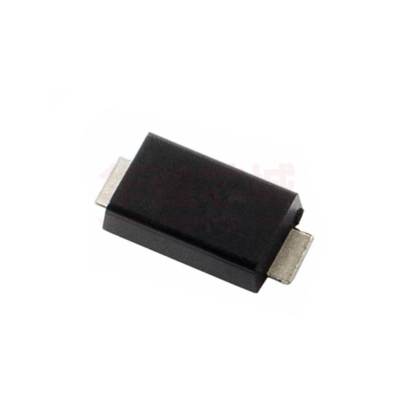

    TVS二极管 VRWM=3.3V VBR(Min)=5.2V VC=8V IPP=75A Ppp=600W SMB
SMBJ3.3A 数据手册
Surface Mount Transient Voltage Suppressors (TVS) SMBJ Series 5.0 To 440 V 600W Description Uni-directional Bi-directional The SMBJ series is designed specifically to protect sensitive electronic equipment from voltage transients induced by lightning and other transient voltage events. Features                    For surface mounted applications in order to optimize board space Low leakage Uni and Bidirectional unit Glass passivated junction Low inductance Excellent clamping capability 600W Peak power capability at 10 × 1000µs waveform Repetition rate (duty cycle):0.01% Fast response time: typically less than 1.0ps from 0 Volts to VBR min Typical IR less than 5μA above 12V. High Temperature soldering: 260°C/40 seconds at terminals Typical maximum temperature coefficient ΔVBR = 0.1% × VBR@25°C× ΔT Plastic package has Underwriters Laboratory Flammability 94V-0 Matte tin lead–free Plated Halogen free and RoHS compliant Typical failure mode is short from over-specified voltage or current Whisker test is conducted based on JEDEC JESD201A per its table 4a and 4c IEC-61000-4-2 ESD 15kV(Air), 8kV (Contact) ESD protection of data lines in accordance with IEC 61000-4-2 (IEC801-2) EFT protection of data lines in accordance with IEC 61000-4-4 (IEC801-4) Functional Diagram Bi-directional Cathode Anode Uni-direction Agency Approvals AGENCY AGENCY FILE NUMBER E341027 Applications TVS devices are ideal for the protection of I/O interfaces, VCC bus and other vulnerable circuits used in Telecom, Computer, Industrial and Consumer electronic applications. Maximum Ratings (TA=25℃ unless otherwise noted) Parameter Symbol Value Unit Peak Pulse Power Dissipation with a 10/1000µs waveform (Fig.1)(Note 1), (Note 2) PPPM 600 Watts Amps Peak Pulse Current with a 10/1000µs waveform.(Note1,Fig.3) IPP See Next Table PM(AV) 5.0 Watt Peak Forward Surge Current, 8.3ms Single Half Sine Wave (Note 3) IFSM 100 Amps Maximum Instantaneous Forward Voltage at 25A for Unidirectional Only (Note 4) VF 3.5/5.0 Voltage TJ , TSTG -55 to +150 ℃ Power Dissipation on Infinite Heat Sink at TL=75°C Operating junction and Storage Temperature Range. Notes: 1. Non-repetitive current pulse, per Fig. 3 and derated above TA = 25℃ per Fig. 2. 2. Mounted on 5.0mm x 5.0mm (0.03mm thick) Copper Pads to each terminal. 3. 8.3ms single half sine-wave, or equivalent square wave, Duty cycle = 4 pulses per minutes maximum. 4. VF < 3.5V for VBR < 200V and VF< 6.5V for VBR > 201V. SOCAY Electronics Corp., Ltd. Revision March 28, 2017 www.socay.com 1/7 @ SOCAY Electronics Corp., Ltd. 2017 Specifications are subject to change without notice. Please refer to www.socay.com for current information. Surface Mount Transient Voltage Suppressors (TVS) SMBJ Series 5.0 To 440 V 600W Electrical Characteristics (TA=25℃ unless otherwise noted) Part Number Marking Uni Bi Uni Bi SMBJ5.0A SMBJ5.0CA KE AE Reverse Stand-Off Voltage VRWM (V) Breakdown Voltage VBR (V) @IT Test Current IT (mA) Maximum Clamping Voltage VC @IPP (V) Maximum Peak Pulse Current IPP (A) Maximum Reverse Leakage IR @VRWM (μA) MIN MAX 5.0 6.40 7.00 10 9.2 65.22 800 6.67 7.37 10 10.3 58.25 800 SMBJ6.0A SMBJ6.0CA KG AG 6.0 SMBJ6.5A SMBJ6.5CA KK AK 6.5 7.22 7.98 10 11.2 53.57 500 SMBJ7.0A SMBJ7.0CA KM AM 7.0 7.78 8.60 10 12.0 50.00 200 SMBJ7.5A SMBJ7.5CA KP AP 7.5 8.33 9.21 1 12.9 46.51 100 8.89 9.83 1 13.6 44.12 50 SMBJ8.0A SMBJ8.0CA KR AR 8.0 SMBJ8.5A SMBJ8.5CA KT AT 8.5 9.44 10.40 1 14.4 41.67 10 SMBJ9.0A SMBJ9.0CA KV AV 9.0 10.00 11.10 1 15.4 38.96 5 SMBJ10A SMBJ10CA KX AX 10.0 11.10 12.30 1 17.0 35.29 5 SMBJ11A SMBJ11CA KZ WZ 11.0 12.20 13.50 1 18.2 32.97 5 SMBJ12A SMBJ12CA LE BE 12.0 13.30 14.70 1 19.9 30.15 5 SMBJ13A SMBJ13CA LG BG 13.0 14.40 15.90 1 21.5 27.91 5 SMBJ14A SMBJ14CA LK BK 14.0 15.60 17.20 1 23.2 25.86 5 SMBJ15A SMBJ15CA LM BM 15.0 16.70 18.50 1 24.4 24.59 5 SMBJ16A SMBJ16CA LP BP 16.0 17.80 19.70 1 26.0 23.08 5 SMBJ17A SMBJ17CA LR BR 17.0 18.90 20.90 1 27.6 21.74 5 SMBJ18A SMBJ18CA LT BT 18.0 20.00 22.10 1 29.2 20.55 5 SMBJ19A SMBJ19CA LB BB 19.0 21.10 23.30 1 30.8 19.49 5 SMBJ20A SMBJ20CA LV BV 20.0 22.20 24.50 1 32.4 18.52 5 SMBJ22A SMBJ22CA LX BX 22.0 24.40 26.90 1 35.5 16.90 5 SMBJ24A SMBJ24CA LZ BZ 24.0 26.70 29.50 1 38.9 15.42 5 SMBJ26A SMBJ26CA ME CE 26.0 28.90 31.90 1 42.1 14.25 5 SMBJ28A SMBJ28CA MG CG 28.0 31.10 34.40 1 45.4 13.22 5 SMBJ30A SMBJ30CA MK CK 30.0 33.30 36.80 1 48.4 12.40 5 SMBJ33A SMBJ33CA MM CM 33.0 36.70 40.60 1 53.3 11.26 5 SMBJ36A SMBJ36CA MP CP 36.0 40.00 44.20 1 58.1 10.33 5 SMBJ40A SMBJ40CA MR CR 40.0 44.40 49.10 1 64.5 9.30 5 SMBJ43A SMBJ43CA MT CT 43.0 47.80 52.80 1 69.4 8.65 5 SOCAY Electronics Corp., Ltd. Revision March 28, 2017 www.socay.com 2/7 @ SOCAY Electronics Corp., Ltd. 2017 Specifications are subject to change without notice. Please refer to www.socay.com for current information. Surface Mount Transient Voltage Suppressors (TVS) SMBJ Series 5.0 To 440 V Electrical Characteristics 600W (TA=25℃ unless otherwise noted) (Continue) Uni Bi Uni Bi Reverse Stand-Off Voltage VRWM (V) SMBJ45A SMBJ45CA MV CV SMBJ48A SMBJ48CA MX SMBJ51A SMBJ51CA SMBJ54A Breakdown Voltage VBR (V) @IT Maximum Clamping Voltage VC @IPP (V) Maximum Peak Pulse Current IPP (A) Maximum Reverse Leakage IR @VRWM (μA) MIN MAX Test Current IT (mA) 45.0 50.00 55.30 1 72.7 8.25 5 CX 48.0 53.30 58.90 1 77.4 7.75 5 MZ CZ 51.0 56.70 62.70 1 82.4 7.28 5 SMBJ54CA NE DE 54.0 60.00 66.30 1 87.1 6.89 5 SMBJ58A SMBJ58CA NG DG 58.0 64.40 71.20 1 93.6 6.41 5 SMBJ60A SMBJ60CA NK DK 60.0 66.70 73.70 1 96.8 6.20 5 SMBJ64A SMBJ64CA NM DM 64.0 71.10 78.60 1 103.0 5.83 5 SMBJ70A SMBJ70CA NP DP 70.0 77.80 86.00 1 113.0 5.31 5 SMBJ75A SMBJ75CA NR DR 75.0 83.30 92.10 1 121.0 4.96 5 SMBJ78A SMBJ78CA NT DT 78.0 86.70 95.80 1 126.0 4.76 5 SMBJ80A SMBJ80CA NB DB 80.0 88.80 97.60 1 129.6 4.63 5 SMBJ85A SMBJ85CA NV DV 85.0 94.40 104.00 1 137.0 4.38 5 SMBJ90A SMBJ90CA NX DX 90.0 100.00 111.00 1 146.0 4.11 5 SMBJ100A SMBJ100CA NZ DZ 100.0 111.00 123.00 1 162.0 3.70 5 SMBJ110A SMBJ110CA PE EE 110.0 122.00 135.00 1 177.0 3.39 5 SMBJ120A SMBJ120CA PG EG 120.0 133.00 147.00 1 193.0 3.11 5 SMBJ130A SMBJ130CA PK EK 130.0 144.00 159.00 1 209.0 2.87 5 SMBJ140A SMBJ140CA PB EB 140.0 155.00 171.00 1 226.8 2.65 5 SMBJ150A SMBJ150CA PM EM 150.0 167.00 185.00 1 243.0 2.47 5 SMBJ160A SMBJ160CA PP EP 160.0 178.00 197.00 1 259.0 2.32 5 SMBJ170A SMBJ170CA PR ER 170.0 189.00 209.00 1 275.0 2.18 5 SMBJ180A SMBJ180CA PT ET 180.0 201.00 220.00 1 291.6 2.06 5 SMBJ190A SMBJ190CA PV EV 190.0 211.00 232.00 1 307.8 1.95 5 SMBJ200A SMBJ200CA PW EW 200.0 224.00 247.00 1 324.0 1.85 5 SMBJ220A SMBJ220CA PX EX 220.0 246.00 272.00 1 356.0 1.69 5 SMBJ250A SMBJ250CA PZ EZ 250.0 279.00 309.00 1 405.0 1.48 5 SMBJ300A SMBJ300CA QE FE 300.0 335.00 371.00 1 486.0 1.23 5 SMBJ350A SMBJ350CA QG FG 350.0 391.00 432.00 1 567.0 1.06 5 SMBJ400A SMBJ400CA QK FK 400.0 447.00 494.00 1 648.0 0.93 5 SMBJ440A SMBJ440CA QM FM 440.0 492.00 543.00 1 713.0 0.84 5 Part Number Marking Note: 1. Suffix 'A ' denotes 5% tolerance device. 2. Add suffix ' CA ' after part number to specify Bi-directional devices. 3. For Bi-Directional devices having VR of 10 volts and under, the IR limit is double. SOCAY Electronics Corp., Ltd. Revision March 28, 2017 www.socay.com 3/7 @ SOCAY Electronics Corp., Ltd. 2017 Specifications are subject to change without notice. Please refer to www.socay.com for current information. Surface Mount Transient Voltage Suppressors (TVS) SMBJ Series 5.0 To 440 V 600W Ratings and Characteristic Curves (TA=25°C unless otherwise noted) Figure 1 - Peak Pulse Power Rating Curve Figure 2 - Pulse Derating Curve Peak Pulse Power (PPP) or Current (IPP) Derating in Percentage % PPPM - Peak Pulse Power (kW) 10 10 1 0.1 0.1 1 10 100 td - Pulse Width (μs) 1000 60 40 20 0 0 25 50 75 100 125 TA-Ambient temperature(°C) 150 175 Figure 4 - Typical Junction Capacitance 10000 150 tr=10µsec Bi-directional @zero bins TJ=25°C Pulse Width(td) is defined as the point where the peak current decays to 50% of IPPM Peak Value IPPM Uni-directional @zero bins 1000 100 Cj (pF) IPPM - Peak Pulse Current, % IRSM 80 10000 Figure 3 - Pulse Waveform Half Value IPPM (IPPM/2) 50 0 10 tc 0 2.0 t - Time (ms) 3.0 4.0 1.0 IFSM-Peak Forward Surge Current (A) 4.0 3.0 2.0 1.0 25 50 75 100 125 150 175 100.0 1000.0 SOCAY Electronics Corp., Ltd. TJ=TJ max. 8.3 ms Single Half Sine-Wave 80 60 40 20 0 200 TL - Lead Temperature(°C) Revision March 28, 2017 10.0 Figure 6 - Maximum Non-Repetitive Surge Current 100 0 Bi-directional @VRWM VBR-Reverse Breakdown Voltage (V) 5.0 0.0 Tj=25°C f=1.0MHz Vsig=50mVp-p 1 1.0 Uni-directional @VRWM 100 10/1000µsec. Waveform as defined by R.E.A Figure 5 - Steady State Power Derating Curve PM(AV), Steady State Power Dissipation (W) 100 1 10 Number of Cycles at 60Hz 100 www.socay.com 4/7 @ SOCAY Electronics Corp., Ltd. 2017 Specifications are subject to change without notice. Please refer to www.socay.com for current information. Surface Mount Transient Voltage Suppressors (TVS) SMBJ Series 5.0 To 440 V 600W I-V Curve Characteristics Uni-directional Bi-directional I I IPP IF VC V VBR VRW R M VF IT IPP VC C r i t i c a l IR IT IT V IR VRW VBR VC R M IPP Z o n e T Physical Specifications VBR VRW R M Environmental Specifications L Weight 0.003 ounce, 0.093 gram Case JEDEC DO-214AA Molded Plastic over T glass passivated junction t o P Color band denotes cathode except Bipolar Matte Tin-plated leads, Solderable per JESD22-B102D Polarity Terminal Temperature Cycle JESD22-A104 Pressure Cooker JESD22-A102 High Temp. Storage JESD22-A103 HTRB JESD22-A108 Thermal Shock JESD22-A106 Soldering Parameters Reflow Condition Pre Heat TP Ramp-up TL Critical Zone TL to TP Temperature TS(max) Ramp-down TS(min) 25 -Temperature Min (Ts(min)) 150°C -Temperature Max (Ts(max)) 200°C - Time (min to max) (Ts) 60 -180 Seconds Average ramp up rate ( Liquidus Temp TL) to peak 3°C/second max TS(max) to TL - Ramp-up Rate 3°C/second max Reflow Preheat Lead–free assembly - Temperature (TL) (Liquidus) 217°C - Time (min to max) (TL) 60 -150 Seconds Peak Temperature (TP) Time to peak temperature (t 25℃ to peak) Time Time within 5°C Temperature (tp) SOCAY Electronics Corp., Ltd. Revision March 28, 2017 260 +0/-5°C of actual peak 20 -40 Seconds Ramp-down Rate 6°C/second max Time 25°C to peak Temperature (TP) 8 minutes Max Do not exceed 280°C www.socay.com 5/7 @ SOCAY Electronics Corp., Ltd. 2017 Specifications are subject to change without notice. Please refer to www.socay.com for current information. Surface Mount Transient Voltage Suppressors (TVS) SMBJ Series 5.0 To 440 V 600W Dimensions Dimensions DO-214AA (SMB) Cathode Band Part Numbering Inches Millimeters Min Max Min Max A 0.073 0.087 1.85 2.21 B 0.167 0.187 4.25 4.75 C 0.130 0.155 3.30 3.94 D 0.083 0.096 2.11 2.44 E 0.030 0.060 0.76 1.52 F 0.002 0.008 0.051 0.203 G 0.200 0.220 5.08 5.59 H 0.006 0.012 0.15 0.31 I 0.090 - 2.40 - J 0.085 - 2.10 - K - 0.100 - 2.60 L 0.085 - 2.10 - Part Marking SMBJ×××CA Socay Logo 5% VBR VOLTAGE TOLERANCE BI-DIRECTIONAL VR VOLTAGE Cathode Band SERIES SOCAY Electronics Corp., Ltd. Revision March 28, 2017 Marking Code www.socay.com 6/7 @ SOCAY Electronics Corp., Ltd. 2017 Specifications are subject to change without notice. Please refer to www.socay.com for current information. Surface Mount Transient Voltage Suppressors (TVS) SMBJ Series 5.0 To 440 V 600W Packaging Part Number Component Package Quantity Packaging Option Reel Diameters (mm) SMBJXXXXX DO-214AA (SMB) 500 pcs Tape & Reel -12mm/7″tape 177.8 SMBJXXXXX DO-214AA (SMB) 3000 pcs Tape & Reel -12mm/13″tape 330.0 Tape and Reel Specifications 7.0/13.0 (177.8/330.0) 0.157 (4.0) 0.059 Diameter (1.5) 0.472 (12.0) 0.36 (9.2) 0.512(13.0) Arbor Hole Diameter 0.315 (8.0) 0.49 (12.4) Cover tape Direction of Feed Dimensions are in inches (and millimeters) SOCAY Electronics Corp., Ltd. Revision March 28, 2017 www.socay.com 7/7 @ SOCAY Electronics Corp., Ltd. 2017 Specifications are subject to change without notice. Please refer to www.socay.com for current information.
