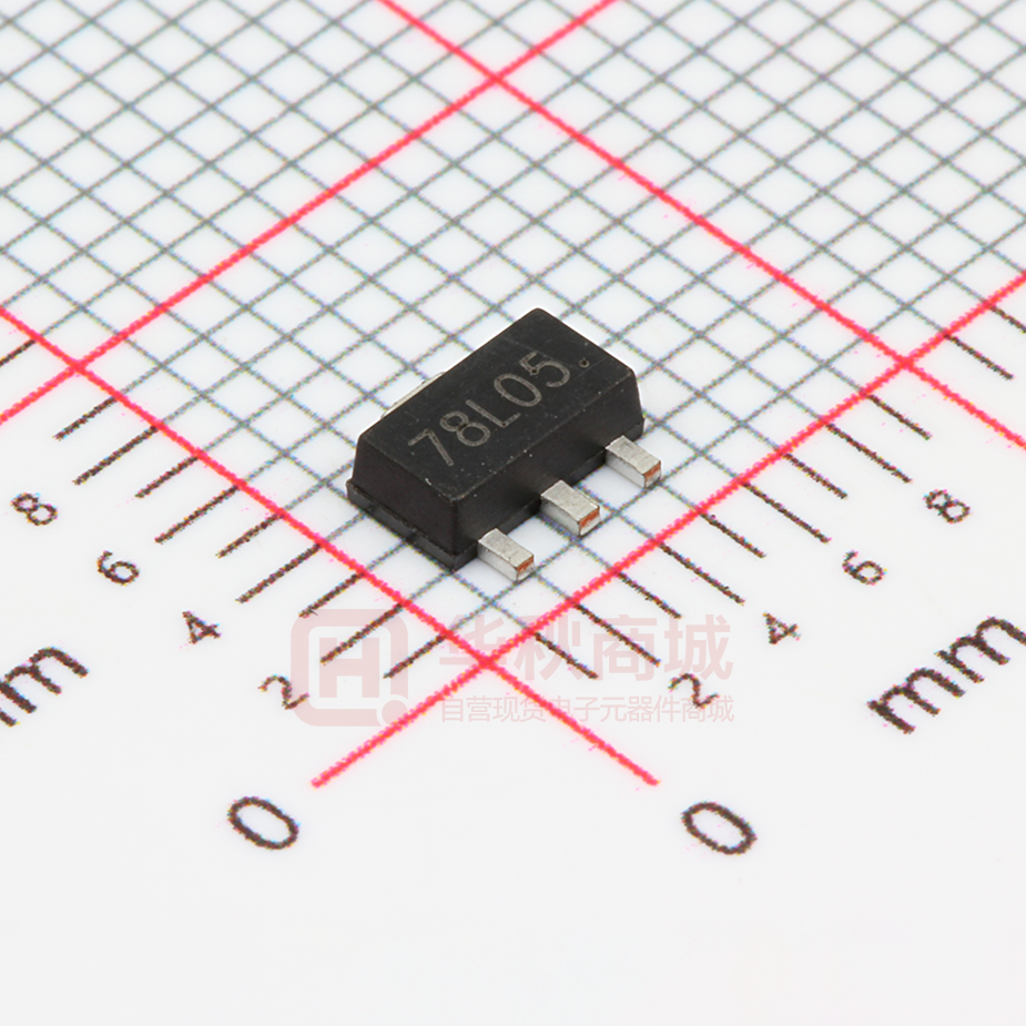

    输出类型:固定 输出极性:正 最大输入电压:35V 输出电压:5V 输出电流:150mA 电源纹波抑制比(PSRR):49dB@(120Hz)
78L05 数据手册
3-Terminal Terminal Positive Voltage Regulator FEATURES ·Maximum Output Current IO: 0.15 A ·Output Voltage VO: 5V/6V/8V/9V/10V/12V/15V/18V/20V/24V /6V/8V/9V/10V/12V/15V/18V/20V/24V ·Continuous Total Dissipation PD: 0.5 W (Ta = 25 ℃) 1:OUT 2:GND GND 33:IN SOT-89 89 PLASTIC PACKAGE Absolute Maximum Ratings (Ta = 25 OC) Parameter Input Voltage Output 78L05~78L15 VI 78L18~78L24 78L05~78L24 Rating Unit 35 V 40 Io 150 mA Power Dissipation Ptot 500 1) mW Operating Temperature Topr - 40 to + 85 ℃ Junction Temperature Range TJ - 40 to +125 25 ℃ Storage Temperature Range Tstg - 55 to +150 ℃ 1) Device Current Symbol is installed in the heat dissipation good environment 78L05 Electrical Characteristics (Ta = 25℃ ℃) Parameter Symbol Co = 0.1 μF) (Unless otherwise specified, VI = 10 V, Io = 40 mA, CI = 0.33 μF, C Test Condition Min. Typ. Max. Unit Tj = 25℃ 4.75 5 5.25 V 7 V ≤ VI ≤ 20 V, 1 mA ≤ IO ≤ 40 mA 4.65 5 5.35 V 7 V ≤ VI ≤ 20 V, Tj = 25℃ -- -- 150 8 V ≤ VI ≤ 20 V, Tj = 25℃ -- -- 100 Output Voltage VO Voltage Regulation Sv Current Regulation SI 1 mA ≤ IO ≤ 100 mA, Tj = 25℃ -- -- 60 mV Quiescent Current IQ Tj = 25℃ -- -- 6 mA 8 V ≤ VI ≤ 20 V -- -- 1.5 1 mA ≤ IO ≤ 40 mA -- -- 0.1 mV Quiescent Current Change ΔIQ Ripple Rejection Srip f = 120 Hz, 8 V ≤ VI ≤ 18 V, Tj = 25℃ -- 49 -- dB Dropout Voltage VDrop Tj = 25℃ -- 1.7 -- V 1 of 6 mA 78L06 Electrical Characteristics (Ta = 25℃ ℃) Parameter Symbol (Unless otherwise specified, VI = 10 V, Io = 40 mA, CI = 0.33 μF, C Co = 0.1 μF) Test Condition Min. Typ. Max. Unit Tj = 25℃ 5.70 6 6.30 V 8.1 V ≤ VI ≤ 21 V, 1 mA ≤ IO ≤ 40 mA 5.58 6 6.42 V 8.1 V ≤ VI ≤ 21 V, Tj = 25℃ -- -- 150 9 V ≤ VI ≤ 21 V, Tj = 25℃ -- -- 110 Output Voltage VO Voltage Regulation Sv Current Regulation SI 1 mA ≤ IO ≤ 100 mA, Tj = 25℃ -- -- 70 mV Quiescent Current IQ Tj = 25℃ -- -- 6 mA 9 V ≤ VI ≤ 21 V -- -- 1.5 1 mA ≤ IO ≤ 40 mA -- -- 0.1 mV Quiescent Current Change ΔIQ Ripple Rejection Srip f = 120 Hz, 9 V ≤ VI ≤ 19 V, Tj = 25℃ -- 47 -- dB Dropout Voltage VDrop Tj = 25℃ -- 1.7 -- V 78L08 Electrical Characteristics (Ta = 25℃ ℃) Parameter Symbol mA IO=40mA,CI=0.33μF,CO=0.1μF) (Unless otherwise specified,0≤TJ≤+125℃,VI=14V,IO=40mA Test Condition Min. Typ. Max. Unit Tj = 25℃ 7.60 8 8.40 V 10.5 V ≤ VI ≤ 23 V, 1 mA ≤ IO ≤ 40 mA 7.44 8 8.56 V 10.5 V ≤ VI ≤ 23 V, Tj = 25℃ -- -- 175 11 V ≤ VI ≤ 23 V, Tj = 25℃ -- -- 125 Output Voltage VO Voltage Regulation Sv Current Regulation SI 1 mA ≤ IO ≤ 100 mA, Tj = 25℃ -- -- 80 mV Quiescent Current IQ Tj = 25℃ -- -- 6.5 mA 11 V ≤ VI ≤ 23 V -- -- 1.5 1 mA ≤ IO ≤ 40 mA -- -- 0.1 mV Quiescent Current Change ΔIQ Ripple Rejection Srip f = 120 Hz, 12 V ≤ VI ≤ 23 V, Tj = 25℃ -- 45 -- dB Dropout Voltage VDrop Tj = 25℃ -- 1.7 -- V 2 of 6 mA 78L09 Electrical Characteristics (Ta = 25℃ ℃) Parameter Symbol IO=40mA,CI=0.33μF,CO=0.1μF) (Unless otherwise specified: 0≤TJ≤+125℃,VI=15V,IO=40mA Test Condition Min. Typ. Max. Unit Tj = 25℃ 8.55 9 9.45 V 11.4 V ≤ VI ≤ 24 V, 1 mA ≤ IO ≤ 40 mA 8.37 9 9.63 V 11.4 V ≤ VI ≤ 24 V, Tj = 25℃ -- -- 200 12 V ≤ VI ≤ 24 V, Tj = 25℃ -- -- 160 Output Voltage VO Voltage Regulation Sv Current Regulation SI 1 mA ≤ IO ≤ 100 mA, Tj = 25℃ -- -- 90 mV Quiescent Current IQ Tj = 25℃ -- -- 6.5 mA 12 V ≤ VI ≤ 24 V -- -- 1.5 1 mA ≤ IO ≤ 40 mA -- -- 0.1 mV Quiescent Current Change ΔIQ Ripple Rejection Srip f = 120 Hz, 12 V ≤ VI ≤ 24 V, Tj = 25℃ -- 44 -- dB Dropout Voltage VDrop Tj = 25℃ -- 1.7 -- V 78L10 Electrical Characteristics (Ta = 25℃ ℃) Parameter Symbol mA IO=40mA,CI=0.33μF,CO=0.1μF) (Unless otherwise specified: 0≤TJ≤+125℃,VI=16V,IO=40mA Test Condition Min. Typ. Max. Unit Tj = 25℃ 9.50 10 10.50 V 12.5 V ≤ VI ≤ 25 V, 1 mA ≤ IO ≤ 40 mA 9.30 10 10.70 V 12.5 V ≤ VI ≤ 25 V, Tj = 25℃ -- -- 230 13 V ≤ VI ≤ 25V, Tj = 25℃ -- -- 170 Output Voltage VO Voltage Regulation Sv Current Regulation SI 1 mA ≤ IO ≤ 100 mA, Tj = 25℃ -- -- 90 mV Quiescent Current IQ Tj = 25℃ -- -- 6.5 mA 13 V ≤ VI ≤ 25 -- -- 1.5 1 mA ≤ IO ≤ 40 mA -- -- 0.1 mV Quiescent Current Change ΔIQ Ripple Rejection Srip f = 120 Hz, 13 V ≤ VI ≤ 24 V, Tj = 25℃ -- 43 -- dB Dropout Voltage VDrop Tj = 25℃ -- 1.7 -- V 78L12 Electrical Characteristics (Ta = 25℃ ℃) Parameter Symbol mA (Unless otherwise specified: 0≤TJ≤+125℃,VI=19V,IO=40mA IO=40mA,CI=0.33μF,CO=0.1μF) Test Condition Min. Typ. Max. Unit Tj = 25℃ 11.40 12 12.60 V 14.5 V ≤ VI ≤ 27 V, 1 mA ≤ IO ≤ 40 mA 11.16 12 12.84 V 14.5 V ≤ VI ≤ 27 V, Tj = 25℃ -- -- 250 16 V ≤ VI ≤ 27 V, Tj = 25℃ -- -- 200 Output Voltage VO Voltage Regulation Sv Current Regulation SI 1 mA ≤ IO ≤ 100 mA, Tj = 25℃ -- -- 100 mV Quiescent Current IQ Tj = 25℃ -- -- 6.5 mA 16 V ≤ VI ≤ 27 V -- -- 1.5 1 mA ≤ IO ≤ 40 mA -- -- 0.1 mV Quiescent Current Change ΔIQ Ripple Rejection Srip f = 120 Hz, 15 V ≤ VI ≤ 25V, Tj = 25℃ -- 43 -- dB Dropout Voltage VDrop Tj = 25℃ -- 1.7 -- V 3 of 6 mA 78L15 Electrical Characteristics (Ta = 25℃ ℃) Parameter Symbol IO=40mA,CI=0.33μF,CO=0.1μF) (Unless otherwise specified: 0≤TJ≤+125℃,VI=23V,IO=40mA Test Condition Min. Typ. Max. Unit Tj = 25℃ 14.25 15 15.75 V 17.5 V ≤ VI ≤ 30V, 1 mA ≤ IO ≤ 40 mA 13.95 15 16.05 V 17.5 V ≤ VI ≤ 30V, Tj = 25℃ -- -- 200 20 V ≤ VI ≤ 30V, Tj = 25℃ -- -- 250 Output Voltage VO Voltage Regulation Sv Current Regulation SI 1 mA ≤ IO ≤ 100 mA, Tj = 25℃ -- -- 150 mV Quiescent Current IQ Tj = 25℃ -- -- 6.5 mA 20 V ≤ VI ≤ 30 V -- -- 1.5 1 mA ≤ IO ≤ 40 mA -- -- 0.1 mV Quiescent Current Change ΔIQ Ripple Rejection Srip f = 120 Hz, 18.5 V ≤ VI ≤ 28.5V, Tj = 25℃ -- 40 -- dB Dropout Voltage VDrop Tj = 25℃ -- 1.7 -- V 78L18 Electrical Characteristics (Ta = 25℃ ℃) Parameter Symbol mA IO=40mA,CI=0.33μF,CO=0.1μF) (Unless otherwise specified: 0≤TJ≤+125℃,VI=27V,IO=40mA Test Condition Min. Typ. Max. Unit Tj = 25℃ 17.10 18 18.90 V 21.4 V ≤ VI ≤ 33V, 1 mA ≤ IO ≤ 40 mA 16.74 18 19.26 V 21.4 V ≤ VI ≤ 33V, Tj = 25℃ -- -- 325 22 V ≤ VI ≤ 33V, Tj = 25℃ -- -- 275 Output Voltage VO Voltage Regulation Sv Current Regulation SI 1 mA ≤ IO ≤ 100 mA, Tj = 25℃ -- -- 170 mV Quiescent Current IQ Tj = 25℃ -- -- 6.5 mA 22 V ≤ VI ≤ 33V -- -- 1.5 1 mA ≤ IO ≤ 40 mA -- -- 0.1 mV Quiescent Current Change ΔIQ Ripple Rejection Srip f = 120 Hz, 23 V ≤ VI ≤ 33V, Tj = 25℃ -- 38 -- dB Dropout Voltage VDrop Tj = 25℃ -- 1.7 -- V 78L20 Electrical Characteristics (Ta = 25℃ ℃) Parameter Symbol mA (Unless otherwise specified: 0≤TJ≤+125℃,VI=29V,IO=40mA IO=40mA,CI=0.33μF,CO=0.1μF) Test Condition Min. Typ. Max. Unit Tj = 25℃ 19.0 20 21.0 V 23.5 V ≤ VI ≤ 35V, 1 mA ≤ IO ≤ 40 mA 18.60 20 21.40 V 23.5 V ≤ VI ≤ 35V, Tj = 25℃ -- -- 330 24V ≤ VI ≤ 35V, Tj = 25℃ -- -- 285 Output Voltage VO Voltage Regulation Sv Current Regulation SI 1 mA ≤ IO ≤ 100 mA, Tj = 25℃ -- -- 180 mV Quiescent Current IQ Tj = 25℃ -- -- 6.5 mA 24V ≤ VI ≤ 35V -- -- 1.5 1 mA ≤ IO ≤ 40 mA -- -- 0.1 mV Quiescent Current Change ΔIQ Ripple Rejection Srip f = 120 Hz, 25V ≤ VI ≤ 35V, Tj = 25℃ -- 37 -- dB Dropout Voltage VDrop Tj = 25℃ -- 1.7 -- V 4 of 6 mA 78L24 Electrical Characteristics (Ta = 25℃ ℃) Parameter IO=40mA,CI=0.33μF,CO=0.1μF) (Unless otherwise specified: 0≤TJ≤+125℃,VI=33V,IO=40mA Symbol Test Condition Min. Typ. Max. Unit Tj = 25℃ 22.80 24 25.20 V 27.5 V ≤ VI ≤ 38V, 1 mA ≤ IO ≤ 40 mA 22.32 24 25.68 V 27.5 V ≤ VI ≤ 38V, Tj = 25℃ -- -- 350 28V ≤ VI ≤ 38V, Tj = 25℃ -- -- 300 Output Voltage VO Voltage Regulation Sv Current Regulation SI 1 mA ≤ IO ≤ 100 mA, Tj = 25℃ -- -- 200 mV Quiescent Current IQ Tj = 25℃ -- -- 6.5 mA 28V ≤ VI ≤ 38V -- -- 1.5 1 mA ≤ IO ≤ 40 mA -- -- 0.1 mV Quiescent Current Change ΔIQ Ripple Rejection Srip f = 120 Hz, 29V ≤ VI ≤ 39V, Tj = 25℃ -- 35 -- dB Dropout Voltage VDrop Tj = 25℃ -- 1.7 -- V Electrical characteristic curve Figure 1: dissipation power relationship with the temperature curve Figure 2 output voltage and junction temperature curve 5 of 6 mA Outline Dimension Unit: mm 6 of 6
