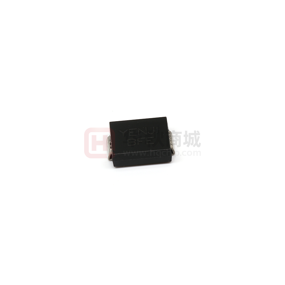

    ESD抑制器/TVS二极管 VRWM=26V VBR(min)=28.9V VC=42.1V@IPP=35.7A SMC
SMCJ26CA 数据手册
SMCJ SERIES TRANSIENT VOLTAGE SUPPRESSORS FEATURE — — — — — — — — — — — For surface mounted applications in order to optimize board space. Low profile package. Built-in strain relief. Glass passivated junction. Low inductance. Excellent clamping capability. Repetition Rate (duty cycle):0.05%. Fast response time: typically less than 1.0ps from 0 Volts to BV min. Typical IR less than 1μA above 10V. High Temperature soldering: 260°C/10 seconds at terminals. Plastic package has Underwriters Laboratory Flammability 94V-O. SMC/DO-214AB MECHANICAL DATE — — — — — Case: JEDEC DO214AB. Molded plastic over glass passivated junction. Terminal: Solder plated, solderable per MIL-STD-750, Method 2026. Polarity: Color band denoted positive end (cathode) except Bidirectional. Standard Packaging: 12mm tape (EIA STD RS-481). Weight: 0.007 ounce, 0.21 grams. DEVICES FOR BIPOLAR APPLICATION For bidirectional use C or CA suffix for types SMCJ5.0 thru types SMCJ440 (e.g.SMCJ5.0CA, SMCJ440CA), electrical characteristics apply in both directions. MAXIMUM RATINGS AND CHARACTERISTICS Ratings at 25ć ambient temperature unless otherwise specified. RATING SYMBOL VALUE UNITS Peak Pulse Power Dissipation on 10/1000ȝs waveform (Note1,Note2, Fig.1). PPPM Minimum 1500 Watts Peak Pulse Current of on 10/1000ȝs waveform.(Note1,Fig.3) IPPM See Table Amps Steady State Power Dissipation at TL =75ć,Lead lengths.375”, (9.5mm) (Note2,Fig.5). PM(AV) 6.5 Watts Peak Forward Surge Current,8.3ms Single Half Sine-Wave Superimposed on Rated Load, (JEDEC Method) (Note 3,Fig.6). IFSM 200 Amps TJ , TSTG -65 to +150 ć Operating junction and Storage Temperature Range. Notes: 1. Non-repetitive current pulse, per Fig. 3 and derated above TA = 25ć per Fig. 2. 2. Mounted on 0.8mm x 0.8mm Copper Pads to each terminal. 3. 8.3ms single half sine-wave, or equivalent square wave, Duty cycle = 4 pulses per minutes maximum. 1/4 SMCJ SERIES Cathode Band s D1 D d T1 T L SMC/DO-214AB Millimeters Item Inches Min. Max. Min. Max. L 6.60 7.11 0.260 0.280 D 5.59 6.22 0.220 0.245 D1 2.90 3.20 0.114 0.126 T 7.75 8.13 0.305 0.320 T1 0.76 1.52 0.030 0.060 d - 0.203 - 0.008 s 2.06 2.62 0.079 0.103 t 0.152 0.305 0.006 0.012 ELECTRICAL CHARACTERISTICS Part Number Device Reverse Breakdown Breakdown Marking Stand-Off Voltage Voltage Code Voltage NIN.@IT MAX.@IT Test Current Maximum Peak Reverse Clamping Pulse Leakage Voltage @IPP Current @VRWM UNT-POLAR BI-POLAR UNI BI VRWM(V) VBR MIN.(V) VBR MAX.(V) IT(mA) VC(V) IPP(A) IR(ȝA) SMCJ5.0A SMCJ5.0CA GDE BDE 5.0 6.40 7.00 10 9.2 163.0 800 SMCJ6.0A SMCJ6.0CA GDG BDG 6.0 6.67 7.37 10 10.3 145.7 800 SMCJ6.5A SMCJ6.5CA GDK BDK 6.5 7.22 7.98 10 11.2 134.0 500 SMCJ7.0A SMCJ7.0CA GDM BDM 7.0 7.78 8.60 10 12.0 125.0 200 SMCJ7.5A SMCJ7.5CA GDP BDP 7.5 8.33 9.21 1 12.9 116.3 100 SMCJ8.0A SMCJ8.0CA GDR BDR 8.0 8.89 9.83 1 13.6 110.3 50 SMCJ8.5A SMCJ8.5CA GDT BDT 8.5 9.44 10.40 1 14.4 104.2 20 SMCJ9.0A SMCJ9.0CA GDV BDV 9.0 10.00 11.10 1 15.4 97.4 10 SMCJ10A SMCJ10CA GDX BDX 10.0 11.10 12.30 1 17.0 88.3 5 SMCJ11A SMCJ11CA GDZ BDZ 11.0 12.20 13.50 1 18.2 82.5 1 SMCJ12A SMCJ12CA GEE BEE 12.0 13.30 14.70 1 19.9 75.4 1 SMCJ13A SMCJ13CA GEG BEG 13.0 14.40 15.90 1 21.5 69.8 1 SMCJ14A SMCJ14CA GEK BEK 14.0 15.60 17.20 1 23.2 64.7 1 SMCJ15A SMCJ15CA GEM BEM 15.0 16.70 18.50 1 24.4 61.5 1 SMCJ16A SMCJ16CA GEP BEP 16.0 17.80 19.70 1 26.0 57.7 1 SMCJ17A SMCJ17CA GER BER 17.0 18.90 20.90 1 27.6 54.4 1 SMCJ18A SMCJ18CA GET BET 18.0 20.00 22.10 1 29.2 51.4 1 SMCJ20A SMCJ20CA GEV BEV 20.0 22.20 24.50 1 32.4 46.3 1 2/4 SMCJ SERIES Part Number Device Reverse Breakdown Breakdown Marking Stand-Off Voltage Voltage Code Voltage NIN.@IT MAX.@IT Test Current Maximum Peak Reverse Clamping Pulse Leakage Voltage @IPP Current @VRWM UNT-POLAR BI-POLAR UNI BI VRWM(V) VBR MIN.(V) VBR MAX.(V) IT(mA) VC(V) IPP(A) IR(ȝA) SMCJ22A SMCJ22CA GEX BEX 22.0 24.40 26.90 1 35.5 42.3 1 SMCJ24A SMCJ24CA GEZ BEZ 24.0 26.70 29.50 1 38.9 38.6 1 SMCJ26A SMCJ26CA GFE BFE 26.0 28.90 31.90 1 42.1 35.7 1 SMCJ28A SMCJ28CA GFG BFG 28.0 31.10 34.40 1 45.4 33.1 1 SMCJ30A SMCJ30CA GFK BFK 30.0 33.30 36.80 1 48.4 31.0 1 SMCJ33A SMCJ33CA GFM BFM 33.0 36.70 40.60 1 53.3 28.2 1 SMCJ36A SMCJ36CA GFP BFP 36.0 40.00 44.20 1 58.1 25.9 1 SMCJ40A SMCJ40CA GFR BFR 40.0 44.40 49.10 1 64.5 23.3 1 SMCJ43A SMCJ43CA GFT BFT 43.0 47.80 52.80 1 69.4 21.7 1 SMCJ45A SMCJ45CA GFV BFV 45.0 50.00 55.30 1 72.7 20.6 1 SMCJ48A SMCJ48CA GFX BFX 48.0 53.30 58.90 1 77.4 19.4 1 SMCJ51A SMCJ51CA GFZ BFZ 51.0 56.70 62.70 1 82.4 18.2 1 SMCJ54A SMCJ54CA GGE BGE 54.0 60.00 66.30 1 87.1 17.3 1 SMCJ58A SMCJ58CA GGG BGG 58.0 64.40 71.20 1 93.6 16.1 1 SMCJ60A SMCJ60CA GGK BGK 60.0 66.70 73.70 1 96.8 15.5 1 SMCJ64A SMCJ64CA GGM BGM 64.0 71.10 78.60 1 103.0 14.6 1 SMCJ70A SMCJ70CA GGP BGP 70.0 77.80 86.00 1 113.0 13.3 1 SMCJ75A SMCJ75CA GGR BGR 75.0 83.30 92.10 1 121.0 12.4 1 SMCJ78A SMCJ78CA GGT BGT 78.0 86.70 95.80 1 126.0 11.9 1 SMCJ85A SMCJ85CA GGV BGV 85.0 94.40 104.00 1 137.0 11.0 1 SMCJ90A SMCJ90CA GGX BGX 90.0 100.00 111.00 1 146.0 10.3 1 SMCJ100A SMCJ100CA GGZ BGZ 100.0 111.00 123.00 1 162.0 9.3 1 SMCJ110A SMCJ110CA GHE BHE 110.0 122.00 135.00 1 177.0 8.5 1 SMCJ120A SMCJ120CA GHG BHG 120.0 133.00 147.00 1 193.0 7.8 1 SMCJ130A SMCJ130CA GHK BHK 130.0 144.00 159.00 1 209.0 7.2 1 SMCJ150A SMCJ150CA GHM BHM 150.0 167.00 185.00 1 243.0 6.2 1 SMCJ160A SMCJ160CA GHP BHP 160.0 178.00 197.00 1 259.0 5.8 1 SMCJ170A SMCJ170CA GHR BHR 170.0 189.00 209.00 1 275.0 5.5 1 SMCJ180A SMCJ180CA GHT BHT 180.0 201.00 222.00 1 292.0 5.1 1 SMCJ190A SMCJ190CA GHU BHU 190.0 211.00 233.00 1 308.0 4.8 1 SMCJ200A SMCJ200CA GHV BHV 200.0 224.00 247.00 1 324.0 4.6 1 SMCJ210A SMCJ210CA GHW BHW 210.0 237.00 263.00 1 340.0 4.4 1 SMCJ220A SMCJ220CA GHX BHX 220.0 246.00 272.00 1 356.0 4.2 1 SMCJ250A SMCJ250CA GHZ BHZ 250.0 279.00 309.00 1 405.0 3.7 1 SMCJ300A SMCJ300CA GJE BJE 300.0 335.00 371.00 1 486.0 3.1 1 SMCJ350A SMCJ350CA GJG BJG 350.0 391.00 432.00 1 567.0 2.6 1 SMCJ400A SMCJ400CA GJK BJK 400.0 447.00 494.00 1 648.0 2.3 1 SMCJ440A SMCJ440CA GJM BJM 440.0 492.00 543.00 1 713.0 2.1 1 Notes: For bidirectional type having VRWM of 10 volts and less, the IR limit is double. 3/4 SMCJ SERIES Figure 1 - Peak Pulse Power Rating Curve Figure 2 - Pulse Derating Curve 100 Peak Pulse Power (PPP) or Current (IPP) Derating in Percentage % PPPM-Peak Pulse Power (kW) 100 10 0.31x0.31" (8.0x8.0mm) Copper Pad Area 1 0.000001 80 60 40 20 0 0.00001 0.0001 0.001 0 td-Pulse Width (sec.) 100 125 150 175 100000 tr=10μsec TJ=25°C Pulse Width(td) is defined as the point where the peak current decays to 50% of IPPM Peak Value IPPM 100 Bi-directional V=0V 10000 Uni-directional V=0V Cj (pF) IPPM- Peak Pulse Current, % IRSM 75 Figure 4 - Typical Junction Capacitance 150 Half Value IPPM IPPM ( ) 2 50 10/1000μsec. Waveform as defined by R.E.A 1000 100 Bi-directional @VR 10 td 1.0 0 2.0 3.0 Uni-directional @VR Tj=25C f=1.0MHz Vsig=50mVp-p 1 1.0 4.0 Figure 5 - Steady State Power Dissipation Derating Curve IFSM - Peak Forward Surge Current (A) 25 50 75 100 125 150 TA - Ambient Temperature (ºC) 100.0 1000.0 Figure 6 - Maximum Non-Repetitive Forward Non-Repetitive PeakOnly Forward Figure 6 - Maximum Surge Current Uni-Directional 6.5 6 5.5 5 4.5 4 3.5 3 2.5 2 1.5 1 0.5 0 0 10.0 VBR - Reverse Breakdown Voltage (V) t-Time (ms) PM(AV), Steady Sate Power Dissipation (W) 50 TA - Ambient temperature (ºC) Figure 3 - Pulse Waveform 0 25 200 180 160 140 120 100 80 60 40 20 0 175 1 10 Number of Cycles at 60 Hz 4/4 100
