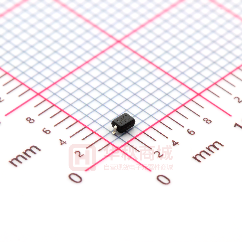

GBLC03CI thru GBLC24CI TVS Array The GBLCxxCI Series is ultra low capacitance transient voltage suppressor arrays, designed to protect applications such as portable electronics and SMART phones. This series is available in both unidirectional and bidirectional configurations and is rated at 350 Watts for an 8/20μs waveform. The GBLCxxCI Series meets IEC 61000-4-2 (ESD) and IEC 61000-4-4 (EFT) requirements. At higher operating frequencies or faster edge rates, insertion loss and signal integrity are a major concern. This series offers an ultra low capacitance and low leakage current in a miniature SOD-323 package. Features  350 Watts Peak Pulse Power per Line (8 x 20 us Waveform)  Replacement for MLV (0805)  Protects One Power or I/O Port  Low Clamping Voltage  Available in Multiple Voltages Ranging From 3V to 24V  Ultra Low Capacitance: 0.8pF (Typical)  Response Time is < 1 ns  Meets MSL 1 Requirements  Solid-state silicon avalanche technology  ROHS compliant  WeiPan technology Main applications  Hand−Held Portable Applications  Networking and Telecom(Ethernet 10/100/1000 Base T)  USB Interface  Automotive Electronics  Serial and Parallel Ports  Notebooks, Desktops, Servers SOD323 Protection solution to meet  IEC61000-4-2 (ESD) ±15kV (air), ±8kV (contact)  IEC61000-4-4 (EFT) 40A (5/50ns) 1/4 GBLC03CI thru GBLC24CI TVS Array Maximum ratings (Tamb=25℃ Unless Otherwise Specified) Parameter Peak Pulse Power (tp=8/20μs waveform) ESD Rating per IEC61000-4-2: Symbol Value Unit PPPP 350 Watts Contact 8 Air 15 KV Lead Soldering Temperature TL 260 (10 sec.) ℃ Operating Temperature Range TJ -55 ~ 150 ℃ TSTG -55 ~ 150 ℃ TL 260 ℃ Storage Temperature Range Lead Solder Temperature − Maximum (10 Second Duration) Maximum ratings are those values beyond which device damage can occur. Maximum ratings applied to the device are individual stres s limit values (not normal operating conditions) and are not valid simultaneously. If these limits are exceeded, device functional operation is not implied, damage may occur and reliability may be affected. *Other voltages may be available upon request. 1. Non-repetitive current pulse, per Figure 1. Electrical characteristics ( Tamb=25℃ Unless Otherwise Specified) VRWM VBR @ 1 mA VC (Volts) @1A Max IPP IR @ VRWM Device Capacitance @ VR = 0 V, 1 PPK MHz (pF) (V) (uA) Min (V) (A) Typ (W) GBLC03CI 3 5 4.00 7.50 22 0.8 350 GBLC05CI 5 2 6.00 9.80 20 0.8 350 GBLC08CI 8 1 8.50 13.6 13 0.8 350 GBLC12CI 12 1 13.3 19.0 10 350 GBLC15CI 15 1 16.7 24.0 8.0 0.8 0.8 GBLC24CI 24 1 26.7 43.0 6.0 0.8 350 350 Junction capacitance is measured in VR=0V,F=1MHz I Symbol VRWM IPP Parameter Working Peak Reverse Voltage VBR Breakdown Voltage @ IT VC Clamping Voltage @ IPP IT Test Current IRM Leakage current at VRWM IPP Peak pulse current CO Off-state Capacitance CJ Junction Capacitance VC VBR VRWM IT IR IR IT IPP 2/4 VRWM VBR VC V GBLC03CI thru GBLC24CI TVS Array Typical electrical characterist applications 10 Waveform Parameters: tr=8us td=20us Peak Pulse Power-P PK(KW) PP 110 100 90 80 70 60 50 40 30 20 10 0 td=IPP/2 0 5 10 15 20 25 30 % of Rated Power or Ipp 110 100 90 80 70 60 50 40 30 20 10 0 50 75 0.01 0.1 1 10 100 1000 Non-Repetitive Peak Pulse Power vs. Pulse Time Pulse Waveform 25 0.1 Pulse Duration-tp(us) Time (us) 0 1 100 125 150 Ambient Temperature-TA Power Derating Curve 3/4 GBLC03CI thru GBLC24CI TVS Array Package Information Mechanical Data Case: SOD-323 Case Material: Molded Plastic. UL Flammability K A Millimeters Dim D 2 1 A B E J Min Max Min Max 1.60 1.80 0.063 0.071 B 1.2 1.40 0.047 0.055 C 0.80 0.90 0.031 0.035 D 0.25 0.35 0.010 0.014 0.15REF E C Inches 0.006REF H 0 0.10 0 0.004 J 0.08 0.15 0.003 0.006 K 2.50 2.70 0.098 0.106 H SOD-123 Recommended Pad outline 0.7 2.15 0.7 SOD-323 Reel Dim E P0 K P2 D W F D1 A0 T B0 B1 K0 P1 Package Pocket Size Tape B0×A0×K0(mm) Width Chip Size Reel Diameter Quantity Per Reel P0 P1 4mm 4mm SOD-323 2.60×1.40×1.05 3.30×1.50×1.25 8mm 178mm(7") 3000 D0 D1 E F K T W 1.5mm 0.5mm 1.75mm 3.5mm 0.95mm 0.2mm 8mm 4/4
