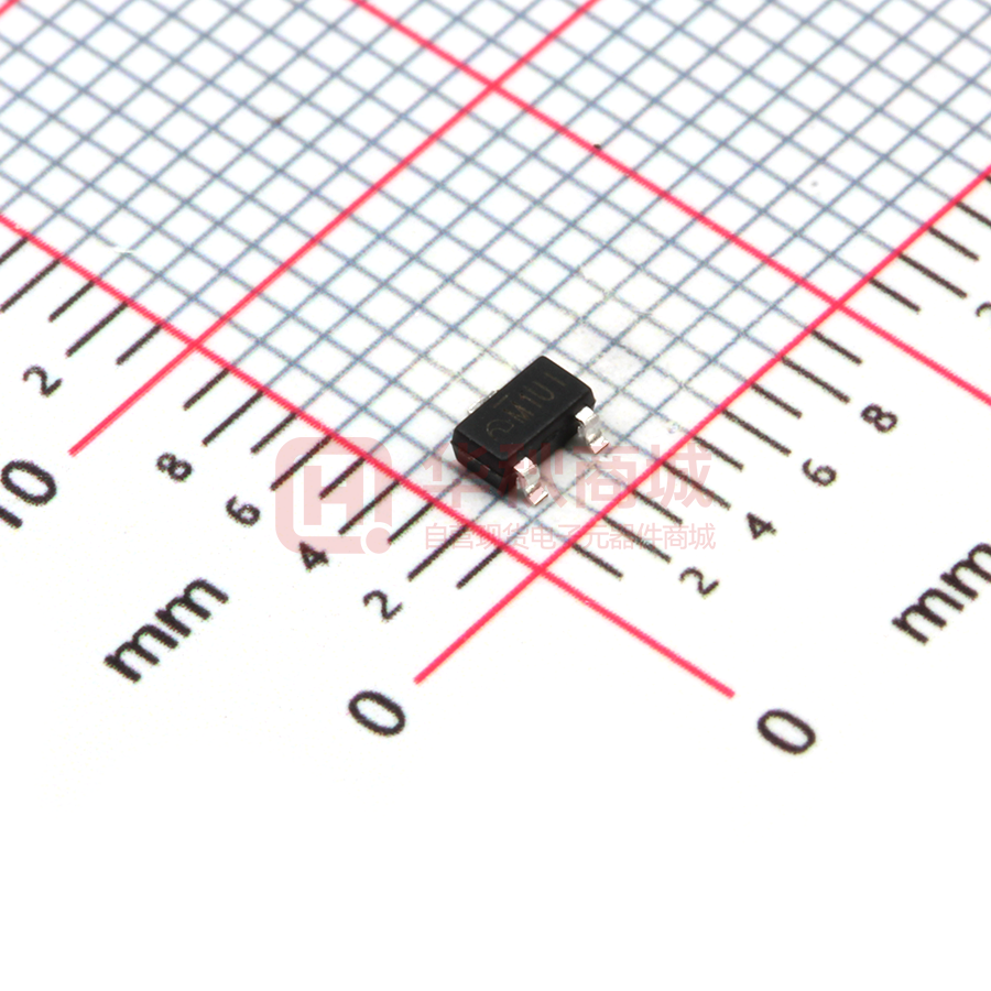

    SOT23-3
    输出类型:固定 输出极性:正 最大输入电压:18V 输出电压:3.3V 输出电流(最大值):500mA
ME6210A33M3G 数据手册
ME6210 500mA,Low Quiescent, Low Dropout LDO Linear Regulators General Description Features ME6210 series are low quiescent, low-dropout  High output accuracy:± 2% linear voltage regulators.ME6210 series are based  Input voltage:2V to 18 V on the CMOS process and allow high voltage  Output voltage:1.5V ~ 5.0V input .The allow operation voltage as high as 18V.  Ultra-low quiescent current (Typ. = 1.5 µ A) ME6210 series have short circuit protection  Output Current:Iout = 500mA (When Vin = 4V and Vout =3V) function. Low dropout voltage: 11mV@ Iout =10mA (Typ. Vout = 3.0V) Typical  Application Power source for home electric/electronic  Input good stability:Typ. 0.03% / V  Short-circuit Current::Typ. 50mA  Ceramic capacitor can be used Package  3-pin SOT89-3,SOT23-3,SOT23,TO92 appliances  Power source for battery-powered devices  Power source for personal communication devices V05 Typical Application Circuit www.microne.com.cn Page 1 of 12 ME6210 Selection Guide ME 6210X X X X X G Environment mark Package: P-SOT89-3 M3-SOT23-3 X-SOT23 T-TO92 Output Voltage Function Product Type Product Series Microne product series product description ME6210A30PG VOUT =3.0V; Package:SOT89-3 ME6210A28M3G VOUT =2.8V; Package:SOT23-3 ME6210A33M3G VOUT =3.3V; Package:SOT23-3 NOTE: 1. At present ,there are five kinds of voltage value: 2.5、2.8V、3.0V、3.3V、3.6V、4.0V、5.0V。 2. If you need other voltage and package, please contact our sales staff。 V05 www.microne.com.cn Page 2 of 12 ME6210 Pin Configuration Pin Assignment ME6210Axx Pin Number M3 P X T SOT23-3 SOT89-3 SOT23 TO-92 1 1 1 1 VSS Ground 2 3 2 3 VOUT Output 3 2 3 2 VIN Input Name Function Absolute Maximum Ratings Parameter Symbol Description Units Input Voltage VIN 18 V Output Current IOUT 700 mA Output Voltage VOUT Vss-0.3 ~ Vout+0.3 V SOT23-3 Pd 300 mW SOT89-3 Pd 500 mW SOT23 Pd 250 mW TO-92 Pd 500 mW Operating Ambient Temperature TOpr -25 ~ +85 ℃ Storage Temperature Tstg -40 ~ +125 ℃ Power Dissipation Lead Temperature V05 260℃,10sec www.microne.com.cn Page 3 of 12 ME6210 Block Diagram Electrical Characteristics ME6210A30 (VIN= VOUT+1.0V,CIN=COUT=10uF,Ta=25OC, unless otherwise noted) Parameter Output Voltage Input Voltage Maximum Output Current Load Regulation Dropout Voltage (Note 3) Supply Current Line Regulations Temperature coefficient Short-circuit V05 Current Symbol Conditions VOUT(E) IOUT=40mA, (Note 2) VIN=Vout+1V Min. X 0.98 Typ. VOUT (T) (Note 1) VIN IOUT _max ∆VOUT VIN=Vout+1V VIN=Vout+1V, 1mA≤IOUT≤200mA Max. Units X 1.02 V 18 V 500 mA 12 30 mV VDIF1 IOUT =10mA 11 14 mV VDIF2 IOUT =100mA 110 140 mV VDIF3 IOUT =200mA 220 280 mV ISS VIN=Vout+1V 1.5 2.5 μ A 0.03 0.1 %/V ±60 ±100 Ppm/℃ 50 70 mA ∆VOUT IOUT =10mA ∆VIN ×VOUT Vout+1V ≤VIN≤18V ∆VOUT VIN=Vout+1V ,IOUT =10mA ∆Ta ×VOUT -40℃≤Ta≤125℃ Ishort VIN=Vout+1V www.microne.com.cn Page 4 of 12 ME6210 ME6210A33 (VIN= VOUT+1.0V,CIN=COUT=10uF,Ta=25OC, unless otherwise noted) Parameter Output Voltage Input Voltage Maximum Output Current Load Regulation Dropout Voltage (Note 3) Supply Current Line Regulations Temperature coefficient Short-circuit Current Symbol Conditions VOUT(E) IOUT=40mA, (Note 2) VIN=Vout+1V Min. X 0.98 Typ. VOUT (T) (Note 1) VIN IOUT _max ∆VOUT VIN=Vout+1V Max. Units X 1.02 V 18 V 500 VIN=Vout+1V, 1mA≤IOUT≤200mA mA 12 30 mV VDIF1 IOUT =10mA 10 13 mV VDIF2 IOUT =100mA 100 130 mV VDIF3 IOUT =200mA 200 260 mV ISS VIN=Vout+1V 1.6 2.5 μ A ∆VOUT IOUT =10mA ∆VIN ×VOUT Vout+1V ≤VIN≤18V 0.03 0.1 %/V ±60 ±100 Ppm/℃ 50 70 mA Typ. Max. Units X 1.02 V 18 V ∆VOUT VIN=Vout+1V ,IOUT =10mA ∆Ta ×VOUT -40℃≤Ta≤125℃ Ishort VIN=Vout+1V ME6210A50 (VIN= VOUT+1.0V,CIN=COUT=10uF,Ta=25OC, unless otherwise noted) Parameter Output Voltage Input Voltage Maximum Output Current Load Regulation Dropout Voltage (Note 3) Supply Current Line Regulations Temperature coefficient Short-circuit V05 Current Symbol Conditions VOUT(E) IOUT=40mA, (Note 2) VIN=Vout+1V Min. X 0.98 VOUT (T) (Note 1) VIN IOUT _max ∆VOUT VIN=Vout+1V VIN=Vout+1V, 1mA≤IOUT≤200mA 500 mA 10 30 mV VDIF1 IOUT =10mA 8 11 mV VDIF2 IOUT =100mA 80 110 mV VDIF3 IOUT =200mA 160 220 mV ISS VIN=Vout+1V 1.7 2.5 μ A ∆VOUT IOUT =10mA ∆VIN ×VOUT Vout+1V ≤VIN≤18V 0.03 0.1 %/V ∆VOUT VIN=Vout+1V ,IOUT =10mA ∆Ta ×VOUT -40℃≤Ta≤125℃ ±60 ±100 Ppm/℃ Ishort VIN=Vout+1V 50 70 mA www.microne.com.cn Page 5 of 12 ME6210 Note : 1. VOUT (T) :Specified Output Voltage 2.VOUT (E) :Effective Output Voltage ( ie. The output voltage when “VOUT (T)+1.0V”is provided at the Vin pin while maintaining a certain Iout value.) 3.VDIF:VIN1 –VOUT (E)’ VIN1 :The input voltage when VOUT (E)’ appears as input voltage is gradually decreased. VOUT (E)’=A voltage equal to 98% of the output voltage whenever an amply stabilized Iout and {VOUT (T) +1.0V} is input. Precautions  During the test, if AC/DC power supply and the ceramic chip capacitors collocation is used, there may be serious voltage spike phenomenon instantaneously. When the power supply access to 15V, the voltage is rushed to about 30V instantaneously. Because of exceeding the limit voltage of chip, the chip is damaged. If you string a small resistance of 1 ohm in the input end during the test, the peak phenomenon can be avoided.  In the test, there is serious burr phenomenon only when the AC/DC power is used with ceramic chip capacitors. But electrolytic capacitors and tantalum capacitance won't appear above phenomenon. Please be sure to pay attention to this point when you use AC/DC power.  In normal use, when any type of capacitor is used with battery or the supply of fire power, the above phenomenon doesn’t occur. V05 www.microne.com.cn Page 6 of 12 ME6210 Type Characteristics (1) Output Voltage VS. Output Current ( Ta = 25 °C,VIN=4V) ME6210A30 (2)Output Voltage VS. Input Voltage (Ta = 25 °C,Iout=10mA) ME6210A30 Output Voltage VS.Input Voltage 3.4 3.2 3.1 3 2.9 2.8 2.7 2.6 Output Voltage(V) Output Voltage(V) Output Voltage VS.Output Current 0 100 200 300 400 3 2.6 2.2 1.8 1.4 1 0.6 500 0 Output Current(mA) 2 4 8 10 12 14 16 18 16 18 Input Voltage(V) (3)Dropout Voltage VS. Output Current ( Ta = 25 °C) ME6210A30 (4)Supply Current VS. Input Voltage ( Ta = 25 °C) ME6210A30 Dropout Voltage VS.Output Current Supply Current VS.Input Voltage 2.4 600 Supply Current(uA) Dropout Voltage(mV) 6 500 400 300 200 100 2 1.6 1.2 0.8 0.4 0 0 0 100 200 300 400 500 0 2 Output Current(mA) 4 6 8 10 12 14 Input Voltage (V) (5)Output Voltage VS. Temperature(VIN=4V ,Iout=10mA) ME6210A30 Output Voltage VS.Temperature Output Voltage(V) 3.1 3.05 3 2.95 2.9 2.85 2.8 -40 -20 0 20 40 60 80 100 120 140 160 Temperature(℃) V05 www.microne.com.cn Page 7 of 12 ME6210 Packaging Information ● SOT89-3 DIM Millimeters Inches Min Max Min Max A 1.4 1.6 0.0551 0.0630 A1 1.4 1.6 0.0551 0.0630 a 0.36 0.48 0.0142 0.0189 b 0.41 0.53 0.0161 0.0209 c 0.36 0.48 0.0142 0.0189 d 1.4 1.75 0.0551 0.0689 B 0.38 0.43 0.015 0.0169 C 1.4 1.6 0.0551 0.0630 D 4.4 4.6 0.1732 0.181 E - 4.25 - 0.1673 e 2.4 2.6 0.0945 0.1023 L1 0.4 - 0.0157 - L2 0.8 - 0.0315 - V05 www.microne.com.cn Page 8 of 12 ME6210 ● SOT23-3 DIM V05 Millimeters Inches Min Max Min Max A 2.7 3.1 0.1063 0.122 B 1.7 2.1 0.0669 0.0827 b 0.35 0.5 0.0138 0.0197 C 1.0 1.2 0.0394 0.0472 c 0.1 0.25 0.0039 0.0098 d 0.2 - 0.0079 - E 2.6 3.0 0.1023 0.1181 e 1.5 1.8 0.059 0.0708 www.microne.com.cn Page 9 of 12 ME6210 ● SOT23 DIM V05 Millimeters Inches Min Max Min Max A 2.7 3.1 0.1063 0.122 B 1.7 2.1 0.0669 0.0827 b 0.35 0.5 0.0138 0.0197 C 1.0 1.2 0.0394 0.0472 c 0.1 0.25 0.0039 0.0098 d 0.2 - 0.0079 - E 2.1 2.64 0.0827 0.1039 e 1.2 1.4 0.0472 0.0551 www.microne.com.cn Page 10 of 12 ME6210 ● TO-92 DIM A A1 b c D D1 E e e1 L h Φ V05 Millimeters Min 3.3 1.1 0.38 0.36 4.3 3.43 4.3 2.4 2.44 14.1 0 一 Inches Max 3.7 1.4 0.55 0.51 4.7 一 4.7 2.7 2.64 14.5 0.38 1.6 www.microne.com.cn Min 0.1299 0.0433 0.015 0.0142 0.1693 0.135 0.1693 0.0945 0.0961 0.5551 0 一 Max 0.1457 0.0551 0.0217 0.0201 0.185 一 0.185 0.1063 0.1039 0.5709 0.015 0.063 Page 11 of 12 ME6210      The information described herein is subject to change without notice. Nanjing Micro One Electronics Inc is not responsible for any problems caused by circuits or diagrams described herein whose related industrial properties, patents, or other rights belong to third parties. The application circuit examples explain typical applications of the products, and do not guarantee the success of any specific mass-production design. Use of the information described herein for other purposes and/or reproduction or copying without the express permission of Nanjing Micro One Electronics Inc is strictly prohibited. The products described herein cannot be used as part of any device or equipment affecting the human body, such as exercise equipment, medical equipment, security systems, gas equipment, or any apparatus installed in airplanes and other vehicles, without prior written permission of Nanjing Micro One Electronics Inc. Although Nanjing Micro One Electronics Inc exerts the greatest possible effort to ensure high quality and reliability, the failure or malfunction of semiconductor products may occur. The user of these products should therefore give thorough consideration to safety design, including redundancy, fire-prevention measures, and malfunction prevention, to prevent any accidents, fires, or community damage that may ensue. V05 www.microne.com.cn Page 12 of 12
