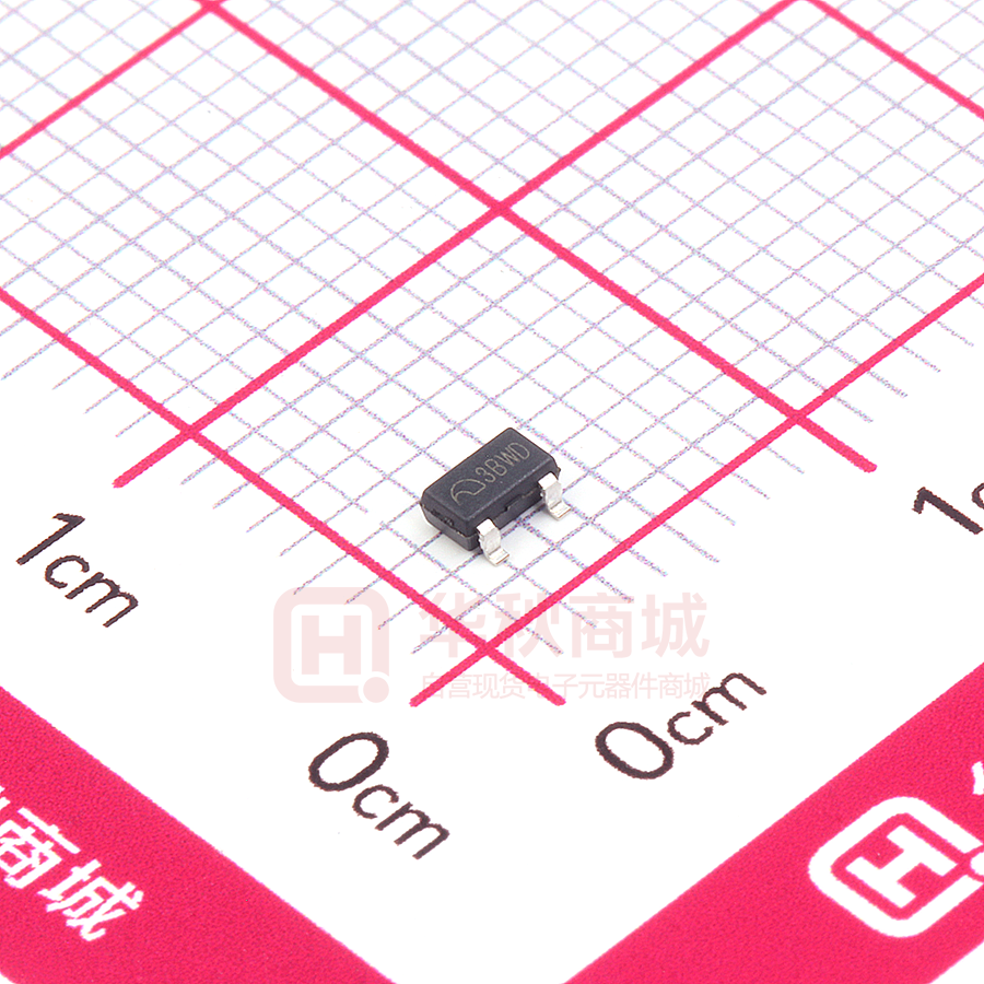

ME6216A12M3G 数据手册
ME6216 Low power consumption, Low ESR Cap. Compatible General Description Features  Output voltage range:1.0V~5.0V regulators  Input voltage: up to 6 V manufactured using CMOS technologies .The  Dropout Voltage:110mV@ IOUT =100mA ME6216 series are highly precise, low power consumption, positive voltage 240mV@ IOUT =200mA series provides large currents with a significantly small dropout voltage.  Highly Accuracy: ±1% The series is compatible with low ESR ceramic  Low power consumption:6uA(TYP.) capacitors .The current limiter’s foldback circuit  Large output current:300mA (VIN=4.3V,VOUT=3.3V) also operates as a short protect for the output  Excellent Input Stability current limiter and the output pin.  Be available to regulator and reference voltage Typical Application  Communication tools  Mobile phones  Portable games  Portable AV systems  Cameras, Video systems  Reference voltage sources V08 Package  3-pin SOT89-3,SOT23-3,SOT23, TO92,DFN2*2-3L Typical Application Circuit www.microne.com.cn Page 1 of 14 ME6216 Selection Guide ME 6216X X X X X G Environment mark Package: P-SOT89-3 M3-SOT23-3 X-SOT23 T-TO92 N3-DFN2*2-3L Output Voltage Function Product Type Product Series Microne product series product description ME6216A10PG VOUT =1.0V; Package:SOT89-3 ME6216A12M3G VOUT =1.2V; Package:SOT23-3 ME6216A14M3G VOUT =1.4V; Package:SOT23-3 ME6216A28M3G VOUT =2.8V; Package:SOT23-3 ME6216A38M3G VOUT =3.8V; Package:SOT23-3 ME6216A30XG VOUT =3.0V; Package:SOT23 ME6216A18TG VOUT =1.8V; Package:TO92 ME6216A18N3AG VOUT =1.8V;Package: DFN2*2-3L(2.0*2.0*0.55-1.30) NOTE: 1. At present ,there are twelve kinds of voltage value: 1.0V、1.2V、1.3V、1.4V、1.5V、1.8V、 2.0V、2.5V、2.7V、2.8V、3.0V、3.3V、3.6V、3.8V、5.0V。 2. If you need other voltage and package, please contact our sales staff。 V08 www.microne.com.cn Page 2 of 14 ME6216 Pin Configuration Pin Assignment ME6216Axx Pin M3 P X T N3 SOT23-3 SOT89-3 SOT23 TO-92 DFN3L 1 1 1 1 2 3 2 3 2 3 Name Function 3 VSS Ground 3 2 VOUT Output 2 1 VIN Input Block Diagram V08 www.microne.com.cn Page 3 of 14 ME6216 Absolute Maximum Ratings Parameter Symbol Description Units Input Voltage VIN 6.5 V Output Current IOUT 390 mA Output Voltage VOUT Vss-0.3 ~ Vout+0.3 V SOT23-3 Pd 300 mW SOT89-3 Pd 500 mW SOT23 Pd 300 mW TO-92 Pd 500 mW DFN3L Pd 500 mW Operating Ambient Temperature TOpr -25 ~ +125 ℃ Storage Temperature Tstg -40 ~ +125 ℃ Power Dissipation Electrical Characteristics ME6216 (Vout=1.2V) (VIN=VOUT+1V,CIN=COUT=1uF,Ta=25OC Unless otherwise stated) PARAMETER Output Voltage (Vout=1.0~1.3V) SYMBOL CONDITION MIX TYP MAX UNIT VOUT(E) (Note 2) IOUT=10mA, VIN=VOUT+1V VOUT(T) -0.015 VOUT(T) (Note 1) VOUT(T) +0.015 V 6 V Input Voltage VIN Maximum Output Current IOUT (max) VIN= VOUT +1V 250 Load Regulation ∆VOUT VIN= VOUT +1V 1mA≤IOUT≤100mA 8 12 mV Dropout Voltage (Note 3) Vdif1 IOUT =100mA 320 350 mV Vdif2 IOUT =200mA 570 600 mV Supply Current ISS VIN= VOUT +1V 6 8 μA Line Regulations ∆VOUT ∆VIN •VOUT IOUT =10mA Vout+1V ≤VIN≤6V 0.05 0.2 %/V Power Supply Ripple Rejection Ratio PSRR Vin= [VOUT +1]V +1Vp-pAC IOUT =10mA,f=1kHz 65 Short Circuit Current I short Vin= VOUT (T)+1V VOUT =VSS 50 70 mA Over Current Protection I limit VIN= VOUT +1V 310 340 mA V08 www.microne.com.cn mA dB Page 4 of 14 ME6216 ME6216 (Vout=1.4V) (VIN=VOUT+1V,CIN=COUT=1uF,Ta=25OC Unless otherwise stated) PARAMETER SYMBOL CONDITION MIX TYP MAX UNIT Output Voltage VOUT(E) (Note 2) IOUT=10mA, VIN=VOUT+1V X 0.99 VOUT(T) (Note 1) X 1.01 V Input Voltage VIN 6 V Maximum Output Current IOUT (max) VIN= VOUT +1V 250 Load Regulation ∆VOUT VIN= VOUT +1V 1mA≤IOUT≤100mA 8 12 mV Dropout Voltage (Note 3) Vdif1 IOUT =100mA 280 300 mV Vdif2 IOUT =200mA 510 530 mV Supply Current ISS VIN= VOUT +1V 6 8 μA Line Regulations ∆VOUT ∆VIN •VOUT IOUT =10mA Vout+1V ≤VIN≤6V 0.05 0.2 %/V Power Supply Ripple Rejection Ratio PSRR Vin= [VOUT +1]V +1Vp-pAC IOUT =10mA,f=1kHz 65 Short Circuit Current I short Vin= VOUT (T)+1V VOUT =VSS 50 70 mA Over Current Protection I limit VIN= VOUT +1V 380 420 mA mA dB ME6216 (Vout=1.8V) (VIN=VOUT+1V,CIN=COUT=1uF,Ta=25OC Unless otherwise stated) PARAMETER SYMBOL CONDITION MIX TYP MAX UNIT Output Voltage VOUT(E) (Note 2) IOUT=10mA, VIN=VOUT+1V X 0.99 VOUT(T) (Note 1) X 1.01 V Input Voltage VIN 6 V Maximum Output Current IOUT (max) VIN= VOUT +1V 300 Load Regulation ∆VOUT VIN= VOUT +1V 1mA≤IOUT≤100mA 8 12 mV Dropout Voltage (Note 3) Vdif1 IOUT =100mA 190 210 mV Vdif2 IOUT =200mA 380 400 mV Supply Current ISS VIN= VOUT +1V 6 8 μA Line Regulations ∆VOUT ∆VIN •VOUT IOUT =10mA Vout+1V ≤VIN≤6V 0.05 0.2 %/V V08 www.microne.com.cn mA Page 5 of 14 ME6216 Power Supply Ripple Rejection Ratio PSRR Vin= [VOUT +1]V +1Vp-pAC IOUT =10mA,f=1kHz 65 Short Circuit Current I short Vin= VOUT (T)+1V VOUT =VSS 50 70 mA Over Current Protection I limit VIN= VOUT +1V 380 420 mA dB ME6216(Vout=2.8V) (VIN=VOUT+1V,CIN=COUT=1uF,Ta=25OC Unless otherwise stated) PARAMETER SYMBOL CONDITION MIX TYP MAX UNIT Output Voltage VOUT(E) (Note 2) IOUT=10mA, VIN=VOUT+1V X 0.99 VOUT(T) (Note 1) X 1.01 V Input Voltage VIN 6 V Maximum Output Current IOUT (max) VIN= VOUT +1V 300 Load Regulation ∆VOUT VIN= VOUT +1V 1mA≤IOUT≤100mA 8 14 mV Dropout Voltage (Note 3) Vdif1 IOUT =100mA 120 140 mV Vdif2 IOUT =200mA 230 250 mV Supply Current ISS VIN= VOUT +1V 5 8 μA Line Regulations ∆VOUT ∆VIN •VOUT IOUT =10mA Vout+1V ≤VIN≤6V 0.05 0.2 %/V Power Supply Ripple Rejection Ratio PSRR Vin= [VOUT +1]V +1Vp-pAC IOUT =10mA,f=1kHz 65 Short Circuit Current I short Vin= VOUT (T)+1V VOUT =VSS 50 70 mA Over Current Protection I limit VIN= VOUT +1V 380 420 mA mA dB ME6216(Vout=3.3V) (VIN=VOUT+1V,CIN=COUT=1uF,Ta=25OC Unless otherwise stated) PARAMETER SYMBOL CONDITION MIX TYP MAX UNIT Output Voltage VOUT(E) (Note 2) IOUT=10mA, VIN=VOUT+1V X 0.99 VOUT(T) (Note 1) X 1.01 V Input Voltage VIN 6 V Maximum Output Current IOUT (max) VIN= VOUT +1V 300 Load Regulation ∆VOUT VIN= VOUT +1V 1mA≤IOUT≤100mA 14 18 mV Dropout Voltage (Note 3) Vdif1 IOUT =100mA 100 120 mV Vdif2 IOUT =200mA 210 260 mV V08 www.microne.com.cn mA Page 6 of 14 ME6216 Supply Current ISS VIN= VOUT +1V 4 8 μA Line Regulations ∆VOUT ∆VIN •VOUT IOUT =10mA Vout+1V ≤VIN≤6V 0.07 0.2 %/V Power Supply Ripple Rejection Ratio PSRR Vin= [VOUT +1]V +1Vp-pAC IOUT =10mA,f=1kHz 65 Short Circuit Current I short Vin= VOUT (T)+1V VOUT =VSS 50 70 mA Over Current Protection I limit VIN= VOUT +1V 380 420 mA dB ME6216(Vout=5.0V) (VIN=VOUT+1V,CIN=COUT=1uF,Ta=25OC Unless otherwise stated) PARAMETER SYMBOL CONDITION MIX TYP MAX UNIT Output Voltage VOUT(E) (Note 2) IOUT=10mA, VIN=VOUT+1V X 0.99 VOUT(T) (Note 1) X 1.01 V Input Voltage VIN 6 V Maximum Output Current IOUT (max) VIN= VOUT +1V 500 Load Regulation ∆VOUT VIN= VOUT +1V 1mA≤IOUT≤100mA 8 14 mV Dropout Voltage (Note 3) Vdif1 IOUT =100mA 90 110 mV Vdif2 IOUT =200mA 170 200 mV Supply Current ISS VIN= VOUT +1V 7 8 μA Power Supply Ripple Rejection Ratio PSRR Vin= [VOUT +1]V +1Vp-pAC IOUT =10mA,f=1kHz 65 Short Circuit Current I short Vin= VOUT (T)+1V VOUT =VSS 50 70 mA Over Current Protection I limit VIN= VOUT +1V 550 600 mA mA dB Note : 1. VOUT (T) :Specified Output Voltage 2.VOUT (E) :Effective Output Voltage ( le. The output voltage when “VOUT (T)+1.0V”is provided at the Vin pin while maintaining a certain IOUT value.) 3.Vdif :VIN1 –VOUT (E)’ VIN1 :The input voltage when VOUT(E)’ appears as input voltage is gradually decreased. VOUT (E)’=A voltage equal to 98% of the output voltage whenever an amply stabilized IOUT {VOUT (T)+1.0V} is input. V08 www.microne.com.cn Page 7 of 14 ME6216 Type Characteristics ( ME6216A33 ) (1)Output Voltage VS. Output Current (VIN=VOUT+1, Ta = 25 °C) (2)Output Voltage VS. Input Voltage (Ta = 25 °C) Output Voltage VS.Output Current Output Voltage VS.Input Voltage Output Voltage(V) Output Voltage(V) 3.5 3.4 3.3 3.2 3.1 3 2.9 2.8 0 50 100 150 200 250 300 3.5 3 2.5 2 1.5 1 0.5 0 350 100mA 10mA 1mA 0.5 1.5 2.5 4.5 5.5 6.5 6 6.5 Input Voltage(V) Output Current(mA) (3)Dropout Voltage VS. Output Current (VIN=VOUT+1V,Ta = 25 °C) (4)Supply Current VS. Input Voltage (Ta = 25 °C) Dropout Voltage VS.Output Current Supply Current VS.Input Voltage 6 500 Supply Current(uA) Dropout Voltage(mV) 3.5 400 300 200 100 5 4 3 2 1 0 0 0 50 100 150 200 250 300 350 3.5 4 4.5 5 5.5 Input Voltage (V) Output Current(mA) (5)Output Voltage VS. Temperature (VIN=VOUT+1V, IOUT =10mA) Output Voltage VS.Temperature Output Voltage(V) 3.32 3.3 3.28 3.26 3.24 3.22 -40 -20 0 20 40 60 80 100 120 140 160 Temperature(℃) V08 www.microne.com.cn Page 8 of 14 ME6216 Packaging Information ● SOT89-3 DIM A b b1 c D D1 D2 e1 E E1 E2 e L θ V08 Millimeters Min 1.4 0.32 0.4 0.35 4.4 Inches Max 1.6 0.52 0.58 0.45 4.6 Min 0.0551 0.0126 0.0157 0.0138 0.1732 1.55(TYP) 1.75(TYP) 3(TYP) 2.3 3.94 0.061(TYP) 0.0689(TYP) 0.1181(TYP) 2.6 4.4 0.0906 0.1551 1.9(TYP) 1.5(TYP) 0.8 Max 0.063 0.0205 0.0228 0.01772 0.1811 0.1023 0.1732 0.0748(TYP) 0.0591(TYP) 1.2 45° 0.0315 0.0472 45° www.microne.com.cn Page 9 of 14 ME6216 ● SOT23-3 DIM A A1 A2 A3 b c D E E1 e L L1 θ c1 V08 Millimeters Min 1 0 0.9 0.6 0.25 0.1 2.8 2.6 1.5 Inches Max 1.5 0.15 1.3 0.7 0.5 0.25 3.1 3.1 1.8 Min 0.0394 0 0.0354 0.0236 0.0098 0.0039 0.1102 0.1023 0.0591 0.95(TYP) 0.25 0.0374(TYP) 0.6 0.0098 0.59(TYP) 0 Max 0.0591 0.0059 0.0512 0.0276 0.0197 0.0098 0.122 0.122 0.0709 0.0236 0.0232(TYP) 8° 0.2(TYP) 0 8° 0.0079(TYP) www.microne.com.cn Page 10 of 14 ME6216 ● SOT23 DIM A A1 A2 b c D e1 E E1 e L L1 θ c1 V08 Millimeters Min 0.9 0 0.9 0.28 0.07 2.8 1.8 1.2 2.25 Inches Max 1.15 0.14 1.05 0.52 0.23 3 2 1.4 2.55 Min 0.0354 0 0.0354 0.011 0.0028 0.1102 0.0709 0.0472 0.0886 0.95(TYP) 0.55(TYP) 0.25 0 Max 0.0453 0.0055 0.0413 0.0205 0.0091 0.1181 0.0787 0.0551 0.1004 0.0374(TYP) 0.0217(TYP) 0.55 8° 0.25(TYP) 0.0098 0 0.0217 8° 0.0098(TYP) www.microne.com.cn Page 11 of 14 ME6216 ● TO-92 DIM A A1 b c D D1 E e e1 L h Φ V08 Millimeters Min 3.3 1.1 0.38 0.36 4.3 3.43 4.3 Inches Max 3.7 1.4 0.55 0.51 4.7 一 4.7 Min 0.1299 0.0433 0.015 0.0142 0.1693 0.135 0.1693 1.27 2.44 14.1 0 一 Max 0.1457 0.0551 0.0217 0.0201 0.185 一 0.185 0.05 2.64 14.5 0.38 1.6 www.microne.com.cn 0.0961 0.5551 0 一 0.1039 0.5709 0.015 0.063 Page 12 of 14 ME6216 ● DFN3L(2.0*2.0*0.55-1.30) DIM A A1 c b D b1 E E2 E3 e L L1 h D2 K V08 Millimeters Min 0.5 0 Inches Max 0.6 0.05 Min 0.0197 0 0.152REF 0.25 1.9 0.006REF 0.35 2.1 0.0098 0.0748 0.2REF 1.9 0.95 0.2 1.3BSC 0.0748 0.0374 0.0079 0.0827 0.0453 0.0157 0.0512BSC 0.45 0.3 0.2REF 1.4 0.2 0.0138 0.0827 0.0079REF 2.1 1.15 0.4 0.35 0.2 Max 0.0236 0.002 1.6 0.4 www.microne.com.cn 0.0138 0.0177 0.00787402 0.01181103 0.0079REF 0.0551 0.063 0.0079 0.01579 Page 13 of 14 ME6216      The information described herein is subject to change without notice. Nanjing Micro One Electronics Inc is not responsible for any problems caused by circuits or diagrams described herein whose related industrial properties, patents, or other rights belong to third parties. The application circuit examples explain typical applications of the products, and do not guarantee the success of any specific mass-production design. Use of the information described herein for other purposes and/or reproduction or copying without the express permission of Nanjing Micro One Electronics Inc is strictly prohibited. The products described herein cannot be used as part of any device or equipment affecting the human body, such as exercise equipment, medical equipment, security systems, gas equipment, or any apparatus installed in airplanes and other vehicles, without prior written permission of Nanjing Micro One Electronics Inc. Although Nanjing Micro One Electronics Inc exerts the greatest possible effort to ensure high quality and reliability, the failure or malfunction of semiconductor products may occur. The user of these products should therefore give thorough consideration to safety design, including redundancy, fire-prevention measures, and malfunction prevention, to prevent any accidents, fires, or community damage that may ensue. V08 www.microne.com.cn Page 14 of 14
