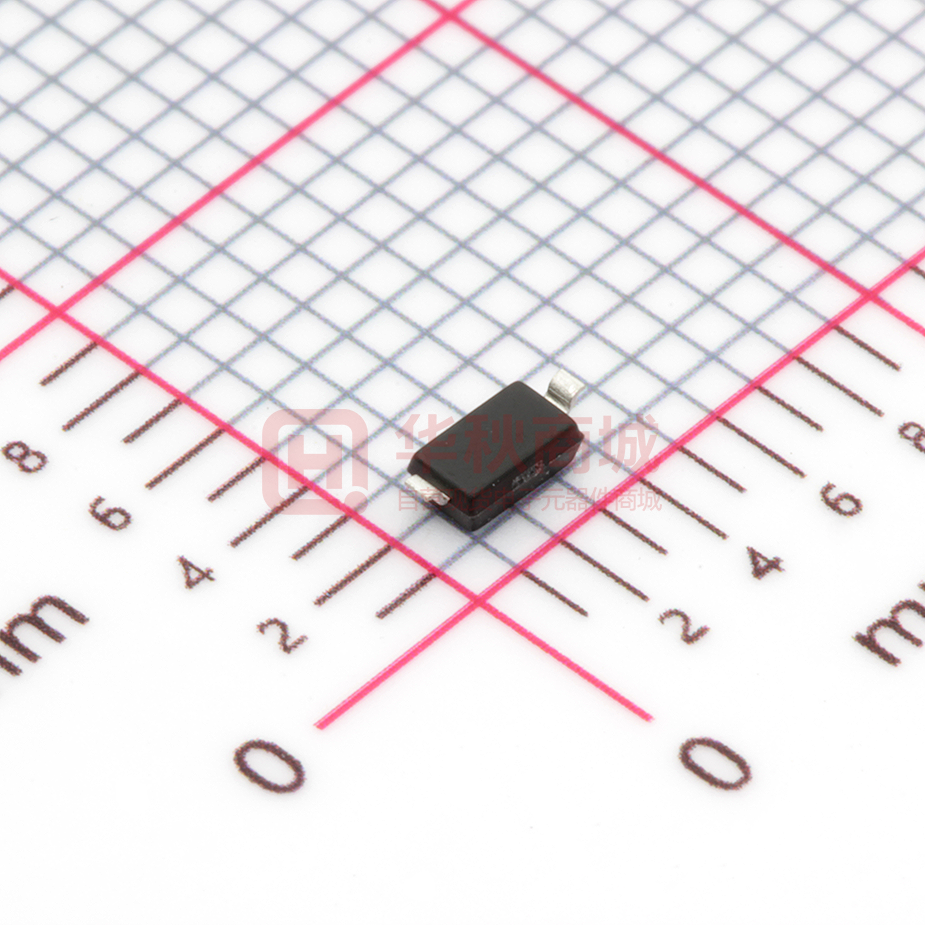

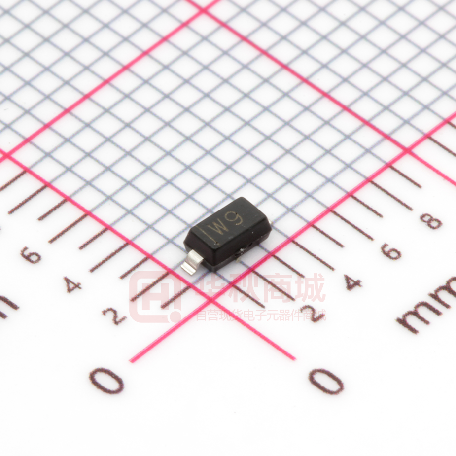

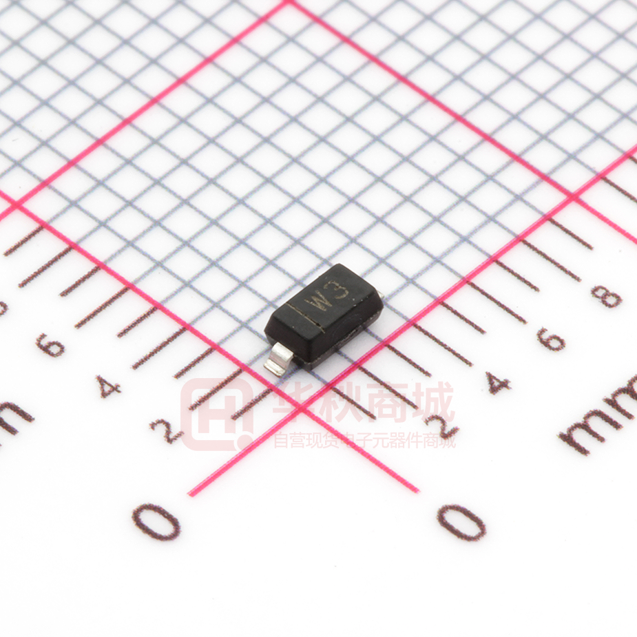

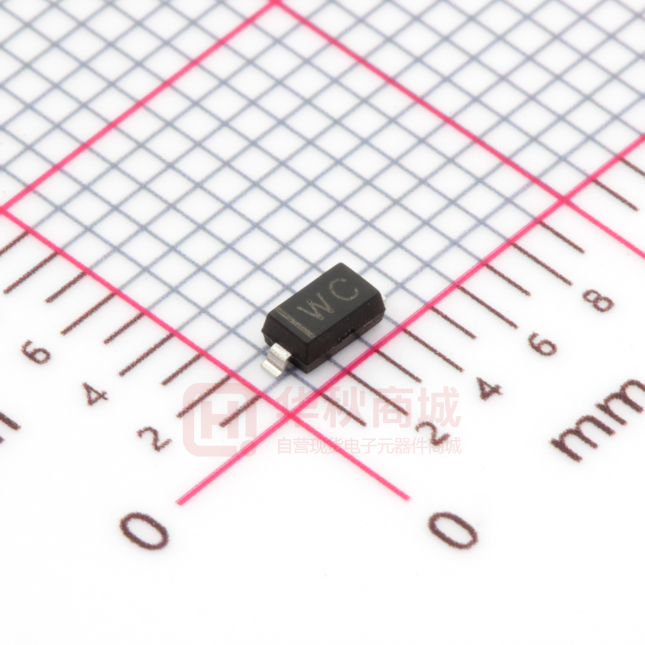

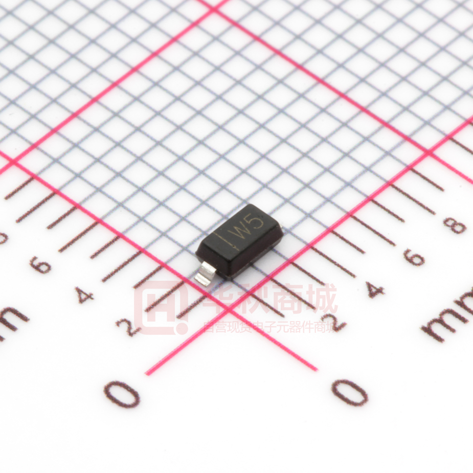

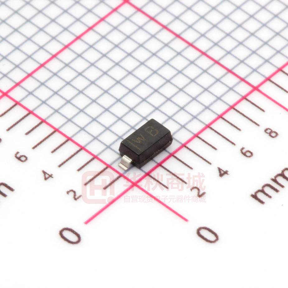

    稳压二极管 SOD123 Vz=5.6V Ir=1µA
BZT52C5V6 数据手册
BZT52C2V4-BZT52C43 东莞市通科电子有限公司 DongGuan Tongke Electronic Co.,LTD SOD- 123 Plastic-Encapsulate Diodes Features ZENER DIODE SOD-123 z Planar Die Construction z 500mW Pow er Dissipation on Ceramic PCB z General Purpose, Medium Current z Ideally Suited for Automated Assembly Processes z Available in Lead Free Version Maximum Ratings(Ta=25℃ unless otherwise specified) Characteristic Forward Voltage (Note 2) Symbol Value Unit VF 0.9 V PD 500 mW @ IF = 10mA Power Dissipation(Note 1) Thermal Resistance from Junction to Ambient RθJA 357 Junction Temperature TJ 150 ℃ /W ℃ Storage Temperature TSTG -55~+150 ℃ BZT52C2V4-BZT52C43 1 www.tongke888.com 400-6922-883 BZT52C2V4-BZT52C43 东莞市通科电子有限公司 DongGuan Tongke Electronic Co.,LTD SOD- 123 Plastic-Encapsulate Diodes ELECTRICAL CHARACTERISTICS Ta=25℃ unless otherwise specified Type Type Number Code Zener Voltage Range (Note 2) Maximum Typical Maximum Zener Impedance Reverse Temperature (Note 3) Current Coefficent @IZTC (Note 2) VZ@IZT IZT Nom(V) Min(V) Max(V) mA ZZT@IZT ZZK@IZK Ω Test Current IZTC IZK IR VR mV/°C mA uA V Min Max mA BZT52C2V4 WX 2.4 2.20 2.60 5 100 600 1.0 50 1.0 -3.5 0 5 BZT52C2V7 W1 2.7 2.5 2.9 5 100 600 1.0 20 1.0 -3.5 0 5 BZT52C3V0 W2 3.0 2.8 3.2 5 95 600 1.0 10 1.0 -3.5 0 5 BZT52C3V3 W3 3.3 3.1 3.5 5 95 600 1.0 5 1.0 -3.5 0 5 BZT52C3V6 W4 3.6 3.4 3.8 5 90 600 1.0 5 1.0 -3.5 0 5 BZT52C3V9 W5 3.9 3.7 4.1 5 90 600 1.0 3 1.0 -3.5 0 5 BZT52C4V3 W6 4.3 4.0 4.6 5 90 600 1.0 3 1.0 -3.5 0 5 BZT52C4V7 W7 4.7 4.4 5.0 5 80 500 1.0 3 2.0 -3.5 0.2 5 BZT52C5V1 W8 5.1 4.8 5.4 5 60 480 1.0 2 2.0 -2.7 1.2 5 BZT52C5V6 W9 5.6 5.2 6.0 5 40 400 1.0 1 2.0 -2.0 2.5 5 BZT52C6V2 WA 6.2 5.8 6.6 5 10 150 1.0 3 4.0 0.4 3.7 5 BZT52C6V8 WB 6.8 6.4 7.2 5 15 80 1.0 2 4.0 1.2 4.5 5 BZT52C7V5 WC 7.5 7.0 7.9 5 15 80 1.0 1 5.0 2.5 5.3 5 BZT52C8V2 WD 8.2 7.7 8.7 5 15 80 1.0 0.7 5.0 3.2 6.2 5 BZT52C9V1 WE 9.1 8.5 9.6 5 15 100 1.0 0.5 6.0 3.8 7.0 5 BZT52C10 WF 10 9.4 10.6 5 20 150 1.0 0.2 7.0 4.5 8.0 5 BZT52C11 WG 11 10.4 11.6 5 20 150 1.0 0.1 8.0 5.4 9.0 5 BZT52C12 WH 12 11.4 12.7 5 25 150 1.0 0.1 8.0 6.0 10.0 5 BZT52C13 WI 13 12.4 14.1 5 30 170 1.0 0.1 8.0 7.0 11.0 5 BZT52C15 WJ 15 13.8 15.6 5 30 200 1.0 0.1 10.5 9.2 13.0 5 BZT52C16 WK 16 15.3 17.1 5 40 200 1.0 0.1 11.2 10.4 14.0 5 BZT52C18 WL 18 16.8 19.1 5 45 225 1.0 0.1 12.6 12.4 16.0 5 BZT52C20 WM 20 18.8 21.2 5 55 225 1.0 0.1 14.0 14.4 18.0 5 BZT52C22 WN 22 20.8 23.3 5 55 250 1.0 0.1 15.4 16.4 20.0 5 BZT52C24 WO 24 22.8 25.6 5 70 250 1.0 0.1 16.8 18.4 22.0 5 BZT52C27 WP 27 25.1 28.9 2 80 300 0.5 0.1 18.9 21.4 25.3 2 BZT52C30 WQ 30 28.0 32.0 2 80 300 0.5 0.1 21.0 24.4 29.4 2 BZT52C33 WR 33 31.0 35.0 2 80 325 0.5 0.1 23.1 27.4 33.4 2 BZT52C36 WS 36 34.0 38.0 2 90 350 0.5 0.1 25.2 30.4 37.4 2 BZT52C39 WT 39 37.0 41.0 2 130 350 0.5 0.1 27.3 33.4 41.2 2 BZT52C43 WU 43 40.0 46.0 5 100 700 1.0 0.1 32 10.0 12.0 5 Notes: 1. Device mounted on ceramic PCB: 7.6mm x 9.4mm x 0.87mm with pad areas 25mm 2 2. Short duration test pulse used to minimize self-heating effect 3. f=1kHZ BZT52C2V4-BZT52C43 2 www.tongke888.com 400-6922-883 BZT52C2V4-BZT52C43 东莞市通科电子有限公司 DongGuan Tongke Electronic Co.,LTD SOD- 123 Plastic-Encapsulate Diodes Features Breakdown characteristics at Tj=constant (pulsed) Forward characteristics BZT52C2V4-BZT52C43 Admissible power dissipation versus ambient temperature 3 www.tongke888.com 400-6922-883 BZT52C2V4-BZT52C43 东莞市通科电子有限公司 DongGuan Tongke Electronic Co.,LTD SOD- 123 Plastic-Encapsulate Diodes Features Pulse thermal resistance versus pulse duration Dynamic resistance versus Zener current Capacitance versus Zener voltage Dynamic resistance versus Zener current Dynamic resistance versus Zener current Thermal differential resistance versus Zener voltage BZT52C2V4-BZT52C43 4 www.tongke888.com 400-6922-883 东莞市通科电子有限公司 DongGuan Tongke Electronic Co.,LTD BZT52C2V4-BZT52C43 SOD- 123 Plastic-Encapsulate Diodes Features Dynamic resistance versus Zener voltage Temperature dependence of Zener voltage versus Zener voltage Change of Zener voltage versus junction temperature Change of Zener voltage versus junction temperature Change of Zener voltge from turn-on up to the point of thermal equilibrium versus Zener voltage BZT52C2V4-BZT52C43 5 www.tongke888.com 400-6922-883 BZT52C2V4-BZT52C43 东莞市通科电子有限公司 DongGuan Tongke Electronic Co.,LTD SOD- 123 Plastic-Encapsulate Diodes Features SOD-123 Package Outline Dimensions Dimensions In Millimeters Max Min 1.050 1.250 0.000 0.100 1.050 1.150 0.450 0.650 0.080 0.150 1.500 1.700 2.600 2.800 3.550 3.850 0.500 REF 0.250 0.450 0° 8° Symbol A A1 A2 b c D E E1 L L1 θ BZT52C2V4-BZT52C43 6 Dimensions In Inches Min Max 0.041 0.049 0.000 0.004 0.041 0.045 0.018 0.026 0.003 0.006 0.059 0.067 0.102 0.110 0.140 0.152 0.020 REF 0.010 0.018 0° 8° www.tongke888.com 400-6922-883
