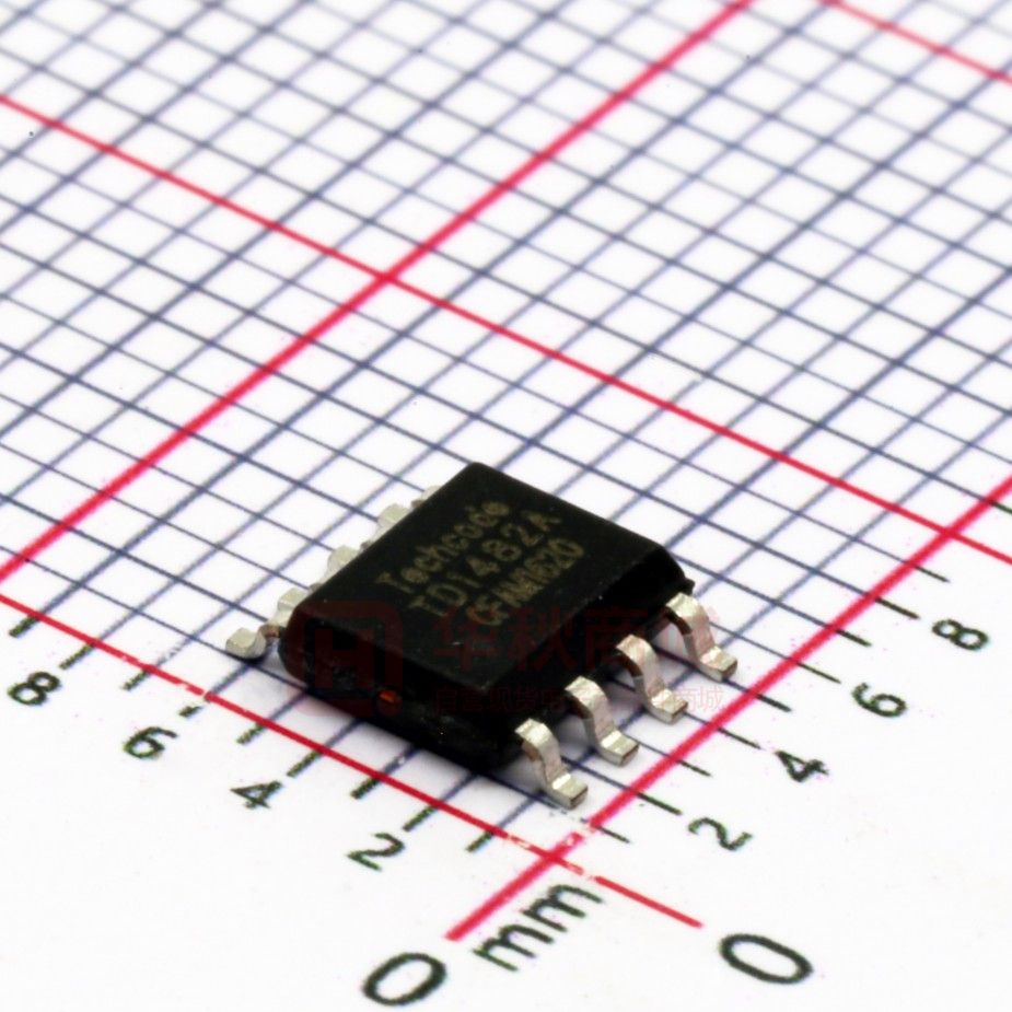

    2A 23V 同步整流降压变换器
TD1482A 数据手册
Techcode®         DATASHEET 2A 23V Synchronous Rectified Step-Down Converte General Description  TD1482A Features    The TD1482A is a monolithic synchronous buck regulator. The device integrates two 130mΩ MOSFETs, and provides 2A of continuous load current over a wide input voltage of 4.75V to 23V. Current mode control provides fast transient response and cycle-by-cycle current limit. An adjustable soft-start prevents inrush current at turn-on, and in shutdown mode the supply current drops to 1µA. This device, available in an SOP8 package, provides a very compact solution with minimal external components.  •   2A Output Current •   Wide 4.75V to 23V Operating Input Range •   Integrated 130mΩ Power MOSFET Switches •   Output Adjustable from 0.923V to 20V •   Up to 93% Efficiency •   Programmable Soft-Start •   Stable with Low ESR Ceramic Output Capacitors •   Fixed 340KHz Frequency •   Cycle-by-Cycle Over Current Protection •   Input Under Voltage Lockout Applications  •   Distributed Power Systems •   Networking Systems •   FPGA, DSP, ASIC Power Supplies •   Green Electronics/ Appliances • Notebook Computers Package Types                    Figure 1. Package Types of TD1482A    October,  20,  2010.                                                        America  Techcode  Semiconductor,  INC.                                            www.techcodesemi.com  1  Techcode®         DATASHEET 2A 23V Synchronous Rectified Step-Down Converte TD1482A Pin Configurations    Figure 2 Pin Configuration of TD1482A(Top View)  Pin Description  Pin Number Pin Name Description High-Side Gate Drive Boost Input. BS supplies the drive for the high-side N-Channel 1 BS MOSFET switch. Connect a 0.01µF or greater capacitor from SW to BS to power the high side switch. Power Input. IN supplies the power to the IC, as well as the step-down converter 2 IN switches. Drive IN with a 4.75V to 23V power source. Bypass IN to GND with a suitably large capacitor to eliminate noise on the input to the IC. See Input Capacitor. Power Switching Output. SW is the switching node that supplies power to the output. 3 SW Connect the output LC filter from SW to the output load. Note that a capacitor is required from SW to BS to power the high-side switch. 4 GND 5 FB Ground. Feedback Input. FB senses the output voltage to regulate that voltage. Drive FB with a resistive voltage divider from the output voltage. The feedback threshold is 0.923V. See Setting the Output Voltage. Compensation Node. COMP is used to compensate the regulation control loop. 6 COMP Connect a series RC network from COMP to GND to compensate the regulation control loop. In some cases, an additional capacitor from COMP to GND is required. See Compensation Components. Enable Input. EN is a digital input that turns the regulator on or off. Drive EN high to 7 EN turn on the regulator, drive it low to turn it off. Pull up with 100kΩ resistor for automatic startup. Soft-Start Control Input. SS controls the soft start period. Connect a capacitor from SS 8 SS to GND to set the soft-start period. A 0.1µF capacitor sets the soft-start period to 15ms. To disable the soft-start feature, leave SS unconnected. October,  20,  2010.                                                        America  Techcode  Semiconductor,  INC.                                            www.techcodesemi.com  2  Techcode®         DATASHEET 2A 23V Synchronous Rectified Step-Down Converte TD1482A Ordering Information    TD1482A  □ □    Circuit Type                                                                                                                          Packing: Blank:Tube R:Type and Reel Package P:SOP8 Function Block  Figure 3 Function Block Diagram of TD1482A      October,  20,  2010.                                                        America  Techcode  Semiconductor,  INC.                                            www.techcodesemi.com  3  Techcode®         DATASHEET 2A 23V Synchronous Rectified Step-Down Converte TD1482A   Absolute Maximum Ratings    Parameter Symbol Value Unit Supply Voltage VIN -0.3 to 23 V Switch Node Voltage VSW 21 V Boost Voltage VBS VSW – 0.3V to VSW+6V V Output Voltage VOUT 0.923V to 20 V –0.3V to +6V V All Other Pins Operating Junction Temperature TJ 150 ºC Operating Ambient Temperature TA -40 to 80 ºC Storage Temperature TSTG -65 to 150 ºC Lead Temperature (Soldering, 10 sec) TLEAD 260 ºC 2000 V ESD (HBM) MSL Level3 Thermal Resistance-Junction to Ambient Thermal Resistance-Junction to Case RθJA RθJC 90 45 ºC / W ºC / W       October,  20,  2010.                                                        America  Techcode  Semiconductor,  INC.                                            www.techcodesemi.com  4          Techcode® DATASHEET 2A 23V Synchronous Rectified Step-Down Converte TD1482A Electrical Characteristics  VIN = 12V, Ta = 25℃  unless otherwise specified.    Parameters Symbol Shutdown Supply Current Min. VEN = 0V VEN = 2.0V; VFB = Supply Current Feedback Voltage Test Condition 1.0V VFB 4.75V ≤ VIN ≤ 23V 0.900 Feedback Overvoltage Threshold Typ. Max. Unit 1 3.0 µA 1.3 1.5 mA 0.923 0.946 V 1.1 V 400 V/V 800 µA/V Error Amplifier Voltage Gain * AEA Error Amplifier Transconductance GEA High-Side Switch On Resistance * RDS(ON)1 130 mΩ Low-Side Switch On Resistance * RDS(ON)2 130 mΩ High-Side Switch Leakage ∆IC = ±10µA VEN = 0V, VSW = 0V Current Upper Switch Current Limit Minimum Duty Cycle Lower Switch Current Limit From Drain to Source COMP to Current Sense Transconductance Oscillation Frequency Short Circuit Oscillation Frequency Maximum Duty Cycle 10 2.4 GCS Fosc1 3.4 A 1.1 A 3.5 A/V 340 KHz Fosc2 VFB = 0V 100 KHz DMAX VFB = 1.0V 90 % 220 ns Minimum On Time * EN Shutdown Threshold Voltage µA VEN Rising 1.1 1.5 2.0 V EN Shutdown Threshold Voltage Hysteresis EN Lockout Threshold Voltage EN Lockout Hysterisis 210 2.2 2.5 210 mV 2.7 V mV October,  20,  2010.                                                        America  Techcode  Semiconductor,  INC.                                            www.techcodesemi.com  5          Techcode® DATASHEET 2A 23V Synchronous Rectified Step-Down Converte TD1482A Electrical Characteristics(Cont.)  VIN = 12V, Ta = 25℃  unless otherwise specified.  Parameters Symbol Input Under Voltage Lockout Threshold Test Condition VIN Rising Input Under Voltage Lockout Threshold Hysteresis Min. 3.80 Typ. 4.10 Max. 4.40 Unit V 210 mV Soft-Start Current VSS = 0V 6 µA Soft-Start Period CSS = 0.1µF 1 ms 5 Thermal Shutdown * 160 °C Typical Performance Characteristics    Figure 4. Steady State Test  Figure 5. Startup through Enable  October,  20,  2010.                                                        America  Techcode  Semiconductor,  INC.                                            www.techcodesemi.com  6          Techcode® DATASHEET 2A 23V Synchronous Rectified Step-Down Converte TD1482A         Figure 6. Shutdown through Enable  Figure 7. Heavy Load Operation      Figure 9.Light Load Operation  Figure 8.Medium Load Operation                        October,  20,  2010.                                                        America  Techcode  Semiconductor,  INC.                                            www.techcodesemi.com  7  Techcode®         DATASHEET 2A 23V Synchronous Rectified Step-Down Converte TD1482A         Figure 11. Short Circuit Recovery  Figure 10. Short Circuit Protection            Figure 12. Load Transient    October,  20,  2010.                                                        America  Techcode  Semiconductor,  INC.                                            www.techcodesemi.com  8  Techcode®         DATASHEET 2A 23V Synchronous Rectified Step-Down Converte TD1482A Typical Application Circuit     Fig13. TD1482A with 3.3V Output, 22µF/6.3V Ceramic Output Capacitor        October,  20,  2010.                                                        America  Techcode  Semiconductor,  INC.                                            www.techcodesemi.com  9          Techcode® DATASHEET 2A 23V Synchronous Rectified Step-Down Converte TD1482A Function Description  Component Selection Setting the Output Voltage The output voltage is set using a resistive voltage divider from the output voltage to FB pin.The voltage divider divides the output voltage down to the feedback voltage by the ratio: Where VFB is the feedback voltage and VOUT is the output voltage.Thus the output voltage is:   Where VOUT is the output voltage, VIN is the input voltage, fS is the switching frequency, and ∆IL is the peak-to-peak inductor ripple current. Choose an inductor that will not saturate under the maximum inductor peak current. The peak inductor current can be calculated by:   Where ILOAD is the load current. The choice of which style inductor to use mainly depends on the price vs. size requirements and any EMI requirements. Optional Schottky Diode R2 can be as high as 100kΩ, but a typical value is During the transition between high-side switch and 10kΩ. Using the typical value for R2, R1 is determined low-side switch, the body diode of the lowside power by: MOSFET conducts the inductor current. The forward voltage of this body diode is high. An optional Schottky   diode may be paralleled between the SW pin and For example, for a 3.3V output voltage, R2 is 10kΩ, GND pin to improve overall efficiency. Table 1 lists and R1 is 26.1kΩ. example Schottky diodes and their Manufacturers. Inductor    The inductor is required to supply constant current to Part Number Voltage/Current  Vendor the output load while being driven by the switched B130 30V, 1A Diodes, Inc. input voltage. A larger value inductor will result in less SK13 30V, 1A  Diodes, Inc.  ripple current that will result in lower output ripple MBRS130 30V, 1A  International Rectifier voltage. However,the larger value inductor will have a Input Capacitor larger physical size, higher series resistance, and/or The input current to the step-down converter is lower saturation current. A good rule for determining discontinuous, therefore a capacitor is required to the inductance to use is to allow the peak-to-peak ripple current in the inductor to be approximately 30% supply the AC current to the step-down converter while maintaining the DC input voltage. Use low ESR of the maximum switch current limit. Also, make sure capacitors for the best performance. Ceramic that the peak inductor current is below the maximum capacitors are preferred, but tantalum or low-ESR switch current limit. The inductance value can be electrolytic capacitors may also suffice. Choose X5R calculated by: or X7R dielectrics when using ceramic capacitors.       October,  20,  2010.                                                        America  Techcode  Semiconductor,  INC.                                            www.techcodesemi.com  10          Techcode® DATASHEET 2A 23V Synchronous Rectified Step-Down Converte TD1482A Since the input capacitor (C1) absorbs the input switching current it requires an adequate ripple current   In the case of tantalum or electrolytic capacitors,the rating. The RMS current in the input capacitor can be ESR dominates the impedance at the switching estimated by: frequency. For simplification, the output ripple can be approximated to:   The worst-case condition occurs at VIN = 2VOUT,where IC1 = ILOAD/2. For simplification, choose the input capacitor whose RMS current rating greater than half of the maximum load current. The input capacitor can be electrolytic, tantalum or ceramic. When using electrolytic or tantalum capacitors, a small, high quality ceramic capacitor, i.e. 0.1μF, should be placed as close to the IC as possible. When using ceramic capacitors, make sure that they have enough capacitance to provide sufficient charge to prevent excessive voltage ripple at input. The input voltage ripple for low ESR capacitors can be estimated by:   Where C1 is the input capacitance value. Output Capacitor The output capacitor is required to maintain the DC output voltage. Ceramic, tantalum, or low ESR electrolytic capacitors are recommended. Low ESR capacitors are preferred to keep the output voltage ripple low. The output voltage ripple can be estimated by:   Where C2 is the output capacitance value and RESR is the equivalent series resistance (ESR) value of the output capacitor. In the case of ceramic capacitors, the impedance at the switching frequency is dominated by the capacitance. The output voltage ripple is mainly caused by the capacitance. For simplification, the output voltage ripple can be estimated by:     The characteristics of the output capacitor also affect the stability of the regulation system. The TD1482A can be optimized for a wide range of capacitance and ESR values. Compensation Components TD1482A employs current mode control for easy compensation and fast transient response. The system stability and transient response are controlled through the COMP pin. COMP pin is the output of the internal transconductance error amplifier. A series capacitor-resistor combination sets a pole-zero combination to control the characteristics of the control system. The DC gain of the voltage feedback loop is given by:   Where AVEA is the error amplifier voltage gain;GCS is the current sense transconductance and RLOAD is the load resistor value. The system has two poles of importance. One is due to the compensation capacitor (C3) and the output resistor of the error amplifier, and the other is due to the output capacitor and the load resistor. These poles are located at:     Where GEA is the error amplifier transconductance.   October,  20,  2010.                                                        America  Techcode  Semiconductor,  INC.                                            www.techcodesemi.com  11          Techcode® DATASHEET 2A 23V Synchronous Rectified Step-Down Converte The system has one zero of importance, due to the compensation capacitor (C3) and the compensation resistor (R3). This zero is located at: TD1482A Determine the C3 value by the following equation:   The system may have another zero of importance, if the output capacitor has a large capacitance and/or a high ESR value. The zero,due to the ESR and capacitance of the output capacitor, is located at:   Where R3 is the compensation resistor. 3. Determine if the second compensation capacitor (C6) is required. It is required if the ESR zero of the output capacitor is located at less than half of the switching frequency, or the following relationship is valid:   If this is the case, then add the second compensation In this case (as shown in Figure 14), a third pole set by capacitor (C6) to set the pole fP3 at the location of the the compensation capacitor (C6) and the ESR zero. Determine the C6 value by the equation: compensation resistor (R3) is used to compensate the effect of the ESR zero on the loop gain. This pole is   located at: External Bootstrap Diode An external bootstrap diode may enhance the efficiency of the regulator, the applicable   The goal of compensation design is to shape the conditions of external BST diode are: converter transfer function to get a desired loop gain. z VOUT=5V or 3.3V; and z Duty cycle is high: The system crossover frequency where the feedback loop has the unity gain is important. Lower crossover frequencies result in slower line and load transient In these cases, an external BST diode is responses,while higher crossover frequencies could cause system instability. A good rule of thumb is to set recommended from the output of the voltage regulator to BST pin, as shown in Fig.14 the crossover frequency below one-tenth of the switching frequency. To optimize the compensation components, the following procedure can be used. 1. Choose the compensation resistor (R3) to set the desired crossover frequency. Determine the R3 value by the following equation:     Figure14.Add Optional External Bootstrap Diode to Enhance    Efficiency  Where fC is the desired crossover frequency which is The recommended external BST diode is IN4148, and typically below one tenth of the switching frequency. the BST cap is 0.1~1μF. 2. Choose the compensation capacitor (C3) to achieve   the desired phase margin. For applications with typical inductor values, setting the compensation zero, fZ1, below one-forth of the crossover frequency provides sufficient phase margin.  October,  20,  2010.                                                        America  Techcode  Semiconductor,  INC.                                            www.techcodesemi.com  12  Techcode®         DATASHEET 2A 23V Synchronous Rectified Step-Down Converte TD1482A Package Information  SOP8 Package Outline Dimensions        October,  20,  2010.                                                        America  Techcode  Semiconductor,  INC.                                            www.techcodesemi.com  13          Techcode® DATASHEET 2A 23V Synchronous Rectified Step-Down Converte TD1482A Design Notes   October,  20,  2010.                                                        America  Techcode  Semiconductor,  INC.                                            www.techcodesemi.com  14
