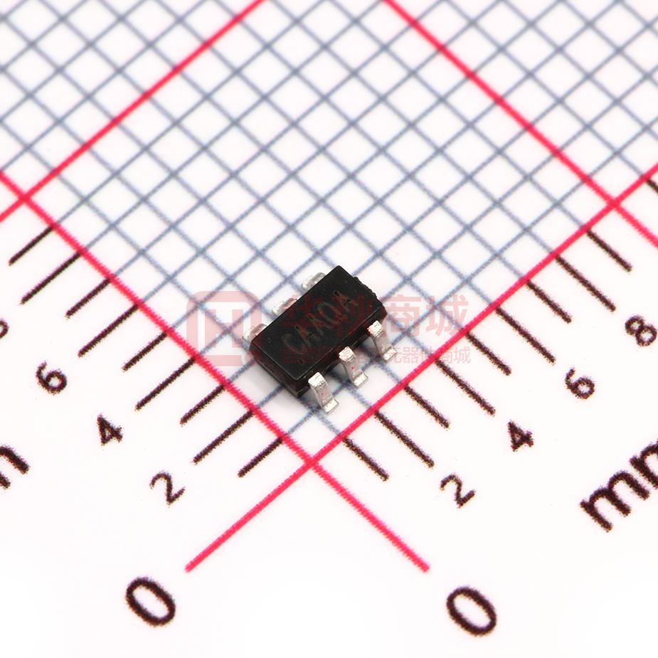

Pinout (top view)
(SOT23-6)
Top Mark: CAxyz (Device code: CA, x=year code, y=week code, z= lot number code)
SOT23-6
5
2
1
FB
3
EN
NC
4
6
