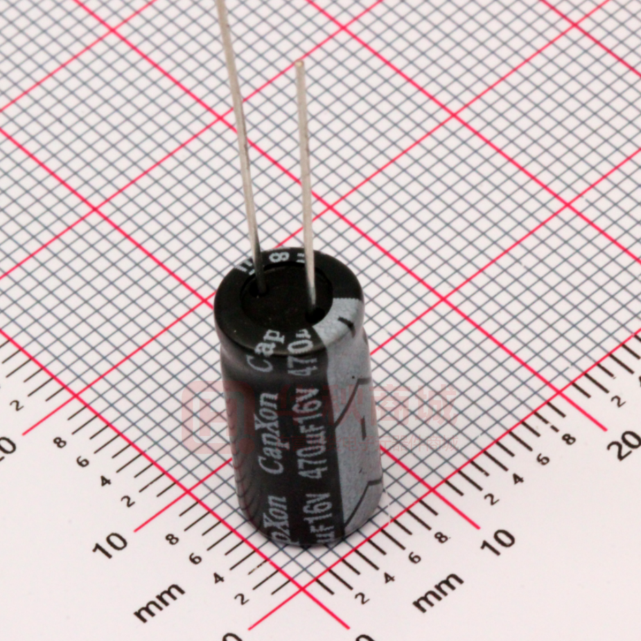

    直插铝电解电容 插件,D8xL16mm 470µF ±20% Ф8.00 x 16.00mm 16V 3000Hrs@105℃
KF471M016F160A 数据手册
KF Series KF Series Low Impedance Features ◆ Used in communication equipments, switching power supply, industrial measuring instruments, etc. ◆ Load life 2000~5000 Hrs at 105℃ ◆ Safety vent construction design. ◆ For detail specifications, please refer to Engineering Bulletin No. E126 ◆ RoHS Compliant Specifications Item Performance Characteristics Operating Temperature Range Rated Voltage Range Capacitance Range Capacitance Tolerance Leakage Current (+20℃,max.) Dissipation Factor (tanδ,at 20℃,120Hz) -40 to +105℃ 6.3 to 100 VDC 0.47 to 15000 μF -25 to +105℃ 160 to 450 VDC 0.47 to 470 μF ±20%(120Hz,+20℃) I≦0.01 CV or 3 (μA) I≦0.03 CV (μA) After 2 minutes whichever is greater measured with rated working voltage applied. Working Voltage(VDC) D.F. (%)max. 6.3 18 10 16 16 14 25 12 After 2 minutes withrate working voltage applied. 35 10 50 9 63 8 100 8 Working Voltage(VDC) 160 200 250 350 400 420 450 D.F. (%)max. 12 12 12 15 15 17 17 For capacitance >1000 μF, add 2% per another 1000uF. Impedance ratio max Low Temperature Characteristics (at 120Hz) Working Voltage(VDC) Z-25℃ Z+20℃ Z-40℃ Z+20℃ 6.3 4 8 10 3 6 16 3 4 25 3 3 35 3 3 50 3 3 Working Voltage(VDC) Z-25℃ Z+20℃ Z-40℃ Z+20℃ 160 200 250 350 400 450 2 2 3 5 5 6 3 6 6 6 6 - 63 2 3 100 2 3 For capacitance >1000 μF, add 0.5 per another 1000uF for -25℃ +20℃ add 1 per another 1000uF for -40℃ +20℃ Load Life Shelf Life Test conditions Dφ Life hours Duration time : as right Ambient temperature : +105℃ 5 - 6.3 φ 2000 Applied voltage : Rated DC working voltage 8 φ 3000 After test requirement at +20℃ Capacitance change : ≦ ±20% of the initial measured value ≧ 10 φ 5000 Dissipation factor : ≦ 200% of the initial specified value (160-450V : 2000hrs) Leakage current : ≦ The initial specified value Test conditions Duration time : 1000Hrs Ambient temperature : +105℃ Applied voltage : None After test requirement at +20℃: Same limits as Load life. Pre-treatment for measurements shall be conducted after application of DC working voltage for 30 minutes. Multiplier for Ripple Current vs. Frequency CAP(μF) Frequency(Hz) 50(60) CAP≦10 0.47 10<CAP≦100 0.52 100<CAP≦1000 0.58 1000<CAP 0.63 120 0.59 0.62 0.72 0.78 400 0.76 0.80 0.84 0.87 1K 0.85 0.89 0.90 0.91 10K 50K-100K 0.97 1 0.97 1 0.98 1 0.98 1 Diagram of Dimensions:(unit:mm) Dφ F dφ α 5 2.0 6.3 2.5 0.5 D<18 1.5 120 8 3.5 L<20 0.5 L≧20 0.6 10 5.0 D=18 L<35.5 L≧35.5 1.5 2.0 13 5.0 0.6 D>18 2.0 16 7.5 18 7.5 0.8 22 10 KF Series Case Size φDxL(mm) Cap(μF) 10 22 33 47 56 68 100 120 150 180 220 270 330 470 560 680 820 1000 1200 1500 1800 2200 2700 3300 4700 5600 6800 8200 10000 15000 6.3 (8) Size Ripple 10 (13) Impedance 16 (20) Size Ripple Impedance 5x11 5x11 5x11 5x11 5x11 5x11 6.3x11 6.3x11 98 100 150 160 170 210 250 290 2.7 2.6 1.34 1.23 1.05 0.8 0.75 0.61 6.3x11 320 0.46 6.3x11 8x11.5 8x11.5 8x11.5 10x12.5 8x11.5 10x12.5 10x16 10x16 340 400 460 580 635 550 765 890 1040 0.35 0.3 0.27 0.25 0.16 0.17 0.11 0.1 0.076 10x16 10x20 1200 1400 0.067 0.062 Size 5x11 5x11 5x11 5x11 5x11 5x11 6.3x11 6.3x11 6.3x11 Ripple 74 100 114 155 180 195 265 270 290 Impedance 4.7 2.6 2 1.1 0.82 0.69 0.5 0.47 0.41 8x11.5 6.3x11 8x11.5 8x11.5 8x11.5 10x12.5 10x12.5 370 315 480 520 590 750 785 0.34 0.38 0.25 0.21 0.156 0.124 0.105 10x16 10x16 10x20 1100 1180 1350 0.092 0.078 0.065 10x25 10x30 13x20 13x20 10x25 13x25 13x20 13x25 1500 1600 1380 1800 1730 2000 1880 2450 0.061 0.056 0.06 0.047 0.05 0.038 0.04 0.033 2790 2640 2880 0.030 0.030 0.026 2990 3200 3320 3550 0.025 0.024 0.024 0.024 5x11 5x11 6.3x11 5x11 6.3x11 170 175 220 185 240 1.00 0.92 0.81 0.90 0.76 6.3x11 6.3x11 8x11.5 8x11.5 8x11.5 310 340 390 450 490 0.65 0.54 0.42 0.25 0.23 8x11.5 8x16 10x12.5 8x16 10x16 10x16 550 620 770 750 860 1100 0.21 0.20 0.17 0.15 0.16 0.14 10x20 1250 0.11 10x25 1550 0.058 10x20 10x25 10x25 13x20 13x20 1380 1470 1490 1550 1650 0.090 0.095 0.075 0.075 0.036 13x20 10x25 13x20 1750 1650 1900 0.041 0.52 0.035 13x25 2000 0.031 13x30 13x25 13x30 16x25 16x31.5 16x35.5 18x35.5 2100 1900 2160 2350 2550 2700 2950 0.036 0.040 0.034 0.032 0.027 0.024 0.023 16x25 2100 0.030 16x25 13x30 16x31.5 16x25 16x31.5 16x35.5 18x35.5 2290 2650 2770 2850 0.028 0.026 0.026 0.024 16x35.5 18x35.5 18x35.5 18x41 Ripple Current ( mA, rms ) at 105℃ 100KHz Max Impedance (Ω) at 20℃ 100KHz 121 Radial WV(SV) KF Series φDxL(mm) WV(SV) Cap(μF) 0.47 1 2.2 3.3 4.7 5.6 6.8 10 22 33 47 56 68 100 120 150 180 220 270 330 470 560 680 820 1000 1200 1500 1800 2200 2700 3300 4700 5600 6800 25 (32) 35 (44) 50 (63) Size Ripple Impedance Size Ripple Impedance 3.65 3.09 2.82 2.37 1.5 1.21 0.8 Size 5x11 5x11 5x11 5x11 5x11 5x11 5x11 5x11 6.3x11 6.3x11 6.3x11 Ripple 25 40 55 60 90 105 110 120 150 250 290 Impedance 5.4 4 2.8 2.2 2 1.93 1.89 1.82 1.25 0.8 0.65 5x11 5x11 5x11 5x11 5x11 5x11 5x11 6.3x11 6.3x11 6.3x11 6.3x11 6.3x11 8x11.5 8x11.5 8x11.5 10x12.5 10x12.5 10x16 10x16 10x20 10x20 10x25 13x20 13x25 13x25 16x25 16x25 16x25 16x31.5 16x35.5 18x35.5 18x41 68 75 80 85 125 155 190 220 250 280 370 380 410 455 550 720 820 1200 1250 1320 1400 1530 1650 1980 2210 2510 2650 2820 3240 3650 3720 3850 3.95 3.25 2.98 2.56 1.95 1.42 1.10 1.00 0.79 0.65 0.35 0.33 0.31 0.25 0.15 0.125 0.114 0.076 0.072 0.065 0.052 0.052 0.045 0.041 0.038 0.036 0.035 0.031 0.026 0.024 0.024 0.024 5x11 5x11 5x11 5x11 5x11 5x11 6.3x11 85 92 97 105 150 180 280 6.3x11 8x11.5 8x11.5 8x11.5 8x11.5 10x12.5 10x12.5 10x16 10x16 10x20 10x25 13x20 13x20 310 350 450 510 540 650 750 910 1050 1200 1500 1570 1700 0.64 0.52 0.25 0.22 0.191 0.172 0.114 0.095 0.079 0.065 0.061 0.056 0.048 8x11.5 8x11.5 10x12.5 10x12.5 10x12.5 10x16 10x16 10x20 10x25 13x20 13x20 13x25 13x30 310 375 480 530 590 860 930 1060 1150 1590 1740 1930 2100 0.49 0.33 0.17 0.156 0.132 0.114 0.096 0.078 0.065 0.055 0.05 0.044 0.039 13x25 13x30 16x25 16x31.5 16x31.5 16x35.5 18x35.5 18x41 1900 2130 2270 2700 2780 2850 3100 3500 0.042 0.039 0.036 0.035 0.034 0.029 0.026 0.024 16x25 16x31.5 16x35.5 16x35.5 18x35.5 18x41 18x41 2300 2650 2750 2850 3040 3070 3100 0.036 0.036 0.034 0.034 0.032 0.027 0.025 Ripple Current ( mA, rms ) at 105℃ 100KHz Max Impedance (Ω) at 20℃ 100KHz 122 KF Series φDxL(mm) Cap(μF) 0.47 1 2.2 3.3 4.7 5.6 6.8 10 22 33 47 56 68 100 120 150 180 220 270 330 470 560 680 820 1000 1200 1500 1800 63 (79) 100 (125) Size 5x11 5x11 5x11 5x11 5x11 5x11 5x11 5x11 6.3x11 8x11.5 8x11.5 8x11.5 Ripple 25 33 45 58 65 95 100 110 180 270 300 330 Impedance 5.4 4 2.8 2.2 2 1.9 1.82 1.75 0.80 0.61 0.56 0.38 10x12.5 10x16 10x16 10x16 10x20 10x20 13x20 13x20 13x25 13x25 13x30 16x25 16x31.5 16x35.5 18x35.5 18x41 480 610 620 700 800 920 1150 1250 1620 1680 1950 2150 2350 2550 2710 3000 0.21 0.14 0.13 0.11 0.10 0.080 0.065 0.055 0.053 0.049 0.043 0.038 0.034 0.032 0.031 0.027 Size 5x11 5x11 5x11 5x11 5x11 5x11 6.3x11 6.3x11 8x11.5 10x12.5 10x12.5 10x12.5 10x16 10x16 10x25 10x25 13x20 13x20 13x25 13x30 16x25 16x31.5 16x35.5 18x35.5 18x35.5 18x41 Ripple 20 30 42 55 72 100 115 130 220 320 370 400 440 470 560 660 780 820 950 1120 1440 1650 1720 1790 1840 1930 160 (200) Impedance 5.9 4.4 3.3 2.8 2.6 2.33 1.95 1.77 0.85 0.69 0.58 0.43 0.42 0.35 0.3 0.22 0.174 0.142 0.13 0.11 0.1 0.09 0.085 0.08 0.071 0.066 Size 5x11 6.3x11 6.3x11 8x11.5 8x11.5 10x12.5 10x16 10x16 10x16 10x20 13x20 13x20 13x25 13x25 16x25 16x25 16x31.5 16x35.5 16x35.5 18x35.5 18x41 Ripple 36 45 55 70 80 91 100 140 205 260 320 340 370 450 540 560 710 760 820 990 1180 Impedance 9.44 7.85 5.21 4.31 4.16 3.61 3.12 2.69 1.3 1.1 0.91 0.67 0.66 0.56 0.47 0.35 0.26 0.22 0.19 0.18 0.16 Ripple Current ( mA, rms ) at 105℃ 100KHz Max Impedance (Ω) at 20℃ 100KHz 123 Radial WV(SV) KF Series φDxL(mm) WV(SV) Cap(μF) 0.47 1 2.2 3.3 4.7 5.6 6.8 10 22 33 47 56 68 100 120 150 180 220 200 (250) 2.2 3.3 4.7 5.6 6.8 10 22 33 47 56 68 100 350 (400) Size 5x11 6.3x11 Ripple 36 45 Impedance 9.38 7.76 Size 5x11 6.3x11 Ripple 40 50 Impedance 8.85 6.54 6.3x11 55 5.18 8x11.5 72 4.12 8x11.5 71 4.25 8x11.5 75 3.85 8x11.5 10x12.5 8x11.5 10x12.5 8x16 10x16 78 85 90 95 115 140 5.00 4.12 4.50 3.55 3.25 2.71 10x16 150 2.02 10x16 10x20 10x20 13x20 13x20 13x25 13x20 186 205 280 330 360 400 430 1.80 1.40 1.00 0.80 0.65 0.62 0.45 8x11.5 10x12.5 8x11.5 10x12.5 8x16 10x12.5 10x16 8x16 10x12.5 10x16 85 100 95 105 124 126 140 141 144 160 3.50 2.95 2.93 2.72 2.50 2.20 1.86 1.80 1.75 1.4 10x20 10x25 13x20 13x20 13x25 13x25 210 248 310 375 405 420 13x25 16x25 16x25 16x31.5 480 540 780 820 0.42 0.35 0.30 0.28 16x25 16x31.5 16x25 16x31.5 16x31.5 16x35.5 18x31.5 18x35.5 18x41 740 830 840 860 920 1050 1090 0.28 0.26 0.25 0.23 0.20 0.19 0.16 16x31.5 16x35.5 16x35.5 18x31.5 18x35.5 18x31.5 18x41 WV(SV) Cap(μF) 0.47 1 250 (300) 400 (450) Size 6.3x11 8x11.5 10x12.5 8x11.5 8x11.5 10x12.5 8x16 10x12.5 10x16 10x20 13x20 13x25 16x25 16x31.5 16x31.5 18x35.5 Ripple 26 36 76 65 86 105 105 120 160 235 295 440 580 650 800 900 Size 6.3x11 6.3x11.5 8x11.5 8x11.5 10x12.5 10x12.5 10x16 10x16 10x20 10x16 10x20 10x16 10x25 Ripple 40 50 58 75 86 90 100 118 130 120 132 148 180 Impedance 8.82 7.90 6.35 5.3 4.02 3.80 3.52 3.13 2.77 2.76 2.58 2.43 1.65 10x16 10x25 165 200 1.64 1.35 1.3 1.25 0.9 0.60 0.45 0.42 13x20 13x20 13x25 16x25 16x31.5 16x35.5 220 263 290 389 430 460 1.22 1.02 0.86 0.76 0.62 0.60 490 675 0.38 0.27 692 730 750 750 830 850 910 0.26 0.25 0.24 0.23 0.21 0.20 0.19 16x31.5 16x35.5 18x31.5 18x35.5 18x35.5 18x41 18x41 475 481 487 513 525 560 590 0.57 0.56 0.56 0.55 0.54 0.52 0.50 420 (470) Impedance 33.00 16.50 13.00 13.00 12.00 10.00 8.00 9.00 7.50 3.60 2.65 1.60 1.40 0.85 0.80 0.61 450 (500) Size 6.3x11 8x11.5 10x12.5 Ripple 28 38 58 Impedance 34.00 17.00 12.10 Size 8x11.5 8x11.5 10x16 Ripple 30 45 65 Impedance 34.00 17.35 10.25 10x12.5 10x16 10x16 87 102 109 11.00 8.50 6.80 10x16 10x20 10x20 89 105 110 10x16 10x20 13x25 16x25 16x31.5 16x35.5 18x31.5 18x35.5 160 180 330 480 620 670 750 820 6.00 3.70 2.70 1.80 1.10 0.90 0.80 0.70 10x20 10x25 13x25 16x25 16x35.5 18x31.5 18x35.5 18x41 135 180 320 460 650 730 760 880 10.00 5.00 4.75 4.60 4.05 3.75 2.80 2.20 1.05 0.95 0.75 0.74 Ripple Current ( mA, rms ) at 105℃ 100KHz Max Impedance (Ω) at 20℃ 100KHz 124
KF471M016F160A
物料型号:CapXon KF系列
器件简介:CapXon KF系列是一种低阻抗电容器,适用于通信设备、开关电源、工业测量仪器等。在105℃下,负载寿命为2000至5000小时。
引脚分配:文档中未提供具体的引脚分配信息。
参数特性: - 工作温度范围:-40至+105°C - 额定电压范围:6.3至100VDC或160至450VDC - 电容范围:0.47至15000μF - 电容公差:±20%(在120Hz和+20°C下) - 漏电流(+20°C下,最大值):1μF至0.01CV或3μA,取两者中较大的值,测量时间为2分钟后 - 耗散因数(在20°C和120Hz下):不同工作电压下,耗散因数的最大值不同,具体数值见文档表格
功能详解: - 安全阀设计 - 符合RoHS标准 - 详细规格请参考工程公告号E126
应用信息:适用于需要高可靠性和长寿命的应用场合,如通信设备、开关电源和工业测量仪器。
封装信息:提供了详细的尺寸图表,包括不同电容值和工作电压对应的封装尺寸(单位:毫米)。
