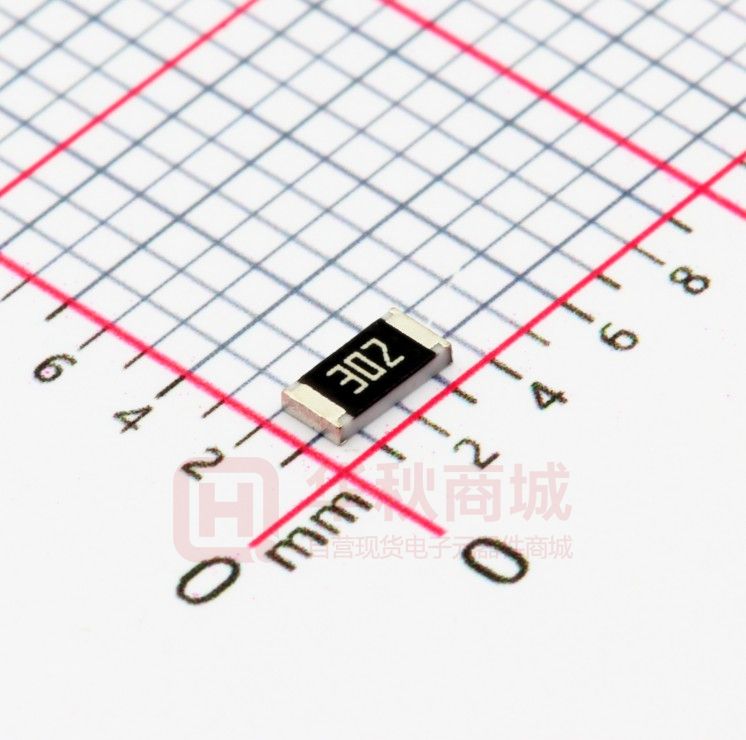

RC1206JR-07300KL
RC1206JR-07300KL
    YAGEO(国巨)
    1206
    贴片电阻 1206 300KΩ ±5% 1/4W ±100ppm/℃
RC1206JR-07300KL 数据手册
Product specification – Jul 02, 2009 V.4 Supersedes Date of Mar. 06, 2003 1100 DATA SHEET GENERAL PURPOSE CHIP RESISTORS RC1206 5%, 1% RoHS compliant Product specification Chip Resistor Surface Mount RC SCOPE ORDERING INFORMATION - GLOBAL PART NUMBER & 12NC This specification describes RC1206 series chip resistors with lead-free terminations made by thick film process. Both part numbers are identified by the series, size, tolerance, packing type, temperature coefficient, taping reel and resistance value. YAGEO BRAND ordering code GLOBAL PART NUMBER APPLICATIONS All general purpose application FEATURES Halogen Free Epoxy RoHS - - compliant RC1206 ( PREFERRED ) X R - XX XXXX L (1) (2) (3) (4) (5) (6) (1) TOLERANCE F = ±1% J = ±5% (for Jumper ordering, use code of J) (2) PACKAGING TYPE R = Paper taping reel Products with lead free terminations meet RoHS requirements (3) TEMPERATURE COEFFICIENT OF RESISTANCE Pb-glass contained in electrodes, resistor element and glass are exempted by RoHS (4) TAPING REEL – = Base on spec 07 = 7 inch dia. Reel 10 = 10 inch dia. Reel 13 = 13 inch dia. Reel Reducing environmentally hazardous wastes High component and equipment reliability Saving 2 9 1206 (RoHS Compliant) SERIES (5) RESISTANCE VALUE There are 2~4 digits indicated the resistor value. Letter R/K/M is decimal point, no need to mention the last zero after R/K/M, e.g.1K2, not 1K20. of PCB space None forbidden-materials used in products/production Detailed resistance rules show in table of “Resistance rule of global part number”. (6) DEFAULT CODE Letter L is system default code for order only (Note) Resistance rule of global part number Resistance code rule Example 0R 0R = Jumper XRXX (1 to 9.76 Ω) 1R = 1 Ω 1R5 = 1.5 Ω 9R76 = 9.76 Ω XXRX (10 to 97.6 Ω) 10R = 10 Ω 97R6 = 97.6 Ω XXXR (100 to 976 Ω) 100R = 100 Ω XKXX (1 to 9.76 KΩ) 1K = 1,000 Ω 9K76 = 9760 Ω XMXX (1 to 9.76 MΩ) 1M = 1,000,000 Ω 9M76= 9,760,000 Ω ORDERING EXAMPLE The ordering code of a RC1206 chip resistor, value 56 X with ±1% tolerance, supplied in 7-inch tape reel is: RC1206FR-0756RL. NOTE 1. All our RSMD products meet RoHS compliant and Halogen Free. "LFP" of the internal 2D reel label mentions "Lead Free Process" 2. On customized label, "LFP" or specific symbol can be printed www.yageo.com Jul 02, 2009 V.4 Product specification Chip Resistor Surface Mount RC SERIES 3 9 1206 (RoHS Compliant) PHYCOMP BRAND ordering codes Both GLOBAL PART NUMBER (preferred) and 12NC (traditional) codes are acceptable to order Phycomp brand products. GLOBAL PART NUMBER ( PREFERRED ) For detailed information of GLOBAL PART NUMBER and ordering example, please refer to page 2. 12NC CODE 2322 / 2350 XXX XXXXX L (1) TYPE/ START 1206 IN (1) (2) (3) Last digit of 12NC Resistance decade (3) (4) TOL. RESISTANCE (%) RANGE PAPER / PE TAPE ON REEL (units) (2) 5,000 10,000/not preferred 20,000 Last digit 0.01 to 0.0976 X 0.1 to 0.976 X 0 8 7 RC01 2322 ±5% 1 to 10 MΩ 711 61xxx 711 51xxx 711 81xxx 1 to 9.76 X RC02 2322 ±1% 1 to 10 MΩ 724 6xxxx 724 7xxxx 724 8xxxx 10 to 97.6 X 9 HRC01 2350 ±5% 11 to 22 MΩ 520 10xxx - - 100 to 976 X 1 Jumper 2322 - 0Ω 711 91032 711 91005 711 92004 1 to 9.76 KX 2 10 to 97.6 KX 3 (1) The resistors have a 12-digit ordering code starting with 2322 / 2350. 100 to 976 KX 4 (2) The subsequent 4 or 5 digits indicate the resistor tolerance and packaging. 1 to 9.76 MX 5 10 to 97.6 MX 6 (3) The remaining 4 or 3 digits represent the resistance value with the last digit indicating the multiplier as shown in the table of “Last digit of 12NC”. (4) Letter L is system default code for order only (Note) ORDERING EXAMPLE The ordering code of a RC02 resistor, value 56 X with ±1% tolerance, supplied in tape of 10,000 units per reel is: 232272465609L or RC1206FR-0756RL. Example: 0.02 X = 0200 or 200 0.3 X = 3007 or 307 1X = 1008 or 108 33 KX = 3303 or 333 10 MX = 1006 or 106 NOTE 1. All our RSMD products meet RoHS compliant and Halogen Free. "LFP" of the internal 2D reel label mentions "Lead Free Process" 2. On customized label, "LFP" or specific symbol can be printed www.yageo.com Jul 02, 2009 V.4 Product specification Chip Resistor Surface Mount RC SERIES 4 9 1206 (RoHS Compliant) MARKING RC1206 E-24 series: 3 digits 03 YNSC001 Fig. 1 Value = 10 KΩ First two digits for significant figure and 3rd digit for number of zeros Both E-24 and E-96 series: 4 digits 00 YNSC004 Fig. 2 Value = 10 KΩ First three digits for significant figure and 4th digit for number of zeros For further marking information, please see special data sheet “Chip resistors marking” CONSTRUCTION The resistor is constructed on top of a high-grade ceramic body. Internal metal electrodes are added on each end to make the contacts to the thick film resistive element. The composition of the resistive element is a noble metal imbedded into a glass and covered by a second glass to prevent environment influences. The resistor is laser trimmed to the rated resistance value. The resistor is covered with a protective epoxy coat, finally the two external terminations (matte tin on Nibarrier) are added. See fig.3 OUTLINES For dimension see Table 1 marking layer overcoat Primary glass layer resistive layer (Jumper chip is a conductor) inner electrode H termination (Ni/matte tin) ceramic substrate I2 overcoat I1 W DIMENSIONS YNSC066 Table 1 TYPE L RC1206 L (mm) 3.10 ± 0.10 W (mm) 1.60 ± 0.10 H (mm) 0.55 ± 0.10 I1 (mm) 0.45 ± 0.20 I2 (mm) 0.40 ± 0.20 Fig. 3 Chip resistor outlines www.yageo.com Jul 02, 2009 V.4 Product specification Chip Resistor Surface Mount RC SERIES ELECTRICAL CHARACTERISTICS 5 9 1206 (RoHS Compliant) FOOTPRINT AND SOLDERING PROFILES Table 2 RC1206 1/4 W CHARACTERISTICS Operating Temperature Range –55 °C to +155 °C Maximum Working Voltage 200 V Maximum Overload Voltage 400 V Dielectric Withstanding Voltage 500 V For recommended footprint and soldering profiles, please see the special data sheet “Chip resistors mounting”. 5% (E24) 1 Ω to 22 MΩ Resistance Range 1% (E24/E96) 1 Ω to 10 MΩ Zero Ohm Jumper < 0.05 Ω Temperature Coefficient 1 Ω ≤ R ≤ 10 Ω ±200 ppm/°C 10 MΩ < R ≤ 22 MΩ ±200 ppm/°C 10 Ω < R ≤ 10 MΩ ±100 ppm/°C Rated Current 2A Maximum Current 10 A Jumper Criteria PACKING STYLE AND PACKAGING QUANTITY Table 3 Packing style and packaging quantity PRODUCT TYPE PACKING STYLE REEL DIMENSION QUANTITY PER REEL RC1206 Paper Taping Reel (R) 7" (178 mm) 5,000 units 10" (254 mm) 10,000 units 13" (330 mm) 20,000 units NOTE 1. For paper tape and reel specification/dimensions, please see the special data sheet “Chip resistors packing” FUNCTIONAL DESCRIPTION POWER RATING RC1206 rated power at 70°C is 1/4 W RATED VOLTAGE The DC or AC (rms) continuous working voltage corresponding to the rated power is determined by the following formula: V=√(P X R) or max. working voltage whichever is less handbook, halfpage P (%Prated ) MLB206_2 100 50 0 55 0 50 70 100 155 o Tamb ( C) Where V=Continuous rated DC or AC (rms) working voltage (V) Fig. 4 Maximum dissipation (P) in percentage of rated power as a function of the operating ambient temperature (Tamb) P=Rated power (W) R=Resistance value (X) www.yageo.com Jul 02, 2009 V.4 Product specification Chip Resistor Surface Mount RC SERIES 6 9 1206 (RoHS Compliant) TESTS AND REQUIREMENTS Table 4 Test condition, procedure and requirements TEST TEST METHOD PROCEDURE REQUIREMENTS Temperature Coefficient of Resistance (T.C.R.) IEC 60115-1 4.8 At +25/–55 °C and +25/+125 °C Refer to table 2 Formula: R2–R1 T.C.R= ------------------------- ×106 (ppm/°C) R1(t2–t1) Where t1=+25 °C or specified room temperature t2=–55 °C or +125 °C test temperature R1=resistance at reference temperature in ohms R2=resistance at test temperature in ohms Life/Endurance IEC 60115-1 4.25.1 At 70±5 °C for 1,000 hours, RCWV applied for 1.5 hours on, 0.5 hour off, still air required ±(1.0%+0.05 Ω) for 1% tol. ±(3.0%+0.05 Ω) for 5% tol.
