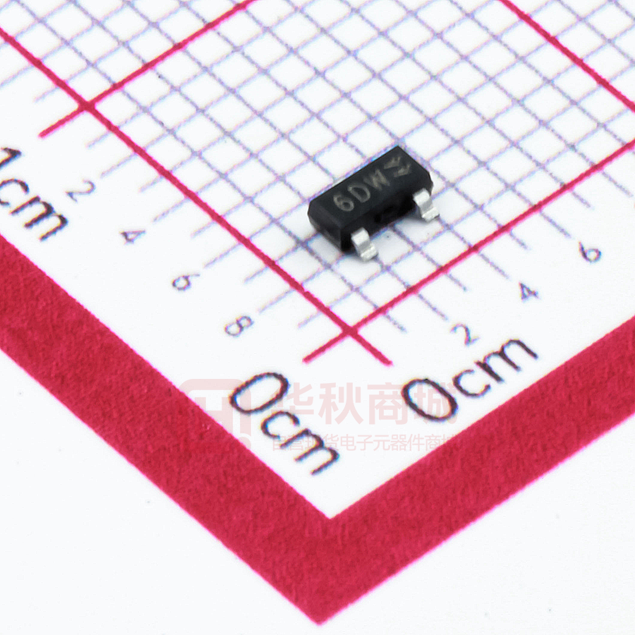

    通用三极管 45V 500mA NPN SOT23 100~600
BC817,215 数据手册
DISCRETE SEMICONDUCTORS DATA SHEET book, halfpage M3D088 BC817 NPN general purpose transistor Product specification Supersedes data of 1997 Mar 12 1999 Jun 01 Philips Semiconductors Product specification NPN general purpose transistor BC817 FEATURES PINNING • High current (max. 500 mA) PIN • Low voltage (max. 45 V). APPLICATIONS DESCRIPTION 1 base 2 emitter 3 collector • General purpose switching and amplification. DESCRIPTION NPN transistor in a SOT23 plastic package. PNP complement: BC807. handbook, halfpage 3 3 MARKING TYPE NUMBER 1 MARKING CODE(1) TYPE NUMBER MARKING CODE(1) BC817 6D∗ BC817-25 6B∗ BC817-16 6A∗ BC817-40 6C∗ 1 2 2 Top view MAM255 Note 1. ∗ = p : Made in Hong Kong. ∗ = t : Made in Malaysia. Fig.1 Simplified outline (SOT23) and symbol. LIMITING VALUES In accordance with the Absolute Maximum Rating System (IEC 134). SYMBOL PARAMETER CONDITIONS MIN. MAX. UNIT VCBO collector-base voltage open emitter − 50 V VCEO collector-emitter voltage open base; IC = 10 mA − 45 V VEBO emitter-base voltage open collector − 5 V IC collector current (DC) − 500 mA ICM peak collector current − 1 A IBM peak base current − 200 mA Ptot total power dissipation − 250 mW Tstg storage temperature −65 +150 °C Tj junction temperature − 150 °C Tamb operating ambient temperature −65 +150 °C Tamb ≤ 25 °C; note 1 Note 1. Transistor mounted on an FR4 printed-circuit board. 1999 Jun 01 2 Philips Semiconductors Product specification NPN general purpose transistor BC817 THERMAL CHARACTERISTICS SYMBOL Rth j-a PARAMETER CONDITIONS thermal resistance from junction to ambient VALUE UNIT 500 K/W note 1 Note 1. Transistor mounted on an FR4 printed-circuit board. CHARACTERISTICS Tj = 25 °C unless otherwise specified. SYMBOL PARAMETER CONDITIONS MIN. TYP. MAX. UNIT IE = 0; VCB = 20 V − − 100 nA ICBO collector cut-off current IE = 0; VCB = 20 V; Tj = 150 °C − − 5 µA IEBO emitter cut-off current IC = 0; VEB = 5 V − − 100 nA hFE DC current gain IC = 100 mA; VCE = 1 V; note 1; see Figs 2, 3 and 4 100 − 600 BC817-16 100 − 250 BC817-25 160 − 400 BC817-40 250 − 600 BC817 hFE DC current gain 40 − − VCEsat collector-emitter saturation voltage IC = 500 mA; IB = 50 mA; note 1 − − 700 mV VBE base-emitter voltage IC = 500 mA; VCE = 1 V; note 2 − − 1.2 V Cc collector capacitance IE = ie = 0; VCB = 10 V; f = 1 MHz; − 5 − pF fT transition frequency IC = 10 mA; VCE = 5 V; f = 100 MHz; 100 − − MHz IC = 500 mA; VCE = 1 V; note 1 Notes 1. Pulse test: tp ≤ 300 µs; δ ≤ 0.02. 2. VBE decreases by approx. 2 mV/K with increasing temperature. 1999 Jun 01 3 Philips Semiconductors Product specification NPN general purpose transistor BC817 MBH721 20 handbook, full pagewidth hFE 160 VCE = 1 V 120 80 40 0 10−1 1 10 102 IC (mA) 103 BC817-16. Fig.2 DC current gain; typical values. MBH720 500 handbook, full pagewidth hFE 400 VCE = 1 V 300 200 100 0 10−1 1 10 BC817-25. Fig.3 DC current gain; typical values. 1999 Jun 01 4 102 IC (mA) 103 Philips Semiconductors Product specification NPN general purpose transistor BC817 MBH722 500 handbook, full pagewidth hFE 400 VCE = 1 V 300 200 100 0 10−1 1 10 BC817-40. Fig.4 DC current gain; typical values. 1999 Jun 01 5 102 IC (mA) 103 Philips Semiconductors Product specification NPN general purpose transistor BC817 PACKAGE OUTLINE Plastic surface mounted package; 3 leads SOT23 D E B A X HE v M A 3 Q A A1 1 2 e1 bp c w M B Lp e detail X 0 1 2 mm scale DIMENSIONS (mm are the original dimensions) UNIT A A1 max. bp c D E e e1 HE Lp Q v w mm 1.1 0.9 0.1 0.48 0.38 0.15 0.09 3.0 2.8 1.4 1.2 1.9 0.95 2.5 2.1 0.45 0.15 0.55 0.45 0.2 0.1 OUTLINE VERSION REFERENCES IEC JEDEC EIAJ ISSUE DATE 97-02-28 SOT23 1999 Jun 01 EUROPEAN PROJECTION 6 Philips Semiconductors Product specification NPN general purpose transistor BC817 DEFINITIONS Data Sheet Status Objective specification This data sheet contains target or goal specifications for product development. Preliminary specification This data sheet contains preliminary data; supplementary data may be published later. Product specification This data sheet contains final product specifications. Limiting values Limiting values given are in accordance with the Absolute Maximum Rating System (IEC 134). Stress above one or more of the limiting values may cause permanent damage to the device. These are stress ratings only and operation of the device at these or at any other conditions above those given in the Characteristics sections of the specification is not implied. Exposure to limiting values for extended periods may affect device reliability. Application information Where application information is given, it is advisory and does not form part of the specification. LIFE SUPPORT APPLICATIONS These products are not designed for use in life support appliances, devices, or systems where malfunction of these products can reasonably be expected to result in personal injury. Philips customers using or selling these products for use in such applications do so at their own risk and agree to fully indemnify Philips for any damages resulting from such improper use or sale. 1999 Jun 01 7 Philips Semiconductors – a worldwide company Argentina: see South America Australia: 34 Waterloo Road, NORTH RYDE, NSW 2113, Tel. +61 2 9805 4455, Fax. +61 2 9805 4466 Austria: Computerstr. 6, A-1101 WIEN, P.O. Box 213, Tel. +43 1 60 101 1248, Fax. +43 1 60 101 1210 Belarus: Hotel Minsk Business Center, Bld. 3, r. 1211, Volodarski Str. 6, 220050 MINSK, Tel. +375 172 20 0733, Fax. +375 172 20 0773 Belgium: see The Netherlands Brazil: see South America Bulgaria: Philips Bulgaria Ltd., Energoproject, 15th floor, 51 James Bourchier Blvd., 1407 SOFIA, Tel. +359 2 68 9211, Fax. +359 2 68 9102 Canada: PHILIPS SEMICONDUCTORS/COMPONENTS, Tel. +1 800 234 7381, Fax. +1 800 943 0087 China/Hong Kong: 501 Hong Kong Industrial Technology Centre, 72 Tat Chee Avenue, Kowloon Tong, HONG KONG, Tel. +852 2319 7888, Fax. +852 2319 7700 Colombia: see South America Czech Republic: see Austria Denmark: Sydhavnsgade 23, 1780 COPENHAGEN V, Tel. +45 33 29 3333, Fax. +45 33 29 3905 Finland: Sinikalliontie 3, FIN-02630 ESPOO, Tel. +358 9 615 800, Fax. +358 9 6158 0920 France: 51 Rue Carnot, BP317, 92156 SURESNES Cedex, Tel. +33 1 4099 6161, Fax. +33 1 4099 6427 Germany: Hammerbrookstraße 69, D-20097 HAMBURG, Tel. +49 40 2353 60, Fax. +49 40 2353 6300 Hungary: see Austria India: Philips INDIA Ltd, Band Box Building, 2nd floor, 254-D, Dr. Annie Besant Road, Worli, MUMBAI 400 025, Tel. +91 22 493 8541, Fax. +91 22 493 0966 Indonesia: PT Philips Development Corporation, Semiconductors Division, Gedung Philips, Jl. Buncit Raya Kav.99-100, JAKARTA 12510, Tel. +62 21 794 0040 ext. 2501, Fax. +62 21 794 0080 Ireland: Newstead, Clonskeagh, DUBLIN 14, Tel. +353 1 7640 000, Fax. +353 1 7640 200 Israel: RAPAC Electronics, 7 Kehilat Saloniki St, PO Box 18053, TEL AVIV 61180, Tel. +972 3 645 0444, Fax. +972 3 649 1007 Italy: PHILIPS SEMICONDUCTORS, Piazza IV Novembre 3, 20124 MILANO, Tel. +39 02 67 52 2531, Fax. +39 02 67 52 2557 Japan: Philips Bldg 13-37, Kohnan 2-chome, Minato-ku, TOKYO 108-8507, Tel. +81 3 3740 5130, Fax. +81 3 3740 5057 Korea: Philips House, 260-199 Itaewon-dong, Yongsan-ku, SEOUL, Tel. +82 2 709 1412, Fax. +82 2 709 1415 Malaysia: No. 76 Jalan Universiti, 46200 PETALING JAYA, SELANGOR, Tel. +60 3 750 5214, Fax. +60 3 757 4880 Mexico: 5900 Gateway East, Suite 200, EL PASO, TEXAS 79905, Tel. +9-5 800 234 7381, Fax +9-5 800 943 0087 Middle East: see Italy Netherlands: Postbus 90050, 5600 PB EINDHOVEN, Bldg. VB, Tel. +31 40 27 82785, Fax. +31 40 27 88399 New Zealand: 2 Wagener Place, C.P.O. Box 1041, AUCKLAND, Tel. +64 9 849 4160, Fax. +64 9 849 7811 Norway: Box 1, Manglerud 0612, OSLO, Tel. +47 22 74 8000, Fax. +47 22 74 8341 Pakistan: see Singapore Philippines: Philips Semiconductors Philippines Inc., 106 Valero St. Salcedo Village, P.O. Box 2108 MCC, MAKATI, Metro MANILA, Tel. +63 2 816 6380, Fax. +63 2 817 3474 Poland: Ul. Lukiska 10, PL 04-123 WARSZAWA, Tel. +48 22 612 2831, Fax. +48 22 612 2327 Portugal: see Spain Romania: see Italy Russia: Philips Russia, Ul. Usatcheva 35A, 119048 MOSCOW, Tel. +7 095 755 6918, Fax. +7 095 755 6919 Singapore: Lorong 1, Toa Payoh, SINGAPORE 319762, Tel. +65 350 2538, Fax. +65 251 6500 Slovakia: see Austria Slovenia: see Italy South Africa: S.A. PHILIPS Pty Ltd., 195-215 Main Road Martindale, 2092 JOHANNESBURG, P.O. Box 58088 Newville 2114, Tel. +27 11 471 5401, Fax. +27 11 471 5398 South America: Al. Vicente Pinzon, 173, 6th floor, 04547-130 SÃO PAULO, SP, Brazil, Tel. +55 11 821 2333, Fax. +55 11 821 2382 Spain: Balmes 22, 08007 BARCELONA, Tel. +34 93 301 6312, Fax. +34 93 301 4107 Sweden: Kottbygatan 7, Akalla, S-16485 STOCKHOLM, Tel. +46 8 5985 2000, Fax. +46 8 5985 2745 Switzerland: Allmendstrasse 140, CH-8027 ZÜRICH, Tel. +41 1 488 2741 Fax. +41 1 488 3263 Taiwan: Philips Semiconductors, 6F, No. 96, Chien Kuo N. Rd., Sec. 1, TAIPEI, Taiwan Tel. +886 2 2134 2886, Fax. +886 2 2134 2874 Thailand: PHILIPS ELECTRONICS (THAILAND) Ltd., 209/2 Sanpavuth-Bangna Road Prakanong, BANGKOK 10260, Tel. +66 2 745 4090, Fax. +66 2 398 0793 Turkey: Yukari Dudullu, Org. San. Blg., 2.Cad. Nr. 28 81260 Umraniye, ISTANBUL, Tel. +90 216 522 1500, Fax. +90 216 522 1813 Ukraine: PHILIPS UKRAINE, 4 Patrice Lumumba str., Building B, Floor 7, 252042 KIEV, Tel. +380 44 264 2776, Fax. +380 44 268 0461 United Kingdom: Philips Semiconductors Ltd., 276 Bath Road, Hayes, MIDDLESEX UB3 5BX, Tel. +44 181 730 5000, Fax. +44 181 754 8421 United States: 811 East Arques Avenue, SUNNYVALE, CA 94088-3409, Tel. +1 800 234 7381, Fax. +1 800 943 0087 Uruguay: see South America Vietnam: see Singapore Yugoslavia: PHILIPS, Trg N. Pasica 5/v, 11000 BEOGRAD, Tel. +381 11 62 5344, Fax.+381 11 63 5777 For all other countries apply to: Philips Semiconductors, International Marketing & Sales Communications, Building BE-p, P.O. Box 218, 5600 MD EINDHOVEN, The Netherlands, Fax. +31 40 27 24825 Internet: http://www.semiconductors.philips.com © Philips Electronics N.V. 1999 SCA 65 All rights are reserved. Reproduction in whole or in part is prohibited without the prior written consent of the copyright owner. The information presented in this document does not form part of any quotation or contract, is believed to be accurate and reliable and may be changed without notice. No liability will be accepted by the publisher for any consequence of its use. Publication thereof does not convey nor imply any license under patent- or other industrial or intellectual property rights. Printed in The Netherlands 15002/03/pp8 Date of release: 1999 Jun 01 Document order number: 9397 750 05955
