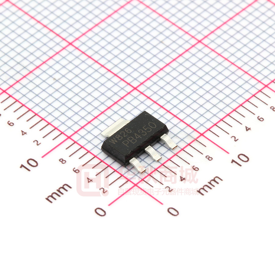

PBSS4350Z 50 V low VCEsat NPN transistor 26 June 2018 Product data sheet 1. General description NPN low VCEsat transistor in a SOT223 plastic package. PNP complement: PBSS5350Z. 2. Features and benefits • • • • • • Low collector-emitter saturation voltage High collector current capability: IC and ICM High collector current gain (hFE ) at high IC Higher efficiency leading to less heat generation Reduced PCB area requirements compared to DPAK. AEC-Q101 qualified 3. Applications • Power management • • DC/DC converters • Supply line switching • Battery charger • Linear voltage regulation (LDO). Peripheral drivers • • Driver in low supply voltage applications, e.g. lamps, LEDs Inductive load driver, e.g. relays, buzzers, motors. 4. Quick reference data Table 1. Quick reference data Symbol Parameter Conditions Min Typ Max Unit VCEO collector-emitter voltage open base - - 50 V IC collector current - - 3 A ICM peak collector current single pulse; tp ≤ 1 ms - - 5 A hFE DC current gain VCE = 2 V; IC = 500 mA; Tamb = 25 °C [1] 200 - - RCEsat collector-emitter saturation resistance IC = 2 A; IB = 200 mA; Tamb = 25 °C [1] - 110 145 [1] Pulse test: tp ≤ 300 μs; δ ≤ 0.02 mΩ PBSS4350Z Nexperia 50 V low VCEsat NPN transistor 5. Pinning information Table 2. Pinning information Pin Symbol Description 1 B base 2 C collector 3 E emitter 4 C collector Simplified outline Graphic symbol C 4 B 1 2 3 SC-73 (SOT223) E sym123 6. Ordering information Table 3. Ordering information Type number PBSS4350Z Package Name Description Version SC-73 plastic surface-mounted package with increased heatsink; 4 leads SOT223 7. Marking Table 4. Marking codes Type number Marking code PBSS4350Z PB4350 PBSS4350Z Product data sheet All information provided in this document is subject to legal disclaimers. 26 June 2018 © Nexperia B.V. 2018. All rights reserved 2 / 12 PBSS4350Z Nexperia 50 V low VCEsat NPN transistor 8. Limiting values Table 5. Limiting values In accordance with the Absolute Maximum Rating System (IEC 60134). Symbol Parameter Conditions Min Max Unit VCBO collector-base voltage open emitter - 60 V VCEO collector-emitter voltage open base - 50 V VEBO emitter-base voltage open collector - 6 V IC collector current - 3 A ICM peak collector current - 5 A IBM peak base current - 1 A Ptot total power dissipation [1] - 1.35 W [2] - 2 W single pulse; tp ≤ 1 ms Tamb ≤ 25 °C Tj junction temperature - 150 °C Tamb ambient temperature -65 150 °C Tstg storage temperature -65 150 °C [1] [2] 2 Device mounted on an FR4 PCB, single-sided copper, tin-plated, mounting pad for collector 1 cm . 2 Device mounted on an FR4 PCB, single-sided copper, tin-plated, mounting pad for collector 6 cm . 9. Thermal characteristics Table 6. Thermal characteristics Symbol Parameter Conditions Rth(j-a) thermal resistance from junction to ambient in free air [1] [2] Min Typ Max Unit [1] - - 92 K/W [2] - - 62.5 K/W 2 Device mounted on an FR4 PCB, single-sided copper, tin-plated, mounting pad for collector 1 cm . 2 Device mounted on an FR4 PCB, single-sided copper, tin-plated, mounting pad for collector 6 cm . PBSS4350Z Product data sheet All information provided in this document is subject to legal disclaimers. 26 June 2018 © Nexperia B.V. 2018. All rights reserved 3 / 12 PBSS4350Z Nexperia 50 V low VCEsat NPN transistor 10. Characteristics Table 7. Characteristics Symbol Parameter Conditions Min Typ Max Unit ICBO collector-base cut-off current VCB = 50 V; IE = 0 A; Tamb = 25 °C - - 100 nA VCB = 50 V; IE = 0 A; Tj = 150 °C - - 50 µA IEBO emitter-base cut-off current VEB = 5 V; IC = 0 A; Tamb = 25 °C - - 100 nA hFE DC current gain VCE = 2 V; IC = 500 mA; Tamb = 25 °C [1] 200 - - VCE = 2 V; IC = 1 A; Tamb = 25 °C [1] 200 - - VCE = 2 V; IC = 2 A; Tamb = 25 °C [1] 100 - - IC = 500 mA; IB = 50 mA; Tamb = 25 °C [1] - - 90 mV IC = 1 A; IB = 50 mA; Tamb = 25 °C [1] - - 170 mV IC = 2 A; IB = 200 mA; Tamb = 25 °C [1] - - 290 mV VCEsat collector-emitter saturation voltage RCEsat collector-emitter saturation resistance [1] - 110 145 mΩ VBEsat base-emitter saturation voltage [1] - - 1.2 V VBEon base-emitter turn-on voltage VCE = 2 V; IC = 1 A; Tamb = 25 °C [1] - - 1.1 V fT transition frequency VCE = 5 V; IC = 100 mA; f = 100 MHz; Tamb = 25 °C 100 - - MHz Cc collector capacitance VCB = 10 V; IE = 0 A; ie = 0 A; f = 1 MHz; Tamb = 25 °C - - 30 pF [1] Pulse test: tp ≤ 300 μs; δ ≤ 0.02 PBSS4350Z Product data sheet All information provided in this document is subject to legal disclaimers. 26 June 2018 © Nexperia B.V. 2018. All rights reserved 4 / 12 PBSS4350Z Nexperia 50 V low VCEsat NPN transistor mgw175 600 hFE 500 mgw176 1.2 VBE (V) 1.0 (1) (1) 400 0.8 (2) 300 (2) 0.6 (3) 200 0.4 (3) 100 0 10- 1 0.2 1 10 102 0 10- 1 103 104 IC (mA) VCE = 2 V (1) Tamb = 150 °C (2) Tamb = 25 °C (3) Tamb = −55 °C Fig. 1. 1 10 102 103 104 IC (mA) VCE = 2 V (1) Tamb = −55 °C (2) Tamb = 25 C (3) Tamb = 150 °C DC current gain; typical values Fig. 2. mgw181 103 Base-emitter voltage as a function of collectorcurrent; typical values mgw178 1.2 VBEsat (V) 1.0 VCEsat (mV) 102 (1) 0.8 (2) (1) 0.6 (2) (3) (3) 0.4 10 0.2 1 10- 1 1 10 102 0 10- 1 103 104 IC (mA) Collector-emitter saturation as a function of collector current; typical values. PBSS4350Z Product data sheet 10 102 103 104 IC (mA) IC/IB = 20 (1) Tamb = 150 °C (2) Tamb = 25 °C (3) Tamb = −55 °C IC/IB = 20 (1) Tamb = 150 °C (2) Tamb = 25 °C (3) Tamb = −55 °C Fig. 3. 1 Fig. 4. Base-emitter saturation voltage as a function of collector current; typical values All information provided in this document is subject to legal disclaimers. 26 June 2018 © Nexperia B.V. 2018. All rights reserved 5 / 12 PBSS4350Z Nexperia 50 V low VCEsat NPN transistor mgw179 1200 IC (mA) (1) IC (A) (1) 1000 mgw180 5 (2) 4 (3) (8) (4) 800 (2) (3) (4) (5) (6) (7) (5) 3 (9) (6) 600 (7) (10) 2 (8) 400 (9) (10) 200 1 (11) (12) 0 0 0.4 0.8 1.2 0 1.6 2 VCE (V) Tamb = 25 °C (1) IB = 3.96 mA (2) IB = 3.63 mA (3) IB = 3.30 mA (4) IB = 2.97 mA (5) IB = 2.64 mA (6) IB = 2.31 mA (7) IB = 1.98 mA (8) IB = 1.65 mA (9) IB = 1.32 mA (10) IB = 0.99 mA (11) IB = 0.66 mA (12) IB = 0.33 mA Fig. 5. 0 0.4 0.8 1.2 1.6 2 VCE (V) Tamb = 25 °C (1) IB = 150 mA (2) IB= 135 mA (3) IB = 120 mA (4) IB = 105 mA (5) IB = 90 mA (6) IB = 75 mA (7) IB = 60 mA (8) IB = 45 mA (9) IB = 30 mA (10) IB = 15 mA Fig. 6. Collector current as a function of collectoremitter voltage; typical values Collector current as a function of collectoremitter voltage; typical values. mgw182 103 RCEsat (Ω) 102 10 1 (1) (2) (3) 10- 1 10- 2 10- 1 1 10 102 103 104 IC (mA) IC/IB = 20 (1) Tamb = 150 °C (2) Tamb = 25 °C (3) Tamb = −55 °C Fig. 7. Collector-emitter equivalent on-resistance as a function of collector current; typical values PBSS4350Z Product data sheet All information provided in this document is subject to legal disclaimers. 26 June 2018 © Nexperia B.V. 2018. All rights reserved 6 / 12 PBSS4350Z Nexperia 50 V low VCEsat NPN transistor 11. Package outline Plastic surface-mounted package with increased heatsink; 4 leads D SOT223 E B A X c y HE v M A b1 4 Q A A1 1 2 e1 3 Lp bp w M B detail X e 0 2 4 mm scale DIMENSIONS (mm are the original dimensions) UNIT A A1 bp b1 c D E e e1 HE Lp Q v w y mm 1.8 1.5 0.10 0.01 0.80 0.60 3.1 2.9 0.32 0.22 6.7 6.3 3.7 3.3 4.6 2.3 7.3 6.7 1.1 0.7 0.95 0.85 0.2 0.1 0.1 OUTLINE VERSION REFERENCES IEC JEDEC SOT223 Fig. 8. JEITA EUROPEAN PROJECTION ISSUE DATE 04-11-10 06-03-16 SC-73 Package outline SC-73 (SOT223) PBSS4350Z Product data sheet All information provided in this document is subject to legal disclaimers. 26 June 2018 © Nexperia B.V. 2018. All rights reserved 7 / 12 PBSS4350Z Nexperia 50 V low VCEsat NPN transistor 12. Soldering 7 3.85 3.6 3.5 0.3 1.3 1.2 (4×) (4×) solder lands 4 solder resist 3.9 6.1 7.65 solder paste occupied area 1 2 3 Dimensions in mm 2.3 2.3 1.2 (3×) 1.3 (3×) 6.15 Fig. 9. sot223_fr Reflow soldering footprint for SC-73 (SOT223) 8.9 6.7 1.9 solder lands 4 solder resist 6.2 1 2 8.7 Dimensions in mm 3 1.9 (3×) 2.7 occupied area preferred transport direction during soldering 2.7 1.1 1.9 (2×) sot223_fw Fig. 10. Wave soldering footprint for SC-73 (SOT223) PBSS4350Z Product data sheet All information provided in this document is subject to legal disclaimers. 26 June 2018 © Nexperia B.V. 2018. All rights reserved 8 / 12 PBSS4350Z Nexperia 50 V low VCEsat NPN transistor 13. Revision history Table 8. Revision history Data sheet ID Release date Data sheet status Change notice Supersedes PBSS4350Z v.3 20180626 Product data sheet - PBSS4350Z v.2 Modifications: • • • Figures 6 and 7 corrected The format of this data sheet has been redesigned to comply with the identity guidelines of Nexperia. Legal texts have been adapted to the new company name where appropriate. PBSS4350Z v.2 20030513 Product data sheet - PBSS4350Z v.1 PBSS4350Z v.1 20030120 Product data sheet - - PBSS4350Z Product data sheet All information provided in this document is subject to legal disclaimers. 26 June 2018 © Nexperia B.V. 2018. All rights reserved 9 / 12 PBSS4350Z Nexperia 50 V low VCEsat NPN transistor Suitability for use — Nexperia products are not designed, authorized or warranted to be suitable for use in life support, life-critical or safety-critical systems or equipment, nor in applications where failure or malfunction of an Nexperia product can reasonably be expected to result in personal injury, death or severe property or environmental damage. Nexperia and its suppliers accept no liability for inclusion and/or use of Nexperia products in such equipment or applications and therefore such inclusion and/or use is at the customer’s own risk. 14. Legal information Data sheet status Document status [1][2] Product status [3] Definition Objective [short] data sheet Development This document contains data from the objective specification for product development. Preliminary [short] data sheet Qualification This document contains data from the preliminary specification. Product [short] data sheet Production This document contains the product specification. [1] [2] [3] Please consult the most recently issued document before initiating or completing a design. The term 'short data sheet' is explained in section "Definitions". The product status of device(s) described in this document may have changed since this document was published and may differ in case of multiple devices. The latest product status information is available on the internet at https://www.nexperia.com. Definitions Draft — The document is a draft version only. The content is still under internal review and subject to formal approval, which may result in modifications or additions. Nexperia does not give any representations or warranties as to the accuracy or completeness of information included herein and shall have no liability for the consequences of use of such information. Short data sheet — A short data sheet is an extract from a full data sheet with the same product type number(s) and title. A short data sheet is intended for quick reference only and should not be relied upon to contain detailed and full information. For detailed and full information see the relevant full data sheet, which is available on request via the local Nexperia sales office. In case of any inconsistency or conflict with the short data sheet, the full data sheet shall prevail. Product specification — The information and data provided in a Product data sheet shall define the specification of the product as agreed between Nexperia and its customer, unless Nexperia and customer have explicitly agreed otherwise in writing. In no event however, shall an agreement be valid in which the Nexperia product is deemed to offer functions and qualities beyond those described in the Product data sheet. Disclaimers Limited warranty and liability — Information in this document is believed to be accurate and reliable. However, Nexperia does not give any representations or warranties, expressed or implied, as to the accuracy or completeness of such information and shall have no liability for the consequences of use of such information. Nexperia takes no responsibility for the content in this document if provided by an information source outside of Nexperia. In no event shall Nexperia be liable for any indirect, incidental, punitive, special or consequential damages (including - without limitation - lost profits, lost savings, business interruption, costs related to the removal or replacement of any products or rework charges) whether or not such damages are based on tort (including negligence), warranty, breach of contract or any other legal theory. Notwithstanding any damages that customer might incur for any reason whatsoever, Nexperia’s aggregate and cumulative liability towards customer for the products described herein shall be limited in accordance with the Terms and conditions of commercial sale of Nexperia. Right to make changes — Nexperia reserves the right to make changes to information published in this document, including without limitation specifications and product descriptions, at any time and without notice. This document supersedes and replaces all information supplied prior to the publication hereof. PBSS4350Z Product data sheet Quick reference data — The Quick reference data is an extract of the product data given in the Limiting values and Characteristics sections of this document, and as such is not complete, exhaustive or legally binding. Applications — Applications that are described herein for any of these products are for illustrative purposes only. Nexperia makes no representation or warranty that such applications will be suitable for the specified use without further testing or modification. Customers are responsible for the design and operation of their applications and products using Nexperia products, and Nexperia accepts no liability for any assistance with applications or customer product design. It is customer’s sole responsibility to determine whether the Nexperia product is suitable and fit for the customer’s applications and products planned, as well as for the planned application and use of customer’s third party customer(s). Customers should provide appropriate design and operating safeguards to minimize the risks associated with their applications and products. Nexperia does not accept any liability related to any default, damage, costs or problem which is based on any weakness or default in the customer’s applications or products, or the application or use by customer’s third party customer(s). Customer is responsible for doing all necessary testing for the customer’s applications and products using Nexperia products in order to avoid a default of the applications and the products or of the application or use by customer’s third party customer(s). Nexperia does not accept any liability in this respect. Limiting values — Stress above one or more limiting values (as defined in the Absolute Maximum Ratings System of IEC 60134) will cause permanent damage to the device. Limiting values are stress ratings only and (proper) operation of the device at these or any other conditions above those given in the Recommended operating conditions section (if present) or the Characteristics sections of this document is not warranted. Constant or repeated exposure to limiting values will permanently and irreversibly affect the quality and reliability of the device. Terms and conditions of commercial sale — Nexperia products are sold subject to the general terms and conditions of commercial sale, as published at http://www.nexperia.com/profile/terms, unless otherwise agreed in a valid written individual agreement. In case an individual agreement is concluded only the terms and conditions of the respective agreement shall apply. Nexperia hereby expressly objects to applying the customer’s general terms and conditions with regard to the purchase of Nexperia products by customer. No offer to sell or license — Nothing in this document may be interpreted or construed as an offer to sell products that is open for acceptance or the grant, conveyance or implication of any license under any copyrights, patents or other industrial or intellectual property rights. Export control — This document as well as the item(s) described herein may be subject to export control regulations. Export might require a prior authorization from competent authorities. Non-automotive qualified products — Unless this data sheet expressly states that this specific Nexperia product is automotive qualified, the product is not suitable for automotive use. It is neither qualified nor tested in accordance with automotive testing or application requirements. Nexperia accepts no liability for inclusion and/or use of non-automotive qualified products in automotive equipment or applications. In the event that customer uses the product for design-in and use in automotive applications to automotive specifications and standards, customer (a) shall use the product without Nexperia’s warranty of the product for such automotive applications, use and specifications, and (b) whenever customer uses the product for automotive applications beyond Nexperia’s specifications such use shall be solely at customer’s own risk, and (c) customer fully indemnifies Nexperia for any liability, damages or failed product claims resulting from customer design and use of the product for automotive applications beyond Nexperia’s standard warranty and Nexperia’s product specifications. All information provided in this document is subject to legal disclaimers. 26 June 2018 © Nexperia B.V. 2018. All rights reserved 10 / 12 PBSS4350Z Nexperia 50 V low VCEsat NPN transistor Translations — A non-English (translated) version of a document is for reference only. The English version shall prevail in case of any discrepancy between the translated and English versions. Trademarks Notice: All referenced brands, product names, service names and trademarks are the property of their respective owners. PBSS4350Z Product data sheet All information provided in this document is subject to legal disclaimers. 26 June 2018 © Nexperia B.V. 2018. All rights reserved 11 / 12 PBSS4350Z Nexperia 50 V low VCEsat NPN transistor Contents 1. General description......................................................1 2. Features and benefits.................................................. 1 3. Applications.................................................................. 1 4. Quick reference data....................................................1 5. Pinning information......................................................2 6. Ordering information....................................................2 7. Marking.......................................................................... 2 8. Limiting values............................................................. 3 9. Thermal characteristics............................................... 3 10. Characteristics............................................................ 4 11. Package outline.......................................................... 7 12. Soldering..................................................................... 8 13. Revision history..........................................................9 14. Legal information.......................................................10 © Nexperia B.V. 2018. All rights reserved For more information, please visit: http://www.nexperia.com For sales office addresses, please send an email to: salesaddresses@nexperia.com Date of release: 26 June 2018 PBSS4350Z Product data sheet All information provided in this document is subject to legal disclaimers. 26 June 2018 © Nexperia B.V. 2018. All rights reserved 12 / 12
