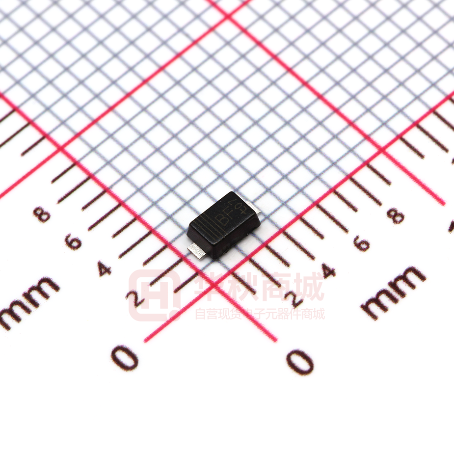

    肖特基二极管 40V 570mW SMT SOD123W 3A 250pF
PMEG4030ER,115 数据手册
PMEG4030ER 3 A low VF MEGA Schottky barrier rectifier 12 December 2017 Product data sheet 1. General description Planar Maximum Efficiency General Application (MEGA) Schottky barrier rectifier with an integrated guard ring for stress protection, encapsulated in a SOD123W small and flat lead Surface-Mounted Device (SMD) plastic package. 2. Features and benefits • • • • • • • Average forward current: IF(AV) ≤ 3 A Reverse voltage: VR ≤ 40 V Low forward voltage High power capability due to clip-bond technology AEC-Q101 qualified Small and flat lead SMD plastic package Capable for reflow and wave soldering 3. Applications • • • • • Low voltage rectification High efficiency DC-to-DC conversion Switch Mode Power Supply (SMPS) Reverse polarity protection Low power consumption applications 4. Quick reference data Table 1. Quick reference data Symbol Parameter Conditions Min Typ Max Unit IF(AV) average forward current δ = 0.5 ; f = 20 kHz; Tamb ≤ 40 °C; square wave - - 3 A δ = 0.5 ; f = 20 kHz; Tsp ≤ 130 °C; square wave - - 3 A [1] VR reverse voltage Tj = 25 °C - - 40 V VF forward voltage IF = 3 A; Tj = 25 °C - 460 540 mV IR reverse current VR = 40 V; Tj = 25 °C - 25 100 µA [1] Device mounted on a ceramic PCB, Al2O3, standard footprint. PMEG4030ER Nexperia 3 A low VF MEGA Schottky barrier rectifier 5. Pinning information Table 2. Pinning information Pin Symbol Description 1 K cathode[1] 2 A anode [1] Simplified outline 1 Graphic symbol 2 CFP3 (SOD123W) 1 2 sym001 The marking bar indicates the cathode. 6. Ordering information Table 3. Ordering information Type number PMEG4030ER Package Name Description Version CFP3 plastic, surface mounted package; 2 terminals; 2.6 mm x 1.7 mm SOD123W x 1 mm body 7. Marking Table 4. Marking codes Type number Marking code PMEG4030ER BF PMEG4030ER Product data sheet All information provided in this document is subject to legal disclaimers. 12 December 2017 © Nexperia B.V. 2017. All rights reserved 2 / 13 PMEG4030ER Nexperia 3 A low VF MEGA Schottky barrier rectifier 8. Limiting values Table 5. Limiting values In accordance with the Absolute Maximum Rating System (IEC 60134). Symbol Parameter Conditions Min Max Unit VR reverse voltage Tj = 25 °C - 40 V IF(AV) average forward current δ = 0.5 ; f = 20 kHz; Tamb ≤ 40 °C; square [1] wave - 3 A δ = 0.5 ; f = 20 kHz; Tsp ≤ 130 °C; square wave - 3 A - 50 A [2] - 0.57 W [3] - 0.95 W [1] - 1.8 W IFSM non-repetitive peak forward current tp = 8 ms; Tj(init) = 25 °C; square wave Ptot total power dissipation Tamb ≤ 25 °C Tj junction temperature - 150 °C Tamb ambient temperature -55 150 °C Tstg storage temperature -65 150 °C [1] [2] [3] Device mounted on a ceramic PCB, Al2O3, standard footprint. Device mounted on an FR4 PCB, single-sided copper, tin-plated and standard footprint. 2 Device mounted on an FR4 PCB, single-sided copper, tin-plated, mounting pad for cathode 1 cm . 9. Thermal characteristics Table 6. Thermal characteristics Symbol Parameter Conditions Rth(j-a) thermal resistance from junction to ambient in free air Rth(j-sp) [1] [2] [3] [4] [5] thermal resistance from junction to solder point Min Typ Max Unit [1] [2] - - 220 K/W [1] [3] - - 130 K/W [1] [4] - - 70 K/W [5] - - 18 K/W For Schottky barrier diodes thermal runaway has to be considered, as in some applications the reverse power losses PR are a significant part of the total power losses. Device mounted on an FR4 PCB, single-sided copper, tin-plated and standard footprint. 2 Device mountted on an FR4 PCB, single-sided copper, tin-plated, mouting pad for cathode 1 cm . Device mounted on a ceramic PCB, Al2O3, standard footprint. Soldering point of cathode tab. PMEG4030ER Product data sheet All information provided in this document is subject to legal disclaimers. 12 December 2017 © Nexperia B.V. 2017. All rights reserved 3 / 13 PMEG4030ER Nexperia 3 A low VF MEGA Schottky barrier rectifier 006aab649 103 duty cycle = Zth(j-a) (K/W) 1 102 0.5 0.25 0.1 10 0.02 1 0.75 0.33 0.2 0.05 0.01 0 10- 1 10- 3 10- 2 10- 1 1 10 102 tp (s) 103 FR4 PCB, standard footprint Fig. 1. Transient thermal impedance from junction to ambient as a function of pulse duration; typical values 006aab650 103 Zth(j-a) (K/W) duty cycle = 1 102 0.5 0.25 0.1 10 0.02 1 0.75 0.33 0.2 0.05 0.01 0 10- 1 10- 3 10- 2 10- 1 FR4 PCB, mounting pad for cathode 1 cm Fig. 2. 1 10 102 tp (s) 2 103 Transient thermal impedance from junction to ambient as a function of pulse duration; typical values PMEG4030ER Product data sheet All information provided in this document is subject to legal disclaimers. 12 December 2017 © Nexperia B.V. 2017. All rights reserved 4 / 13 PMEG4030ER Nexperia 3 A low VF MEGA Schottky barrier rectifier 102 006aab651 duty cycle = 1 Zth(j-a) (K/W) 0.75 0.5 0.33 0.25 0.2 10 0.1 0.05 0.02 0.01 1 0 10- 1 10- 3 10- 2 10- 1 1 102 10 103 tp (s) Ceramic PCB, Al2O3, standard footprint Fig. 3. Transient thermal impedance from junction to ambient as a function of pulse duration; typical values 10. Characteristics Table 7. Characteristics Symbol Parameter Conditions Min Typ Max Unit VF forward voltage IF = 0.1 A; Tj = 25 °C - 295 330 mV IF = 1 A; Tj = 25 °C - 380 440 mV IF = 3 A; Tj = 25 °C - 460 540 mV VR = 10 V; Tj = 25 °C - 5 - µA VR = 40 V; Tj = 25 °C - 25 100 µA VR = 1 V; f = 1 MHz; Tj = 25 °C - 250 - pF VR = 10 V; f = 1 MHz; Tj = 25 °C - 95 - pF IR Cd reverse current diode capacitance PMEG4030ER Product data sheet All information provided in this document is subject to legal disclaimers. 12 December 2017 © Nexperia B.V. 2017. All rights reserved 5 / 13 PMEG4030ER Nexperia 3 A low VF MEGA Schottky barrier rectifier 006aab652 10 IF (A) (1) 1 006aab653 10- 2 IR (A) 10- 3 (2) (1) (2) 10- 4 (3) 10- 1 (4) (5) 10- 5 (3) 10- 6 10- 2 10- 7 10- 3 10- 4 0.0 0.1 0.2 0.3 0.4 0.5 10- 9 0.6 0.7 VF (V) (1) Tj = 150 °C (2) Tj = 125 °C (3) Tj = 85 °C (4) Tj = 25 °C (5) Tj = -40 °C Fig. 4. (4) 10- 8 0 10 20 30 VR (V) 40 (1) Tj = 125 °C (2) Tj = 85 °C (3) Tj = 25 °C (4) Tj = -40 °C Forward current as a function of forward voltage; typical values Fig. 5. 006aab654 600 Reverse current as a function of reverse voltage; typical values 006aab661 2.0 (4) PF(AV) (W) Cd (pF) (3) 1.5 400 (2) (1) 1.0 200 0.5 0 0 10 20 30 VR (V) 0.0 0.0 40 f = 1 MHz; Tamb = 25 °C Fig. 6. Fig. 7. Product data sheet 2.0 3.0 4.0 5.0 IF(AV) (A) Tj = 150 °C (1) δ = 0.1 (2) δ = 0.2 (3) δ = 0.5 (4) δ = 1 Diode capacitance as a function of reverse voltage; typical values PMEG4030ER 1.0 Average forward power dissipation as a function of average forward current; typical values All information provided in this document is subject to legal disclaimers. 12 December 2017 © Nexperia B.V. 2017. All rights reserved 6 / 13 PMEG4030ER Nexperia 3 A low VF MEGA Schottky barrier rectifier 006aab656 0.7 PR(AV) (W) 0.6 006aab662 4.5 IF(AV) (A) 0.5 3.0 0.4 (1) (1) (2) 0.3 (3) 1.5 0.2 (2) (3) (4) (4) 0.1 0.0 0 10 20 30 VR (V) 0.0 40 Tj = 125 °C (1) δ = 1 (2) δ = 0.9 (3) δ = 0.8 (4) δ = 0.5 Fig. 8. Average reverse power dissipation as a function of reverse voltage; typical values 006aab663 4.5 IF(AV) (A) 0 25 50 75 100 125 FR4 PCB, standard footprint Tj = 150 °C (1) δ = 1; DC (2) δ = 0.5; f = 20 kHz (3) δ = 0.2; f = 20 kHz (4) δ = 0.1; f = 20 kHz Fig. 9. Average forward current as a function of ambient temperature; typical values 006aab664 4.5 (1) IF(AV) (A) (1) 150 175 Tamb (°C) (2) 3.0 3.0 (2) (3) (4) 1.5 0.0 (3) 0 (4) 1.5 25 50 75 100 125 0.0 150 175 Tamb (°C) 2 FR4 PCB, mounting pad for cathode 1 cm Tj = 150 °C (1) δ = 1; DC (2) δ = 0.5; f = 20 kHz (3) δ = 0.2; f = 20 kHz (4) δ = 0.1; f = 20 kHz Product data sheet 25 50 75 100 125 150 175 Tamb (°C) Ceramic PCB, Al2O3, standard footprint Tj = 150 °C (1) δ = 1; DC (2) δ = 0.5; f = 20 kHz (3) δ = 0.2; f = 20 kHz (4) δ = 0.1; f = 20 kHz Fig. 10. Average forward current as a function of ambient temperature; typical values PMEG4030ER 0 Fig. 11. Average forward current as a function of ambient temperature; typical values All information provided in this document is subject to legal disclaimers. 12 December 2017 © Nexperia B.V. 2017. All rights reserved 7 / 13 PMEG4030ER Nexperia 3 A low VF MEGA Schottky barrier rectifier 006aab665 4.5 (1) IF(AV) (A) (2) 3.0 (3) (4) 1.5 0.0 0 25 50 75 100 125 150 175 Tsp (°C) Tj = 150 °C (1) δ = 1; DC (2) δ = 0.5; f = 20 kHz (3) δ = 0.2; f = 20 kHz (4) δ = 0.1; f = 20 kHz Fig. 12. Average forward current as a function of solder point temperature; typical values 11. Test information P tcy duty cycle δ = tp tcy tp t 006aac658 Fig. 13. Duty cycle definition The current ratings for the typical waveforms are calculated according to the equations: IF(AV) = IM × δ with IM defined as peak current, IRMS = IF(AV) at DC, and IRMS = IM × √δ with IRMS defined as RMS current. Quality information This product has been qualified in accordance with the Automotive Electronics Council (AEC) standard Q101 - Stress test qualification for discrete semiconductors, and is suitable for use in automotive applications. PMEG4030ER Product data sheet All information provided in this document is subject to legal disclaimers. 12 December 2017 © Nexperia B.V. 2017. All rights reserved 8 / 13 PMEG4030ER Nexperia 3 A low VF MEGA Schottky barrier rectifier 12. Package outline 1.9 1.5 1.1 0.9 1 0.6 0.3 3.7 3.3 2.8 2.4 2 1.05 0.75 0.22 0.10 Dimensions in mm 08-11-06 Fig. 14. Package outline CFP3 (SOD123W) 13. Soldering 4.4 2.9 2.8 solder lands 1.1 1.2 (2×) (2×) 2.1 1.6 solder resist solder paste occupied area 1.1 (2×) 1.2 (2×) Dimensions in mm sod123w_fr Fig. 15. Reflow soldering footprint for CFP3 (SOD123W) PMEG4030ER Product data sheet All information provided in this document is subject to legal disclaimers. 12 December 2017 © Nexperia B.V. 2017. All rights reserved 9 / 13 PMEG4030ER Nexperia 3 A low VF MEGA Schottky barrier rectifier Wave soldering footprint information SOD123W 8.3 4.8 1.8 3.5 2.4 (2×) 2.55 (2×) 3.0 (2×) 3.15 (2×) occupied area solder resist solder lands dummy track (solder resist and Cu free) Dimensions in mm Issue date 17-06-06 17-06-07 sod123w_fw Fig. 16. Wave soldering footprint for CFP3 (SOD123W) PMEG4030ER Product data sheet All information provided in this document is subject to legal disclaimers. 12 December 2017 © Nexperia B.V. 2017. All rights reserved 10 / 13 PMEG4030ER Nexperia 3 A low VF MEGA Schottky barrier rectifier 14. Revision history Table 8. Revision history Data sheet ID Release date Data sheet status Change notice Supersedes PMEG4030ER v.2 20171212 Product data sheet - PMEG4030ER Modifications: PMEG4030ER_1 PMEG4030ER Product data sheet • • Features and benefits: Capable for reflow and wave soldering added Soldering: Wave soldering footprint added 20090811 Product data sheet - All information provided in this document is subject to legal disclaimers. 12 December 2017 - © Nexperia B.V. 2017. All rights reserved 11 / 13 PMEG4030ER Nexperia 3 A low VF MEGA Schottky barrier rectifier for the products described herein shall be limited in accordance with the Terms and conditions of commercial sale of Nexperia. 15. Legal information Right to make changes — Nexperia reserves the right to make changes to information published in this document, including without limitation specifications and product descriptions, at any time and without notice. This document supersedes and replaces all information supplied prior to the publication hereof. Data sheet status Document status [1][2] Product status [3] Objective [short] data sheet Development This document contains data from the objective specification for product development. Preliminary [short] data sheet Qualification This document contains data from the preliminary specification. Product [short] data sheet Production This document contains the product specification. [1] [2] [3] Definition Suitability for use in automotive applications — This Nexperia product has been qualified for use in automotive applications. Unless otherwise agreed in writing, the product is not designed, authorized or warranted to be suitable for use in life support, life-critical or safety-critical systems or equipment, nor in applications where failure or malfunction of an Nexperia product can reasonably be expected to result in personal injury, death or severe property or environmental damage. Nexperia and its suppliers accept no liability for inclusion and/or use of Nexperia products in such equipment or applications and therefore such inclusion and/or use is at the customer's own risk. Quick reference data — The Quick reference data is an extract of the product data given in the Limiting values and Characteristics sections of this document, and as such is not complete, exhaustive or legally binding. Please consult the most recently issued document before initiating or completing a design. The term 'short data sheet' is explained in section "Definitions". The product status of device(s) described in this document may have changed since this document was published and may differ in case of multiple devices. The latest product status information is available on the Internet at URL http://www.nexperia.com. Definitions Preview — The document is a preview version only. The document is still subject to formal approval, which may result in modifications or additions. Nexperia does not give any representations or warranties as to the accuracy or completeness of information included herein and shall have no liability for the consequences of use of such information. Draft — The document is a draft version only. The content is still under internal review and subject to formal approval, which may result in modifications or additions. Nexperia does not give any representations or warranties as to the accuracy or completeness of information included herein and shall have no liability for the consequences of use of such information. Short data sheet — A short data sheet is an extract from a full data sheet with the same product type number(s) and title. A short data sheet is intended for quick reference only and should not be relied upon to contain detailed and full information. For detailed and full information see the relevant full data sheet, which is available on request via the local Nexperia sales office. In case of any inconsistency or conflict with the short data sheet, the full data sheet shall prevail. Product specification — The information and data provided in a Product data sheet shall define the specification of the product as agreed between Nexperia and its customer, unless Nexperia and customer have explicitly agreed otherwise in writing. In no event however, shall an agreement be valid in which the Nexperia product is deemed to offer functions and qualities beyond those described in the Product data sheet. Disclaimers Limited warranty and liability — Information in this document is believed to be accurate and reliable. However, Nexperia does not give any representations or warranties, expressed or implied, as to the accuracy or completeness of such information and shall have no liability for the consequences of use of such information. Nexperia takes no responsibility for the content in this document if provided by an information source outside of Nexperia. Applications — Applications that are described herein for any of these products are for illustrative purposes only. Nexperia makes no representation or warranty that such applications will be suitable for the specified use without further testing or modification. Customers are responsible for the design and operation of their applications and products using Nexperia products, and Nexperia accepts no liability for any assistance with applications or customer product design. It is customer’s sole responsibility to determine whether the Nexperia product is suitable and fit for the customer’s applications and products planned, as well as for the planned application and use of customer’s third party customer(s). Customers should provide appropriate design and operating safeguards to minimize the risks associated with their applications and products. Nexperia does not accept any liability related to any default, damage, costs or problem which is based on any weakness or default in the customer’s applications or products, or the application or use by customer’s third party customer(s). Customer is responsible for doing all necessary testing for the customer’s applications and products using Nexperia products in order to avoid a default of the applications and the products or of the application or use by customer’s third party customer(s). Nexperia does not accept any liability in this respect. Limiting values — Stress above one or more limiting values (as defined in the Absolute Maximum Ratings System of IEC 60134) will cause permanent damage to the device. Limiting values are stress ratings only and (proper) operation of the device at these or any other conditions above those given in the Recommended operating conditions section (if present) or the Characteristics sections of this document is not warranted. Constant or repeated exposure to limiting values will permanently and irreversibly affect the quality and reliability of the device. Terms and conditions of commercial sale — Nexperia products are sold subject to the general terms and conditions of commercial sale, as published at http://www.nexperia.com/profile/terms, unless otherwise agreed in a valid written individual agreement. In case an individual agreement is concluded only the terms and conditions of the respective agreement shall apply. Nexperia hereby expressly objects to applying the customer’s general terms and conditions with regard to the purchase of Nexperia products by customer. No offer to sell or license — Nothing in this document may be interpreted or construed as an offer to sell products that is open for acceptance or the grant, conveyance or implication of any license under any copyrights, patents or other industrial or intellectual property rights. Export control — This document as well as the item(s) described herein may be subject to export control regulations. Export might require a prior authorization from competent authorities. In no event shall Nexperia be liable for any indirect, incidental, punitive, special or consequential damages (including - without limitation - lost profits, lost savings, business interruption, costs related to the removal or replacement of any products or rework charges) whether or not such damages are based on tort (including negligence), warranty, breach of contract or any other legal theory. Translations — A non-English (translated) version of a document is for reference only. The English version shall prevail in case of any discrepancy between the translated and English versions. Notwithstanding any damages that customer might incur for any reason whatsoever, Nexperia’ aggregate and cumulative liability towards customer Notice: All referenced brands, product names, service names and trademarks are the property of their respective owners. PMEG4030ER Product data sheet Trademarks All information provided in this document is subject to legal disclaimers. 12 December 2017 © Nexperia B.V. 2017. All rights reserved 12 / 13 PMEG4030ER Nexperia 3 A low VF MEGA Schottky barrier rectifier 16. Contents 1. General description......................................................1 2. Features and benefits.................................................. 1 3. Applications.................................................................. 1 4. Quick reference data....................................................1 5. Pinning information......................................................2 6. Ordering information....................................................2 7. Marking.......................................................................... 2 8. Limiting values............................................................. 3 9. Thermal characteristics............................................... 3 10. Characteristics............................................................ 5 11. Test information......................................................... 8 12. Package outline.......................................................... 9 13. Soldering..................................................................... 9 14. Revision history........................................................11 15. Legal information..................................................... 12 © Nexperia B.V. 2017. All rights reserved For more information, please visit: http://www.nexperia.com For sales office addresses, please send an email to: salesaddresses@nexperia.com Date of release: 12 December 2017 PMEG4030ER Product data sheet All information provided in this document is subject to legal disclaimers. 12 December 2017 © Nexperia B.V. 2017. All rights reserved 13 / 13
