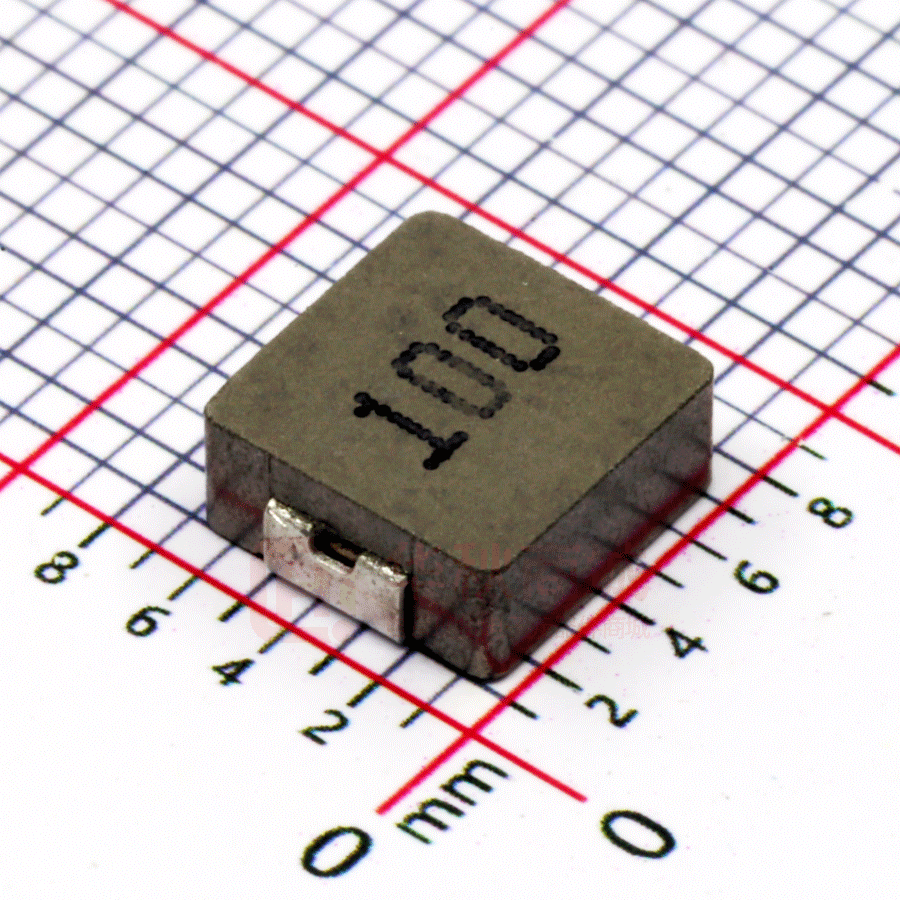

Molded d SMD Power P Inductorrs – MW WSA Serries Operating g Temp. : -40℃~+12 25℃ (Including selff-heating) FEATURE ES  Metal ma aterial for larg ge current and d low loss  Closed magnetic m circu uit design red duces leakag ge flux  Halogen free, RoSH compliant c APPLICA ATIONS  Server, desktop com mputer, notebo ook  Graphiccs, memory  Industria al equipmentt, telecomm base b station PRODUC CT IDENTIF FICATION MWS SA ① 04 410 □ ③ ② MWSA A 1R0 M T ④ ⑤ ⑥ ③ Typ pe ① - Molded SMD Powe er Inductor Fea ature Type □ Design C Code or Blank ④ ② External Dim mensions(L×W W×H) [mm] Nominal Inductance Ex xample Nominal Value 0410 4.2×4.4×1 1.0 R15 0.15μH 0412 4.2×4.4×1 1.2 1R0 1.0μH 0415 4.2×4.4×1 1.5 0402 4.2×4.4×2 2.0 0515 5.2×5.4×1 1.5 0518 5.2×5.4×1 1.8 0503 5.2×5.4×3 3.0 0618 6.6×7.1×1 1.8 0624 6.6×7.1×2 2.4 0603 6.6×7.1×3 3.0 1004 10.5×11.5× ×4.0 1204 12.8×13.5× ×4.0 1205 12.8×13.5× ×5.0 1206 12.8×13.5× ×6.5 Sunlo ord ⑤ Indu uctance Tolera ance M ⑥ ± ±20% Packing T Tape e & Reel Specificatio ons subject to change without notice. Please P check our website w for latest infformation. Revise ed 2017/04/15 Sunlord Indusstrial Park, Dafuyuan n Industrial Zone, Guanlan, Shenzhen, Ch hina 518110 Tel: 008 86-755-29832660 Fa ax: 0086-755-822690 029 E-Mail: sunlord@ @sunlordinc.com SHAPE AND A DIMEN NSIONS Fig.1 Re ecommende ed Land Patttern (Typ.) Unit:mm Series A B C Ma ax. D E I Typ. J Ty yp. H Typ. MWSA0410 4.2±0.3 3 4.4±0.3 35 1.0 0 0.8± ±0.3 2.0±0.3 1.5 2.2 2 2.5 MWSA0412 4.2±0.3 3 4.4±0.3 35 1.2 2 0.8± ±0.3 2.0±0.3 1.5 2.2 2 2.5 MWSA0415 4.2±0.3 3 4.4±0.3 35 1.5 5 0.8± ±0.3 2.0±0.3 1.5 2.2 2 2.5 MWSA040 02 4.2±0.3 3 4.4±0.3 35 2.0 0 0.8± ±0.3 2.0±0.3 1.5 2.2 2 2.5 MWSA0515 5.2±0.3 3 5.4±0..3 1.5 5 1.20± ±0.3 2.2 2±0.3 1.9 2.2 2 2.5 MWSA0518 5.2±0.3 3 5.4±0..3 1.8 8 1.20± ±0.3 2.2 2±0.3 1.9 2.2 2 2.5 MWSA050 03 5.2±0.3 3 5.4±0..3 3.0 0 1.20± ±0.3 2.2 2±0.3 1.9 2.2 2 2.5 MWSA0618 6.6±0.3 3 7.1±0..4 1.8 8 1.60± ±0.3 3.0±0.3 2.2 3.7 3.5 MWSA062 24 6.6±0.3 3 7.1±0..4 2.4 4 1.60± ±0.3 3.0±0.3 2.2 3.7 3.5 MWSA060 03 6.6±0.3 3 7.1±0..4 3.0 0 1.60± ±0.3 3.0±0.3 2.2 3.7 3.5 MWSA1004 4C 10.5±0..5 11.5±1.0 4.0 0 2.5± ±0.3 3.0±0.3 3.5 6.0 4.0 MWSA100 04 10.5±0..5 11.5±1.0 4.0 0 2.5± ±0.3 3.0±0.3 3.5 6.0 4.0 MWSA120 04 12.8±0..5 13.5±1.0 4.0 0 2.0± ±0.3 5.0±0.3 4.5 6.0 5.0 MWSA120 05 12.8±0..5 13.5±1.0 5.0 0 2.0± ±0.3 See Remarks R 4.5 6.0 5.0 MWSA120 06 12.8±0..5 13.5±1.0 6.5 5 2.0± ±0.3 3.8 85±0.3 4.5 6.0 5.0 SPECIFIC CATIONS MWSA0410 0 Series Part Number N Inductancce L Test Condition C U Units Syymbol MWSA04 410-100MT μH L 10.0 Hzz, V 100kk, 1.0V Part Number N Inductancce L Test Condition C U Units Syymbol MWSA04 412-R15MT MWSA04 412-R22MT MWSA04 412-R33MT MWSA04 412-R47MT MWSA04 412-R68MT MWSA04 412-1R0MT MWSA04 412-1R5MT MWSA04 412-2R2MT MWSA04 412-4R7MT μH L 0.15 0.22 0.33 0.47 0.68 1.0 1.5 2.2 4.7 Hzz, V 100kk, 1.0V 100kk, 1.0V 100kk, 1.0V 100kk, 1.0V 100kk, 1.0V 100kk, 1.0V 100kk, 1.0V 100kk, 1.0V 100kk, 1.0V Max. DC Resistance mΩ DCR 335 Typ. Satu uration Curre ent A Isa at 1.6 6 Typ. Heat Rating Current A Irms 1.5 Max. DC Resistance mΩ DCR 9.0 11.0 19.0 21.0 36.0 47.0 75.0 83.5 195.0 Typ. Satu uration Curre ent A Isa at 15.0 0 11.0 0 8.4 4 6.8 8 6.0 0 5.5 5 4.0 0 3.5 5 2.8 8 Typ. Heat Rating Current A Irms 7.5 7.0 6.5 6.0 4.7 4.5 3.25 2.75 1.8 MWSA0412 2 Series Sunlo ord Specificatio ons subject to change without notice. Please P check our website w for latest infformation. Revise ed 2017/04/15 Sunlord Indusstrial Park, Dafuyuan n Industrial Zone, Guanlan, Shenzhen, Ch hina 518110 Tel: 008 86-755-29832660 Fa ax: 0086-755-822690 029 E-Mail: sunlord@ @sunlordinc.com SPECIFICATIONS MWSA0415 Series Part Number Inductance L Test Condition Units Symbol MWSA0415-R36MT MWSA0415-R68MT MWSA0415-1R5MT μH L 0.36 0.68 1.50 Hz, V 100k, 1.0V 100k, 1.0V 100k, 1.0V Part Number Inductance L Test Condition Units Symbol MWSA0402-R10MT MWSA0402-R22MT MWSA0402-R33MT MWSA0402-R47MT MWSA0402-R56MT MWSA0402-R68MT MWSA0402-1R0MT MWSA0402-1R2MT MWSA0402-1R5MT MWSA0402-2R2MT MWSA0402-2R7MT MWSA0402-3R3MT MWSA0402-4R7MT MWSA0402-6R8MT MWSA0402-100MT MWSA0402-220MT μH L 0.10 0.22 0.33 0.47 0.56 0.68 1.0 1.2 1.5 2.2 2.7 3.3 4.7 6.8 10.0 22.0 Hz, V 100k, 1.0V 100k, 1.0V 100k, 1.0V 100k, 1.0V 100k, 1.0V 100k, 1.0V 100k, 1.0V 100k, 1.0V 100k, 1.0V 100k, 1.0V 100k, 1.0V 100k, 1.0V 100k, 1.0V 100k, 1.0V 100k, 1.0V 100k, 1.0V Part Number Inductance L Test Condition Units Symbol MWSA0515-R47MT MWSA0515-R68MT μH L 0.47 0.68 Hz, V 100k, 1.0V 100k, 1.0V Part Number Inductance L Test Condition Units Symbol MWSA0518-R47MT MWSA0518-R56MT MWSA0518-1R0MT MWSA0518-1R5MT MWSA0518-2R2MT MWSA0518-3R3MT MWSA0518-4R7MT MWSA0518-6R8MT MWSA0518-100MT μH L 0.47 0.56 1.0 1.5 2.2 3.3 4.7 6.8 10.0 Hz, V 100k, 1.0V 100k, 1.0V 100k, 1.0V 100k, 1.0V 100k, 1.0V 100k, 1.0V 100k, 1.0V 100k, 1.0V 100k, 1.0V Max. DC Resistance mΩ DCR 10.0 29.0 57.6 Typ. Saturation Current A Isat 9.5 6.0 5.2 Typ. Heat Rating Current A Irms 8.0 4.3 4.2 Max. DC Resistance mΩ DCR 4.0 6.6 11.0 14.0 16.0 18.0 27.0 27.0 46.0 58.0 70.0 87.0 105.0 175.0 282.0 363.0 Typ. Saturation Current A Isat 22.0 12.5 12.0 9.5 10.0 9.0 7.0 7.0 6.0 5.0 4.0 4.0 3.0 2.5 2.2 1.4 Typ. Heat Rating Current A Irms 13.0 9.5 10.0 7.5 7.0 7.0 6.0 6.0 5.0 4.5 4.5 3.3 2.8 2.4 1.6 1.2 Max. DC Resistance mΩ DCR 13.0 18.0 Typ. Saturation Current A Isat 9.0 6.0 Typ. Heat Rating Current A Irms 5.5 4.0 Max. DC Resistance mΩ DCR 9.0 10.0 17.0 26.0 35.0 58.0 85.0 120.0 155.0 Typ. Saturation Current A Isat 12.5 11.0 9.0 8.0 6.5 5.0 4.0 3.4 3.0 Typ. Heat Rating Current A Irms 10.5 9.5 8.0 7.5 5.0 4.5 3.5 2.8 2.5 MWSA0402 Series MWSA0515 Series MWSA0518 Series Sunlord Specifications subject to change without notice. Please check our website for latest information. Revised 2017/04/15 Sunlord Industrial Park, Dafuyuan Industrial Zone, Guanlan, Shenzhen, China 518110 Tel: 0086-755-29832660 Fax: 0086-755-82269029 E-Mail: sunlord@sunlordinc.com SPECIFICATIONS MWSA0503 Series Part Number Inductance L Test Condition Units Symbol MWSA0503-R10MT MWSA0503-R20MT MWSA0503-R33MT MWSA0503-R33MTB01 MWSA0503-R47MT MWSA0503-R68MT MWSA0503-1R0MT MWSA0503-1R2MT MWSA0503-1R5MT MWSA0503-2R2MT MWSA0503-3R3MT MWSA0503-4R7MT MWSA0503-6R8MT MWSA0503-8R2MT MWSA0503-100MT μH L 0.1 0.2 0.33 0.33 0.47 0.68 1.0 1.2 1.5 2.2 3.3 4.7 6.8 8.2 10.0 Hz, V 100k, 1.0V 100k, 1.0V 100k, 1.0V 100k, 1.0V 100k, 1.0V 100k, 1.0V 100k, 1.0V 100k, 1.0V 100k, 1.0V 100k, 1.0V 100k, 1.0V 100k, 1.0V 100k, 1.0V 100k, 1.0V 100k, 1.0V Part Number Inductance L Test Condition Units Symbol MWSA0618-R10MT MWSA0618-R22MT MWSA0618-R47MT MWSA0618-R68MT MWSA0618-1R0MT MWSA0618-1R5MT MWSA0618-2R2MT MWSA0618-3R3MT MWSA0618-4R7MT MWSA0618-6R8MT MWSA0618-100MT MWSA0618-220MT μH L 0.10 0.22 0.47 0.68 1.0 1.5 2.2 3.3 4.7 6.8 10 22 Hz, V 100k, 1.0V 100k, 1.0V 100k, 1.0V 100k, 1.0V 100k, 1.0V 100k, 1.0V 100k, 1.0V 100k, 1.0V 100k, 1.0V 100k, 1.0V 100k, 1.0V 100k, 1.0V Part Number Inductance L Test Condition Units Symbol MWSA0624-R22MT MWSA0624-R33MT MWSA0624-R47MT MWSA0624-R56MT MWSA0624-R68MT MWSA0624-1R0MT MWSA0624-1R5MT MWSA0624-2R2MT MWSA0624-3R3MT MWSA0624-4R7MT MWSA0624-6R8MT MWSA0624-100MT MWSA0624-150MT MWSA0624-220MT μH L 0.22 0.33 0.47 0.56 0.68 1.0 1.5 2.2 3.3 4.7 6.8 10.0 15.0 22.0 Hz, V 100k, 1.0V 100k, 1.0V 100k, 1.0V 100k, 1.0V 100k, 1.0V 100k, 1.0V 100k, 1.0V 100k, 1.0V 100k, 1.0V 100k, 1.0V 100k, 1.0V 100k, 1.0V 100k, 1.0V 100k, 1.0V Max. DC Resistance mΩ DCR 3.0 3.9 5.5 5.3 8.5 12.0 14.0 16.0 25.0 29.0 38.0 60.0 90.0 110.0 125.0 Typ. Saturation Current A Isat 33.0 20.0 18.0 24.0 15.0 11.5 11.0 11.0 9.0 7.5 6.0 5.0 4.0 3.7 3.5 Typ. Heat Rating Current A Irms 25.0 14.0 14.0 13.7 11.0 9.0 8.5 8.5 8.2 7.0 5.5 4.5 3.5 3.3 3.2 Max. DC Resistance mΩ DCR 2.3 3.5 8.4 12.0 16.0 26.0 35.0 50.0 62.0 110.0 155.0 350.0 Typ. Saturation Current A Isat 38.0 24.0 18.0 17.0 14.0 12.0 8.0 6.5 5.0 4.5 4.0 2.3 Typ. Heat Rating Current A Irms 25.0 22.0 11.5 9.5 8.5 8.0 7.0 4.5 4.0 3.0 2.3 1.8 Max. DC Resistance mΩ DCR 3.0 4.1 5.1 6.5 7.0 13.5 20.0 28.0 39.0 50.0 70.0 101.0 160.0 230.0 Typ. Saturation Current A Isat 34.0 24.5 22.0 17.0 16.0 16.0 15.0 14.0 13.0 7.5 6.0 4.0 3.3 2.5 Typ. Heat Rating Current A Irms 21.0 18.0 15.0 13.0 12.0 9.0 9.0 7.0 5.5 5.0 4.0 3.1 2.5 2.0 MWSA0618 Series MWSA0624 Series Sunlord Specifications subject to change without notice. Please check our website for latest information. Revised 2017/04/15 Sunlord Industrial Park, Dafuyuan Industrial Zone, Guanlan, Shenzhen, China 518110 Tel: 0086-755-29832660 Fax: 0086-755-82269029 E-Mail: sunlord@sunlordinc.com SPECIFICATIONS MWSA0603 Series Part Number Inductance L Test Condition Units Symbol MWSA0603-R10MT MWSA0603-R15MT MWSA0603-R20MT MWSA0603-R22MT MWSA0603-R24MT MWSA0603-R33MT MWSA0603-R47MT MWSA0603-R56MT MWSA0603-R68MT MWSA0603-R82MT MWSA0603-1R0MT MWSA0603-1R2MT MWSA0603-1R5MT MWSA0603-2R2MT MWSA0603-2R5MT MWSA0603-3R3MT MWSA0603-4R7MT MWSA0603-6R8MT MWSA0603-8R2MT MWSA0603-100MT MWSA0603-150MT MWSA0603-220MT MWSA0603-330MT μH L 0.10 0.15 0.20 0.22 0.24 0.33 0.47 0.56 0.68 0.82 1.0 1.2 1.5 2.2 2.5 3.3 4.7 6.8 8.2 10 15 22 33 Hz, V 100k, 1.0V 100k, 1.0V 100k, 1.0V 100k, 1.0V 100k, 1.0V 100k, 1.0V 100k, 1.0V 100k, 1.0V 100k, 1.0V 100k, 1.0V 100k, 1.0V 100k, 1.0V 100k, 1.0V 100k, 1.0V 100k, 1.0V 100k, 1.0V 100k, 1.0V 100k, 1.0V 100k, 1.0V 100k, 1.0V 100k, 1.0V 100k, 1.0V 100k, 1.0V Part Number Inductance L Test Condition Units Symbol MWSA1004C-R15MT MWSA1004C-R19MT MWSA1004C-R22MT MWSA1004C-R24MT MWSA1004C-R30MT MWSA1004C-R36MT MWSA1004C-R47MT MWSA1004C-R56MT MWSA1004C-R68MT MWSA1004C-R78MT MWSA1004C-R80MT MWSA1004C-1R0MT MWSA1004C-1R5MT MWSA1004C-1R8MT MWSA1004C-2R0MT MWSA1004C-2R2MT MWSA1004-2R2MT MWSA1004C-3R3MT MWSA1004C-4R7MT MWSA1004C-6R8MT MWSA1004C-8R2MT MWSA1004C-100MT MWSA1004C-150MT μH L 0.15 0.19 0.22 0.24 0.30 0.36 0.47 0.56 0.68 0.78 0.80 1.0 1.5 1.8 2.0 2.2 2.2 3.3 4.7 6.8 8.2 10 15 Hz, V 100k, 1.0V 100k, 1.0V 100k, 1.0V 100k, 1.0V 100k, 1.0V 100k, 1.0V 100k, 1.0V 100k, 1.0V 100k, 1.0V 100k, 1.0V 100k, 1.0V 100k, 1.0V 100k, 1.0V 100k, 1.0V 100k, 1.0V 100k, 1.0V 100k, 1.0V 100k, 1.0V 100k, 1.0V 100k, 1.0V 100k, 1.0V 100k, 1.0V 100k, 1.0V Max. DC Resistance mΩ DCR 1.7 2.5 3.0 3.0 3.1 3.5 4.1 4.5 5.3 6.0 7.4 12.0 12.1 15.0 22.0 22.0 33.0 48.0 60.0 67.0 115.0 200.0 310.0 Typ. Saturation Current A Isat 60.0 52.0 41.0 34.0 31.0 26.0 21.0 19.0 18.0 17.0 16.0 20.0 14.0 13.0 14.0 10.5 6.5 6.3 6.0 5.5 4.5 3.0 2.5 Typ. Heat Rating Current A Irms 32.5 26.0 24.0 24.0 23.0 21.0 18.0 16.5 16.0 14.0 12.0 10.0 12.0 9.5 7.0 8.5 6.0 5.0 5.0 4.5 3.0 2.3 2.0 Max. DC Resistance mΩ DCR 0.65 0.8 1.0 1.05 1.1 1.2 1.7 1.8 2.4 2.6 2.7 3.3 4.2 5.0 5.8 7.0 6.3 11.8 20.0 25.0 27.0 30.0 45.0 Typ. Saturation Current A Isat 75.0 46.0 60.0 44.0 50.0 45.0 40.0 33.0 30.0 20.0 29.0 28.0 24.0 16.0 14.0 16.5 13.0 16.0 13.0 12.0 9.0 8.5 7.0 Typ. Heat Rating Current A Irms 45.0 40.0 35.0 33.0 35.0 30.0 30.0 25.0 23.0 22.0 23.0 19.0 16.0 17.0 16.0 12.0 13.0 11.0 9.0 8.5 8.0 7.8 6.25 MWSA1004C Series Sunlord Specifications subject to change without notice. Please check our website for latest information. Revised 2017/04/15 Sunlord Industrial Park, Dafuyuan Industrial Zone, Guanlan, Shenzhen, China 518110 Tel: 0086-755-29832660 Fax: 0086-755-82269029 E-Mail: sunlord@sunlordinc.com SPECIFICATIONS MWSA1004C Series Part Number Inductance L Test Condition Units Symbol MWSA1004C-220MT MWSA1004C-330MT MWSA1004C-470MT MWSA1004C-680MT MWSA1004C-101MT μH L 22 33 47 68 100 Hz, V 100k, 1.0V 100k, 1.0V 100k, 1.0V 100k, 1.0V 100k, 1.0V Part Number Inductance L Test Condition Units Symbol MWSA1004-2R2MT μH L 2.2 Hz, V 100k, 1.0V Part Number Inductance L Test Condition Units Symbol MWSA1204-R10MT MWSA1204-R15MT MWSA1204-R22MT MWSA1204-R33MT MWSA1204-R47MT MWSA1204-R60MT MWSA1204-R68MT MWSA1204-R82MT MWSA1204-1R0MT MWSA1204-1R5MT MWSA1204-1R8MT MWSA1204-2R2MT MWSA1204-3R3MT MWSA1204-4R7MT MWSA1204-5R6MT MWSA1204-6R8MT MWSA1204-8R2MT MWSA1204-100MT μH L 0.10 0.15 0.22 0.33 0.47 0.60 0.68 0.82 1.0 1.5 1.8 2.2 3.3 4.7 5.6 6.8 8.2 10 Hz, V 100k, 1.0V 100k, 1.0V 100k, 1.0V 100k, 1.0V 100k, 1.0V 100k, 1.0V 100k, 1.0V 100k, 1.0V 100k, 1.0V 100k, 1.0V 100k, 1.0V 100k, 1.0V 100k, 1.0V 100k, 1.0V 100k, 1.0V 100k, 1.0V 100k, 1.0V 100k, 1.0V Part Number Inductance L Test Condition Units Symbol MWSA1205-R10MT MWSA1205-R22MT MWSA1205-R33MT MWSA1205-R36MT MWSA1205-R47MT MWSA1205-R50MT MWSA1205-R56MT MWSA1205-R68MT MWSA1205-R82MT MWSA1205-1R0MT MWSA1205-1R2MT μH L 0.10 0.22 0.33 0.36 0.47 0.50 0.56 0.68 0.82 1.0 1.2 Hz, V 100k, 1.0V 100k, 1.0V 100k, 1.0V 100k, 1.0V 100k, 1.0V 100k, 1.0V 100k, 1.0V 100k, 1.0V 100k, 1.0V 100k, 1.0V 100k, 1.0V Max. DC Resistance mΩ DCR 66.0 92.0 145.0 195.0 270.0 Typ. Saturation Current A Isat 5.5 4.8 3.5 3.0 2.25 Typ. Heat Rating Current A Irms 5.0 4.4 3.3 2.5 2.0 Max. DC Resistance mΩ DCR 6.3 Typ. Saturation Current A Isat 13.0 Typ. Heat Rating Current A Irms 13.0 Max. DC Resistance mΩ DCR 0.96 1.2 1.3 1.5 2.0 2.2 2.5 3.0 3.5 5.5 7.0 8.0 12.0 15.0 18.0 22.0 28.0 34.0 Typ. Saturation Current A Isat 84.0 75.0 65.0 62.0 55.0 51.0 49.0 44.0 40.0 35.0 30.0 29.0 27.0 24.0 19.0 18.0 16.0 14.0 Typ. Heat Rating Current A Irms 43.0 41.0 38.5 36.5 32.0 29.0 28.0 25.0 24.0 19.0 16.5 16.0 12.0 10.0 9.5 9.0 8.5 7.0 Max. DC Resistance mΩ DCR 0.6 0.8 1.1 0.85 1.3 1.15 1.5 1.55 1.67 2.2 3.5 Typ. Saturation Current A Isat 118.0 110.0 60.0 50.0 48.0 48.0 47.0 46.0 40.0 35.0 34.0 Typ. Heat Rating Current A Irms 55.0 51.0 42.0 42.0 38.0 38.0 36.0 33.0 30.0 26.0 25.0 MWSA1004 Series MWSA1204 Series MWSA1205 Series Sunlord Specifications subject to change without notice. Please check our website for latest information. Revised 2017/04/15 Sunlord Industrial Park, Dafuyuan Industrial Zone, Guanlan, Shenzhen, China 518110 Tel: 0086-755-29832660 Fax: 0086-755-82269029 E-Mail: sunlord@sunlordinc.com SPECIFICATIONS MWSA1205 Series Part Number Inductance L Test Condition Units Symbol MWSA1205-1R5MT MWSA1205-1R8MT MWSA1205-2R2MT MWSA1205-3R3MT MWSA1205-4R7MT MWSA1205-5R6MT MWSA1205-6R8MT MWSA1205-7R8MT MWSA1205-8R2MT MWSA1205-100MT MWSA1205-150MT MWSA1205-220MT MWSA1205-330MT MWSA1205-470MT μH L 1.5 1.8 2.2 3.3 4.7 5.6 6.8 7.8 8.2 10 15 22 33 47 Hz, V 100k, 1.0V 100k, 1.0V 100k, 1.0V 100k, 1.0V 100k, 1.0V 100k, 1.0V 100k, 1.0V 100k, 1.0V 100k, 1.0V 100k, 1.0V 100k, 1.0V 100k, 1.0V 100k, 1.0V 100k, 1.0V Part Number Inductance L Test Condition Units Symbol MWSA1206-R10MT MWSA1206-R15MT MWSA1206-R22MT MWSA1206-R30MT MWSA1206-R33MT MWSA1206-R40MT MWSA1206-R47MT MWSA1206-R56MT MWSA1206-R68MT MWSA1206-R82MT MWSA1206-1R0MT MWSA1206-1R2MT MWSA1206-1R5MT MWSA1206-1R8MT MWSA1206-2R2MT MWSA1206-3R3MT MWSA1206-4R7MT MWSA1206-5R6MT MWSA1206-6R8MT MWSA1206-8R2MT MWSA1206-100MT MWSA1206-120MT MWSA1206-150MT MWSA1206-180MT MWSA1206-220MT MWSA1206-270MT MWSA1206-330MT MWSA1206-470MT MWSA1206-680MT MWSA1206-101MT MWSA1206-121MT MWSA1206-151MT μH L 0.10 0.15 0.22 0.30 0.33 0.40 0.47 0.56 0.68 0.82 1.0 1.2 1.5 1.8 2.2 3.3 4.7 5.6 6.8 8.2 10 12 15 18 22 27 33 47 68 100 120 150 Hz, V 100k, 1.0V 100k, 1.0V 100k, 1.0V 100k, 1.0V 100k, 1.0V 100k, 1.0V 100k, 1.0V 100k, 1.0V 100k, 1.0V 100k, 1.0V 100k, 1.0V 100k, 1.0V 100k, 1.0V 100k, 1.0V 100k, 1.0V 100k, 1.0V 100k, 1.0V 100k, 1.0V 100k, 1.0V 100k, 1.0V 100k, 1.0V 100k, 1.0V 100k, 1.0V 100k, 1.0V 100k, 1.0V 100k, 1.0V 100k, 1.0V 100k, 1.0V 100k, 1.0V 100k, 1.0V 100k, 1.0V 100k, 1.0V Max. DC Resistance mΩ DCR 3.2 4.9 5.5 7.0 9.0 16.5 18.0 20.5 22.5 22.0 30.0 58.0 84.0 130.0 Typ. Saturation Current A Isat 33.0 30.0 24.0 22.0 21.0 20.0 19.0 18.0 16.0 12.0 10.0 6.5 6.0 5.0 Typ. Heat Rating Current A Irms 23.0 19.0 15.0 14.0 13.0 11.5 12.0 10.0 9.5 9.0 8.0 4.5 3.5 3.0 Max. DC Resistance mΩ DCR 0.5 0.6 0.7 0.8 0.9 1.0 1.2 1.4 1.6 1.9 2.0 2.5 3.0 3.2 4.2 6.8 11.2 13.2 14.0 16.0 20.7 23.0 29.0 35.0 39.5 56.0 75.0 90.0 140.0 200.0 235.0 350.0 Typ. Saturation Current A Isat 120.0 118.0 112.0 72.0 65.0 64.0 63.0 62.0 60.0 50.0 49.0 48.0 45.0 41.0 40.0 35.0 30.0 27.0 16.5 13.5 12.5 10.0 9.0 8.0 7.5 6.5 6.0 5.5 4.5 3.5 3.2 2.7 Typ. Heat Rating Current A Irms 60.0 55.0 53.0 48.0 46.0 44.0 41.0 37.0 35.0 33.0 32.0 30.0 27.0 24.0 22.0 18.0 14.0 13.5 11.5 11.0 10.0 7.0 6.0 5.0 5.0 4.0 4.0 3.5 3.0 2.5 2.3 2.0 MWSA1206 Series Sunlord Specifications subject to change without notice. Please check our website for latest information. Revised 2017/04/15 Sunlord Industrial Park, Dafuyuan Industrial Zone, Guanlan, Shenzhen, China 518110 Tel: 0086-755-29832660 Fax: 0086-755-82269029 E-Mail: sunlord@sunlordinc.com Sunlord Specifications subject to change without notice. Please check our website for latest information. Revised 2017/04/15 Sunlord Industrial Park, Dafuyuan Industrial Zone, Guanlan, Shenzhen, China 518110 Tel: 0086-755-29832660 Fax: 0086-755-82269029 E-Mail: sunlord@sunlordinc.com

1. 物料型号:MWSA系列,包括不同的尺寸和电感值,例如MWSA0410、MWSA0412、MWSA0415等。
2. 器件简介:MWSA系列是贴片功率电感器,采用金属材料,具有大电流和低损耗的特点,闭合的磁路设计减少了漏磁通,且无卤素,符合RoHS标准。
3. 引脚分配:文档中提供了推荐的焊盘图案,但具体的引脚分配未详细说明。
4. 参数特性: - 工作温度范围:-40℃至+125℃(包括自热)。 - 电感公差:例如'M'表示±20%。
5. 功能详解:适用于服务器、台式电脑、笔记本电脑、图形卡、内存、工业设备、电信基站等。
6. 应用信息:适用于多种电子设备,尤其是需要高电流和低损耗的场合。
7. 封装信息:提供了不同尺寸的电感器的外部尺寸,例如0410系列的尺寸为4.2x4.4x1.0mm。
8. 规格参数:详细列出了不同型号的电感器的电感值、测试条件、最大直流电阻、典型饱和电流和典型热额定电流。
