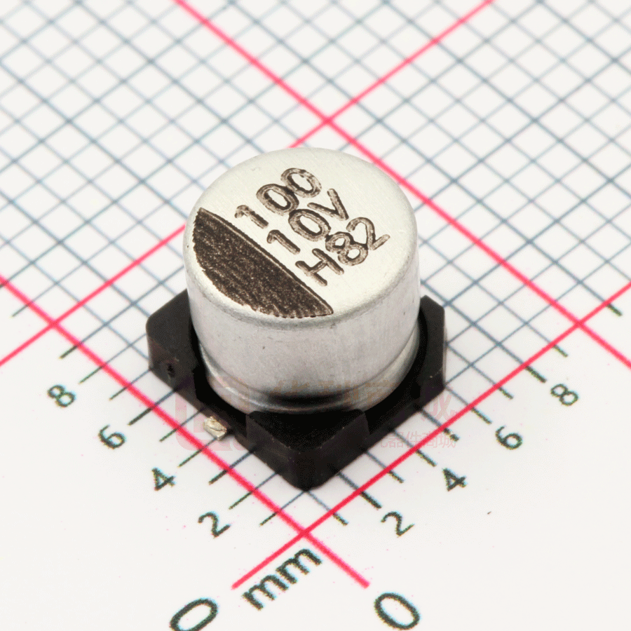

    贴片铝电解电容 SMD,D6.3xL7.7mm 100µF ±20% 16V 5000Hrs@105℃
MV101M016E077ETR 数据手册
  Aluminum Electrolytic Capacitor    MV series  Part number  Capacitance  Voltage  Surge Voltage  Capacitance  Tolerance (@120Hz, +20°C) Ripple current (max, @120Hz,+105°C)  Dissipation factor (tanδ @120Hz, +20°C)  Leakage Current (max, @ +20°C)*  Size  Operating temperature  Endurance  MV101M016E077ETR 100 16 18 ±20 81 22 16 6.3x7.7 ‐40 to 105 5000 µF VDC VDC % mA % µA mm °C h                            *L.C.  I≦ 0.01CV or 3µA (C = CAP., V = W.V.)  After 2 minutes, whichever is greater measured with rated working voltage applied.  Test conditions  Duration time  Applied voltage  After test requirements (+20°C):  Capacitance  change  Dissipation factor change  Leakage current  comment    Endurance  Shelf Life  5000h @ 105°C  1000h @ 105°C  Rated DC working voltage,IR  None      ≤ ±30% of initial measured value  ≤ 300% of the initial specified value  ≤ the initial specified value    Pre‐treatment for measurements shall  be conducted after application of DC  working voltage for 30 min.      L max  D  L  A  B  C  W  P±0.2  6.3  7.7  6.6  6.6  7.2  0.5~0.8  2.2  Series  1_2  Cap  3_4_5  Tol.  6  Voltage  7_8_9  MV  101  M  016        =100µF    …  =±20%      =16V      Case D  10  Case L  11_12_13 Type  14_15_16  Cust.  17_18_19_20  E  077  ETR    =6.3mm      =7.7mm      =tape and reel      no request      Specification and description for the component(s) are subject to change without notice. For packaging, handling, precautions and warning information, please visit our website: www.capxongroup.com CapXon       V.ED‐20171110
