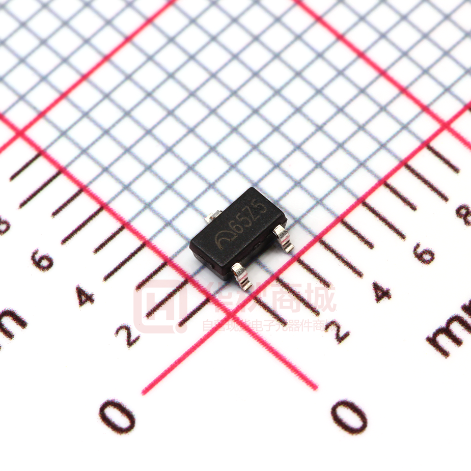

    线性稳压器/LDO 输入6V 输出3V 300mA
ME6206A30M3G 数据手册
ME6206 Low power consumption, Low ESR Cap.Compatible ME6206 Series General Description Features ME6206 series are highly precise, low power consumption, high voltage, positive  voltage Maximum Output Current: 300mA (VIN=4.3V,VOUT=3.3V) regulators manufactured using CMOS and laser  Dropout Voltage: 200mV@ IOUT =100mA trimming technologies .The series provides large  Input Voltage Range: up to 6.0V currents with a significantly small dropout voltage.  Highly Accuracy: ±2% The series is compatible with low ESR ceramic  Low Power Consumption: 8uA(TYP.) capacitors .The current limiter’s foldback circuit also  Excellent Input Stability  Be available to regulator and reference operates as a short protect for the output current voltage limiter and the output pin. Package Typical Application  Mobile phones  communication equipment  Portable games  Cameras, Video systems  Reference voltage sources  Battery powered equipment ● 3-pin SOT89-3,SOT23-3,TO92,SOT23 Typical Application Circuit V20 www.microne.com.cn Page 1 of 16 ME6206 Selection Guide ME 6206X X X X X G Environment mark Package: M3--SOT23-3 X--SOT23 P--SOT89-3 T--TO92 Output Voltage Function Product Type Product Series Microne product series Output voltage Supply Current Package ME6206A15PG 1.5V 8uA SOT89-3 ME6206A15M3G 1.5V 8uA SOT23-3 ME6206A15XG 1.5V 8uA SOT23 ME6206A33TG 3.3V 8uA TO92 ME6206A33M3G 3.3V 8uA SOT23-3 ME6206K33M3G 3.3V 180uA SOT23-3 NOTE: At present ,there are ten kinds of voltage value: 1.5V、1.8V、2.0V、2.1V、2.5V、2.7V、2.8V、3.0V、3.3V、3.6V。 If you need other voltage and package, please contact our sales staff。 V20 www.microne.com.cn Page 2 of 16 ME6206 Pin Configuration 3 1 2 3 1 2 1 SOT23/SOT23-3 2 3 SOT89-3 TO92 Pin Assignment ME6206Axx/ ME6206Kxx Pin M3 P P1 X T SOT23-3 SOT89-3 SOT89-3 SOT23 TO-92 1 1 2 1 2 3 1 3 2 3 Name Function 1 VSS Ground 2 3 VOUT Output 3 2 VIN Input The difference of printing on the chip between P and P1 is : P: , P1: Block Diagram V20 www.microne.com.cn Page 3 of 16 ME6206 Absolute Maximum Ratings Parameter Symbol Description Units Input Voltage VIN 6.5 V Output Current Iout 500 mA Output Voltage Vout Vss-0.3 ~ Vout+0.3 V SOT23-3 Pd 300 mW SOT89-3 Pd 500 mW SOT23 Pd 300 mW TO-92 Pd 500 mW Operating Ambient Temperature TOpr -25 ~ +125 ℃ Storage Temperature Tstg -40 ~ +125 ℃ Power Dissipation ME6206A15 O (VIN=Vout+1V,Cin=Cout=1uF,Ta=25 C Unless otherwise stated) PARAMETER SYMBOL CONDITION MIX TYP MAX UNIT Output Voltage VOUT(E) (Note 2) IOUT=10mA, VIN=Vout+1V X 0.98 VOUT(T) (Note 1) X 1.02 V Input Voltage VIN 6 V Maximum Output Current IOUT (max) VIN=Vout+1V 100 Load Regulation ∆VOUT VIN=Vout+1V, 1mA≤IOUT≤80mA 10 20 mV Dropout Voltage (Note 3) Vdif1 IOUT =20mA 180 200 mV Vdif2 IOUT =50mA 360 380 mV Supply Current ISS VIN=Vout+1V 7 15 μA Line Regulations ∆VOUT ∆VIN •VOUT IOUT =10mA Vout+1V ≤VIN≤5V 0.1 0.2 %/V Power Supply Ripple Rejection Ratio PSRR Vin= [Vout+1]V +1Vp-pAC IOUT =10mA,f=1kHz 45 47 dB Short Circuit Current Ishort Vin=Vout(T)+1.5V Vout=Vss 20 50 mA Over Current Protection I limit V20 mA 300 www.microne.com.cn mA Page 4 of 16 ME6206 ME6206A18 (VIN=Vout+1V,Cin=Cout=1uF,Ta=25OC Unless otherwise stated) PARAMETER SYMBOL CONDITION MIX TYP MAX UNIT Output Voltage VOUT(E) (Note 2) IOUT=10mA, VIN=Vout+1V X 0.98 VOUT(T) (Note 1) X 1.02 V Input Voltage VIN 6 V Maximum Output Current IOUT (max) VIN=Vout+1V 120 Load Regulation ∆VOUT VIN=Vout+1V, 1mA≤IOUT≤80mA 12 27 mV Dropout Voltage (Note 3) Vdif1 IOUT =20mA 180 200 mV Vdif2 IOUT =50mA 360 380 mV Supply Current ISS VIN=Vout+1V 7 15 μA IOUT =10mA Vout+1V ≤VIN≤5V 0.1 0.2 %/V 45 47 dB 25 50 mA ∆VOUT ∆VIN •VOUT Line Regulations Power Supply Ripple Rejection Ratio PSRR Vin= [Vout+1]V +1Vp-pAC IOUT =10mA,f=1kHz Short Circuit Current Ishort Vin=Vout(T)+1.5V Vout=Vss Over Current Protection I limit mA 400 mA ME6206A21 O (VIN=Vout+1V,Cin=Cout=1uF,Ta=25 C Unless otherwise stated) PARAMETER SYMBOL CONDITION MIX TYP MAX UNIT Output Voltage VOUT(E) (Note 2) IOUT=10mA, VIN=Vout+1V X 0.98 VOUT(T) (Note 1) X 1.02 V Input Voltage VIN 6 V Maximum Output Current IOUT (max) VIN=Vout+1V 200 Load Regulation ∆VOUT VIN=Vout+1V, 1mA≤IOUT≤80mA 10 20 mV Dropout Voltage (Note 3) Vdif1 IOUT =50mA 100 130 mV Vdif2 IOUT =100mA 200 230 mV Supply Current ISS VIN=Vout+1V 7 15 μA Line Regulations ∆VOUT ∆VIN •VOUT IOUT =10mA Vout+1V ≤VIN≤5V 0.1 0.2 %/V Power Supply Ripple Rejection Ratio PSRR Vin= [Vout+1]V +1Vp-pAC IOUT =10mA,f=1kHz 45 47 dB Short Circuit Current Ishort Vin=Vout(T)+1.5V Vout=Vss 20 50 mA Over Current Protection I limit V20 mA 450 www.microne.com.cn mA Page 5 of 16 ME6206 ME6206A28 (VIN=Vout+1V,Cin=Cout=1uF,Ta=25OC Unless otherwise stated) PARAMETER SYMBOL CONDITION MIX TYP MAX UNIT Output Voltage VOUT(E) (Note 2) IOUT=10mA, VIN=Vout+1V X 0.98 VOUT(T) (Note 1) X 1.02 V Input Voltage VIN 6 V Maximum Output Current IOUT (max) VIN=Vout+1V 300 Load Regulation ∆VOUT VIN=Vout+1V 1mA≤IOUT≤100mA 14 28 mV Dropout Voltage (Note 3) Vdif1 IOUT =80mA 180 200 mV Vdif2 IOUT =200mA 380 400 mV Supply Current ISS VIN=Vout+1V 8 15 μA IOUT =10mA Vout+1V ≤VIN≤6V 0.03 0.2 %/V 50 52 dB 30 60 mA Line Regulations ∆VOUT ∆VIN •VOUT Power Supply Ripple Rejection Ratio PSRR Vin= [Vout+1]V +1Vp-pAC IOUT =10mA,f=1kHz Short Circuit Current I short Vin=Vout(T)+1.5V Vout=Vss Over Current Protection I limit mA 500 mA ME6206A30 O (VIN=Vout+1V,Cin=Cout=1uF,Ta=25 C Unless otherwise stated) PARAMETER SYMBOL CONDITION MIX TYP MAX UNIT Output Voltage VOUT(E) (Note 2) IOUT=10mA, VIN=Vout+1V X 0.98 VOUT(T) (Note 1) X 1.02 V Input Voltage VIN 6 V Maximum Output Current IOUT (max) VIN=Vout+1V 300 Load Regulation ∆VOUT VIN=Vout+1V 1mA≤IOUT≤100mA 14 Dropout Voltage (Note 3) Vdif1 IOUT =80mA 180 mV Vdif2 IOUT =200mA 380 mV Supply Current ISS VIN=Vout+1V 8 15 μA Line Regulations ∆VOUT ∆VIN •VOUT IOUT =10mA Vout+1V ≤VIN≤6V 0.03 0.2 %/V Power Supply Ripple Rejection Ratio PSRR Vin= [Vout+1]V +1Vp-pAC IOUT =10mA,f=1kHz 50 52 dB Short Circuit Current I short Vin=Vout(T)+1.5V Vout=Vss 30 60 mA Over Current Protection I limit V20 mA 28 500 www.microne.com.cn Page 6 of 16 mV mA ME6206 ME6206A33 (VIN=Vout+1V,Cin=Cout=1uF,Ta=25OC Unless otherwise stated) PARAMETER SYMBOL CONDITION MIX TYP MAX UNIT Output Voltage VOUT(E) (Note 2) IOUT=10mA, VIN=Vout+1V X 0.98 VOUT(T) (Note 1) X 1.02 V Input Voltage VIN 6 V Maximum Output Current IOUT (max) VIN=Vout+1V 300 Load Regulation ∆VOUT VIN=Vout+1V 1mA≤IOUT≤100mA 14 28 mV Dropout Voltage (Note 3) Vdif1 IOUT =80mA 180 200 mV Vdif2 IOUT =200mA 380 400 mV Supply Current ISS VIN=Vout+1V 9 15 μA Line Regulations ∆VOUT ∆VIN •VOUT IOUT =10mA Vout+1V ≤VIN≤6V 0.03 0.2 %/V Power Supply Ripple Rejection Ratio PSRR Vin= [Vout+1]V +1Vp-pAC IOUT =10mA,f=1kHz 50 52 dB Short Circuit Current I short Vin=Vout(T)+1.5V Vout=Vss 30 60 mA Over Current Protection I limit mA 500 mA ME6206K33 (VIN=Vout+1V,Cin=Cout=1uF,Ta=25OC Unless otherwise stated) PARAMETER SYMBOL CONDITION MIX TYP MAX UNIT Output Voltage VOUT(E) (Note 2) IOUT=10mA, VIN=Vout+1V X 0.98 VOUT(T) (Note 1) X 1.02 V Input Voltage VIN 6 V Maximum Output Current IOUT (max) VIN=Vout+1V 300 Load Regulation ∆VOUT VIN=Vout+1V 1mA≤IOUT≤100mA 14 28 mV Dropout Voltage (Note 3) Vdif1 IOUT =80mA 180 200 mV Vdif2 IOUT =200mA 380 400 mV Supply Current ISS VIN=Vout+1V 180 500 μA Line Regulations ∆VOUT ∆VIN •VOUT IOUT =10mA Vout+1V ≤VIN≤6V 0.03 0.2 %/V Power Supply Ripple Rejection Ratio PSRR Vin= [Vout+1]V +1Vp-pAC IOUT =10mA,f=1kHz 50 52 dB Short Circuit Current I short Vin=Vout(T)+1.5V Vout=Vss 30 60 mA Over Current Protection I limit V20 mA 500 www.microne.com.cn Page 7 of 16 mA ME6206 Note : 1. VOUT (T) :Specified Output Voltage 2.VOUT (E) :Effective Output Voltage ( le. The output voltage when “VOUT (T)+1.0V”is provided at the Vin pin while maintaining a certain Iout value.) 3.Vdif :VIN1 –VOUT (E)’ VIN1 :The input voltage when VOUT(E)’ appears as input voltage is gradually decreased. VOUT (E)’=A voltage equal to 98% of the output voltage whenever an amply stabilized Iout {VOUT (T)+1.0V} is input. Type Characteristics (1) Output Current VS. Output Voltage(VIN=Vout+1, Ta = 25 °C) ME6206A18PG ME6206A21M3G Output current VS.Output voltage 2 1.9 1.8 1.7 1.6 Output voltage(V) Output Voltage(V) Output CurrentVS.Output Voltage 1.5 1.4 1.3 1.2 1.1 1 0 50 100 150 200 250 2.40 2.30 2.20 2.10 2.00 1.90 1.80 0 300 50 100 200 250 ME6206A28PG ME6206A30PG Output CurrentVS.Output Voltage Output CurrentVS.Output Voltage 4 3 Output Voltage ( V) 3.8 2.9 2.8 2.7 2.6 3.6 3.4 3.2 3 2.8 2.6 2.4 2.2 2.5 2 0 50 100 150 200 250 300 Output Current(mA) 0 50 100 150 200 Output Current(mA) ME6206A33PG Output CurrentVS.Output Voltage 4.3 4.1 Output Voltage ( V) 300 Output current(mA) Output Current(mA) Output Voltage(V) 150 3.9 3.7 3.5 3.3 3.1 2.9 2.7 2.5 2.3 0 50 100 150 200 250 300 Output Current(mA) V20 www.microne.com.cn Page 8 of 16 250 300 ME6206 (2)Input Voltage VS. Output Voltage(Ta = 25 °C) ME6206A18PG ME6206A21M3G Input voltage VS.Output voltage Input VoltageVS.Output Voltage 2 Output Voltage(V) 1.6 Output voltage(V) 1.8 1mA 1.4 1.2 1 10mA 0.8 0.6 100mA 0.4 0.2 0 0.5 1.5 2.5 3.5 4.5 5.5 2.4 2.1 1.8 1.5 1.2 0.9 0.6 0.3 0.0 1mA 10mA 100mA 0.5 6.5 1.5 2.5 Input Voltage(V) 4.5 5.5 6.5 5.5 6.5 Input voltage(V) ME6206A28PG ME6206A30PG Input VoltageVS.Output Voltage Input VoltageVS.Output Voltage 3.5 3.6 3 Output Voltage(V) 3.2 Output Voltage(V) 3.5 2.8 2.4 1mA 2 1.6 1.2 10mA 0.8 0.4 0.5 1.5 2.5 3.5 2 10mA 1.5 1 100mA 0.5 100mA 0 1mA 2.5 0 4.5 5.5 6.5 Input Voltage(V) 0.5 1.5 2.5 3.5 4.5 Input Voltage(V) ME6206A33PG Input VoltageVS.Output Voltage 4 Output Voltage(V) 3.6 3.2 2.8 1mA 2.4 2 10mA 1.6 1.2 0.8 0.4 100m A 0 0.5 1.5 2.5 3.5 4.5 5.5 6.5 Input Voltage(V) V20 www.microne.com.cn Page 9 of 16 ME6206 (3)Output Current VS. Dropout Voltage(VIN=Vout+1V,Ta = 25 °C) ME6206A18PG ME6206A21M3G Output voltage VS.Dropout voltage Output Current VS.Droput Voltage 600 Dropout voltage(mV) Droput Voltage(mV) 1000 900 800 700 600 500 400 300 200 100 0 500 400 300 200 100 0 0 50 100 150 200 250 0 50 100 150 Output voltage(V) Output Current(mA) ME6206A28PG 250 200 250 ME6206A30PG Output Current VS.Droput Voltage Output Current VS.Droput Voltage 450 450 400 400 350 350 Droput Voltage(mV) Droput Voltage(mV) 200 300 250 200 150 100 50 300 250 200 150 100 50 0 0 50 100 150 200 250 Output Current(mA) 0 0 50 100 150 Output Current(mA) ME6206A33PG Output Current VS.Droput Voltage 450 Droput Voltage(mV) 400 350 300 250 200 150 100 50 0 0 50 100 150 200 250 Output Current (mA) V20 www.microne.com.cn Page 10 of 16 ME6206 (4)Input Voltage VS. Supply Current(Ta = 25 °C) ME6206A18PG ME6206A21M3G Input Voltage VS.Supply Current 9 7 8 6 Supply Current(uA) Supply Current(uA) Input Voltage VS. Supply Current 7 6 5 4 3 2 5 4 3 2 1 1 0 0 0 0.5 1 1.5 2 2.5 3 3.5 4 4.5 5 5.5 6 6.5 0 0.5 1 1.5 2 2.5 Input Voltage(V) ME6206A28PG 4.5 5 5.5 6.5 Input Voltage VS. Supply Current 8 7 7 6 6 Supply Current(uA) 8 5 4 3 2 1 5 4 3 2 1 0 0.5 1 1.5 2 2.5 3 3.5 4 4.5 5 5.5 6 6.5 Input Voltage(V) 0 0.5 1 1.5 2 2.5 3 3.5 4 4.5 5 5.5 Input Voltage(V) ME6206A33PG Input Voltage VS. Supply Current 7 6 Supply Current(uA) 6 ME6206A30PG Input Voltage VS. Supply Current Supply Current(uA) 3 3.5 4 Input Voltage(V) 5 4 3 2 1 0 0.5 1 1.5 2 2.5 3 3.5 4 4.5 5 5.5 6 6.5 Input Voltage(V) V20 www.microne.com.cn Page 11 of 16 6 6.5 ME6206 Packaging Information ● SOT23-3 DIM A A1 A2 A3 b c D E E1 e L L1 θ c1 V20 Millimeters Min 1 0 0.9 0.6 0.25 0.1 2.8 2.6 1.5 Inches Max 1.5 0.15 1.3 0.7 0.5 0.25 3.1 3.1 1.8 Min 0.0394 0 0.0354 0.0236 0.0098 0.0039 0.1102 0.1023 0.0591 0.95(TYP) 0.25 0.0374(TYP) 0.6 0.0098 0.59(TYP) 0 Max 0.0591 0.0059 0.0512 0.0276 0.0197 0.0098 0.122 0.122 0.0709 0.0236 0.0232(TYP) 8° 0.2(TYP) www.microne.com.cn 0 8° 0.0079(TYP) Page 12 of 16 ME6206 ● SOT23 DIM A A1 A2 b c D e1 E E1 e L L1 θ c1 V20 Millimeters Min 0.9 0 0.9 0.28 0.07 2.8 1.8 1.2 2.25 Inches Max 1.15 0.14 1.05 0.52 0.23 3 2 1.4 2.55 Min 0.0354 0 0.0354 0.011 0.0028 0.1102 0.0709 0.0472 0.0886 0.95(TYP) 0.55(TYP) 0.25 0 Max 0.0453 0.0055 0.0413 0.0205 0.0091 0.1181 0.0787 0.0551 0.1004 0.0374(TYP) 0.0217(TYP) 0.55 8° 0.25(TYP) www.microne.com.cn 0.0098 0 0.0217 8° 0.0098(TYP) Page 13 of 16 ME6206 ● SOT89-3 DIM A b b1 c D D1 D2 e1 E E1 E2 e L θ V20 Millimeters Min 1.4 0.32 0.4 0.35 4.4 Inches Max 1.6 0.52 0.58 0.45 4.6 Min 0.0551 0.0126 0.0157 0.0138 0.1732 1.55(TYP) 1.75(TYP) 3(TYP) 2.3 3.94 0.061(TYP) 0.0689(TYP) 0.1181(TYP) 2.6 4.4 0.0906 0.1551 1.9(TYP) 1.5(TYP) 0.8 Max 0.063 0.0205 0.0228 0.01772 0.1811 0.1023 0.1732 0.0748(TYP) 0.0591(TYP) 1.2 45° www.microne.com.cn 0.0315 0.0472 45° Page 14 of 16 ME6206 ● TO92 DIM A A1 b c D D1 E e e1 L h Φ V20 Millimeters Min 3.3 1.1 0.38 0.36 4.3 3.43 4.3 Inches Max 3.7 1.4 0.55 0.51 4.7 一 4.7 Min 0.1299 0.0433 0.015 0.0142 0.1693 0.135 0.1693 1.27 2.44 14.1 0 一 Max 0.1457 0.0551 0.0217 0.0201 0.185 一 0.185 0.05 2.64 14.5 0.38 1.6 www.microne.com.cn 0.0961 0.5551 0 一 0.1039 0.5709 0.015 0.063 Page 15 of 16 ME6206      The information described herein is subject to change without notice. Nanjing Micro One Electronics Inc is not responsible for any problems caused by circuits or diagrams described herein whose related industrial properties, patents, or other rights belong to third parties. The application circuit examples explain typical applications of the products, and do not guarantee the success of any specific mass-production design. Use of the information described herein for other purposes and/or reproduction or copying without the express permission of Nanjing Micro One Electronics Inc is strictly prohibited. The products described herein cannot be used as part of any device or equipment affecting the human body, such as exercise equipment, medical equipment, security systems, gas equipment, or any apparatus installed in airplanes and other vehicles, without prior written permission of Nanjing Micro One Electronics Inc. Although Nanjing Micro One Electronics Inc exerts the greatest possible effort to ensure high quality and reliability, the failure or malfunction of semiconductor products may occur. The user of these products should therefore give thorough consideration to safety design, including redundancy, fire-prevention measures, and malfunction prevention, to prevent any accidents, fires, or community damage that may ensue. V20 www.microne.com.cn Page 16 of 16
