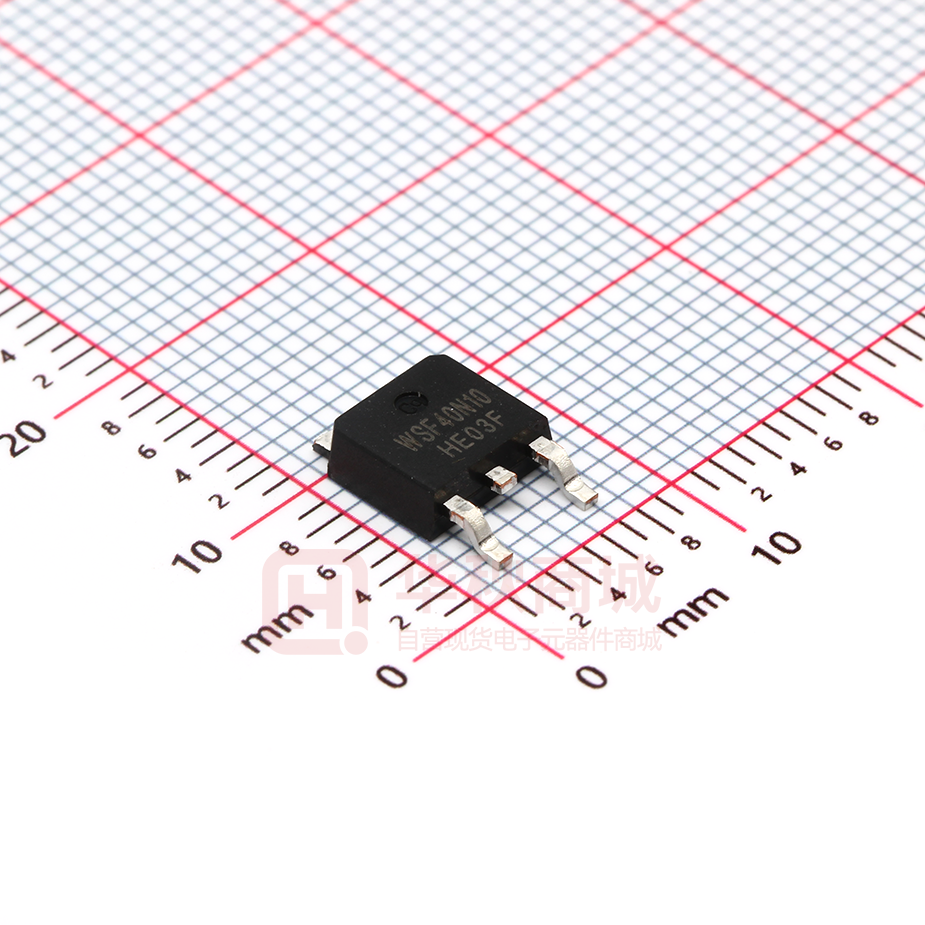

WSF40N10
N-Ch MOSFET
Product Summery
General Description
The WSF40N10 is the highest performance trench
N-Ch MOSFET with extreme high cell density ,
which provide excellent RDSON and gate charge
for most of the synchronous buck converter
applications .
