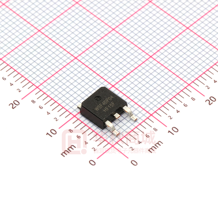

WSF40P04
P-Ch MOSFET
General Description
Product Summery
The WSF40P04 is the highest performance
trench P-Ch MOSFET with extreme high cell
density , which provide excellent RDSON and
gate charge for most of the synchronous
buck converter applications .
BVDSS
RDSON
ID
-40V
32mΩ
-20A
Applications
The WSF40P04 meet the RoHS and Green
Product requirement 100% EAS guaranteed
with full function reliability approved.
z High Frequency Point-of-Load Synchronous
Buck Converter for MB/NB/UMPC/VGA
z Networking DC-DC Power System
Features
z Load Switch
z Advanced high cell density Trench technology
TO-252-3L(D-PAK) Pin Configuration
z Super Low Gate Charge
z Excellent CdV/dt effect decline
z 100% EAS Guaranteed
z Green Device Available
