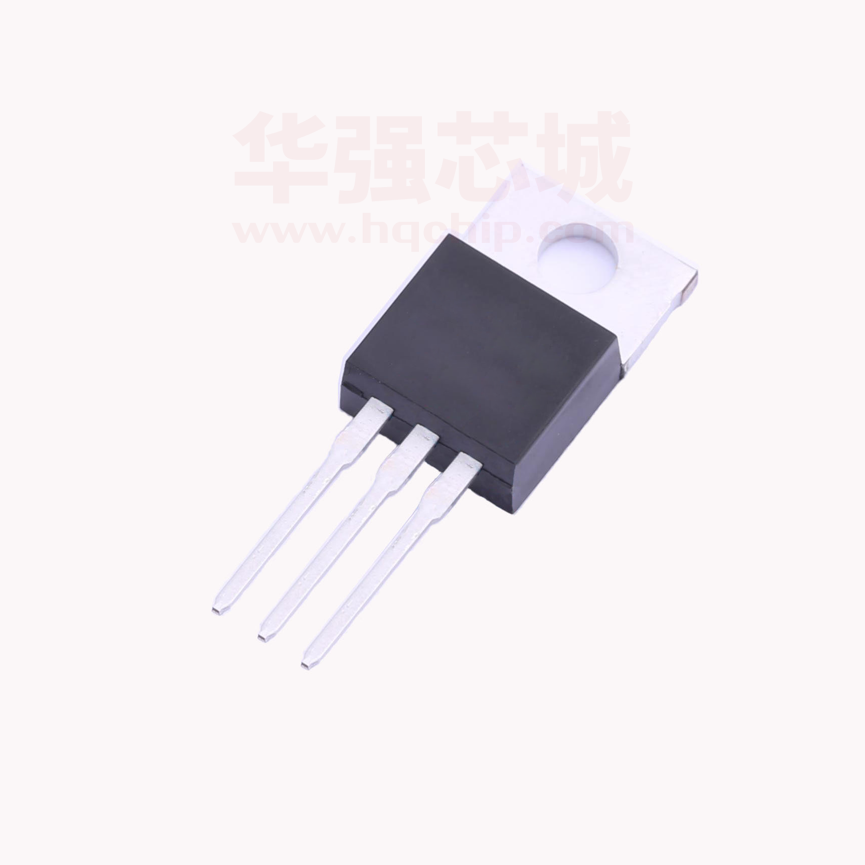

    MOS管 N-Channel VDS=60V VGS=±20V ID=50A RDS(ON)=20mΩ@10V TO220F
WSR50N06 数据手册
WSR50N06 N-Ch MOSFET General Description Product Summery The WSR50N06 is the highest performance trench N-Ch MOSFET with extreme high cell density , which provide excellent RDSON and gate charge for most of the synchronous buck converter applications . BVDSS RDSON ID 60V 16mΩ 50A Applications The WSR50N06 meet the RoHS and Green Product requirement , 100% EAS guaranteed with full function reliability approved. z High Frequency Point-of-Load Synchronous Buck Converter for MB/NB/UMPC/VGA z Networking DC-DC Power System z LCD/LED back light Features TO-220F Pin Configuration z Advanced high cell density Trench technology z Super Low Gate Charge z Excellent CdV/dt effect decline z 100% EAS Guaranteed z Green Device Available Absolute Maximum Ratings Symbol Parameter Rating Units VDS Drain-Source Voltage 60 V VGS Gate-Source Voltage ±20 V ID@TC=25℃ 1 Continuous Drain Current, VGS @ 10V 50 A ID@TC=100℃ Continuous Drain Current, VGS @ 10V1 30 A 1 10 A 1 8 A 180 A ID@TA=25℃ ID@TA=70℃ IDM Continuous Drain Current, VGS @ 10V Continuous Drain Current, VGS @ 10V Pulsed Drain Current 2 3 EAS Single Pulse Avalanche Energy 35 mJ IAS Avalanche Current PD@TC=25℃ 28 A 4 53 W 4 Total Power Dissipation PD@TA=25℃ Total Power Dissipation 3.5 W TSTG Storage Temperature Range -55 to 150 ℃ TJ Operating Junction Temperature Range -55 to 150 ℃ Thermal Data Symbol Parameter Typ. RθJA Thermal Resistance Junction-Ambient RθJC 1 www.winsok.tw Thermal Resistance Junction-Case Page 1 1 Max. Unit --- 62 ℃/W --- 2 ℃/W Dec.2014 WSR50N06 N-Ch MOSFET Electrical Characteristics (TJ=25 ℃, unless otherwise noted) Symbol BVDSS Parameter Conditions Drain-Source Breakdown Voltage △BVDSS/△TJ BVDSS Temperature Coefficient RDS(ON) Static Drain-Source On-Resistance2 Min. Typ. Max. Unit VGS=0V , ID=250uA 60 --- --- V Reference to 25℃ , ID=1mA --- 0.057 --- V/℃ VGS=10V , ID=18A --- 16 20 VGS=4.5V , ID=9A --- 22 26 mΩ 2 3 4 V --- -5.67 --- mV/℃ VDS=48V , VGS=0V , TJ=25℃ --- --- 1 VDS=48V , VGS=0V , TJ=55℃ --- --- 5 Gate-Source Leakage Current VGS=±20V , VDS=0V --- --- ±100 nA gfs Forward Transconductance VDS=5V , ID=15A --- 9 --- S Rg Gate Resistance VDS=0V , VGS=0V , f=1MHz --- 1.7 3.4 Ω Qg Total Gate Charge (4.5V) --- 29 38 Qgs Gate-Source Charge --- 3.7 12 Qgd Gate-Drain Charge --- 6.4 17 Turn-On Delay Time --- 15 20 VGS(th) Gate Threshold Voltage △VGS(th) VGS(th) Temperature Coefficient IDSS Drain-Source Leakage Current IGSS Td(on) VGS=VDS , ID =250uA VDS=30V , VGS=4.5V , ID=15A uA nC Rise Time VDD=30V , VGS=10V , RG=3.3Ω, --- 39 90 Turn-Off Delay Time ID=15A --- 34 73 Fall Time --- 8.2 15.2 Ciss Input Capacitance --- 2458 --- Coss Output Capacitance --- 117 --- Crss Reverse Transfer Capacitance --- 84 --- Min. Typ. Max. Unit 35 --- --- mJ Min. Typ. Max. Unit --- --- 50 A --- --- 180 A --- --- 1 V --- 19.6 --- nS --- 14.2 --- nC Tr Td(off) Tf VDS=15V , VGS=0V , f=1MHz ns pF Guaranteed Avalanche Characteristics Symbol EAS Parameter Conditions 5 Single Pulse Avalanche Energy VDD=25V , L=0.1mH , IAS=15A Diode Characteristics Symbol IS ISM Parameter Conditions 1,6 Continuous Source Current 2,6 Pulsed Source Current 2 VSD Diode Forward Voltage trr Reverse Recovery Time Qrr Reverse Recovery Charge VG=VD=0V , Force Current VGS=0V , IS=1A , TJ=25℃ IF=1A ,dI/dt=100A/µs,TJ=25℃ Note : 1. The data tested by surface mounted on a 1 inch2 FR-4 board with 2OZ copper,t
