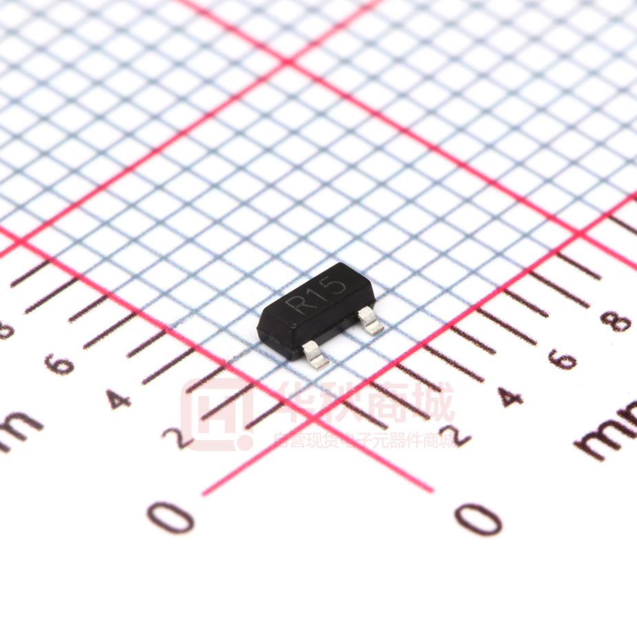

    MOS管 P-Channel VDS=20V VGS=±12V ID=5.1A RDS(ON)=55mΩ@4.5V SOT23N
WST6225 数据手册
WST6225 P-Ch MOSFET Product Summery General Description TheWST6225 is the highest performance trench P-ch MOSFET with extreme high cell density , which provide excellent RDSON and gate charge for most of the small power switching and load switch applications. BVDSS RDSON ID -20V 42mΩ -5.1A Applications The WST6225 meet the RoHS and Green Product requirement , with full function reliability approved. z High Frequency Point-of-Load Synchronous Buck Converter for MB/NB/UMPC/VGA z Networking DC-DC Power System Features z Load Switch z Advanced high cell density Trench technology SOT-23-3L Pin Configuration z Super Low Gate Charge z Excellent CdV/dt effect decline z Green Device Available Absolute Maximum Ratings Symbol Parameter VDS VGS ID@TC=25℃ ID@TC=70℃ IDM Rating Units Drain-Source Voltage -20 V Gate-Source Voltage ±12 V 1 -5.1 A 1 -3.9 A -15 A Continuous Drain Current, VGS @ -4.5V Continuous Drain Current, VGS @ -4.5V Pulsed Drain Current 2 3 PD@TA=25℃ Total Power Dissipation 1 W TSTG Storage Temperature Range -55 to 150 ℃ TJ Operating Junction Temperature Range -55 to 150 ℃ Thermal Data Symbol Parameter RθJA Thermal Resistance Junction-Ambient RθJC 1 www.winsok.tw Thermal Resistance Junction-Case Page 1 1 Typ. Max. Unit --- 125 ℃/W --- 80 ℃/W Dec.2014 WST6225 P-Ch MOSFET Electrical Characteristics (TJ=25 ℃, unless otherwise noted) Symbol BVDSS Parameter Conditions Drain-Source Breakdown Voltage △BVDSS/△TJ BVDSS Temperature Coefficient RDS(ON) Static Drain-Source On-Resistance2 VGS(th) Gate Threshold Voltage Min. Typ. Max. Unit VGS=0V , ID=-250uA -20 --- --- V Reference to 25℃ , ID=-1mA --- -0.016 --- V/℃ VGS=-4.5V , ID=-3A --- 42 55 VGS=-2.5V , ID=-2A --- 56 70 VGS=-1.8V , ID=-1A mΩ --- 73 85 -0.3 -0.5 -1.0 V --- 3.97 --- mV/℃ VDS=-16V , VGS=0V , TJ=25℃ --- --- -1 VDS=-16V , VGS=0V , TJ=55℃ --- --- -5 VGS=VDS , ID =-250uA △VGS(th) VGS(th) Temperature Coefficient IDSS Drain-Source Leakage Current IGSS Gate-Source Leakage Current VGS=±8V , VDS=0V --- --- ±100 nA gfs Forward Transconductance VDS=-5V , ID=-3A --- 14 --- S Qg Total Gate Charge (-4.5V) --- 12.1 16.9 Qgs Gate-Source Charge --- 1.5 2.1 Qgd Gate-Drain Charge --- 3.1 4.3 8.8 Td(on) VDS=-15V , VGS=-4.5V , ID=-3A Turn-On Delay Time uA nC --- 4.4 Rise Time VDD=-10V , VGS=-4.5V , --- 45 81 Turn-Off Delay Time RG=3.3Ω, ID=-3A --- 48.4 97 Fall Time --- 30.4 60.8 Ciss Input Capacitance --- 938 --- Coss Output Capacitance --- 108 --- Crss Reverse Transfer Capacitance --- 96 --- Min. Typ. Max. --- --- -4.8 A --- --- -15 A --- --- -1 V --- 28 --- nS --- 9 --- nC Tr Td(off) Tf VDS=-15V , VGS=0V , f=1MHz ns pF Diode Characteristics Symbol Parameter Conditions 1,4 IS Continuous Source Current ISM Pulsed Source Current VSD Diode Forward Voltage2 trr Reverse Recovery Time Qrr Reverse Recovery Charge 2,4 VG=VD=0V , Force Current VGS=0V , IS=-1A , TJ=25℃ IF=-3A , dI/dt=100A/µs , TJ=25℃ Unit Note : 2 1.The data tested by surface mounted on a 1 inch FR-4 board with 2OZ copper. 2.The data tested by pulsed , pulse width ≦ 300us , duty cycle ≦ 2% 3.The power dissipation is limited by 150℃ junction temperature 4.The data is theoretically the same as ID and IDM , in real applications , should be limited by total power dissipation. www.winsok.tw Page 1 Dec.2014 WST6225 P-Ch MOSFET Typical Characteristics 100 25 -ID=3A VGS=-5V VGS=-4.5V RDSON (mΩ) -ID Drain Current (A) 20 VGS=-3V 15 VGS=-2.5V 10 80 60 VGS=-1.8V 5 40 0 0 1 2 -VDS , Drain-to-Source Voltage (V) 1 3 Fig.1 Typical Output Characteristics 2 3 -VGS (V) 4 5 Fig.2 On-Resistance vs. G-S Voltage -IS Source Current(A) 4 3 TJ=150℃ TJ=25℃ 2 1 0 0 0.2 0.4 0.6 0.8 1 -VDS , Drain-to-Source Voltage (V) Fig.3 Fig.4 Gate-Charge Characteristics Forward Characteristics of Reverse 1.8 Normalized On Resistance 1.8 Normalized VGS(th) 1.4 1 0.6 0.2 1.4 1.0 0.6 0.2 -50 0 50 100 150 -50 50 100 150 Fig.6 Normalized RDSON vs. TJ Fig.5 Normalized VGS(th) vs. TJ www.winsok.tw 0 TJ , Junction Temperature (℃) TJ ,Junction Temperature (℃ ) Page 1 Dec.2014 WST6225 P-Ch MOSFET 10000 100.00 10ms -ID (A) Capacitance (pF) 1000 100us 10.00 Ciss 1.00 100ms Coss 100 1s Crss 0.10 DC TA=25℃ Single Pulse F=1.0MHz 0.01 10 1 6 11 -VDS (V) 15 0.1 20 1 Fig.7 Capacitance 10 -VDS (V) 100 Fig.8 Safe Operating Area Normalized Thermal Response (R θJA) 1 DUTY=0.5 0.2 0.1 0.1 0.05 0.02 0.01 0.01 PDM 0.001 TON SINGLE PULSE T D = TON/T TJpeak = TA + PDM x RθJA 0.0001 0.0001 0.001 0.01 0.1 1 10 100 1000 t , Pulse Width (s) Fig.9 Normalized Maximum Transient Thermal Impedance Fig.10 Switching Time Waveform www.winsok.tw Fig.11 Gate Charge Waveform Page 1 Dec.2014 Attention 1,AnyandallWinsokpowerproductsdescribedorcontainedhereindonothavespecificationsthatcanhandle applicationsthatrequireextremelyhighlevelsofreliability,suchaslifeͲsupportsystems,aircraft'scontrolsystems,or otherapplicationswhosefailurecanbereasonablyexpectedtoresultinseriousphysicaland/ormaterialdamage.  ConsultwithyourWinsokpowerrepresentativenearestyoubeforeusinganyWinsokpowerproductsdescribedor containedhereininsuchapplications. 2,Winsokpowerassumesnoresponsibilityforequipmentfailuresthatresultfromusingproductsatvaluesthatexceed,  evenmomentarily,ratedvalues(suchasmaximumratings,operatingconditionranges,orotherparameters)listedin productsspecificationsofanyandallWinsokpowerproductsdescribedorcontainedherein. 3,SpecificationsofanyandallWinsokpowerproductsdescribedorcontainedhereinstipulatetheperformance, characteristics,andfunctionsofthedescribedproductsintheindependentstate,andarenotguaranteesofthe performance,characteristics,andfunctionsofthedescribedproductsasmountedinthecustomer’sproductsor equipment.Toverifysymptomsandstatesthatcannotbeevaluatedinanindependentdevice,thecustomershouldalways evaluateandtestdevicesmountedinthecustomer’sproductsorequipment. 4,WinsokpowerSemiconductorCO.,LTD.strivestosupplyhighͲqualityhighͲreliabilityproducts.However,anyandall semiconductorproductsfailwithsomeprobability.Itispossiblethattheseprobabilisticfailurescouldgiverisetoaccidents oreventsthatcouldendangerhumanlivesthatcouldgiverisetosmokeorfire,orthatcouldcausedamagetoother property.Whendesigningequipment,adoptsafetymeasuressothatthesekindsofaccidentsoreventscannotoccur.Such measuresincludebutarenotlimitedtoprotectivecircuitsanderrorpreventioncircuitsforsafedesign,redundantdesign, andstructuraldesign. 5,IntheeventthatanyorallWinsokpowerproducts(includingtechnicaldata,services)describedorcontainedhereinare controlledunderanyofapplicablelocalexportcontrollawsandregulations,suchproductsmustnotbeexportedwithout obtainingtheexportlicensefromtheauthoritiesconcernedinaccordancewiththeabovelaw. 6,Nopartofthispublicationmaybereproducedortransmittedinanyformorbyanymeans,electronicormechanical, includingphotocopyingandrecording,oranyinformationstorageorretrievalsystem,orotherwise,withouttheprior writtenpermissionofWinsokpowerSemiconductorCO.,LTD. 7,Information(includingcircuitdiagramsandcircuitparameters)hereinisforexampleonly;itisnotguaranteedfor volumeproduction. Winsokpowerbelievesinformationhereinisaccurateandreliable,butnoguaranteesaremadeor impliedregardingitsuseoranyinfringementsofintellectualpropertyrightsorotherrightsofthirdparties. 8,Anyandallinformationdescribedorcontainedhereinaresubjecttochangewithoutnoticeduetoproduct/technology improvement,etc.Whendesigningequipment,refertothe"DeliverySpecification"fortheWinsokpowerproductthatyou  Intendtouse. 9,thiscatalogprovidesinformationasofSep.2014. Specificationsandinformationhereinaresubjecttochangewithout notice.
