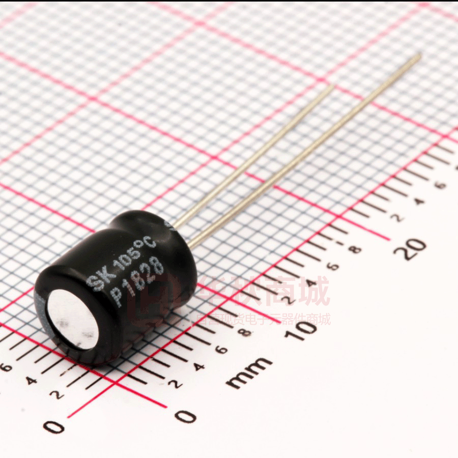

SK470M035E070A
SK470M035E070A
    CAPXON(台湾丰宾)
    插件,D6.3xL7mm
    直插铝电解电容 插件,D6.3xL7mm 47µF ±20% Ф6.30 x 7.00mm 35V 1000Hrs@105℃
SK470M035E070A 数据手册
SK Series SK Series 7 mm Standard 105℃ Features ◆ Design for space-saving and high density insertion. ◆ Applications: VTR, car radio, car stereos. charger, etc. ◆ For detail specifications, please refer to Engineering Bulletin No. E115 ◆ RoHS Compliant Specifications Item Performance Characteristics Operating Temperature Range -40 to +105℃ Rated Voltage Range 4 to 63 VDC Capacitance Range 0.1 to 470 μF Capacitance Tolerance Leakage Current(+20℃, max) Dissipation Factor (tanδ,at 20℃,120Hz) ±20% (120Hz, +20℃) I≦0.01 CV or 3 (μA) After 1 minute, whichever is greater measured with rate working voltage applied. Working Voltage (VDC) D.F. (%)max 4 25 6.3 22 10 20 16 16 25 14 35 12 50 10 63 9 4 7 15 6.3 4 8 10 3 6 16 2 4 25 2 4 35 2 3 50 2 3 63 2 3 Impedance ratio max Load Life Shelf Life Working Voltage (VDC) Z-25℃ / Z+20℃ Z-40℃ / Z+20℃ Test conditions Duration time :1000 Hrs Ambient temperature :+105℃ Applied voltage :Rated DC working voltage After test requirement at +20℃ Capacitance change :≦ ±20% of the initial measured value (4V : ≦ ±30%) Dissipation factor :≦ 200% of the initial specified value Leakage current :≦ The initial specified value Test conditions Duration time Ambient temperature Applied voltage Radial Low Temperature Characteristics (at 120Hz) :1000 Hrs :+105℃ :None After test requirement at +20℃ : Same limits as Load life. Pre-treatment for measurements shall be conducted after application of DC working voltage for 30 minutes. Multiplier for Ripple Current vs. Frequency CAP(μF) Frequency(Hz) 50(60) 120 0.8 1 CAP≦10 0.8 1 10<CAP≦100 0.8 1 100<CAP≦1000 400 1.30 1.23 1.16 1K 1.45 1.36 1.25 10K 50K-100K 1.65 1.70 1.48 1.53 1.25 1.38 Diagram of Dimensions:(unit:mm) Dφ F dφ 87 4 5 1.5±0.5 2.0±0.5 0.45 6.3 8 2.5±0.5 3.5±0.5 0.5 SK Series Case Size φDxL(mm) 4 (5) WV (SV) Cap(μF) 4.7 6.8 Size Ripple Size 6.3 (8) Ripple Size 10 (13) Ripple 10 15 22 33 47 68 100 220 330 470 4x7 23 4x7 31 4x7 26 4x7 35 5x7 55 4x7 5x7 4x7 5x7 5x7 32 35 40 47 55 5x7 58 6.3x7 65 6.3x7 8x7 90 120 5x7 6.3x7 6.3x7 8x7 8x7 65 75 90 120 120 WV (SV) Cap(μF) 0.1 0.15 0.22 0.33 0.47 0.68 1 1.5 2.2 3.3 4.7 6.8 10 15 22 33 47 68 Size 35 (44) Ripple 4x7 22 4x7 5x7 4x7 5x7 5x7 6.3x7 5x7 6.3x7 6.3x7 8x7 8x7 8x7 24 28 30 35 38 45 50 58 54 68 80 85 4x7 4x7 28 35 4x7 5x7 4x7 5x7 5x7 6.3x7 5x7 6.3x7 6.3x7 8x7 40 45 47 51 60 68 80 90 105 150 50 (63) Size 4x7 4x7 4x7 4x7 4x7 4x7 4x7 4x7 4x7 4x7 4x7 5x7 5x7 6.3x7 5x7 6.3x7 6.3x7 6.3x7 8x7 8x7 Size 16 (20) Ripple 4x7 4x7 20 30 4x7 4x7 5x7 4x7 5x7 5x7 6.3x7 6.3x7 32 37 42 45 50 61 67 72 6.3x7 8x7 95 105 Ripple 1.5 1.8 2.5 3.5 5 7 10 13 19 24 27 29 32 33 35 38 52 Size 4x7 4x7 4x7 4x7 4x7 4x7 4x7 4x7 4x7 5x7 5x7 6.3x7 6.3x7 60 63 78 Size 4x7 4x7 4x7 5x7 5x7 5x7 6.3x7 5x7 6.3x7 6.3x7 8x7 6.3x7 25 (32) Ripple 17 21 30 33 38 45 48 52 60 68 72 75 8x7 63 (79) 115 Ripple 1.5 1.8 2.5 3.5 6 7 12 14 19 25 29 33 35 6.3x7 40 8x7 55 8x7 65 Ripple Current ( mA, rms ) at 105℃ 120Hz 88
