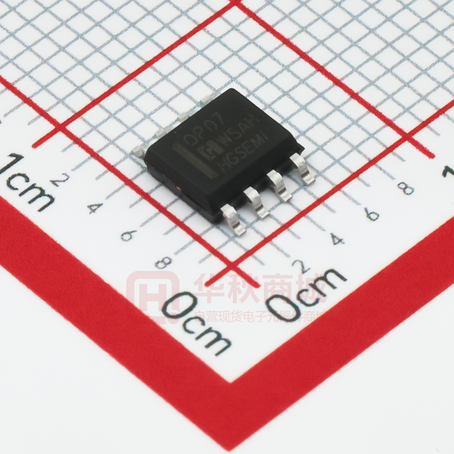

OP07M/TR
OP07M/TR
    HGSEMI(华冠)
    SOP-8
    极低偏置单极运算放大器 SOP8_150MIL 500KHz
OP07M/TR 数据手册
OP07 Very low offset single bipolar operational amplifier Features ■ Extremely low offset: 150µV/ max. ■ Low input bias current: 1.8nA ■ LOW Vio drift: 0.5µV/°C ■ Ultra stable with time: 2µV/month max. ■ Wide supply voltage range: ±3V to ± 22V ■ Temperature range: 0°C to -105°C N DIP8 (Plastic package) Description The OP07 is a very high precision op-amp with an offset voltage maximum of 150µV. Pin connections (top view) Offering also low input current (1.8nA) and high gain (400V/mV), the OP07C is particularly suitable for instrumentation applications. Offset Null 1 1 8 Inverting Input 2 7 VCC Non-inverting Input 3 6 Output 4 5 N.C. V CC http://www.hgsemi.com.cn 1 Offset Null 2 2018 AUG OP07 1 Schematic diagram Figure 1. Schematic diagram VCC R2A R2B Offset Null R1A N2 R7 C1 R1B N4 T15 T9 T10 T18 D8 T5 Non-inverting input Inverting input D9 T3 T6 T4 R3 T7 Output C3 D6 D1 D4 D3 R9 D7 T1 R4 D2 T8 C2 D11 R10 D5 T12 T17 R5 T2 T16 T13 T11 D10 T14 R6 R8 VCC Figure 2. Input offset voltage nulling circuit Offset Null 1 20kΩ Offset Null 2 VCC http://www.hgsemi.com.cn 2 2018 AUG OP07 2 Absolute maximum ratings Table 1. Absolute maximum ratings Symbol Parameter Value Unit VCC Supply voltage ± 22 V Vid Differential input voltage ± 30 V Vi Input voltage ± 22 V Toper Operating temperature -40 to 105 °C Tstg Storage temperature -65 to 150 °C Rthja Thermal resistance junction to ambient(1) (2) DIP8 85 °C/W Rthjc Thermal resistance junction to case(1) (2) DIP8 41 °C/W HBM: human body model(3) 1.5 kV 200 V 1.5 kV ESD MM: machine model(4) CDM: charged device model (5) 1. Short-circuits can cause excessive heating and destructive dissipation. 2. Rth are typical values. 3. Human body model: 100pF discharged through a 1.5kΩ resistor between two pins of the device, done for all couples of pin combinations with other pins floating. 4. Machine model: a 200pF cap is charged to the specified voltage, then discharged directly between two pins of the device with no external series resistor (internal resistor < 5Ω). Done for all couples of pin combinations with other pins floating. 5. Charged device model: all pins plus package are charged together to the specified voltage and then discharged directly to the ground. http://www.hgsemi.com.cn 3 2018 AUG OP07 3 Electrical characteristics Table 2. VCC+ = 15 V, VCC- = Ground, Tamb = 25° C (unless otherwise specified) Symbol Typ. Max. Unit Input offset voltage 0°C ≤ Tamb ≤ +105°C 60 150 250 µV Long term input offset - voltage stability (1) 0.4 2 µV/Mo Input offset voltage drift 0.5 1.8 µV/°C Input offset current (Vic = 0V) 0°C ≤ Tamb ≤ +105°C 0.8 6 7 nA DIio Input offset current drift 15 50 pA/°C DIib Input bias current drift 15 50 pA/°C Ro Open loop output resistance 60 Ω Rid Differential input resistance 33 MW Ric Common mode input resistance 120 GW Vio DVio Iio Parameter Min. Vicm Input common mode voltage range 0°C ≤ Tamb ≤ +105°C ±13 ±13 ±13.5 CMR Common-mode rejection ratio (Vic = Vicm -min) 0°C ≤ Tamb ≤ +105°C 100 97 120 SVR Supply voltage rejection ratio (VCC = ±3 to ±18V) 0°C ≤ Tamb ≤ +105°C 90 86 104 Avd Large signal voltage gain VCC = ±15, RL = 2kΩ, VO = ±10V 0°C ≤ Tamb ≤ +105°C VCC = ±3, RL = 500Ω, VO = ±0.5V 120 100 100 400 ±12 ±11.5 ±13 ±12.8 ±12 V Slew rate ( RL = 2kΩ, CL = 100pF) 0.17 V/µs Gain bandwidth product (RL = 2kΩ, CL = 100pF, f = 100kHz) 0.5 MHz Supply current - no load 0°C ≤ Tamb ≤ +105°C VCC = ±3V 2.7 0.67 5 6 1.3 en Equivalent input noise voltage f = 10Hz f = 100Hz f = 1kHz 11 10.5 10 20 13.5 11.5 nV -----------Hz in Equivalent input noise current f = 10Hz f = 100Hz f = 1kHz 0.3 0.2 0.1 0.9 0.3 0.2 pA -----------Hz Vopp SR GBP ICC Output voltage swing RL = 10kΩ RL = 2kΩ RL = 1kΩ 0°C ≤ Tamb ≤ +105°C RL = 2kΩ V dB dB V/mV 400 ±11 mA 1. Long term input offset voltage stability refers to the average trend line of Vio vs time over extended periods after the first 30 days of operation. http://www.hgsemi.com.cn 4 2018 AUG
