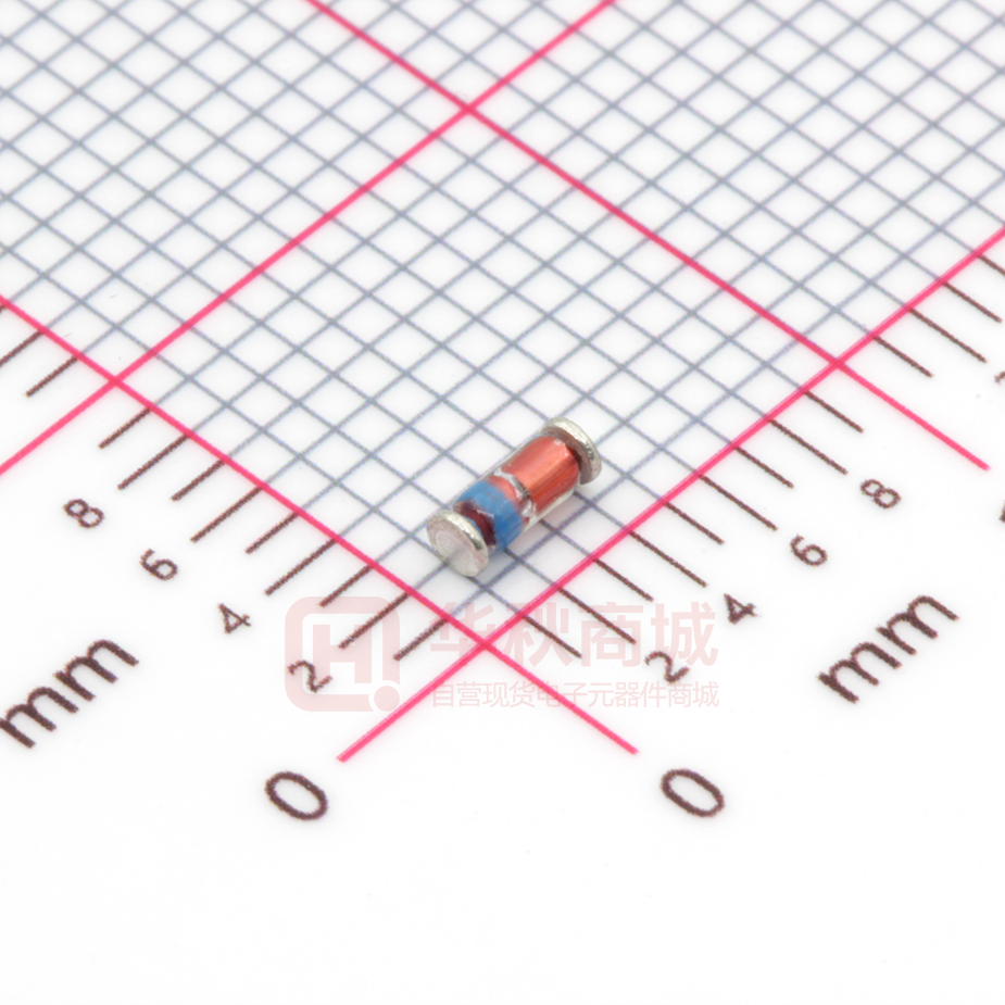

    稳压二极管 Vz=15V 5% Izt=5mA 500mW
ZMM15V 数据手册
DongGuan Tongke Electronic Co.,LTD ZMM2V4 - ZMM75 500mW SURFACE MOUNT ZENER DIODE Features · · · · Planar Die Construction Sealed Glass Case Ideally Suited for Automated Insertion 2.4V - 75V Nominal Zener Voltages A B C Mechanical Data · · · · · MiniMELF Case: MiniMELF, Glass Terminals: Solderable per MIL-STD-202, Method 208 Polarity: Cathode Band Approx. Weight: 0.05 grams Lead Free: For RoHS / Lead Free Version Maximum Ratings Dim Min Max A 3.30 3.70 B 1.30 1.60 C 0.28 0.50 All Dimensions in mm @ TA = 25°C unless otherwise specified Characteristic Symbol Value Unit Power Dissipation (Note 2) Pd 500 mW Forward Voltage @ IF = 200mA VF 1.5 V RqJA 300 K/W Tj, TSTG -55 to +175 °C Thermal Resistance, Junction to Ambient Air (Note 2) Operating and Storage Temperature Range Notes: 1. Tested with Pulses, tp = 20ms. 2. Valid provided that Electrodes are kept at Ambient Temperature. ZMM2V4 - ZMM75 1 of 3 www.tongke888.com 400-6922-883 DongGuan Tongke Electronic Co.,LTD ZMM2V4 - ZMM75 500mW SURFACE MOUNT ZENER DIODE Electrical Characteristics Type Number @ TA = 25°C unless otherwise specified Nominal Zener Voltage (Note 1) Zener Voltage Range Maximum Zener Impedance Maximum Zener Impedance VZ @ IZT VZ @ IZT ZZT @ IZT ZZK @ IZK Maximum Leakage Current @ VR IR@ TJ = 25°C IR@ TJ = 150°C VR Temperature Coefficient (V) (mA) (V) (W) (W) (mA) (µA) (µA) (V) (%/K) ZMM2V4 2.4 5.0 2.28 to 2.56 85 600 1.0 50 100 1.0 -0.09 to -0.06 ZMM2V7 2.7 5.0 2.5 to 2.9 85 600 1.0 10 50 1.0 -0.09 to -0.06 ZMM3V0 3.0 5.0 2.8 to 3.2 90 600 1.0 4.0 40 1.0 -0.08 to -0.05 ZMM3V3 3.3 5.0 3.1 to 3.5 90 600 1.0 2.0 40 1.0 -0.08 to -0.05 ZMM3V6 3.6 5.0 3.4 to 3.8 90 600 1.0 2.0 40 1.0 -0.08 to -0.05 ZMM3V9 3.9 5.0 3.7 to 4.1 90 600 1.0 2.0 40 1.0 -0.08 to -0.05 ZMM4V3 4.3 5.0 4.0 to 4.6 90 600 1.0 1.0 20 1.0 -0.06 to -0.03 ZMM4V7 4.7 5.0 4.4 to 5.0 80 600 1.0 0.5 10 1.0 -0.05 to +0.02 ZMM5V1 5.1 5.0 4.8 to 5.4 60 550 1.0 0.1 2.0 1.0 -0.02 to +0.02 ZMM5V6 5.6 5.0 5.2 to 6.0 40 450 1.0 0.1 2.0 1.0 -0.05 to +0.05 ZMM6V2 6.2 5.0 5.8 to 6.6 10 200 1.0 0.1 2.0 2.0 0.03 to 0.06 ZMM6V8 6.8 5.0 6.4 to 7.2 8.0 150 1.0 0.1 2.0 3.0 0.03 to 0.07 ZMM7V5 7.5 5.0 7.0 to 7.9 7.0 50 1.0 0.1 2.0 5.0 0.03 to 0.07 ZMM8V2 8.2 5.0 7.7 to 8.7 7.0 50 1.0 0.1 2.0 6.2 0.03 to 0.08 ZMM9V1 9.1 5.0 8.5 to 9.6 10 50 1.0 0.1 2.0 6.8 0.03 to 0.09 ZMM10 10 5.0 9.4 to 10.6 15 70 1.0 0.1 2.0 7.5 0.03 to 0.10 ZMM11 11 5.0 10.4 to 11.6 20 70 1.0 0.1 2.0 8.2 0.03 to 0.11 ZMM12 12 5.0 11.4 to 12.7 20 90 1.0 0.1 2.0 9.1 0.03 to 0.11 ZMM13 13 5.0 12.4 to 14.1 26 110 1.0 0.1 2.0 10 0.03 to 0.11 ZMM15 15 5.0 13.8 to 15.6 30 110 1.0 0.1 2.0 11 0.03 to 0.11 ZMM16 16 5.0 15.3 to 17.1 40 170 1.0 0.1 2.0 12 0.03 to 0.11 ZMM18 18 5.0 16.8 to 19.1 50 170 1.0 0.1 2.0 13 0.03 to 0.11 ZMM20 20 5.0 18.8 to 21.2 55 220 1.0 0.1 2.0 15 0.03 to 0.11 ZMM22 22 5.0 20.8 to 23.3 55 220 1.0 0.1 2.0 16 0.04 to 0.12 ZMM24 24 5.0 22.8 to 25.6 80 220 1.0 0.1 2.0 18 0.04 to 0.12 ZMM27 27 5.0 25.1 to 28.9 80 220 1.0 0.1 2.0 20 0.04 to 0.12 ZMM30 30 5.0 28 to 32 80 220 1.0 0.1 2.0 22 0.04 to 0.12 ZMM33 33 5.0 31 to 35 80 220 1.0 0.1 2.0 24 0.04 to 0.12 ZMM36 36 5.0 34 to 38 80 220 1.0 0.1 2.0 27 0.04 to 0.12 ZMM39 39 2.5 37 to 41 90 500 0.5 0.1 5.0 30 0.04 to 0.12 ZMM43 43 2.5 40 to 46 90 600 0.5 0.1 5.0 33 0.04 to 0.12 ZMM47 47 2.5 44 to 50 110 700 0.5 0.1 5.0 36 0.04 to 0.12 ZMM51 51 2.5 48 to 54 125 700 0.5 0.1 10 39 0.04 to 0.12 ZMM56 56 2.5 52 to 60 135 1000 0.5 0.1 10 43 0.04 to 0.12 ZMM62 62 2.5 58 to 66 150 1000 0.5 0.1 10 47 0.04 to 0.12 ZMM68 68 2.5 64 to 72 200 1000 0.5 0.1 10 51 0.04 to 0.12 ZMM75 75 2.5 70 to 79 250 1500 0.5 0.1 10 56 0.04 to 0.12 Notes: 1. Tested with pulses tp = 20 ms. 2. Valid provided that electrodes are kept at ambient temperature. ZMM2V4 - ZMM75 2 of 3 www.tongke888.com 400-6922-883 DongGuan Tongke Electronic Co.,LTD ZMM2V4 - ZMM75 50 100 Ptot = 500mw TA = 25°C 40 80 IZ, ZENER CURRENT (mA) IZ, ZENER CURRENT (mA) Ptot = 500mW TA = 25°C 60 40 20 30 20 10 0 0 8 4 12 16 0 20 30 25 20 VZ, ZENER VOLTAGE (V) Fig. 8, Zener Current vs Zener Voltage 15 VZ, ZENER VOLTAGE (V) Fig. 1, Zener Current vs Zener Voltage 1000 Tj = 25°C DIFFERENTIAL ZENER IMPEDANCE (W) 600 Pd, POWER DISSIPATION (mW) 500 400 300 200 100 0 0 40 80 120 160 35 IZ = 1mA 100 5mA 10 10mA 1 200 0 5 10 15 20 VZ, ZENER VOLTAGE (V) Fig. 4, Differential Zener Impedance TA, AMBIENT TEMPERATURE (°C) Fig. 3, Power Dissipation vs Ambient Temperature 25 200 Cj, JUNCTION CAPACITANCE (pF) VR = 2V Tj = 25°C 150 100 50 0 0 5 10 15 20 25 VZ, ZENER VOLTAGE (V) Fig. 5, Junction Capacitance vs Zener Voltage ZMM2V4 - ZMM75 3 of 3 www.tongke888.com 400-6922-883
ZMM15V
物料型号:ZMM2V4 - ZMM75
器件简介:这是一系列500mW表面安装的齐纳二极管,具有平面芯片结构和密封的玻璃外壳,非常适合自动化插入。
引脚分配:MiniMELF封装,可焊接引脚,极性为带有色带的阴极。
参数特性: - 功率耗散:500mW - 正向电压@200mA:1.5V - 热阻,结到环境空气:300 K/W - 工作和存储温度范围:-55至+175摄氏度
功能详解:文档提供了不同型号的齐纳二极管的额定齐纳电压、齐纳电压范围、最大齐纳阻抗、最大漏电流、温度系数等电气特性。
应用信息:文档没有明确提供应用信息,但通常齐纳二极管用于电压稳定和过压保护。
封装信息:MiniMELF玻璃封装,具体尺寸数据在文档中有详细描述。
