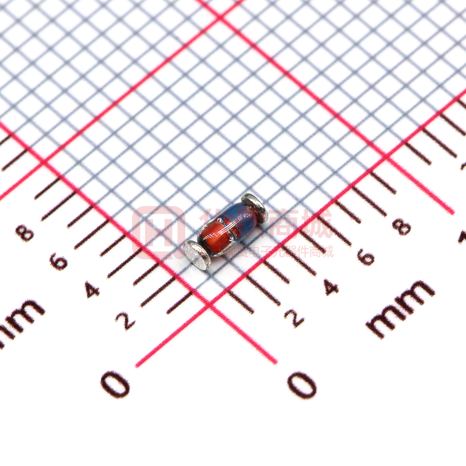

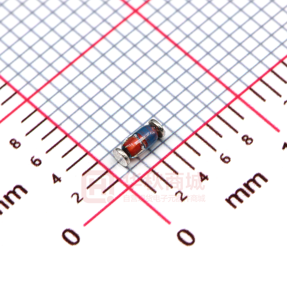

    LL-34(SOD-80)
    稳压二极管 Vz=12V 11.4V~12.7V Izt=5mA P=500mW LL34
ZMM12 数据手册
ZMM2V0-150 ZENER DIODES FEATURES     Low zener impedance Low regulation factor Glass passivated junction High temperature soldering guaranteed 260°C/10S at terminals LL34 (SOD-80) MECHANICAL DATA Cathode indification φ1 .5±0.1  Case: MINI MELF molded glass body  Terminals: Plated axial leads, solderable per MIL-STD 750, method 2026  Polarity: Color band denotes cathode end  Mounting Position: Any  Weight: 0.04 grams (approx.) C 3.5 ±0.2 B 0.4±0.1 A Dimensions in millimeters Maximum Ratings (TA=25 °C unless otherwise noted) Characteristic Symbol Value Unit Power Dissipation at Tamb=25 C(Note 1) Ptot 500 mW Forward voltage at IF=100mA VF 1.0 V Junction Temperature Tj 200 °C Storage Temperature Range TSTG -65 to + 200 °C Thermal resistance junction ambient(Note 1) RqJA 0.3 K/mW Note 1: Valid provided that leads at a distance of 10mm from case are kept at ambient temperature © GUANGDONG HOTTECH INDUSTRIAL CO.,LTD E-mail:hkt@heketai.com 1/ 4 ZMM2V0-150 ZENER DIODES ELECTRICAL CHARACTERISTICS @ Ta=25°C unless otherwise specified Nominal Test Device ZenerVoltage Current Type Vz@IZT IZT Maximum Maximum Zener Impedance ZZT@IZT ZZk@IZK IZK Maximu Reverse Typical mRegul Leakage Current Temperature atorCur Coefficient rent IR @VR IZM Min Max mA Ohms Ohms mA µA Volts (%/°C) mA ZMM2V0 1.90 2.10 5 100 600 1 150 1 -0.085 165 ZMM2V2 2.09 2.31 5 100 600 1 150 1 -0.085 165 ZMM2V4 2.28 2.56 5 85 600 1 50 1 -0.085 155 ZMM2V7 2.5 2.9 5 85 600 1 10 1 -0.08 135 ZMM3V0 2.8 3.2 5 85 600 1 4 1 -0.075 125 ZMM3V3 3.1 3.5 5 85 600 1 2 1 -0.07 115 ZMM3V6 3.4 3.8 5 85 600 1 2 1 -0.065 105 ZMM3V9 3.7 4.1 5 85 600 1 2 1 -0.06 95 ZMM4V3 4 4.6 5 75 600 1 1 1 0.055 90 ZMM4V7 4.4 5 5 60 600 1 0.5 1 0.03 85 ZMM5V1 4.8 5.4 5 35 550 1 0.1 1 0.03 80 ZMM5V6 5.2 6 5 25 450 1 0.1 1 0.038 70 ZMM6V2 5.8 6.6 5 10 200 1 0.1 2 0.045 64 ZMM6V8 6.4 7.2 5 8 150 1 0.1 3 0.05 58 ZMM7V5 7 7.9 5 7 50 1 0.1 5 0.058 53 ZMM8V2 7.7 8.7 5 7 50 1 0.1 6.2 0.062 74 ZMM9V1 8.5 9.6 5 10 50 1 0.1 6.8 0.068 43 ZMM10 9.4 10.6 5 15 70 1 0.1 7.5 0.075 40 ZMM11 10.4 11.6 5 20 70 1 0.1 8.2 0.076 36 ZMM12 11.4 12.7 5 20 90 1 0.1 9.1 0.077 32 ZMM13 12.4 14.1 5 26 110 1 0.1 10 0.079 29 ZMM15 13.8 15.6 5 30 110 1 0.1 11 0.082 27 ZMM16 15.3 17.1 5 40 170 1 0.1 12 0.083 24 ZMM18 16.8 19.1 5 50 170 1 0.1 13 0.085 21 ZMM20 18.8 21.2 5 55 220 1 0.1 15 0.086 20 ZMM22 20.8 23.3 5 55 220 1 0.1 16 0.087 18 ZMM24 22.8 25.6 5 80 220 1 0.1 18 0.088 16 ZMM27 25.1 28.9 5 80 220 1 0.1 20 0.09 14 ZMM30 28 32 5 80 220 1 0.1 22 0.091 13 ZMM33 31 35 5 80 220 1 0.1 24 0.092 12 ZMM36 34 38 5 80 220 1 0.1 27 0.093 11 ZMM39 37 41 2.5 90 500 0.5 0.1 30 0.094 10 ZMM43 40 46 2.5 90 600 0.5 0.1 33 0.095 9.2 ZMM47 44 50 2.5 110 700 0.5 0.1 36 0.095 8.5 ZMM51 48 54 2.5 125 700 0.5 0.1 39 0.096 7.8 ZMM56 52 60 2.5 135 1000 0.5 0.1 43 0.096 7 © GUANGDONG HOTTECH INDUSTRIAL CO.,LTD E-mail:hkt@heketai.com 2/ 4 ZMM2V0-150 ZENER DIODES ELECTRICAL CHARACTERISTICS @ Ta=25°C unless otherwise specified ZMM62 58 66 2.5 150 1000 0.5 0.1 47 0.096 6.4 ZMM68 64 72 2.5 200 1000 0.5 0.1 51 0.096 5.9 ZMM75 70 80 2.5 250 1500 0.5 0.1 56 0.096 5.3 ZMM82 77 87 2.5 300 2000 0.5 0.1 62 0.096 4.8 ZMM91 85 96 1 450 5000 0.1 0.1 68 0.096 4.4 ZMM100 94 106 1 450 5000 0.1 0.1 75 0.096 4.0 ZMM110 104 116 1.0 600 5000 0.1 0.1 82 +0.096 3.6 ZMM120 114 127 1.0 800 5000 0.1 0.1 91 +0.096 3.3 ZMM130 124 141 1.0 1000 5000 0.1 0.1 100 +0.096 3.0 ZMM150 138 156 1.0 1200 5000 0.1 0.1 110 +0.096 2.6 Typical Characteristics 5 mA 10 15 20 25 30 Iz,TEST CURRENT,MILLIAMPERS 50 V 40 30 Test Current Iz=5mA 20 10 0 27 24 22 20 15 12 11 9V1 6V8 6V2 5V6 5V1 4V7 4V3 3V9 3V3 2V4 Vz,ZENER VOLTAGE,volts POWER ,TEMPERATURE DERATING CURVE Pd(mW) Power Dissipation 500 400 300 200 100 50 100 150 200 300 TA(oC) © GUANGDONG HOTTECH INDUSTRIAL CO.,LTD E-mail:hkt@heketai.com 3/ 4 ZMM2V0-150 ZENER DIODES LL34 Embossed Carrier Tape DIMENSIONS ARE IN MILLIMETER TYPE A B C d E F P0 P P1 W LL34 1.6 3.9 1.6 φ1.50 1.75 3.50 4.00 4.00 2.00 8.0 ±0.05 ±0.05 ±0.05 ±0.1 ±0.1 ±0.1 ±0.1 ±0.1 ±0.1 ±0.1 TOLERANCE LL34 Tape Leader and Trailer LL34 Reel DIMENSIONS ARE IN MILLIMETER REEL OPTION 7’’ DIA TOLERANCE D D1 D2 G H I W1 W2 φ178 54.40 13.00 R78 R25.60 R6.50 9.50 12.30 ±2 ±1 ±1 ±1 ±1 ±1 ±1 ±1 © GUANGDONG HOTTECH INDUSTRIAL CO.,LTD E-mail:hkt@heketai.com 4/ 4
