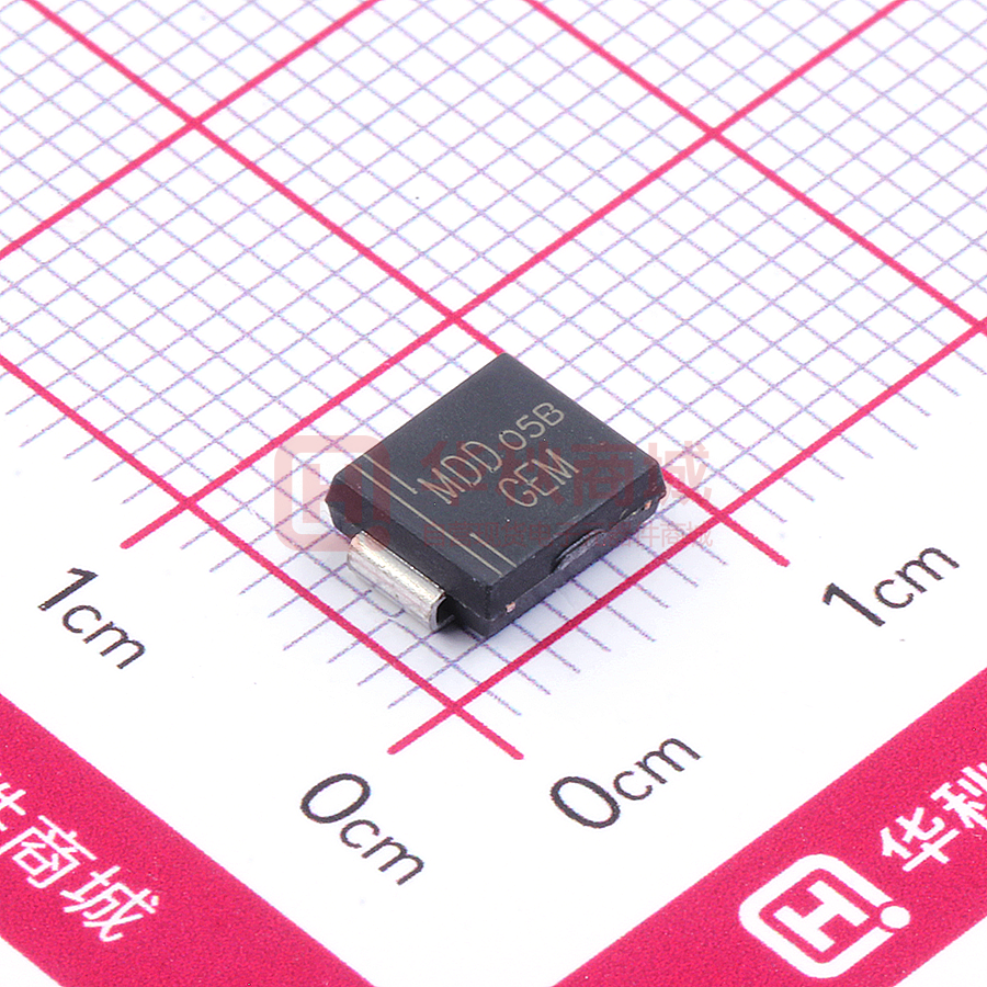

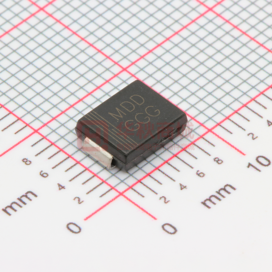

SMCJ58A
SMCJ58A
    MDD(辰达半导体)
    SMC(DO-214AB)
    PD=1500W,VRM=58V,VBR=64.4~71.2V,VC=93.6V
SMCJ58A 数据手册
SMCJ5.0(C)A THRU SMCJ440(C)A Stand-off Voltage - 5.0 to 440 Volts Peak Pulse Power: 1500 Watts SURFACE MOUNT TRANSIENT VOLTAGE SUPPRESSOR Features DO-214AB/SMC  For surface mounted applications in order to optimize board  space Low profile package 0.245(6.22) 0.220(5.59) 0.126 (3.20) 0.114 (2.90)  Built-in strain relief  Glass passivated junction 0.280(7.11) 0.260(6.60)  Low inductance  Excellent clamping capability 0.012(0.305) 0.006(0.152)  1500W peak pulse power capability at 10/1000μs waveform, 0.103(2.62) 0.079(2.06)  repetition rate (duty cycle): 0.01%  Fast response time 0.060(1.52) 0.030(0.76) 0.008(0.203)MAX.  Typical IR less than 1μA above 10V  High Temperature soldering: 260℃/10 seconds at terminals  Plastic package has underwriters laboratory flammability 94V-0 0.320(8.13) 0.305(7.75) Dimensions in inches and (millimeters) Mechanical Data Marking Code Case : JEDEC SMC molded plastic body Terminals : Solderable per MIL-STD-750,Method 2026 Polarity : Polarity symbol marking on body Mounting Position : Any Weight : 0.003 ounce, 0.095 grams Standard Packaging: 12mm tape (EIA STD RS-481) Cathode Band(for Uni-directional products only) MDD XXY AE MDD Logo Trace Code Marking Y:Numeric code at the end of the year (A~K) XX: WeeK Code (NOTE:The weekly code is based on the actual number of weeks in the calendar year.) Marking Code Part Number Code Applications SMCJ XXX C A 5% VBR Voltage Tolerance I/O interface AC/DC power supply Bidirectional Voltage Low frequency signal transmission line (RS232, RS485, etc.) Series Code MAXIMUM RATINGS AND CHARACTERISTICS Ratings at 25℃ ambient temperature unless otherwise specified. Peak pulse power dissipation at 10/1000μs waveform (Note1, Note2, Fig.1) PPPM Peak pulse current of at 10/1000μs waveform (Note 1, Fig.3) IPPM See Table A PM(AV) 6.5 W IFSM 200 A TJ,TSTG -65 to +150 ℃ Typical thermal resistance junction to lead RθJL 15 ℃/W Typical thermal resistance junction to ambient RθJA 75 ℃/W Steady state power dissipation at TA=50℃ (Fig.5) Peak forward surge current, 8.3ms single half sine-wave superimposed on rated load, (JEDEC Method) (Note3, Fig.6) Operating junction and Storage Temperature Range. Minimum 1500 W Notes:1. Non-repetitive current pulse, per Fig.3 and derated above TA=25℃ per Fig.2. 2. Mounted on 5.0mm×5.0mm (0.03mm thick) copper pads to each terminal. 3. 8.3ms single half sine-wave, or equivalent square wave, duty cycle=4 pulses per minutes maximum. http://www.microdiode.com Rev:2024A2 Page :1 SMCJ5.0(C)A THRU SMCJ440(C)A Stand-off Voltage - 5.0 to 440 Volts Peak Pulse Power: 1500 Watts Electrical Characteristics (TA=25℃ ℃) Part Number Device Marking Code Reverse Stand-Off Voltage Breakdown Voltage @IT Test Current Maximum Clamping Voltage @IPP Peak Pulse Current Reverse Leakage @VRWM Unidirectional Bidirectional UNI BI VRWM(V) VBR(V) IT(mA) VC(V) IPP(A) IR(μA) SMCJ5.0A SMCJ5.0CA GDE BDE 5.0 6.40~7.00 10 9.2 163.0 800 SMCJ6.0A SMCJ6.0CA GDG BDG 6.0 6.67~7.37 10 10.3 145.7 800 SMCJ6.5A SMCJ6.5CA GDK BDK 6.5 7.22~7.98 10 11.2 134.0 500 SMCJ7.0A SMCJ7.0CA GDM BDM 7.0 7.78~8.60 10 12.0 125.0 200 SMCJ7.5A SMCJ7.5CA GDP BDP 7.5 8.33~9.21 1 12.9 116.3 100 SMCJ8.0A SMCJ8.0CA GDR BDR 8.0 8.89~9.83 1 13.6 110.3 50 SMCJ8.5A SMCJ8.5CA GDT BDT 8.5 9.44~10.40 1 14.4 104.2 20 SMCJ9.0A SMCJ9.0CA GDV BDV 9.0 10.00~11.10 1 15.4 97.4 10 SMCJ10A SMCJ10CA GDX BDX 10.0 11.10~12.30 1 17.0 88.3 5 SMCJ11A SMCJ11CA GDZ BDZ 11.0 12.20~13.50 1 18.2 82.5 1 SMCJ12A SMCJ12CA GEE BEE 12.0 13.30~14.70 1 19.9 75.4 1 SMCJ13A SMCJ13CA GEG BEG 13.0 14.40~15.90 1 21.5 69.8 1 SMCJ14A SMCJ14CA GEK BEK 14.0 15.60~17.20 1 23.2 64.7 1 SMCJ15A SMCJ15CA GEM BEM 15.0 16.70~18.50 1 24.4 61.5 1 SMCJ16A SMCJ16CA GEP BEP 16.0 17.80~19.70 1 26.0 57.7 1 SMCJ17A SMCJ17CA GER BER 17.0 18.90~20.90 1 27.6 54.4 1 SMCJ18A SMCJ18CA GET BET 18.0 20.00~22.10 1 29.2 51.4 1 SMCJ20A SMCJ20CA GEV BEV 20.0 22.20~24.50 1 32.4 46.3 1 SMCJ22A SMCJ22CA GEX BEX 22.0 24.40~26.90 1 35.5 42.3 1 SMCJ24A SMCJ24CA GEZ BEZ 24.0 26.70~29.50 1 38.9 38.6 1 SMCJ26A SMCJ26CA GFE BFE 26.0 28.90~31.90 1 42.1 35.7 1 SMCJ28A SMCJ28CA GFG BFG 28.0 31.10~34.40 1 45.4 33.1 1 SMCJ30A SMCJ30CA GFK BFK 30.0 33.30~36.80 1 48.4 31.0 1 SMCJ33A SMCJ33CA GFM BFM 33.0 36.70~40.60 1 53.3 28.2 1 SMCJ36A SMCJ36CA GFP BFP 36.0 40.00~44.20 1 58.1 25.9 1 SMCJ40A SMCJ40CA GFR BFR 40.0 44.40~49.10 1 64.5 23.3 1 SMCJ43A SMCJ43CA GFT BFT 43.0 47.80~52.80 1 69.4 21.7 1 SMCJ45A SMCJ45CA GFV BFV 45.0 50.00~55.30 1 72.7 20.6 1 SMCJ48A SMCJ48CA GFX BFX 48.0 53.30~58.90 1 77.4 19.4 1 SMCJ51A SMCJ51CA GFZ BFZ 51.0 56.70~62.70 1 82.4 18.2 1 SMCJ54A SMCJ54CA GGE BGE 54.0 60.00~66.30 1 87.1 17.3 1 SMCJ58A SMCJ58CA GGG BGG 58.0 64.40~71.20 1 93.6 16.1 1 SMCJ60A SMCJ60CA GGK BGK 60.0 66.70~73.70 1 96.8 15.5 1 SMCJ64A SMCJ64CA GGM BGM 64.0 71.10~78.60 1 103.0 14.6 1 SMCJ70A SMCJ70CA GGP BGP 70.0 77.80~86.00 1 113.0 13.3 1 SMCJ75A SMCJ75CA GGR BGR 75.0 83.30~92.10 1 121.0 12.4 1 SMCJ78A SMCJ78CA GGT BGT 78.0 86.70~95.80 1 126.0 11.9 1 SMCJ85A SMCJ85CA GGV BGV 85.0 94.40~104.00 1 137.0 11.0 1 SMCJ90A SMCJ90CA GGX BGX 90.0 100.00~111.00 1 146.0 10.3 1 SMCJ100A SMCJ100CA GGZ BGZ 100.0 111.00~123.00 1 162.0 9.3 1 SMCJ110A SMCJ110CA GHE BHE 110.0 122.00~135.00 1 177.0 8.5 1 SMCJ120A SMCJ120CA GHG BHG 120.0 133.00~147.00 1 193.0 7.8 1 http://www.microdiode.com Rev:2024A2 Page :2 SMCJ5.0(C)A THRU SMCJ440(C)A Stand-off Voltage - 5.0 to 440 Volts Peak Pulse Power: 1500 Watts Electrical Characteristics (TA=25℃ ℃) Device Marking Code Part Number Reverse Stand-Off Voltage Breakdown Voltage @IT Test Current Maximum Clamping Voltage @IPP Peak Pulse Current Reverse Leakage @VRWM Unidirectional Bidirectional UNI BI VRWM(V) VBR(V) IT(mA) VC(V) IPP(A) IR(μA) SMCJ130A SMCJ130CA GHK BHK 130.0 144.00~159.00 1 209.0 7.2 1 SMCJ150A SMCJ150CA GHM BHM 150.0 167.00~185.00 1 243.0 6.2 1 SMCJ160A SMCJ160CA GHP BHP 160.0 178.00~197.00 1 259.0 5.8 1 SMCJ170A SMCJ170CA GHR BHR 170.0 189.00~209.00 1 275.0 5.5 1 SMCJ180A SMCJ180CA GHT BHT 180.0 201.00~222.00 1 292.0 5.1 1 SMCJ190A SMCJ190CA GHU BHU 190.0 211.00~233.00 1 308.0 4.8 1 1 SMCJ200A SMCJ200CA GHV BHV 200.0 224.00~247.00 1 324.0 4.6 SMCJ210A SMCJ210CA GHW BHW 210.0 237.00~263.00 1 340.0 4.4 1 SMCJ220A SMCJ220CA GHX BHX 220.0 246.00~272.00 1 356.0 4.2 1 SMCJ250A SMCJ250CA GHZ BHZ 250.0 279.00~309.00 1 405.0 3.7 1 SMCJ300A SMCJ300CA GJE BJE 300.0 335.00~371.00 1 486.0 3.1 1 SMCJ350A SMCJ350CA GJG BJG 350.0 391.00~432.00 1 567.0 2.6 1 SMCJ400A SMCJ400CA GJK BJK 400.0 447.00~494.00 1 648.0 2.3 1 SMCJ440A SMCJ440CA GJM BJM 440.0 492.00~543.00 1 713.0 2.1 1 Notes: For bidirectional type having VRWM of 10V and less, the IR limit is double. Figure 1. Peak Pulse Power Rating Curve Figure 2. Pulse Derating Curve PPPM - Peak Pulse Power (kW) 100 80 60 40 20 0 0 25 50 75 100 125 150 175 TA-Ambient Temperature (℃) Figure 4. Typical Junction Capacitance IPPM - Peak Pulse Current, %IRSM Figure 3. Pulse Waveform http://www.microdiode.com Rev:2024A2 Page :3 SMCJ5.0(C)A THRU SMCJ440(C)A Stand-off Voltage - 5.0 to 440 Volts Figure 6. Maximum Non-Repetitive Forward Surge Current Uni-Directional Only PM(AV), Steady State Power Dissipation (W) Figure 5. Steady State Power Dissipation Derating Curve Peak Pulse Power: 1500 Watts Reflow Soldering Recommended Conditions Profile Feature Pb-Free Assembly Average ramp-up rate (TL to TP) 3℃/second max. Preheat -Temperature Min (TS min) -Temperature Max (TS max) -Time (min to max) (tS) 150℃ 200℃ 60-180 seconds TS max to TL -Ramp-up Rate 3℃/second max. Time maintained above: -Temperature (TL) -Time (tL) 217℃ 60-150 seconds Peak Temperature (TP) Time within 5℃ of actual Peak Temperature (tP) Ramp-down Rate Time 25℃ to Peak Temperature 260℃ 20-40 seconds 6℃/second max. 8 minutes max. The curve above is for reference only. http://www.microdiode.com Rev:2024A2 Page :4 SMCJ5.0(C)A THRU SMCJ440(C)A Stand-off Voltage - 5.0 to 440 Volts Peak Pulse Power: 1500 Watts Packing information unit:mm P0 P1 d Item Symbol Tolerance SMC Carrier width Carrier length Carrier depth Sprocket hole 13" Reel outside diameter 13" Reel inner diameter Feed hole diameter Sprocket hole position Punch hole position Punch hole pitch Sprocket hole pitch Embossment center Overall tape thickness Tape width A B C d D D1 D2 E F P P0 P1 T W Reel width W1 0.1 0.1 0.1 0.05 2.0 min 0.5 0.1 0.1 0.1 0.1 0.1 0.1 0.3 1.0 6.15 8.41 2.42 1.50 330.00 50.00 13.00 1.75 7.50 8.00 4.00 2.00 0.25 16.00 16.50 E F B A W P D2 T D1 C W1 D Note:Devices are packed in accor dance with EIA standar RS-481-A and specifications listed above. Reel packing PACKAGE REEL SIZE REEL (pcs) COMPONENT SPACING (mm) SMC 13" 3,000 4.0 BOX (pcs) 6000 INNER BOX (mm) REEL DIA, (mm) 190*190*41 330 CARTON SIZE (mm) 365*365*340 CARTON (pcs) 42000 APPROX. GROSS WEIGHT (kg) 14.0 Suggested Pad Layout http://www.microdiode.com Symbol Unit (mm) A 4.3 0.170 B 0.160 C 4.1 7.9 0.311 D 3.8 0.150 E 12 0.472 Unit (inch) Rev:2024A2 Page :5
