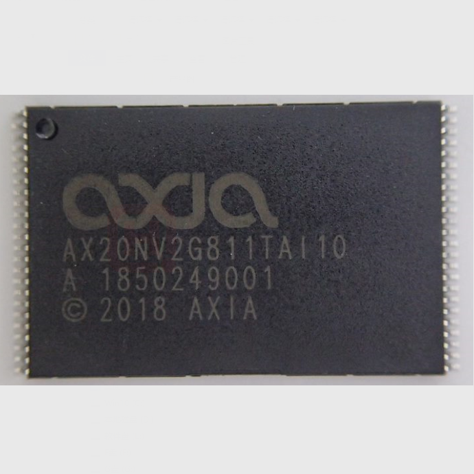

    Axia Memory Technology的AX20NV1Gx是一款3.0V 1 Gbit NAND闪存,组织为2112字节×64页×1024个块。所有读取和程序操作均使用2112字节寄存器执行;允...
AX20NV2G811TAI101 数据手册
2Gbit x8, x16: NAND Flash Memory NAND Flash Memory (AX20NV2G8, AX20NV2G6) Features • • • • • • • • Interface ▪ Open NAND Flash Interface (ONFI 1.0) compliant ▪ x8, x16 Technology ▪ Single-level cell (SLC) ▪ 3xnm NAND Process Operating Voltage Range ▪ VCC: 2.70V – 3.60V Operating Temperature Range ▪ Industrial: -40°C to 85°C Packages ▪ 48-pin TSOP (12.0mm x 20mm) ▪ 63-ball FBGA (9mm x 11mm) Device Signature ▪ Manufacturer’s ID ▪ Device ID ▪ Device Parameters ▪ Unique ID One Time Programmable Area (OTP) ▪ One Block (128K + 4K bytes) Quality and Reliability ▪ Recommended Error Correction Code: 4-bit / 528 bytes of data ▪ Data retention: 10 years ▪ Endurance (P/E cycles): 100K (Typ.) • • • • ▪ Block zero (block address 00h) is a valid block when shipped from factory and will remain valid for at least 1K P/E cycles with ECC Memory Array Organization ▪ x8 • Page size: 2176 bytes (2048 + 128 bytes) ▪ x16 • Page size: 1088 words (1024 + 64 words) ▪ Block size: 64 pages (128K + 8K bytes) ▪ Device size: 2048 blocks (2 Planes) Data Protection ▪ WP# signal: write protect entire device Device Status ▪ Ready/Busy# (R/B#) signal: hardware method for detecting internal operation completion status Advanced Command Set ▪ Program page cache mode ▪ Read page cache mode ▪ Page data move (copy back): ▪ Internal data move ▪ Multi-plane Commands Performance Device Operation Values Units 30.0 (Maximum) µs 300.0 (Typical) µs Block Erase 3.5 (Typical) ms Standby 10.0 (Typical) µA Read page 15.0 (Typical) mA Read page Program Page Revision: F Axia Memory Technology P a g e 1 | 62 2Gbit x8, x16: NAND Flash Memory Table of Contents Features ...................................................................................................................................................... 1 Performance .............................................................................................................................................. 1 Table of Contents ..................................................................................................................................... 2 General Description................................................................................................................................. 3 Ordering Options ..................................................................................................................................... 4 Valid Combinations — Standard ...................................................................................................... 4 Signal Description and Assignment ................................................................................................... 5 Package Options ...................................................................................................................................... 6 48-Pin TSOP (Top View) ..................................................................................................................... 6 63-Ball FBGA (Balls Down, Top View) ............................................................................................ 7 Architecture ............................................................................................................................................... 8 Status Register ................................................................................................................................... 11 Bus Interface ........................................................................................................................................... 17 Standby ................................................................................................................................................. 17 Busy ....................................................................................................................................................... 17 Device Protection (Write Protect WP#) ........................................................................................ 17 Command Input .................................................................................................................................. 18 Address Input...................................................................................................................................... 18 Data Input ............................................................................................................................................. 19 Data Output.......................................................................................................................................... 20 Command Set...................................................................................................................................... 21 Device Initialization ............................................................................................................................... 53 Device Power-Down .............................................................................................................................. 55 Electrical Specifications....................................................................................................................... 56 Error Management ................................................................................................................................. 59 ECC Management................................................................................................................................... 60 Product Use Limitations....................................................................................................................... 61 Limited Warranty ................................................................................................................................ 61 Revision History ..................................................................................................................................... 62 Revision: F Axia Memory Technology P a g e 2 | 62 2Gbit x8, x16: NAND Flash Memory General Description Axia Memory Technology’s AX20NV2Gx is a 3.0V 2Gbit NAND Flash organized as 2176 bytes × 64 pages × 2048 blocks. All read and program operations are performed using a 2176-byte register; allowing data to be transferred to and from the memory array in 2176-bytes increments. The erase operation is implemented in a single block unit (2176 bytes × 64 pages). Axia’s NAND Flash devices communicate through an asynchronous ONFI 1.0 compatible interface for highperformance I/O operations. It is a multiplexed 8-bit/16-bit bus (I/Ox) that transfers commands, address, and data. There are five control signals used to implement the asynchronous data interface: CE#, CLE, ALE, WE#, and RE#. Additional signals control hardware write protection (WP#) and monitor device status (R/B#). This hardware interface creates a low pin-count device with a standard pinout that remains the same in Axia’s NAND device family, enabling future upgrades to higher densities with no board redesign. Additionally, Axia’s NAND Flash devices support a copy back function which optimizes management of defective blocks. When a page program operation fails, the data already loaded in the page buffer can be directly programmed to another page inside the same array section without the time-consuming serial data insertion phase. Also present in Axia’s NAND Flash devices is a cache read feature that increases the read throughput. During cache reading, the device loads the new data in a cache register while the previous data is transferred to the I/Os. And finally, Axia’s NAND Flash devices provide special features listed below in Table 1: Table 1: Special Features # 1 2 Feature Description One-Time Programmable Area Unique Identifier Revision: F Details Size: 1 block (128K + 8K bytes) Size: 16 bytes Axia Memory Technology P a g e 3 | 62 2Gbit x8, x16: NAND Flash Memory Ordering Options The ordering part numbers are firmed by a valid combination of the following options: AX 20 N V 2G 8 1 1 TA I 10 1 Packing Type 1: Tray 2: Tape & Reel Special Features 10: MID Value 1 Temperature Range C: 0°C to +85°C I: -40°C to +85°C E: -40°C to +105°C Package Type BA: 63-ball WFBGA (9x11x1.0) TA: 48-pin TSOP Die Code 1 NAND Generation 1: 1st Generation SLC Bus Width 8: x8 6: x16 Density 2G: 2Gigabit Operational Voltage V: 2.70V to 3.60V E: 1.65V to 1.95V NAND Grade N: Standard Product Family 20: ONFI NAND Brand AX: Axia Memory Technology Valid Combinations — Standard Valid Combinations list includes device configurations currently available. Contact your local sales office to confirm availability of specific valid combinations and to check on newly released combinations. Table 2: Valid Combinations List Valid Combinations Base Part Number AX20NV2G Bus Width x8 Generation 1 Die Code 1 Package type BA, TA Temperature Range I Special Features 10 Packing Type 1, 2 Part Number AX20NV2G811BAI101 AX20NV2G811TAI101 AX20NV2G811BAI102 Revision: F Axia Memory Technology P a g e 4 | 62 2Gbit x8, x16: NAND Flash Memory Signal Description and Assignment Figure 1: Device Pinout ALE CE# WP# RE# WE# AXIA I/O[x:0] x: 7/15 NAND 2 Gbit CLE R/B# Table 3: Signal Description Signal Type CE# CLE Input Input ALE Input WE# Input RE# WP# Input Input R/B# Output I/O [7:0] - x8 I/O [15:0] - x16 Input / Output VCC Supply VCC: Core and I/O power supply. VSS Supply VSS: Core and I/O ground supply. NC DNU Revision: F Description Chip enable: Enables or disables the NAND Flash. Command latch enable: Loads a command from x8 - I/O[7:0], x16 - I/O[15:0] into the command register. Address latch enable: Loads an address from x8 - I/O[7:0], x16 - I/O[15:0] into the address register. Write enable: Transfers commands, addresses, and serial data from the host system to the NAND Flash. Read enable: Transfers serial data from the NAND Flash to the host system. Write protect: Enables or disables array PROGRAM and ERASE operations. Ready/Busy: An open-drain, active-low output that requires an external pull-up resistor. This signal indicates NAND Flash activity. Data inputs/outputs: The bidirectional I/Os transfer address, data, and command information. No connect: NCs are not internally connected. They can be driven (VCC / VSS) or left unconnected. Do not use: DNUs must be left unconnected. Axia Memory Technology P a g e 5 | 62 2Gbit x8, x16: NAND Flash Memory Package Options 48-Pin TSOP (Top View) 48 1 48 1 NC text text NC NC text text VSS NC text text NC NC text text IO15 NC text text NC NC text text IO14 NC text text NC NC text text IO13 NC text text IO7 NC text text IO7 NC text text IO6 NC text text IO6 R/B# text text IO5 R/B# text text IO5 RE# text text IO4 RE# text text IO4 CE# text text NC CE# text text IO12 NC text text NC NC text text NC NC text text NC NC text text NC VCC text 12 37 text VCC VCC text 12 37 text VCC VSS text 13 36 text VSS VSS text 13 36 text NC NC text text NC NC text text NC NC text text NC NC text text NC CLE text text NC CLE text text IO11 ALE text text IO3 ALE text text IO3 WE# text text IO2 WE# text text IO2 WP# text text IO1 WP# text text IO1 NC text text IO0 NC text text IO0 NC text text NC NC text text IO10 NC text text NC NC text text IO9 NC text text NC NC text text IO8 NC text text NC NC text text VSS Revision: F 48-Pin TSOP Package (x8) 24 25 48-Pin TSOP Package (x16) 24 Axia Memory Technology 25 P a g e 6 | 62 2Gbit x8, x16: NAND Flash Memory 63-Ball FBGA (Balls Down, Top View) Revision: F Axia Memory Technology P a g e 7 | 62 2Gbit x8, x16: NAND Flash Memory Architecture Axia’s NAND Flash devices use ONFI 1.0 compatible interface for all operations. Data, commands, and addresses are multiplexed onto the I/O pins. The commands received at the I/Os are latched by a command register and are used to determine the operations the device must perform. The addresses are latched into an address register and sent either to a row decoder to select a row address, or to a column decoder to select a column address. Data is transferred to or from the NAND Flash memory array either in a byte format (x8) or in a word format (x16) through a page buffer which is a combination of a data register and a cache register. During normal page operations, the data and cache registers act as a single register. During cache operations, the data and cache registers operate independently to increase data throughput. The NAND Flash memory array is programmed and read using page-based operations and is erased using block-based operations. The status register reports the status of all operations. Figure 2: Functional Block Diagram x8 IO[7:0] x16 IO[15:0] Address Register Status Register I/O Control Column Decoder ALE CE# WP# RE# CLE WE# R/B# Row Decoder Command Register Command & Control High Voltage Generator NAND Memory Array (2 Planes) OTP Area RDY_BSY# Page Buffer Revision: F Axia Memory Technology P a g e 8 | 62 2Gbit x8, x16: NAND Flash Memory Memory Array Architecture & Addressing Figure 3: Memory Array Architecture Plane of Even Numbered Blocks Plane of Odd Numbered Blocks x8: Page = 2,048 + 128 bytes = 2,176 bytes 1 block = 64 pages (139,264 bytes) 2Gbit Device = 2048 blocks (285,212,672 bytes) x16: Page = 1,024 + 64 words = 1,088 words 1 block = 64 pages (69,632 words) 2Gbit Device = 2048 blocks (142,606,336 words) Block 0 Block 1 Block 2 Block 3 Block 2044 Block 2045 Block 2046 Block 2047 Data Buffer Data Buffer Cache Buffer Cache Buffer Page Buffer x8 – x16 – x8 – x16 – Bytes Words x8 – x16 – Bytes Words x8 – x16 – Bytes Words Bytes Words Table 4: Array Addressing Sequence – x8, x16 x8: Cycle IO[7] IO[6] IO[5] IO[4] IO[3] IO[2] IO[1] IO[0] First BYTA7 BYTA6 BYTA5 BYTA4 BYTA3 BYTA2 BYTA1 BYTA0 Second Logic '0' Logic '0' Logic '0' Logic '0' BYTA11 BYTA10 BYTA9 BYTA8 Third BA7 BA6 / PLA PA5 PA4 PA3 PA2 PA1 PA0 Fourth BA15 BA14 BA13 BA12 BA11 BA10 BA9 BA8 Logic '0' Logic '0' Logic '0' Logic '0' Logic '0' Logic '0' Logic '0' BA16 IO[3] IO[2] Fifth x16: Cycle IO[15:8] IO[7] IO[1] IO[0] First Logic '0' WRDA7 WRDA6 WRDA5 WRDA4 WRDA3 WRDA2 WRDA1 WRDA0 Second Logic '0' Logic '0' Logic '0' Logic '0' Logic '0' Logic '0' WRDA10 WRDA9 WRDA8 Third Logic '0' BA7 BA6 / PLA PA5 PA4 PA3 PA2 PA1 PA0 Fourth Logic '0' BA15 BA14 BA13 BA12 BA11 BA10 BA9 BA8 Fifth Logic '0' Logic '0' Logic '0' Logic '0' Logic '0' Logic '0' Logic '0' Logic '0' BA16 Notes: 1. 2. 3. 4. IO[6] IO[5] IO[4] BYTAx: Byte based Column address, WRDAx: Word based Column address, PAx: Page address, BAx: Block address, PLA: Plane address Block address concatenated with page address = actual page address I/O[15:8] are not used during the addressing sequence and must be driven to Logic ‘0’ (Low) 1st and 2nd address cycles form the column Address, whereas 3rd, 4th and 5th address cycles form the row address Revision: F Axia Memory Technology P a g e 9 | 62 2Gbit x8, x16: NAND Flash Memory Table 5: Block Addressing Block # Row Address Range Plane Number Block 0 000000h ~ 00003Fh 0 Block 1 000040h ~ 00007Fh 1 Block 2 000080h ~ 0000BFh 0 Block 2045 01FF40h ~ 01FF7Fh 1 Block 2046 01FF80h ~ 01FFBFh 0 Block 2047 01FFC0h ~ 01FFFFh 1 ………. Revision: F Axia Memory Technology P a g e 10 | 62 2Gbit x8, x16: NAND Flash Memory Status Register Table 6: Status Register Definition Status Register Bits Name SR[7] WRPT SR[6] RDY SR[5] ARDY SR[4] ECCS SR[3] OTPS SR[2] RSVD SR[1] PS1 SR[0] PES Notes: 1. 2. 3. 4. 5. 6. 7. Function Default State Description WP# based Device Protection 1 0 = Device is protected - WP# is Low 1 = Device Is not protected - WP# is High Data Cache Register Ready Status Bit 1 0 = Data Cache is busy - not ready 1 = Data Cache is not busy - ready Memory Array Ready Status Bit Error Correction Code (ECC) Status One-Time Programmable (OTP) Area Protection Status Reserved for Future Use 1 0 = Memory Array is busy - not ready 1 = Memory Array is not busy - ready 0 = On-die ECC Engine disabled / Error Count Normal 1 = Page Uncorrectable / Recommend Re-program 0 = OTP Area not protected 1 = OTP Area protected 0 Reserved for Future Use Program Status of the Previous Command Program and Erase Status of the Current Command 0 0 = Program was successful 1 = Program was not successful 0 = Program or Erase was successful 1 = Program or Erase was not successful 0 0 0 SR[7] – WRPT: If set to ‘1’, the device is not write protected and can be programmed or erased. If cleared to ‘0’, then the device is write protected and cannot be programmed or erased. This is always valid regardless of state of the R/B#. SR[6] - RDY: If set to ‘1’, the device is ready for another command and all other status bits are valid. If cleared to ‘0’, then the last command issued is not yet complete and all other status bits are not valid. When cache operations are in use, this bit indicates when the Cache buffer is ready to accept new data. R/B# follows RDY (SR[5] indicates if the last command was complete). SR[5] – ARDY: If set to ‘1’, all array operations are complete. If cleared to zero, then there is a command being processed or an array operation in progress. SR[4] – ECCS: If the internal ECC is On, this bit indicates if the last read contained ECC errors. It is supported in two modes; selected using configuration register address 90h bit [4]. a. Mode 1: This mode indicates if a page has a high ECC error count and is recommended to rewrite the page. If set to ‘1’, it is recommended to rewrite the entire page. If cleared to ‘0’, it is in normal state (internal ECC enabled, error counts are in safe level), or internal ECC disabled. b. Mode 2: This mode indicates if the page has more ECC errors than the internal engine can correct (UECC). If set to ‘1’, it indicates that the ECC has failed and the page is uncorrectable. If cleared to ‘0’, then it is in normal state (internal ECC enabled, safely working), or internal ECC disabled. SR[3] – OTPS: This bit indicates whether the OTP is in protected mode (locked down). This bit is set to ‘1’ if the OTP is locked down and a program command is issued. It is cleared to ‘0’ when either not in OTP mode, or power-up or when Reset command is issued. SR[1] – PS1: This bit is only valid for cache program operations and shows whether the previous operation was a success or a failure. This bit is not valid until after the second 15h command or the 10h command has been transferred in a Cache program sequence. SR[0] – PES: This bit is valid for program and erase operations and shows whether the operation was a success or a failure. During cache program operations, this bit is only valid when ARDY is set to ‘1’. Revision: F Axia Memory Technology P a g e 11 | 62 2Gbit x8, x16: NAND Flash Memory Identification Definition (Address 00h) Table 7: Device Identification Definition (Address 00h) Byte # 0 Bit 7 Bit 6 Bit 5 Bit 4 Bit 3 Bit 2 Bit 1 Bit 0 Values MID 1 0 1 0 1 1 0 1 ADh 2Gbit, x8, 3.3V 1 1 1 1 0 0 0 1 DAh 2Gbit, x16, 3.3V 1 1 0 0 0 0 0 1 Internal Device # 1 0 0 Internal Device # 2 0 1 CAh x8/x16 ↓ 90h/90h Internal Device # 4 1 0 Internal Device # 8 1 1 0 0 Page Size - 2KB 0 1 Page Size - 4KB 1 0 Page Size - 8KB Spare Area Size - 8 bytes / 512 bytes Spare Area Size - 16 bytes / 512 bytes Block Size - 64KB 1 1 0 0 Block Size - 128KB 0 1 Block Size - 256KB 1 0 Block Size - 512KB 1 1 Options Manufacturer's ID 1 Device ID 2 Device Characteristics 3 Array Architecture Interface Type Access Time Revision: F Cell Type - 2 LEVEL 0 0 Cell Type - 4 LEVEL 0 1 Cell Type - 8 LEVEL 1 0 Cell Type - 16 LEVEL Simultaneous Programmed Pages - 1 Simultaneous Programmed Pages - 2 Simultaneous Programmed Pages - 4 Simultaneous Programmed Pages - 8 Interleaved Programming - Not Supported Interleaved Programming Supported Cache Program - Not Supported Cache Program Supported Page Size - 1KB 1 1 0 0 0 1 1 0 1 1 0 1 0 1 x8/x16 ↓ 95h/D5h 0 1 x8 0 x16 1 45ns 0 0 25ns 1 0 Axia Memory Technology P a g e 12 | 62 2Gbit x8, x16: NAND Flash Memory Byte # Bit 1 Bit 0 0 0 2-bits per 512 Bytes 0 1 4-bits per 512 Bytes 1 0 8-bits per 512 Bytes 1 1 Options Reserved for Future Use Reserved for Future Use 1-bit per 512 Bytes 4 ECC Level Number of Planes Size of Plane Reserved Bit 7 Bit 6 Bit 5 Bit 4 Bit 3 0 1 1 1 Bit 2 1 Plane 0 0 2 Planes 0 1 4 Planes 1 0 8 Planes 1 1 Plane Size - 64Mb 0 0 0 Plane Size - 128Mb 0 0 1 Plane Size - 256Mb 0 1 0 Plane Size - 512Mb 0 1 1 Plane Size - 1Gb 1 0 0 Plane Size - 2Gb 1 0 1 Plane Size - 4Gb 1 1 0 Plane Size - 8Gb Reserved for Future Use 1 1 1 Values x8/x16 ↓ 46h/46h 0 Identification Definition (Address 20h) Table 8: Device Identification Definition (Address 20h) Byte # Option Value 0 1 2 3 "O" "N" "F" "I" 4Fh 4Eh 46h 49h Revision: F Axia Memory Technology P a g e 13 | 62 2Gbit x8, x16: NAND Flash Memory Parameter Page Structure & Values Table 9: Parameter Page Structure & Values Byte # O/M Description Values Revision Information & Features Block 0-3 M Signature "O" "N" "F" "I" 4Fh, 4Eh, 46h, 49h 4-5 M Revision Number 02h, 00h M Features Supported Bit # Value 0 1 = Supports 16-bit Data bus 1 1 = Supports multiple LUN operations 2 1 = Supports non-sequential page programming 3 1 = Supports interleaved operations 4 1 = Supports odd to even page Copyback 5 - 15 0 = Reserved 1Ch, 00h M Optional Commands Supported Bit # Value 0 1 = Supports Page Cache Program 1 1 = Supports Read Cache 2 1 = Supports Get/Set features 3 1 = Supports Read Status Enhanced 4 1 = Supports Copyback 5 1 = Supports Read Unique ID 6 - 15 0 = Reserved 3Bh, 00h Reserved (0) 00h, 00h, 00h, 00h, 00h, 00h, 00h, 00h, 00h, 00h, 00h, 00h, 00h, 00h, 00h, 00h, 00h, 00h, 00h, 00h, 00h, 00h 6-7 8-9 10- 31 Manufacturer's Information Block 53h, 4Bh, 20h, 48h, 59h, 4Eh, 49h, 58h, 20h, 20h, 20h, 20h 48h, 32h, 37h, 55h, 32h, 47h, 38h, 46h, 32h, 44h, 4Bh, 41h, 2Dh, 42h, 4Dh, 20h, 20h, 20h, 20h, 20h 32 - 43 M Manufacturer's ID (12 ASCII Characters) 44 - 63 M Device Model (20 ASCII Characters) H27U2G8F2DKA-BM H27U2G8F2DKA-BM 64 M JEDEC Manufacturer's ID ADh 65 - 66 O Date Code 00h, 00h 00h, 00h, 00h, 00h, 00h, 00h, 00h, 00h, 00h, 00h, 00h, 00h, 00h 67 - 79 Reserved (0) Memory Organization Block 80 - 83 M Number of Data Bytes per Page (2048 Bytes) 00h, 08h, 00h, 00h 84 - 85 M Number of Spare Bytes per Page (128 Bytes) 80h, 00h 86 - 89 M Number of Data Bytes per Partial Page (512 Bytes) 00h, 00h, 00h, 00h 90 - 91 M Number of Spare Bytes per Partial Page (16 Bytes) 00h, 00h 92 - 95 M Number of Pages per Block (64 Pages) 40h, 00h, 00h, 00h Revision: F Axia Memory Technology P a g e 14 | 62 2Gbit x8, x16: NAND Flash Memory Byte # O/M 96 - 99 M Number of Blocks per Logical Unit (LUN) (2048) 00h, 08h, 00h, 00h 100 M Number of Logical Units (LUNs) 01h 101 M Number of address cycles Bit # Value 0-3 Row Address Cycles 4-7 Column Address Cycles 23h 102 M Number of Bits per Cell 01h 103 - 104 M Bad Blocks Number per LUN (40) 28h, 00h 105 - 106 M Block Endurance (50K) 05h, 04h 107 M Guaranteed Valid Blocks at Beginning of Target 01h 108 - 109 M Block Endurance for Guaranteed Valid Blocks 05h, 04h 110 M Number of Programs per Page 04h 111 M Partial Programming Attributes Bit # Value 0 1 = Partial Page programming has Constraints 1-3 1 = Reserved (0) 4 1 = Partial Page Layout 5-7 0 = Reserved 00h 112 M Number of Bits ECC Correctability 04h M Number of Interleaved Address Bits Bit # Value 0-3 Number of Interleaved Address Bits 4-7 Reserved (0) 01h M Interleaved Operation Attributes Bit # Value 0 Overlapped / concurrent Interleaving Support 1 1 = No Block Address Restrictions 2 1 = Program Cache Supported 3 Address Restrictions for Program Cache 4-7 0 = Reserved 04h Reserved (0) 00h, 00h, 00h, 00h, 00h, 00h, 00h, 00h, 00h, 00h, 00h, 00h, 00h 113 114 115 - 127 Description Values Electrical Parameter Block 128 129 - 130 M I/O Pin Capacitance (10pF) 0Ah M Timing Mode Support Bit # Value 0 1 = Supports Timing mode 0 1 1 = Supports Timing mode 1 2 1 = Supports Timing mode 2 3 1 = Supports Timing mode 3 4 1 = Supports Timing mode 4 5 1 = Supports Timing mode 5 6 - 15 0 = Reserved 1Fh, 00h Revision: F Axia Memory Technology P a g e 15 | 62 2Gbit x8, x16: NAND Flash Memory Byte # O/M Description Values 131 - 132 M Program Cache Timing Mode Support Bit # Value 0 1 = Supports Timing mode 0 1 1 = Supports Timing mode 1 2 1 = Supports Timing mode 2 3 1 = Supports Timing mode 3 4 1 = Supports Timing mode 4 5 1 = Supports Timing mode 5 6 - 15 0 = Reserved 133 - 134 M tPROG Maximum Page Program Time (700 μs) BCh, 02h 135 - 136 M tBERS Maximum Block Erase Time (10000 μs) 10h, 27h 137 - 138 M tR Maximum Page Read Time (25 μs) 1Eh, 00h Reserved (0) 3Ch, 00h, 00h, 00h, 00h, 00h, 00h, 00h, 00h, 00h, 00h, 00h, 00h, 00h, 00h, 00h, 00h, 00h, 00h, 00h, 00h, 00h, 00h, 00h, 00h 139 - 163 1Fh, 00h Vendor Block 164 - 165 M 166 - 253 Vendor Specific Revision Number Vendor Specific 00h, 00h 00h, 00h, 00h, 00h, 00h, 00h, 00h, 00h, 00h, 00h, 00h, 00h, 00h, 00h, 00h, 00h, 00h, 00h, 00h, 00h, 00h, 00h, 00h, 00h, 00h, 00h, 00h, 00h, 00h, 00h, 00h, 00h, 00h, 00h, 00h, 00h, 00h, 00h, 00h, 00h, 00h, 00h, 00h, 00h, 00h, 00h, 00h, 00h, 00h, 00h, 00h, 00h, 00h, 00h, 00h, 00h, 00h, 00h, 00h, 00h, 00h, 00h, 00h, 00h, 00h, 00h, 00h, 00h, 00h, 00h, 00h, 00h, 00h, 00h, 00h, 00h, 00h, 00h, 00h, 00h, 00h, 00h, 00h, 00h, 00h, 00h, 00h CCh, 92h 254 - 255 M Integrity CRC 256 - 511 M Value of Bytes 0 - 255 Not Available 512 - 767 M Value of Bytes 0 - 255 Not Available 768 + O Additional Redundant Parameter Pages Not Available Redundant Parameter Pages Revision: F Axia Memory Technology P a g e 16 | 62 2Gbit x8, x16: NAND Flash Memory Bus Interface As mentioned above, the I/O bus on the device is multiplexed. Commands, addresses and data input/output all share the same I/O pins. Commands and addresses are always supplied on I/O[7:0]. Data uses I/O [7:0] for x8 configuration and uses I/O[15:0] for x16 configuration. The read, program or erase command sequences typically consist of a command input cycle, two or five address input cycles, and one or more data cycles, either input or output. Table 10: Device Modes Selection Mode CE# CLE ALE WE# RE# WP# I/O[x] Standby VIH VIH / VIL VIH / VIL VIH / VIL VIH / VIL VCC / VSS VIH / VIL Command Input VIL VIH VIL ↑ VIH VIH Data Address Input VIL VIL VIH ↑ VIH VIH Data Data Input VIL VIL VIL ↑ VIH VIH Data Data Output VIL VIL VIL VIH ↓ VIH / VIL Data Write Protect VIH / VIL VIH / VIL VIH / VIL VIH / VIL VIH / VIL VIL VIH / VIL Notes: 1. VIH = High (Logic ‘1’), VIL = Low (Logic ‘0’) Standby The device enters standby when CE# pin is driven VIH (High). This helps reduce power consumption. In standby mode, all I/Os are tri-stated (High-Z). Note: The device enters standby if CE# goes High and the device is not busy (no program/erase operations in progress). Busy The device enters busy when program, erase or read operations are initiated. The device returns to Standby after the completion of the operation. During busy state, only RESET (FFH) and READ STATUS REGISTER (70h) commands are accepted by the device. Table 11: Recommended Signal Selections During Busy Mode CE# CLE ALE WE# RE# WP# I/O[x] Busy Period (READ) VIH / VIL VIH / VIL VIH / VIL VIH / VIL VIH / VIL VIH / VIL VIH / VIL Busy Period (Program) VIH / VIL VIH / VIL VIH / VIL VIH / VIL VIH / VIL VIH VIH / VIL Busy Period (Erase) VIH / VIL VIH / VIL VIH / VIL VIH / VIL VIH / VIL VIH VIH / VIL Notes: 1. VIH = High (Logic ‘1’), VIL = Low (Logic ‘0’) Device Protection (Write Protect WP#) The write protect# (WP#) signal enables or disables PROGRAM and ERASE operations within the Flash device. When WP# is Low, PROGRAM and ERASE operations are disabled. When WP# is High, PROGRAM and ERASE operations are enabled. It is recommended that the host drive WP# Low during power-on until VCC is stable to prevent inadvertent PROGRAM and ERASE operations. Revision: F Axia Memory Technology P a g e 17 | 62 2Gbit x8, x16: NAND Flash Memory WP# must be transitioned only when the device is in Standby and prior to beginning a command sequence. After a command sequence is complete and the device is ready, WP# can be transitioned. After WP# is transitioned, the host must wait tWW before issuing a new command. The WP# signal is always an active input, even when CE# is High. This signal should not be multiplexed with other signals. Command Input A command is entered from I/O[7:0] to the command register on the rising edge of WE# when CE# is Low, ALE is Low, CLE is High, and RE# is High. Most commands are ignored if the device is busy (R/B# = 0); however, some commands, including READ STATUS (70h), are accepted. For devices with a x16 interface, I/O[15:8] must be written with zeros when a command is issued. Figure 4: Command Latch Cycle CE# CLE ALE Logic WE# Logic RE# tDS IOx tDH Command Logic R/B# Don t Care Address Input An address is entered to the address register on the rising edge of WE# when CE# is Low, ALE is High, CLE is Low, and RE# is High. Bits that are not part of the address space must be Low (see Array Addressing Sequences). The number of address cycles required depends on the command (refer to the command descriptions to determine addressing requirements). Addresses are input on I/O[7:0] on x8 devices and on I/O[15:0] on x16 devices. Moreover, for commands that start a modify operation (program/erase), WP# must be high. Revision: F Axia Memory Technology P a g e 18 | 62 2Gbit x8, x16: NAND Flash Memory Figure 5: Address Latch Cycle CE# CLE Logic ALE WE# Logic RE# tDS tDH Row/Column Address IOx Logic R/B# Don t Care Data Input Data is entered to the page buffer (cache register and/or data register) on the rising edge of WE# when CE# is Low, ALE is Low, CLE is Low, and RE# is High. Data input is ignored if the device is busy (R/B# = 0). Data is input on I/O[7:0] on x8 devices and on I/O[15:0] on x16 devices. Figure 6: Data Input Cycle CE# CLE ALE tALS Logic tWC WE# tWH tWH tWP tWP Logic RE# tDS IOx tDH DIN_M tDS tDH DIN_M+1 tDS tDH DIN_M+2 Logic R/B# Don t Care Revision: F Axia Memory Technology P a g e 19 | 62 2Gbit x8, x16: NAND Flash Memory Data Output Data can only be output if the device is not busy and is in the READ state. Data output is supported following a READ operation from the NAND Flash array. Data is output from the cache register on the falling edge of RE# when CE# is Low, ALE is Low, CLE is Low, and WE# is High. Data is output on I/O[7:0] on x8 devices and on I/O[15:0] on x16 devices. Figure 7: Data Output Cycle tCHZ CE# tCOH CLE Logic ALE Logic Logic WE# tRC RE# tRP tREH tREA IOx High-Z tREH tREA DOUT_M tRHZ tREA DOUT_M+1 DOUT_M+2 tRR R/B# Don t Care Revision: F Axia Memory Technology P a g e 20 | 62 2Gbit x8, x16: NAND Flash Memory Command Set Single Plane Commands Table 12: Single Plane Command Set Operation Command Cycle #1 Address Cycles Data Input Cycles Command Cycle #2 Command Accepted Device Busy 0 N/A Yes Reset Operation RESET FFh 0 Identification Operations READ ID 90h 1 0 N/A No READ UNIQUE ID EDh 1 0 N/A No READ PARAMETER PAGE ECH 1 0 N/A No 0 N/A Yes Status Register Operation READ STATUS REGISTER 70h 0 Read Operations READ MODE 00h 0 0 N/A No READ PAGE READ PAGE CACHE (Start) READ PAGE CACHE (End) READ PAGE CACHE (Random) READ RANDOM DATA 00h 5 0 30h No 31h 0 0 N/A No 00h 5 0 31h No 3Fh 0 0 N/A No 05h 2 0 E0h No Program Operations PROGRAM PAGE PROGRAM PAGE CACHE (End) PROGRAM PAGE CACHE (Start) RANDOM DATA INPUT 80h 4 Yes 10h No 80h 4 Yes 10h No 80h 4 Yes 15h No 85h 2 Yes N/A No Yes 10h No No D0h No Re-Program Operations PROGRAM PAGE 2 (RE-PROGRAM) 8Bh 5 Erase Operation ERASE BLOCK 60h 3 Data Move Operations (Internal) READ FOR DATA MOVE 00h 5 No 35h No PROGRAM FOR DATA MOVE 85h 5 Optional 10h No N/A No OTP REGION ENTRY Revision: F One-Time Programmable (OTP) Region Operations 29h-17h0 0 04h-19h Axia Memory Technology P a g e 21 | 62 2Gbit x8, x16: NAND Flash Memory Multi-Plane (MP) / Multi-Device (MD) Commands Table 13: Multi-Plane / Multi-Device Command Set CMD Cycle #1 Operation ADDR Cycles CMD Cycle #2 ADDR Cycles CMD Cycle #2 ADDR Cycles CADB Program Operations PROGRAM PAGE MP 80h 80h 5 5 11h - 81h 11h - 80h 5 5 10h 10h - No PROGRAM PAGE CACHE MP (END) 80h 80h 5 5 11h - 81h 11h - 80h 5 5 10h 10h - No PROGRAM PAGE CACHE MP 80h 80h 5 5 11h - 81h 11h - 80h 5 5 15h 15h - No 3 3 D0h D0h - No 5 5 10h 10h - No - - - Yes Erase Operations 60h 60h ERASE BLOCK MP 3 3 60h D1h - 60h Data Move Operations (Internal) PROGRAM FOR DATA MOVE MP 85h 85h READ STATUS REGISTER MP/MD 78h 5 5 11h - 81h 11h - 85h Status Register Operation 3 - RESET Operation (FFh) The RESET command (FFh) places the NAND Flash device into the standby mode and aborts any command sequence in progress. READ, PROGRAM, and ERASE commands can be aborted while the device is in the busy state using the RESET command. The contents of the memory location being programmed, or the block being erased are no longer valid - the data may be partially erased or programmed and is invalid. The command register is cleared and is ready for the next command. The data register and cache register contents are marked invalid. The status register contains the value E0h when WP# is High; otherwise it contains the value 60h. R/B# goes Low for tRST during which the device completes the reset operation. Revision: F Axia Memory Technology P a g e 22 | 62 2Gbit x8, x16: NAND Flash Memory Figure 8: RESET Operation CE# CLE ALE Logic WE# Logic RE# tDS IOx tDH FFh tWB R/B# READ ID Operation (90h) The READ ID (90h) command is used to read the product identification information programmed into the NAND Flash device. This command is accepted when the device is in Standby mode. Writing 90h to the command register puts the device in read ID mode. The device stays in this mode until another valid command is issued. When the 90h command is followed by an 00h address cycle, the device returns a 5-byte identifier code that includes the manufacturer ID, device configuration, and part-specific information. Reading beyond the five bytes yields indeterminate data. When the 90h command is followed by a 20h address cycle, the device returns the 4-byte ONFI identifier code. Reading beyond the four bytes yields indeterminate data. Note: Table 7 provides the ID values. Revision: F Axia Memory Technology P a g e 23 | 62 2Gbit x8, x16: NAND Flash Memory Figure 9: READ ID Operation CE# CLE tAR ALE WE# tWHR RE# tDS IOx tDH 90h tDS tDH 00h / 20h Byte 0 Byte 1 Byte 2 Byte 3 Byte 4 READ UNIQUE ID Operation (EDh) The READ UNIQUE ID (EDh) command is used to read the ONFI Unique identification information programmed into the NAND Flash device. This command is accepted when the device is in Standby mode. Writing EDh to the command register puts the device in read UNIQUE ID mode. The device stays in this mode until another valid command is issued. When the EDh command is followed by a 00h address cycle, the device returns 16-bytes of a unique value. The next 16-bytes are the bit-wise complement of the unique value. The host can verify that the Unique ID was read correctly by performing an XOR of the two values; result should be all ones. The host must monitor the R/B# pin or wait for the maximum data transfer time (tR) before reading the Unique ID data. Table 14: Unique ID Data Description Bytes 0-15 16-31 32-47 48-63 64-79 80-95 96-111 112-127 128-143 144-159 160-175 176-191 192-207 208-223 224-239 240-255 256-271 Revision: F Information Unique ID Unique ID Complement Unique ID Unique ID Complement Unique ID Unique ID Complement Unique ID Unique ID Complement Unique ID Unique ID Complement Unique ID Unique ID Complement Unique ID Unique ID Complement Unique ID Unique ID Complement Unique ID Axia Memory Technology P a g e 24 | 62 2Gbit x8, x16: NAND Flash Memory Bytes 272-287 288-303 304-319 320-335 336-351 352-367 368-383 384-399 400-415 416-431 432-447 448-463 464-479 480-495 496-511 Information Unique ID Complement Unique ID Unique ID Complement Unique ID Unique ID Complement Unique ID Unique ID Complement Unique ID Unique ID Complement Unique ID Unique ID Complement Unique ID Unique ID Complement Unique ID Unique ID Complement Figure 10: READ Unique ID Operation CE# CLE ALE WE# tWHR RE# tDS IOx tDH EDh tDS tDH Unique ID Byte 0 00h tWB Unique ID Byte 1 Unique ID Byte 15 tR R/B# READ PARAMETER PAGE Operation (ECh) The READ PARAMETER PAGE (ECh) command is used to read the ONFI parameter page which describes the device’s organization, features, timings and other behavioral parameters. These values are static and cannot be altered by the user. The READ PARAMETER PAGE command is accepted by the device when it is in Standby mode. Writing ECh to the command register puts the device in read parameter page mode. It stays in this mode until another valid command is issued. When the ECh command is followed by an 00h address cycle, the device goes busy for tR. If desired, the RANDOM DATA OUTPUT (05h-E0h) command can be used to change the location of data output. If the READ STATUS (70h) command is used to monitor for command completion, the READ MODE (00h) command must be used to re-enable data output mode. Revision: F Axia Memory Technology P a g e 25 | 62 2Gbit x8, x16: NAND Flash Memory Figure 11: Parameter Read Operation CE# CLE ALE WE# RE# tDS IOx tDH ECh tDS tDH Param Byte 0 00h Param Byte 1 Param Byte 255 tR R/B# READ STATUS REGISTER Operation (70h) The device provides its status through its 8-bit status register. After the READ STATUS REGISTER (70h) command is issued, status register output is enabled. The contents of the status register are returned on I/O[7:0] for each data output request (toggle RE#). When the status register output is enabled, changes in the status register are seen on I/O[7:0] as long as CE# and RE# are Low; it is not necessary to toggle RE# to see the status register update. The command register remains in Status Read mode until another valid command is issued to it. Figure 12: Read Status Register Operation tCEA CE# tCLR CLE ALE WE# RE# tDS IOx tDH 70h tIR Status Output Don t Care Revision: F Axia Memory Technology P a g e 26 | 62 2Gbit x8, x16: NAND Flash Memory READ MODE Operation (00h) Upon initial device power up, the device defaults to Read mode. This operation is also initiated by writing 00h and 30h to the command register along with four address cycles. Two types of read operations are available: random read and serial page read. The random read mode is enabled when the page address is changed. The repetitive high to low transitions of the RE# clock make the device output the data starting from the selected column address up to the last column address. The device may output random data in a page instead of the consecutive sequential data by writing random data output command. Random data output can be operated multiple times regardless of how many times it is done in a page. Any operation other than read or random data output causes the device to exit read mode. The READ MODE (00h) command enables data output and disables status output after a READ operation (00h-30h, 00-31h) has been modified with a status operation (70h). This command is accepted by the device when it is ready (RDY = 1, ARDY = 1). It is also accepted by the device during READ PAGE CACHE (31h, 00h-31h) operations (RDY = 1 and ARDY = 0). READ PAGE Operation (00h – 30h) The READ PAGE (00h–30h) command copies a page (x8: 2176 bytes, x16: 1088 words) from the NAND Flash array to its cache register and enables data output. This command is accepted by the device when it is ready (RDY = 1, ARDY = 1). To read a page from the NAND Flash array, the host must first write the 00h command to the command register, followed by writing 5 address cycles to the address registers, and conclude with writing the 30h command. The device will go busy (RDY = 0, ARDY = 0) for t R as data is transferred. To determine the progress of the data transfer, the host can monitor the device’s R/B# signal or use the READ STATUS REGISTER operation (70h). If the READ STATUS REGISTER operation is used to monitor the progress, the host must disable status output and enable data output by issuing the READ MODE (00h) command when the device gets ready (RDY = 1, ARDY = 1). As mentioned above, two types of read operations are available: random read and serial page read. During data output the READ RANDOM DATA (05h-E0h) command can be issued if random data output from the page is desired. Otherwise, the data output is sequential. Revision: F Axia Memory Technology P a g e 27 | 62 Revision: F R/B# IOx RE# WE# ALE CLE CE# tDS 00h tDH Column Address 0 Column Address 1 tWC tDH Row Address 0 tDS tDH Row Address 1 tDS tDH Row Address 2 tDS tDS 30h tDH tWB tR tRR tAR tCLR DOUT 0 tWP tRC DOUT 1 DOUT n tRHZ tCOH tCHZ Don t Care 2Gbit x8, x16: NAND Flash Memory Figure 13: Read Page Operation Axia Memory Technology P a g e 28 | 62 2Gbit x8, x16: NAND Flash Memory Figure 14: Read Page Operation Overview CB: Page N Page N To I/Os DB: Page N Page N Memory Array CMD: 30h A data transfer operation from the cell array to the Cache Buffer (CB) via Data Buffer (DB) starts on the rising edge of WE# in the 30h command input cycle (after the address information has been latched in). The device will be in the Busy state during this transfer period. READ PAGE CACHE Start Operation (31h) The READ PAGE CACHE Start (31h) command allows reading a page from the cache register while another page is simultaneously loaded from the Flash array into the data register. A READ PAGE (00h– 30h) command must be issued prior to the READ PAGE CACHE Start command. Operationally, the READ PAGE CACHE Start (31h) command reads the next sequential page within a block into the data register (while the previous page is output from the cache register). This command is accepted by the device when it is ready (RDY = 1, ARDY = 1). It is also accepted during READ PAGE CACHE (31h, 00h-31h) operation (RDY = 1 and ARDY = 0). To issue this command, write 31h to the command register. After this command is issued, R/B# goes Low and the device is busy (RDY = 0, ARDY = 0) for tRBSY. After tRBSY, R/B# goes High (RDY = 1, ARDY = 0), indicating that the cache register is available and that the specified page is being copied from the NAND Flash array to the data register. At this point, data can be output from the cache register beginning at column address 0. The READ RANDOM DATA (05h-E0h) command can be used to change the column address of the data being output from the cache register. The READ PAGE CACHE Start (31h) command must not cross block boundaries. The host can enter the address of the next page to be read from the Flash array. If the host does not enter an address to retrieve, the next sequential page is read. When no more pages are to be read, the final page is copied into the page register by issuing the READ PAGE CACHE End (3Fh) command. Revision: F Axia Memory Technology P a g e 29 | 62 Revision: F Axia Memory Technology R/B# IOx RE# WE# ALE CLE CE# R/B# IOx RE# WE# ALE CLE CE# tDS tRCBSY 00h tDH tRR tCLR Column Address 0 DOUT 0 Column Address 0 tWP tRC Page Address M Column Address 1 tWC DOUT n tRHW tDH Row Address 0 tDS tDH tDS 3Fh tDH tDH tWHR Row Address 2 tDS tWB Page Address M Row Address 1 tDS tRCBSY tRR tCLR DOUT 0 30h tDH Column Address 0 tDS tWB tWP tRC Page Address M+1 tR tCHZ 31h Don t Care DOUT n tRHZ tCOH tDS tDH tWB tWHR tRCBSY tRR tCLR Column Address 0 DOUT 0 tWP tRC Page Address M DOUT n tRHW tDS 31h tDH 2Gbit x8, x16: NAND Flash Memory Figure 15: Read Page Cache Start Operation P a g e 30 | 62 2Gbit x8, x16: NAND Flash Memory Figure 16: Read Page Cache Start Operation Overview Page N To I/Os CB: Page N CB: Page N+1 DB: Page N DB: Page N+1 DB: Page N+2 Page N Page N+1 Page N+2 To I/Os Page N+1 To I/Os Cache Buffer CB: Page N+2 Page N+2 Memory Array Memory Array Memory Array Memory Array CMD: 30h CMD: 31h CMD: 31h CMD: 3Fh When 31h command is issued to the device, the data content of the next page is transferred to the Data Buffer (DB) during serial output of the Cache Buffer (CB). • • • • • • • During Normal read, Data is transferred from Page N to CB through DB. During this time period, the device outputs Busy state for tR. After the Ready/Busy returns to Ready, 31h command is issued and data is transferred from DB to CB again. This data transfer takes tRBSY . Data of Page N+1 is transferred to DB while the data of Page N in CB can be read out by RE# clock simultaneously. The 31h command makes data of Page N+1 transfer to CB from DB after the completion of the transfer from cell to DB. The devic e outputs Busy state for tRBSY . Data of Page N+2 is transferred to DB while the data of Page N +1 in CB can be read out by RE# clock simultaneously. The 3Fh command makes the data of Page N+2 transfer to the CB from the DB after the completion of the transfer to DB. The device outputs Busy state for tRBSY . Data of Page N+2 in CB can be read out. READ PAGE CACHE Random Operation (00h - 31h) The READ PAGE CACHE RANDOM (00h-31h) command allows reading a page from the cache register while another page is simultaneously loaded from the Flash array into the data register. However, the page address can be randomly selected (not sequential). A READ PAGE (00h – 30h) command must be issued prior to the READ PAGE CACHE RANDOM command. This command is accepted by the device when it is ready (RDY = 1, ARDY = 1). It is also accepted during READ PAGE CACHE (31h, 00h-31h) operation (RDY = 1 and ARDY = 0). To issue this command, write 00h to the command register, followed by writing 5 address cycles to the address register and conclude by writing 31h to the command register. Note that the column address in the address specified is ignored. After this command is issued, R/B# goes Low and the device is busy (RDY = 0, ARDY = 0) for tRBSY. After tRBSY, R/B# goes High (RDY = 1, ARDY = 0) indicating that the cache register is available and that the specified page is being copied from the NAND Flash array to the data register. The data in the cache register can be read beginning at column address 0. The READ RANDOM DATA (05h-E0h) command can be used to change the column address of the data being output from the cache register. Revision: F Axia Memory Technology P a g e 31 | 62 Revision: F Axia Memory Technology R/B# IOx RE# WE# ALE CLE CE# R/B# IOx RE# WE# ALE CLE CE# tDH 00h tDH Page Address N Row Address 1 tDS tDS tDH Row Address 2 tDS Column Address 0 tDS 31h Column Address 1 tDH tWB tWB tWHR tRCBSY Row Address 0 tRR tCLR tWC tDH DOUT 0 Column Address 0 tWP Page Address M Row Address 1 tDS tDH tRC Page Address M Row Address 2 tDS DOUT n tDS tRHW 30h tDH tWB tDS 3Fh tR tDH tWB tWHR tDS tDH tRCBSY 00h tRR tCLR Column Address 0 DOUT 0 Column Address 0 tWP tRC Page Address N Column Address 1 tWC tDH Don t Care DOUT n tRHZ tCOH tCHZ Page Address N Row Address 0 tDS 2Gbit x8, x16: NAND Flash Memory Figure 17: Read Page Cache Random Operation P a g e 32 | 62 2Gbit x8, x16: NAND Flash Memory READ PAGE CACHE End Operation (3Fh) The READ PAGE CACHE End (3Fh) command ends the read page cache sequence and copies a page from the data register to the cache register. This command is accepted by the device when it is ready (RDY = 1, ARDY = 1). It is also accepted by the die (LUN) during READ PAGE CACHE (31h, 00h-31h) operations (RDY = 1 and ARDY = 0). To issue the READ PAGE CACHE End (3Fh) command, write 3Fh to the command register. After this command is issued, R/B# goes LOW and device is busy (RDY = 0, ARDY = 0) for tRBSY. After tRBSY, R/B# goes HIGH and the device is ready (RDY = 1, ARDY = 1). At this point, data can be output from the cache register, beginning at column address 0. The READ RANDOM DATA (05h-E0h) command can be used to change the column address of the data being output from the cache register. READ RANDOM DATA Operation (05h – E0h) The READ RANDOM DATA (05h-E0h) command changes the column address of the selected cache register and enables data output from the device. This command is accepted when the device is ready (RDY = 1; ARDY = 1) or during CACHE READ operations (RDY = 1; ARDY = 0). Writing 05h to the command register, followed by two column address cycles containing the column address, followed by the E0h command, puts the device into data output mode. After the E0h command cycle is issued, the host must wait at least tWHR before requesting data output. The device stays in data output mode until another valid command is issued. Figure 18: Read Random Operation CE# CLE tCLR ALE tWC WE# tRHW tWHR tRC tWP RE# tDS IOx DOUT n-1 DOUT n tDH 05h tREA Column Address 0 Column Address 1 E0h tREA DOUT m DOUT m+1 DOUT m+k R/B# PROGRAM PAGE / PROGRAM PAGE CACHE End Operation (80h – 10h) As mentioned in the architecture section, programming is page based. Pages must be programmed sequentially within a block. However, the device also allows multiple partial page programming in a single page program cycle; Partial page programming of consecutive bytes (1 to 2176) or words (1 to 1088) in a single page program cycle. The number of consecutive partial page programming operation within the same page without an intervening erase operation must not exceed 4; for example, 2 times for main array (1time/512byte) and 2 times for spare array (1time/16byte). The PROGRAM PAGE (80h-10h) command enables the host to input data to a cache register and program it to the addressed block and page in the Flash array. This command is accepted by the device when it is ready (RDY = 1, ARDY = 1). It is also accepted when the device is busy with a PROGRAM PAGE CACHE (80h-15h) operation (RDY = 1, ARDY = 0). Note that (80h-10h) command is also used to end the program page cache operation. Revision: F Axia Memory Technology P a g e 33 | 62 2Gbit x8, x16: NAND Flash Memory To program an addressed page in the Flash array, write 80h to the command register. Write 5 address cycles containing the column address and row address. Data input cycles follow. Serial data is input beginning at the column address specified. At any time during the data input cycle the RANDOM DATA INPUT command can be issued. When data entry is complete, write 10h to the command register. The device will go busy (RDY = 0, ARDY = 0) for tPROG as data is programmed. The internal program state controller automatically executes the algorithms and timings necessary to program and verify, thereby freeing the system controller for other tasks. To determine the progress of the data transfer, the host can either monitor the device's R/B# signal or, execute the status operation (70h). When the device is ready (RDY = 1, ARDY = 1), the host should check the status of the Program/Erase status (PS1/PES2) bit. The internal program verify detects only errors for "1"s that are not successfully programmed to "0"s. Revision: F Axia Memory Technology P a g e 34 | 62 Revision: F Axia Memory Technology R/B# IOx RE# WE# ALE CLE CE# R/B# IOx RE# WE# ALE CLE CE# 80h DIN m tDS tDH tDS 10h tDH Column Address 0 Column Address 1 tPRO G tDH Row Address 0 tDS 70h tWC tDH Row Address 1 tDS tREA tDH Status Output Don t Care tCOH Row Address 2 tDS tADL tDS DIN 0 tDH 2Gbit x8, x16: NAND Flash Memory Figure 19: Program Page Operation P a g e 35 | 62 2Gbit x8, x16: NAND Flash Memory Figure 20: Program Page Operation Overview Data Input From I/Os CB: Data Input DB: Data Input Program / Read / Verify Selected Page Memory Array CMD: 10h The data is programmed from the Data Buffer (DB) to the selected page on the rising edge of WE# following input of the h command. After programming, the programmed data is transferred back to the DB to be automatically verified by the device. If the programming does not succeed, the Program/ Verify operation is repeated by the device until success is achieved or until the maximum programming loop count is reached. PROGRAM PAGE CACHE Operation (80h – 15h) PROGRAM PAGE CACHE is used to improve the program throughput by programing data using the cache register. Cache program is available only within a block. The PROGRAM PAGE CACHE (80h-15h) command is an extension of the PROGRAM PAGE (80h-10h) command. The PROGRAM PAGE CACHE (80h-15h) command enables the host to input data to the cache register while the data register contents are programmed to the memory array. The PROGRAM PAGE CACHE command is accepted by the device when it is ready (RDY =1, ARDY = 1). It is also accepted by the device when it is busy with a PROGRAM PAGE CACHE operation (RDY = 1, ARDY = 0). To input a page to the cache register, write 80h to the command register. Then write 5 address cycles containing the column address and row address. Data input cycles follow. Serial data is input beginning at the column address specified. At any time during the data input cycle the RANDOM DATA INPUT (85h) command can be issued. When data input is complete, write 15h to the command register. The device will go busy (RDY = 0, ARDY = 0) for tPBSY to copy data from the cache register to the data register, and then to begin the programming operation. To determine the progress of the data transfer, the host can either monitor the device's R/B# signal or, execute the READ STATUS REGISTER (70h) command. When the device is busy with a PROGRAM PAGE CACHE operation (RDY = 1, ARDY = 0), the host must check the status of the PS1 bit to ensure cache operation was successful. If, after tPBSY, the host wants to wait for the program cache operation to complete without issuing PROGRAM PAGE (80h-10h) command, the host should monitor ARDY bit in the status register until it is 1. The host should then check the status of the PS1 and PES2 bits for program completion status. Revision: F Axia Memory Technology P a g e 36 | 62 Revision: F Axia Memory Technology R/B# IOx RE# WE# ALE CLE CE# R/B# IOx RE# WE# ALE CLE CE# Column Address 0 tDS 80h tDH Column Address 1 Column Address 0 Row Address 0 tWC Column Address 1 tDH Page Address N Row Address 1 tDS Row Address 0 tDH tDH tADL tDS tDH tDH Row Address 2 tDS DIN 0 Page Address M Row Address 1 tDS Row Address 2 tDS tWC tADL tDS DIN 0 tDH DIN m tDS 10h tDH DIN m tDS tDH tPRO G 15h 70h tCBSY tREA tDS tDH tCHZ Don t Care tCOH Status Output 80h Column Address 0 2Gbit x8, x16: NAND Flash Memory Figure 21: Page Cache Program Operation P a g e 37 | 62 Revision: F Page N Data Input From I/Os • • • • • • CMD: 80h CMD: 15h CMD: 80h Page N+1 CMD: 15h Memory Array DB: Data Input M+1 CB: Page N+1 Data Input From I/Os CMD: 80h Memory Array Page N+2 CB: CMD: 10h Memory Array DB: Data Input M+2 Program / Read / Verify The programming with CB is terminated by the 10h command. When the device becomes Ready, it shows that the internal programming of the Page N+2 is completed. The device output busy state from the 10h command until t PROG. Data for Page N+2 is input to the CB while the data of the Page N+1 is being programmed. CB: Data Input M+2 DB: Data Input M+1 Program / Read / Verify Issuing the 15h command, the data in the CB is transferred to the DB after the programming of page N is completed. The device output busy state from the 15h command until t PBSY. Data is programmed to the selected page while the data for page N+1 is input to the CB. Data is transferred to the DB by the 15h command. During the transfer the Ready/Busy outputs Busy State (t PBSY). Data for Page N is input to Cache Buffer (CB). Issuing the 15h command to the device after serial data input initiates the program operation with Data Buffer (DB). Detailed Program Page Cache Operation steps are as follows: Memory Array Page N DB: Data Input M Program / Read / Verify CB: Data Input M+1 Memory Array DB: Data Input M DB: Data Input From I/Os Memory Array CB: CB: Data Input M 2Gbit x8, x16: NAND Flash Memory Figure 22: Page Cache Program Operation Overview Axia Memory Technology P a g e 38 | 62 2Gbit x8, x16: NAND Flash Memory RANDOM DATA INPUT Operation (85h) The RANDOM DATA INPUT (85h) command changes the column address and enables data input. This command is accepted by the device when it is ready (RDY = 1; ARDY = 1) or during PROGRAM PAGE CACHE operations (RDY = 1; ARDY = 0). The RANDOM DATA INPUT (85h) command is allowed after the required address cycles are specified, but prior to the final program command cycle (10h,15h) of the following commands while data input is permitted: PROGRAM PAGE (80h-10h), PROGRAM PAGE CACHE (80h-15h),and PROGRAM FOR DATA MOVE (85h-10h). Writing 85h to the command register, followed by two column address cycles containing the column address, puts the device into data input mode. After the second address cycle is issued, the host must wait at least tADL before inputting data. The device stays in data input mode until another valid command is issued. Figure 23: Random data Input Operation CE# CLE ALE tWC tADL WE# RE# tDS IOx tDH DIN n-1 tDS tDH DIN n tDS tDS tDH 85h Column Address 0 Column Address 1 tDH DIN m DIN m+1 Random data Input DIN m+2 10h Program Command R/B# PROGRAM PAGE 2 (RE-PROGRAM) Operation (8Bh – 10h) The PROGRAM PAGE 2 (8Bh-10h) command allows re-programming of the same data into a new page if the last PAGE PROGRAM (80h-10h) operation failed. This command is most efficient if the data to be programmed is not changed. However, if the data needs to be altered, data in cycles can be initiated before issuing the program confirm “10h” command. To re-program the loaded data into a new page address in the Flash array, write 8Bh to the command register. Write 5 address cycles containing the column address and row address of the new page. Data input cycles follow. Serial data is input beginning at the column address specified. At any time during the data input cycle the RANDOM DATA INPUT command can be issued. When data entry is complete, write 10h to the command register. The device will go busy (RDY = 0, ARDY = 0) for tPROG as data is programmed. To determine the progress of the data transfer, the host can either monitor the device's R/B# signal or, execute the status operation (70h). When the device is ready (RDY = 1, ARDY = 1), the host should check the status of the Program/Erase status (PS1/PES2) bits. Revision: F Axia Memory Technology P a g e 39 | 62 Revision: F Axia Memory Technology R/B# IOx RE# WE# ALE CLE CE# R/B# IOx RE# WE# ALE CLE CE# tDS 80h tPRO G tDH Column Address 0 70h Column Address 1 tREA tDH FAIL!! Status E1h Row Address 0 tDS tWC tDH Row Address 1 tDS tDS tDH 8Bh tDH Row Address 2 tDS tADL DIN 0 Column Address 0 tDS tDH Column Address 1 tDH Row Address 0 tDS DIN m tWC tDH 10h Row Address 1 tDS tDS tDH tDH Row Address 2 tDS tDS 10h Don t Care tDH 2Gbit x8, x16: NAND Flash Memory Figure 24: Program Page 2 (RE-PROGRAM) Operation P a g e 40 | 62 2Gbit x8, x16: NAND Flash Memory ERASE BLOCK Operation (60h – D0h) The erase operation in the device is done on a block basis. The ERASE BLOCK (60h-D0h) command erases the specified block in the NAND Flash array. This command is accepted by the device when it is ready (RDY = 1, ARDY = 1). To erase a block, write 60h to the command register. Then write 3 address cycles containing the row address (the page address is not required). Conclude by writing D0h to the command register. The device will go busy (RDY = 0, ARDY = 0) for tBERS while the block is erased. To determine the progress of the data transfer, the host can either monitor the device's R/B# signal or, execute the READ STATUS REGISTER (70h) command. When the device completes an ERASE Block operation, the host must check the status of the PES2 bit for erase completion status. Figure 25: Erase Block Operation tCHZ CE# tCOH CLE ALE tADL WE# RE# tDH IOx 60h tDH Row Address 0 tDH Row Address 1 tDS tDH Row Address 2 tDS tDH D0h Status Output 70h Row Address (Block) Status Read tBERS tREA R/B# Don t Care READ FOR DATA MOVE Operation (00h – 35h) The READ FOR DATA MOVE (00h-35h) operation working in conjunction with PROGRAM FOR DATA MOVE (85h-10h) operation provides a very efficient copy-back operation where data stored in one page can be written to another page without utilizing any of the host’s resources. It is much faster since loading of the data is not required (if data modifications are not needed). The READ FOR DATA MOVE (00h-35h) command is functionally identical to the READ PAGE (00h-30h) command, except that 35h is written to the command register instead of 30h. It is recommended that the host read the data out of the device to verify the data prior to issuing the PROGRAM FOR DATA MOVE (85h-10h) command to prevent the propagation of data errors. PROGRAM FOR DATA MOVE Operation (85h – 10h) The PROGRAM FOR DATA MOVE (85h-10h) command is functionally identical to the PROGRAM PAGE (80h-10h) command, except that when 85h is written to the command register. Revision: F Axia Memory Technology P a g e 41 | 62 Revision: F Axia Memory Technology R/B# IOx RE# WE# ALE CLE CE# R/B# IOx RE# WE# ALE CLE CE# Row Address 0 tDS 00h tWC tDH tDH Row Address 1 tDS Column Address 0 tDH Row Address 2 tDS tADL Column Address 1 tDS DIN 0 tDH Row Address 0 tDH Row Address 1 tDS Optional Data Enter tWC tDH DIN m Row Address 2 tDS tDS 10h tDH tDS 35h tDH tWB tPRO G tR 70h tREA tDS 85h tCHZ Don t Care tCOH Status Output tDH Column Address 0 2Gbit x8, x16: NAND Flash Memory Figure 26: Read/Program For Move Operation P a g e 42 | 62 2Gbit x8, x16: NAND Flash Memory Figure 27: Read/Program For Data Move Operation Overview Page K To I/Os CB: Page K DB: Page K Data Input From I/Os For Page N CB: Data Input N CB: DB: DB: Data Input N Program / Read / Verify Page K Page N Memory Array Memory Array Page N CMD: 35h CMD: 85h Memory Array CMD: 10h Data Move operation from Page K to Page N is as following: 1 Data for Page K is transferred to the Cache Buffer (CB) - Read for Data Move. 2 Data for Page K is read out. 3 Data Move to Page address N is input and any data updates are implemented. 4 CB for Page N is transferred to the Data Buffer (DB). 5 By issuing the 10h command, the data in the DB is programmed to Page N – Program for Data Move ONE-TIME PROGRAMMABLE (OTP) ENTRY Operation (29h-17h-04h-19h) The device contains a one-time programmable (OTP) area, which is accessed by writing 29h-17h-04h19h to the command register. The device is then ready to accept READ PAGE (00h-30h) and PROGRAM PAGE (80h-10h) commands. The OTP area is of a single block size (64 pages), and hence only row addresses between 00h and 3Fh are allowed. The host must issue the Reset command to exit the OTP area and access the normal flash array. The ERASE BLOCK (60h-D0h) command is not allowed in the OTP area. MULTI-PLANE Operations Axia’s 2Gbit NAND Flash devices are divided into two physical planes. Each plane contains a cache register and a data register independent of the other plane. The planes are addressed via the lowest block address bit (BA[6]). Specific details are provided in array addressing sequence. Two-plane operations must be of the same type across the planes; for example, it is not possible to perform a PROGRAM operation on one plane with an ERASE operation on another. When issuing a two-plane program or erase operation, use the READ STATUS (70h) command and check the status of the previous operation(s); pass or fail. If the READ STATUS (70h) command indicates that an error occurred (PS1 = 1 and/or PES2 = 1), use the READ STATUS MULTI-PLANE (78h) command to determine which plane’s operation failed. MULTI-PLANE Operations’ Addressing Requirements Multi-plane commands for 2Gbit devices require two, five-cycle addresses; one address per plane. For a given multi-plane operation, these addresses are subject to the following requirements: • • • The plane select bit, BA[6], must be different for each issued address. The page address bits, PA[5:0], must be identical for each issued address. The READ STATUS REGISTER Multi-Plane / Multi-Device (78h) command can be used following multi-plane program page and erase block operations to check the status. Revision: F Axia Memory Technology P a g e 43 | 62 2Gbit x8, x16: NAND Flash Memory PROGRAM PAGE MP Operation (80h – 11h – 81h – 10h) / (80h – 11h – 80h – 10h) The PROGRAM PAGE MP (80h-11h-81h/80h-10h) command enables the host to program two pages in parallel (one in each plane). A multi-plane program cycle consists of a double serial data loading period in which up to 4352 bytes of data can be loaded into the data register, followed by a non-volatile programming period where the loaded data is programmed into the appropriate cells. Two command sequences are shown which realize the same operation. To input a page to the cache register and queue it to be moved to the NAND Flash array at the specified address, write 80h to the command register followed by five address cycles containing the column address and row address. Data input cycles follow where serial data is input beginning at the specified address. At any time during the data input cycle, the RANDOM DATA INPUT (85h) command can be issued. When data input is complete, write 11h to the command register. The device will go busy (RDY = 0, ARDY = 0) for tPBSY. To determine the progress of tPBSY, the host can monitor the devices R/B# signal or, issue the READ STATUS REGISTER operations (70h, 78h). When the device’s status shows that it is ready (RDY = 1), additional PROGRAM PAGE MP (80h-11h) commands can be issued to queue additional planes for data transfer. Alternatively, the PROGRAM PAGE (80h-10h) or PROGRAM PAGE CACHE (80h-15h) commands can be issued. When the PROGRAM PAGE (80h-10h) command is used as the final command of a multi-plane program operation, data is transferred from the cache registers to the NAND Flash array for all addressed planes during tPROG. When the device is ready (RDY = 1, ARDY = 1), the host should check the status of the PS1/PES2 bits for each of the planes to verify that programming was successfully. Note that all commands are prohibited between 11h and 81h/80h except for READ STATUS REGISTER / READ STATUS REGISTER MP/MD and RESET commands. Note that the PROGRAM PAGE MP command is available only within two paired blocks in separate planes. This is accomplished in two ways: 1. (80h – 11h – 81h – 10h) - By setting the block address bits for the first plane to all zeros and the second address issued selects the block for both planes (plane address bit must be ‘1’ in the second address issued). 2. (80h – 11h – 80h – 10h) - Both addresses are issued in this protocol, however, the block address bits must be the same except for the bit(s) that select the planes. Revision: F Axia Memory Technology P a g e 44 | 62 Revision: F Axia Memory Technology R/B# IOx RE# WE# ALE CLE CE# R/B# IOx RE# WE# ALE CLE CE# Column Address 1 tDS 80h tWC tDH tDH tDH Column Address 1 tADL A0 – A11: Valid, A12 – A17: Valid, A18: Logic Row Address 1 tDS Plane 2, Page Address N Row Address 0 tDS Column Address 0 tDH DIN 0 tDH tDH tADL A18: Logic Row Address 1 tDS A0 – A11: Valid, A12 – A17: Logic Plane 1, Page Address M Row Address 0 tDS A19 – A28: Valid tDS tWC DIN 0 tDH DIN m A19 – A28: Logic tDS tDS 10h tDH DIN m tPRO G tDS 11h tDH 70h tREA tDBSY Status Output Don t Care tCOH tCHZ tDH 81h/80h tDS Column Address 0 2Gbit x8, x16: NAND Flash Memory Figure 28: Program Page MP Operation P a g e 45 | 62 2Gbit x8, x16: NAND Flash Memory Figure 29: Program Page MP Operation Overview Data Input From I/Os Plane 0 Plane 1 CB: Data Input CB: Data Input DB: Data Input Program / Read / Verify DB: Data Input Program / Read / Verify Page N Memory Array (Even 1024 Blocks) Page P CMD: 80h-11h Memory Array (Odd 1024 Blocks) CMD: 80h/81h-10h The data is programmed from the DBs to the selected pages in the two planes on the rising edge of WE# following input of the h command. After programming, the programmed data is transferred back to the DBs to be automatically verified by the device. If the programming does not succeed, the Program/Verify operation is repeated by the device until success is achieved or until the maximum programming loop count is reached. PROGRAM PAGE CACHE MP Operation (80h – 11h – 81h – 15h) / (80h – 11h – 80h – 15h) The PROGRAM PAGE MP (80h-11h) command moves multiple pages from the cache registers to the data registers and on to different planes of the NAND Flash array. Once the programming data is moved from the cache registers, they are free to receive data input from the host. This is done by appending PROGRAM PAGE CACHE MP (81h/80h-15h) command to the PROGRAM PAGE MP (80h-11h) command. When the PROGRAM PAGE CACHE MP (81h/80h-15h) command is used as the final command of a program cache multi-plane operation, data is transferred from the cache registers to the data registers. The data is then moved from the data registers to the NAND Flash array for all addressed planes. This occurs during tPBSY. After tPBSY, the host should check the status of the PS1 bit for each of the planes from the program cache operation to verify that programming completed successfully. Note that all commands are prohibited between 11h and 81h/80h except for READ STATUS REGISTER / READ STATUS REGISTER MP/MD and RESET commands. Note that the PROGRAM PAGE CACHE MP command is available only within two paired blocks in separate planes. This is accomplished in two ways: 1. (80h – 11h – 81h – 15h) - By setting the block address bits for the first plane to all zeros and the second address issued selects the block for both planes (plane address bit must be ‘1’ in the second address issued). 2. (80h – 11h – 80h – 15h) - Both addresses are issued in this protocol, however, the block address bits must be the same except for the bit(s) that select the planes. Revision: F Axia Memory Technology P a g e 46 | 62 Revision: F Axia Memory Technology R/B# IOx RE# WE# ALE CLE CE# R/B# IOx RE# WE# ALE CLE CE# tDS tDS 80h 80h tDH tDH Column Address 0 Column Address 0 Column Address 1 Column Address 1 tWC tWC tDH tDH tDH A18: Logic tADL A18: Logic Row Address 1 tDS Plane 2, Page Address O A0 – A11: Valid, A12 – A17: Logic Row Address 0 tDS tDH Row Address 1 tDS Plane 1, Page Address M A0 – A11: Valid, A12 – A17: Logic Row Address 0 tDS tADL DIN 0 tDH DIN 0 tDH A19 – A28: Logic tDS A19 – A28: Logic tDS DIN m DIN m tDS tDS 11h 11h tDH tDH tDBSY tDBSY tDH tDH 81h/80h tDS 81h/80h tDS Column Address 0 Column Address 0 Column Address 1 Column Address 1 tWC tWC tDH tDH tDH Row Address 1 tDS Plane 2, Page Address P A0 – A11: Valid, A12 – A17: Valid, A18: Logic Row Address 0 tDS tDH Row Address 1 tDS Plane 1, Page Address N A0 – A11: Valid, A12 – A17: Valid, A18: Logic Row Address 0 tDS tDS DIN 0 DIN 0 A19 – A28: Valid tDS A19 – A28: Valid tADL tADL tDH tDH DIN m DIN m tDS tDS 10h 15h tDH tDH tPROG tDBSY 70h tREA tCHZ Status Output Don t Care tCOH 2Gbit x8, x16: NAND Flash Memory Figure 30: Program Page Cache MP Operation P a g e 47 | 62 2Gbit x8, x16: NAND Flash Memory ERASE BLOCK MP Operation (60h – 60h – D0h) / (60h – D1h – 60h – D0h) The ERASE BLOCK MP (60h-D1h or 60h) command queues a plane addressed block to be erased in the NAND Flash array. This command can be issued one or more times. Each time a new plane address is specified, that block in the plane is queued to be erased. To specify the final block to be erased and to begin the ERASE operation for all previously queued planes, issue the ERASE BLOCK (60h-D0h) command. This command is accepted by the device when it is ready (RDY = 1, ARDY = 1). To queue a block to be erased, write 60h to the command register, then write three address cycles containing the row address; the page address is ignored. Conclude by writing D1h to the command register. The device will go busy (RDY = 0, ARDY = 0) for tEBSY. Note that if D1h is omitted, the device will not go busy for tEBSY. To determine the progress of tEBSY, the host can monitor the device’s R/B# signal, or alternatively, the READ STATUS REGISTER operations (70h, 78h) can be used. When the device’s status shows that it is ready (RDY = 1, ARDY = 1), additional ERASE BLOCK MP (60h-D1h) commands can be issued to queue additional planes for erase. Alternatively, the ERASE BLOCK (60h-D0h) command can be issued to erase all queued blocks. Note that all commands are prohibited between 11h and 81h/80h except for READ STATUS REGISTER / READ STATUS REGISTER MP/MD and RESET commands. Note that the ERASE BLOCK MP command is available only within two paired blocks in separate planes. This is accomplished in two ways: 1. (60h – 60h – D0h) - By setting the block address bits for the first plane to all zeros and the second address issued selects the block for both planes (plane address bit must be ‘1’ in the second address issued). 2. (60h – D1h – 60h – D0h) - Both addresses are issued in this protocol, however, the block address bits must be the same except for the bit(s) that select the planes. Revision: F Axia Memory Technology P a g e 48 | 62 Revision: F R/B# IOx RE# WE# ALE CLE CE# tDS 60h tDH Row Address 0 tWC tDH tDH A19 – A28: Logic Row Address 2 tDS Plane 1, Block Address M A12 – A17: Logic A18: Logic Row Address 1 tDS tADL tDS tDH D1h (Ignore) tDBSY tDS 60h tDH Row Address 0 tWC tDH tDH A19 – A28: Valid Row Address 2 tDS Page 2, Block Address M A12 – A17: Valid, A18: Logic Row Address 1 tDS tADL tDS D0h tDH tBERS 70h tREA Status Output Don t Care tCOH tCHZ 2Gbit x8, x16: NAND Flash Memory Figure 31: Erase Block MP Operation Axia Memory Technology P a g e 49 | 62 2Gbit x8, x16: NAND Flash Memory PROGRAM FOR DATA MOVE MP Operation (85h – 11h - 81h – 10h) / (85h – 11h – 85h – 10h) The PROGRAM FOR DATA MOVE MP (85h-11h) command is functionally identical to the PROGRAM PAGE MP(85h-11h) command. Program for multi-plane data move program must be preceded by 2 single READ FOR DATA MOVE (00h-35h) (1st page must be read from the 1st plane and 2nd page from the 2nd plane). Multi-plane copy back cannot cross plane boundaries: the contents of the source page of one plane can only be copied to a destination page in the same plane. Note that all commands are prohibited between 11h and 81h/80h except for READ STATUS REGISTER / READ STATUS REGISTER MP/MD and RESET commands. Note that the PROGRAM FOR DATA MOVE MP command is available only within two paired blocks in separate planes. This is accomplished in two ways: 1. (85h – 11h – 81h – 10h) - By setting the block address bits for the first plane to all zeros and the second address issued selects the block for both planes (plane address bit must be ‘1’ in the second address issued). 2. (85h – 11h – 85h – 10h) - Both addresses are issued in this protocol, however, the block address bits must be the same except for the bit(s) that select the planes. Revision: F Axia Memory Technology P a g e 50 | 62 Revision: F Axia Memory Technology R/B# IOx RE# WE# ALE CLE CE# R/B# IOx RE# WE# ALE CLE CE# tDS tDS 85h 00h tDH tDH Column Address 0 Column Address 0 Column Address 1 Column Address 1 tDH Row Address 0 tDS tDH Row Address 0 tDS tDH A18: Logic Row Address 1 tDS Plane 1, Page Address K (Destination Address) A0 – A11: Logic A12 – A17: Logic tWC tDH tDH A19 – A28: Logic Row Address 2 tDS Row Address 2 tDS A19 – A28: Valid tDH Row Address 1 tDS Plane 1, Page Address M (Source Address) A0 – A11: Valid, A12 – A17: Valid, A18: Logic tWC tDS tDS 11h 35h tDH tDH tWB tWB tDBSY tR tDS 00h tDS 81/85h tDH tDH Column Address 0 Column Address 0 Column Address 1 Column Address 1 tWC tDH tDH Row Address 1 tDS tWC tDH tDH Row Address 1 tDS A19 – A28: Valid tDH Row Address 2 tDS tDH Row Address 2 tDS A19 – A28: Valid Plane 2, Page Address K (Destination Address) A0 – A11: Valid, A12 – A17: Valid, A18: Logic Row Address 0 tDS Plane 2, Page Address N (Source Address) A0 – A11: Valid, A12 – A17: Valid, A18: Logic Row Address 0 tDS tDS 35h tDS tDH 10h tDH tWB tR tPRO G 70h tREA tCHZ Status Output Don t Care tCOH 2Gbit x8, x16: NAND Flash Memory Figure 32: Program for Data Move MP Operation P a g e 51 | 62 2Gbit x8, x16: NAND Flash Memory READ STATUS REGISTER MP / MD Operation (78h) The READ STATUS REGISTER MP/MD (78h) command returns the status value on a specific plane in case of multi-plane operation on the same die or the status value in a specific die in multi-die packages. Writing 78h to the command register, followed by three row address cycles containing the page, block, and device addresses, puts the selected device into read status mode. The selected device stays in this mode until another valid command is issued. Devices that are not addressed are deselected to avoid bus contention. Figure 33: Read Status Register MP / MD Operation tCHZ tCLR CE# tCOH CLE tAR ALE tWC WE# tRHZ RE# tDS IOx Revision: F tDH 78h tDS Row Address 0 Row Address 1 tDH Row Address 2 Axia Memory Technology Status Output P a g e 52 | 62 2Gbit x8, x16: NAND Flash Memory Device Initialization When powering up, the following procedure is required to initialize the device correctly: • Ramp VCC. • Drive WP# Low during power-up until VCC is stable • RESET operation is required after VCC ramps up and must be the first command issued. The host must wait 5ms after VCC reaches VCC (minimum) before issuing RESET. • The device is now initialized and ready for normal operation (after RESET busy time t RST has elapsed - this can be monitored by polling R/B# or issuing the READ STATUS (70h) command). Figure 34: Power-On Behavior Voltage VCC (Maximum) VCC (Minimum) 5ms Time 0V Issue RESET Revision: F Axia Memory Technology P a g e 53 | 62 2Gbit x8, x16: NAND Flash Memory Figure 35: Power-On Behavior (Continued) Revision: F Axia Memory Technology P a g e 54 | 62 2Gbit x8, x16: NAND Flash Memory Device Power-Down When powering down, the following procedure is required to initialize the device correctly: • Ramp down VCC. • Drive WP# Low during power-down before VCC reaches VCC (minimum) and goes below. Figure 36: Power-Down Behavior Voltage VCC (Maximum) VCC (Minimum) Time 0V Figure 37: Power-Down Behavior (Continued) Revision: F Axia Memory Technology P a g e 55 | 62 2Gbit x8, x16: NAND Flash Memory Electrical Specifications Table 15: Absolute Maximum Ratings Voltage on any pin with respect to VSS Parameter / Condition Voltage Input VCC Supply Voltage Storage Temperature Short circuit output current, I/Os Minimum -0.6 -0.6 -65.0 - Maximum 4.6 4.6 150.0 5.0 Units V V °C mA Table 16: Recommended Operating Conditions Parameter / Condition Minimum Maximum Units Industrial -40.0 85.0 °C VCC Supply Voltage 3.0V 2.7 3.6 V VSS Supply Voltage 0V 0.0 0.0 V Operating Temperature Table 17: Pin Capacitance Parameter Test Conditions Symbol Maximum Units Input Pin Capacitance TEMP = 25°C; f = 1 MHz; VIN = 0V CIN 10.0 pF Input / Output Pin Capacitance TEMP = 25°C; f = 1 MHz; VIN = 0V CINOUT 10.0 pF Table 18: DC Characteristics Parameter Symbol Test Conditions Read Current (Seq) ICC1 tRC = 50ns, CE#=VIL, IOUT=0mA Program Current 3.0V Device (2.7V-3.6V) Minimum Typical Maximum Units - 15.0 30.0 mA ICC2 - 15.0 30.0 mA Erase Current ICC3 - 15.0 30.0 mA Standby Current (TTL) ICC4 - - 1.0 mA Standby Current (CMOS) Input Leakage Current ICC5 CE#=VIH, WP#=0V/VCC CE#=VCC-0.2, WP#=0/VCC VIN=0 to VCC (max) - 10.0 50.0 µA - - ±10.0 µA Output Leakage Current Input High Voltage ILO VOUT=0 to VCC (max) - - ±10.0 µA VIH 0.8xVCC - VCC+0.3 V Input Low Voltage VIL -0.3 - 0.2xVCC V Output High Voltage Level VOH IOH = -100µA VCC-0.1 - - V IOH = -400µA 2.4 - - V Output Low Voltage Level VOL IOL = 100mA - - 0.1 V IOL = 2.1mA - - 0.4 V Output Low Current (R/B#) IOL (R/B#) VOL=0.1V 3.0 4.0 - mA VOL=0.4V 8.0 10.0 - mA Revision: F ILI Axia Memory Technology P a g e 56 | 62 2Gbit x8, x16: NAND Flash Memory Table 19: Program / Erase Characteristics 3.0V Device (2.7V-3.6V) Parameter Symbol Minimum Typical Maximum Units Program Time tPROG - 300.0 700.0 µs Cache Program Time tPBSY - 3.0 tPROG µs Cache Erase Time tEBSY - 0.5 1.0 µs Block Erase Time tBERS - 3.5 10.0 ms Array Read Time tR - - 30.0 µs Cache Read Time tRBSY - 3.0 tR µs Number of Partial-Page Programs NOP - - 4.0 cycles Table 20: AC Test Conditions Parameter Value Input pulse levels 0.0V to VCC Input rise and fall times 5ns Input and output measurement timing levels VCC/2 Output Load CL = 30pF Table 21: AC Timing Characteristics 3.0V Device (2.7V-3.6V) Parameter Symbol Minimum Maximum Units CLE Setup time tCLS 12.0 - ns CLE Hold time tCLH 5.0 - ns CE# Setup time tCS 20.0 - ns CE# Hold time tCH 5.0 - ns WE# Pulse width tWP 12.0 - ns ALE Setup time tALS 12.0 - ns ALE Hold time tALH 5.0 - ns Data Setup time tDS 12.0 - ns Data Hold time tDH 5.0 - ns Write Cycle time tWC 25.0 - ns WE# High Hold time tWH 10.0 - ns Address to Data Loading time tADL 70.0 - ns Data Transfer from Cell to Register tR - 30.0 µs ALE to RE# Delay tAR 10.0 - ns CLE to RE# Delay tCLR 10.0 - ns Ready to RE# Low tRR 20.0 - ns RE# Pulse Width tRP 12.0 - ns Revision: F Axia Memory Technology P a g e 57 | 62 2Gbit x8, x16: NAND Flash Memory 3.0V Device (2.7V-3.6V) Parameter Symbol Minimum Maximum Units WE# High to Busy tWB - 100.0 ns Read Cycle Time tRC 25.0 - ns RE# Access Time tREA - 20.0 ns CE# Access Time tCEA - 25.0 ns RE# High to Output Hi-Z tRHZ - 100.0 ns CE# High to Output Hi-Z CE# High to ALE or CLE Don’t care RE# High to Output Hold tCHZ - 30.0 ns tCSD 10.0 - ns tRHOH 15.0 - ns RE# Low to Output Hold tRLOH 5.0 - ns CE# High to Output Hold tCOH 15.0 - ns RE# High Hold Time tREH 10.0 - ns tIR 0.0 - ns RE# High to WE# Low tRHW 100.0 - ns WE# High to RE# Low tWHR 60. - ns Device Resetting Time (Read/Program/Erase) tRST - 5.0/10.0/500.0 µs Write protection time tWW 100.0 - ns Output Hi-Z to RE# Low Revision: F Axia Memory Technology P a g e 58 | 62 2Gbit x8, x16: NAND Flash Memory Error Management NAND Flash devices have bad blocks that are invalid when shipped from the factory. However, each NAND Flash device specifies a minimum number of valid blocks (NVB) of the total available blocks during the endurance life of the product. An invalid block is one that contains at least one page that has more bad bits than can be corrected by the minimum required ECC. Even though NAND Flash devices contain bad blocks, they can be used reliably in systems provided the systems have bad block management and errorcorrection algorithms. Axia’s NAND Flash devices are shipped from the factory erased. The factory identifies invalid blocks before shipping by providing a bad block marker (00h to FEh) into the 1st byte in the spare area of the 1st or 2nd page (if the 1st page is Bad). This method is compliant with ONFI Factory Defect Mapping requirements. System software should check the first spare area location on the first page of each block before performing any PROGRAM or ERASE operations on the NAND Flash device, thus creating a bad block table for the whole device. The following recommendations should be followed to achieve maximum reliability performance: • • • Always check the program/erase status bits (PS1, PES2) after a PROGRAM or ERASE operation Use bad block management and wear-leveling algorithms The first block (physical block address 00h) is guaranteed to be valid with ECC when shipped from the factory (1K program/erase cycles) Table 22: Error Management Details Description Minimum number of valid blocks (NVM) Total number of available blocks First spare area location Bad block mark Revision: F Requirement 2008 2048 x8: byte 2048, x16: word 1024 x8: 00h - FEh, x16: 0000h - FFFEh Axia Memory Technology P a g e 59 | 62 2Gbit x8, x16: NAND Flash Memory ECC Management Digital data stored in SLC NAND Flash is prone to a certain number of errors which must be detected and corrected. Error correction codes (ECC) are widely implemented on the host side which encode data in such a way that a decoder can identify and correct errors in the data. The most commonly used ECC codes in the industry are Hamming, Reed-Solomon and Bose-ChaudhuriHocquenghem (BCH). Hamming codes are designed to detect 2-bit errors and correct 1-bit errors. As an example, according to the Hamming ECC principle, a 22-bit ECC syndrome is needed to perform a 1-bit correction per 256 bytes. Similarly, for 512 bytes, a Hamming ECC principle can be used that generates a 24-bit ECC syndrome per 528 bytes to perform a 2-bit detection and a 1-bit correction. Thus, for 2112-byte page NAND devices, the calculation is done per 512 bytes; a 24-bit ECC syndrome per 512 bytes (exactly 3 bytes per 512 bytes). 2112-byte pages are divided into 512-byte (main area page) + 32-byte (spare) chunks. Figure 38 shows how the main and spare page areas can be used to implement the Hamming codes. Figure 38: Main Page divided into Chunks 128 Bytes – Spare Area 2048 Bytes – Main Area Page A1 512 Bytes A2 512 Bytes A3 512 Bytes A4 512 Bytes Spare 1 Spare 2 Spare 3 Spare 4 32 Bytes 32 Bytes 32 Bytes 32 Bytes BCH codes are more popular than Reed-Solomon due to their improved efficiency. However, BCH can only correct 1-bit errors which are more typical in NAND Flash devices. Most new processor designs anticipate coupling with NAND Flash devices and include 4-bit and greater ECC engines within the hardware itself. Axia’s recommendation for BCH based ECC is shown in Table 23: Table 23: Minimum ECC Requirements Description Minimum required ECC Revision: F Requirement 4-bit ECC per 528 bytes of data Axia Memory Technology P a g e 60 | 62 2Gbit x8, x16: NAND Flash Memory Product Use Limitations Axia reserves the right to make changes to the information in this document, and related hardware, software and system (collectively referred to as “Products”) without notice. This document supersedes and replaces any and all prior or contemporaneous information or arrangement of any kind relating to the subject matter hereof. This document and any information set forth herein may not be reproduced without the prior written permission from Axia. Critical Applications. Products are not authorized for use in applications in which failure of the Axia component could result, directly or indirectly in death, personal injury, or severe property or environmental damage ("Critical Applications"). Axia assumes no liability for Products if used for Critical Applications. Should customer or distributor purchase, use, or sell any Axia component for Critical Applications, customer and distributor shall indemnify and hold harmless Axia and its subsidiaries, subcontractors, and affiliates and the directors, officers, and employees of each against all claims, costs, damages, and expenses and reasonable attorneys' fees arising out of, directly or indirectly, any claim of product liability, personal injury, or death arising in any way out of such Critical Application, whether or not Axia or its subsidiaries, subcontractors, or affiliates were negligent in the design, manufacture, or warning of the Products. Automotive Applications. Products are not authorized for use in automotive applications unless specified by Axia. Axia assumes no liability for Products if used for automotive applications. Distributor and customer shall assume the sole risk and liability for such use and shall indemnify and hold Axia harmless against all claims, costs, damages, and expenses and reasonable attorneys' fees arising out of, directly or indirectly, any claim of product liability, personal injury, death, or property damage resulting directly or indirectly from any use of Products in automotive applications. Military Applications. Products are not authorized for use in military applications, including without limitation, for the design, development, use, stockpiling or manufacturing of nuclear, chemical, or biological weapons or missile technology products (mass destruction weapons). Customer Responsibility. Customers are solely responsible for the design and operation of their systems using Products. It is customer’s sole responsibility to determine whether Products are suited for their system. Customers are required to incorporate good safety design measures and adequate safeguards to eliminate risks of personal injury, death, or severe property or environmental damages that could result from failure of Products. AXIA ASSUMES NO LIABILITY FOR CUSTOMERS' PRODUCT DESIGN OR APPLICATIONS AND DAMAGES OR LOSSES OCCURING AS A RESULT OF NONCOMPLIANCE WITH APPLICABLE LAWS AND REGULATIONS. The information contained herein is presented only as guidance for Product use. Axia assumes no responsibility for any infringement of patents or any other intellectual property rights of third parties that may result from the use of Products. No license to any intellectual property right is granted by this document, whether expressed or implied. You may not perform compositional, structural, functional or other analysis of Products, or undertake deconvolution or reverse engineering with respect to Products. Limited Warranty In no event shall Axia and its representatives be liable for any indirect, incidental, punitive, special or consequential damages (including but not limited to loss of use, revenue or profit), whether or not such damages are based on tort, warranty, breach of contract or other legal theory. In no event shall Axia’s aggregate liability for any breach, warranty, indemnity or other obligation or liability arising out of or in connection with the sale of Products or the use of any Products exceed the purchase price of the particular Product(s) or services with respect to which losses or damages are claimed. Revision: F Axia Memory Technology P a g e 61 | 62 2Gbit x8, x16: NAND Flash Memory Revision History Revision REV E REV F Date 10/10/2018 04/14/2019 Revision: F Change Summary Initial release Added Typ. to Endurance Updated Array Read Time (tR), Figure 35: Power-On Behavior (Continued), Figure 37: Power-Down Behavior (Continued) Axia Memory Technology P a g e 62 | 62
