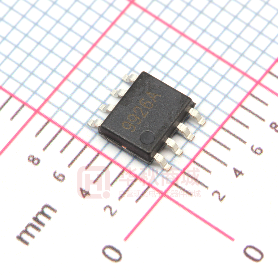

    20V/7.6A双2N功率MOSFET
AC9926 数据手册
AC9926 亚芯电子(深圳)有限公司 C B02C 20V /7.6A Dual 2N Power MOSFET 8B02C B V General Description DS RDS(on),TYP@VGS=10V RDS(on),TYP@VGS=4.5 ID 20V /7.6A Dual 2N Power MOSFET Very low on-resistance RDS(on) @ VGS=4.5 V Pb-free lead plating; RoHS compliant Part ID Package Type Marking Tape and reel infomation AC9926 SOP8 9926 3000 Parameter 20 V 18.2 mΩ 34.0 mΩ 7.6 A 100% UIS Tested 100% Rg Tested Symbol Maximum Units Drain-Source Voltage VDS 20 V Gate-Source Voltage VGS 12 ±V Continuous Drain Current A Pulsed Drain Current Avalanche Current TA=25°C TA=70°C B Power Dissipation G 12.2 IAR 2.4 EAR 5.6 TA=25°C A A mJ 2 PD TA=70°C Junction and Storage Temperature Range 6.1 IDM G Repetitive avalanche energy L=0.1mH 7.6 ID W 1.28 -55 to 150 TJ, TSTG °C Thermal Characteristics Parameter Symbol Maximum Junction-to-Ambient A t ≤ 10s Maximum Junction-to-Ambient A Steady State Maximum Junction-to-Lead www.asiachip.cn C Steady State 第 1 页,共 4 页 RθJA RθJL Typ Max Units 65 97 °C/W 130 156 °C/W 39 62 °C/W Rev0:Oct 2018 亚芯电子(深圳)有限公司 AC9926 20V /7.6A Dual 2N Power MOSFET STATIC PARAMETERS Symbol BVDSS Parameter Drain-Source Breakdown Voltage Conditions ID = -250uA, VGS = 0V IDSS Zero Gate Voltage Drain Current VDS=20V, VGS=0V IGSS Gate-Body leakage current VDS = 0V, VGS = ±20V VGS(th) Gate Threshold Voltage VDS = VGS ID = 250µA RDS(ON) Static Drain-Source OnResistance gFS VSD Min Typ Max Units 20 V 1 5 uA ±100 nA 0.8 1.1 V VGS=-10V, ID=7.6A 18.2 26.0 VGS=4.5V, ID=7.6A 34.0 52.0 Forward Transconductance VDS=5V, ID=7.6A 99 Diode Forward Voltage IS=1A,VGS=34V 0.72 0.6 S 1 V 7.6 A Typ Max Units 525 640 pF 95 116 pF 75 89 pF 1 Ω Max Units Maximum Body-Diode Continuous Current IS mΩ DYNAMIC PARAMETERS Symbol Parameter Ciss Input Capacitance Coss Output Capacitance Crss Reverse Transfer Capacitance Rg Gate resistance Conditions Min VGS=0V, VDS=15V, f=1MHz VGS=0V, VDS=0V, f=1MHz SWITCHING PARAMETERS Symbol Parameter Qg (10V) Total Gate Charge Qg 4.5V) Total Gate Charge Qgs Gate Source Charge Qgd Gate Drain Charge 2 tD(on) Turn-On DelayTime 7 tr Turn-On Rise Time tD(off) Turn-Off DelayTime tf Turn-Off Fall Time Body Diode Reverse Recovery Time trr Qrr Body Diode Reverse Recovery Charge www.asiachip.cn Conditions Min Typ 6 VGS=10V, VDS=15V, ID=7.6A VGS=10V, VDS=15V,RL=0.75Ω, RGEN=3Ω 3 1.4 5.6 19.6 nC ns 6.3 IF=-8A, dI/dt=500A/µs 14 ns IF=18A, dI/dt=500A/µs 6 nC 第 2 页,共 4 页 Rev0:Oct 2018 亚芯电子(深圳)有限公司 www.asiachip.cn 第 3 页,共 4 页 AC9926 20V /7.6A Dual 2N Power MOSFET Rev0:Oct 2018 亚芯电子(深圳)有限公司 www.asiachip.cn 第 4 页,共 4 页 AC9926 20V /7.6A Dual 2N Power MOSFET Rev0:Oct 2018
AC9926
物料型号:AC9926
器件简介:AC9926是一款20V /7.6A的双2N功率MOSFET,采用无铅铅镀层,符合RoHS标准,具有非常低的导通电阻RDS(on)。
引脚分配:文档中提供了顶视图和底视图,展示了引脚的布局。例如,S1和S2是源极,D1和D2是漏极,G1和G2是栅极。
参数特性:包括漏源电压(VDS)、栅源电压(VGS)、连续漏电流(ID)、脉冲漏电流(IDM)、雪崩电流(IAR)、重复雪崩能量(EAR)、功率耗散(PD)、结和存储温度范围(TJ,TSTG)等。
功能详解:文档提供了静态参数、动态参数和开关参数的详细描述,包括漏源击穿电压(BVDSs)、零栅电压漏电流(Ioss)、栅体漏电流(IGSS)、栅阈值电压(VGs(th))、静态漏源导通电阻(RDS(ON))、正向跨导(gFS)、二极管正向电压(VsD)等。
应用信息:文档中没有明确提供应用信息,但根据器件的特性,可以推断它适用于需要高电压和大电流的应用场景。
封装信息:AC9926采用SOP8封装,标记为9926,适用于3000的胶带和卷轴信息。
