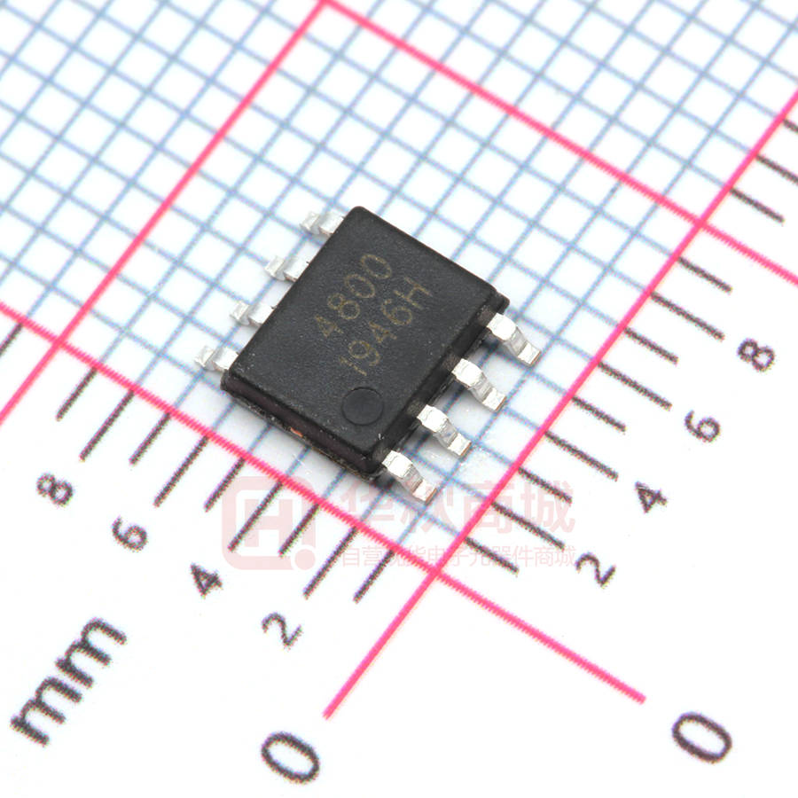

    30V/6.9A双2N功率MOSFET
AC4800 数据手册
AC4800 亚芯电子(深圳)有限公司 C B03C 30V /6.9A Dual 2N Power MOSFET 7B03C B V General Description DS RDS(on),TYP@VGS=10V RDS(on),TYP@VGS=4.5 ID 30V /6.9A Dual 2N Power MOSFET Very low on-resistance RDS(on) @ VGS=4.5 V Pb-free lead plating; RoHS compliant Part ID Package Type Marking Tape and reel infomation AC4800 SOP8 4800 3000 Parameter 30 V 22.4 mΩ 35.2 mΩ 6.9 A 100% UIS Tested 100% Rg Tested Symbol Maximum Units Drain-Source Voltage VDS 30 V Gate-Source Voltage VGS 12 ±V Continuous Drain Current A Pulsed Drain Current Avalanche Current TA=25°C TA=70°C B Power Dissipation G 11.0 IAR 2.2 EAR 5.1 TA=25°C A A mJ 2 PD TA=70°C Junction and Storage Temperature Range 5.8 IDM G Repetitive avalanche energy L=0.1mH 6.9 ID W 1.3 -55 to 150 TJ, TSTG °C Thermal Characteristics Parameter Symbol Maximum Junction-to-Ambient A t ≤ 10s Maximum Junction-to-Ambient A Steady State Maximum Junction-to-Lead www.asiachip.cn C Steady State 第 1 页,共 4 页 RθJA RθJL Typ Max Units 80 120 °C/W 160 192 °C/W 48 76 °C/W Rev0:Oct 2018 亚芯电子(深圳)有限公司 AC4800 30V /6.9A Dual 2N Power MOSFET STATIC PARAMETERS Symbol BVDSS Parameter Drain-Source Breakdown Voltage Conditions ID = -250uA, VGS = 0V IDSS Zero Gate Voltage Drain Current VDS=30V, VGS=0V IGSS Gate-Body leakage current VDS = 0V, VGS = ±20V VGS(th) Gate Threshold Voltage VDS = VGS ID = 250µA RDS(ON) Static Drain-Source OnResistance gFS VSD Min Typ Max Units 30 V 1 5 uA ±100 nA 1.1 1.5 V VGS=-10V, ID=6.9A 22.4 32.0 VGS=4.5V, ID=6.9A 35.2 45.8 Forward Transconductance VDS=5V, ID=6.9A 94 Diode Forward Voltage IS=1A,VGS=29V 0.72 0.8 S 1 V 6.9 A Typ Max Units 630 768 pF 75 92 pF 50 59 pF 0.9 Ω Max Units Maximum Body-Diode Continuous Current IS mΩ DYNAMIC PARAMETERS Symbol Parameter Ciss Input Capacitance Coss Output Capacitance Crss Reverse Transfer Capacitance Rg Gate resistance Conditions Min VGS=0V, VDS=15V, f=1MHz VGS=0V, VDS=0V, f=1MHz SWITCHING PARAMETERS Symbol Parameter Qg (10V) Total Gate Charge Qg 4.5V) Total Gate Charge Qgs Gate Source Charge Qgd Gate Drain Charge 1.8 tD(on) Turn-On DelayTime 4.25 tr Turn-On Rise Time tD(off) Turn-Off DelayTime tf Turn-Off Fall Time Body Diode Reverse Recovery Time trr Qrr Body Diode Reverse Recovery Charge www.asiachip.cn Conditions Min Typ 6 VGS=10V, VDS=15V, ID=6.9A VGS=10V, VDS=15V,RL=0.75Ω, RGEN=3Ω 3 1.26 3.4 11.9 nC ns 3.825 IF=-8A, dI/dt=500A/µs 8.5 ns IF=18A, dI/dt=500A/µs 2.6 nC 第 2 页,共 4 页 Rev0:Oct 2018 亚芯电子(深圳)有限公司 www.asiachip.cn 第 3 页,共 4 页 AC4800 30V /6.9A Dual 2N Power MOSFET Rev0:Oct 2018 亚芯电子(深圳)有限公司 www.asiachip.cn 第 4 页,共 4 页 AC4800 30V /6.9A Dual 2N Power MOSFET Rev0:Oct 2018
