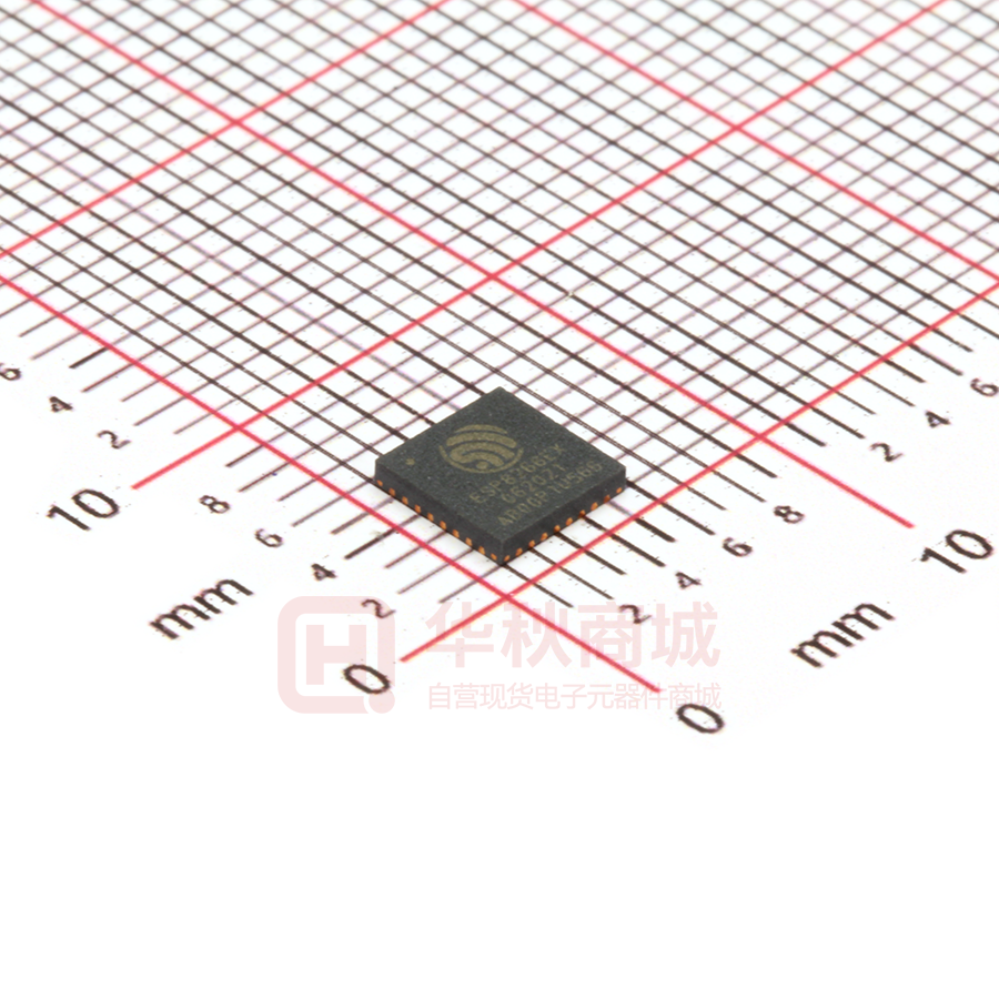

ESP8266EX
ESP8266EX
    ESPRESSIF(乐鑫)
    VFQFN32_EP
    IC RF TXRX+MCU WIFI 32QFN
