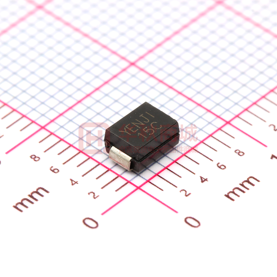

P6SMB15CA
P6SMB15CA
    YENJI(台湾元基)
    SMB(DO-214AA)
    TVS二极管 VRWM=12.8V VC=21.2V SMB Ipp=28.8 Ppp=600W
P6SMB15CA 数据手册
P6SMB Series Transient Voltage Suppressors Feature: * 600 Watt Peak Power Dissipation * Glass Passivated Die Construction * Excellent Clamping Capability Fast Response Time * Plastic Material Has UL Flammability Classification Rating 94V-O SMB(DO-214AA) Mechanical Data * Case: Transfer Molded Epoxy * Polarity: Indicator by Cathode Band (Bi-directional Devices Has no Polarity Indicator) * Terminals: Solderable per MIL-STD-202 Method 208 * Weight: 0.1grams(approx) Maximum Ratings Characteristics Symbol Value Unit P PPM 600 W Peak Pulse Current of on 10/1000us Waveform(1)(FIG3) I PPM see Table A Peak Forward Surge Current 8.3ms Single Half Sine-Wave, Superimposed on Rated Load(JEDEC Method)(3) I FSM 100 A Operating and Storage Junction Temperature Range Tj, T STG Peak Pulse Power Dissipation on 10/1000us Waveform(1)(2)(FIG1) -55 to -150 NOTE: 1. Non-Repetitive Current Pulse, per FIG3 and Derated above TA=25 C per FIG2 2 2. Mounted on 5.0mm Copper Pads to each Terminal 3. 8.3ms Single Half Sine-Wave, or equivalent Square Wave, Duty Cycle=4 pulses per minutes Maximum. 1/4 C P6SMB Series Transient Voltage Suppressors Electrical characteristics DEVICE REVERSE BREAK DOWN REVERSE TEST MAXIMUM PEAK MARKING STANDVOLTAGE CURRE CLAMPING PULSE LEAKAGE PART NUMBER OFF CODE NT VOLTAGE CURRENT @ VRWM VBR(V)(2) VOLTAGE VBR(V)(1) IT (mA) @Ipp Vc(V) Ipp (A) IR(µA)(3) UNI- POLAR BI-POLAR(1) UNI BI VRWM(V) MIN.@IT MAX.@IT P6SMB6.8A P6SMB6.8CA 6V8A 6V8C 5.80 6.45 7.14 10 10.5 58.1 1000 6.40 7.13 7.88 10 11.3 54.0 800 P6SMB7.5A P6SMB7.5CA 7V5A 7V5C P6SMB8.2A P6SMB8.2CA 8V2A 8V2C 7.02 7.79 8.61 10 12.1 50.4 200 P6SMB9.1A P6SMB9.1CA 9V1A 9V1C 7.78 8.65 9.55 10 13.4 45.5 50 10A 8.55 9.50 10.50 1 14.5 42.1 10 10C P6SMB10A P6SMB10CA 9.40 10.50 11.60 1 15.6 39.1 5 P6SMB11A P6SMB11CA 11A 11C 10.20 11.40 12.50 1 16.7 36.5 5 P6SMB12A P6SMB12CA 12A 12C P6SMB13A P6SMB13CA 13A 13C 11.10 12.40 13.70 1 18.2 33.5 5 12.80 14.30 15.80 1 21.2 28.8 5 P6SMB15A P6SMB15CA 15A 15C 13.60 15.20 16.80 1 22.5 27.1 5 P6SMB16A P6SMB16CA 16A 16C 15.30 17.10 18.90 1 25.5 24.2 5 P6SMB18A P6SMB18CA 18A 18C P6SMB20A P6SMB20CA 20A 20C 17.10 19.00 21.00 1 27.7 22.0 5 22A 18.80 20.90 23.10 1 30.6 19.9 5 22C P6SMB22A P6SMB22CA P6SMB24A P6SMB24CA 24A 24C 20.50 22.80 25.20 1 33.2 18.4 5 P6SMB27A P6SMB27CA 27A 27C 23.10 25.70 28.40 1 37.5 16.3 5 P6SMB30A P6SMB30CA 30A 30C 25.60 28.50 31.50 1 41.4 14.7 5 28.20 31.40 34.70 1 45.7 13.3 5 P6SMB33A P6SMB33CA 33A 33C P6SMB36A P6SMB36CA 36A 36C 30.80 34.20 37.80 1 49.9 12.2 5 P6SMB39A P6SMB39CA 39A 39C 33.30 37.10 41.00 1 53.9 11.3 5 P6SMB43A P6SMB43CA 43A 43C 36.80 40.90 45.20 1 59.3 10.3 5 47A 40.20 44.70 49.40 1 64.8 9.4 5 47C P6SMB47A P6SMB47CA 51A 43.60 48.50 53.60 1 70.1 8.7 5 51C P6SMB51A P6SMB51CA 47.80 53.20 58.80 1 77.0 7.9 5 P6SMB56A P6SMB56CA 56A 56C P6SMB62A P6SMB62CA 62A 62C 53.00 58.90 65.10 1 85.0 7.2 5 58.10 64.60 71.40 1 92.0 6.6 5 P6SMB68A P6SMB68CA 68A 68C 64.10 71.30 78.80 1 103.0 5.9 5 P6SMB75A P6SMB75CA 75A 75C 70.10 77.90 86.10 1 113.0 5.4 5 P6SMB82A P6SMB82CA 82A 82C 77.80 86.50 95.50 1 125.0 4.9 5 P6SMB91A P6SMB91CA 91A 91C 100A 85.50 95.00 105.00 1 137.0 4.5 5 100C P6SMB100A P6SMB100CA 110A 94.00 105.00 116.00 1 152.0 4.0 5 110C P6SMB110A P6SMB110CA 114.00 126.00 1 165.0 3.7 5 P6SMB120A P6SMB120CA 120A 120C 102.00 P6SMB130A P6SMB130CA 130A 130C 111.00 124.00 137.00 1 179.0 3.4 5 143.00 158.00 1 207.0 2.9 5 P6SMB150A P6SMB150CA 150A 150C 128.00 152.00 168.00 1 219.0 2.8 5 P6SMB160A P6SMB160CA 160A 160C 136.00 P6SMB170A P6SMB170CA 170A 170C 145.00 162.00 179.00 1 234.0 2.6 5 P6SMB180A P6SMB180CA 180A 180C 154.00 171.00 189.00 1 246.0 2.5 5 200A 171.00 190.00 210.00 1 274.0 2.2 5 200C P6SMB200A P6SMB200CA 220A 185.00 209.00 231.00 1 328.0 1.9 5 220C P6SMB220A P6SMB220CA 237.00 263.00 1 344.0 1.8 5 P6SMB250A P6SMB250CA 250A 250C 214.00 P6SMB300A P6SMB300CA 300A 300C 256.00 285.00 315.00 1 414.0 1.5 5 332.00 368.00 1 482.0 1.3 5 P6SMB350A P6SMB350CA 350A 350C 300.00 380.00 420.00 1 548.0 1.1 5 P6SMB400A P6SMB400CA 400A 400C 342.00 P6SMB440A P6SMB440CA 440A 440C 376.00 418.00 462.00 1 602.0 1.0 5 P6SMB480A P6SMB480CA 480A 480C 408.00 456.00 504.00 1 658.0 0.9 5 485.00 535.00 1 698.0 5 P6SMB510A P6SMB510CA 510A 510C 434.00 0.9 5 P6SMB530A P6SMB530CA 530A 530C 450.00 503.50 556.50 1 725.0 0.8 5 1 P6SMB540A P6SMB540CA 540A 540C 459.00 740.0 0.8 513.00 567.00 5 1 0.8 P6SMB550A P6SMB550CA 550A 550C 467.00 522.50 577.50 760.0 NOTE: 1. Suffix C denotes Bi-direction device, Suffix A denotes the VBRis + 5% for parts without A , the VBR is + 10%. 2. VBR messured with I T Current pulse=300us. 3. For bidirectional type having Vrwm of 10 volts and less, the IR limit is double. P6SMB 2/4 P6SMB Series Transient Voltage Suppressors Ratings and Characteristic Curves P eak P uls e P ower (P P P ) or C urrent (I P P ) Derating in P ercentage, % P P P M — P eak P uls e P ower (kW) 100 10 1 0.2 x 0.2" (0.5 x 0.5mm) C opper P ad Areas 0.1 0.1 s 1.0 s 10 s 100 s 1.0ms 10ms 100 75 50 25 0 0 td — P uls e Width (s ec.) 100 6,000 T J = 25 C P uls e Width (td) is defined as the point where the peak current decays to 50% of I P P M tr = 10 u s ec. P eak Value IP P M 100 C J — J unction C apacitance (pF ) I P P M — P eak P uls e C urrent, % I R S M 75 Half Value — IP P 2 IP P M 50 10/1000 s ec. Waveform as defined by R .E .A. 1.0 3.0 2.0 1 100 200 FIG. 4 - Typical Junction Capacitance I F S M — P eak F orward S urge C urrent (A) 1.0 10 10 V WM — R evers e S tand-Off Voltage (V ) 10 1 T J = 25 C f = 1.0MHz V s ig = 50mV p-p Uni-Directional B i-Directional 10 4.0 100 0.1 200 V R , Meas ured at S tand-Off Voltage, V WM 100 t — Time (ms ) 0.01 175 1,000 FIG. 3- Pulse Wavef orm 0.1 0.001 150 Meas ured at Zero B ias td 0 125 FIG. 2- Pulse Derating Curve 150 Trans ient T hermal Impedance ( C /W) 50 T A — Ambient Temperature ( C ) FIG. 1- Peak Pulse Power Rating Curve 0 25 100 1000 200 8.3ms S ingle Half S ine-Wave (J E DE C Method) Unidirectional Only 100 10 1 1 0 Number of C ycles at 60H Z tp — P uls e Duration (s ec) FIG. 6 - Maximum Non-Repetitive Peak Forward Surge Current FIG. 5 - Typical Transient Thermal Impedance 3/4 100 P6SMB Series Transient Voltage Suppressors SMB Outline Dimension Unit:mm SMB Min Max A 3.30 3.94 B 4.06 1.96 0.15 4.80 2.21 0.31 5.00 0.10 5.59 0.20 0.76 1.52 2.00 2.62 Dim C D E G H J 4/4
