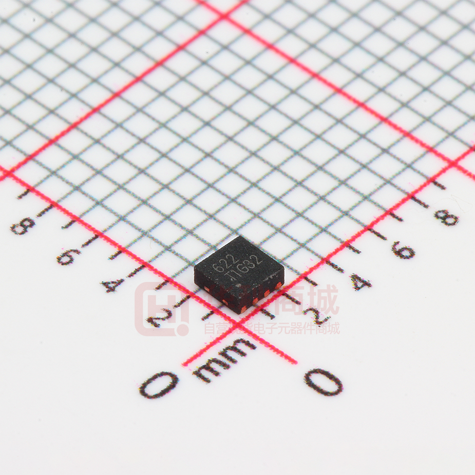

    TDFN8L_2X2MM_EP
    通用放大器 TDFN8L_2X2MM_EP 2通道 7MHz 3.7V/µs
RS622XTDE8 数据手册
RS621S, RS622S RS621, RS622, RS624 7MHz, Rail-to-Rail I/O CMOS Operational Amplifier FEATURES DESCRIPTION  HIGH GAIN BANDWIDTH:7MHz  RAIL-TO-RAIL INPUT AND OUTPUT 0.7mV Typical Vos INPUT VOLTAGE RANGE: -0.1V to +5.6V with Vs = 5.5V   SUPPLY RANGE: +2.5V to +5.5V   SHUTDOWN: RS621S/RS622S SPECIFIED UP TO +125°C  MicroSIZE The RS62X families of products offer low voltage operation and rail-to-rail input and output, as well as excellent speed/power consumption ratio, providing an excellent bandwidth (7MHz) and slew rate of 3.7V/us. The op-amps are unity gain stable and feature an ultra-low input bias current. The devices are ideal for sensor interfaces, active filters and portable applications. The RS621S, RS622S include a shutdown mode. Under logic control, the amplifiers can be switched from normal operation to a standby current that is less than 1uA.The RS62X families of operational amplifiers are specified at the full temperature range of −40°C to +125°C under single or dual power supplies of 2.5V to 5.5V. PACKAGES: SOT23-5, SOT23-6 APPLICATIONS  SENSORS  PHOTODIODE AMPLIFICATION   ACTIVE FILTERS TEST EQUIPMENT  DRIVING A/D CONVERTERS PIN CONFIGURATIONS +IN 3 + - 4 -IN 6 1 V- 2 +IN 3 + - NC V+ 5 EN -IN 2 4 -IN +IN 3 V- 8 1 NC 7 V+ 6 OUT 5 4 OUT A 2 - +IN A 3 V- 4 En A 5 NC V+ 9 OUT B - 8 -IN B 7 +IN B 6 En B 14 OUT D 13 -IN D 1 -IN A SOT23-6 SOT23-5 10 + 2 OUT + V- V+ - 5 1 RS621 + OUT RS622S RS621S RS621 A B SOIC-8,MSOP-8 MSOP-10 RS621B V+ 1 -IN 2 + NC V- - IN 2 - 3 4 OUT +IN 3 V- 4 8 + 5 1 - + IN RS624 RS622 RS621S 7 EN V+ 6 OUT 5 NC OUT A -IN A 2 +IN A 3 SOT23-5 V- 8 1 + A B+ 4 7 OUTB 6 -IN B 5 SOIC-8 SOIC-8,MSOP-8,TSSOP-8, TDFN2x2-8L,TDFN3x3-8L Note: NC indicates no internal connection V+ +IN B OUT A 1 -IN A 2 +IN A 3 12 +IN D V+ 4 11 V- +IN B 5 10 +IN C -IN B 6 9 -IN C OUT B 7 8 OUT C A - + - + B D + - + C SOIC-14,TSSOP-14, TDFN3x2-14L REV B.5 1 www.run-ic.com RS621S, RS622S RS621, RS622, RS624 ABSOLUTE MAXIMUM RATINGS (1) Supply Voltage, V+ to V-...............................................7.0V (2) Input Terminals, Voltage …………... – 0.5 to (V+) + 0.5V (2) Current …………………....…..... ±10mA Storage Temperature ……….…………… −65°C to +150°C Operating Temperature ……….………… −40°C to +125°C Junction Temperature................................................150°C Package Thermal Resistance @ TA = +25°C SOT23-5, SOT23-6………………….………………200°C/W MSOP-10, SOIC-8 ,TSSOP-8……….………….... 150°C/W SOIC-14, TSSOP-14………….……….……………100°C/W Lead Temperature (Soldering, 10s) ……………........260°C ESD Susceptibility HBM …......................................................................5000V MM ……………………….........………………...……….400V ESD SENSITIVITY CAUTION ESD damage can range from subtle performance degradation to complete device failure. Precision integrated circuits may be more susceptible to damage because very small parametric changes could cause the device not to meet its published specifications. (1) Stresses above these ratings may cause permanent damage. Exposure to absolute maximum conditions for extended periods may degrade device reliability. These are stress ratings only, and functional operation of the device at these or any other conditions beyond those specified is not implied. (2) Input terminals are diode-clamped to the power-supply rails. Input signals that can swing more than 0.5V beyond the supply rails should be current-limited to 10mA or less. PACKAGE/ORDERING INFORMATION PRODUCT RS621 RS621S RS622 RS622S RS624 TEMPERATURE PACKAGE PACKAGE RANGE LEAD MARKING RS621XK -40℃~125℃ SOIC-8 RS621 Tape and Reel,2500 RS621XF -40℃~125℃ SOT23-5 621 Tape and Reel,3000 RS621BXF -40℃~125℃ SOT23-5 621B Tape and Reel,3000 RS621XM -40℃~125℃ MSOP-8 RS621 Tape and Reel,3000 RS621SXK -40℃~125℃ SOIC-8 RS621S Tape and Reel,2500 RS621SXH -40℃~125℃ SOT23-6 621S Tape and Reel,3000 RS622XK -40℃~125℃ SOIC-8 RS622 Tape and Reel,2500 RS622XM -40℃~125℃ MSOP-8 RS622 Tape and Reel,3000 RS622XTDE8 -40℃~125℃ TDFN2x2-8L RS622 Tape and Reel,3000 RS622XTDC8 -40℃~125℃ TDFN3x3-8L RS622 Tape and Reel,3000 RS622XQ -40℃~125℃ TSSOP-8 RS622 Tape and Reel,3000 RS622SXN -40℃~125℃ MSOP-10 RS622S Tape and Reel,3000 RS624XP -40℃~125℃ SOIC-14 RS624 Tape and Reel,2500 RS624XQ -40℃~125℃ TSSOP-14 RS624 Tape and Reel,3000 RS624XTDB14 -40℃~125℃ TDFN3x2-14L RS624 Tape and Reel,3000 ORDERING NUMBER 2 PACKAGE OPTION www.run-ic.com RS621S, RS622S RS621, RS622, RS624 ELECTRICAL CHARACTERISTICS (At TA = +25C, Vs=5V, RL = 10kΩ connected to VS/2, and VOUT = VS/2, unless otherwise noted.) PARAMETER CONDITIONS TJ RS621S,RS622S, RS621,RS622,RS624 MIN TYP MAX UNIT 5.5 V 600 800 uA POWER SUPPLY Vs IQ 25°C Operating Voltage Range Quiescent Current/Amplifier PSRR Power-Supply Rejection Ratio 2.5 25°C 25°C Vs= 2.5V to 5.5V Vcm =(V-)+0.5V –40°C to 125°C 78 93 dB 72 INPUT Vos Input Offset Voltage 25°C Vos TC Input Offset Voltage Average Drift -40°C to 125°C IB Input Bias Current Ios Input Offset Current Vcm Common-Mode Voltage Range CMRR Common-Mode Rejection Ratio 0.7 3 mV 2 uV/°C 25°C 1 10 pA 25°C 1 10 pA 5.6 V Vs=5.5V 25°C -0.1 Vs = 5.5V, Vcm =-0.1V to 4V 25°C 74 –40°C to 125°C 68 Vs = 5.5V, Vcm = -0.1V to 5.6V 25°C 62 –40°C to 125°C 60 RL =2KΩ, Vo = 0.15V to 4.85V 25°C 96 –40°C to 125°C 83 25°C RL = 10kΩ, Vo = 0.05V to 4.95V –40°C to 125°C 98 92 dB 83 OUTPUT AOL Open-Loop Voltage Gain dB 106 85 25°C 25°C 40 7 mV 25°C 50 mA Slew Rate Gain-Bandwidth Product 25°C 3.7 V/us 25°C 7 MHz Phase Margin 25°C 64 ° 0.5 us 0.5 us Output Swing From Rail Iout RL = 2KΩ RL = 10kΩ 102 Output Short-Circuit Current FREQUENCY RESPONSE SR GBP Φm ts Settling Time, 0.1% Overload Recovery Time V IN • Gain ≥ V s NOISE en Input-Referred Voltage Noise f = 1 kHz 25°C 11 nV/√Hz f = 10 kHz 25°C 7.5 nV/√Hz ENABLE/SHUTDOWN(RS621S,RS622S) IQ(OFF) Supply Current in Shutdown 25°C
