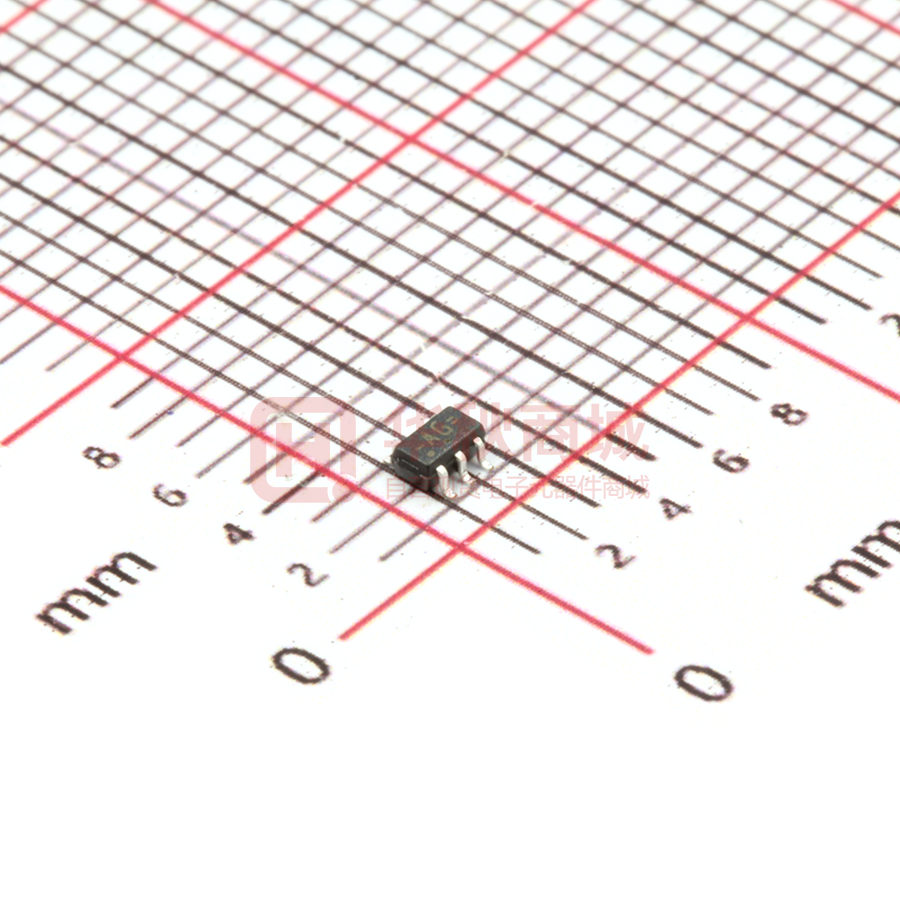

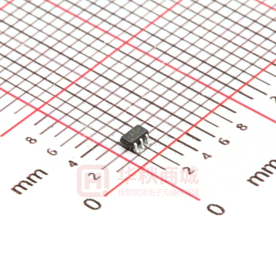

74AHC1G32; 74AHCT1G32 2-input OR gate Rev. 8 — 18 November 2014 Product data sheet 1. General description 74AHC1G32 and 74AHCT1G32 are high-speed Si-gate CMOS devices. They provide a 2-input OR function. The AHC device has CMOS input switching levels and supply voltage range 2 V to 5.5 V. The AHCT device has TTL input switching levels and supply voltage range 4.5 V to 5.5 V. 2. Features and benefits  Symmetrical output impedance  High noise immunity  ESD protection:  HBM JESD22-A114E: exceeds 2000 V  MM JESD22-A115-A: exceeds 200 V  CDM JESD22-C101C: exceeds 1000 V  Low power dissipation  Balanced propagation delays  SOT353-1 and SOT753 package options  Specified from 40 C to +125 C 3. Ordering information Table 1. Ordering information Type number 74AHC1G32GW Package Temperature range Name Description Version 40 C to +125 C TSSOP5 plastic thin shrink small outline package; 5 leads; body width 1.25 mm SOT353-1 40 C to +125 C SC-74A plastic surface-mounted package; 5 leads SOT753 74AHCT1G32GW 74AHC1G32GV 74AHCT1G32GV 74AHC1G32; 74AHCT1G32 Nexperia 2-input OR gate 4. Marking Table 2. Marking codes Type number Marking code[1] 74AHC1G32GW AG 74AHCT1G32GW CG 74AHC1G32GV A32 74AHCT1G32GV C32 [1] The pin 1 indicator is located on the lower left corner of the device, below the marking code. 5. Functional diagram  %  $ <    PQD PQD Fig 1. •  Logic symbol Fig 2. IEC logic symbol % < $ PQD Fig 3. Logic diagram 6. Pinning information 6.1 Pinning $+&* $+&7* %  $  *1'   9&&  < DDN Fig 4. Pin configuration SOT353-1 (TSSOP5) and SOT753 (SC-74A) 74AHC_AHCT1G32 Product data sheet All information provided in this document is subject to legal disclaimers. Rev. 8 — 18 November 2014 © Nexperia B.V. 2017. All rights reserved 2 of 13 74AHC1G32; 74AHCT1G32 Nexperia 2-input OR gate 6.2 Pin description Table 3. Pin description Symbol Pin Description B 1 data input A 2 data input GND 3 ground (0 V) Y 4 data output VCC 5 supply voltage 7. Functional description Table 4. Function table H = HIGH voltage level; L = LOW voltage level Inputs Output A B Y L L L L H H H L H H H H 8. Limiting values Table 5. Limiting values In accordance with the Absolute Maximum Rating System (IEC 60134). Symbol Parameter VCC Conditions Min Max Unit supply voltage 0.5 +7.0 V VI input voltage 0.5 +7.0 V 20 - mA - 20 mA - 25 mA IIK input clamping current VI < 0.5 V IOK output clamping current VO < 0.5 V or VO > VCC + 0.5 V IO output current 0.5 V < VO < VCC + 0.5 V ICC supply current - 75 mA IGND ground current 75 - mA Tstg storage temperature 65 +150 C - 250 mW total power dissipation Ptot Tamb = 40 C to +125 C [1] [2] [1] The input and output voltage ratings may be exceeded if the input and output current ratings are observed. [2] For both TSSOP5 and SC-74A packages: above 87.5 C the value of Ptot derates linearly with 4.0 mW/K. 74AHC_AHCT1G32 Product data sheet All information provided in this document is subject to legal disclaimers. Rev. 8 — 18 November 2014 © Nexperia B.V. 2017. All rights reserved 3 of 13 74AHC1G32; 74AHCT1G32 Nexperia 2-input OR gate 9. Recommended operating conditions Table 6. Recommended operating conditions Voltages are referenced to GND (ground = 0 V). Symbol Parameter Conditions 74AHC1G32 Min Typ 74AHCT1G32 Max Min Typ Unit Max VCC supply voltage 2.0 5.0 5.5 4.5 5.0 5.5 V VI input voltage 0 - 5.5 0 - 5.5 V VO output voltage 0 - VCC 0 - VCC V Tamb ambient temperature 40 +25 +125 40 +25 +125 C t/V input transition rise and fall rate VCC = 3.3 V  0.3 V - - 100 - - - ns/V VCC = 5.0 V  0.5 V - - 20 - - 20 ns/V 10. Static characteristics Table 7. Static characteristics Voltages are referenced to GND (ground = 0 V). Symbol Parameter 25 C Conditions 40 C to +85 C 40 C to +125 C Unit Min Typ Max Min Max Min Max VCC = 2.0 V 1.5 - - 1.5 - 1.5 - V VCC = 3.0 V 2.1 - - 2.1 - 2.1 - V VCC = 5.5 V 3.85 - - 3.85 - 3.85 - V VCC = 2.0 V - - 0.5 - 0.5 - 0.5 V VCC = 3.0 V - - 0.9 - 0.9 - 0.9 V VCC = 5.5 V - - 1.65 - 1.65 - 1.65 V HIGH-level VI = VIH or VIL output voltage IO = 50 A; VCC = 2.0 V 1.9 2.0 - 1.9 - 1.9 - V IO = 50 A; VCC = 3.0 V 2.9 3.0 - 2.9 - 2.9 - V IO = 50 A; VCC = 4.5 V 4.4 4.5 - 4.4 - 4.4 - V IO = 4.0 mA; VCC = 3.0 V 2.58 - - 2.48 - 2.40 - V IO = 8.0 mA; VCC = 4.5 V For type 74AHC1G32 VIH VIL VOH VOL HIGH-level input voltage LOW-level input voltage 3.94 - - 3.8 - 3.70 - V LOW-level VI = VIH or VIL output voltage IO = 50 A; VCC = 2.0 V - 0 0.1 - 0.1 - 0.1 V IO = 50 A; VCC = 3.0 V - 0 0.1 - 0.1 - 0.1 V IO = 50 A; VCC = 4.5 V - 0 0.1 - 0.1 - 0.1 V IO = 4.0 mA; VCC = 3.0 V - - 0.36 - 0.44 - 0.55 V IO = 8.0 mA; VCC = 4.5 V - - 0.36 - 0.44 - 0.55 V - - 0.1 - 1.0 - 2.0 A II input leakage current ICC supply current VI = VCC or GND; IO = 0 A; VCC = 5.5 V - - 1.0 - 10 - 40 A CI input capacitance - 1.5 10 - 10 - 10 pF 74AHC_AHCT1G32 Product data sheet VI = 5.5 V or GND; VCC = 0 V to 5.5 V All information provided in this document is subject to legal disclaimers. Rev. 8 — 18 November 2014 © Nexperia B.V. 2017. All rights reserved 4 of 13 74AHC1G32; 74AHCT1G32 Nexperia 2-input OR gate Table 7. Static characteristics …continued Voltages are referenced to GND (ground = 0 V). Symbol Parameter 25 C Conditions 40 C to +85 C 40 C to +125 C Unit Min Typ Max Min Max Min Max For type 74AHCT1G32 VIH HIGH-level input voltage VCC = 4.5 V to 5.5 V 2.0 - - 2.0 - 2.0 - V VIL LOW-level input voltage VCC = 4.5 V to 5.5 V - - 0.8 - 0.8 - 0.8 V VOH HIGH-level VI = VIH or VIL; VCC = 4.5 V output voltage IO = 50 A 4.4 4.5 - 4.4 - 4.4 - V 3.94 - - 3.8 - 3.70 - V IO = 8.0 mA VOL LOW-level VI = VIH or VIL; VCC = 4.5 V output voltage IO = 50 A IO = 8.0 mA VI = 5.5 V or GND; VCC = 0 V to 5.5 V - 0 0.1 - 0.1 - 0.1 V - - 0.36 - 0.44 - 0.55 V - - 0.1 - 1.0 - 2.0 A II input leakage current ICC supply current VI = VCC or GND; IO = 0 A; VCC = 5.5 V - - 1.0 - 10 - 40 A ICC additional per input pin; VI = 3.4 V; supply current other inputs at VCC or GND; IO = 0 A; VCC = 5.5 V - - 1.35 - 1.5 - 1.5 mA CI input capacitance - 1.5 10 - 10 - 10 pF 11. Dynamic characteristics Table 8. Dynamic characteristics GND = 0 V; tr = tf =  3.0 ns. For waveform see Figure 5. For test circuit see Figure 6. Symbol Parameter 25 C Conditions Min Typ 40 C to +85 C 40 C to +125 C Unit Max Min Max Min Max For type 74AHC1G32 tpd propagation delay [1] A and B to Y VCC = 3.0 V to 3.6 V [2] CL = 15 pF - 4.4 7.9 1.0 9.5 1.0 10.0 ns CL = 50 pF - 6.3 11.4 1.0 13.0 1.0 14.5 ns - 3.2 5.5 1.0 6.5 1.0 7.0 ns - 4.6 7.5 1.0 8.5 1.0 9.5 ns - 16 - - - - - pF VCC = 4.5 V to 5.5 V [3] CL = 15 pF CL = 50 pF CPD power dissipation capacitance 74AHC_AHCT1G32 Product data sheet per buffer; CL = 50 pF; f = 1 MHz; VI = GND to VCC [4] All information provided in this document is subject to legal disclaimers. Rev. 8 — 18 November 2014 © Nexperia B.V. 2017. All rights reserved 5 of 13 74AHC1G32; 74AHCT1G32 Nexperia 2-input OR gate Table 8. Dynamic characteristics …continued GND = 0 V; tr = tf =  3.0 ns. For waveform see Figure 5. For test circuit see Figure 6. Symbol Parameter 25 C Conditions 40 C to +85 C 40 C to +125 C Unit Min Typ Max Min Max Min Max - 3.3 6.9 1.0 8.0 1.0 9.0 ns - 4.8 7.9 1.0 9.0 1.0 10 ns - 17 - - - - - pF For type 74AHCT1G32 propagation delay tpd [1] A and B to Y VCC = 4.5 V to 5.5 V [3] CL = 15 pF CL = 50 pF power dissipation capacitance CPD per buffer; CL = 50 pF; f = 1 MHz; VI = GND to VCC [1] tpd is the same as tPLH and tPHL. [2] Typical values are measured at VCC = 3.3 V. [4] [3] Typical values are measured at VCC = 5.0 V. [4] CPD is used to determine the dynamic power dissipation PD (W). PD = CPD  VCC2  fi +  (CL  VCC2  fo) where: fi = input frequency in MHz; fo = output frequency in MHz; CL = output load capacitance in pF; VCC = supply voltage in Volts. 12. Waveforms $%LQSXW  90 W3+/
