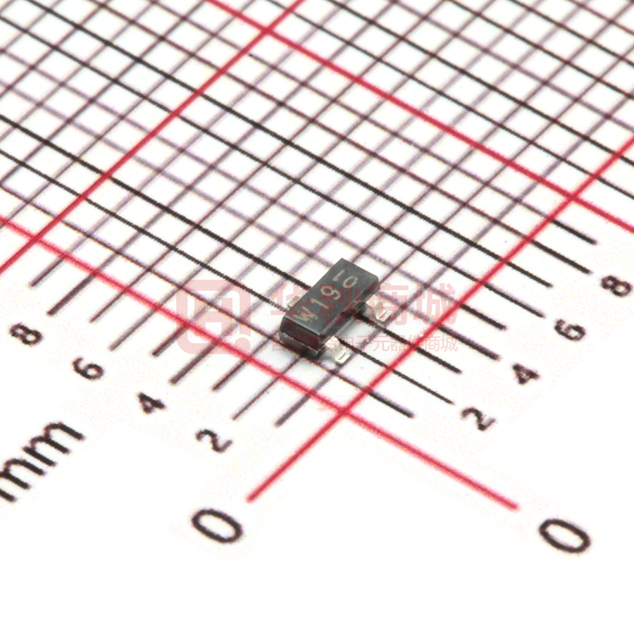

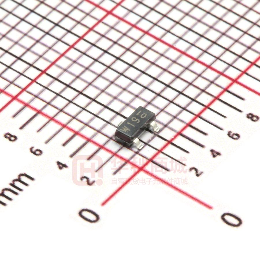

PDTA143Z series PNP resistor-equipped transistors; R1 = 4.7 k, R2 = 47 k Rev. 7 — 5 December 2011 Product data sheet 1. Product profile 1.1 General description PNP Resistor-Equipped Transistor (RET) family in Surface-Mounted Device (SMD) plastic packages. Table 1. Product overview Type number Package Nexperia JEITA JEDEC NPN complement PDTA143ZE SOT416 SC-75 - PDTC143ZE ultra small PDTA143ZM SOT883 SC-101 - PDTC143ZM leadless ultra small PDTA143ZT SOT23 - TO-236AB PDTC143ZT small PDTA143ZU SOT323 SC-70 - very small PDTC143ZU Package configuration 1.2 Features and benefits  100 mA output current capability  Built-in bias resistors  Simplifies circuit design  Reduces component count  Reduces pick and place costs  AEC-Q101 qualified 1.3 Applications  Digital applications in automotive and industrial segments  Control of IC inputs  Cost-saving alternative for BC847/857 series in digital applications  Switching loads 1.4 Quick reference data Table 2. Quick reference data Symbol Parameter Conditions Min Typ Max Unit VCEO collector-emitter voltage open base - - 50 V IO output current - - 100 mA R1 bias resistor 1 (input) 3.3 4.7 6.1 k R2/R1 bias resistor ratio 8 10 12 PDTA143Z series Nexperia PNP resistor-equipped transistors; R1 = 4.7 k, R2 = 47 k 2. Pinning information Table 3. Pinning Pin Description Simplified outline Graphic symbol SOT23; SOT323; SOT416 1 input (base) 2 GND (emitter) 3 3 3 R1 output (collector) 1 R2 1 2 2 006aaa144 sym003 SOT883 1 input (base) 2 GND (emitter) 3 1 3 3 R1 2 output (collector) 1 Transparent top view R2 2 sym003 3. Ordering information Table 4. Ordering information Type number Package Name Description Version PDTA143ZE SC-75 plastic surface-mounted package; 3 leads SOT416 PDTA143ZM SC-101 leadless ultra small plastic package; 3 solder lands; SOT883 body 1.0  0.6  0.5 mm PDTA143ZT - plastic surface-mounted package; 3 leads SOT23 PDTA143ZU SC-70 plastic surface-mounted package; 3 leads SOT323 4. Marking Table 5. Type number Marking code[1] PDTA143ZE 37 PDTA143ZM DP PDTA143ZT *19 PDTA143ZU *47 [1] PDTA143Z_SER Product data sheet Marking codes * = placeholder for manufacturing site code All information provided in this document is subject to legal disclaimers. Rev. 7 — 5 December 2011 © Nexperia B.V. 2017. All rights reserved 2 of 17 PDTA143Z series Nexperia PNP resistor-equipped transistors; R1 = 4.7 k, R2 = 47 k 5. Limiting values Table 6. Limiting values In accordance with the Absolute Maximum Rating System (IEC 60134). Symbol Parameter Conditions Min Max Unit VCBO collector-base voltage open emitter - 50 V VCEO collector-emitter voltage open base - 50 V VEBO emitter-base voltage open collector - 5 V VI input voltage - +5 V positive PDTA143Z_SER Product data sheet negative - 30 V IO output current - 100 mA ICM peak collector current single pulse; tp  1 ms - 100 mA Ptot total power dissipation Tamb  25 C PDTA143ZE (SOT416) [1][2] - 150 mW PDTA143ZM (SOT883) [2][3] - 250 mW PDTA143ZT (SOT23) [1] - 250 mW PDTA143ZU (SOT323) [1] - 200 mW Tj junction temperature - 150 C Tamb ambient temperature 65 +150 C Tstg storage temperature 65 +150 C [1] Device mounted on an FR4 Printed-Circuit Board (PCB), single-sided copper, tin-plated and standard footprint. [2] Reflow soldering is the only recommended soldering method. [3] Device mounted on an FR4 PCB with 70 m copper strip line, standard footprint. All information provided in this document is subject to legal disclaimers. Rev. 7 — 5 December 2011 © Nexperia B.V. 2017. All rights reserved 3 of 17 PDTA143Z series Nexperia PNP resistor-equipped transistors; R1 = 4.7 k, R2 = 47 k 006aac778 300 Ptot (mW) (1) (2) 200 (3) 100 0 -75 -25 25 75 125 175 Tamb (°C) (1) SOT23; FR4 PCB, standard footprint SOT883; FR4 PCB with 70 m copper strip line, standard footprint (2) SOT323; FR4 PCB, standard footprint (3) SOT416; FR4 PCB, standard footprint Fig 1. Power derating curves 6. Thermal characteristics Table 7. PDTA143Z_SER Product data sheet Thermal characteristics Symbol Parameter Conditions Rth(j-a) thermal resistance from junction to ambient in free air Min Typ Max Unit PDTA143ZE (SOT416) [1][2] - - 830 K/W PDTA143ZM (SOT883) [2][3] - - 500 K/W PDTA143ZT (SOT23) [1] - - 500 K/W PDTA143ZU (SOT323) [1] - - 625 K/W [1] Device mounted on an FR4 PCB, single-sided copper, tin-plated and standard footprint. [2] Reflow soldering is the only recommended soldering method. [3] Device mounted on an FR4 PCB with 70 m copper strip line, standard footprint. All information provided in this document is subject to legal disclaimers. Rev. 7 — 5 December 2011 © Nexperia B.V. 2017. All rights reserved 4 of 17 PDTA143Z series Nexperia PNP resistor-equipped transistors; R1 = 4.7 k, R2 = 47 k 006aac781 103 duty cycle = 1 Zth(j-a) (K/W) 0.75 0.5 0.33 0.2 102 0.1 0.05 0.02 10 0.01 0 1 10-5 10-4 10-3 10-2 10-1 1 10 102 103 tp (s) FR4 PCB, standard footprint Fig 2. Transient thermal impedance from junction to ambient as a function of pulse duration for PDTA143ZE (SOT416); typical values 006aac782 103 Zth(j-a) (K/W) duty cycle = 1 0.75 0.5 102 0.33 0.2 0.1 0.05 10 0.02 0.01 0 1 10-5 10-4 10-3 10-2 10-1 1 10 102 103 tp (s) FR4 PCB, 70 m copper strip line Fig 3. Transient thermal impedance from junction to ambient as a function of pulse duration for PDTA143ZM (SOT883); typical values PDTA143Z_SER Product data sheet All information provided in this document is subject to legal disclaimers. Rev. 7 — 5 December 2011 © Nexperia B.V. 2017. All rights reserved 5 of 17 PDTA143Z series Nexperia PNP resistor-equipped transistors; R1 = 4.7 k, R2 = 47 k 006aac779 103 duty cycle = 1 Zth(j-a) (K/W) 0.75 0.5 0.33 102 0.2 0.1 0.05 0.02 10 0.01 0 1 10-5 10-4 10-3 10-2 10-1 1 10 102 103 tp (s) FR4 PCB, standard footprint Fig 4. Transient thermal impedance from junction to ambient as a function of pulse duration for PDTA143ZT (SOT23); typical values 006aac780 103 duty cycle = 1 Zth(j-a) (K/W) 0.75 0.5 0.33 102 0.2 0.1 0.05 0.02 10 0.01 0 1 10-5 10-4 10-3 10-2 10-1 1 10 102 103 tp (s) FR4 PCB, standard footprint Fig 5. Transient thermal impedance from junction to ambient as a function of pulse duration for PDTA143ZU (SOT323); typical values PDTA143Z_SER Product data sheet All information provided in this document is subject to legal disclaimers. Rev. 7 — 5 December 2011 © Nexperia B.V. 2017. All rights reserved 6 of 17 PDTA143Z series Nexperia PNP resistor-equipped transistors; R1 = 4.7 k, R2 = 47 k 7. Characteristics Table 8. Characteristics Tamb = 25 C unless otherwise specified. Symbol Parameter PDTA143Z_SER Product data sheet Conditions Min Typ Max Unit ICBO collector-base cut-off current VCB = 50 V; IE = 0 A - - 100 nA ICEO collector-emitter cut-off current VCE = 30 V; IB = 0 A - - 1 A VCE = 30 V; IB = 0 A; Tj = 150 C - - 5 A IEBO emitter-base cut-off current VEB = 5 V; IC = 0 A - - 170 A hFE DC current gain VCE = 5 V; IC = 10 mA 100 - - VCEsat collector-emitter saturation voltage IC = 5 mA; IB = 0.25 mA - - 100 mV VI(off) off-state input voltage VCE = 5 V; IC = 100 A - 0.6 0.5 V VI(on) on-state input voltage VCE = 0.3 V; IC = 5 mA 1.3 0.9 - V R1 bias resistor 1 (input) 3.3 4.7 6.1 k 8 10 12 - - 3 pF - 180 - MHz R2/R1 bias resistor ratio Cc collector capacitance VCB = 10 V; IE = ie = 0 A; f = 1 MHz fT transition frequency VCE = 5 V; IC = 10 mA; f = 100 MHz [1] Characteristics of built-in transistor All information provided in this document is subject to legal disclaimers. Rev. 7 — 5 December 2011 [1] © Nexperia B.V. 2017. All rights reserved 7 of 17 PDTA143Z series Nexperia PNP resistor-equipped transistors; R1 = 4.7 k, R2 = 47 k 006aac824 103 hFE 006aac825 -1 (1) VCEsat (V) (2) (3) 102 -10-1 (1) 10 (2) (3) 1 -10-1 -1 -102 -10 -10-2 -10-1 -1 -102 -10 IC (mA) IC (mA) VCE = 5 V IC/IB = 20 (1) Tamb = 100 C (1) Tamb = 100 C (2) Tamb = 25 C (2) Tamb = 25 C (3) Tamb = 40 C (3) Tamb = 40 C Fig 6. DC current gain as a function of collector current; typical values Fig 7. 006aac826 -10 Collector-emitter saturation voltage as a function of collector current; typical values 006aac827 -10 VI(off) (V) VI(on) (V) (1) -1 -1 (2) (1) (2) (3) (3) -10-1 -10-1 -1 -102 -10 -10-1 -10-1 IC (mA) VCE = 0.3 V VCE = 5 V (1) Tamb = 40 C (2) Tamb = 25 C (2) Tamb = 25 C (3) Tamb = 100 C (3) Tamb = 100 C On-state input voltage as a function of collector current; typical values PDTA143Z_SER Product data sheet -10 IC (mA) (1) Tamb = 40 C Fig 8. -1 Fig 9. Off-state input voltage as a function of collector current; typical values All information provided in this document is subject to legal disclaimers. Rev. 7 — 5 December 2011 © Nexperia B.V. 2017. All rights reserved 8 of 17 PDTA143Z series Nexperia PNP resistor-equipped transistors; R1 = 4.7 k, R2 = 47 k 006aac828 8 006aac763 103 Cc (pF) fT (MHz) 6 102 4 2 0 0 -10 -20 -30 -40 -50 VCB (V) f = 1 MHz; Tamb = 25 C 10 -10-1 -1 -102 -10 IC (mA) VCE = 5 V; Tamb = 25 C Fig 10. Collector capacitance as a function of collector-base voltage; typical values Fig 11. Transition frequency as a function of collector current; typical values of built-in transistor 8. Test information 8.1 Quality information This product has been qualified in accordance with the Automotive Electronics Council (AEC) standard Q101 - Stress test qualification for discrete semiconductors, and is suitable for use in automotive applications. PDTA143Z_SER Product data sheet All information provided in this document is subject to legal disclaimers. Rev. 7 — 5 December 2011 © Nexperia B.V. 2017. All rights reserved 9 of 17 PDTA143Z series Nexperia PNP resistor-equipped transistors; R1 = 4.7 k, R2 = 47 k 9. Package outline 0.62 0.55 0.55 0.47 0.95 0.60 1.8 1.4 3 0.45 0.15 0.50 0.46 3 0.30 0.22 1.75 0.9 1.45 0.7 1.02 0.95 0.65 1 0.30 0.22 2 0.30 0.15 0.25 0.10 2 1 0.20 0.12 1 0.35 Dimensions in mm 04-11-04 Fig 12. Package outline PDTA143ZE (SOT416/SC-75) 3.0 2.8 Dimensions in mm 03-04-03 Fig 13. Package outline PDTA143ZM (SOT883/SC-101) 1.1 0.9 2.2 1.8 1.1 0.8 0.45 0.15 3 3 0.45 0.15 2.5 1.4 2.1 1.2 2.2 1.35 2.0 1.15 1 1 2 1.9 0.48 0.38 Dimensions in mm 04-11-04 Fig 14. Package outline PDTA143ZT (SOT23) 2 0.4 0.3 0.15 0.09 0.25 0.10 1.3 Dimensions in mm 04-11-04 Fig 15. Package outline PDTA143ZU (SOT323/SC-70) 10. Packing information Table 9. Packing methods The indicated -xxx are the last three digits of the 12NC ordering code.[1] Type number Package Description 3000 5000 10000 -115 - -135 PDTA143ZE SOT416 PDTA143ZM SOT883 2 mm pitch, 8 mm tape and reel - - -315 PDTA143ZT SOT23 4 mm pitch, 8 mm tape and reel -215 - -235 PDTA143ZU SOT323 4 mm pitch, 8 mm tape and reel -115 - -135 [1] 4 mm pitch, 8 mm tape and reel Packing quantity For further information and the availability of packing methods, see Section 14. PDTA143Z_SER Product data sheet All information provided in this document is subject to legal disclaimers. Rev. 7 — 5 December 2011 © Nexperia B.V. 2017. All rights reserved 10 of 17 PDTA143Z series Nexperia PNP resistor-equipped transistors; R1 = 4.7 k, R2 = 47 k 11. Soldering 2.2 1.7 solder lands solder resist 1 0.85 2 solder paste 0.5 (3×) occupied area Dimensions in mm 0.6 (3×) 1.3 sot416_fr Reflow soldering is the only recommended soldering method. Fig 16. Reflow soldering footprint PDTA143ZE (SOT416/SC-75) 1.3 0.7 R0.05 (12×) solder lands solder resist 0.9 0.6 0.7 solder paste 0.25 (2×) occupied area 0.3 (2×) 0.3 0.4 (2×) 0.4 Dimensions in mm sot883_fr Reflow soldering is the only recommended soldering method. Fig 17. Reflow soldering footprint PDTA143ZM (SOT883/SC-101) PDTA143Z_SER Product data sheet All information provided in this document is subject to legal disclaimers. Rev. 7 — 5 December 2011 © Nexperia B.V. 2017. All rights reserved 11 of 17 PDTA143Z series Nexperia PNP resistor-equipped transistors; R1 = 4.7 k, R2 = 47 k 3.3 2.9 1.9 solder lands solder resist 3 2 1.7 solder paste occupied area 0.6 (3×) 0.7 (3×) Dimensions in mm 0.5 (3×) 0.6 (3×) 1 sot023_fr Fig 18. Reflow soldering footprint PDTA143ZT (SOT23) 2.2 1.2 (2×) 1.4 (2×) solder lands 4.6 solder resist 2.6 occupied area Dimensions in mm 1.4 preferred transport direction during soldering 2.8 4.5 sot023_fw Fig 19. Wave soldering footprint PDTA143ZT (SOT23) PDTA143Z_SER Product data sheet All information provided in this document is subject to legal disclaimers. Rev. 7 — 5 December 2011 © Nexperia B.V. 2017. All rights reserved 12 of 17 PDTA143Z series Nexperia PNP resistor-equipped transistors; R1 = 4.7 k, R2 = 47 k 2.65 1.85 1.325 solder lands solder resist 2 2.35 0.6 (3×) 3 solder paste 1.3 1 occupied area 0.5 (3×) Dimensions in mm 0.55 (3×) sot323_fr Fig 20. Reflow soldering footprint PDTA143ZU (SOT323/SC-70) 4.6 2.575 1.425 (3×) solder lands solder resist occupied area 1.8 3.65 2.1 09 (2×) Dimensions in mm preferred transport direction during soldering sot323_fw Fig 21. Wave soldering footprint PDTA143ZU (SOT323/SC-70) PDTA143Z_SER Product data sheet All information provided in this document is subject to legal disclaimers. Rev. 7 — 5 December 2011 © Nexperia B.V. 2017. All rights reserved 13 of 17 PDTA143Z series Nexperia PNP resistor-equipped transistors; R1 = 4.7 k, R2 = 47 k 12. Revision history Table 10. Revision history Document ID Release date Data sheet status Change notice Supersedes PDTA143Z_SER v.7 20111205 Product data sheet - PDTA143Z_SERIES v.6 Modifications: • The format of this document has been redesigned to comply with the new identity guidelines of NXP Semiconductors. • • • • • • • • Legal texts have been adapted to the new company name where appropriate. • • • • • Section 8 “Test information”: added Type numbers PDTA143ZEF, PDTA143ZK and PDTA143ZS removed. Section 1 “Product profile”: updated Section 3 “Ordering information”: added Section 4 “Marking”: updated Figure 1 to 11: added Section 6 “Thermal characteristics”: updated Table 8 “Characteristics”: Vi(on) redefined to VI(on) on-state input voltage, Vi(off) redefined to VI(off) off-state input voltage, ICEO updated, fT added Section 9 “Package outline”: superseded by minimized package outline drawings Section 10 “Packing information”: added Section 11 “Soldering”: added Section 13 “Legal information”: updated PDTA143Z_SERIES v.6 20040805 Product data sheet - PDTA143Z_SERIES v.5 PDTA143Z_SERIES v.5 20030908 Product specification - PDTA143Z_SERIES v.4 PDTA143Z_SERIES v.4 20030410 Product specification - - PDTA143Z_SER Product data sheet All information provided in this document is subject to legal disclaimers. Rev. 7 — 5 December 2011 © Nexperia B.V. 2017. All rights reserved 14 of 17 PDTA143Z series Nexperia PNP resistor-equipped transistors; R1 = 4.7 k, R2 = 47 k 13. Legal information 13.1 Data sheet status Document status[1][2] Product status[3] Definition Objective [short] data sheet Development This document contains data from the objective specification for product development. Preliminary [short] data sheet Qualification This document contains data from the preliminary specification. Product [short] data sheet Production This document contains the product specification. [1] Please consult the most recently issued document before initiating or completing a design. [2] The term ‘short data sheet’ is explained in section “Definitions”. [3] The product status of device(s) described in this document may have changed since this document was published and may differ in case of multiple devices. The latest product status information is available on the Internet at URL http://www.nexperia.com. 13.2 Definitions Draft — The document is a draft version only. The content is still under internal review and subject to formal approval, which may result in modifications or additions. Nexperia does not give any representations or warranties as to the accuracy or completeness of information included herein and shall have no liability for the consequences of use of such information. Short data sheet — A short data sheet is an extract from a full data sheet with the same product type number(s) and title. A short data sheet is intended for quick reference only and should not be relied upon to contain detailed and full information. For detailed and full information see the relevant full data sheet, which is available on request via the local Nexperia sales office. In case of any inconsistency or conflict with the short data sheet, the full data sheet shall prevail. Product specification — The information and data provided in a Product data sheet shall define the specification of the product as agreed between Nexperia and its customer, unless Nexperia and customer have explicitly agreed otherwise in writing. In no event however, shall an agreement be valid in which the Nexperia product is deemed to offer functions and qualities beyond those described in the Product data sheet. 13.3 Disclaimers Limited warranty and liability — Information in this document is believed to be accurate and reliable. However, Nexperia does not give any representations or warranties, expressed or implied, as to the accuracy or completeness of such information and shall have no liability for the consequences of use of such information. Nexperia takes no responsibility for the content in this document if provided by an information source outside of Nexperia. In no event shall Nexperia be liable for any indirect, incidental, punitive, special or consequential damages (including - without limitation - lost profits, lost savings, business interruption, costs related to the removal or replacement of any products or rework charges) whether or not such damages are based on tort (including negligence), warranty, breach of contract or any other legal theory. Notwithstanding any damages that customer might incur for any reason whatsoever, Nexperia’s aggregate and cumulative liability towards customer for the products described herein shall be limited in accordance with the Terms and conditions of commercial sale of Nexperia. Right to make changes — Nexperia reserves the right to make changes to information published in this document, including without limitation specifications and product descriptions, at any time and without notice. This document supersedes and replaces all information supplied prior to the publication hereof. PDTA143Z_SER Product data sheet Suitability for use — Nexperia products are not designed, authorized or warranted to be suitable for use in life support, life-critical or safety-critical systems or equipment, nor in applications where failure or malfunction of a Nexperia product can reasonably be expected to result in personal injury, death or severe property or environmental damage. Nexperia and its suppliers accept no liability for inclusion and/or use of Nexperia products in such equipment or applications and therefore such inclusion and/or use is at the customer’s own risk. Applications — Applications that are described herein for any of these products are for illustrative purposes only. Nexperia makes no representation or warranty that such applications will be suitable for the specified use without further testing or modification. Customers are responsible for the design and operation of their applications and products using Nexperia products, and Nexperia accepts no liability for any assistance with applications or customer product design. It is customer’s sole responsibility to determine whether the Nexperia product is suitable and fit for the customer’s applications and products planned, as well as for the planned application and use of customer’s third party customer(s). Customers should provide appropriate design and operating safeguards to minimize the risks associated with their applications and products. Nexperia does not accept any liability related to any default, damage, costs or problem which is based on any weakness or default in the customer’s applications or products, or the application or use by customer’s third party customer(s). Customer is responsible for doing all necessary testing for the customer’s applications and products using Nexperia products in order to avoid a default of the applications and the products or of the application or use by customer’s third party customer(s). Nexperia does not accept any liability in this respect. Limiting values — Stress above one or more limiting values (as defined in the Absolute Maximum Ratings System of IEC 60134) will cause permanent damage to the device. Limiting values are stress ratings only and (proper) operation of the device at these or any other conditions above those given in the Recommended operating conditions section (if present) or the Characteristics sections of this document is not warranted. Constant or repeated exposure to limiting values will permanently and irreversibly affect the quality and reliability of the device. Terms and conditions of commercial sale — Nexperia products are sold subject to the general terms and conditions of commercial sale, as published at http://www.nexperia.com/profile/terms, unless otherwise agreed in a valid written individual agreement. In case an individual agreement is concluded only the terms and conditions of the respective agreement shall apply. Nexperia hereby expressly objects to applying the customer’s general terms and conditions with regard to the purchase of Nexperia products by customer. No offer to sell or license — Nothing in this document may be interpreted or construed as an offer to sell products that is open for acceptance or the grant, conveyance or implication of any license under any copyrights, patents or other industrial or intellectual property rights. All information provided in this document is subject to legal disclaimers. Rev. 7 — 5 December 2011 © Nexperia B.V. 2017. All rights reserved 15 of 17 PDTA143Z series Nexperia PNP resistor-equipped transistors; R1 = 4.7 k, R2 = 47 k Export control — This document as well as the item(s) described herein may be subject to export control regulations. Export might require a prior authorization from competent authorities. Quick reference data — The Quick reference data is an extract of the product data given in the Limiting values and Characteristics sections of this document, and as such is not complete, exhaustive or legally binding. 13.4 Trademarks Notice: All referenced brands, product names, service names and trademarks are the property of their respective owners. 14. Contact information For more information, please visit: http://www.nexperia.com For sales office addresses, please send an email to: salesaddresses@nexperia.com PDTA143Z_SER Product data sheet All information provided in this document is subject to legal disclaimers. Rev. 7 — 5 December 2011 © Nexperia B.V. 2017. All rights reserved 16 of 17 PDTA143Z series Nexperia PNP resistor-equipped transistors; R1 = 4.7 k, R2 = 47 k 15. Contents 1 1.1 1.2 1.3 1.4 2 3 4 5 6 7 8 8.1 9 10 11 12 13 13.1 13.2 13.3 13.4 14 15 © Product profile . . . . . . . . . . . . . . . . . . . . . . . . . . 1 General description . . . . . . . . . . . . . . . . . . . . . 1 Features and benefits . . . . . . . . . . . . . . . . . . . . 1 Applications . . . . . . . . . . . . . . . . . . . . . . . . . . . 1 Quick reference data . . . . . . . . . . . . . . . . . . . . 1 Pinning information . . . . . . . . . . . . . . . . . . . . . . 2 Ordering information . . . . . . . . . . . . . . . . . . . . . 2 Marking . . . . . . . . . . . . . . . . . . . . . . . . . . . . . . . . 2 Limiting values. . . . . . . . . . . . . . . . . . . . . . . . . . 3 Thermal characteristics . . . . . . . . . . . . . . . . . . 4 Characteristics . . . . . . . . . . . . . . . . . . . . . . . . . . 7 Test information . . . . . . . . . . . . . . . . . . . . . . . . . 9 Quality information . . . . . . . . . . . . . . . . . . . . . . 9 Package outline . . . . . . . . . . . . . . . . . . . . . . . . 10 Packing information . . . . . . . . . . . . . . . . . . . . 10 Soldering . . . . . . . . . . . . . . . . . . . . . . . . . . . . . 11 Revision history . . . . . . . . . . . . . . . . . . . . . . . . 14 Legal information. . . . . . . . . . . . . . . . . . . . . . . 15 Data sheet status . . . . . . . . . . . . . . . . . . . . . . 15 Definitions . . . . . . . . . . . . . . . . . . . . . . . . . . . . 15 Disclaimers . . . . . . . . . . . . . . . . . . . . . . . . . . . 15 Trademarks. . . . . . . . . . . . . . . . . . . . . . . . . . . 16 Contact information. . . . . . . . . . . . . . . . . . . . . 16 Contents . . . . . . . . . . . . . . . . . . . . . . . . . . . . . . 17 Nexperia B.V. 2017. All rights reserved For more information, please visit: http://www.nexperia.com For sales office addresses, please send an email to: salesaddresses@nexperia.com Date of release: 05 December 2011 Mouser Electronics Authorized Distributor Click to View Pricing, Inventory, Delivery & Lifecycle Information: Nexperia: PDTA143ZT,215 PDTA143ZE,115 PDTA143ZU,115 PDTA143ZM,315 PDTA143ZT,235
