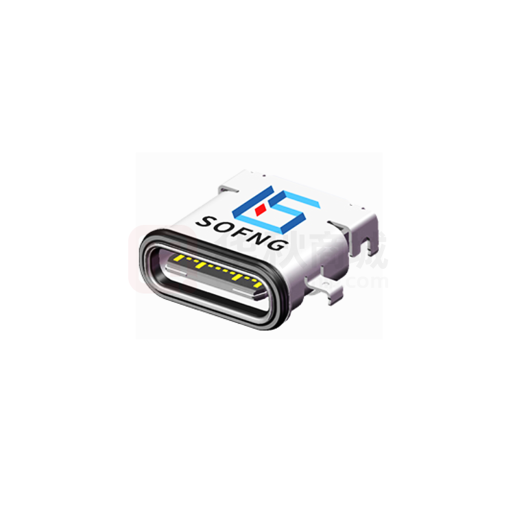

    USB连接器 Type-C 24Pin 卧贴
MC-313F-14 数据手册
www.Sofng.com C Operation:SMT+DIP 沉板式& 3.1Type-C 连接器/防水结构 ARD SOCKETS LTEM NO.:MC-313F-14 (Consumer Electronics) (9.65L× (9.65L×9.20W× 9.20W×4.00H & DUL SMT LOW PCB TYPE) Universal Serial Bus Connectors 外焊 SMT+DIP Technical parameter ╲ LEVEL A[better product] ╲ PROJECT Contact Rating Electrical Initial Contact Resistance Properties Insulation Resistance Withstand Voltage B[average product] 侧向導入 LATERAL 3A, 24V DC 30mΩ max. 100MΩ min.500V DC 精密部品 NICETY 50mΩ max. Skey/PD:100MΩ min.300V DC 500V AC for 1 minute 350 V AC for 1 minut There No Load 6,500 Cycles 5,500 Cycles Rated Load 5,500 Cycles 4,500 Cycles 可靠 STABILIZE Durable Performance 環保材质 RoHS Sterage temp. Page1 -25℃~+75℃(Operating Temp: ) Unit:mm ● ● ● Page2 DECIMALS SPECIFED TOLERANCES ANGLES X.X :±0.25 X.X :±3° X.XX :±0.15 X.XX :±2° UNLESS OTHERWISE X.XXX :±0.10 Material declaration No. ①A NAME HOUSING MATERIAL DESCRIPTION - HIGH TEMP[Black] ②B Terminal-A 12PIN COPPER ALLOY【G/F】 Au:15μ” PLATING OVERALL;[t=0.12mm]銅鎳硅合金 ③C Terminal-B 12PIN COPPER ALLOY【G/F】 Au:15μ” PLATING OVERALL;[t=0.12mm]銅鎳硅合金 ④D MID PLATE STAINLESS【G/F】 STAINLESS STEEL(t=0.15mm) ⑤E GND PLATE STAINLESS【G/F】 STAINLESS STEEL/ Ni PLATING(t=0.10mm) ⑥F SHELL-#1 STAINLESS【G/F】 STAINLESS STEEL/ Ni PLATING(t=0.20mm) ⑦G SHELL-#2 STAINLESS【G/F】 STAINLESS STEEL/ Ni PLATING(t=0.20mm) ⑧H GLUE WATER - EPOXY[Black] SOFNG ELECTRONIC TECHNOLOGY Co., LTD CIRCUIT BOARD SIZE (Vertical view) Operating Force Inward 5.0~8.0N.(1N.=100gram-force) Exiting 5.0~8.0N.(1N.=100gram-force) PIN ASSIGNMENTS Reel label RoHS label 1000PCS/reel Vacuum Packed Bag Solder-ability IR Reflow:255℃,5sec. Manual:350℃,3sec. PIN Signal NAME Description PIN Signal NAME Description A1 GND Ground return B12 GND Ground return A2 SSTXp1 Positive half of firs SuperSpeed TX differential pair B11 SSRXp1 Positive half of second SuperSpeed RX differential pair A3 SSTXn1 Negatice half of first SuperSpeed TX differential pair B10 SSRXn1 Negative half of second SuperSpeed RX differential pair A4 V BUS Bus Power B9 V BUS Bus Power A5 CC1 Configuration Channel B8 SBU2 Sideband Use(SBU) A6 Dp1 Positive half of the USB 2.0 differential pair-Position 1 B7 Dn2 Negative half of the USB 2.0 differential pair-Position 2 A7 Dn1 Negative half of the USB 2.0 differential pair-Position 1 B6 Dp2 Positive half of the USB 2.0 differential pair-Position 2 A8 SBU1 Sideband Use(SBU) B5 CC2 Configuration Channel A9 V BUS Bus Power B4 V BUS Bus Power A10 SSRXn2 Negative half of second SuperSpeed RX differential pair B3 SSTXn2 Negatice half of first SuperSpeed TX differential pair2 A11 SSRXp2 Positive half of second SuperSpeed RX differential pair B2 SSTXp2 Positive half of firs SuperSpeed TX differential pair2 A12 GND Ground return B1 GND Ground return RoHS label Cardboard box label 注記 NOTICE 1.碩方公司擁有最終解釋權;The SOFNG company reserves the right of final interpretation; 2.文件禁止外洩、轉載;Leaked and reproduced prohibited; 3.未經授權修改無效。Modify is invalid. (Max.)
