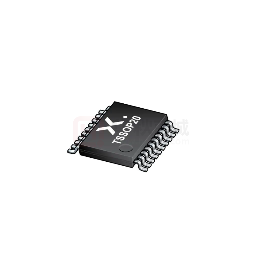

74AHCT245A Octal bus transceiver; 3-state Rev. 2 — 26 October 2016 Product data sheet 1. General description The 74AHCT245A is an 8-bit transceiver with 3-state outputs. The device features an output enable (OE) and send/receive (DIR) for direction control. A HIGH on OE causes the outputs to assume a high-impedance OFF-state. The 74AHCT245A is designed to operate over a VCC range from 4.5 V to 5.5 V. The inputs are TTL compatible, which allows the device to be used to translate from 3.3 V to 5 V. Schmitt-trigger action at all inputs makes the circuit tolerant of slower input rise and fall times. This device is fully specified for partial Power-down applications using IOFF. The IOFF circuitry disables the output, preventing the damaging backflow current through the device when it is powered down. 2. Features and benefits          Direct interface with TTL levels Supply voltage range from 4.5 V to 5.5 V Typical tpd of 3.0 ns at 5 V Typical VOL(p) < 0.8 V at VCC = 5 V, Tamb = 25 C Typical VOH(v) > 2.3 V at VCC = 5 V, Tamb = 25 C Supports mixed-mode voltage operation on all ports IOFF circuitry provides partial Power-down mode operation Latch-up performance exceeds 250 mA per JESD 78 Class II ESD protection:  HBM ANSI/ESDA/JEDEC JS-001 Class 2 exceeds 3 kV  MM JESD22-A115-A exceeds 200 V  CDM JESD22-C101E exceeds 2 kV  Specified from 40 C to +85 C and from 40 C to +125 C 74AHCT245A Nexperia Octal bus transceiver; 3-state 3. Ordering information Table 1. Ordering information Type number Package Temperature range Name 74AHCT245APW 40 C to +125 C TSSOP20 Description Version plastic thin shrink small outline package; 20 leads; body width 4.4 mm SOT360-1 4. Functional diagram  ',5 2(  %   (1 (1                $  $ %   Logic symbol 74AHCT245A Product data sheet  PQD PQD Fig 1.   $ %  *  %   $ %    $ %   $ %   $ %   $ Fig 2. IEC logic symbol All information provided in this document is subject to legal disclaimers. Rev. 2 — 26 October 2016 © Nexperia B.V. 2017. All rights reserved 2 of 13 74AHCT245A Nexperia Octal bus transceiver; 3-state 5. Pinning information 5.1 Pinning $+&7$ ',5   9&& $   2( $   % $   % $   % $   % $   % $   % $   % *1'   % DDD Fig 3. Pin configuration TSSOP20 5.2 Pin description Table 2. Pin description Symbol Pin DIR 1 direction control A0 to A7 2, 3, 4, 5, 6, 7, 8, 9 data input/output GND 10 ground (0 V) B0 to B7 18, 17, 16, 15, 14, 13, 12, 11 data input/output OE 19 output enable input (active LOW) VCC 20 supply voltage 74AHCT245A Product data sheet Description All information provided in this document is subject to legal disclaimers. Rev. 2 — 26 October 2016 © Nexperia B.V. 2017. All rights reserved 3 of 13 74AHCT245A Nexperia Octal bus transceiver; 3-state 6. Functional description Table 3. Function table[1] Input Input/output OE DIR An Bn L L A=B input L H input B=A H X Z Z [1] H = HIGH voltage level; L = LOW voltage level; X = don’t care; Z = high-impedance OFF-state. 7. Limiting values Table 4. Limiting values In accordance with the Absolute Maximum Rating System (IEC 60134). Voltages are referenced to GND (ground = 0 V). Symbol Parameter VCC supply voltage VI input voltage VO output voltage Conditions active mode Min Max Unit 0.5 +7.0 V [1] 0.5 +7.0 V [2][3] 0.5 VCC + 0.5 V [2] 0.5 +7.0 V - mA power-down or 3-state mode IIK input clamping current VI < 0 V 20 IOK output clamping current VO < 0 V 20 - mA IO output current VO = 0 V to VCC - 25 mA ICC supply current - 75 mA IGND ground current 75 - mA Tstg storage temperature 65 +150 C Ptot total power dissipation - 500 mW Tamb = 40 C to +125 C [4] [1] If the input current ratings are observed, the minimum input voltage ratings may be exceeded. [2] If the output current ratings are observed, the output voltage ratings may be exceeded. [3] This value is limited to 7.0 V maximum. [4] For TSSOP20 package: above 100 C, the value of Ptot derates linearly with 10 mW/K. 74AHCT245A Product data sheet All information provided in this document is subject to legal disclaimers. Rev. 2 — 26 October 2016 © Nexperia B.V. 2017. All rights reserved 4 of 13 74AHCT245A Nexperia Octal bus transceiver; 3-state 8. Recommended operating conditions Table 5. Recommended operating conditions Voltages are referenced to GND (ground = 0 V). Symbol Parameter Conditions VCC supply voltage VI input voltage VO output voltage Tamb ambient temperature t/V input transition rise and fall rate Min Max Unit 4.5 5.5 V 0 5.5 V active mode 0 VCC V power-down or 3-state mode 0 5.5 V 40 +125 C - 20 VCC = 5.0 V  0.5 V ns/V 9. Static characteristics Table 6. Static characteristics Voltages are referenced to GND (ground = 0 V). Symbol Parameter 25 C Conditions 40 C to +85 C 40 C to +125 C Unit Min Typ Max Min Max Min Max VIH HIGH-level input voltage VCC = 4.5 V to 5.5 V 2 - - 2 - 2 - V VIL LOW-level input voltage VCC = 4.5 V to 5.5 V - - 0.8 - 0.8 - 0.8 V VOH HIGH-level VI = VIH or VIL; VCC = 4.5 V output voltage IO = 50 A IO = 8 mA VOL LOW-level VI = VIH or VIL; VCC = 4.5 V output voltage IO = 50 A IO = 8 mA 4.4 4.5 - 4.4 - 4.4 - V 3.94 - - 3.8 - 3.7 - V - 0 0.1 - 0.1 - 0.1 V - - 0.36 - 0.44 - 0.55 V IOZ OFF-state VCC = 5.5 V; VI = VIH or VIL; output current VO = GND to 5.5 V - - 0.25 - 2.5 - 2.5 A IOFF power-off leakage current VI or VO = GND to 5.5 V; VCC = 0 V - - 0.5 - 5 - 5 A II input leakage current VI = VCC or GND; VCC = 0 V to 5.5 V - - 0.1 - 1 - 1 A ICC supply current VI = VCC or GND; IO = 0 A; VCC = 5.5 V - - 2 - 20 - 20 A ICC additional per input pin; VI = 3.4 V; supply current IO = 0 A; other pins at VCC or GND; VCC = 5.5 V - - 1.35 - 1.5 - 1.5 mA 74AHCT245A Product data sheet All information provided in this document is subject to legal disclaimers. Rev. 2 — 26 October 2016 © Nexperia B.V. 2017. All rights reserved 5 of 13 74AHCT245A Nexperia Octal bus transceiver; 3-state 10. Dynamic characteristics Table 7. Dynamic characteristics GND = 0 V. For test circuit, see Figure 6. Symbol Parameter propagation delay tpd 25 C Conditions 40 C to +85 C 40 C to +125 C Unit Min Typ[1] Max Min Max Min Max CL = 15 pF - 3.0 7.7 1 8.5 1 10 ns CL = 50 pF - 4.8 8.7 1 9.5 1 11 ns CL = 15 pF - 4.5 13.8 1 15 1 17 ns CL = 50 pF - 6.3 14.8 1 16 1 17.5 ns CL = 15 pF - 3.4 10.2 1 11.1 1 12.2 ns CL = 50 pF - 5.7 15.4 1 16.5 1 18 ns An to Bn or Bn to An; see Figure 4 [2] VCC = 4.5 V to 5.5 V enable time ten OE to An or OE to Bn; see Figure 5 VCC = 4.5 V to 5.5 V disable time OE to An or OE to Bn; see Figure 5 tdis [2] VCC = 4.5 V to 5.5 V tsk(o) output skew VCC = 4.5 V to 5.5 V; time CL = 50 pF - - 1 - 1 - 1 ns CI input capacitance VI = VCC or GND; VCC = 5 V - 2 6 - 6 - 6 pF CI/O input/output capacitance VO = VCC or GND; VCC = 5 V - 5.5 - - - - - pF CPD power dissipation capacitance per buffer; CL = 0 pF; f = 10 MHz; VI = GND to VCC - 9 - - - - - pF [3] [1] Typical values are measured at Tamb = 25 C and VCC = 5 V. [2] tpd is the same as tPLH and tPHL. ten is the same as tPZL and tPZH. tdis is the same as tPLZ and tPHZ. [3] CPD is used to determine the dynamic power dissipation PD (W). PD = CPD  VCC2  fi +  (CL  VCC2  fo) where: fi = input frequency in MHz; fo = output frequency in MHz; CL = output load capacitance in pF; VCC = supply voltage in Volts. 74AHCT245A Product data sheet All information provided in this document is subject to legal disclaimers. Rev. 2 — 26 October 2016 © Nexperia B.V. 2017. All rights reserved 6 of 13 74AHCT245A Nexperia Octal bus transceiver; 3-state Table 8. Noise characteristics GND = 0 V. For test circuit, see Figure 6. Symbol Parameter Tamb = 25 C Conditions Unit Min Typ Max VCC = 5 V; CL = 50 pF VOL(p) LOW-level output voltage (peak) - 0.5 1.5 V VOL(v) LOW-level output voltage (valley) 1.5 0.3 - V VOH(v) HIGH-level output voltage (valley) - 4.5 - V VIH(AC) AC HIGH-level input voltage dynamic 2 - - V VIL(AC) AC LOW-level input voltage dynamic - - 0.8 V 11. Waveforms 9, $Q%QLQSXW  *1' 90 90 W3/+ W3+/ 92+ 90 %Q$QRXWSXW  92/ 90 PQD Measurement points are given in Table 9. VOL and VOH are typical voltage output levels that occur with the output load. Fig 4. Propagation delay input (An, Bn) to output (Bn, An) 9, 2(LQSXW 90 *1' W 3/= W 3=/ 9&& RXWSXW /2:WR2)) 2))WR/2: 92/ 90 9; W 3+= 92+ W 3=+ 9< RXWSXW +,*+WR2)) 2))WR+,*+ 90 *1' RXWSXWV HQDEOHG RXWSXWV GLVDEOHG RXWSXWV HQDEOHG PQD Measurement points are given in Table 9. VOL and VOH are typical voltage output levels that occur with the output load. Fig 5. Enable and disable times 74AHCT245A Product data sheet All information provided in this document is subject to legal disclaimers. Rev. 2 — 26 October 2016 © Nexperia B.V. 2017. All rights reserved 7 of 13 74AHCT245A Nexperia Octal bus transceiver; 3-state Table 9. Measurement points Input Output VM VM VX VY 1.5 V 0.5VCC VOL + 0.3 V VOH  0.3 V 9, W:  QHJDWLYH SXOVH 90 9 9, WI WU WU WI  SRVLWLYH SXOVH 9 90  90 90  W: 9&& 9&& 9, * 92 5/ 6 RSHQ '87 &/ 57 DDG Test data is given in Table 10. Definitions test circuit: RT = Termination resistance should be equal to output impedance Zo of the pulse generator CL = Load capacitance including jig and probe capacitance RL = Load resistor S1 = Test selection switch Fig 6. Table 10. Test circuit for measuring switching times Test data Input VI Load tr, tf GND to 3.0 V 3.0 ns 74AHCT245A Product data sheet S1 position CL RL tPHL, tPLH tPZH, tPHZ tPZL, tPLZ 15 pF, 50 pF 1 k open GND VCC All information provided in this document is subject to legal disclaimers. Rev. 2 — 26 October 2016 © Nexperia B.V. 2017. All rights reserved 8 of 13 74AHCT245A Nexperia Octal bus transceiver; 3-state 12. Package outline 76623SODVWLFWKLQVKULQNVPDOORXWOLQHSDFNDJHOHDGVERG\ZLGWKPP ' 627 ( $ ; F +( \ Y 0 $ =   4 $ SLQLQGH[ $   $ $ ș /S /   H GHWDLO; Z 0 ES   PP VFDOH ',0(16,216 PPDUHWKHRULJLQDOGLPHQVLRQV  81,7 $ PD[ $ $ $ ES F '   (   H +( / /S 4 Y Z \ =   ș PP                            R R 1RWHV 3ODVWLFRUPHWDOSURWUXVLRQVRIPPPD[LPXPSHUVLGHDUHQRWLQFOXGHG 3ODVWLFLQWHUOHDGSURWUXVLRQVRIPPPD[LPXPSHUVLGHDUHQRWLQFOXGHG 287/,1( 9(56,21 627 Fig 7. 5()(5(1&(6 ,(& -('(& -(,7$ (8523($1 352-(&7,21 ,668('$7(   02 Package outline SOT360-1 (TSSOP20) 74AHCT245A Product data sheet All information provided in this document is subject to legal disclaimers. Rev. 2 — 26 October 2016 © Nexperia B.V. 2017. All rights reserved 9 of 13 74AHCT245A Nexperia Octal bus transceiver; 3-state 13. Abbreviations Table 11. Abbreviations Acronym Description CDM Charge Device Model DUT Device Under Test ESD ElectroStatic Discharge HBM Human Body Model MM Machine Model TTL Transistor-Transistor Logic 14. Revision history Table 12. Revision history Document ID Release date Data sheet status Change notice Supersedes 74AHCT245A v.2 20161026 Product data sheet - 74AHCT245A v.1 - - Modifications: 74AHCT245A v.1 74AHCT245A Product data sheet • Type number 74AHCT245ABQ removed. 20160602 Product data sheet All information provided in this document is subject to legal disclaimers. Rev. 2 — 26 October 2016 © Nexperia B.V. 2017. All rights reserved 10 of 13 74AHCT245A Nexperia Octal bus transceiver; 3-state 15. Legal information 15.1 Data sheet status Document status[1][2] Product status[3] Definition Objective [short] data sheet Development This document contains data from the objective specification for product development. Preliminary [short] data sheet Qualification This document contains data from the preliminary specification. Product [short] data sheet Production This document contains the product specification. [1] Please consult the most recently issued document before initiating or completing a design. [2] The term ‘short data sheet’ is explained in section “Definitions”. [3] The product status of device(s) described in this document may have changed since this document was published and may differ in case of multiple devices. The latest product status information is available on the Internet at URL http://www.nexperia.com. 15.2 Definitions Draft — The document is a draft version only. The content is still under internal review and subject to formal approval, which may result in modifications or additions. Nexperia does not give any representations or warranties as to the accuracy or completeness of information included herein and shall have no liability for the consequences of use of such information. Short data sheet — A short data sheet is an extract from a full data sheet with the same product type number(s) and title. A short data sheet is intended for quick reference only and should not be relied upon to contain detailed and full information. For detailed and full information see the relevant full data sheet, which is available on request via the local Nexperia sales office. In case of any inconsistency or conflict with the short data sheet, the full data sheet shall prevail. Product specification — The information and data provided in a Product data sheet shall define the specification of the product as agreed between Nexperia and its customer, unless Nexperia and customer have explicitly agreed otherwise in writing. In no event however, shall an agreement be valid in which the Nexperia product is deemed to offer functions and qualities beyond those described in the Product data sheet. 15.3 Disclaimers Limited warranty and liability — Information in this document is believed to be accurate and reliable. However, Nexperia does not give any representations or warranties, expressed or implied, as to the accuracy or completeness of such information and shall have no liability for the consequences of use of such information. Nexperia takes no responsibility for the content in this document if provided by an information source outside of Nexperia. In no event shall Nexperia be liable for any indirect, incidental, punitive, special or consequential damages (including - without limitation - lost profits, lost savings, business interruption, costs related to the removal or replacement of any products or rework charges) whether or not such damages are based on tort (including negligence), warranty, breach of contract or any other legal theory. Notwithstanding any damages that customer might incur for any reason whatsoever, Nexperia’s aggregate and cumulative liability towards customer for the products described herein shall be limited in accordance with the Terms and conditions of commercial sale of Nexperia. Right to make changes — Nexperia reserves the right to make changes to information published in this document, including without limitation specifications and product descriptions, at any time and without notice. This document supersedes and replaces all information supplied prior to the publication hereof. 74AHCT245A Product data sheet Suitability for use — Nexperia products are not designed, authorized or warranted to be suitable for use in life support, life-critical or safety-critical systems or equipment, nor in applications where failure or malfunction of a Nexperia product can reasonably be expected to result in personal injury, death or severe property or environmental damage. Nexperia and its suppliers accept no liability for inclusion and/or use of Nexperia products in such equipment or applications and therefore such inclusion and/or use is at the customer’s own risk. Applications — Applications that are described herein for any of these products are for illustrative purposes only. Nexperia makes no representation or warranty that such applications will be suitable for the specified use without further testing or modification. Customers are responsible for the design and operation of their applications and products using Nexperia products, and Nexperia accepts no liability for any assistance with applications or customer product design. It is customer’s sole responsibility to determine whether the Nexperia product is suitable and fit for the customer’s applications and products planned, as well as for the planned application and use of customer’s third party customer(s). Customers should provide appropriate design and operating safeguards to minimize the risks associated with their applications and products. Nexperia does not accept any liability related to any default, damage, costs or problem which is based on any weakness or default in the customer’s applications or products, or the application or use by customer’s third party customer(s). Customer is responsible for doing all necessary testing for the customer’s applications and products using Nexperia products in order to avoid a default of the applications and the products or of the application or use by customer’s third party customer(s). Nexperia does not accept any liability in this respect. Limiting values — Stress above one or more limiting values (as defined in the Absolute Maximum Ratings System of IEC 60134) will cause permanent damage to the device. Limiting values are stress ratings only and (proper) operation of the device at these or any other conditions above those given in the Recommended operating conditions section (if present) or the Characteristics sections of this document is not warranted. Constant or repeated exposure to limiting values will permanently and irreversibly affect the quality and reliability of the device. Terms and conditions of commercial sale — Nexperia products are sold subject to the general terms and conditions of commercial sale, as published at http://www.nexperia.com/profile/terms, unless otherwise agreed in a valid written individual agreement. In case an individual agreement is concluded only the terms and conditions of the respective agreement shall apply. Nexperia hereby expressly objects to applying the customer’s general terms and conditions with regard to the purchase of Nexperia products by customer. No offer to sell or license — Nothing in this document may be interpreted or construed as an offer to sell products that is open for acceptance or the grant, conveyance or implication of any license under any copyrights, patents or other industrial or intellectual property rights. All information provided in this document is subject to legal disclaimers. Rev. 2 — 26 October 2016 © Nexperia B.V. 2017. All rights reserved 11 of 13 74AHCT245A Nexperia Octal bus transceiver; 3-state Export control — This document as well as the item(s) described herein may be subject to export control regulations. Export might require a prior authorization from competent authorities. Non-automotive qualified products — Unless this data sheet expressly states that this specific Nexperia product is automotive qualified, the product is not suitable for automotive use. It is neither qualified nor tested in accordance with automotive testing or application requirements. Nexperia accepts no liability for inclusion and/or use of non-automotive qualified products in automotive equipment or applications. In the event that customer uses the product for design-in and use in automotive applications to automotive specifications and standards, customer (a) shall use the product without Nexperia’s warranty of the product for such automotive applications, use and specifications, and (b) whenever customer uses the product for automotive applications beyond Nexperia’s specifications such use shall be solely at customer’s own risk, and (c) customer fully indemnifies Nexperia for any liability, damages or failed product claims resulting from customer design and use of the product for automotive applications beyond Nexperia’s standard warranty and Nexperia’s product specifications. Translations — A non-English (translated) version of a document is for reference only. The English version shall prevail in case of any discrepancy between the translated and English versions. 15.4 Trademarks Notice: All referenced brands, product names, service names and trademarks are the property of their respective owners. 16. Contact information For more information, please visit: http://www.nexperia.com For sales office addresses, please send an email to: salesaddresses@nexperia.com 74AHCT245A Product data sheet All information provided in this document is subject to legal disclaimers. Rev. 2 — 26 October 2016 © Nexperia B.V. 2017. All rights reserved 12 of 13 Nexperia 74AHCT245A Octal bus transceiver; 3-state 17. Contents 1 2 3 4 5 5.1 5.2 6 7 8 9 10 11 12 13 14 15 15.1 15.2 15.3 15.4 16 17 © General description . . . . . . . . . . . . . . . . . . . . . . 1 Features and benefits . . . . . . . . . . . . . . . . . . . . 1 Ordering information . . . . . . . . . . . . . . . . . . . . . 2 Functional diagram . . . . . . . . . . . . . . . . . . . . . . 2 Pinning information . . . . . . . . . . . . . . . . . . . . . . 3 Pinning . . . . . . . . . . . . . . . . . . . . . . . . . . . . . . . 3 Pin description . . . . . . . . . . . . . . . . . . . . . . . . . 3 Functional description . . . . . . . . . . . . . . . . . . . 4 Limiting values. . . . . . . . . . . . . . . . . . . . . . . . . . 4 Recommended operating conditions. . . . . . . . 5 Static characteristics. . . . . . . . . . . . . . . . . . . . . 5 Dynamic characteristics . . . . . . . . . . . . . . . . . . 6 Waveforms . . . . . . . . . . . . . . . . . . . . . . . . . . . . . 7 Package outline . . . . . . . . . . . . . . . . . . . . . . . . . 9 Abbreviations . . . . . . . . . . . . . . . . . . . . . . . . . . 10 Revision history . . . . . . . . . . . . . . . . . . . . . . . . 10 Legal information. . . . . . . . . . . . . . . . . . . . . . . 11 Data sheet status . . . . . . . . . . . . . . . . . . . . . . 11 Definitions . . . . . . . . . . . . . . . . . . . . . . . . . . . . 11 Disclaimers . . . . . . . . . . . . . . . . . . . . . . . . . . . 11 Trademarks. . . . . . . . . . . . . . . . . . . . . . . . . . . 12 Contact information. . . . . . . . . . . . . . . . . . . . . 12 Contents . . . . . . . . . . . . . . . . . . . . . . . . . . . . . . 13 Nexperia B.V. 2017. All rights reserved For more information, please visit: http://www.nexperia.com For sales office addresses, please send an email to: salesaddresses@nexperia.com Date of release: 26 October 2016
74AHCT245APWJ
物料型号:74AHCT245A 器件简介:74AHCT245A 是由Nexperia公司生产的八路总线收发器,用于在单向总线和双向总线之间转换。
引脚分配:该器件有20个引脚,包括8个双向数据输入/输出引脚,2个总线方向控制引脚,以及电源和地引脚。
参数特性:工作电压范围为2.0V至5.5V,工作温度范围为-40°C至+125°C,封装类型为TSSOP-20。
功能详解:74AHCT245A 支持双向数据传输,具有低电压肖特基TTL电平输出,可实现高速数据传输。
应用信息:适用于高速数据通信、微处理器总线扩展、多处理器系统等应用场景。
封装信息:TSSOP-20封装,适用于表面贴装技术。
