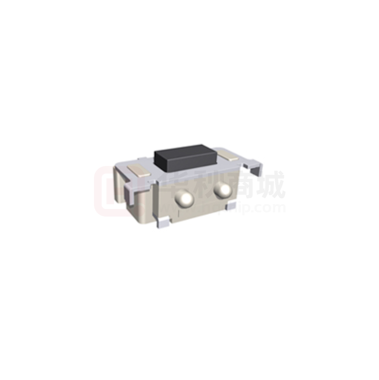

    轻触开关 SMD,7.8x3.5mm SPST 50mA
TS-1112E 数据手册
www.Sofng.com S Operation:SMT/Tact Swtich & 贴片卧式  中小型轻触开关  带导位柱 WITCHES LTEM NO.:TS-1112E-T26 (Three D) (L7.8mm× L7.8mm×W3.5mm× W3.5mm×H3.55mm TACT-SWITCH ) 贴片安装 SMT Technical parameter ╲ LEVEL A[better product] ╲ PROJECT Contact Rating Electrical Initial Contact Resistance Properties Insulation Resistance B[average product] 侧操作 LATERAL 50mA, 24V DC 30mΩ max. 100MΩ min.500V DC Withstand Voltage 50mΩ max. 精密部品 NICETY Skey/PD:100MΩ min.300V DC 500V AC for 1 minute 350 V AC for 1 minut There No Load 100,000 Cycles 75,000 Cycles Rated Load 80,000 Cycles 50,000 Cycles 可靠 STABILIZE Durable Performance -25℃~+75℃(Operating Temp: Sterage temp. ) 適合環保 RoHS Unit:mm 3.5 1.75 1.5 7.0± 0.2 1 2 2-0.8 Guide peg 2 - 1.0 2.3 7.8± 0.2 0.08 Stem 1 2 - 0.6 4.2 2 2 - 0.6 3.5 MAX 0.3 2.0 3.0 t 0.2 SOFNG ELECTRONIC TECHNOLOGY Co., LTD CIRCUIT BOARD SIZE (Vertical view) 2.6N.(1N.=100gram-force) Exiting 2.0N.(1N.=100gram-force) 5.1 3.3 Solder-ability IR Reflow:255℃,5sec. (Max.) Manual:350℃,3sec. 1.0 0.85 1.27 Inward 1.2 Operating Force 2.3 5.3 8.3 2 - Ø1.0 [Holes] Material declaration Material declaration No. NAME Description ①A 拨柄 LCP (Black)热塑性 ②B 基座 LCP (Black)热塑性 350:max. ③C 盖板 SUS 不锈钢 Q235-A 3s max. ④D 簧片 镀银&不锈钢 SUS304 60W max. ⑤E 嵌件 镀银&黄铜 Please practice according to below condition: (1) Preheat :150 ℃ 90-120s (2) Soldering heat : 255 ℃ Max 10S. 100: max. (3) Immersion depth: Up to the surface of the board ( c) 60s max. 260: max. 300 255°C Max.3sec Max. 5s max. 2 200 220°C 10sec Max. 20sec. 100 本品不屬於危害性廢棄物,須丟棄時可以委託 0 TIME 時間(秒) (120 second)秒 3~4 min. 炉内通过时间 回收商予以回收再生處理。 Products do not belong to · 運送時本產品不要直接與水、酸鹼性化學物質 接觸,或放置於含有以上氣體環境中,並且需要 注記 NOTICE 注意會有滑落、側翻的危險發生;運輸過程中 1.碩方公司擁有最終解釋權;The company reserves the right of final interpretation; 不能有碰撞或者擠壓,須保證溫度與濕度適中 2.文件禁止外洩、轉載;Leaked and reproduced prohibited; [常溫 25℃,濕度在 50℃以內],不可導致材料變 3.未經授權修改無效。Modify is invalid. 形或氧化。
