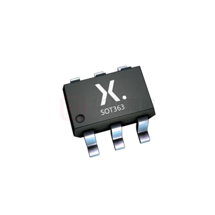

    IC GATE OR 1CH 2-INP SOT363
74AXP1T32GWH 数据手册
74AXP1T32 Dual supply 2-input OR gate Rev. 2 — 22 March 2019 Product data sheet 1. General description The 74AXP1T32 is a dual supply 2-input OR gate. It features two inputs (A, B), an output (Y) and dual supply pins (VCCI and VCCO). The inputs are referenced to VCCI and the output is referenced to VCCO. All inputs can be connected directly to VCCI or GND. VCCI can be supplied at any voltage between 0.7 V and 2.75 V. VCCO can be supplied at any voltage between 1.2 V and 5.5 V. This feature allows voltage level translation. Schmitt-trigger action at all inputs makes the circuit tolerant of slower input rise and fall times. This device ensures very low static and dynamic power consumption across the entire supply range and is fully specified for partial power down applications using IOFF. The IOFF circuitry disables the output, preventing the potentially damaging backflow current through the device when it is powered down. 2. Features and benefits • • • • • • • • • • • • • • • Wide supply voltage range: • VCCI: 0.7 V to 2.75 V • VCCO: 1.2 V to 5.5 V Low input capacitance; CI = 0.6 pF (typical) Low output capacitance; CO = 1.8 pF (typical) Low dynamic power consumption; CPD = 0.5 pF at VCCI = 1.2 V (typical) Low dynamic power consumption; CPD = 7.1 pF at VCCO = 3.3 V (typical) Low static power consumption; ICCI = 0.5 μA (85 °C maximum) Low static power consumption; ICCO = 1.8 μA (85 °C maximum) High noise immunity Complies with JEDEC standard: • JESD8-12A.01 (1.1 V to 1.3 V; A, B input) • JESD8-11A.01 (1.4 V to 1.6 V) • JESD8-7A (1.65 V to 1.95 V) • JESD8-5A.01 (2.3 V to 2.7 V) • JESD8-C (2.7 V to 3.6 V; Y output) • JESD12-6 (4.5 V to 5.5 V; Y output) ESD protection: • HBM ANSI/ESDA/JEDEC JS-001 Class 2 exceeds 2 kV • CDM JESD22-C101E exceeds 1000 V Latch-up performance exceeds 100 mA per JESD78D Class II Inputs accept voltages up to 2.75 V Low noise overshoot and undershoot < 10 % of VCCO IOFF circuitry provides partial power-down mode operation Specified from -40 °C to +85 °C 74AXP1T32 Nexperia Dual supply 2-input OR gate 3. Ordering information Table 1. Ordering information Type number Package 74AXP1T32GX Temperature range Name Description Version -40 °C to +85 °C plastic thermal enhanced extremely thin small outline package; no leads; 6 terminals; body 1.0 x 0.8 x 0.35 mm SOT1255 X2SON6 4. Marking Table 2. Marking Type number Marking code[1] 74AXP1T32GX rT [1] The pin 1 indicator is located on the lower left corner of the device, below the marking code. 5. Functional diagram B 5 3 B A Y Y 4 A VCCI VCCO aaa-025599 aaa-025598 Fig. 1. Logic symbol Fig. 2. Logic diagram 6. Pinning information 6.1. Pinning 74AXP1T32 VCCI VCCO 1 6 GND 2 3 A 5 B 4 Y aaa-025601 Transparent top view Fig. 3. Pin configuration SOT1255 (X2SON6) 74AXP1T32 Product data sheet All information provided in this document is subject to legal disclaimers. Rev. 2 — 22 March 2019 © Nexperia B.V. 2019. All rights reserved 2 / 14 74AXP1T32 Nexperia Dual supply 2-input OR gate 6.2. Pin description Table 3. Pin description Symbol Pin Description VCCI 1 input supply voltage GND 2 ground (0 V) A 3 data input A Y 4 data output Y B 5 data input B VCCO 6 output supply voltage 7. Functional description Table 4. Function table H = HIGH voltage level; L = LOW voltage level; X = Don’t care; Z = high-impedance OFF-state. Supply voltage Output Input VCCI VCCO A B Y 0.7 V to 2.75 V 1.2 V to 5.5 V L L L 0.7 V to 2.75 V 1.2 V to 5.5 V L H H 0.7 V to 2.75 V 1.2 V to 5.5 V H L H 0.7 V to 2.75 V 1.2 V to 5.5 V H H H GND 1.2 V to 5.5 V X X Z 0.7 V to 2.75 V GND X X Z GND GND X X Z 8. Limiting values Table 5. Limiting values In accordance with the Absolute Maximum Rating System (IEC 60134). Voltages are referenced to GND (ground = 0 V). Symbol Parameter VCCI Conditions Min Max Unit input supply voltage -0.5 3.3 V VCCO output supply voltage -0.5 6.0 V IIK input clamping current -50 - VI input voltage -0.5 3.3 IOK output clamping current VO < 0 V -50 - VO output voltage Active mode VI < 0 V [1] mA V mA [1][2] -0.5 [1] -0.5 6.0 V - ±25 mA Power-down or 3-state mode IO output current ICCI input supply current - 50 mA ICCO output supply current - 50 mA IGND ground current -50 - mA Tstg storage temperature -65 +150 °C 74AXP1T32 Product data sheet VO = 0 V to VCCO VCCO + 0.5 V All information provided in this document is subject to legal disclaimers. Rev. 2 — 22 March 2019 © Nexperia B.V. 2019. All rights reserved 3 / 14 74AXP1T32 Nexperia Dual supply 2-input OR gate Symbol Parameter Conditions Ptot total power dissipation Tamb = -40 °C to +85 °C [1] [2] [3] Min Max Unit - 250 mW [3] The minimum input and output voltage ratings may be exceeded if the input and output current ratings are observed. VCCO + 0.5 V should not exceed 6.0 V. For X2SON6 package: above 118 °C, the value of Ptot derates linearly with 7.8 mW/K. 9. Recommended operating conditions Table 6. Recommended operating conditions Voltages are referenced to GND (ground = 0 V). Symbol Parameter Conditions Min Max Unit VCCI VCCO input supply voltage 0.7 2.75 V output supply voltage 1.2 5.5 V VI input voltage 0 2.75 V VO output voltage Active mode 0 VCCO V Power-down or 3-state mode 0 5.5 V -40 +85 °C 0 200 ns/V Tamb ambient temperature Δt/ΔV input transition rise and fall rate VCCI = 0.7 V to 2.75 V 10. Static characteristics Table 7. Static characteristics At recommended operating conditions, unless otherwise specified; voltages are referenced to GND (ground = 0 V). Symbol Parameter VIH VIL VOH VOL HIGH-level input voltage LOW-level input voltage Conditions Tamb = 25 °C Min Typ Max Min Max VCCI = 0.75 V to 0.85 V 0.75VCCI - - 0.75VCCI - V VCCI = 1.1 V to 1.95 V 0.65VCCI - - 0.65VCCI - V VCCI = 2.3 V to 2.7 V 1.6 - - 1.6 - V VCCI = 0.75 V to 0.85 V - - 0.25VCCI - 0.25VCCI V VCCI = 1.1 V to 1.95 V - - 0.35VCCI - 0.35VCCI V VCCI = 2.3 V to 2.7 V - - 0.7 - 0.7 V - 1.05 - - - V IO = -2 mA; VCCO = 1.2 V HIGH-level output voltage I = -3 mA; V O CCO = 1.4 V [1] 1.05 - - 1.05 - V IO = -4.5 mA; VCCO = 1.65 V 1.2 - - 1.2 - V IO = -8 mA; VCCO = 2.3 V 1.7 - - 1.7 - V IO = -10 mA; VCCO = 3.0 V 2.2 - - 2.2 - V IO = -12 mA; VCCO = 4.5 V 3.7 - - 3.7 - V - 0.18 - - - V - - 0.35 - 0.35 V IO = 4.5 mA; VCCO = 1.65 V - - 0.45 - 0.45 V IO = 8 mA; VCCO = 2.3 V - - 0.7 - 0.7 V IO = 10 mA; VCCO = 3.0 V - - 0.8 - 0.8 V IO = 2 mA; VCCO = 1.2 V LOW-level output voltage I = 3 mA; V O CCO = 1.4 V [1] IO = 12 mA; VCCO = 4.5 V II input leakage current 74AXP1T32 Product data sheet Tamb = -40 °C to +85 °C Unit VI = 0 V to 2.75 V; VCCI = 0 V to 2.75 V [1] - - 0.8 - 0.8 V - ±0.001 ±0.1 - ±0.5 μA All information provided in this document is subject to legal disclaimers. Rev. 2 — 22 March 2019 © Nexperia B.V. 2019. All rights reserved 4 / 14 74AXP1T32 Nexperia Dual supply 2-input OR gate Symbol Parameter Conditions Tamb = 25 °C Tamb = -40 °C to +85 °C Unit Min Typ Max Min Max IOZ OFF-state output current VO = 0 V to 5.5 V; VCCO = 1.2 V to 5.5 V - ±0.001 ±0.1 - ±0.5 μA IOFF power-off leakage current inputs; VI = 0 V to 2.75 V; [1] VCCI = 0 V; VCCO = 0 V to 5.5 V - ±0.01 ±0.1 - ±0.5 μA output; VO = 0 V to 5.5 V; VCCO = 0 V; VCCI = 0 V to 2.75 V; VI = 0 V to 2.75 V [1] - ±0.01 ±0.1 - ±0.5 μA additional power-off leakage current inputs; VI = 0 V or 2.75 V; VCCI = 0 V to 0.1 V; VCCO = 0 V to 5.5 V [1] - ±0.02 ±0.1 - ±0.5 μA output; VO = 0 V or 5.5 V; VCCO = 0 V to 0.1 V; VCCI = 0 V to 2.75 V; VI = 0 V or 2.75 V [1] - ±0.02 ±0.1 - ±0.5 μA ΔIOFF [1] Typical values are measured at VCCI = VCCO = 1.2 V unless otherwise specified. Table 8. Static characteristics supply current At recommended operating conditions, unless otherwise specified; voltages are referenced to GND (ground = 0 V). Symbol Parameter Conditions ICCI VI = 0 V or VCCI; input supply current ICCO ΔICCI [1] [2] [3] output supply current additional input supply current Tamb = -40 °C to +85 °C Unit Typ 25 °C Max 25 °C Typ 85 °C Max 85 °C VCCI = 0.7 V to 1.3 V [1] 1 100 10 300 nA VCCI = 1.3 V to 2.75 V [2] 1 100 20 500 nA VCCI = 2.75 V; VCCO = 0 V 1 100 20 500 nA VCCI = 0 V; VCCO = 5.5 V 1 100 1 100 nA VI = 0 V or VCCI; IO = 0 A; see Table 9 VCCO = 1.2 V to 3.6 V [1] 0.001 1.0 0.01 1.2 μA VCCO = 3.6 V to 5.5 V [3] 0.8 1.5 1.0 1.8 μA VCCI = 2.75 V; VCCO = 0 V 0.001 0.1 0.003 0.2 μA VCCI = 0 V; VCCO = 3.6 V 0.2 0.6 0.3 0.8 μA VCCI = 0 V; VCCO = 5.5 V 0.4 0.8 0.5 1.0 μA 2 100 14 150 μA VI = VCCI - 0.5 V; VCCI = 2.5 V Typical values are measured at VCCI = VCCO = 1.2 V unless otherwise specified. Typical values are measured at VCCI = VCCO = 2.5 V. Typical values are measured at VCCI = 1.2 V and VCCO = 5.0 V. Table 9. Typical output supply current (ICCO) VCCI VCCO Unit 0V 1.2 V 1.5 V 1.8 V 2.5 V 3.3 V 5.0 V 0V 0 1 5 20 100 200 400 nA 0.8 V 1 10 150 200 300 500 800 nA 1.2 V 1 1 5 200 300 500 800 nA 1.5 V 1 1 5 100 300 500 800 nA 1.8 V 1 1 5 100 300 500 800 nA 2.5 V 1 1 5 100 100 500 800 nA 74AXP1T32 Product data sheet All information provided in this document is subject to legal disclaimers. Rev. 2 — 22 March 2019 © Nexperia B.V. 2019. All rights reserved 5 / 14 74AXP1T32 Nexperia Dual supply 2-input OR gate 11. Dynamic characteristics Table 10. Dynamic characteristics Voltages are referenced to GND (ground = 0 V); for test circuit, see Fig. 11; for waveform, see Fig. 4. Symbol Parameter Conditions VCCO 1.2 V Unit 1.5 V ± 0.1 V 1.8 V ± 0.15 V Typ[1] Min Typ[1] Max Min Typ[1] Max 23 3 18 73 3 16 69 ns VCCI = 1.1 V to 1.3 V 16.9 3.1 10.8 19.9 2.8 8.7 15.9 ns VCCI = 1.4 V to 1.6 V 16.0 2.8 9.9 18.2 2.5 7.8 13.2 ns VCCI = 1.65 V to 1.95 V 15.6 2.7 9.5 17.3 2.4 7.3 11.8 ns VCCI = 2.3 V to 2.7 V 15.2 2.5 9.0 16.8 2.2 6.9 11.0 ns 23 3 18 148 3 16 145 ns VCCI = 1.1 V to 1.3 V 16.9 3.1 10.8 19.9 2.8 8.7 15.9 ns VCCI = 1.4 V to 1.6 V 16.0 2.8 9.9 18.2 2.5 7.8 13.2 ns VCCI = 1.65 V to 1.95 V 15.6 2.7 9.5 17.3 2.4 7.3 11.8 ns VCCI = 2.3 V to 2.7 V 15.2 2.5 9.0 16.8 2.2 6.9 11.0 ns - 1.0 - - 1.0 - - ns Tamb = 25 °C [2] propagation A, B to Y delay VCCI = 0.75 V to 0.85 V tpd Tamb = -40 °C to +85 °C [2] propagation A, B to Y delay VCCI = 0.75 V to 0.85 V tpd tt [1] [2] [3] transition time VCCI = 0.75 V to 2.7 V [3] Typical values are measured at nominal supply voltages and Tamb = +25 °C. tpd is the same as tPLH and tPHL. tt is the same as tTHL and tTLH. Table 11. Dynamic characteristics Voltages are referenced to GND (ground = 0 V); for test circuit, see Fig. 11; for waveform, see Fig. 4. Symbol Parameter Conditions VCCO Unit 2.5 V ± 0.2 V 3.3 V ± 0.3 V 5.0 V ± 0.5 V Min Typ[1] Max Min Typ[1] Max Min Typ[1] Max Tamb = 25 °C tpd [2] propagation A, B to Y delay VCCI = 0.75 V to 0.85 V 2 14 69 2 14 77 2 15 89 ns VCCI = 1.1 V to 1.3 V 2.4 6.9 10.9 2.2 6.3 9.6 2.1 6.0 9.1 ns VCCI = 1.4 V to 1.6 V 2.1 6.0 9.1 2.0 5.4 8.2 1.9 5.0 7.7 ns VCCI = 1.65 V to 1.95 V 2.0 5.6 8.6 1.8 4.9 7.6 1.8 4.6 7.2 ns VCCI = 2.3 V to 2.7 V 1.9 5.1 8.0 1.7 4.5 7.0 1.6 4.1 6.5 ns 2 14 164 2 14 191 2 15 222 ns VCCI = 1.1 V to 1.3 V 2.4 6.9 10.9 2.2 6.3 9.6 2.1 6.0 9.1 ns VCCI = 1.4 V to 1.6 V 2.1 6.0 9.1 2.0 5.4 8.2 1.9 5.0 7.7 ns VCCI = 1.65 V to 1.95 V 2.0 5.6 8.6 1.8 4.9 7.6 1.8 4.6 7.2 ns VCCI = 2.3 V to 2.7 V 1.9 5.1 8.0 1.7 4.5 7.0 1.6 4.1 6.5 ns Tamb = -40 °C to +85 °C tpd [2] propagation A, B to Y delay VCCI = 0.75 V to 0.85 V 74AXP1T32 Product data sheet All information provided in this document is subject to legal disclaimers. Rev. 2 — 22 March 2019 © Nexperia B.V. 2019. All rights reserved 6 / 14 74AXP1T32 Nexperia Dual supply 2-input OR gate Symbol Parameter tt [1] [2] [3] transition time Conditions VCCO VCCI = 0.75 V to 2.7 V [3] Unit 2.5 V ± 0.2 V 3.3 V ± 0.3 V 5.0 V ± 0.5 V Min Typ[1] Max Min Typ[1] Max Min Typ[1] Max 1.0 1.0 1.0 - - - - - - ns Typical values are measured at nominal supply voltages and tamb = +25 °C. tpd is the same as tPLH and tPHL. tt is the same as tTHL and tTLH. Table 12. Typical dynamic characteristics at Tamb = 25 °C Voltages are referenced to GND (ground = 0 V); for test circuit, see Fig. 11; for waveform, see Fig. 4. Symbol Parameter CPD power dissipation capacitance Conditions VCCO Unit 1.2 V 1.5 V 1.8 V 2.5 V 3.3 V 5.0 V VCCI = 0.8 V 0.5 0.5 0.5 0.5 0.5 0.5 pF VCCI = 1.2 V 0.5 0.5 0.5 0.5 0.5 0.5 pF VCCI = 1.5 V 0.5 0.5 0.5 0.5 0.5 0.5 pF VCCI = 1.8 V 0.6 0.6 0.6 0.6 0.6 0.6 pF VCCI = 2.5 V 0.8 0.8 0.8 0.8 0.8 0.8 pF VCCI = 0.8 V 6.7 6.8 6.8 6.9 7.5 9.5 pF VCCI = 1.2 V 6.8 6.9 7.0 7.0 7.1 7.6 pF VCCI = 1.5 V 6.9 6.9 6.9 7.0 7.1 7.6 pF VCCI = 1.8 V 6.9 6.9 6.9 7.0 7.2 7.6 pF VCCI = 2.5 V 6.9 7.0 7.0 7.0 7.2 7.6 pF fi = 1 MHz; RL = ∞ Ω; VI = 0 V to VCCI [1] input supply [2] output supply [3] CI input capacitance VI = 0 V or VCCI; VCCI = 0 V to 2.7 V 0.6 0.6 0.6 0.6 0.6 0.6 pF CO output capacitance VO = 0 V; VCCO = 0 V 1.8 1.8 1.8 1.8 1.8 1.8 pF [1] [2] [3] CPD is used to determine the dynamic power dissipation (PD in μW). Power dissipated from input supply (VCCI) 2 PD = CPD x VCCI × fi x N where: CPD = power dissipation capacitance of the input supply. VCCI = input supply voltage in V; fi = input frequency in MHz; N = number of inputs switching; Power dissipated from output supply (VCCO) 2 PD = (CL + CPD) x VCCO x fo where: CL = load capacitance in pF; CPD = power dissipation capacitance of the output supply. VCCO = output supply voltage in V; fo = output frequency in MHz; 74AXP1T32 Product data sheet All information provided in this document is subject to legal disclaimers. Rev. 2 — 22 March 2019 © Nexperia B.V. 2019. All rights reserved 7 / 14 74AXP1T32 Nexperia Dual supply 2-input OR gate 11.1. Waveform, graphs and test circuit VI A, B input VM VM GND tPLH VOH tPHL 90 % Y output 90 % VM VM 10 % VOL 10 % tTLH tTHL aaa-025602 Measurement points are given in Table 13. VOL and VOH are typical output voltage levels that occur with the output load. Fig. 4. Input A, B to output Y propagation delay times and output transition times Table 13. Measurement points Supply voltage Output Input VCCI VCCO VM VM VI 0.75 V to 2.7 V 1.2 V to 5.5 V 0.5VCCO 0.5VCCI VCCI aaa-018538 6 tpd (ns) aaa-018539 6 (3) tpd (ns) (3) (2) (2) 4 4 (1) (1) 2 2 0 0 30 60 90 CL (pF) 0 120 Tamb = -40 °C to +85 °C unless otherwise specified. (1) Minimum: VCCO = 5.5 V (2) Typical: Tamb = 25 °C; VCCO = 5 V (3) Maximum: VCCO = 4.5 V Fig. 5. Additional propagation delay versus load capacitance 74AXP1T32 Product data sheet 0 30 60 90 CL (pF) 120 Tamb = -40 °C to +85 °C unless otherwise specified. (1) Minimum: VCCO = 3.6 V (2) Typical: Tamb = 25 °C; VCCO = 3.3 V (3) Maximum: VCCO = 3 V Fig. 6. Additional propagation delay versus load capacitance All information provided in this document is subject to legal disclaimers. Rev. 2 — 22 March 2019 © Nexperia B.V. 2019. All rights reserved 8 / 14 74AXP1T32 Nexperia Dual supply 2-input OR gate aaa-018540 (3) 8 aaa-018541 12 (3) tpd (ns) tpd (ns) 6 (2) 4 8 (2) (1) (1) 4 2 0 0 30 60 90 CL (pF) 0 120 Tamb = -40 °C to +85 °C unless otherwise specified. (1) Minimum: VCCO = 2.7 V (2) Typical: Tamb = 25 °C; VCCO = 2.5 V (3) Maximum: VCCO = 2.3 V Fig. 7. Additional propagation delay versus load capacitance 0 30 60 90 CL (pF) 120 Tamb = -40 °C to +85 °C unless otherwise specified. (1) Minimum: VCCO = 1.95 V (2) Typical: Tamb = 25 °C; VCCO = 1.8 V (3) Maximum: VCCO = 1.65 V Fig. 8. Additional propagation delay versus load capacitance aaa-018542 18 (3) tpd (ns) aaa-018543 18 12 tpd (ns) (2) 12 6 (1) 6 0 0 30 60 90 CL (pF) 120 Tamb = -40 °C to +85 °C unless otherwise specified. (1) Minimum: VCCO = 1.6 V (2) Typical: Tamb = 25 °C; VCCO = 1.5 V (3) Maximum: VCCO = 1.4 V Fig. 9. Additional propagation delay versus load capacitance 74AXP1T32 Product data sheet 0 0 30 60 90 CL (pF) 120 Tamb = 25 °C; VCCO = 1.2 V. Fig. 10. Additional propagation delay versus load capacitance All information provided in this document is subject to legal disclaimers. Rev. 2 — 22 March 2019 © Nexperia B.V. 2019. All rights reserved 9 / 14 74AXP1T32 Nexperia Dual supply 2-input OR gate tW VI 90 % negative pulse VM VM 10 % 0V tf tr tr tf VI 90 % positive pulse VM VM 10 % 0V tW VCCI VCCO PULSE GENERATOR VI DUT VO RT CL RL aaa-018544 Test data is given in Table 14. Definitions test circuit: RT = termination resistance should be equal to output impedance Zo of the pulse generator. CL = load capacitance including jig and probe capacitance. RL = Load resistance. Fig. 11. Test circuit for measuring switching times Table 14. Test data Supply voltage Load Input VCCI VCCO CL RL tr, tf VI 0.75 V to 2.7 V 1.2 V to 5.5 V 5 pF 5 kΩ ≤3.0 ns VCCI 74AXP1T32 Product data sheet All information provided in this document is subject to legal disclaimers. Rev. 2 — 22 March 2019 © Nexperia B.V. 2019. All rights reserved 10 / 14 74AXP1T32 Nexperia Dual supply 2-input OR gate 12. Package outline X2SON6: plastic thermal enhanced extremely thin small outline package; no leads; 6 terminals; body 1.0 x 0.8 x 0.35 mm SOT1255 X A D B A pin 1 ID area E A1 detail X C e1 b (4x) 4 3 y1 C A B v y L (4x) 2 5 Dh (2x) 1 6 e2 0 1 mm scale Dimensions (mm are the original dimensions) Unit mm A A1 D Dh E e1 e2 b L v y y1 max 0.35 0.04 1.05 0.30 0.85 0.30 0.25 nom 0.32 0.02 1.00 0.25 0.80 0.60 0.40 0.25 0.20 0.10 0.05 0.05 0.22 0.17 min 0.30 0.00 0.95 0.22 0.75 sot1255_po Outline version References IEC JEDEC JEITA European projection Issue date 15-07-20 15-07-22 SOT1255 Fig. 12. Package outline SOT1255 (X2SON6) 74AXP1T32 Product data sheet All information provided in this document is subject to legal disclaimers. Rev. 2 — 22 March 2019 © Nexperia B.V. 2019. All rights reserved 11 / 14 74AXP1T32 Nexperia Dual supply 2-input OR gate 13. Abbreviations Table 15. Abbreviations Acronym Description CDM Charged Device Model DUT Device Under Test ESD ElectroStatic Discharge HBM Human Body Model 14. Revision history Table 16. Revision history Document ID Release date Data sheet status Change notice Supersedes 74AXP1T32 v.2 20190322 Product data sheet - 74AXP1T32 v.1 Modifications: • • • 74AXP1T32 v.1 74AXP1T32 Product data sheet The format of this data sheet has been redesigned to comply with the identity guidelines of Nexperia. Legal texts have been adapted to the new company name where appropriate. Type number 74AXP1T32GW (SOT363) removed. 20161107 Product data sheet - All information provided in this document is subject to legal disclaimers. Rev. 2 — 22 March 2019 - © Nexperia B.V. 2019. All rights reserved 12 / 14 74AXP1T32 Nexperia Dual supply 2-input OR gate 15. Legal information injury, death or severe property or environmental damage. Nexperia and its suppliers accept no liability for inclusion and/or use of Nexperia products in such equipment or applications and therefore such inclusion and/or use is at the customer’s own risk. Data sheet status Quick reference data — The Quick reference data is an extract of the product data given in the Limiting values and Characteristics sections of this document, and as such is not complete, exhaustive or legally binding. Document status [1][2] Product status [3] Definition Objective [short] data sheet Development This document contains data from the objective specification for product development. Preliminary [short] data sheet Qualification This document contains data from the preliminary specification. Product [short] data sheet Production This document contains the product specification. [1] [2] [3] Please consult the most recently issued document before initiating or completing a design. The term 'short data sheet' is explained in section "Definitions". The product status of device(s) described in this document may have changed since this document was published and may differ in case of multiple devices. The latest product status information is available on the internet at https://www.nexperia.com. Definitions Draft — The document is a draft version only. The content is still under internal review and subject to formal approval, which may result in modifications or additions. Nexperia does not give any representations or warranties as to the accuracy or completeness of information included herein and shall have no liability for the consequences of use of such information. Short data sheet — A short data sheet is an extract from a full data sheet with the same product type number(s) and title. A short data sheet is intended for quick reference only and should not be relied upon to contain detailed and full information. For detailed and full information see the relevant full data sheet, which is available on request via the local Nexperia sales office. In case of any inconsistency or conflict with the short data sheet, the full data sheet shall prevail. Product specification — The information and data provided in a Product data sheet shall define the specification of the product as agreed between Nexperia and its customer, unless Nexperia and customer have explicitly agreed otherwise in writing. In no event however, shall an agreement be valid in which the Nexperia product is deemed to offer functions and qualities beyond those described in the Product data sheet. Disclaimers Limited warranty and liability — Information in this document is believed to be accurate and reliable. However, Nexperia does not give any representations or warranties, expressed or implied, as to the accuracy or completeness of such information and shall have no liability for the consequences of use of such information. Nexperia takes no responsibility for the content in this document if provided by an information source outside of Nexperia. In no event shall Nexperia be liable for any indirect, incidental, punitive, special or consequential damages (including - without limitation - lost profits, lost savings, business interruption, costs related to the removal or replacement of any products or rework charges) whether or not such damages are based on tort (including negligence), warranty, breach of contract or any other legal theory. Notwithstanding any damages that customer might incur for any reason whatsoever, Nexperia’s aggregate and cumulative liability towards customer for the products described herein shall be limited in accordance with the Terms and conditions of commercial sale of Nexperia. Right to make changes — Nexperia reserves the right to make changes to information published in this document, including without limitation specifications and product descriptions, at any time and without notice. This document supersedes and replaces all information supplied prior to the publication hereof. Suitability for use — Nexperia products are not designed, authorized or warranted to be suitable for use in life support, life-critical or safety-critical systems or equipment, nor in applications where failure or malfunction of an Nexperia product can reasonably be expected to result in personal 74AXP1T32 Product data sheet Applications — Applications that are described herein for any of these products are for illustrative purposes only. Nexperia makes no representation or warranty that such applications will be suitable for the specified use without further testing or modification. Customers are responsible for the design and operation of their applications and products using Nexperia products, and Nexperia accepts no liability for any assistance with applications or customer product design. It is customer’s sole responsibility to determine whether the Nexperia product is suitable and fit for the customer’s applications and products planned, as well as for the planned application and use of customer’s third party customer(s). Customers should provide appropriate design and operating safeguards to minimize the risks associated with their applications and products. Nexperia does not accept any liability related to any default, damage, costs or problem which is based on any weakness or default in the customer’s applications or products, or the application or use by customer’s third party customer(s). Customer is responsible for doing all necessary testing for the customer’s applications and products using Nexperia products in order to avoid a default of the applications and the products or of the application or use by customer’s third party customer(s). Nexperia does not accept any liability in this respect. Limiting values — Stress above one or more limiting values (as defined in the Absolute Maximum Ratings System of IEC 60134) will cause permanent damage to the device. Limiting values are stress ratings only and (proper) operation of the device at these or any other conditions above those given in the Recommended operating conditions section (if present) or the Characteristics sections of this document is not warranted. Constant or repeated exposure to limiting values will permanently and irreversibly affect the quality and reliability of the device. Terms and conditions of commercial sale — Nexperia products are sold subject to the general terms and conditions of commercial sale, as published at http://www.nexperia.com/profile/terms, unless otherwise agreed in a valid written individual agreement. In case an individual agreement is concluded only the terms and conditions of the respective agreement shall apply. Nexperia hereby expressly objects to applying the customer’s general terms and conditions with regard to the purchase of Nexperia products by customer. No offer to sell or license — Nothing in this document may be interpreted or construed as an offer to sell products that is open for acceptance or the grant, conveyance or implication of any license under any copyrights, patents or other industrial or intellectual property rights. Export control — This document as well as the item(s) described herein may be subject to export control regulations. Export might require a prior authorization from competent authorities. Non-automotive qualified products — Unless this data sheet expressly states that this specific Nexperia product is automotive qualified, the product is not suitable for automotive use. It is neither qualified nor tested in accordance with automotive testing or application requirements. Nexperia accepts no liability for inclusion and/or use of non-automotive qualified products in automotive equipment or applications. In the event that customer uses the product for design-in and use in automotive applications to automotive specifications and standards, customer (a) shall use the product without Nexperia’s warranty of the product for such automotive applications, use and specifications, and (b) whenever customer uses the product for automotive applications beyond Nexperia’s specifications such use shall be solely at customer’s own risk, and (c) customer fully indemnifies Nexperia for any liability, damages or failed product claims resulting from customer design and use of the product for automotive applications beyond Nexperia’s standard warranty and Nexperia’s product specifications. Translations — A non-English (translated) version of a document is for reference only. The English version shall prevail in case of any discrepancy between the translated and English versions. Trademarks Notice: All referenced brands, product names, service names and trademarks are the property of their respective owners. All information provided in this document is subject to legal disclaimers. Rev. 2 — 22 March 2019 © Nexperia B.V. 2019. All rights reserved 13 / 14 74AXP1T32 Nexperia Dual supply 2-input OR gate Contents 1. General description...................................................... 1 2. Features and benefits.................................................. 1 3. Ordering information....................................................2 4. Marking.......................................................................... 2 5. Functional diagram.......................................................2 6. Pinning information......................................................2 6.1. Pinning.........................................................................2 6.2. Pin description............................................................. 3 7. Functional description................................................. 3 8. Limiting values............................................................. 3 9. Recommended operating conditions..........................4 10. Static characteristics..................................................4 11. Dynamic characteristics.............................................6 11.1. Waveform, graphs and test circuit............................. 8 12. Package outline........................................................ 11 13. Abbreviations............................................................ 12 14. Revision history........................................................12 15. Legal information......................................................13 © Nexperia B.V. 2019. All rights reserved For more information, please visit: http://www.nexperia.com For sales office addresses, please send an email to: salesaddresses@nexperia.com Date of release: 22 March 2019 74AXP1T32 Product data sheet All information provided in this document is subject to legal disclaimers. Rev. 2 — 22 March 2019 © Nexperia B.V. 2019. All rights reserved 14 / 14
