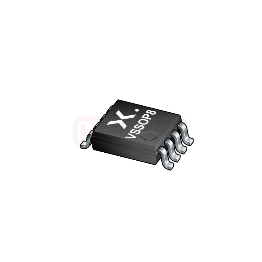

74AXP1T57 Dual supply configurable multiple function gate Rev. 5 — 3 July 2017 1 Product data sheet General description The 74AXP1T57 is a dual supply configurable multiple function gate with Schmitt-trigger inputs. It features three inputs (A, B and C), an output (Y) and dual supply pins (VCCI and VCCO). The inputs are referenced to VCCI and the output is referenced to VCCO. All inputs can be connected directly to VCCI or GND. VCCI can be supplied at any voltage between 0.7 V and 2.75 V and VCCO can be supplied at any voltage between 1.2 V and 5.5 V. This feature allows voltage level translation. The 74AXP1T57 can be configured as any of the following logic functions AND, OR, NAND, NOR, XNOR, inverter and buffer. This device ensures very low static and dynamic power consumption across the entire supply range and is fully specified for partial power down applications using IOFF. The IOFF circuitry disables the output, preventing the potentially damaging backflow current through the device when it is powered down. 2 Features and benefits • Wide supply voltage range: – VCCI: 0.7 V to 2.75 V – VCCO: 1.2 V to 5.5 V • Low input capacitance; CI = 0.6 pF (typical) • Low output capacitance; CO = 1.8 pF (typical) • Low dynamic power consumption; CPD = 0.6 pF at VCCI = 1.2 V (typical) • Low dynamic power consumption; CPD = 7.1 pF at VCCO = 3.3 V (typical) • Low static power consumption; ICCI = 0.5 μA (85 °C maximum) • Low static power consumption; ICCO = 1.8 μA (85 °C maximum) • High noise immunity • Complies with JEDEC standard: – JESD8-12A.01 (1.1 V to 1.3 V; A, B, C inputs) – JESD8-11A.01 (1.4 V to 1.6 V) – JESD8-7A (1.65 V to 1.95 V) – JESD8-5A.01 (2.3 V to 2.7 V) – JESD8-C (2.7 V to 3.6 V; Y output) – JESD12-6 (4.5 V to 5.5 V; Y output) • ESD protection: – HBM ANSI/ESDA/JEDEC JS-001 Class 2 exceeds 2 kV – CDM JESD22-C101E exceeds 1000 V • Latch-up performance exceeds 100 mA per JESD78D Class II • Inputs accept voltages up to 2.75 V • Low noise overshoot and undershoot < 10 % of VCCO • IOFF circuitry provides partial power-down mode operation • Multiple package options 74AXP1T57 Nexperia Dual supply configurable multiple function gate • Specified from -40 °C to +85 °C 3 Ordering information Table 1. Ordering information Type number Package Temperature range Name 74AXP1T57DC -40 °C to +85 °C VSSOP8 plastic very thin shrink small outline package; 8 leads; body width 2.3 mm SOT765-1 74AXP1T57GT -40 °C to +85 °C XSON8 plastic extremely thin small outline package; no leads; 8 terminals; body 1 x 1.95 x 0.5 mm SOT833-1 74AXP1T57GN -40 °C to +85 °C XSON8 extremely thin small outline package; no leads; 8 terminals; body 1.2 x 1.0 x 0.35 mm SOT1116 74AXP1T57GS -40 °C to +85 °C XSON8 extremely thin small outline package; no leads; 8 terminals; body 1.35 x 1.0 x 0.35 mm SOT1203 74AXP1T57GX -40 °C to +85 °C X2SON8 plastic thermal enhanced extremely thin small outline SOT1233 package; no leads; 8 terminals; body 1.35 x 0.8 x 0.35 mm 4 Description Version Marking Table 2. Marking Type number Marking code 74AXP1T57DC rD 74AXP1T57GT rD 74AXP1T57GN rD 74AXP1T57GS rD 74AXP1T57GX rD [1] 5 [1] The pin 1 indicator is located on the lower left corner of the device, below the marking code. Functional diagram A A 6 2 6 B C 3 2 Y B C 3 7 7 VCCI aaa-018525 Figure 1.  Logic symbol 74AXP1T57 Product data sheet Y VCCO aaa-018526 Figure 2.  Logic diagram All information provided in this document is subject to legal disclaimers. Rev. 5 — 3 July 2017 © Nexperia B.V. 2017. All rights reserved. 2 / 24 74AXP1T57 Nexperia Dual supply configurable multiple function gate 6 Pinning information 6.1 Pinning 74AXP1T57 74AXP1T57 VCCI 1 1 8 VCCO A 2 7 C B 3 6 Y 74AXP1T57 VCCI 1 7 C 6 Y 5 GND 8 VCCO 8 VCCO A 2 7 C B 3 6 Y GND 4 VCCI GND 4 5 A 4 GND GND B 5 GND Transparent top view Figure 3.  Pin configuration VSSOP8 Figure 4.  Pin configuration XSON8 3 aaa-027036 Transparent top view aaa-018528 aaa-018527 2 Figure 5.  Pin configuration X2SON8 6.2 Pin description Table 3. Pin description Symbol Pin Description VCCI 1 input supply voltage 2, 3, 7 data input 4, 5 ground (0 V) Y 6 data output VCCO 8 output supply voltage A, B, C GND [1] [1] All GND pins must be connected to ground (0 V). 74AXP1T57 Product data sheet All information provided in this document is subject to legal disclaimers. Rev. 5 — 3 July 2017 © Nexperia B.V. 2017. All rights reserved. 3 / 24 74AXP1T57 Nexperia Dual supply configurable multiple function gate 7 Functional description Table 4. Function table H = HIGH voltage level; L = LOW voltage level; X = don’t care; Z = high-impedance OFF-state. Supply voltage Output Input VCCI VCCO C B A Y 0.7 V to 2.75 V 1.2 V to 5.5 V L L L H 0.7 V to 2.75 V 1.2 V to 5.5 V L L H L 0.7 V to 2.75 V 1.2 V to 5.5 V L H L H 0.7 V to 2.75 V 1.2 V to 5.5 V L H H L 0.7 V to 2.75 V 1.2 V to 5.5 V H L L L 0.7 V to 2.75 V 1.2 V to 5.5 V H L H L 0.7 V to 2.75 V 1.2 V to 5.5 V H H L H 0.7 V to 2.75 V 1.2 V to 5.5 V H H H H GND 1.2 V to 5.5 V X X X Z 0.7 V to 2.75 V GND X X X Z GND GND X X X Z 7.1 Logic configurations Table 5. Function selection table Logic function Figure 2-input AND see Figure 6 2-input AND with both inputs inverted see Figure 9 2-input NAND with inverted input see Figure 7 and Figure 8 2-input OR with inverted input see Figure 7 and Figure 8 2-input NOR see Figure 9 2-input NOR with both inputs inverted see Figure 6 2-input XNOR see Figure 10 Inverter see Figure 11 Buffer see Figure 12 74AXP1T57 Product data sheet All information provided in this document is subject to legal disclaimers. Rev. 5 — 3 July 2017 © Nexperia B.V. 2017. All rights reserved. 4 / 24 74AXP1T57 Nexperia Dual supply configurable multiple function gate VCCI B C Y B C Y VCCO 1 B VCCI 8 2 7 C 3 6 Y 4 5 B C Y B C Y VCCO B 1 8 2 7 C 3 6 Y 4 5 aaa-018531 aaa-018530 Figure 6.  2-input AND gate or 2-input NOR gate with both inputs inverted VCCI A C A C Y A Y Figure 7.  2-input NAND gate with input B inverted or 2input OR gate with inverted C input VCCO 1 8 2 7 C 3 6 Y 4 5 VCCI A C Y A C VCCO A Y 1 8 2 7 C 3 6 Y 4 5 aaa-018532 aaa-018533 Figure 8.  2-input NAND gate with input C inverted or 2input OR gate with inverted A input VCCI B C Y B Figure 9.  2-input NOR gate or 2-input AND gate with both inputs inverted VCCO 1 8 2 7 C 3 6 Y 4 5 VCCI Y A aaa-018534 A VCCO 1 8 2 7 3 6 4 5 Y aaa-018535 Figure 10.  2-input XNOR gate Figure 11.  Inverter VCCI B Y B VCCO 1 8 2 7 3 6 4 5 Y aaa-018536 Figure 12.  Buffer 74AXP1T57 Product data sheet All information provided in this document is subject to legal disclaimers. Rev. 5 — 3 July 2017 © Nexperia B.V. 2017. All rights reserved. 5 / 24 74AXP1T57 Nexperia Dual supply configurable multiple function gate 8 Limiting values Table 6. Limiting values In accordance with the Absolute Maximum Rating System (IEC 60134). Voltages are referenced to GND (ground = 0 V). Symbol Parameter VCCI Conditions Min Max Unit input supply voltage -0.5 +3.3 V VCCO output supply voltage -0.5 +6.0 V IIK input clamping current -50 - VI input voltage -0.5 +3.3 IOK output clamping current VO < 0 V -50 - VO output voltage Active mode VI < 0 V [1] Power-down or 3-state mode mA V mA [1] [2] -0.5 [1] -0.5 +6.0 V - ±25 mA IO output current ICCI input supply current - 50 mA ICCO output supply current - 50 mA IGND ground current -50 - mA Tstg storage temperature -65 +150 °C - 300 mW Min Max Unit Ptot [1] [2] [3] total power dissipation VO = 0 V to VCCO VCCO + 0.5 V Tamb = -40 °C to +85 °C [3] The minimum input and output voltage ratings may be exceeded if the input and output current ratings are observed. VCCO + 0.5 V should not exceed 6.0 V. For SOT833-1 package: above 70 °C the value of Ptot derates linearly with 3.2 mW/K. For SOT1203 package: above 80 °C the value of Ptot derates linearly with 3.6 mW/K. 9 Recommended operating conditions Table 7. Recommended operating conditions Voltages are referenced to GND (ground = 0 V). Symbol Parameter VCCI input supply voltage 0.7 2.75 V VCCO output supply voltage 1.2 5.5 V VI input voltage 0 2.75 V VO output voltage Active mode 0 VCCO V Power-down or 3-state mode 0 5.5 V -40 +85 °C Tamb Conditions ambient temperature 74AXP1T57 Product data sheet All information provided in this document is subject to legal disclaimers. Rev. 5 — 3 July 2017 © Nexperia B.V. 2017. All rights reserved. 6 / 24 74AXP1T57 Nexperia Dual supply configurable multiple function gate 10 Static characteristics Table 8. Static characteristics At recommended operating conditions, unless otherwise specified; voltages are referenced to GND (ground = 0 V). Symbol Parameter Conditions Tamb = -40 °C to +85 °C Min VT+ positive-going threshold voltage VT- VOH hysteresis voltage HIGH-level output voltage VOL LOW-level output voltage II IOZ Typ 25 °C Max 25 °C Max 85 °C see Figure 13 and Figure 14 VCCI = 0.75 V to 0.85 V 0.3VCCI - 0.8VCCI 0.8VCCI V VCCI = 1.1 V to 1.95 V 0.4VCCI - 0.7VCCI 0.7VCCI V VCCI = 2.3 V to 2.7 V 0.9 - 1.7 1.7 V VCCI = 0.75 V to 0.85 V 0.2VCCI - 0.7VCCI 0.7VCCI V VCCI = 1.1 V to 1.95 V 0.3VCCI - 0.6VCCI 0.6VCCI V VCCI = 2.3 V to 2.7 V 0.7 - 1.5 1.5 V VCCI = 0.75 V to 0.85 V 0.06VCCI - 0.5VCCI 0.5VCCI V VCCI = 1.1 V to 1.95 V 0.1VCCI - 0.4VCCI 0.4VCCI V VCCI = 2.3 V to 2.7 V 0.2 - 1.0 1.0 V - 1.05 - - V IO = -3 mA; VCCO = 1.4 V 1.05 - - - V IO = -4.5 mA; VCCO = 1.65 V 1.2 - - - V IO = -8 mA; VCCO = 2.3 V 1.7 - - - V IO = -10 mA; VCCO = 3.0 V 2.2 - - - V IO = -12 mA; VCCO = 4.5 V 3.7 - - - V - 0.18 - - V IO = 3 mA; VCCO = 1.4 V - - 0.35 0.35 V IO = 4.5 mA; VCCO = 1.65 V - - 0.45 0.45 V IO = 8 mA; VCCO = 2.3 V - - 0.7 0.7 V IO = 10 mA; VCCO = 3.0 V - - 0.8 0.8 V IO = 12 mA; VCCO = 4.5 V - - 0.8 0.8 V - ±0.001 ±0.1 ±0.5 μA - ±0.001 ±0.1 ±0.5 μA negative-going see Figure 13 and Figure 14 threshold voltage VH Unit see Figure 13 and Figure 14 IO = -2 mA; VCCO = 1.2 V IO = 2 mA; VCCO = 1.2 V input leakage VI = 0 V to 2.75 V; current VCCI = 0 V to 2.75 V OFF-state output VO = 0 V to 5.5 V; current 74AXP1T57 Product data sheet [1] [1] [1] VCCO = 1.2 V to 5.5 V All information provided in this document is subject to legal disclaimers. Rev. 5 — 3 July 2017 © Nexperia B.V. 2017. All rights reserved. 7 / 24 74AXP1T57 Nexperia Dual supply configurable multiple function gate Symbol Parameter Conditions Tamb = -40 °C to +85 °C Min IOFF power-off leakage inputs; VI = 0 V to 2.75 V; Unit Typ 25 °C Max 25 °C Max 85 °C [1] - ±0.01 ±0.1 ±0.5 μA [1] - ±0.01 ±0.1 ±0.5 μA [1] - ±0.02 ±0.1 ±0.5 μA [1] - ±0.02 ±0.1 ±0.5 μA VCCI = 0 V; VCCO = 0 V to 5.5 V current output; VO = 0 V to 5.5 V; VCCO = 0 V; VCCI = 0 V to 2.75 V; VI = 0 V to 2.75 V ΔIOFF additional inputs; VI = 0 V or 2.75 V; power-off leakage VCCI = 0 V to 0.1 V; VCCO = 0 V to 5.5 V current output; VO = 0 V or 5.5 V; VCCO = 0 V to 0.1 V; VCCI = 0 V to 2.75 V; VI = 0 V or 2.75 V [1] Typical values are measured at VCCI = VCCO = 1.2 V unless otherwise specified. VO VI VI VH VT- VT+ Figure 13.  Transfer characteristic 74AXP1T57 Product data sheet VT+ VH VT- VO mna207 mna208 Figure 14.  Definition of VT+, VT-, and VH All information provided in this document is subject to legal disclaimers. Rev. 5 — 3 July 2017 © Nexperia B.V. 2017. All rights reserved. 8 / 24 74AXP1T57 Nexperia Dual supply configurable multiple function gate Table 9. Static characteristics supply current At recommended operating conditions, unless otherwise specified; voltages are referenced to GND (ground = 0 V). Symbol Parameter Conditions Tamb = -40 °C to +85 °C Unit Typ 25 °C Max 25 °C Typ 85 °C Max 85 °C ICCI input supply current ICCO ΔICCI VI = 0 V or VCCI; VCCI = 0.7 V to 1.3 V [1] 1 100 10 300 nA VCCI = 1.3 V to 2.75 V [2] 1 100 20 500 nA VCCI = 2.75 V; VCCO = 0 V 1 100 20 500 nA VCCI = 0 V; VCCO = 5.5 V 1 100 1 100 nA output supply VI = 0 V or VCCI; IO = 0 A; current see Table 10 additional input VCCO = 1.2 V to 3.6 V [1] 0.001 1.0 0.01 1.2 μA VCCO = 3.6 V to 5.5 V [3] 0.8 1.5 1.0 1.8 μA VCCI = 2.75 V; VCCO = 0 V 0.001 0.1 0.003 0.2 μA VCCI = 0 V; VCCO = 3.6 V 0.2 0.6 0.3 0.8 μA VCCI = 0 V; VCCO = 5.5 V 0.4 0.8 0.5 1.0 μA 2 100 14 150 μA VI = VCCI - 0.5 V; VCCI = 2.5 V supply current [1] [2] [3] Typical values are measured at VCCI = VCCO = 1.2 V unless otherwise specified. Typical values are measured at VCCI = VCCO = 2.5 V. Typical values are measured at VCCI = 1.2 V and VCCO = 5.0 V. Table 10. Typical output supply current (ICCO) VCCI VCCO Unit 0V 1.2 V 1.5 V 1.8 V 2.5 V 3.3 V 5.0 V 0V 0 1 5 20 100 200 400 nA 0.8 V 1 10 150 200 300 500 800 nA 1.2 V 1 1 5 200 300 500 800 nA 1.5 V 1 1 5 100 300 500 800 nA 1.8 V 1 1 5 100 300 500 800 nA 2.5 V 1 1 5 100 100 500 800 nA 74AXP1T57 Product data sheet All information provided in this document is subject to legal disclaimers. Rev. 5 — 3 July 2017 © Nexperia B.V. 2017. All rights reserved. 9 / 24 74AXP1T57 Nexperia Dual supply configurable multiple function gate 11 Dynamic characteristics Table 11. Dynamic characteristics Voltages are referenced to GND (ground = 0 V); for test circuit, see Figure 22; for waveform, see Figure 15. Symbol Parameter Conditions VCCO 1.2 V [1] Typ Unit 1.5 V ± 0.1 V Min [1] Typ 1.8 V ± 0.15 V Max Min [1] Typ Max Tamb = 25 °C tpd [2] propagation A, B and C to Y delay VCCI = 0.75 V to 0.85 V 25 4 20 76 4 18 72 ns VCCI = 1.1 V to 1.3 V 16.5 3.4 10.9 21.0 3.0 8.9 17.0 ns VCCI = 1.4 V to 1.6 V 15.5 3.1 9.9 19.0 2.6 7.9 14.0 ns VCCI = 1.65 V to 1.95 V 15.0 2.6 9.4 18.0 2.1 7.4 12.5 ns VCCI = 2.3 V to 2.7 V 14.5 2.7 8.9 17.5 2.2 6.9 11.7 ns 25 3 20 151 3 18 148 ns VCCI = 1.1 V to 1.3 V 16.5 3.4 10.9 21.0 3.0 8.9 17.0 ns VCCI = 1.4 V to 1.6 V 15.5 3.1 9.9 19.0 2.6 7.9 14.0 ns VCCI = 1.65 V to 1.95 V 15.0 2.6 9.4 18.0 2.1 7.4 12.5 ns 14.5 2.7 8.9 17.5 2.2 6.9 11.7 ns - 1.0 - - 1.0 - - ns Tamb = -40 °C to +85 °C tpd [2] propagation A, B and C to Y delay VCCI = 0.75 V to 0.85 V VCCI = 2.3 V to 2.7 V tt transition VCCI = 0.75 V to 2.7 V [3] time [1] [2] [3] Typical values are measured at nominal supply voltages and Tamb = +25 °C. tpd is the same as tPLH and tPHL. tt is the same as tTHL and tTLH. 74AXP1T57 Product data sheet All information provided in this document is subject to legal disclaimers. Rev. 5 — 3 July 2017 © Nexperia B.V. 2017. All rights reserved. 10 / 24 74AXP1T57 Nexperia Dual supply configurable multiple function gate Table 12. Dynamic characteristics Voltages are referenced to GND (ground = 0 V); for test circuit, see Figure 22; for waveform, see Figure 15. Symbol Parameter Conditions VCCO 2.5 V ± 0.2 V Min Typ [1] Unit 3.3 V ± 0.3 V Max Min Typ [1] 5.0 V ± 0.5 V Max Min Typ [1] Max Tamb = 25 °C tpd [2] propagation A, B and C to Y delay VCCI = 0.75 V to 0.85 V 3 16 72 3 16 80 3 17 92 ns VCCI = 1.1 V to 1.3 V 2.6 7.3 12.0 2.5 6.7 10.7 2.4 6.4 10.2 ns VCCI = 1.4 V to 1.6 V 2.3 6.2 9.9 2.1 5.6 9.0 2.1 5.3 8.5 ns VCCI = 1.65 V to 1.95 V 1.7 5.7 9.3 1.6 5.1 8.3 1.5 4.8 7.9 ns VCCI = 2.3 V to 2.7 V 1.9 5.2 8.7 1.8 4.6 7.7 1.7 4.3 7.2 ns 2 16 167 2 16 194 2 17 225 ns VCCI = 1.1 V to 1.3 V 2.6 7.3 12.0 2.5 6.7 10.7 2.4 6.4 10.2 ns VCCI = 1.4 V to 1.6 V 2.3 6.2 9.9 2.1 5.6 9.0 2.1 5.3 8.5 ns VCCI = 1.65 V to 1.95 V 1.7 5.7 9.3 1.6 5.1 8.3 1.5 4.8 7.9 ns 1.9 5.2 8.7 1.8 4.6 7.7 1.7 4.3 7.2 ns 1.0 - - 1.0 - - 1.0 - - ns Tamb = -40 °C to +85 °C tpd [2] propagation A, B and C to Y delay VCCI = 0.75 V to 0.85 V VCCI = 2.3 V to 2.7 V tt transition VCCI = 0.75 V to 2.7 V [3] time [1] [2] [3] Typical values are measured at nominal supply voltages and tamb = +25 °C. tpd is the same as tPLH and tPHL. tt is the same as tTHL and tTLH. 74AXP1T57 Product data sheet All information provided in this document is subject to legal disclaimers. Rev. 5 — 3 July 2017 © Nexperia B.V. 2017. All rights reserved. 11 / 24 74AXP1T57 Nexperia Dual supply configurable multiple function gate Table 13. Typical dynamic characteristics at Tamb = 25 °C Voltages are referenced to GND (ground = 0 V); for test circuit, see Figure 22; for waveform, see Figure 15. Symbol Parameter Conditions CPD VCCO 1.2 V 1.5 V 1.8 V 2.5 V 3.3 V 5.0 V VCCI = 0.8 V 0.5 0.5 0.5 0.5 0.5 0.5 pF VCCI = 1.2 V 0.6 0.6 0.6 0.6 0.6 0.6 pF VCCI = 1.5 V 0.7 0.7 0.7 0.7 0.7 0.7 pF VCCI = 1.8 V 0.8 0.8 0.8 0.8 0.8 0.8 pF 1.0 1.0 1.0 1.0 1.0 1.0 pF VCCI = 0.8 V 6.7 6.8 6.8 6.9 7.5 9.5 pF VCCI = 1.2 V 6.8 6.9 7.0 7.0 7.1 7.6 pF VCCI = 1.5 V 6.9 6.9 6.9 7.0 7.1 7.6 pF VCCI = 1.8 V 6.9 6.9 6.9 7.0 7.2 7.6 pF VCCI = 2.5 V 6.9 7.0 7.0 7.0 7.2 7.6 pF VI = 0 V or VCCI; VCCI = 0 V to 2.7 V 0.6 0.6 0.6 0.6 0.6 0.6 pF VO = 0 V; VCCO = 0 V 1.8 1.8 1.8 1.8 1.8 1.8 pF power fi = 1 MHz; RL = ∞ Ω; VI = 0 V to VCCI [1] dissipation input supply [2] capacitance VCCI = 2.5 V [3] output supply CI input Unit capacitance CO output capacitance [1] [2] [3] CPD is used to determine the dynamic power dissipation (PD in μW). Power dissipated from input supply (VCCI) 2 PD = CPD × VCCI × fi × N where: CPD = power dissipation capacitance of the input supply. VCCI = input supply voltage in V; fi = input frequency in MHz; N = number of inputs switching; Power dissipated from output supply (VCCO) 2 PD = (CL + CPD) x VCCO x fo where: CL = load capacitance in pF; CPD = power dissipation capacitance of the output supply. VCCO = output supply voltage in V; fo = output frequency in MHz; 74AXP1T57 Product data sheet All information provided in this document is subject to legal disclaimers. Rev. 5 — 3 July 2017 © Nexperia B.V. 2017. All rights reserved. 12 / 24 74AXP1T57 Nexperia Dual supply configurable multiple function gate 11.1 Waveforms and graphs VI A, B, C input VM VM 0V tPHL VOH tPLH 90 % Y output 90 % VM VM 10 % VOL 10 % tTHL tTLH aaa-008187 Measurement points are given in Table 14. VOL and VOH are typical output voltage levels that occur with the output load. Figure 15.  Input A, B and C to output Y propagation delay times and output transition times Table 14. Measurement points Supply voltage Output Input VCCI VCCO VM VM VI 0.75 V to 2.7 V 1.2 V to 5.5 V 0.5VCCO 0.5VCCI VCCI aaa-018538 6 tpd (ns) aaa-018539 6 (3) tpd (ns) (3) (2) (2) 4 4 (1) (1) 2 2 0 0 30 60 90 CL (pF) 0 120 0 30 60 90 CL (pF) 120 Tamb = -40 °C to +85 °C unless otherwise specified. Tamb = -40 °C to +85 °C unless otherwise specified. (1) Minimum: VCCO = 5.5 V (1) Minimum: VCCO = 3.6 V (2) Typical: Tamb = 25 °C; VCCO = 5 V (2) Typical: Tamb = 25 °C; VCCO = 3.3 V (3) Maximum: VCCO = 4.5 V (3) Maximum: VCCO = 3 V Figure 16.  Additional propagation delay versus load capacitance Figure 17.  Additional propagation delay versus load capacitance 74AXP1T57 Product data sheet All information provided in this document is subject to legal disclaimers. Rev. 5 — 3 July 2017 © Nexperia B.V. 2017. All rights reserved. 13 / 24 74AXP1T57 Nexperia Dual supply configurable multiple function gate aaa-018540 (3) 8 aaa-018541 12 (3) tpd (ns) tpd (ns) 6 (2) 4 8 (2) (1) (1) 4 2 0 0 30 60 90 CL (pF) 0 120 0 30 60 90 CL (pF) 120 Tamb = -40 °C to +85 °C unless otherwise specified. Tamb = -40 °C to +85 °C unless otherwise specified. (1) Minimum: VCCO = 2.7 V (1) Minimum: VCCO = 1.95 V (2) Typical: Tamb = 25 °C; VCCO = 2.5 V (2) Typical: Tamb = 25 °C; VCCO = 1.8 V (3) Maximum: VCCO = 2.3 V (3) Maximum: VCCO = 1.65 V Figure 18.  Additional propagation delay versus load capacitance Figure 19.  Additional propagation delay versus load capacitance aaa-018542 18 aaa-018543 18 (3) tpd (ns) tpd (ns) 12 12 (2) 6 0 6 (1) 0 30 60 90 CL (pF) 120 Tamb = -40 °C to +85 °C unless otherwise specified. 0 0 30 60 90 CL (pF) 120 Tamb = 25 °C; VCCO = 1.2 V. (1) Minimum: VCCO = 1.6 V (2) Typical: Tamb = 25 °C; VCCO = 1.5 V (3) Maximum: VCCO = 1.4 V Figure 20.  Additional propagation delay versus load capacitance 74AXP1T57 Product data sheet Figure 21.  Additional propagation delay versus load capacitance All information provided in this document is subject to legal disclaimers. Rev. 5 — 3 July 2017 © Nexperia B.V. 2017. All rights reserved. 14 / 24 74AXP1T57 Nexperia Dual supply configurable multiple function gate VI negative pulse tW 90 % 10 % 0V tf tr tr tf VI positive pulse 0V VM VM 90 % VM VM 10 % tW VCCI VCCO PULSE GENERATOR VI DUT RT VO CL RL aaa-018544 Test data is given in Table 15. Definitions test circuit: RT = termination resistance should be equal to output impedance Zo of the pulse generator. CL = load capacitance including jig and probe capacitance. RL = Load resistance. Figure 22.  Test circuit for measuring switching times Table 15. Test data Supply voltage Load Input VCCI VCCO CL RL tr, tf VI 0.75 V to 2.7 V 1.2 V to 5.5 V 5 pF 5 kΩ ≤3.0 ns VCCI 74AXP1T57 Product data sheet All information provided in this document is subject to legal disclaimers. Rev. 5 — 3 July 2017 © Nexperia B.V. 2017. All rights reserved. 15 / 24 74AXP1T57 Nexperia Dual supply configurable multiple function gate 12 Package outline VSSOP8: plastic very thin shrink small outline package; 8 leads; body width 2.3 mm D SOT765-1 E A X c y HE v A Z 5 8 Q A A2 A1 pin 1 index (A3) θ Lp 1 detail X 4 e L w bp 0 5 mm scale Dimensions (mm are the original dimensions) Unit mm A max. max nom min 1 A1 A2 0.15 0.85 0.00 0.60 A3 0.12 D(1) E(2) 0.27 0.23 2.1 2.4 0.17 0.08 1.9 2.2 bp c e HE 0.5 3.2 3.0 L 0.4 Lp Q 0.40 0.21 0.15 0.19 v w y 0.2 0.08 0.1 Z(1) θ 0.4 8° 0.1 0° Note 1. Plastic or metal protrusions of 0.15 mm maximum per side are not included. 2. Plastic or metal protrusions of 0.25 mm maximum per side are not included. Outline version SOT765-1 References IEC JEDEC JEITA sot765-1_po European projection Issue date 07-06-02 16-05-31 MO-187 Figure 23.  Package outline SOT765-1 (VSSOP8) 74AXP1T57 Product data sheet All information provided in this document is subject to legal disclaimers. Rev. 5 — 3 July 2017 © Nexperia B.V. 2017. All rights reserved. 16 / 24 74AXP1T57 Nexperia Dual supply configurable multiple function gate XSON8: plastic extremely thin small outline package; no leads; 8 terminals; body 1 x 1.95 x 0.5 mm 1 2 SOT833-1 b 4 3 4× (2) L L1 e 8 7 6 e1 5 e1 e1 8× A (2) A1 D E terminal 1 index area 0 1 2 mm scale DIMENSIONS (mm are the original dimensions) UNIT A(1) max A1 max b D E e e1 L L1 mm 0.5 0.04 0.25 0.17 2.0 1.9 1.05 0.95 0.6 0.5 0.35 0.27 0.40 0.32 Notes 1. Including plating thickness. 2. Can be visible in some manufacturing processes. REFERENCES OUTLINE VERSION IEC JEDEC JEITA SOT833-1 --- MO-252 --- EUROPEAN PROJECTION ISSUE DATE 07-11-14 07-12-07 Figure 24.  Package outline SOT833-1 (XSON8) 74AXP1T57 Product data sheet All information provided in this document is subject to legal disclaimers. Rev. 5 — 3 July 2017 © Nexperia B.V. 2017. All rights reserved. 17 / 24 74AXP1T57 Nexperia Dual supply configurable multiple function gate XSON8: extremely thin small outline package; no leads; 8 terminals; body 1.2 x 1.0 x 0.35 mm 1 2 SOT1116 b 4 3 (4×)(2) L L1 e 8 7 e1 6 e1 5 e1 (8×)(2) A1 A D E terminal 1 index area 0 0.5 Dimensions Unit mm 1 mm scale A(1) A1 b D E e e1 max 0.35 0.04 0.20 1.25 1.05 nom 0.15 1.20 1.00 0.55 min 0.12 1.15 0.95 0.3 L L1 0.35 0.40 0.30 0.35 0.27 0.32 Note 1. Including plating thickness. 2. Visible depending upon used manufacturing technology. Outline version sot1116_po References IEC JEDEC JEITA European projection Issue date 10-04-02 10-04-07 SOT1116 Figure 25.  Package outline SOT1116 (XSON8) 74AXP1T57 Product data sheet All information provided in this document is subject to legal disclaimers. Rev. 5 — 3 July 2017 © Nexperia B.V. 2017. All rights reserved. 18 / 24 74AXP1T57 Nexperia Dual supply configurable multiple function gate XSON8: extremely thin small outline package; no leads; 8 terminals; body 1.35 x 1.0 x 0.35 mm SOT1203 b 1 2 3 (4×)(2) 4 L L1 e 8 7 6 e1 e1 5 e1 (8×)(2) A1 A D E terminal 1 index area 0 0.5 Dimensions Unit mm 1 mm scale A(1) A1 b D E e e1 L L1 max 0.35 0.04 0.20 1.40 1.05 0.35 0.40 nom 0.15 1.35 1.00 0.55 0.35 0.30 0.35 min 0.12 1.30 0.95 0.27 0.32 Note 1. Including plating thickness. 2. Visible depending upon used manufacturing technology. Outline version sot1203_po References IEC JEDEC JEITA European projection Issue date 10-04-02 10-04-06 SOT1203 Figure 26.  Package outline SOT1203 (XSON8) 74AXP1T57 Product data sheet All information provided in this document is subject to legal disclaimers. Rev. 5 — 3 July 2017 © Nexperia B.V. 2017. All rights reserved. 19 / 24 74AXP1T57 Nexperia Dual supply configurable multiple function gate X2SON8: plastic thermal enhanced extremely thin small outline package; no leads; 8 terminals; body 1.35 x 0.8 x 0.35 mm SOT1233 X A B D A E A1 detail X pin 1 index area e e 1 2 pin 1 index area C b (6x) 8 v w 3 C A B C y 4 Dh L (6x) 7 6 b1 (2x) 5 y1 C e1 0 1 mm scale Dimensions (mm are the original dimensions) Unit mm A A1 max 0.35 0.04 nom 0.32 min 0.30 0.00 b 0.25 0.20 0.15 b1 D Dh E 1.40 0.27 0.85 0.15 1.35 0.22 0.80 (ref) 1.30 0.17 0.75 e 0.5 e1 L 0.27 0.54 0.22 0.17 v 0.1 w y y1 0.05 0.05 0.05 sot1233_po Outline version SOT1233 References IEC JEDEC JEITA European projection Issue date 16-04-21 17-01-05 --- Figure 27.  Package outline SOT1233 (X2SON8) 74AXP1T57 Product data sheet All information provided in this document is subject to legal disclaimers. Rev. 5 — 3 July 2017 © Nexperia B.V. 2017. All rights reserved. 20 / 24 74AXP1T57 Nexperia Dual supply configurable multiple function gate 13 Abbreviations Table 16. Abbreviations Acronym Description CDM Charged Device Model DUT Device Under Test ESD ElectroStatic Discharge HBM Human Body Model 14 Revision history Table 17. Revision history Document ID Release date Data sheet status Change notice Supersedes 74AXP1T57 v.5 20170703 Product data sheet - 74AXP1T57 v.4 Modifications: • Figure 27: Package outline drawing for SOT1233 / X2SON8) has changed. 74AXP1T57 v.4 20161028 Modifications: • Added type number 74AXP1T57GX (SOT1233/X2SON8) 74AXP1T57 v.3 20161007 Modifications: • Type numbers 74AXP1T57DP and 74AXP1T57GD removed. 74AXP1T57 v.2 20151222 Modifications: • • • • • • • • 74AXP1T57 v.1 20150803 74AXP1T57 Product data sheet Product data sheet Product data sheet Product data sheet - 74AXP1T57 v.3 74AXP1T57 v.2 74AXP1T57 v.1 Table 6: Conditions VO corrected (errata). Table 6: Derating values for packages added (errata). Table 7: Conditions VO corrected (errata). Table 8: Conditions IOZ corrected (errata). Table 9: Conditions ΔICCI corrected (errata). Table 11 and Table 12: Conditions tτ corrected (errata). Table 11: Conditions tτ corrected (errata). Table 13: Removed "leadless packages" from conditions (errata). Product data sheet - All information provided in this document is subject to legal disclaimers. Rev. 5 — 3 July 2017 - © Nexperia B.V. 2017. All rights reserved. 21 / 24 74AXP1T57 Nexperia Dual supply configurable multiple function gate 15 Legal information 15.1 Data sheet status Document status [1][2] Product status [3] Definition Objective [short] data sheet Development This document contains data from the objective specification for product development. Preliminary [short] data sheet Qualification This document contains data from the preliminary specification. Product [short] data sheet Production This document contains the product specification. [1] [2] [3] Please consult the most recently issued document before initiating or completing a design. The term 'short data sheet' is explained in section "Definitions". The product status of device(s) described in this document may have changed since this document was published and may differ in case of multiple devices. The latest product status information is available on the Internet at URL http://www.nexperia.com. 15.2 Definitions Draft — The document is a draft version only. The content is still under internal review and subject to formal approval, which may result in modifications or additions. Nexperia does not give any representations or warranties as to the accuracy or completeness of information included herein and shall have no liability for the consequences of use of such information. Short data sheet — A short data sheet is an extract from a full data sheet with the same product type number(s) and title. A short data sheet is intended for quick reference only and should not be relied upon to contain detailed and full information. For detailed and full information see the relevant full data sheet, which is available on request via the local Nexperia sales office. In case of any inconsistency or conflict with the short data sheet, the full data sheet shall prevail. Product specification — The information and data provided in a Product data sheet shall define the specification of the product as agreed between Nexperia and its customer, unless Nexperia and customer have explicitly agreed otherwise in writing. In no event however, shall an agreement be valid in which the Nexperia product is deemed to offer functions and qualities beyond those described in the Product data sheet. 15.3 Disclaimers Limited warranty and liability — Information in this document is believed to be accurate and reliable. However, Nexperia does not give any representations or warranties, expressed or implied, as to the accuracy or completeness of such information and shall have no liability for the consequences of use of such information. Nexperia takes no responsibility for the content in this document if provided by an information source outside of Nexperia. In no event shall Nexperia be liable for any indirect, incidental, punitive, special or consequential damages (including - without limitation lost profits, lost savings, business interruption, costs related to the removal or replacement of any products or rework charges) whether or not such damages are based on tort (including negligence), warranty, breach of contract or any other legal theory. Notwithstanding any damages that customer might incur for any reason whatsoever, Nexperia's aggregate and cumulative liability towards customer for the products described herein shall be limited in accordance with the Terms and conditions of commercial sale of Nexperia. Right to make changes — Nexperia reserves the right to make changes to information published in this document, including without limitation specifications and product descriptions, at any time and without notice. This document supersedes and replaces all information supplied prior to the publication hereof. Suitability for use — Nexperia products are not designed, authorized or warranted to be suitable for use in life support, life-critical or safety-critical 74AXP1T57 Product data sheet systems or equipment, nor in applications where failure or malfunction of an Nexperia product can reasonably be expected to result in personal injury, death or severe property or environmental damage. Nexperia and its suppliers accept no liability for inclusion and/or use of Nexperia products in such equipment or applications and therefore such inclusion and/or use is at the customer’s own risk. Applications — Applications that are described herein for any of these products are for illustrative purposes only. Nexperia makes no representation or warranty that such applications will be suitable for the specified use without further testing or modification. Customers are responsible for the design and operation of their applications and products using Nexperia products, and Nexperia accepts no liability for any assistance with applications or customer product design. It is customer’s sole responsibility to determine whether the Nexperia product is suitable and fit for the customer’s applications and products planned, as well as for the planned application and use of customer’s third party customer(s). Customers should provide appropriate design and operating safeguards to minimize the risks associated with their applications and products. Nexperia does not accept any liability related to any default, damage, costs or problem which is based on any weakness or default in the customer’s applications or products, or the application or use by customer’s third party customer(s). Customer is responsible for doing all necessary testing for the customer’s applications and products using Nexperia products in order to avoid a default of the applications and the products or of the application or use by customer’s third party customer(s). Nexperia does not accept any liability in this respect. Limiting values — Stress above one or more limiting values (as defined in the Absolute Maximum Ratings System of IEC 60134) will cause permanent damage to the device. Limiting values are stress ratings only and (proper) operation of the device at these or any other conditions above those given in the Recommended operating conditions section (if present) or the Characteristics sections of this document is not warranted. Constant or repeated exposure to limiting values will permanently and irreversibly affect the quality and reliability of the device. Terms and conditions of commercial sale — Nexperia products are sold subject to the general terms and conditions of commercial sale, as published at http://www.nexperia.com/profile/terms, unless otherwise agreed in a valid written individual agreement. In case an individual agreement is concluded only the terms and conditions of the respective agreement shall apply. Nexperia hereby expressly objects to applying the customer’s general terms and conditions with regard to the purchase of Nexperia products by customer. No offer to sell or license — Nothing in this document may be interpreted or construed as an offer to sell products that is open for acceptance or the grant, conveyance or implication of any license under any copyrights, patents or other industrial or intellectual property rights. Export control — This document as well as the item(s) described herein may be subject to export control regulations. Export might require a prior authorization from competent authorities. All information provided in this document is subject to legal disclaimers. Rev. 5 — 3 July 2017 © Nexperia B.V. 2017. All rights reserved. 22 / 24 74AXP1T57 Nexperia Dual supply configurable multiple function gate Non-automotive qualified products — Unless this data sheet expressly states that this specific Nexperia product is automotive qualified, the product is not suitable for automotive use. It is neither qualified nor tested in accordance with automotive testing or application requirements. Nexperia accepts no liability for inclusion and/or use of non-automotive qualified products in automotive equipment or applications. In the event that customer uses the product for design-in and use in automotive applications to automotive specifications and standards, customer (a) shall use the product without Nexperia's warranty of the product for such automotive applications, use and specifications, and (b) whenever customer uses the product for automotive applications beyond Nexperia's specifications such use shall be solely at customer’s own risk, and (c) customer fully indemnifies Nexperia for any liability, damages or failed product claims resulting from customer 74AXP1T57 Product data sheet design and use of the product for automotive applications beyond Nexperia's standard warranty and Nexperia's product specifications. Translations — A non-English (translated) version of a document is for reference only. The English version shall prevail in case of any discrepancy between the translated and English versions. 15.4 Trademarks Notice: All referenced brands, product names, service names and trademarks are the property of their respective owners. All information provided in this document is subject to legal disclaimers. Rev. 5 — 3 July 2017 © Nexperia B.V. 2017. All rights reserved. 23 / 24 74AXP1T57 Nexperia Dual supply configurable multiple function gate Contents 1 2 3 4 5 6 6.1 6.2 7 7.1 8 9 10 11 11.1 12 13 14 15 General description ............................................ 1 Features and benefits .........................................1 Ordering information .......................................... 2 Marking .................................................................2 Functional diagram ............................................. 2 Pinning information ............................................ 3 Pinning ............................................................... 3 Pin description ................................................... 3 Functional description ........................................4 Logic configurations ...........................................4 Limiting values .................................................... 6 Recommended operating conditions ................ 6 Static characteristics .......................................... 7 Dynamic characteristics ...................................10 Waveforms and graphs ................................... 13 Package outline .................................................16 Abbreviations .................................................... 21 Revision history ................................................ 21 Legal information .............................................. 22 Please be aware that important notices concerning this document and the product(s) described herein, have been included in section 'Legal information'. © Nexperia B.V. 2017. All rights reserved. For more information, please visit: http://www.nexperia.com For sales office addresses, please send an email to: salesaddresses@nexperia.com Date of release: 3 July 2017 Document identifier: 74AXP1T57 Mouser Electronics Authorized Distributor Click to View Pricing, Inventory, Delivery & Lifecycle Information: Nexperia: 74AXP1T57GNX 74AXP1T57GSX 74AXP1T57GTX 74AXP1T57DCH 74AXP1T57GXX
