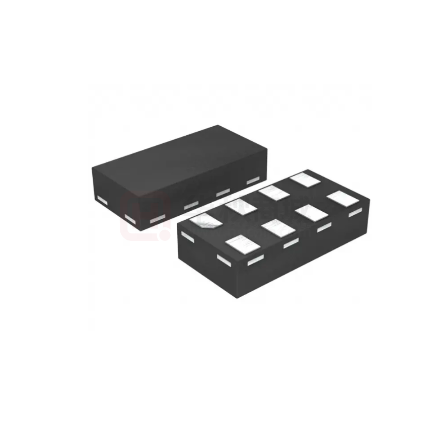

74CBTLV3306GTX
74CBTLV3306GTX
    NEXPERIA(安世)
    XDFN8
    2位总线开关 XSON8_1.95X1MM 2.3~3.6V
74CBTLV3306GTX 数据手册
74CBTLV3306 2-bit bus switch Rev. 1 — 7 December 2016 Product data sheet 1. General description The 74CBTLV3306 is a 2-bit high-speed bus switch with separate output enable inputs (nOE). Each switch is disabled when the associated output enable (nOE) input is HIGH. To ensure the high-impedance OFF-state during power-up or power-down, nOE should be tied to the VCC through a pull-up resistor. The minimum value of the resistor is determined by the current-sinking capability of the driver. Schmitt trigger action at control input makes the circuit tolerant to slower input rise and fall times across the entire VCC range from 2.3 V to 3.6 V. This device is fully specified for partial power-down applications using IOFF. The IOFF circuitry disables the output, preventing the damaging backflow current through the device when it is powered down. 2. Features and benefits  Supply voltage range from 2.3 V to 3.6 V  High noise immunity  Complies with JEDEC standard:  JESD8-5 (2.3 V to 2.7 V)  JESD8-B/JESD36 (2.7 V to 3.6 V)  ESD protection:  HBM JESD22-A114F exceeds 2000 V  MM JESD22-A115-A exceeds 200 V  CDM AEC-Q100-011 revision B exceeds 1000 V  4  switch connection between two ports  Rail to rail switching on data I/O ports  CMOS low power consumption  Latch-up performance exceeds 250 mA per JESD78B Class I level A  IOFF circuitry provides partial Power-down mode operation  Multiple package options  Specified from 40 C to +85 C and 40 C to +125 C 74CBTLV3306 Nexperia 2-bit bus switch 3. Ordering information Table 1. Ordering information Type number Package Temperature range Name Description Version 74CBTLV3306DC 40 C to +125 C VSSOP8 plastic very thin shrink small outline package; 8 leads; SOT765-1 body width 2.3 mm 74CBTLV3306GT 40 C to +125 C XSON8 plastic extremely thin small outline package; no leads; SOT833-1 8 terminals; body 1  1.95  0.5 mm 4. Marking Table 2. Marking codes Type number Marking code[1] 74CBTLV3306DC b6 74CBTLV3306GT b6 [1] The pin 1 indicator is located on the lower left corner of the device, below the marking code. 5. Functional diagram 2( % $ Q$ Q% 2( $ % Q2( DDD Fig 1. Logic symbol 74CBTLV3306 Product data sheet Fig 2. DDN Logic diagram (one switch) All information provided in this document is subject to legal disclaimers. Rev. 1 — 7 December 2016 © Nexperia B.V. 2017. All rights reserved 2 of 17 74CBTLV3306 Nexperia 2-bit bus switch 6. Pinning information 6.1 Pinning &%7/9 2(   9&& $   2( %   % *1'   $ &%7/9 2(   9&& $   2( %   % *1'   $ DDD 7UDQVSDUHQWWRSYLHZ DDD Fig 3. Pin configuration SOT765-1 Fig 4. Pin configuration SOT833-1 6.2 Pin description Table 3. Pin description Symbol Pin Description 1OE, 2OE 1, 7 output enable input 1A, 2A 2, 5 data input/output (A port) 1B, 2B 3, 6 data input/output (B port) GND 4 ground (0 V) VCC 8 positive supply voltage 7. Functional description Table 4. Function selection[1] Input Input/output nOE nA, nB L nA = nB H Z [1] H = HIGH voltage level; L = LOW voltage level; Z = high-impedance OFF-state. 74CBTLV3306 Product data sheet All information provided in this document is subject to legal disclaimers. Rev. 1 — 7 December 2016 © Nexperia B.V. 2017. All rights reserved 3 of 17 74CBTLV3306 Nexperia 2-bit bus switch 8. Limiting values Table 5. Limiting values In accordance with the Absolute Maximum Rating System (IEC 60134). Voltages are referenced to GND (ground = 0 V). Symbol Parameter Conditions VCC supply voltage Min Max Unit 0.5 +4.6 V 0.5 +4.6 V 0.5 VCC + 0.5 V VI input voltage control inputs [1] VSW switch voltage enable and disable mode [2] IIK input clamping current VI < 0.5 V 50 - mA ISK switch clamping current VI < 0.5 V 50 - mA VSW = 0 V to VCC ISW switch current - 128 mA ICC supply current - +100 mA IGND ground current 100 - mA Tstg storage temperature 65 +150 C - 500 mW total power dissipation Ptot Tamb = 40 C to +125 C [3] [1] The minimum input voltage rating may be exceeded if the input clamping current ratings are observed. [2] The switch voltage ratings may be exceeded if switch clamping current ratings are observed [3] For VSSOP8 packages: above 110 C, the value of Ptot derates linearly with 8.0 mW/K. For XSON8 packages: above 118 C the value of Ptot derates linearly with 7.8 mW/K. 9. Recommended operating conditions Table 6. Recommended operating conditions Symbol Parameter VCC supply voltage Conditions VI input voltage VSW switch voltage Tamb ambient temperature t/V input transition rise and fall rate Min Max Unit 2.3 3.6 V control inputs 0 3.6 V enable and disable mode 0 VCC V 40 +125 C 0 200 ns/V pin nOE; VCC = 2.3 V to 3.6 V 10. Static characteristics Table 7. Static characteristics At recommended operating conditions voltages are referenced to GND (ground = 0 V). Symbol Parameter Tamb = 40 C to +85 C Conditions Tamb = 40 C to +125 C Unit Min Typ[1] Max Min Max VCC = 2.3 V to 2.7 V 1.7 - - 1.7 - V VCC = 3.0 V to 3.6 V 2.0 - - 2.0 - V LOW-level input VCC = 2.3 V to 2.7 V voltage VCC = 3.0 V to 3.6 V - - 0.7 - 0.7 V - - 0.9 - 0.9 V II input leakage current - - 1.0 - 20 A IS(OFF) OFF-state VCC = 3.6 V; see Figure 5 leakage current - - 1 - 20 A VIH VIL HIGH-level input voltage 74CBTLV3306 Product data sheet pin nOE; VI = GND to VCC; VCC = 3.6 V All information provided in this document is subject to legal disclaimers. Rev. 1 — 7 December 2016 © Nexperia B.V. 2017. All rights reserved 4 of 17 74CBTLV3306 Nexperia 2-bit bus switch Table 7. Static characteristics …continued At recommended operating conditions voltages are referenced to GND (ground = 0 V). Symbol Parameter Tamb = 40 C to +85 C Conditions Tamb = 40 C to +125 C Unit Min Typ[1] Max Min Max IS(ON) ON-state VCC = 3.6 V; see Figure 6 leakage current - - 1 - 20 A IOFF power-off VI or VO = 0 V to 3.6 V; leakage current VCC = 0 V - - 10 - 50 A ICC supply current VI = GND or VCC; IO = 0 A; VSW = GND or VCC; VCC = 3.6 V - - 10 - 50 A ICC additional supply current pin nOE; VI = VCC  0.6 V; VSW = GND or VCC; VCC = 3.6 V - - 300 - 2000 A CI input capacitance pin nOE; VCC = 3.3 V; VI = 0 V to 3.3 V - 0.9 - - - pF CS(OFF) OFF-state capacitance VCC = 3.3 V; VI = 0 V to 3.3 V - 3.0 - - - pF CS(ON) ON-state capacitance VCC = 3.3 V; VI = 0 V to 3.3 V - 10.6 - - - pF [1] All typical values are measured at Tamb = 25 C. [2] One input at 3 V, other inputs at VCC or GND. [2] 10.1 Test circuits 9&& 9&& Q2( 9,+ $ 9, ,6 Q% Q$ Q2( 9,/ ,6 $ $ *1' 9, 92 ,6 Q$ Q% *1' 92 DDN DDN VI = VCC or GND and VO = GND or VCC. Fig 5. VI = VCC or GND and VO = open circuit. Test circuit for measuring OFF-state leakage current (one switch) 74CBTLV3306 Product data sheet Fig 6. Test circuit for measuring ON-state leakage current (one switch) All information provided in this document is subject to legal disclaimers. Rev. 1 — 7 December 2016 © Nexperia B.V. 2017. All rights reserved 5 of 17 74CBTLV3306 Nexperia 2-bit bus switch 10.2 ON resistance Table 8. Resistance RON At recommended operating conditions; voltages are referenced to GND (ground = 0 V); for test circuit see Figure 7. Symbol Parameter RON Tamb = 40 C to +85 C Conditions Tamb = 40 C to +125 C Unit Min Typ[1] Max Min Max ISW = 64 mA; VI = 0 V - 3.6 8.0 - 15.0  ISW = 24 mA; VI = 0 V - 3.6 8.0 - 15.0  ISW = 15 mA; VI = 1.7 V - 6.6 40.0 - 60.0  ISW = 64 mA; VI = 0 V - 3.5 7.0 - 11.0  ISW = 24 mA; VI = 0 V - 3.5 7.0 - 11.0  ISW = 15 mA; VI = 2.4 V - 4.6 15.0 - 25.5  ON resistance VCC = 2.3 V to 2.7 V; see Figure 8 to Figure 10 [2] VCC = 3.0 V to 3.6 V; see Figure 11 to Figure 13 [1] Typical values are measured at Tamb = 25 C and nominal VCC. [2] Measured by the voltage drop between the A and B terminals at the indicated current through the switch. ON-state resistance is determined by the lower of the voltages of the two (A or B) terminals. 10.3 ON resistance test circuit and graphs DDD  521 ȍ  96: 9  9&&   Q2( 9,/ Q$  Q%   9, *1' ,6:       9, 9 DDN  (1) Tamb = 125 C. RON = VSW / ISW. (2) Tamb = 85 C. (3) Tamb = 25 C. (4) Tamb = 40 C. Fig 7. Test circuit for measuring ON resistance (one switch) 74CBTLV3306 Product data sheet Fig 8. ON resistance as a function of input voltage; VCC = 2.5 V; ISW = 15 mA All information provided in this document is subject to legal disclaimers. Rev. 1 — 7 December 2016 © Nexperia B.V. 2017. All rights reserved 6 of 17 74CBTLV3306 Nexperia 2-bit bus switch DDD  521 ȍ DDD  521 ȍ                     9, 9      (1) Tamb = 125 C. (1) Tamb = 125 C. (2) Tamb = 85 C. (2) Tamb = 85 C. (3) Tamb = 25 C. (3) Tamb = 25 C. (4) Tamb = 40 C. (4) Tamb = 40 C. Fig 9. ON resistance as a function of input voltage; VCC = 2.5 V; ISW = 24 mA 521 ȍ  9, 9  Fig 10. ON resistance as a function of input voltage; VCC = 2.5 V; ISW = 64 mA DDD   DDD  521 ȍ                           9, 9       (1) Tamb = 125 C. (1) Tamb = 125 C. (2) Tamb = 85 C. (2) Tamb = 85 C. (3) Tamb = 25 C. (3) Tamb = 25 C. (4) Tamb = 40 C. (4) Tamb = 40 C. Fig 11. ON resistance as a function of input voltage; VCC = 3.3 V; ISW = 15 mA 74CBTLV3306 Product data sheet      9, 9  Fig 12. ON resistance as a function of input voltage; VCC = 3.3 V; ISW = 24 mA All information provided in this document is subject to legal disclaimers. Rev. 1 — 7 December 2016 © Nexperia B.V. 2017. All rights reserved 7 of 17 74CBTLV3306 Nexperia 2-bit bus switch DDD  521 ȍ                   9, 9  (1) Tamb = 125 C. (2) Tamb = 85 C. (3) Tamb = 25 C. (4) Tamb = 40 C. Fig 13. ON resistance as a function of input voltage; VCC = 3.3 V; ISW = 64 mA 11. Dynamic characteristics Table 9. Dynamic characteristics GND = 0 V; for test circuit see Figure 16 Symbol Parameter Tamb = 40 C to +85 C Tamb = 40 C to +125 C Unit Conditions Min Typ[1] Max Min Max - - 0.13 - 0.20 ns - - 0.20 - 0.31 ns 1.0 2.7 4.6 1.0 6.0 ns 1.0 2.4 4.4 1.0 6.0 ns VCC = 2.3 V to 2.7 V 1.0 2.2 3.9 1.0 5.5 ns VCC = 3.0 V to 3.6 V 1.0 2.9 4.2 1.0 5.5 ns propagation delay nA to nB or nB to nA; see Figure 14 tpd [2][3] VCC = 2.3 V to 2.7 V VCC = 3.0 V to 3.6 V enable time ten [4] nOE to nA or nB; see Figure 15 VCC = 2.3 V to 2.7 V VCC = 3.0 V to 3.6 V disable time tdis [5] nOE to nA or nB; see Figure 15 [1] All typical values are measured at Tamb = 25 C and at nominal VCC. [2] The propagation delay is the calculated RC time constant of the typical ON resistance of the switch and the load capacitance, when driven by an ideal voltage source (zero output impedance). [3] tpd is the same as tPLH and tPHL. [4] ten is the same as tPZH and tPZL. [5] tdis is the same as tPHZ and tPLZ. 74CBTLV3306 Product data sheet All information provided in this document is subject to legal disclaimers. Rev. 1 — 7 December 2016 © Nexperia B.V. 2017. All rights reserved 8 of 17 74CBTLV3306 Nexperia 2-bit bus switch 12. Waveforms 9, LQSXW 90 90 9 W3+/ W3/+ 92+ 90 RXWSXW 90 92/ DDL Measurement points are given in Table 10. Logic levels: VOL and VOH are typical output voltage levels that occur with the output load. Fig 14. The data input (nA or nB) to output (nB or nA) propagation delays Table 10. Measurement points Supply voltage Input Output VCC VM VI tr = tf VM VX VY 2.3 V to 2.7 V 0.5VCC VCC  2.0 ns 0.5VCC VOL + 0.15 V VOH  0.15 V 3.0 V to 3.6 V 0.5VCC VCC  2.0 ns 0.5VCC VOL + 0.3 V VOH  0.3 V 9, Q2(LQSXW 90 *1' W3/= W3=/ 9&& RXWSXW /2:WR2)) 2))WR/2: 90 9; 92/ W3+= 92+ W3=+ 9< RXWSXW +,*+WR2)) 2))WR+,*+ 90 *1' VZLWFK HQDEOHG VZLWFK GLVDEOHG VZLWFK HQDEOHG DDN Measurement points are given in Table 10. Logic levels: VOL and VOH are typical output voltage levels that occur with the output load. Fig 15. Enable and disable times 74CBTLV3306 Product data sheet All information provided in this document is subject to legal disclaimers. Rev. 1 — 7 December 2016 © Nexperia B.V. 2017. All rights reserved 9 of 17 74CBTLV3306 Nexperia 2-bit bus switch W: 9,  QHJDWLYH SXOVH 90 90  9 WI WU WU WI 9,  SRVLWLYH SXOVH 90 90  9 W: 9(;7 9&& * 9, 5/ 92 '87 57 5/ &/ DDH Test data is given in Table 11. Definitions for test circuit: RL = Load resistance. CL = Load capacitance including jig and probe capacitance. RT = Termination resistance should be equal to the output impedance Zo of the pulse generator. VEXT = External voltage for measuring switching times. Fig 16. Test circuit for measuring switching times Table 11. Test data Supply voltage Load VCC CL RL tPLH, tPHL tPZH, tPHZ tPZL, tPLZ 2.3 V to 2.7 V 30 pF 500  open GND 2VCC 3.0 V to 3.6 V 50 pF 500  open GND 2VCC 74CBTLV3306 Product data sheet VEXT All information provided in this document is subject to legal disclaimers. Rev. 1 — 7 December 2016 © Nexperia B.V. 2017. All rights reserved 10 of 17 74CBTLV3306 Nexperia 2-bit bus switch 12.1 Additional dynamic characteristics Table 12. Additional dynamic characteristics At recommended operating conditions; voltages are referenced to GND (ground = 0 V); VI = GND or VCC (unless otherwise specified); tr = tf 2.5 ns. Symbol Parameter f(3dB) [1] Tamb = 25 C Conditions 3 dB frequency response VCC = 3.3 V; RL = 50 ; see Figure 17 [1] Unit Min Typ Max - 423 - MHz fi is biased at 0.5VCC. 12.2 Test circuits 9&& 9&& Q2( 9,/ 5/ Q% IL Q$ *1' G% DDD nOE connected to GND; Adjust fi voltage to obtain 0 dBm level at output. Increase fi frequency until dB meter reads 3 dB. Fig 17. Test circuit for measuring the frequency response when channel is in ON-state 74CBTLV3306 Product data sheet All information provided in this document is subject to legal disclaimers. Rev. 1 — 7 December 2016 © Nexperia B.V. 2017. All rights reserved 11 of 17 74CBTLV3306 Nexperia 2-bit bus switch 13. Package outline 96623SODVWLFYHU\WKLQVKULQNVPDOORXWOLQHSDFNDJHOHDGVERG\ZLGWKPP ' 627 ( $ ; F \ +( Y $ =   4 $ $ $ SLQLQGH[ $ ș /S  GHWDLO;  H / Z ES  PP VFDOH 'LPHQVLRQV PPDUHWKHRULJLQDOGLPHQVLRQV 8QLW PP $ PD[ PD[ QRP PLQ $ $ $    '  (          ES F    H +( /   /S 4 Z \     Y     =  ș  ƒ  ƒ  1RWH 3ODVWLFRUPHWDOSURWUXVLRQVRIPPPD[LPXPSHUVLGHDUHQRWLQFOXGHG 3ODVWLFRUPHWDOSURWUXVLRQVRIPPPD[LPXPSHUVLGHDUHQRWLQFOXGHG 2XWOLQH YHUVLRQ 627 5HIHUHQFHV ,(& -('(& -(,7$ VRWBSR (XURSHDQ SURMHFWLRQ ,VVXHGDWH   02 Fig 18. Package outline SOT765-1 (VSSOP8) 74CBTLV3306 Product data sheet All information provided in this document is subject to legal disclaimers. Rev. 1 — 7 December 2016 © Nexperia B.V. 2017. All rights reserved 12 of 17 74CBTLV3306 Nexperia 2-bit bus switch ;621SODVWLFH[WUHPHO\WKLQVPDOORXWOLQHSDFNDJHQROHDGVWHUPLQDOVERG\[[PP   627 E   î  / / H    H  H H î $  $ ' ( WHUPLQDO LQGH[DUHD   PP VFDOH ',0(16,216 PPDUHWKHRULJLQDOGLPHQVLRQV 81,7 $   PD[ $ PD[ E ' ( H H / / PP               1RWHV ,QFOXGLQJSODWLQJWKLFNQHVV &DQEHYLVLEOHLQVRPHPDQXIDFWXULQJSURFHVVHV 5()(5(1&(6 287/,1( 9(56,21 ,(& -('(& -(,7$ 627  02  (8523($1 352-(&7,21 ,668('$7(   Fig 19. Package outline SOT833-1 (XSON8) 74CBTLV3306 Product data sheet All information provided in this document is subject to legal disclaimers. Rev. 1 — 7 December 2016 © Nexperia B.V. 2017. All rights reserved 13 of 17 74CBTLV3306 Nexperia 2-bit bus switch 14. Abbreviations Table 13. Abbreviations Acronym Description CDM Charged Device Model CMOS Complementary Metal-Oxide Semiconductor DUT Device Under Test ESD ElectroStatic Discharge FET Field Effect Transistor HBM Human Body Model MM Machine Model 15. Revision history Table 14. Revision history Document ID Release date Data sheet status Change notice Supersedes 74CBTLV3306 v.1 20161207 Product data sheet - - 74CBTLV3306 Product data sheet All information provided in this document is subject to legal disclaimers. Rev. 1 — 7 December 2016 © Nexperia B.V. 2017. All rights reserved 14 of 17 74CBTLV3306 Nexperia 2-bit bus switch 16. Legal information 16.1 Data sheet status Document status[1][2] Product status[3] Definition Objective [short] data sheet Development This document contains data from the objective specification for product development. Preliminary [short] data sheet Qualification This document contains data from the preliminary specification. Product [short] data sheet Production This document contains the product specification. [1] Please consult the most recently issued document before initiating or completing a design. [2] The term ‘short data sheet’ is explained in section “Definitions”. [3] The product status of device(s) described in this document may have changed since this document was published and may differ in case of multiple devices. The latest product status information is available on the Internet at URL http://www.nexperia.com. 16.2 Definitions Draft — The document is a draft version only. The content is still under internal review and subject to formal approval, which may result in modifications or additions. Nexperia does not give any representations or warranties as to the accuracy or completeness of information included herein and shall have no liability for the consequences of use of such information. Short data sheet — A short data sheet is an extract from a full data sheet with the same product type number(s) and title. A short data sheet is intended for quick reference only and should not be relied upon to contain detailed and full information. For detailed and full information see the relevant full data sheet, which is available on request via the local Nexperia sales office. In case of any inconsistency or conflict with the short data sheet, the full data sheet shall prevail. Product specification — The information and data provided in a Product data sheet shall define the specification of the product as agreed between Nexperia and its customer, unless Nexperia and customer have explicitly agreed otherwise in writing. In no event however, shall an agreement be valid in which the Nexperia product is deemed to offer functions and qualities beyond those described in the Product data sheet. 16.3 Disclaimers Limited warranty and liability — Information in this document is believed to be accurate and reliable. However, Nexperia does not give any representations or warranties, expressed or implied, as to the accuracy or completeness of such information and shall have no liability for the consequences of use of such information. Nexperia takes no responsibility for the content in this document if provided by an information source outside of Nexperia. In no event shall Nexperia be liable for any indirect, incidental, punitive, special or consequential damages (including - without limitation - lost profits, lost savings, business interruption, costs related to the removal or replacement of any products or rework charges) whether or not such damages are based on tort (including negligence), warranty, breach of contract or any other legal theory. Notwithstanding any damages that customer might incur for any reason whatsoever, Nexperia’s aggregate and cumulative liability towards customer for the products described herein shall be limited in accordance with the Terms and conditions of commercial sale of Nexperia. Right to make changes — Nexperia reserves the right to make changes to information published in this document, including without limitation specifications and product descriptions, at any time and without notice. This document supersedes and replaces all information supplied prior to the publication hereof. 74CBTLV3306 Product data sheet Suitability for use — Nexperia products are not designed, authorized or warranted to be suitable for use in life support, life-critical or safety-critical systems or equipment, nor in applications where failure or malfunction of a Nexperia product can reasonably be expected to result in personal injury, death or severe property or environmental damage. Nexperia and its suppliers accept no liability for inclusion and/or use of Nexperia products in such equipment or applications and therefore such inclusion and/or use is at the customer’s own risk. Applications — Applications that are described herein for any of these products are for illustrative purposes only. Nexperia makes no representation or warranty that such applications will be suitable for the specified use without further testing or modification. Customers are responsible for the design and operation of their applications and products using Nexperia products, and Nexperia accepts no liability for any assistance with applications or customer product design. It is customer’s sole responsibility to determine whether the Nexperia product is suitable and fit for the customer’s applications and products planned, as well as for the planned application and use of customer’s third party customer(s). Customers should provide appropriate design and operating safeguards to minimize the risks associated with their applications and products. Nexperia does not accept any liability related to any default, damage, costs or problem which is based on any weakness or default in the customer’s applications or products, or the application or use by customer’s third party customer(s). Customer is responsible for doing all necessary testing for the customer’s applications and products using Nexperia products in order to avoid a default of the applications and the products or of the application or use by customer’s third party customer(s). Nexperia does not accept any liability in this respect. Limiting values — Stress above one or more limiting values (as defined in the Absolute Maximum Ratings System of IEC 60134) will cause permanent damage to the device. Limiting values are stress ratings only and (proper) operation of the device at these or any other conditions above those given in the Recommended operating conditions section (if present) or the Characteristics sections of this document is not warranted. Constant or repeated exposure to limiting values will permanently and irreversibly affect the quality and reliability of the device. Terms and conditions of commercial sale — Nexperia products are sold subject to the general terms and conditions of commercial sale, as published at http://www.nexperia.com/profile/terms, unless otherwise agreed in a valid written individual agreement. In case an individual agreement is concluded only the terms and conditions of the respective agreement shall apply. Nexperia hereby expressly objects to applying the customer’s general terms and conditions with regard to the purchase of Nexperia products by customer. No offer to sell or license — Nothing in this document may be interpreted or construed as an offer to sell products that is open for acceptance or the grant, conveyance or implication of any license under any copyrights, patents or other industrial or intellectual property rights. All information provided in this document is subject to legal disclaimers. Rev. 1 — 7 December 2016 © Nexperia B.V. 2017. All rights reserved 15 of 17 74CBTLV3306 Nexperia 2-bit bus switch Export control — This document as well as the item(s) described herein may be subject to export control regulations. Export might require a prior authorization from competent authorities. Non-automotive qualified products — Unless this data sheet expressly states that this specific Nexperia product is automotive qualified, the product is not suitable for automotive use. It is neither qualified nor tested in accordance with automotive testing or application requirements. Nexperia accepts no liability for inclusion and/or use of non-automotive qualified products in automotive equipment or applications. In the event that customer uses the product for design-in and use in automotive applications to automotive specifications and standards, customer (a) shall use the product without Nexperia’s warranty of the product for such automotive applications, use and specifications, and (b) whenever customer uses the product for automotive applications beyond Nexperia’s specifications such use shall be solely at customer’s own risk, and (c) customer fully indemnifies Nexperia for any liability, damages or failed product claims resulting from customer design and use of the product for automotive applications beyond Nexperia’s standard warranty and Nexperia’s product specifications. Translations — A non-English (translated) version of a document is for reference only. The English version shall prevail in case of any discrepancy between the translated and English versions. 16.4 Trademarks Notice: All referenced brands, product names, service names and trademarks are the property of their respective owners. 17. Contact information For more information, please visit: http://www.nexperia.com For sales office addresses, please send an email to: salesaddresses@nexperia.com 74CBTLV3306 Product data sheet All information provided in this document is subject to legal disclaimers. Rev. 1 — 7 December 2016 © Nexperia B.V. 2017. All rights reserved 16 of 17 Nexperia 74CBTLV3306 2-bit bus switch 18. Contents 1 2 3 4 5 6 6.1 6.2 7 8 9 10 10.1 10.2 10.3 11 12 12.1 12.2 13 14 15 16 16.1 16.2 16.3 16.4 17 18 © General description . . . . . . . . . . . . . . . . . . . . . . 1 Features and benefits . . . . . . . . . . . . . . . . . . . . 1 Ordering information . . . . . . . . . . . . . . . . . . . . . 2 Marking . . . . . . . . . . . . . . . . . . . . . . . . . . . . . . . . 2 Functional diagram . . . . . . . . . . . . . . . . . . . . . . 2 Pinning information . . . . . . . . . . . . . . . . . . . . . . 3 Pinning . . . . . . . . . . . . . . . . . . . . . . . . . . . . . . . 3 Pin description . . . . . . . . . . . . . . . . . . . . . . . . . 3 Functional description . . . . . . . . . . . . . . . . . . . 3 Limiting values. . . . . . . . . . . . . . . . . . . . . . . . . . 4 Recommended operating conditions. . . . . . . . 4 Static characteristics. . . . . . . . . . . . . . . . . . . . . 4 Test circuits . . . . . . . . . . . . . . . . . . . . . . . . . . . . 5 ON resistance . . . . . . . . . . . . . . . . . . . . . . . . . . 6 ON resistance test circuit and graphs. . . . . . . . 6 Dynamic characteristics . . . . . . . . . . . . . . . . . . 8 Waveforms . . . . . . . . . . . . . . . . . . . . . . . . . . . . . 9 Additional dynamic characteristics . . . . . . . . . 11 Test circuits . . . . . . . . . . . . . . . . . . . . . . . . . . . 11 Package outline . . . . . . . . . . . . . . . . . . . . . . . . 12 Abbreviations . . . . . . . . . . . . . . . . . . . . . . . . . . 14 Revision history . . . . . . . . . . . . . . . . . . . . . . . . 14 Legal information. . . . . . . . . . . . . . . . . . . . . . . 15 Data sheet status . . . . . . . . . . . . . . . . . . . . . . 15 Definitions . . . . . . . . . . . . . . . . . . . . . . . . . . . . 15 Disclaimers . . . . . . . . . . . . . . . . . . . . . . . . . . . 15 Trademarks. . . . . . . . . . . . . . . . . . . . . . . . . . . 16 Contact information. . . . . . . . . . . . . . . . . . . . . 16 Contents . . . . . . . . . . . . . . . . . . . . . . . . . . . . . . 17 Nexperia B.V. 2017. All rights reserved For more information, please visit: http://www.nexperia.com For sales office addresses, please send an email to: salesaddresses@nexperia.com Date of release: 07 December 2016 Mouser Electronics Authorized Distributor Click to View Pricing, Inventory, Delivery & Lifecycle Information: Nexperia: 74CBTLV3306GTX 74CBTLV3306DCH
