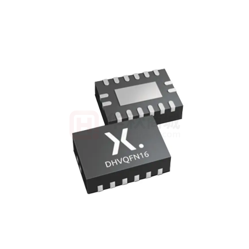

74HCT4040BQX
74HCT4040BQX
    NEXPERIA(安世)
    QFN16_2.5X3.5MM_EP
    74HCT4040BQ-Q100/SOT763/DHVQFN
74HCT4040BQX 数据手册
74HC4040; 74HCT4040 12-stage binary ripple counter Rev. 5 — 3 February 2016 Product data sheet 1. General description The 74HC4040; 74HCT4040 is a 12-stage binary ripple counter with a clock input (CP), an overriding asynchronous master reset input (MR) and twelve parallel outputs (Q0 to Q11). The counter advances on the HIGH-to-LOW transition of CP. A HIGH on MR clears all counter stages and forces all outputs LOW, independent of the state of CP. Each counter stage is a static toggle flip-flop. Inputs include clamp diodes that enable the use of current limiting resistors to interface inputs to voltages in excess of VCC. 2. Features and benefits  Complies with JEDEC standard no. 7A  Input levels:  For 74HC4040: CMOS level  For 74HCT4040: TTL level  ESD protection:  HBM JESD22-A114F exceeds 2000 V  MM JESD22-A115-A exceeds 200 V  Multiple package options  Specified from 40 C to +85 C and from 40 C to +125 C 3. Applications  Frequency dividing circuits  Time delay circuits  Control counters 4. Ordering information Table 1. Ordering information Type number 74HC4040D Package Temperature range Name Description Version 40 C to +125 C SO16 plastic small outline package; 16 leads; body width 3.9 mm SOT109-1 40 C to +125 C SSOP16 plastic shrink small outline package; 16 leads; body SOT338-1 width 5.3 mm 74HCT4040D 74HC4040DB 74HCT4040DB 74HC4040; 74HCT4040 Nexperia 12-stage binary ripple counter Table 1. Ordering information …continued Type number 74HC4040PW Package Temperature range Name Description Version 40 C to +125 C TSSOP16 plastic thin shrink small outline package; 16 leads; body width 4.4 mm SOT403-1 40 C to +125 C DHVQFN16 plastic dual in-line compatible thermal enhanced SOT763-1 very thin quad flat package; no leads; 16 terminals; body 2.5  3.5  0.85 mm 74HCT4040PW 74HC4040BQ 74HCT4040BQ 5. Functional diagram &3 05   7 67$*(&2817(5 &'             4 4 4 4 4 4 4 4 4 4 4 4 DDG Fig 1. Functional diagram &75   &3 05 4 4 4 4 4 4 4 4 4 4 4 4                &7  &7  Logic symbol 74HC_HCT4040 Product data sheet             DDG DDG Fig 2.  Fig 3. IEC logic symbol All information provided in this document is subject to legal disclaimers. . Rev. 5 — 3 February 2016 2 of 82 © Nexperia B.V. 2017. All rights reserved 74HC4040; 74HCT4040 Nexperia 12-stage binary ripple counter )) 7  &3 4 )) 7  4 4 )) 7  )) 7   4 5' 4 4 5' 4 )) 7  4 5' 4 4 )) 7  4 5' 4 5' 5' 05 4 )) 7  4 4 )) 7  4 4 4 )) 7  4 5' 4 4 )) 7  4 5' 4 )) 7  4 5' 4 4 4 4 4 )) 7  4 5' 4 4 4 5' 4 5' 4 4 DDG Fig 4. Logic diagram 6. Pinning information  WHUPLQDO LQGH[DUHD 4   4   4   4 4  4   4 4  4   4 4  4  4  4   05 4   &3 *1'   4  4  *1'   4  4  05  &3  4 4  9&&   *1' 4 4   9&& 4 6.1 Pinning DDG 7UDQVSDUHQWWRSYLHZ DDG (1) This is not a supply pin. The substrate is attached to this pad using conductive die attach material. There is no electrical or mechanical requirement to solder this pad. However, if it is soldered, the solder land should remain floating or be connected to GND. Fig 5. Pin configuration SO16, SSOP16 and TSSOP16 74HC_HCT4040 Product data sheet Fig 6. Pin configuration DHVQFN16 All information provided in this document is subject to legal disclaimers. . Rev. 5 — 3 February 2016 3 of 82 © Nexperia B.V. 2017. All rights reserved 74HC4040; 74HCT4040 Nexperia 12-stage binary ripple counter 6.2 Pin description Table 2. Pin description Symbol Pin Description Q11 1 output 11 Q5 2 output 5 Q4 3 output 4 Q6 4 output 6 Q3 5 output 3 Q2 6 output 2 Q1 7 output 1 GND 8 ground (0 V) Q0 9 output 0 CP 10 clock input (HIGH-to-LOW, edge-triggered) MR 11 master reset input (active HIGH) Q8 12 output 8 Q7 13 output 7 Q9 14 output 9 Q10 15 output 10 VCC 16 positive supply voltage 7. Functional description 7.1 Function table Table 3. Function table Input Output CP MR Q0 to Q11  L no change  L count X H L [1] H = HIGH voltage level; L = LOW voltage level; X = don’t care;  = LOW-to-HIGH clock transition;  = HIGH-to-LOW clock transition. 74HC_HCT4040 Product data sheet All information provided in this document is subject to legal disclaimers. . Rev. 5 — 3 February 2016 4 of 82 © Nexperia B.V. 2017. All rights reserved 74HC4040; 74HCT4040 Nexperia 12-stage binary ripple counter 7.2 Timing diagram              &3LQSXW 05LQSXW 4 4 4 4 4 4 4 4 4 4 4 4 DDG Fig 7. Timing diagram 8. Limiting values Table 4. Limiting values In accordance with the Absolute Maximum Rating System (IEC 60134). Voltages are referenced to GND (ground = 0 V). Symbol Parameter VCC supply voltage Conditions IIK input clamping current VI < 0.5 V or VI > VCC + 0.5 V [1] IOK output clamping current VI < 0.5 V or VI > VCC + 0.5 V [1] IO output current 0.5 V < VO < VCC + 0.5 V ICC supply current IGND ground current Tstg storage temperature Ptot total power dissipation Tamb = 40 C to +125 C Min Max Unit 0.5 +7 V - 20 mA - 20 mA - 25 mA - 50 mA - 50 mA 65 +150 C - 500 mW [2] SO16, SSOP16, TSSOP16 and DHVQFN16 packages [1] The input and output voltage ratings may be exceeded if the input and output current ratings are observed. [2] For SO16 package: Ptot derates linearly with 8 mW/K above 70 C. For SSOP16 and TSSOP16 packages: Ptot derates linearly with 5.5 mW/K above 60 C. For DHVQFN16 packages: Ptot derates linearly with 4.5 mW/K above 60 C. 74HC_HCT4040 Product data sheet All information provided in this document is subject to legal disclaimers. . Rev. 5 — 3 February 2016 5 of 82 © Nexperia B.V. 2017. All rights reserved 74HC4040; 74HCT4040 Nexperia 12-stage binary ripple counter 9. Recommended operating conditions Table 5. Recommended operating conditions Voltages are referenced to GND (ground = 0 V) Symbol Parameter Conditions 74HC4040 74HCT4040 Unit Min Typ Max Min Typ Max 2.0 5.0 6.0 4.5 5.0 5.5 V input voltage 0 - VCC 0 - VCC V output voltage 0 - VCC 0 - VCC V VCC supply voltage VI VO Tamb ambient temperature t/V input transition rise and fall rate 40 +25 +125 40 +25 +125 VCC = 2.0 V - - 625 - - - ns/V C VCC = 4.5 V - 1.67 139 - 1.67 139 ns/V VCC = 6.0 V - - 83 - - - ns/V 10. Static characteristics Table 6. Static characteristics At recommended operating conditions; voltages are referenced to GND (ground = 0 V). Symbol Parameter 25 C Conditions 40 C to +85 C 40 C to +125 C Unit Min Typ Max Min Max Min Max VCC = 2.0 V 1.5 1.2 - 1.5 - 1.5 - 74HC4040 VIH VIL VOH VOL HIGH-level input voltage LOW-level input voltage HIGH-level output voltage LOW-level output voltage V VCC = 4.5 V 3.15 2.4 - 3.15 - 3.15 - V VCC = 6.0 V 4.2 3.2 - 4.2 - 4.2 - V VCC = 2.0 V - 0.8 0.5 - 0.5 - 0.5 V VCC = 4.5 V - 2.1 1.35 - 1.35 - 1.35 V VCC = 6.0 V - 2.8 1.8 - 1.8 - 1.8 V IO = 20 A; VCC = 2.0 V 1.9 2.0 - 1.9 - 1.9 - V IO = 20 A; VCC = 4.5 V 4.4 4.5 - 4.4 - 4.4 - V VI = VIH or VIL IO = 20 A; VCC = 6.0 V 5.9 6.0 - 5.9 - 5.9 - V IO = 4.0 mA; VCC = 4.5 V 3.98 4.32 - 3.84 - 3.7 - V IO = 5.2 mA; VCC = 6.0 V 5.48 5.81 - 5.34 - 5.2 - V IO = 20 A; VCC = 2.0 V - 0 0.1 - 0.1 - 0.1 V IO = 20 A; VCC = 4.5 V - 0 0.1 - 0.1 - 0.1 V IO = 20 A; VCC = 6.0 V - 0 0.1 - 0.1 - 0.1 V IO = 4.0 mA; VCC = 4.5 V - 0.15 0.26 - 0.33 - 0.4 V VI = VIH or VIL IO = 5.2 mA; VCC = 6.0 V - 0.16 0.26 - 0.33 - 0.4 V II input leakage current VI = VCC or GND; VCC = 6.0 V - - 0.1 - 1.0 - 1.0 A ICC supply current VI = VCC or GND; IO = 0 A; VCC = 6.0 V - - 8.0 - 80 - 160 A 74HC_HCT4040 Product data sheet All information provided in this document is subject to legal disclaimers. . Rev. 5 — 3 February 2016 6 of 82 © Nexperia B.V. 2017. All rights reserved 74HC4040; 74HCT4040 Nexperia 12-stage binary ripple counter Table 6. Static characteristics …continued At recommended operating conditions; voltages are referenced to GND (ground = 0 V). Symbol Parameter CI 25 C Conditions input capacitance 40 C to +85 C 40 C to +125 C Unit Min Typ Max - 3.5 - Min Max Min Max pF 74HCT4040 VIH HIGH-level input voltage VCC = 4.5 V to 5.5 V 2.0 1.6 - 2.0 - 2.0 - V VIL LOW-level input voltage VCC = 4.5 V to 5.5 V - 1.2 0.8 - 0.8 - 0.8 V VOH HIGH-level output voltage VI = VIH or VIL; VCC = 4.5 V IO = 20 A 4.4 4.5 - 4.4 - 4.4 - V IO = 4 mA 3.98 4.32 - 3.84 - 3.7 - V IO = 20 A - 0 0.1 - 0.1 - 0.1 V LOW-level output voltage VI = VIH or VIL; VCC = 4.5 V IO = 4.0 mA - 0.15 0.26 - 0.33 - 0.4 V II input leakage current VI = VCC or GND; VCC = 5.5 V - - 0.1 - 1.0 - 1.0 A ICC supply current VI = VCC or GND; IO = 0 A; VCC = 5.5 V - - 8.0 - 80 - 160 A ICC additional supply current per input pin; VI = VCC  2.1 V; IO = 0 A; other inputs at VCC or GND; VCC = 4.5 V to 5.5 V pin CP - 85 306 - 383 - 417 A pin MR - 110 396 - 495 - 539 A - 3.5 - - - - - pF VOL CI input capacitance 74HC_HCT4040 Product data sheet All information provided in this document is subject to legal disclaimers. . Rev. 5 — 3 February 2016 7 of 82 © Nexperia B.V. 2017. All rights reserved 74HC4040; 74HCT4040 Nexperia 12-stage binary ripple counter 11. Dynamic characteristics Table 7. Dynamic characteristics GND (ground = 0 V); CL = 50 pF unless otherwise specified; for test circuit, see Figure 9. Symbol Parameter 25 C Conditions 40 C to +85 C 40 C to +125 C Unit Min Typ Max Min Max Min Max 74HC4040 tpd propagation delay [1] CP to Q0; see Figure 8 VCC = 2.0 V - 47 150 - 190 - 225 ns VCC = 4.5 V - 17 30 - 38 - 45 ns VCC = 5.0 V; CL = 15 pF - 14 - - - - - ns VCC = 6.0 V - 14 26 - 33 - 38 ns VCC = 2.0 V - 28 100 - 125 - 150 ns VCC = 4.5 V - 10 20 - 25 - 30 ns VCC = 5.0 V; CL = 15 pF - 8 - - - - - ns VCC = 6.0 V - 8 17 - 21 - 26 ns - 61 185 - 230 - 280 ns - 22 37 - 46 - 56 ns - 18 31 - 39 - 48 ns VCC = 2.0 V - 19 75 - 95 - 110 ns VCC = 4.5 V - 7 15 - 19 - 22 ns VCC = 6.0 V - 6 13 - 16 - 19 ns VCC = 2.0 V 80 14 - 100 - 120 - ns VCC = 4.5 V 16 5 - 20 - 24 - ns VCC = 6.0 V 14 4 - 17 - 20 - ns VCC = 2.0 V 80 22 - 100 - 120 - ns VCC = 4.5 V 16 8 - 20 - 24 - ns VCC = 6.0 V 14 6 - 17 - 20 - ns VCC = 2.0 V 50 8 - 65 - 75 - ns VCC = 4.5 V 10 3 - 13 - 15 - ns VCC = 6.0 V 9 2 - 11 - 13 - ns VCC = 2.0 V 6 27 - 4.8 - 4 - MHz VCC = 4.5 V 30 82 - 24 - 20 - MHz - 90 - - - - - MHz 35 98 - 28 - 24 - MHz Qn to Qn+1; see Figure 8 tPHL HIGH to LOW MR to Qn; see Figure 8 propagation VCC = 2.0 V delay VCC = 4.5 V VCC = 6.0 V tt tW [2] transition time Qn; see Figure 8 pulse width CP input, HIGH or LOW; see Figure 8 MR input, HIGH; see Figure 8 trec fmax recovery time maximum frequency MR to CP; see Figure 8 CP input; see Figure 8 VCC = 5.0 V; CL = 15 pF VCC = 6.0 V 74HC_HCT4040 Product data sheet All information provided in this document is subject to legal disclaimers. . Rev. 5 — 3 February 2016 8 of 82 © Nexperia B.V. 2017. All rights reserved 74HC4040; 74HCT4040 Nexperia 12-stage binary ripple counter Table 7. Dynamic characteristics …continued GND (ground = 0 V); CL = 50 pF unless otherwise specified; for test circuit, see Figure 9. Symbol Parameter 25 C Conditions 40 C to +85 C 40 C to +125 C Unit Min Typ Max CPD power dissipation capacitance VI = GND to VCC [3] CP to Q0; see Figure 8 [1] Min Max Min Max - 20 - - - - - pF VCC = 4.5 V - 19 40 - 50 - 60 ns VCC = 5.0 V; CL = 15 pF - 16 - - - - - ns VCC = 4.5 V - 10 20 - 25 - 30 ns VCC = 5.0 V; CL = 15 pF - 8 - - - - - ns - 23 45 - 56 - 68 ns - 7 15 - 19 - 22 ns 16 7 - 20 - 24 - ns 16 6 - 20 - 24 - ns 10 2 - 13 - 15 - ns 74HCT4040 tpd propagation delay Qn to Qn+1; see Figure 8 HIGH to LOW MR to Qn; see Figure 8 propagation VCC = 4.5 V delay tPHL [2] transition time Qn; see Figure 8 tt VCC = 4.5 V pulse width tW CP input, HIGH or LOW; see Figure 8 VCC = 4.5 V MR input, HIGH; see Figure 8 VCC = 4.5 V recovery time trec MR to CP; see Figure 8 VCC = 4.5 V maximum frequency fmax CP input; see Figure 8 VCC = 4.5 V VCC = 5.0 V; CL = 15 pF power dissipation capacitance CPD [1] tpd is the same as tPHL, tPLH. [2] tt is the same as tTHL, tTLH. [3] [3] VI = GND to VCC 30 72 - 24 - 20 - MHz - 79 - - - - - MHz - 20 - - - - - pF CPD is used to determine the dynamic power dissipation (PD in W). PD = CPD  VCC2  fi  N + (CL  VCC2  fo) where: fi = input frequency in MHz; fo = output frequency in MHz; CL = output load capacitance in pF; VCC = supply voltage in V; N = number of inputs switching; (CL  VCC2  fo) = sum of outputs. 74HC_HCT4040 Product data sheet All information provided in this document is subject to legal disclaimers. . Rev. 5 — 3 February 2016 9 of 82 © Nexperia B.V. 2017. All rights reserved 74HC4040; 74HCT4040 Nexperia 12-stage binary ripple counter 12. Waveform and test circuit 9, 90 05LQSXW W: WUHF 9, IPD[ 90 &3LQSXW W3+/ W3/+ W:  4RU4Q RXWSXW W3+/   90  W7/+ W7+/ DDG 74HC4040: VM = 50 %; VI = GND to VCC. 74HCT4040: VM = 1.3 V; VI = GND to 3 V. Fig 8. Clock propagation delays, pulse width, transition times, maximum pulse frequency and master resets 9, QHJDWLYH SXOVH W:  90 90  *1' WI 9, WI  SRVLWLYH SXOVH *1' WU WU 90 90  W: 9&& * 9, 92 '87 57 &/ DDK  Test data is given in Table 8. Definitions test circuit: RT = termination resistance should be equal to output impedance Zo of the pulse generator. CL = load capacitance including jig and probe capacitance. Fig 9. Test circuit for measuring switching times Table 8. Test data Type Input Load Test VI tr, tf CL 74HC4040 VCC 6.0 ns 15 pF, 50 pF tPLH, tPHL 74HCT4040 3.0 V 6.0 ns 15 pF, 50 pF tPLH, tPHL 74HC_HCT4040 Product data sheet All information provided in this document is subject to legal disclaimers. . Rev. 5 — 3 February 2016 10 of 82 © Nexperia B.V. 2017. All rights reserved 74HC4040; 74HCT4040 Nexperia 12-stage binary ripple counter 13. Package outline 62SODVWLFVPDOORXWOLQHSDFNDJHOHDGVERG\ZLGWKPP 627 ' ( $ ; F \ +( Y 0 $ =   4 $ $ $   $ SLQLQGH[ ș /S  /  H Z 0 ES   GHWDLO; PP VFDOH ',0(16,216 LQFKGLPHQVLRQVDUHGHULYHGIURPWKHRULJLQDOPPGLPHQVLRQV  81,7 $ PD[ $ $ $ ES F '   (   H +( / /S 4 Y Z \ =   PP                                                 LQFKHV         ș R R 1RWH 3ODVWLFRUPHWDOSURWUXVLRQVRIPP LQFK PD[LPXPSHUVLGHDUHQRWLQFOXGHG 5()(5(1&(6 287/,1( 9(56,21 ,(& -('(& 627 ( 06 -(,7$ (8523($1 352-(&7,21 ,668('$7(   Fig 10. Package outline SOT109-1 (SO16) 74HC_HCT4040 Product data sheet All information provided in this document is subject to legal disclaimers. . Rev. 5 — 3 February 2016 11 of 82 © Nexperia B.V. 2017. All rights reserved 74HC4040; 74HCT4040 Nexperia 12-stage binary ripple counter 6623SODVWLFVKULQNVPDOORXWOLQHSDFNDJHOHDGVERG\ZLGWKPP ' 627 ( $ ; F \ +( Y 0 $ =   4 $ $ $   $ SLQLQGH[ ș /S /   GHWDLO; Z 0 ES H   PP VFDOH ',0(16,216 PPDUHWKHRULJLQDOGLPHQVLRQV  81,7 $ PD[ $ $ $ ES F '   (   H +( / /S 4 Y Z \ =   ș PP                            R R 1RWH 3ODVWLFRUPHWDOSURWUXVLRQVRIPPPD[LPXPSHUVLGHDUHQRWLQFOXGHG 287/,1( 9(56,21 627 5()(5(1&(6 ,(& -('(& -(,7$ (8523($1 352-(&7,21 ,668('$7(   02 Fig 11. Package outline SOT338-1 (SSOP16) 74HC_HCT4040 Product data sheet All information provided in this document is subject to legal disclaimers. . Rev. 5 — 3 February 2016 12 of 82 © Nexperia B.V. 2017. All rights reserved 74HC4040; 74HCT4040 Nexperia 12-stage binary ripple counter 76623SODVWLFWKLQVKULQNVPDOORXWOLQHSDFNDJHOHDGVERG\ZLGWKPP ' 627 ( $ ; F \ +( Y 0 $ =   4 $ SLQLQGH[ $   $ $ ș /S /   H GHWDLO; Z 0 ES   PP VFDOH ',0(16,216 PPDUHWKHRULJLQDOGLPHQVLRQV  81,7 $ PD[ $ $ $ ES F '   (   H +( / /S 4 Y Z \ =   ș PP                            R R 1RWHV 3ODVWLFRUPHWDOSURWUXVLRQVRIPPPD[LPXPSHUVLGHDUHQRWLQFOXGHG 3ODVWLFLQWHUOHDGSURWUXVLRQVRIPPPD[LPXPSHUVLGHDUHQRWLQFOXGHG 287/,1( 9(56,21 627 5()(5(1&(6 ,(& -('(& -(,7$ (8523($1 352-(&7,21 ,668('$7(   02 Fig 12. Package outline SOT403-1 (TSSOP16) 74HC_HCT4040 Product data sheet All information provided in this document is subject to legal disclaimers. . Rev. 5 — 3 February 2016 13 of 82 © Nexperia B.V. 2017. All rights reserved 74HC4040; 74HCT4040 Nexperia 12-stage binary ripple counter '+94)1SODVWLFGXDOLQOLQHFRPSDWLEOHWKHUPDOHQKDQFHGYHU\WKLQTXDGIODWSDFNDJHQROHDGV 627 WHUPLQDOVERG\[[PP % ' $ $ $ ( F GHWDLO; WHUPLQDO LQGH[DUHD WHUPLQDO LQGH[DUHD & H H E   \ \ & Y 0 & $ % Z 0 & /   (K H     'K ;   PP VFDOH ',0(16,216 PPDUHWKHRULJLQDOGLPHQVLRQV  81,7 $   PD[ $ E F '   'K (   (K H H / Y Z \ \ PP                       1RWH 3ODVWLFRUPHWDOSURWUXVLRQVRIPPPD[LPXPSHUVLGHDUHQRWLQFOXGHG 5()(5(1&(6 287/,1( 9(56,21 ,(& -('(& -(,7$ 627  02  (8523($1 352-(&7,21 ,668('$7(    Fig 13. Package outline SOT763-1 (DHVQFN16) 74HC_HCT4040 Product data sheet All information provided in this document is subject to legal disclaimers. . Rev. 5 — 3 February 2016 14 of 82 © Nexperia B.V. 2017. All rights reserved 74HC4040; 74HCT4040 Nexperia 12-stage binary ripple counter 14. Abbreviations Table 9. Abbreviations Acronym Description CMOS Complementary Metal Oxide Semiconductor ESD ElectroStatic Discharge HBM Human Body Model CDM Charge-Device Model TTL Transistor-Transistor Logic 15. Revision history Table 10. Revision history Document ID Release date Data sheet status Change notice Supersedes 74HC_HCT4040 v.5 20160203 Product data sheet - Modifications: 74HC_HCT4040 v.4 Modifications: • 74HC_HCT4040 v.4 Type numbers 74HC4040N and 74HCT4040N (SOT38-4) removed. 20140320 Product data sheet - 74HC_HCT4040 v.3 • The format of this data sheet has been redesigned to comply with the new identity guidelines of NXP Semiconductors. • Legal texts have been adapted to the new company name where appropriate. 74HC_HCT4040 v.3 20050914 Product data sheet - 74HC_HCT4040_CNV v.2 74HC_HCT4040_CNV v.2 19901231 Product specification - - 74HC_HCT4040 Product data sheet All information provided in this document is subject to legal disclaimers. . Rev. 5 — 3 February 2016 15 of 82 © Nexperia B.V. 2017. All rights reserved 74HC4040; 74HCT4040 Nexperia 12-stage binary ripple counter 16. Legal information 16.1 Data sheet status Document status[1][2] Product status[3] Definition Objective [short] data sheet Development This document contains data from the objective specification for product development. Preliminary [short] data sheet Qualification This document contains data from the preliminary specification. Product [short] data sheet Production This document contains the product specification. [1] Please consult the most recently issued document before initiating or completing a design. [2] The term ‘short data sheet’ is explained in section “Definitions”. [3] The product status of device(s) described in this document may have changed since this document was published and may differ in case of multiple devices. The latest product status information is available on the Internet at URL http://www.nexperia.com. 16.2 Definitions Draft — The document is a draft version only. The content is still under internal review and subject to formal approval, which may result in modifications or additions. Nexperia does not give any representations or warranties as to the accuracy or completeness of information included herein and shall have no liability for the consequences of use of such information. Short data sheet — A short data sheet is an extract from a full data sheet with the same product type number(s) and title. A short data sheet is intended for quick reference only and should not be relied upon to contain detailed and full information. For detailed and full information see the relevant full data sheet, which is available on request via the local Nexperia sales office. In case of any inconsistency or conflict with the short data sheet, the full data sheet shall prevail. Product specification — The information and data provided in a Product data sheet shall define the specification of the product as agreed between Nexperia and its customer, unless Nexperia and customer have explicitly agreed otherwise in writing. In no event however, shall an agreement be valid in which the Nexperia product is deemed to offer functions and qualities beyond those described in the Product data sheet. 16.3 Disclaimers Limited warranty and liability — Information in this document is believed to be accurate and reliable. However, Nexperia does not give any representations or warranties, expressed or implied, as to the accuracy or completeness of such information and shall have no liability for the consequences of use of such information. Nexperia takes no responsibility for the content in this document if provided by an information source outside of Nexperia. In no event shall Nexperia be liable for any indirect, incidental, punitive, special or consequential damages (including - without limitation - lost profits, lost savings, business interruption, costs related to the removal or replacement of any products or rework charges) whether or not such damages are based on tort (including negligence), warranty, breach of contract or any other legal theory. Notwithstanding any damages that customer might incur for any reason whatsoever, Nexperia's aggregate and cumulative liability towards customer for the products described herein shall be limited in accordance with the Terms and conditions of commercial sale of Nexperia. Right to make changes — Nexperia reserves the right to make changes to information published in this document, including without limitation specifications and product descriptions, at any time and without notice. This document supersedes and replaces all information supplied prior to the publication hereof. 74HC_HCT4040 Product data sheet Suitability for use — Nexperia products are not designed, authorized or warranted to be suitable for use in life support, life-critical or safety-critical systems or equipment, nor in applications where failure or malfunction of a Nexperia product can reasonably be expected to result in personal injury, death or severe property or environmental damage. Nexperia and its suppliers accept no liability for inclusion and/or use of Nexperia products in such equipment or applications and therefore such inclusion and/or use is at the customer’s own risk. Applications — Applications that are described herein for any of these products are for illustrative purposes only. Nexperia makes no representation or warranty that such applications will be suitable for the specified use without further testing or modification. Customers are responsible for the design and operation of their applications and products using Nexperia products, and Nexperia accepts no liability for any assistance with applications or customer product design. It is customer’s sole responsibility to determine whether the Nexperia product is suitable and fit for the customer’s applications and products planned, as well as for the planned application and use of customer’s third party customer(s). Customers should provide appropriate design and operating safeguards to minimize the risks associated with their applications and products. Nexperia does not accept any liability related to any default, damage, costs or problem which is based on any weakness or default in the customer’s applications or products, or the application or use by customer’s third party customer(s). Customer is responsible for doing all necessary testing for the customer’s applications and products using Nexperia products in order to avoid a default of the applications and the products or of the application or use by customer’s third party customer(s). Nexperia does not accept any liability in this respect. Limiting values — Stress above one or more limiting values (as defined in the Absolute Maximum Ratings System of IEC 60134) will cause permanent damage to the device. Limiting values are stress ratings only and (proper) operation of the device at these or any other conditions above those given in the Recommended operating conditions section (if present) or the Characteristics sections of this document is not warranted. Constant or repeated exposure to limiting values will permanently and irreversibly affect the quality and reliability of the device. Terms and conditions of commercial sale — Nexperia products are sold subject to the general terms and conditions of commercial sale, as published at http://www.nexperia.com/profile/terms, unless otherwise agreed in a valid written individual agreement. In case an individual agreement is concluded only the terms and conditions of the respective agreement shall apply. Nexperia hereby expressly objects to applying the customer’s general terms and conditions with regard to the purchase of Nexperia products by customer. No offer to sell or license — Nothing in this document may be interpreted or construed as an offer to sell products that is open for acceptance or the grant, conveyance or implication of any license under any copyrights, patents or other industrial or intellectual property rights. All information provided in this document is subject to legal disclaimers. . Rev. 5 — 3 February 2016 16 of 82 © Nexperia B.V. 2017. All rights reserved 74HC4040; 74HCT4040 Nexperia 12-stage binary ripple counter Export control — This document as well as the item(s) described herein may be subject to export control regulations. Export might require a prior authorization from competent authorities. Non-automotive qualified products — Unless this data sheet expressly states that this specific Nexperia product is automotive qualified, the product is not suitable for automotive use. It is neither qualified nor tested in accordance with automotive testing or application requirements. Nexperia accepts no liability for inclusion and/or use of non-automotive qualified products in automotive equipment or applications. In the event that customer uses the product for design-in and use in automotive applications to automotive specifications and standards, customer (a) shall use the product without Nexperia's warranty of the product for such automotive applications, use and specifications, and (b) whenever customer uses the product for automotive applications beyond Nexperia's specifications such use shall be solely at customer’s own risk, and (c) customer fully indemnifies Nexperia for any liability, damages or failed product claims resulting from customer design and use of the product for automotive applications beyond Nexperia's standard warranty and Nexperia's product specifications. Translations — A non-English (translated) version of a document is for reference only. The English version shall prevail in case of any discrepancy between the translated and English versions. 16.4 Trademarks Notice: All referenced brands, product names, service names and trademarks are the property of their respective owners. 17. Contact information For more information, please visit: http://www.nexperia.com For sales office addresses, please send an email to: salesaddresses@nexperia.com 74HC_HCT4040 Product data sheet All information provided in this document is subject to legal disclaimers. . Rev. 5 — 3 February 2016 17 of 82 © Nexperia B.V. 2017. All rights reserved Nexperia 74HC4040; 74HCT4040 12-stage binary ripple counter 18. Contents 1 2 3 4 5 6 6.1 6.2 7 7.1 7.2 8 9 10 11 12 13 14 15 16 16.1 16.2 16.3 16.4 17 18 © General description . . . . . . . . . . . . . . . . . . . . . . 1 Features and benefits . . . . . . . . . . . . . . . . . . . . 1 Applications . . . . . . . . . . . . . . . . . . . . . . . . . . . . 1 Ordering information . . . . . . . . . . . . . . . . . . . . . 1 Functional diagram . . . . . . . . . . . . . . . . . . . . . . 2 Pinning information . . . . . . . . . . . . . . . . . . . . . . 3 Pinning . . . . . . . . . . . . . . . . . . . . . . . . . . . . . . . 3 Pin description . . . . . . . . . . . . . . . . . . . . . . . . . 4 Functional description . . . . . . . . . . . . . . . . . . . 4 Function table . . . . . . . . . . . . . . . . . . . . . . . . . . 4 Timing diagram . . . . . . . . . . . . . . . . . . . . . . . . . 5 Limiting values. . . . . . . . . . . . . . . . . . . . . . . . . . 5 Recommended operating conditions. . . . . . . . 6 Static characteristics. . . . . . . . . . . . . . . . . . . . . 6 Dynamic characteristics . . . . . . . . . . . . . . . . . . 8 Waveform and test circuit . . . . . . . . . . . . . . . . 10 Package outline . . . . . . . . . . . . . . . . . . . . . . . . 11 Abbreviations . . . . . . . . . . . . . . . . . . . . . . . . . . 15 Revision history . . . . . . . . . . . . . . . . . . . . . . . . 15 Legal information. . . . . . . . . . . . . . . . . . . . . . . 16 Data sheet status . . . . . . . . . . . . . . . . . . . . . . 16 Definitions . . . . . . . . . . . . . . . . . . . . . . . . . . . . 16 Disclaimers . . . . . . . . . . . . . . . . . . . . . . . . . . . 16 Trademarks. . . . . . . . . . . . . . . . . . . . . . . . . . . 17 Contact information. . . . . . . . . . . . . . . . . . . . . 17 Contents . . . . . . . . . . . . . . . . . . . . . . . . . . . . . . 18 Nexperia B.V. 2017. All rights reserved For more information, please visit: http://www.nexperia.com For sales office addresses, please send an email to: salesaddresses@nexperia.com Date of release: 03 February 2016
