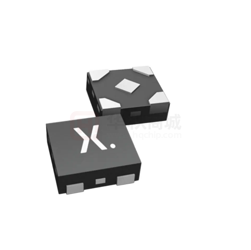

74LV1T86 2-input single supply translating EXCLUSIVE-OR gate Rev. 2 — 3 December 2019 Product data sheet 1. General description The 74LV1T86 is a single, level translating 2-input Exclusive-OR gate . The low threshold inputs support 1.8 V input logic at VCC = 3.3 V and can be used in 1.8 V to 3.3 V level up translation. In addition, the 5 V tolerant input pins enable level down translation (3.3 V to 2.5 V output at VCC = 2.5 V). The output level is referenced to the supply voltage and supports 1.8 V, 2.5 V, 3.3 V and 5.0 V CMOS levels. The wide VCC range permits the generation of output levels to connect to controllers or processors. 2. Features and benefits • • • • • • • Single supply voltage translator at 1.8 V, 2.5 V, 3.3 V and 5.0 V Up translation • 1.2 V to 1.8 V at VCC = 1.8 V • 1.5 V to 2.5 V at VCC = 2.5 V • 1.8 V to 3.3 V at VCC = 3.3 V • 3.3 V to 5.0 V at VCC = 5.0 V Down translation • 3.3 V to 1.8 V at VCC = 1.8 V • 3.3 V to 2.5 V at VCC = 2.5 V • 5.0 V to 3.3 V at VCC = 3.3 V 5 V tolerant inputs Latch-up performance exceeds 250 mA per JESD 78 Class II ESD protection: • HBM ANSI/ESDA/JEDEC JS-001 Class 2 exceeds 2 kV • CDM JESD22-C101F exceeds 1 kV Specified from -40 °C to +85 °C and from -40 °C to +125 °C 3. Applications • • • • Portable applications PC and notebooks Industrial controller Telecom 74LV1T86 Nexperia 2-input single supply translating EXCLUSIVE-OR gate 4. Ordering information Table 1. Ordering information Type number Package Temperature range Name Description Version 74LV1T86GW -40 °C to +125 °C TSSOP5 plastic thin shrink small outline package; 5 leads; body width 1.25 mm SOT353-1 74LV1T86GV -40 °C to +125 °C SC-74A SOT753 74LV1T86GX -40 °C to +125 °C X2SON5 plastic thermal enhanced extremely thin small outline package; no leads; 5 terminals; body 0.8 x 0.8 x 0.35 mm plastic surface-mounted package; 5 leads SOT1226 5. Marking Table 2. Marking Type number Marking code[1] 74LV1T86GW SC 74LV1T86GV SC 74LV1T86GX SC [1] The pin 1 indicator is located on the lower left corner of the device, below the marking code. 6. Functional diagram 1 2 B A Y 1 4 =1 mna039 mna038 Fig. 1. 4 2 Logic symbol Fig. 2. IEC logic symbol B Y A Fig. 3. mna040 Logic diagram 74LV1T86 Product data sheet All information provided in this document is subject to legal disclaimers. Rev. 2 — 3 December 2019 © Nexperia B.V. 2019. All rights reserved 2 / 13 74LV1T86 Nexperia 2-input single supply translating EXCLUSIVE-OR gate 7. Pinning information 7.1. Pinning 74LV1T86 B 1 A 2 GND 3 74LV1T86 5 VCC B 1 VCC 4 Y 3 GND 4 2 A Y aaa-027742 aaa-027741 Fig. 4. 5 Pin configuration SOT353-1 (TSSOP5) and SOT753 (SC-74A) Transparent top view Fig. 5. Pin configuration SOT1226 (X2SON5) 7.2. Pin description Table 3. Pin description Symbol Pin Description B 1 data input A 2 data input GND 3 ground (0 V) Y 4 data output VCC 5 supply voltage 8. Functional description Table 4. Function table H = HIGH voltage level; L = LOW voltage level. Output Input A B Y L L L L H H H L H H H L 74LV1T86 Product data sheet All information provided in this document is subject to legal disclaimers. Rev. 2 — 3 December 2019 © Nexperia B.V. 2019. All rights reserved 3 / 13 74LV1T86 Nexperia 2-input single supply translating EXCLUSIVE-OR gate 9. Limiting values Table 5. Limiting values In accordance with the Absolute Maximum Rating System (IEC 60134). Voltages are referenced to GND (ground = 0 V). Symbol Parameter VCC supply voltage VI input voltage VO output voltage Conditions output HIGH or LOW state output in power-off state Min Max Unit -0.5 +7.0 V [1] -0.5 +7.0 V [2][3] -0.5 VCC + 0.5 V [2] -0.5 4.6 V -20 - mA IIK input clamping current VI < 0 V IOK output clamping current VO < 0 V or VO > VCC - ±20 mA IO output current VO = 0 V to VCC - ±25 mA ICC supply current - 50 mA IGND ground current -50 - mA Tstg storage temperature -65 +150 °C Ptot total power dissipation - 250 mW [1] [2] [3] [4] Tamb = -40 °C to +125 °C [4] If the input current ratings are observed, the minimum input voltage ratings may be exceeded. If the output current ratings are observed, the output voltage ratings may be exceeded. This value is limited to 7 V maximum. For SOT353-1 package: above 74 °C the value of Ptot derates linearly with 3.3 mW/K. For SOT753 package: above 85 °C the value of Ptot derates linearly with 3.8 mW/K. For SOT1226 package: above 67 °C the value of Ptot derates linearly with 3.0 mW/K. 10. Recommended operating conditions Table 6. Recommended operating conditions Voltages are referenced to GND (ground = 0 V). Symbol Parameter VCC supply voltage VI input voltage VO output voltage Tamb ambient temperature Δt/ΔV input transition rise and fall rate 74LV1T86 Product data sheet Conditions output HIGH or LOW state VCC = 1.8 V to 5.0 V All information provided in this document is subject to legal disclaimers. Rev. 2 — 3 December 2019 Min Typ Max Unit 1.6 5.0 5.5 V 0 - 5.5 V 0 - VCC V -40 +25 +125 °C - - 20 © ns/V Nexperia B.V. 2019. All rights reserved 4 / 13 74LV1T86 Nexperia 2-input single supply translating EXCLUSIVE-OR gate 11. Static characteristics Table 7. Static characteristics Voltages are referenced to GND (ground = 0 V). Symbol VIH VIL VOH VOL Parameter HIGH-level input voltage LOW-level input voltage Conditions 25 °C Unit Max Min Max Min Max 0.94 - 1.0 - 1.0 - V VCC = 2.0 V 0.99 - 1.03 - 1.03 - V VCC = 2.25 V to 2.5 V 1.135 - 1.18 - 1.18 - V VCC = 2.75 V 1.21 - 1.23 - 1.23 - V VCC = 3.0 V to 3.3 V 1.35 - 1.37 - 1.37 - V VCC = 3.6 V 1.47 - 1.48 - 1.48 - V VCC = 4.5 V to 5.0 V 2.02 - 2.03 - 2.03 - V VCC = 5.5 V 2.10 - 2.11 - 2.11 - V VCC = 1.65 V to 2.0 V - 0.58 - 0.55 - 0.55 V VCC = 2.25 V to 2.75 V - 0.75 - 0.71 - 0.71 V VCC = 3.0 V to 3.6 V - 0.80 - 0.65 - 0.65 V VCC = 4.5 V to 5.5 V - 0.80 - 0.80 - 0.80 V VCC-0.1 - VCC-0.1 - VCC-0.1 - V VCC = 1.65 V; IO = -2 mA 1.28 - 1.21 - 1.21 - V VCC = 1.8 V; IO = -2 mA 1.5 - 1.45 - 1.45 - V VCC = 2.3 V; IO = -2.3 mA 2.0 - 2.0 - 2.0 - V VCC = 2.3 V; IO = -3 mA 2.0 - 1.93 - 1.93 - V VCC = 2.5 V; IO = -3 mA 2.25 - 2.15 - 2.15 - V VCC = 3.0 V; IO = -3 mA 2.78 - 2.7 - 2.7 - V VCC = 3.0 V; IO = -5.5 mA 2.6 - 2.49 - 2.49 - V VCC = 3.3 V; IO = -5.5 mA 2.9 - 2.8 - 2.8 - V VCC = 4.5 V; IO = -4 mA 4.2 - 4.1 - 4.1 - V VCC = 4.5 V; IO = -8 mA 4.1 - 3.95 - 3.95 - V VCC = 5.0 V; IO = -8 mA 4.6 - 4.5 - 4.5 - V - 0.1 - 0.1 - 0.1 V VCC = 1.65 V; IO = 2 mA - 0.2 - 0.25 - 0.25 V VCC = 2.3 V; IO = 2.3 mA - 0.1 - 0.15 - 0.15 V VCC = 2.3 V; IO = 3 mA - 0.15 - 0.2 - 0.2 V VCC = 3.0 V; IO = 3 mA - 0.1 - 0.15 - 0.15 V VCC = 3.0 V; IO = 5.5 mA - 0.2 - 0.252 - 0.252 V VCC = 4.5 V; IO = 4 mA - 0.15 - 0.2 - 0.2 V VCC = 4.5 V; IO = 8 mA - 0.3 - 0.35 - 0.35 V - ±0.1 - ±1 - ±1 μA - 1 - 10 - 10 μA VCC = 1.65 V to 1.8 V VI = VIH or VIL LOW-level output voltage VCC = 1.65 V to 5.5 V; IO = 20 μA II input leakage current ICC supply current VI = VCC or GND; IO = 0 A; VCC = 1.8 V, 2.5 V, 3.3 V, 5.0 V Product data sheet -40 °C to +125 °C Min VI = VIH or VIL; HIGH-level output voltage VCC = 1.65 V to 5.5 V; IO = -20 μA 74LV1T86 -40 °C to +85 °C VI = VCC or GND; VCC = 0 V to 5.5 V All information provided in this document is subject to legal disclaimers. Rev. 2 — 3 December 2019 © Nexperia B.V. 2019. All rights reserved 5 / 13 74LV1T86 Nexperia 2-input single supply translating EXCLUSIVE-OR gate Symbol ΔICC Parameter Conditions 25 °C -40 °C to +85 °C -40 °C to +125 °C Unit Min Max Min Max Min Max per input pin; VCC = 1.8 V; additional supply current VI = 0.3 V or 1.1 V; IO = 0 A; other pins at VCC or GND - 10 - 10 - 10 μA per input pin; VCC = 5.5 V; VI = 0.3 V or 3.4 V; IO = 0 A; other pins at VCC or GND - 1.35 - 1.5 - 1.5 mA 12. Dynamic characteristics Table 8. Dynamic characteristics GND = 0 V. For test circuit, see Fig. 7. Symbol Parameter Conditions 25 °C Min Typ Max Min Max Min Max - 7.3 11.7 - 13.3 - 14.3 ns VCC = 1.8 V; CL = 30 pF - 8.4 12.9 - 14.7 - 15.8 ns VCC = 2.5 V; CL = 15 pF - 5.1 7.7 - 8.8 - 9.5 ns VCC = 2.5 V; CL = 30 pF - 5.8 8.6 - 9.8 - 10.6 ns VCC = 3.3 V; CL = 15 pF - 4.2 6.2 - 7.0 - 7.6 ns VCC = 3.3 V; CL = 30 pF - 4.8 6.9 - 7.8 - 8.4 ns VCC = 5.0 V; CL = 15 pF - 3.4 4.6 - 5.1 - 5.4 ns VCC = 5.0 V; CL = 30 pF - 3.9 5.1 - 5.8 - 6.1 ns propagation A, B to Y; see Fig. 6 delay VCC = 1.8 V; CL = 15 pF tpd -40 °C to +85 °C -40 °C to +125 °C Unit [1] CI input VI = VCC or GND; VCC = 3.3 V capacitance - 1.5 10 - 10 - 10 pF CO output VO = VCC or GND; VCC = 3.3 V capacitance - 2.5 - - - - - pF CPD per buffer; VI = GND to VCC; power dissipation CL = 30 pF; f = 10 MHz capacitance VCC = 1.8 V - 4.2 - - - - - pF VCC = 2.5 V - 5.6 - - - - - pF VCC = 3.3 V - 7.4 - - - - - pF VCC = 5.0 V - 11.5 - - - - - pF [1] [2] [2] tpd is the same as tPLH and tPHL. CPD is used to determine the dynamic power dissipation (PD in μW). 2 2 PD = CPD x VCC x fi x N + ∑(CL x VCC x fo) where: fi = input frequency in MHz; fo = output frequency in MHz; CL = output load capacitance in pF; VCC = supply voltage in V; N = number of inputs switching; 2 ∑(CL x VCC x fo) = sum of the outputs. 74LV1T86 Product data sheet All information provided in this document is subject to legal disclaimers. Rev. 2 — 3 December 2019 © Nexperia B.V. 2019. All rights reserved 6 / 13 74LV1T86 Nexperia 2-input single supply translating EXCLUSIVE-OR gate 12.1. Waveforms and test circuit VI VM A, B input GND t PHL t PLH VOH VM Y output VOL mna615 Measurement points are given in Table 9. VOL and VOH are typical voltage output levels that occur with the output load. Fig. 6. The input A to output Y propagation delays Table 9. Measurement points Input Output VM VM 0.5VI 0.5VCC VI negative pulse VEXT tW 90 % 90 % VM VM 10 % 0V tf positive pulse 0V G tr tr VI VCC 10 % VI DUT tf 90 % VO RT 90 % VM RL CL VM 10 % 10 % tW aaa-027728 Test data is given in Table 10. Definitions test circuit: RT = Termination resistance should be equal to output impedance Zo of the pulse generator CL = Load capacitance including jig and probe capacitance RL = Load resistance VEXT = External voltage for measuring switching times Fig. 7. Test circuit for measuring switching times Table 10. Test data Supply voltage Input Load VEXT VCC VI Δt/ΔV [1] fmax CL RL tPLH, tPHL tPZH, tPHZ tPZL, tPLZ 1.8 V VCC ≤ 1.0 ns/V 15 MHz 15 pF, 30 pF 1MΩ GND GND VCC 2.5 V VCC ≤ 1.0 ns/V 25 MHz 15 pF, 30 pF 1MΩ GND GND VCC 3.3 V 3V ≤ 1.0 ns/V 50 MHz 15 pF, 30 pF 1MΩ GND GND VCC 5.0 V 3V ≤ 1.0 ns/V 50 MHz 15 pF, 30 pF 1MΩ GND GND VCC [1] dV/dt ≥ 1.0 V/ns 74LV1T86 Product data sheet All information provided in this document is subject to legal disclaimers. Rev. 2 — 3 December 2019 © Nexperia B.V. 2019. All rights reserved 7 / 13 74LV1T86 Nexperia 2-input single supply translating EXCLUSIVE-OR gate 13. Package outline TSSOP5: plastic thin shrink small outline package; 5 leads; body width 1.25 mm D E SOT353-1 A X c y HE v M A Z 5 4 A2 A (A3) A1 θ 1 Lp 3 e e1 L w M bp detail X 0 1.5 3 mm scale DIMENSIONS (mm are the original dimensions) UNIT A max. A1 A2 A3 bp c D(1) E(1) e e1 HE L Lp v w y Z(1) θ mm 1.1 0.1 0 1.0 0.8 0.15 0.30 0.15 0.25 0.08 2.25 1.85 1.35 1.15 0.65 1.3 2.25 2.0 0.425 0.46 0.21 0.3 0.1 0.1 0.60 0.15 7° 0° Note 1. Plastic or metal protrusions of 0.15 mm maximum per side are not included. OUTLINE VERSION SOT353-1 Fig. 8. REFERENCES IEC JEDEC JEITA MO-203 SC-88A EUROPEAN PROJECTION ISSUE DATE 00-09-01 03-02-19 Package outline SOT353-1 (TSSOP5) 74LV1T86 Product data sheet All information provided in this document is subject to legal disclaimers. Rev. 2 — 3 December 2019 © Nexperia B.V. 2019. All rights reserved 8 / 13 74LV1T86 Nexperia 2-input single supply translating EXCLUSIVE-OR gate Plastic surface-mounted package; 5 leads SOT753 D B E y A X HE 5 v M A 4 Q A A1 c 1 2 3 Lp detail X bp e w M B 0 1 2 mm scale DIMENSIONS (mm are the original dimensions) UNIT A A1 bp c D E e HE Lp Q v w y mm 1.1 0.9 0.100 0.013 0.40 0.25 0.26 0.10 3.1 2.7 1.7 1.3 0.95 3.0 2.5 0.6 0.2 0.33 0.23 0.2 0.2 0.1 OUTLINE VERSION REFERENCES IEC JEDEC SOT753 Fig. 9. JEITA EUROPEAN PROJECTION ISSUE DATE 02-04-16 06-03-16 SC-74A Package outline SOT753 (SC-74A) 74LV1T86 Product data sheet All information provided in this document is subject to legal disclaimers. Rev. 2 — 3 December 2019 © Nexperia B.V. 2019. All rights reserved 9 / 13 74LV1T86 Nexperia 2-input single supply translating EXCLUSIVE-OR gate X2SON5: plastic thermal enhanced extremely thin small outline package; no leads; 5 terminals; body 0.8 x 0.8 x 0.35 mm D A B SOT1226 X A E A1 A3 detail X terminal 1 index area e v w b 1 2 terminal 1 index area C C A B C y1 C y k D h 3 L 5 4 0 1 mm scale Dimensions Unit mm A(1) A1 A3 D Dh E b e k L max 0.35 0.04 0.128 0.85 0.30 0.85 0.27 0.27 nom 0.80 0.25 0.80 0.22 0.48 0.22 min 0.040 0.75 0.20 0.75 0.17 0.20 0.17 v 0.1 w y y1 0.05 0.05 0.05 Note 1. Dimension A is including plating thickness. 2. Plastic or metal protrusions of 0.075 mm maximum per side are not included. Outline version References IEC JEDEC EIAJ sot1226_po European projection Issue date 12-04-10 12-04-25 SOT1226 Fig. 10. Package outline SOT1226 (X2SON5) 74LV1T86 Product data sheet All information provided in this document is subject to legal disclaimers. Rev. 2 — 3 December 2019 © Nexperia B.V. 2019. All rights reserved 10 / 13 74LV1T86 Nexperia 2-input single supply translating EXCLUSIVE-OR gate 14. Abbreviations Table 11. Abbreviations Acronym Description CDM Charge Device Model CMOS Complementary Metal Oxide Semiconductor DUT Device Under Test ESD ElectroStatic Discharge HBM Human Body Model 15. Revision history Table 12. Revision history Document ID Release date Data sheet status Change notice Supersedes 74LV1T86 v.2 20191203 Product data sheet - 74LV1T86 v.1 Modifications: • • 74LV1T86 v.1 20171128 74LV1T86 Product data sheet Type number 74LV1T86GV (SOT753/SC-74A) added. Table 5: Derating values for Ptot total power dissipation updated. Product data sheet - All information provided in this document is subject to legal disclaimers. Rev. 2 — 3 December 2019 - © Nexperia B.V. 2019. All rights reserved 11 / 13 74LV1T86 Nexperia 2-input single supply translating EXCLUSIVE-OR gate 16. Legal information injury, death or severe property or environmental damage. Nexperia and its suppliers accept no liability for inclusion and/or use of Nexperia products in such equipment or applications and therefore such inclusion and/or use is at the customer’s own risk. Data sheet status Quick reference data — The Quick reference data is an extract of the product data given in the Limiting values and Characteristics sections of this document, and as such is not complete, exhaustive or legally binding. Document status [1][2] Product status [3] Definition Objective [short] data sheet Development This document contains data from the objective specification for product development. Preliminary [short] data sheet Qualification This document contains data from the preliminary specification. Product [short] data sheet Production This document contains the product specification. [1] [2] [3] Please consult the most recently issued document before initiating or completing a design. The term 'short data sheet' is explained in section "Definitions". The product status of device(s) described in this document may have changed since this document was published and may differ in case of multiple devices. The latest product status information is available on the internet at https://www.nexperia.com. Definitions Draft — The document is a draft version only. The content is still under internal review and subject to formal approval, which may result in modifications or additions. Nexperia does not give any representations or warranties as to the accuracy or completeness of information included herein and shall have no liability for the consequences of use of such information. Short data sheet — A short data sheet is an extract from a full data sheet with the same product type number(s) and title. A short data sheet is intended for quick reference only and should not be relied upon to contain detailed and full information. For detailed and full information see the relevant full data sheet, which is available on request via the local Nexperia sales office. In case of any inconsistency or conflict with the short data sheet, the full data sheet shall prevail. Product specification — The information and data provided in a Product data sheet shall define the specification of the product as agreed between Nexperia and its customer, unless Nexperia and customer have explicitly agreed otherwise in writing. In no event however, shall an agreement be valid in which the Nexperia product is deemed to offer functions and qualities beyond those described in the Product data sheet. Disclaimers Limited warranty and liability — Information in this document is believed to be accurate and reliable. However, Nexperia does not give any representations or warranties, expressed or implied, as to the accuracy or completeness of such information and shall have no liability for the consequences of use of such information. Nexperia takes no responsibility for the content in this document if provided by an information source outside of Nexperia. In no event shall Nexperia be liable for any indirect, incidental, punitive, special or consequential damages (including - without limitation - lost profits, lost savings, business interruption, costs related to the removal or replacement of any products or rework charges) whether or not such damages are based on tort (including negligence), warranty, breach of contract or any other legal theory. Notwithstanding any damages that customer might incur for any reason whatsoever, Nexperia’s aggregate and cumulative liability towards customer for the products described herein shall be limited in accordance with the Terms and conditions of commercial sale of Nexperia. Right to make changes — Nexperia reserves the right to make changes to information published in this document, including without limitation specifications and product descriptions, at any time and without notice. This document supersedes and replaces all information supplied prior to the publication hereof. Suitability for use — Nexperia products are not designed, authorized or warranted to be suitable for use in life support, life-critical or safety-critical systems or equipment, nor in applications where failure or malfunction of an Nexperia product can reasonably be expected to result in personal 74LV1T86 Product data sheet Applications — Applications that are described herein for any of these products are for illustrative purposes only. Nexperia makes no representation or warranty that such applications will be suitable for the specified use without further testing or modification. Customers are responsible for the design and operation of their applications and products using Nexperia products, and Nexperia accepts no liability for any assistance with applications or customer product design. It is customer’s sole responsibility to determine whether the Nexperia product is suitable and fit for the customer’s applications and products planned, as well as for the planned application and use of customer’s third party customer(s). Customers should provide appropriate design and operating safeguards to minimize the risks associated with their applications and products. Nexperia does not accept any liability related to any default, damage, costs or problem which is based on any weakness or default in the customer’s applications or products, or the application or use by customer’s third party customer(s). Customer is responsible for doing all necessary testing for the customer’s applications and products using Nexperia products in order to avoid a default of the applications and the products or of the application or use by customer’s third party customer(s). Nexperia does not accept any liability in this respect. Limiting values — Stress above one or more limiting values (as defined in the Absolute Maximum Ratings System of IEC 60134) will cause permanent damage to the device. Limiting values are stress ratings only and (proper) operation of the device at these or any other conditions above those given in the Recommended operating conditions section (if present) or the Characteristics sections of this document is not warranted. Constant or repeated exposure to limiting values will permanently and irreversibly affect the quality and reliability of the device. Terms and conditions of commercial sale — Nexperia products are sold subject to the general terms and conditions of commercial sale, as published at http://www.nexperia.com/profile/terms, unless otherwise agreed in a valid written individual agreement. In case an individual agreement is concluded only the terms and conditions of the respective agreement shall apply. Nexperia hereby expressly objects to applying the customer’s general terms and conditions with regard to the purchase of Nexperia products by customer. No offer to sell or license — Nothing in this document may be interpreted or construed as an offer to sell products that is open for acceptance or the grant, conveyance or implication of any license under any copyrights, patents or other industrial or intellectual property rights. Export control — This document as well as the item(s) described herein may be subject to export control regulations. Export might require a prior authorization from competent authorities. Non-automotive qualified products — Unless this data sheet expressly states that this specific Nexperia product is automotive qualified, the product is not suitable for automotive use. It is neither qualified nor tested in accordance with automotive testing or application requirements. Nexperia accepts no liability for inclusion and/or use of non-automotive qualified products in automotive equipment or applications. In the event that customer uses the product for design-in and use in automotive applications to automotive specifications and standards, customer (a) shall use the product without Nexperia’s warranty of the product for such automotive applications, use and specifications, and (b) whenever customer uses the product for automotive applications beyond Nexperia’s specifications such use shall be solely at customer’s own risk, and (c) customer fully indemnifies Nexperia for any liability, damages or failed product claims resulting from customer design and use of the product for automotive applications beyond Nexperia’s standard warranty and Nexperia’s product specifications. Translations — A non-English (translated) version of a document is for reference only. The English version shall prevail in case of any discrepancy between the translated and English versions. Trademarks Notice: All referenced brands, product names, service names and trademarks are the property of their respective owners. All information provided in this document is subject to legal disclaimers. Rev. 2 — 3 December 2019 © Nexperia B.V. 2019. All rights reserved 12 / 13 74LV1T86 Nexperia 2-input single supply translating EXCLUSIVE-OR gate Contents 1. General description...................................................... 1 2. Features and benefits.................................................. 1 3. Applications.................................................................. 1 4. Ordering information....................................................2 5. Marking.......................................................................... 2 6. Functional diagram.......................................................2 7. Pinning information......................................................3 7.1. Pinning.........................................................................3 7.2. Pin description............................................................. 3 8. Functional description................................................. 3 9. Limiting values............................................................. 4 10. Recommended operating conditions........................4 11. Static characteristics..................................................5 12. Dynamic characteristics............................................ 6 12.1. Waveforms and test circuit........................................ 7 13. Package outline.......................................................... 8 14. Abbreviations............................................................ 11 15. Revision history........................................................11 16. Legal information......................................................12 © Nexperia B.V. 2019. All rights reserved For more information, please visit: http://www.nexperia.com For sales office addresses, please send an email to: salesaddresses@nexperia.com Date of release: 3 December 2019 74LV1T86 Product data sheet All information provided in this document is subject to legal disclaimers. Rev. 2 — 3 December 2019 © Nexperia B.V. 2019. All rights reserved 13 / 13
