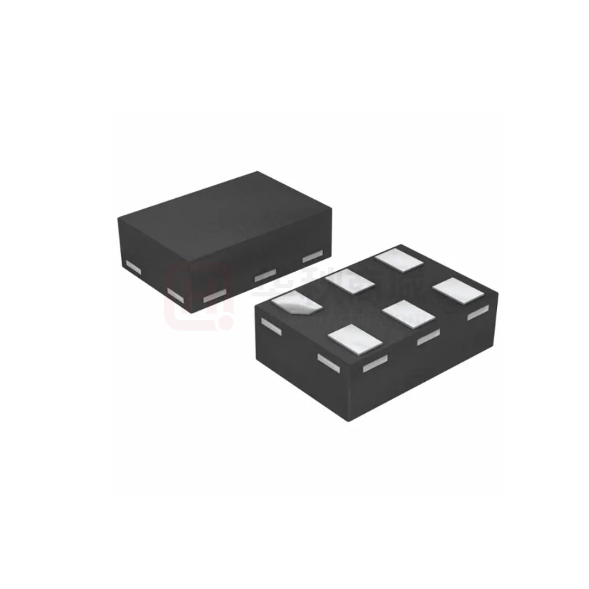

74LVC2G34-Q100 Dual buffer gate Rev. 3 — 28 January 2019 Product data sheet 1. General description The 74LVC2G34-Q100 provides two buffers. Inputs can be driven from either 3.3 V or 5 V devices. These features allow the use of these devices in a mixed 3.3 V and 5 V environment. This device is fully specified for partial power-down applications using IOFF. The IOFF circuitry disables the output, preventing the damaging backflow current through the device when it is powered down. This product has been qualified to the Automotive Electronics Council (AEC) standard Q100 (Grade 1) and is suitable for use in automotive applications. 2. Features and benefits • • • • • • • • • • Automotive product qualification in accordance with AEC-Q100 (Grade 1) • Specified from -40 °C to +85 °C and from -40 °C to +125 °C Wide supply voltage range from 1.65 V to 5.5 V 5 V tolerant inputs for interfacing with 5 V logic High noise immunity Complies with JEDEC standard: • JESD8-7 (1.65 V to 1.95 V) • JESD8-5 (2.3 V to 2.7 V) • JESD8B/JESD36 (2.7 V to 3.6 V) ESD protection: • MIL-STD-883, method 3015 exceeds 2000 V • HBM JESD22-A114F exceeds 2000 V • MM JESD22-A115-A exceeds 200 V (C = 200 pF, R = 0 Ω) ±24 mA output drive (VCC = 3.0 V) CMOS low power consumption Latch-up performance exceeds 250 mA Direct interface with TTL levels 3. Ordering information Table 1. Ordering information Type number Package Name Description Version 74LVC2G34GW-Q100 -40 °C to +125 °C Temperature range SC-88 plastic surface-mounted package; 6 leads SOT363 74LVC2G34GV-Q100 -40 °C to +125 °C TSOP6 plastic surface-mounted package (SC-74; TSOP6); 6 leads SOT457 74LVC2G34GM-Q100 -40 °C to +125 °C XSON6 plastic extremely thin small outline package; no leads; 6 terminals; body 1 x 1.45 x 0.5 mm SOT886 74LVC2G34-Q100 Nexperia Dual buffer gate 4. Marking Table 2. Marking Type number Marking code [1] 74LVC2G34GW-Q100 YA 74LVC2G34GV-Q100 Y34 74LVC2G34GM-Q100 YA [1] The pin 1 indicator is located on the lower left corner of the device, below the marking code. 5. Functional diagram 1 1A 1Y 6 3 2A 2Y 4 1 3 6 1 4 A Y mnb064 mnb063 Fig. 1. 1 Logic symbol Fig. 2. 001aac536 IEC logic symbol Fig. 3. Logic diagram (one gate) 6. Pinning information 6.1. Pinning 74LVC2G34 74LVC2G34 1A 1 6 1Y GND 2 5 VCC 2A 3 4 2Y 1A 1 6 1Y GND 2 5 VCC 2A 3 4 2Y 001aab677 001aab676 Fig. 4. Transparent top view Pin configuration SOT363 (SC-88) and SOT457 (TSOP6) Fig. 5. Pin configuration SOT886 (XSON6) 6.2. Pin description Table 3. Pin description Symbol Pin Description 1A 1 data input GND 2 ground (0 V) 2A 3 data input 2Y 4 data output VCC 5 supply voltage 1Y 6 data output 74LVC2G34_Q100 Product data sheet All information provided in this document is subject to legal disclaimers. Rev. 3 — 28 January 2019 © Nexperia B.V. 2019. All rights reserved 2 / 12 74LVC2G34-Q100 Nexperia Dual buffer gate 7. Functional description Table 4. Function table H = HIGH voltage level; L = LOW voltage level. Input Output nA nY L L H H 8. Limiting values Table 5. Limiting values In accordance with the Absolute Maximum Rating System (IEC 60134). Voltages are referenced to GND (ground = 0 V). Symbol Parameter Conditions Min Max Unit -0.5 +6.5 V VCC supply voltage IIK input clamping current VI input voltage IOK output clamping current VO > VCC or VO < 0 V VO output voltage Active mode [1] -0.5 Power-down mode; VCC = 0 V [1] -0.5 VI < 0 V [1] -50 - -0.5 +6.5 V - ±50 mA VCC + 0.5 V +6.5 V IO output current - ±50 mA ICC supply current - 100 mA IGND ground current -100 - mA Ptot total power dissipation - 250 mW Tstg storage temperature -65 +150 °C [1] [2] VO = 0 V to VCC mA Tamb = -40 °C to +125 °C [2] The input and output voltage ratings may be exceeded if the input and output current ratings are observed. For SC-88 and SC-74A packages: above 87.5 °C the value of Ptot derates linearly with 4.0 mW/K. For XSON6 packages: above 118 °C the value of Ptot derates linearly with 7.8 mW/K. 9. Recommended operating conditions Table 6. Recommended operating conditions Symbol Parameter Conditions Min Typ Max Unit VCC supply voltage 1.65 - 5.5 V VI input voltage VO output voltage Tamb ambient temperature Δt/ΔV input transition rise and fall rate 74LVC2G34_Q100 Product data sheet 0 - 5.5 V Active mode 0 - VCC V Power-down mode; VCC = 0 V 0 - 5.5 V -40 - +125 °C VCC = 1.65 V to 2.7 V - - 20 ns/V VCC = 2.7 V to 5.5 V - - 10 ns/V All information provided in this document is subject to legal disclaimers. Rev. 3 — 28 January 2019 © Nexperia B.V. 2019. All rights reserved 3 / 12 74LVC2G34-Q100 Nexperia Dual buffer gate 10. Static characteristics Table 7. Static characteristics At recommended operating conditions. Voltages are referenced to GND (ground = 0 V). Symbol Parameter VIH HIGH-level input voltage VIL LOW-level input voltage VOH VOL HIGH-level output voltage LOW-level output voltage Conditions -40 °C to +85 °C -40 °C to +125 °C Unit Min Typ[1] Max Min Max 0.65VCC - - 0.65VCC - V VCC = 2.3 V to 2.7 V 1.7 - - 1.7 - V VCC = 2.7 V to 3.6 V 2.0 - - 2.0 - V VCC = 4.5 V to 5.5 V 0.7VCC - - 0.7VCC - V VCC = 1.65 V to 1.95 V - - 0.35VCC - VCC = 2.3 V to 2.7 V - - 0.7 - VCC = 2.7 V to 3.6 V - - 0.8 - VCC = 4.5 V to 5.5 V - - 0.3VCC - VCC - 0.1 - - VCC - 0.1 - V IO = -4 mA; VCC = 1.65 V 1.2 - - 0.95 - V IO = -8 mA; VCC = 2.3 V 1.9 - - 1.7 - V IO = -12 mA; VCC = 2.7 V 2.2 - - 1.9 - V IO = -24 mA; VCC = 3.0 V 2.3 - - 2.0 - V IO = -32 mA; VCC = 4.5 V 3.8 - - 3.4 - V IO = 100 μA; VCC = 1.65 V to 5.5 V - - 0.10 - 0.10 V IO = 4 mA; VCC = 1.65 V - - 0.45 - 0.70 V IO = 8 mA; VCC = 2.3 V - - 0.30 - 0.45 V IO = 12 mA; VCC = 2.7 V - - 0.40 - 0.60 V IO = 24 mA; VCC = 3.0 V - - 0.55 - 0.80 V IO = 32 mA; VCC = 4.5 V - - 0.55 - 0.80 V VCC = 1.65 V to 1.95 V 0.35VCC V 0.7 V 0.8 V 0.3VCC V VI = VIH or VIL IO = -100 μA; VCC = 1.65 V to 5.5 V VI = VIH or VIL II input leakage current VI = 5.5 V or GND; VCC = 0 V to 5.5 V - ±0.1 ±1 - ±1 μA IOFF power-off leakage current VCC = 0 V; VI or VO = 5.5 V - ±0.1 ±2 - ±2 μA ICC supply current VI = 5.5 V or GND; IO = 0 A; VCC = 1.65 V to 5.5 V - 0.1 4 - 4 μA ΔICC additional supply current per pin; VCC = 2.3 V to 5.5 V; VI = VCC - 0.6 V; IO = 0 A - 5 500 - 500 μA CI input capacitance VCC = 3.3 V; VI = GND to VCC - 2.5 - - - pF [1] All typical values are measured at VCC = 3.3 V and Tamb = 25 °C. 74LVC2G34_Q100 Product data sheet All information provided in this document is subject to legal disclaimers. Rev. 3 — 28 January 2019 © Nexperia B.V. 2019. All rights reserved 4 / 12 74LVC2G34-Q100 Nexperia Dual buffer gate 11. Dynamic characteristics Table 8. Dynamic characteristics Voltages are referenced to GND (ground = 0 V); for test circuit see Fig. 7. Symbol Parameter tpd propagation delay CPD [1] [2] [3] Conditions power dissipation capacitance -40 °C to +85 °C -40 °C to +125 °C Unit Min Typ[1] Max Min Max VCC = 1.65 V to 1.95 V 1.0 3.8 8.6 1.0 10.8 ns VCC = 2.3 V to 2.7 V 0.5 2.4 4.4 0.5 5.5 ns VCC = 2.7 V 0.5 2.5 5.0 0.5 6.3 ns VCC = 3.0 V to 3.6 V 0.5 2.2 4.1 0.5 5.1 ns VCC = 4.5 V to 5.5 V 0.5 1.9 3.2 0.5 4.0 ns - 20 - - - pF nA to nY; see Fig. 6 [2] VI = GND to VCC; VCC = 3.3 V [3] Typical values are measured at Tamb = 25 °C and VCC = 1.8 V, 2.5 V, 2.7 V, 3.3 V and 5.0 V respectively. tpd is the same as tPLH and tPHL. CPD is used to determine the dynamic power dissipation (PD in μW). 2 2 PD = CPD x VCC x fi x N + ∑(CL x VCC x fo) where: fi = input frequency in MHz; fo = output frequency in MHz; CL = output load capacitance in pF; VCC = supply voltage in V; N = number of inputs switching; 2 ∑(CL x VCC x fo) = sum of outputs. 11.1. Waveforms and test circuit VI nA input VM VM GND tPLH tPHL VOH VM nY output VOL VM mnb072 Measurement points are given in Table 9. Logic levels: VOL and VOH are typical output voltage levels that occur with the output load. Fig. 6. The data input (nA) to output (nY) propagation delays Table 9. Measurement points Supply voltage Input Output VCC VM VM 1.65 V to 1.95 V 0.5VCC 0.5VCC 2.3 V to 2.7 V 0.5VCC 0.5VCC 2.7 V 1.5 V 1.5 V 3.0 V to 3.6 V 1.5 V 1.5 V 4.5 V to 5.5 V 0.5VCC 0.5VCC 74LVC2G34_Q100 Product data sheet All information provided in this document is subject to legal disclaimers. Rev. 3 — 28 January 2019 © Nexperia B.V. 2019. All rights reserved 5 / 12 74LVC2G34-Q100 Nexperia Dual buffer gate VEXT VCC G VI RL VO DUT RT CL RL mna616 Test data is given in Table 10. Definitions for test circuit: RL = Load resistance. CL = Load capacitance including jig and probe capacitance. RT = Termination resistance should be equal to the output impedance Zo of the pulse generator. VEXT = External voltage for measuring switching times. Fig. 7. Test circuit for measuring switching times Table 10. Test data Supply voltage Input VCC VI tr = tf CL RL tPLH, tPHL 1.65 V to 1.95 V VCC ≤ 2.0 ns 30 pF 1 kΩ open 2.3 V to 2.7 V VCC ≤ 2.0 ns 30 pF 500 Ω open 2.7 V 2.7 V ≤ 2.5 ns 50 pF 500 Ω open 3.0 V to 3.6 V 2.7 V ≤ 2.5 ns 50 pF 500 Ω open 4.5 V to 5.5 V VCC ≤ 2.5 ns 50 pF 500 Ω open 74LVC2G34_Q100 Product data sheet VEXT Load All information provided in this document is subject to legal disclaimers. Rev. 3 — 28 January 2019 © Nexperia B.V. 2019. All rights reserved 6 / 12 74LVC2G34-Q100 Nexperia Dual buffer gate 12. Package outline Plastic surface-mounted package; 6 leads SOT363 D B E y A X HE 6 5 v M A 4 Q pin 1 index A 1 2 e1 A1 3 bp c Lp w M B e detail X 0 1 2 mm scale DIMENSIONS (mm are the original dimensions) UNIT A A1 max bp c D E e e1 HE Lp Q v w y mm 1.1 0.8 0.1 0.30 0.20 0.25 0.10 2.2 1.8 1.35 1.15 1.3 0.65 2.2 2.0 0.45 0.15 0.25 0.15 0.2 0.2 0.1 OUTLINE VERSION REFERENCES IEC JEDEC SOT363 Fig. 8. JEITA EUROPEAN PROJECTION ISSUE DATE 04-11-08 06-03-16 SC-88 Package outline SOT363 (SC-88) 74LVC2G34_Q100 Product data sheet All information provided in this document is subject to legal disclaimers. Rev. 3 — 28 January 2019 © Nexperia B.V. 2019. All rights reserved 7 / 12 74LVC2G34-Q100 Nexperia Dual buffer gate Plastic, surface-mounted package (SC-74; TSOP6); 6 leads D SOT457 B E y A X HE 6 5 v M A 4 Q A pin 1 index A1 c 1 2 Lp 3 bp e detail X w M B 0 1 2 mm scale Dimensions (mm are the original dimensions) Unit mm max nom min A A1 1.1 0.1 0.9 bp c D E 0.40 0.26 3.1 1.7 0.013 0.25 0.10 2.7 1.3 e 0.95 HE Lp Q 3.0 0.6 0.33 2.5 0.2 0.23 v w y 0.2 0.2 0.1 sot457_po Outline version References IEC JEDEC SOT457 Fig. 9. JEITA European projection Issue date 06-03-16 18-11-27 SC-74 Package outline SOT457 (TSOP6) 74LVC2G34_Q100 Product data sheet All information provided in this document is subject to legal disclaimers. Rev. 3 — 28 January 2019 © Nexperia B.V. 2019. All rights reserved 8 / 12 74LVC2G34-Q100 Nexperia Dual buffer gate SOT886 XSON6: plastic extremely thin small outline package; no leads; 6 terminals; body 1 x 1.45 x 0.5 mm b 1 2 3 4x (2) L L1 e 6 5 e1 4 e1 6x A (2) A1 D E terminal 1 index area 0 1 2 mm scale Dimensions (mm are the original dimensions) Unit mm max nom min A(1) 0.5 A1 b D E 0.04 0.25 1.50 1.05 0.20 1.45 1.00 0.17 1.40 0.95 e e1 0.6 0.5 L L1 0.35 0.40 0.30 0.35 0.27 0.32 Notes 1. Including plating thickness. 2. Can be visible in some manufacturing processes. Outline version SOT886 sot886_po References IEC JEDEC JEITA European projection Issue date 04-07-22 12-01-05 MO-252 Fig. 10. Package outline SOT886 (XSON6) 74LVC2G34_Q100 Product data sheet All information provided in this document is subject to legal disclaimers. Rev. 3 — 28 January 2019 © Nexperia B.V. 2019. All rights reserved 9 / 12 74LVC2G34-Q100 Nexperia Dual buffer gate 13. Abbreviations Table 11. Abbreviations Acronym Description CMOS Complementary Metal-Oxide Semiconductor DUT Device Under Test ESD ElectroStatic Discharge HBM Human Body Model MIL Military MM Machine Model TTL Transistor-Transistor Logic 14. Revision history Table 12. Revision history Document ID Release date Data sheet status Change notice Supersedes 74LVC2G34_Q100 v.3 20190128 Product data sheet - Modifications: • • • • The format of this data sheet has been redesigned to comply with the identity guidelines of Nexperia. Legal texts have been adapted to the new company name where appropriate. Type number 74LVC2G34GM-Q100 (SOT886) added. Package outline drawing SOT457 updated 74LVC2G34_Q100 v.2 20161214 Modifications: • 74LVC2G34_Q100 v.1 20120801 74LVC2G34_Q100 Product data sheet 74LVC2G34_Q100 v.2 Product data sheet - 74LVC2G34_Q100 v.1 Table 7: The maximum limits for leakage current and supply current have changed. Product data sheet - All information provided in this document is subject to legal disclaimers. Rev. 3 — 28 January 2019 - © Nexperia B.V. 2019. All rights reserved 10 / 12 74LVC2G34-Q100 Nexperia Dual buffer gate equipment, nor in applications where failure or malfunction of an Nexperia product can reasonably be expected to result in personal injury, death or severe property or environmental damage. Nexperia and its suppliers accept no liability for inclusion and/or use of Nexperia products in such equipment or applications and therefore such inclusion and/or use is at the customer's own risk. 15. Legal information Data sheet status Document status [1][2] Product status [3] Definition Quick reference data — The Quick reference data is an extract of the product data given in the Limiting values and Characteristics sections of this document, and as such is not complete, exhaustive or legally binding. Objective [short] data sheet Development This document contains data from the objective specification for product development. Preliminary [short] data sheet Qualification This document contains data from the preliminary specification. Applications — Applications that are described herein for any of these products are for illustrative purposes only. Nexperia makes no representation or warranty that such applications will be suitable for the specified use without further testing or modification. Product [short] data sheet Production This document contains the product specification. [1] [2] [3] Please consult the most recently issued document before initiating or completing a design. The term 'short data sheet' is explained in section "Definitions". The product status of device(s) described in this document may have changed since this document was published and may differ in case of multiple devices. The latest product status information is available on the internet at https://www.nexperia.com. Definitions Draft — The document is a draft version only. The content is still under internal review and subject to formal approval, which may result in modifications or additions. Nexperia does not give any representations or warranties as to the accuracy or completeness of information included herein and shall have no liability for the consequences of use of such information. Short data sheet — A short data sheet is an extract from a full data sheet with the same product type number(s) and title. A short data sheet is intended for quick reference only and should not be relied upon to contain detailed and full information. For detailed and full information see the relevant full data sheet, which is available on request via the local Nexperia sales office. In case of any inconsistency or conflict with the short data sheet, the full data sheet shall prevail. Product specification — The information and data provided in a Product data sheet shall define the specification of the product as agreed between Nexperia and its customer, unless Nexperia and customer have explicitly agreed otherwise in writing. In no event however, shall an agreement be valid in which the Nexperia product is deemed to offer functions and qualities beyond those described in the Product data sheet. Disclaimers Limited warranty and liability — Information in this document is believed to be accurate and reliable. However, Nexperia does not give any representations or warranties, expressed or implied, as to the accuracy or completeness of such information and shall have no liability for the consequences of use of such information. Nexperia takes no responsibility for the content in this document if provided by an information source outside of Nexperia. In no event shall Nexperia be liable for any indirect, incidental, punitive, special or consequential damages (including - without limitation - lost profits, lost savings, business interruption, costs related to the removal or replacement of any products or rework charges) whether or not such damages are based on tort (including negligence), warranty, breach of contract or any other legal theory. Customers are responsible for the design and operation of their applications and products using Nexperia products, and Nexperia accepts no liability for any assistance with applications or customer product design. It is customer’s sole responsibility to determine whether the Nexperia product is suitable and fit for the customer’s applications and products planned, as well as for the planned application and use of customer’s third party customer(s). Customers should provide appropriate design and operating safeguards to minimize the risks associated with their applications and products. Nexperia does not accept any liability related to any default, damage, costs or problem which is based on any weakness or default in the customer’s applications or products, or the application or use by customer’s third party customer(s). Customer is responsible for doing all necessary testing for the customer’s applications and products using Nexperia products in order to avoid a default of the applications and the products or of the application or use by customer’s third party customer(s). Nexperia does not accept any liability in this respect. Limiting values — Stress above one or more limiting values (as defined in the Absolute Maximum Ratings System of IEC 60134) will cause permanent damage to the device. Limiting values are stress ratings only and (proper) operation of the device at these or any other conditions above those given in the Recommended operating conditions section (if present) or the Characteristics sections of this document is not warranted. Constant or repeated exposure to limiting values will permanently and irreversibly affect the quality and reliability of the device. Terms and conditions of commercial sale — Nexperia products are sold subject to the general terms and conditions of commercial sale, as published at http://www.nexperia.com/profile/terms, unless otherwise agreed in a valid written individual agreement. In case an individual agreement is concluded only the terms and conditions of the respective agreement shall apply. Nexperia hereby expressly objects to applying the customer’s general terms and conditions with regard to the purchase of Nexperia products by customer. No offer to sell or license — Nothing in this document may be interpreted or construed as an offer to sell products that is open for acceptance or the grant, conveyance or implication of any license under any copyrights, patents or other industrial or intellectual property rights. Export control — This document as well as the item(s) described herein may be subject to export control regulations. Export might require a prior authorization from competent authorities. Translations — A non-English (translated) version of a document is for reference only. The English version shall prevail in case of any discrepancy between the translated and English versions. Trademarks Notice: All referenced brands, product names, service names and trademarks are the property of their respective owners. Notwithstanding any damages that customer might incur for any reason whatsoever, Nexperia’s aggregate and cumulative liability towards customer for the products described herein shall be limited in accordance with the Terms and conditions of commercial sale of Nexperia. Right to make changes — Nexperia reserves the right to make changes to information published in this document, including without limitation specifications and product descriptions, at any time and without notice. This document supersedes and replaces all information supplied prior to the publication hereof. Suitability for use in automotive applications — This Nexperia product has been qualified for use in automotive applications. Unless otherwise agreed in writing, the product is not designed, authorized or warranted to be suitable for use in life support, life-critical or safety-critical systems or 74LVC2G34_Q100 Product data sheet All information provided in this document is subject to legal disclaimers. Rev. 3 — 28 January 2019 © Nexperia B.V. 2019. All rights reserved 11 / 12 74LVC2G34-Q100 Nexperia Dual buffer gate Contents 1. General description...................................................... 1 2. Features and benefits.................................................. 1 3. Ordering information....................................................1 4. Marking.......................................................................... 2 5. Functional diagram.......................................................2 6. Pinning information......................................................2 6.1. Pinning.........................................................................2 6.2. Pin description............................................................. 2 7. Functional description................................................. 3 8. Limiting values............................................................. 3 9. Recommended operating conditions..........................3 10. Static characteristics..................................................4 11. Dynamic characteristics.............................................5 11.1. Waveforms and test circuit........................................ 5 12. Package outline.......................................................... 7 13. Abbreviations............................................................ 10 14. Revision history........................................................10 15. Legal information......................................................11 © Nexperia B.V. 2019. All rights reserved For more information, please visit: http://www.nexperia.com For sales office addresses, please send an email to: salesaddresses@nexperia.com Date of release: 28 January 2019 74LVC2G34_Q100 Product data sheet All information provided in this document is subject to legal disclaimers. Rev. 3 — 28 January 2019 © Nexperia B.V. 2019. All rights reserved 12 / 12
