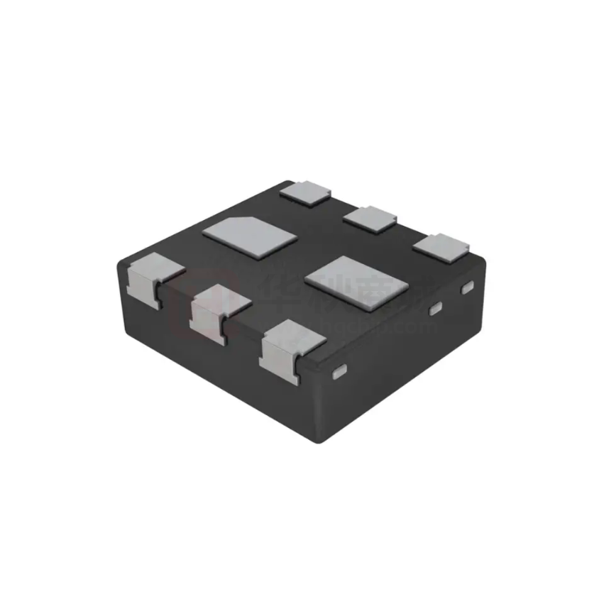

    三极管 NPN Ic=100mA Vceo=45V hfe=450 P=230mW DFN1010B-6
BCM847QASZ 数据手册
BCM847QAS 45 V, 100 mA NPN/NPN matched double transistors 24 April 2018 Product data sheet 1. General description NPN/NPN matched double transistors in an ultra small DFN1010B-6 (SOT1216) leadless SurfaceMounted Device (SMD) plastic package. PNP/PNP complement: BCM857QAS 2. Features and benefits • • • • • • • Reduces component count Reduces pick and place costs Low package height of 0.37 mm Current gain matching Base-emitter voltage matching Application-optimized pinout AEC-Q101 qualified 3. Applications • • Current mirror Differential amplifier 4. Quick reference data Table 1. Quick reference data Symbol Parameter Conditions Min Typ Max Unit VCEO collector-emitter voltage open base - - 45 V IC collector current - - 100 mA ICM peak collector current tp ≤ 1 ms; single pulse - - 200 mA hFE DC current gain VCE = 5 V; IC = 2 mA; Tamb = 25 °C 200 290 450 hFE1/hFE2 DC current gain matching VCE = 5 V; IC = 2 mA; Tamb = 25 °C 0.95 1 1.05 VBE1−VBE2 base-emitter voltage matching - - 2 Per transistor Per device [1] The smaller of the two values is subtracted from the larger value. [1] mV BCM847QAS Nexperia 45 V, 100 mA NPN/NPN matched double transistors 5. Pinning information Table 2. Pinning information Pin Symbol Description 1 E1 Simplified outline Graphic symbol emitter TR1 2 B1 base TR1 3 C2 collector TR2 4 E2 emitter TR2 5 B2 base TR2 6 C1 collector TR1 7 C1 collector TR1 8 C2 collector TR2 C1 1 7 2 3 E2 TR2 TR1 5 8 B2 6 E1 4 B1 C2 sym020 Transparent top view DFN1010B-6 (SOT1216) 6. Ordering information Table 3. Ordering information Type number Package BCM847QAS Name Description Version DFN1010B-6 DFN1010B-6: plastic thermal enhanced ultra thin small outline package; no leads; 6 terminals SOT1216 7. Marking Table 4. Marking codes Type number Marking code BCM847QAS C 010 MARKING CODE (EXAMPLE) READING DIRECTION MARK-FREE AREA PIN 1 INDICATION MARK READING EXAMPLE: YEAR DATE CODE A 110 VENDOR CODE Fig. 1. aaa-019766 DFN1010B-6 (SOT1216) binary marking code description BCM847QAS Product data sheet All information provided in this document is subject to legal disclaimers. 24 April 2018 © Nexperia B.V. 2018. All rights reserved 2 / 11 BCM847QAS Nexperia 45 V, 100 mA NPN/NPN matched double transistors 8. Limiting values Table 5. Limiting values In accordance with the Absolute Maximum Rating System (IEC 60134). Symbol Parameter Conditions Min Max Unit VCBO collector-base voltage open emitter - 50 V VCEO collector-emitter voltage open base - 45 V VEBO emitter-base voltage open collector - 6 V IC collector current - 100 mA ICM peak collector current - 200 mA IBM peak base current - 100 mA Ptot total power dissipation Tamb ≤ 25 °C [1] - 230 mW Ptot total power dissipation Tamb ≤ 25 °C [1] - 350 mW Tj junction temperature - 150 °C Tamb ambient temperature -55 150 °C Tstg storage temperature -65 150 °C Per transistor tp ≤ 1 ms; single pulse Per device [1] Device mounted on an FR4 Printed-Circuit Board (PCB), single-sided copper, tin-plated and standard footprint. aaa-007377 400 Ptot (mW) 300 200 100 0 -75 -25 25 75 125 175 Tamb (°C) FR4 PCB, standard footprint Fig. 2. Per device: Power derating curve BCM847QAS Product data sheet All information provided in this document is subject to legal disclaimers. 24 April 2018 © Nexperia B.V. 2018. All rights reserved 3 / 11 BCM847QAS Nexperia 45 V, 100 mA NPN/NPN matched double transistors 9. Thermal characteristics Table 6. Thermal characteristics Symbol Parameter Conditions thermal resistance from junction to ambient in free air thermal resistance from junction to ambient in free air Min Typ Max Unit [1] - - 544 K/W [1] - - 358 K/W Per transistor Rth(j-a) Per device Rth(j-a) [1] Device mounted on an FR4 PCB, single-sided copper, tin-plated and standard footprint. 103 Zth(j-a) (K/W) aaa-007378 duty cycle = 0.75 1 0.5 0.33 0.2 102 0.1 0.05 10 0.02 0.01 0 1 10-5 10-4 10-3 10-2 10-1 1 10 102 tp (s) 103 FR4 PCB, standard footprint Fig. 3. Per transistor: Transient thermal impedance from junction to ambient as a function of pulse duration; typical values BCM847QAS Product data sheet All information provided in this document is subject to legal disclaimers. 24 April 2018 © Nexperia B.V. 2018. All rights reserved 4 / 11 BCM847QAS Nexperia 45 V, 100 mA NPN/NPN matched double transistors 10. Characteristics Table 7. Characteristics Symbol Parameter Conditions Min Typ Max Unit V(BR)CBO collector-base breakdown voltage IC = 100 µA; IE = 0 A 50 - - V V(BR)CEO collector-emitter breakdown voltage IC = 2 mA; IB = 0 A 45 - - V V(BR)EBO emitter-base breakdown voltage IC = 0 A; IE = 100 µA 6 - - V ICBO collector-base cut-off current VCB = 30 V; IE = 0 A; Tamb = 25 °C - - 15 nA VCB = 30 V; IE = 0 A; Tj = 150 °C - - 5 µA IEBO emitter-base cut-off current VEB = 5 V; IC = 0 A; Tamb = 25 °C - - 100 nA hFE DC current gain VCE = 5 V; IC = 10 µA; Tamb = 25 °C - 250 - VCE = 5 V; IC = 2 mA; Tamb = 25 °C 200 290 450 IC = 10 mA; IB = 0.5 mA; Tamb = 25 °C - - 200 mV Per transistor VCEsat VBEsat VBE collector-emitter saturation voltage IC = 100 mA; IB = 5 mA; Tamb = 25 °C [1] - - 400 mV base-emitter saturation IC = 10 mA; IB = 0.5 mA; Tamb = 25 °C voltage IC = 100 mA; IB = 5 mA; Tamb = 25 °C [2] - 760 - mV [2] - 900 - mV VCE = 5 V; IC = 2 mA; Tamb = 25 °C [3] 600 660 725 mV VCE = 5 V; IC = 10 mA; Tamb = 25 °C [3] - 710 820 mV base-emitter voltage Cc collector capacitance VCB = 10 V; IE = 0 A; ie = 0 A; f = 1 MHz; Tamb = 25 °C - - 4 pF Ce emitter capacitance VEB = 0.5 V; IC = 0 A; ic = 0 A; f = 1 MHz; Tamb = 25 °C - 11 - pF fT transition frequency VCE = 5 V; IC = 10 mA; f = 100 MHz; Tamb = 25 °C 100 - - MHz hFE1/hFE2 DC current gain matching VCE = 5 V; IC = 2 mA; Tamb = 25 °C 0.95 1 1.05 VBE1−VBE2 base-emitter voltage matching - - 2 Per device [1] [2] [3] [4] [4] mV Pulse test: tp ≤ 300 μs; δ ≤ 0.02 VBEsat decreases by about 1.7 mV/K with increasing temperature. VBE decreases by about 2 mV/K with increasing temperature. The smaller of the two values is subtracted from the larger value. BCM847QAS Product data sheet All information provided in this document is subject to legal disclaimers. 24 April 2018 © Nexperia B.V. 2018. All rights reserved 5 / 11 BCM847QAS Nexperia 45 V, 100 mA NPN/NPN matched double transistors mgt727 600 006aab422 0.20 hFE IB (mA) = 4.0 IC (A) 500 0.15 400 3.6 3.2 2.8 2.4 2.0 1.6 1.2 (1) 300 0.8 0.10 0.4 (2) 200 0.05 (3) 100 0 10-1 1 102 10 I C (mA) 0 103 1 2 3 4 VCE (V) 5 Tamb = 25 °C VCE = 5 V (1) Tamb = 150 °C (2) Tamb = 25 °C (3) Tamb = −55 °C Fig. 4. 0 Fig. 5. Collector current as a function of collectoremitter voltage; typical values DC current gain as a function of collector current; typical values mgt728 1200 VBE (mV) 1000 006aab423 1.2 VBEsat (V) 1.0 (1) (1) 800 0.8 (2) (2) 600 0.6 (3) 400 0.4 200 0 10- 2 10- 1 1 10 0.2 10- 1 102 103 I C (mA) Base-emitter voltage as a function of collector current; typical values BCM847QAS Product data sheet 1 10 102 IC (mA) 103 IC/IB = 20 (1) Tamb = -55 °C (2) Tamb = 25 °C (3) Tamb = 150 °C VCE = 5 V (1) Tamb = -55 °C (2) Tamb = 25 °C (3) Tamb = 150 °C Fig. 6. (3) Fig. 7. Base-emitter saturation voltage as a function of collector current; typical values All information provided in this document is subject to legal disclaimers. 24 April 2018 © Nexperia B.V. 2018. All rights reserved 6 / 11 BCM847QAS Nexperia 45 V, 100 mA NPN/NPN matched double transistors mgt729 104 006aab424 109 VCEsat (mV) fT (Hz) 103 108 102 (1) (3) (2) 10 10- 1 1 102 10 I C (mA) 107 10- 1 103 10 IC (mA) 102 Tamb = 25 °C; VCE = 5 V; f = 100 MHz IC/IB = 20 (1) Tamb = 150 °C (2) Tamb = 25 °C (3) Tamb = -55 °C Fig. 8. 1 Collector-emitter saturation voltage as a function of collector current; typical values Fig. 9. Transition frequency as a function of collector current; typical values 11. Test information Quality information This product has been qualified in accordance with the Automotive Electronics Council (AEC) standard Q101 - Stress test qualification for discrete semiconductors, and is suitable for use in automotive applications. 12. Package outline 0.35 0.35 0.15 0.23 1 2 0.125 0.205 0.22 0.30 0.95 1.05 6 0.04 max 3 0.34 0.40 Dimensions in mm 5 4 0.32 0.40 0.275 0.275 1.05 1.15 13-03-05 Fig. 10. Package outline DFN1010B-6 (SOT1216) BCM847QAS Product data sheet All information provided in this document is subject to legal disclaimers. 24 April 2018 © Nexperia B.V. 2018. All rights reserved 7 / 11 BCM847QAS Nexperia 45 V, 100 mA NPN/NPN matched double transistors 13. Soldering Footprint information for reflow soldering of DFN1010B-6 package SOT1216 0.9 0.35 0.35 0.15 0.2 (6x) 0.15 1.3 1.2 0.35 0.25 0.5 0.6 0.35 0.25 1.1 0.3 (6x) 1 1.35 solder paste solder land plus solder paste occupied area solder resist Dimensions in mm Issue date 14-07-28 17-03-31 sot1216_fr Fig. 11. Reflow soldering footprint for DFN1010B-6 (SOT1216) BCM847QAS Product data sheet All information provided in this document is subject to legal disclaimers. 24 April 2018 © Nexperia B.V. 2018. All rights reserved 8 / 11 BCM847QAS Nexperia 45 V, 100 mA NPN/NPN matched double transistors 14. Revision history Table 8. Revision history Data sheet ID Release date Data sheet status Change notice Supersedes BCM847QAS v.1 20180424 Product data sheet - - BCM847QAS Product data sheet All information provided in this document is subject to legal disclaimers. 24 April 2018 © Nexperia B.V. 2018. All rights reserved 9 / 11 BCM847QAS Nexperia 45 V, 100 mA NPN/NPN matched double transistors for the products described herein shall be limited in accordance with the Terms and conditions of commercial sale of Nexperia. 15. Legal information Right to make changes — Nexperia reserves the right to make changes to information published in this document, including without limitation specifications and product descriptions, at any time and without notice. This document supersedes and replaces all information supplied prior to the publication hereof. Data sheet status Document status [1][2] Product status [3] Objective [short] data sheet Development This document contains data from the objective specification for product development. Preliminary [short] data sheet Qualification This document contains data from the preliminary specification. Product [short] data sheet Production This document contains the product specification. [1] [2] [3] Suitability for use in automotive applications — This Nexperia product has been qualified for use in automotive applications. Unless otherwise agreed in writing, the product is not designed, authorized or warranted to be suitable for use in life support, life-critical or safety-critical systems or equipment, nor in applications where failure or malfunction of an Nexperia product can reasonably be expected to result in personal injury, death or severe property or environmental damage. Nexperia and its suppliers accept no liability for inclusion and/or use of Nexperia products in such equipment or applications and therefore such inclusion and/or use is at the customer's own risk. Definition Quick reference data — The Quick reference data is an extract of the product data given in the Limiting values and Characteristics sections of this document, and as such is not complete, exhaustive or legally binding. Please consult the most recently issued document before initiating or completing a design. The term 'short data sheet' is explained in section "Definitions". The product status of device(s) described in this document may have changed since this document was published and may differ in case of multiple devices. The latest product status information is available on the Internet at URL http://www.nexperia.com. Definitions Preview — The document is a preview version only. The document is still subject to formal approval, which may result in modifications or additions. Nexperia does not give any representations or warranties as to the accuracy or completeness of information included herein and shall have no liability for the consequences of use of such information. Draft — The document is a draft version only. The content is still under internal review and subject to formal approval, which may result in modifications or additions. Nexperia does not give any representations or warranties as to the accuracy or completeness of information included herein and shall have no liability for the consequences of use of such information. Short data sheet — A short data sheet is an extract from a full data sheet with the same product type number(s) and title. A short data sheet is intended for quick reference only and should not be relied upon to contain detailed and full information. For detailed and full information see the relevant full data sheet, which is available on request via the local Nexperia sales office. In case of any inconsistency or conflict with the short data sheet, the full data sheet shall prevail. Product specification — The information and data provided in a Product data sheet shall define the specification of the product as agreed between Nexperia and its customer, unless Nexperia and customer have explicitly agreed otherwise in writing. In no event however, shall an agreement be valid in which the Nexperia product is deemed to offer functions and qualities beyond those described in the Product data sheet. Disclaimers Limited warranty and liability — Information in this document is believed to be accurate and reliable. However, Nexperia does not give any representations or warranties, expressed or implied, as to the accuracy or completeness of such information and shall have no liability for the consequences of use of such information. Nexperia takes no responsibility for the content in this document if provided by an information source outside of Nexperia. Applications — Applications that are described herein for any of these products are for illustrative purposes only. Nexperia makes no representation or warranty that such applications will be suitable for the specified use without further testing or modification. Customers are responsible for the design and operation of their applications and products using Nexperia products, and Nexperia accepts no liability for any assistance with applications or customer product design. It is customer’s sole responsibility to determine whether the Nexperia product is suitable and fit for the customer’s applications and products planned, as well as for the planned application and use of customer’s third party customer(s). Customers should provide appropriate design and operating safeguards to minimize the risks associated with their applications and products. Nexperia does not accept any liability related to any default, damage, costs or problem which is based on any weakness or default in the customer’s applications or products, or the application or use by customer’s third party customer(s). Customer is responsible for doing all necessary testing for the customer’s applications and products using Nexperia products in order to avoid a default of the applications and the products or of the application or use by customer’s third party customer(s). Nexperia does not accept any liability in this respect. Limiting values — Stress above one or more limiting values (as defined in the Absolute Maximum Ratings System of IEC 60134) will cause permanent damage to the device. Limiting values are stress ratings only and (proper) operation of the device at these or any other conditions above those given in the Recommended operating conditions section (if present) or the Characteristics sections of this document is not warranted. Constant or repeated exposure to limiting values will permanently and irreversibly affect the quality and reliability of the device. Terms and conditions of commercial sale — Nexperia products are sold subject to the general terms and conditions of commercial sale, as published at http://www.nexperia.com/profile/terms, unless otherwise agreed in a valid written individual agreement. In case an individual agreement is concluded only the terms and conditions of the respective agreement shall apply. Nexperia hereby expressly objects to applying the customer’s general terms and conditions with regard to the purchase of Nexperia products by customer. No offer to sell or license — Nothing in this document may be interpreted or construed as an offer to sell products that is open for acceptance or the grant, conveyance or implication of any license under any copyrights, patents or other industrial or intellectual property rights. Export control — This document as well as the item(s) described herein may be subject to export control regulations. Export might require a prior authorization from competent authorities. In no event shall Nexperia be liable for any indirect, incidental, punitive, special or consequential damages (including - without limitation - lost profits, lost savings, business interruption, costs related to the removal or replacement of any products or rework charges) whether or not such damages are based on tort (including negligence), warranty, breach of contract or any other legal theory. Translations — A non-English (translated) version of a document is for reference only. The English version shall prevail in case of any discrepancy between the translated and English versions. Notwithstanding any damages that customer might incur for any reason whatsoever, Nexperia’ aggregate and cumulative liability towards customer Notice: All referenced brands, product names, service names and trademarks are the property of their respective owners. BCM847QAS Product data sheet Trademarks All information provided in this document is subject to legal disclaimers. 24 April 2018 © Nexperia B.V. 2018. All rights reserved 10 / 11 BCM847QAS Nexperia 45 V, 100 mA NPN/NPN matched double transistors 16. Contents 1. General description......................................................1 2. Features and benefits.................................................. 1 3. Applications.................................................................. 1 4. Quick reference data....................................................1 5. Pinning information......................................................2 6. Ordering information....................................................2 7. Marking.......................................................................... 2 8. Limiting values............................................................. 3 9. Thermal characteristics............................................... 4 10. Characteristics............................................................ 5 11. Test information..........................................................7 12. Package outline.......................................................... 7 13. Soldering..................................................................... 8 14. Revision history..........................................................9 15. Legal information..................................................... 10 © Nexperia B.V. 2018. All rights reserved For more information, please visit: http://www.nexperia.com For sales office addresses, please send an email to: salesaddresses@nexperia.com Date of release: 24 April 2018 BCM847QAS Product data sheet All information provided in this document is subject to legal disclaimers. 24 April 2018 © Nexperia B.V. 2018. All rights reserved 11 / 11
