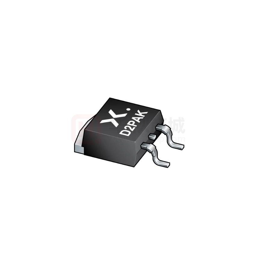

BUK763R4-30B N-channel TrenchMOS standard level FET Rev. 2 — 21 April 2011 Product data sheet 1. Product profile 1.1 General description Standard level N-channel enhancement mode Field-Effect Transistor (FET) in a plastic package using TrenchMOS technology. This product has been designed and qualified to the appropriate AEC standard for use in automotive critical applications. 1.2 Features and benefits „ AEC Q101 compliant „ Suitable for standard level gate drive sources „ Suitable for thermally demanding environments due to 175 °C rating 1.3 Applications „ 12 V loads „ General purpose power switching „ Automotive systems „ Motors, lamps and solenoids 1.4 Quick reference data Table 1. Quick reference data Symbol Parameter Conditions Min Typ Max Unit VDS drain-source voltage Tj ≥ 25 °C; Tj ≤ 175 °C - - 30 V - - 75 A [1] ID drain current VGS = 10 V; Tmb = 25 °C; see Figure 1; see Figure 4 Ptot total power dissipation Tmb = 25 °C; see Figure 2 - - 255 W VGS = 10 V; ID = 25 A; Tj = 25 °C; see Figure 12; see Figure 13 - 2.9 3.4 mΩ ID = 75 A; Vsup ≤ 30 V; RGS = 50 Ω; VGS = 10 V; Tj(init) = 25 °C; unclamped - - 1.3 J Static characteristics RDSon drain-source on-state resistance Avalanche ruggedness EDS(AL)S [1] non-repetitive drain-source avalanche energy Continuous current is limited by package. BUK763R4-30B Nexperia N-channel TrenchMOS standard level FET 2. Pinning information Table 2. Pinning information Pin Symbol Description 1 G gate 2 D drain 3 S source mb D mounting base; connected to drain Simplified outline Graphic symbol mb D G mbb076 S 2 1 3 SOT404 (D2PAK) 3. Ordering information Table 3. Ordering information Type number BUK763R4-30B BUK763R4-30B Product data sheet Package Name Description Version D2PAK plastic single-ended surface-mounted package (D2PAK); 3 leads (one lead cropped) SOT404 All information provided in this document is subject to legal disclaimers. Rev. 2 — 21 April 2011 © Nexperia B.V. 2017. All rights reserved 2 of 14 BUK763R4-30B Nexperia N-channel TrenchMOS standard level FET 4. Limiting values Table 4. Limiting values In accordance with the Absolute Maximum Rating System (IEC 60134). Symbol Parameter Conditions Min Max Unit VDS drain-source voltage Tj ≥ 25 °C; Tj ≤ 175 °C - 30 V VDGR drain-gate voltage RGS = 20 kΩ - 30 V VGS gate-source voltage ID drain current -20 20 V Tmb = 25 °C; VGS = 10 V; see Figure 1; see Figure 4 [1] - 75 A Tmb = 100 °C; VGS = 10 V; see Figure 1 [1] - 75 A [2][3] - 198 A - 794 A Tmb = 25 °C; VGS = 10 V; see Figure 1; see Figure 4 IDM peak drain current Tmb = 25 °C; pulsed; tp ≤ 10 µs; see Figure 4 Ptot total power dissipation Tmb = 25 °C; see Figure 2 - 255 W Tstg storage temperature -55 175 °C Tj junction temperature -55 175 °C [2][3] - 198 A [1] - 75 A pulsed; tp ≤ 10 µs; Tmb = 25 °C - 794 A - 1.3 J - - J Source-drain diode source current IS Tmb = 25 °C peak source current ISM Avalanche ruggedness EDS(AL)S non-repetitive drain-source avalanche energy ID = 75 A; Vsup ≤ 30 V; RGS = 50 Ω; VGS = 10 V; Tj(init) = 25 °C; unclamped EDS(AL)R repetitive drain-source avalanche energy see Figure 3 7] [1] Continuous current is limited by package. [2] Current is limited by power dissipation chip rating. [3] Refer to document 9397 750 12572 for further information. [4] Maximum value not quoted. Repetitive rating defined in avalanche rating figure. [5] Single-shot avalanche rating limited by maximum junction temperature of 175 °C. [6] Repetitive avalanche rating limited by an average junction temperature of 170 °C. [7] Refer to application note AN10273 for further information. BUK763R4-30B Product data sheet [4][5][6][ All information provided in this document is subject to legal disclaimers. Rev. 2 — 21 April 2011 © Nexperia B.V. 2017. All rights reserved 3 of 14 BUK763R4-30B Nexperia N-channel TrenchMOS standard level FET 003aab196 250 ID (A) 03na19 120 Pder (%) 200 80 150 100 (1) 40 50 0 0 0 Fig 1. 50 100 150 Tj (°C) 0 200 50 100 150 200 Tmb (°C) Continuous drain current as a function of mounting base temperature Fig 2. Normalized total power dissipation as a function of mounting base temperature 003aab195 102 (1) IAL (A) (2) 10 (3) 1 10-3 Fig 3. 10-2 10-1 1 tAL (ms) 10 Single shot and repetitive avalanche rating; avalanche current as a function of avalanche time BUK763R4-30B Product data sheet All information provided in this document is subject to legal disclaimers. Rev. 2 — 21 April 2011 © Nexperia B.V. 2017. All rights reserved 4 of 14 BUK763R4-30B Nexperia N-channel TrenchMOS standard level FET 003aab185 104 ID (A) 103 limit R DSon = VDS/ ID tp = 10 μ s 100 μ s 102 (1) 1 ms DC 10 ms 10 100 ms 1 10-1 Fig 4. 1 10 102 VDS (V) Safe operating area; continuous and peak drain currents as a function of drain-source voltage 5. Thermal characteristics Table 5. Thermal characteristics Symbol Parameter Rth(j-mb) thermal resistance from junction to mounting base Conditions Rth(j-a) thermal resistance from junction to ambient mounted on a printed-circuit board; minimum footprint; vertical in still air Min Typ Max Unit - - 0.59 K/W - 50 - K/W 003aab186 1 δ = 0.5 Zth(j-mb) (K/W) 0.2 10 -1 0.1 0.05 0.02 δ= P 10-2 single shot tp T t tp T 10-3 -6 10 Fig 5. 10-5 10-4 10-3 10-2 10-1 tp (s) 1 Transient thermal impedance from junction to mounting base as a function of pulse duration BUK763R4-30B Product data sheet All information provided in this document is subject to legal disclaimers. Rev. 2 — 21 April 2011 © Nexperia B.V. 2017. All rights reserved 5 of 14 BUK763R4-30B Nexperia N-channel TrenchMOS standard level FET 6. Characteristics Table 6. Characteristics Symbol Parameter Conditions Min Typ Max Unit - V Static characteristics V(BR)DSS drain-source breakdown voltage ID = 250 µA; VGS = 0 V; Tj = 25 °C 30 - ID = 250 µA; VGS = 0 V; Tj = -55 °C 27 - - V VGS(th) gate-source threshold voltage ID = 1 mA; VDS = VGS; Tj = 25 °C; see Figure 10; see Figure 11 2 3 4 V VGSth gate-source threshold voltage ID = 1 mA; VDS = VGS; Tj = -55 °C; see Figure 10; see Figure 11 - - 4.4 V ID = 1 mA; VDS = VGS; Tj = 175 °C; see Figure 10; see Figure 11 1 - - V - 0.05 10 µA IDSS drain leakage current VDS = 30 V; VGS = 0 V; Tj = 25 °C IGSS gate leakage current VGS = 20 V; VDS = 0 V; Tj = 25 °C - 2 100 nA VGS = -20 V; VDS = 0 V; Tj = 25 °C - 2 100 nA VGS = 10 V; ID = 25 A; Tj = 175 °C; see Figure 12; see Figure 13 - - 6.5 mΩ VGS = 10 V; ID = 25 A; Tj = 25 °C; see Figure 12; see Figure 13 - 2.9 3.4 mΩ VDS = 30 V; VGS = 0 V; Tj = 175 °C - - 500 µA ID = 25 A; VDS = 24 V; VGS = 10 V; see Figure 14 - 75 - nC - 19 - nC - 23 - nC - 3713 4951 pF - 1249 1499 pF - 460 630 pF - 32 - ns RDSon IDSS drain-source on-state resistance drain leakage current Dynamic characteristics QG(tot) total gate charge QGS gate-source charge QGD gate-drain charge Ciss input capacitance Coss output capacitance Crss reverse transfer capacitance td(on) turn-on delay time VGS = 0 V; VDS = 25 V; f = 1 MHz; Tj = 25 °C; see Figure 15 VDS = 30 V; RL = 1.2 Ω; VGS = 10 V; RG(ext) = 10 Ω tr rise time - 64 - ns td(off) turn-off delay time - 89 - ns tf fall time - 71 - ns LD internal drain inductance from contact screw on mounting base to centre of die - 3.5 - nH from upper edge of drain mounting base to centre of die - 2.5 - nH from drain lead 6 mm from package to centre of die - 4.5 - nH from source lead to source bonding pad - 7.5 - nH LS internal source inductance Source-drain diode VSD source-drain voltage IS = 25 A; VGS = 0 V; Tj = 25 °C; see Figure 16 - 0.85 1.2 V trr reverse recovery time - 70 - ns Qr recovered charge IS = 20 A; dIS/dt = -100 A/µs; VGS = 0 V; VDS = 30 V - 58 - nC BUK763R4-30B Product data sheet All information provided in this document is subject to legal disclaimers. Rev. 2 — 21 April 2011 © Nexperia B.V. 2017. All rights reserved 6 of 14 BUK763R4-30B Nexperia N-channel TrenchMOS standard level FET 003aab187 400 ID (A) 10 003aab189 20 RDSon (mΩ) label is VGS (V) 8 7 label is VGS (V) 5.5 16 6.5 6 5 300 20 6.5 12 6 200 8 5.5 5 100 8 20 4 3.5 0 0 2 4 0 6 8 VDS (V) 0 10 Tj = 25 °C Fig 6. 10 4 4.5 100 200 300 ID (A) 400 Tj = 25 °C Output characteristics: drain current as a function of drain-source voltage; typical values 003aab190 80 Fig 7. Drain-source on-state resistance as a function of drain current; typical values 003aab192 120 ID (A) 100 gfs (S) 60 80 40 60 40 20 Tj = 175 °C 20 Tj = 25 °C 0 0 0 25 50 75 ID (A) 0 100 Tj = 25 °C; VDS = 25 V Fig 8. Product data sheet 4 VGS (V) 6 VDS = 25 V Forward transconductance as a function of drain current; typical values BUK763R4-30B 2 Fig 9. Transfer characteristics: drain current as a function of gate-source voltage; typical values All information provided in this document is subject to legal disclaimers. Rev. 2 — 21 April 2011 © Nexperia B.V. 2017. All rights reserved 7 of 14 BUK763R4-30B Nexperia N-channel TrenchMOS standard level FET 03aa32 5 03aa35 10−1 ID (A) VGS(th) (V) 4 3 typ max 10−3 typ 2 min 10−2 max 10−4 min 10−5 1 0 −60 10−6 0 60 120 0 180 2 4 6 Tj (°C) VGS (V) Fig 10. Gate-source threshold voltage as a function of junction temperature Fig 11. Sub-threshold drain current as a function of gate-source voltage 003aab188 12 RDSon (mΩ) 10 03aa27 2 a 1.5 8 1 6 4 0.5 2 0 4 8 12 16 VGS (V) 20 Fig 12. Drain-source on-state resistance as a function of gate-source voltage; typical values BUK763R4-30B Product data sheet 0 −60 0 60 120 Tj (°C) 180 Fig 13. Normalized drain-source on-state resistance factor as a function of junction temperature All information provided in this document is subject to legal disclaimers. Rev. 2 — 21 April 2011 © Nexperia B.V. 2017. All rights reserved 8 of 14 BUK763R4-30B Nexperia N-channel TrenchMOS standard level FET 003aab193 10 003aab191 8000 VGS (V) C (pF) 8 6000 VDD = 14 V 6 Ciss VDD = 24 V 4000 4 Coss 2000 2 Crss 0 0 20 40 60 QG (nC) 0 10-2 80 Fig 14. Gate-source voltage as a function of gate charge; typical values 10-1 1 10 VDS (V) 102 Fig 15. Input, output and reverse transfer capacitances as a function of drain-source voltage; typical values. 003aab194 100 IS (A) 80 60 40 Tj = 175 °C 20 Tj = 25 °C 0 0.0 0.5 1.0 VSD (V) 1.5 Fig 16. Source (diode forward) current as a function of source-drain (diode forward) voltage; typical values BUK763R4-30B Product data sheet All information provided in this document is subject to legal disclaimers. Rev. 2 — 21 April 2011 © Nexperia B.V. 2017. All rights reserved 9 of 14 BUK763R4-30B Nexperia N-channel TrenchMOS standard level FET 7. Package outline SOT404 Plastic single-ended surface-mounted package (D2PAK); 3 leads (one lead cropped) A A1 E mounting base D1 D HD 2 Lp 1 3 c b e e Q 0 2.5 5 mm scale DIMENSIONS (mm are the original dimensions) UNIT A A1 b c D max. D1 E e Lp HD Q mm 4.50 4.10 1.40 1.27 0.85 0.60 0.64 0.46 11 1.60 1.20 10.30 9.70 2.54 2.90 2.10 15.80 14.80 2.60 2.20 OUTLINE VERSION REFERENCES IEC JEDEC JEITA EUROPEAN PROJECTION ISSUE DATE 05-02-11 06-03-16 SOT404 Fig 17. Package outline SOT404 (D2PAK) BUK763R4-30B Product data sheet All information provided in this document is subject to legal disclaimers. Rev. 2 — 21 April 2011 © Nexperia B.V. 2017. All rights reserved 10 of 14 BUK763R4-30B Nexperia N-channel TrenchMOS standard level FET 8. Revision history Table 7. Revision history Document ID Release date Data sheet status Change notice Supersedes BUK763R4-30B v.2 20110421 Product data sheet - BUK75_763R4-30B_1 Modifications: BUK75_763R4-30B_1 BUK763R4-30B Product data sheet • The format of this data sheet has been redesigned to comply with the new identity guidelines of NXP Semiconductors. • • Legal texts have been adapted to the new company name where appropriate. Type number BUK763R4-30B separated from data sheet BUK75_763R4-30B_1. 20060105 Product specification - All information provided in this document is subject to legal disclaimers. Rev. 2 — 21 April 2011 - © Nexperia B.V. 2017. All rights reserved 11 of 14 BUK763R4-30B Nexperia N-channel TrenchMOS standard level FET 9. Legal information 9.1 Data sheet status Document status [1] [2] Product status [3] Definition Objective [short] data sheet Development This document contains data from the objective specification for product development. Preliminary [short] data sheet Qualification This document contains data from the preliminary specification. Product [short] data sheet Production This document contains the product specification. [1] Please consult the most recently issued document before initiating or completing a design. [2] The term 'short data sheet' is explained in section "Definitions". [3] The product status of device(s) described in this document may have changed since this document was published and may differ in case of multiple devices. The latest product status information is available on the Internet at URL http://www.nexperia.com. 9.2 Definitions Preview — The document is a preview version only. The document is still subject to formal approval, which may result in modifications or additions. Nexperia does not give any representations or warranties as to the accuracy or completeness of information included herein and shall have no liability for the consequences of use of such information. Draft — The document is a draft version only. The content is still under internal review and subject to formal approval, which may result in modifications or additions. Nexperia does not give any representations or warranties as to the accuracy or completeness of information included herein and shall have no liability for the consequences of use of such information. Short data sheet — A short data sheet is an extract from a full data sheet with the same product type number(s) and title. A short data sheet is intended for quick reference only and should not be relied upon to contain detailed and full information. For detailed and full information see the relevant full data sheet, which is available on request via the local Nexperia sales office. In case of any inconsistency or conflict with the short data sheet, the full data sheet shall prevail. Product specification — The information and data provided in a Product data sheet shall define the specification of the product as agreed between Nexperia and its customer, unless Nexperia and customer have explicitly agreed otherwise in writing. In no event however, shall an agreement be valid in which the Nexperia product is deemed to offer functions and qualities beyond those described in the Product data sheet. 9.3 Disclaimers Limited warranty and liability — Information in this document is believed to be accurate and reliable. However, Nexperia does not give any representations or warranties, expressed or implied, as to the accuracy or completeness of such information and shall have no liability for the consequences of use of such information. In no event shall Nexperia be liable for any indirect, incidental, punitive, special or consequential damages (including - without limitation - lost profits, lost savings, business interruption, costs related to the removal or replacement of any products or rework charges) whether or not such damages are based on tort (including negligence), warranty, breach of contract or any other legal theory. Notwithstanding any damages that customer might incur for any reason whatsoever, Nexperia’s aggregate and cumulative liability towards customer for the products described herein shall be limited in accordance with the Terms and conditions of commercial sale of Nexperia. BUK763R4-30B Product data sheet Right to make changes — Nexperia reserves the right to make changes to information published in this document, including without limitation specifications and product descriptions, at any time and without notice. This document supersedes and replaces all information supplied prior to the publication hereof. Suitability for use in automotive applications — This Nexperia product has been qualified for use in automotive applications. The product is not designed, authorized or warranted to be suitable for use in medical, military, aircraft, space or life support equipment, nor in applications where failure or malfunction of a Nexperia product can reasonably be expected to result in personal injury, death or severe property or environmental damage. Nexperia accepts no liability for inclusion and/or use of Nexperia products in such equipment or applications and therefore such inclusion and/or use is at the customer’s own risk. Quick reference data — The Quick reference data is an extract of the product data given in the Limiting values and Characteristics sections of this document, and as such is not complete, exhaustive or legally binding. Applications — Applications that are described herein for any of these products are for illustrative purposes only. Nexperia makes no representation or warranty that such applications will be suitable for the specified use without further testing or modification. Customers are responsible for the design and operation of their applications and products using Nexperia products, and Nexperia accepts no liability for any assistance with applications or customer product design. It is customer’s sole responsibility to determine whether the Nexperia product is suitable and fit for the customer’s applications and products planned, as well as for the planned application and use of customer’s third party customer(s). Customers should provide appropriate design and operating safeguards to minimize the risks associated with their applications and products. Nexperia does not accept any liability related to any default, damage, costs or problem which is based on any weakness or default in the customer’s applications or products, or the application or use by customer’s third party customer(s). Customer is responsible for doing all necessary testing for the customer’s applications and products using Nexperia products in order to avoid a default of the applications and the products or of the application or use by customer’s third party customer(s). Nexperia does not accept any liability in this respect. Limiting values — Stress above one or more limiting values (as defined in the Absolute Maximum Ratings System of IEC 60134) will cause permanent damage to the device. Limiting values are stress ratings only and (proper) operation of the device at these or any other conditions above those given in the Recommended operating conditions section (if present) or the All information provided in this document is subject to legal disclaimers. Rev. 2 — 21 April 2011 © Nexperia B.V. 2017. All rights reserved 12 of 14 BUK763R4-30B Nexperia N-channel TrenchMOS standard level FET Characteristics sections of this document is not warranted. Constant or repeated exposure to limiting values will permanently and irreversibly affect the quality and reliability of the device. Terms and conditions of commercial sale — Nexperia products are sold subject to the general terms and conditions of commercial sale, as published at http://www.nexperia.com/profile/terms, unless otherwise agreed in a valid written individual agreement. In case an individual agreement is concluded only the terms and conditions of the respective agreement shall apply. Nexperia hereby expressly objects to applying the customer’s general terms and conditions with regard to the purchase of Nexperia products by customer. Export control — This document as well as the item(s) described herein may be subject to export control regulations. Export might require a prior authorization from national authorities. 9.4 Trademarks Notice: All referenced brands, product names, service names and trademarks are the property of their respective owners. No offer to sell or license — Nothing in this document may be interpreted or construed as an offer to sell products that is open for acceptance or the grant, conveyance or implication of any license under any copyrights, patents or other industrial or intellectual property rights. 10. Contact information For more information, please visit: http://www.nexperia.com For sales office addresses, please send an email to: salesaddresses@nexperia.com BUK763R4-30B Product data sheet All information provided in this document is subject to legal disclaimers. Rev. 2 — 21 April 2011 © Nexperia B.V. 2017. All rights reserved 13 of 14 Nexperia BUK763R4-30B N-channel TrenchMOS standard level FET 11. Contents 1 1.1 1.2 1.3 1.4 2 3 4 5 6 7 8 9 9.1 9.2 9.3 9.4 10 © Product profile . . . . . . . . . . . . . . . . . . . . . . . . . . .1 General description . . . . . . . . . . . . . . . . . . . . . .1 Features and benefits . . . . . . . . . . . . . . . . . . . . .1 Applications . . . . . . . . . . . . . . . . . . . . . . . . . . . .1 Quick reference data . . . . . . . . . . . . . . . . . . . . .1 Pinning information . . . . . . . . . . . . . . . . . . . . . . .2 Ordering information . . . . . . . . . . . . . . . . . . . . . .2 Limiting values. . . . . . . . . . . . . . . . . . . . . . . . . . .3 Thermal characteristics . . . . . . . . . . . . . . . . . . .5 Characteristics . . . . . . . . . . . . . . . . . . . . . . . . . . .6 Package outline . . . . . . . . . . . . . . . . . . . . . . . . .10 Revision history . . . . . . . . . . . . . . . . . . . . . . . . . 11 Legal information. . . . . . . . . . . . . . . . . . . . . . . .12 Data sheet status . . . . . . . . . . . . . . . . . . . . . . .12 Definitions . . . . . . . . . . . . . . . . . . . . . . . . . . . . .12 Disclaimers . . . . . . . . . . . . . . . . . . . . . . . . . . . .12 Trademarks. . . . . . . . . . . . . . . . . . . . . . . . . . . .13 Contact information. . . . . . . . . . . . . . . . . . . . . .13 Nexperia B.V. 2017. All rights reserved For more information, please visit: http://www.nexperia.com For sales office addresses, please send an email to: salesaddresses@nexperia.com Date of release: 21 April 2011 Mouser Electronics Authorized Distributor Click to View Pricing, Inventory, Delivery & Lifecycle Information: Nexperia: BUK763R4-30,118
