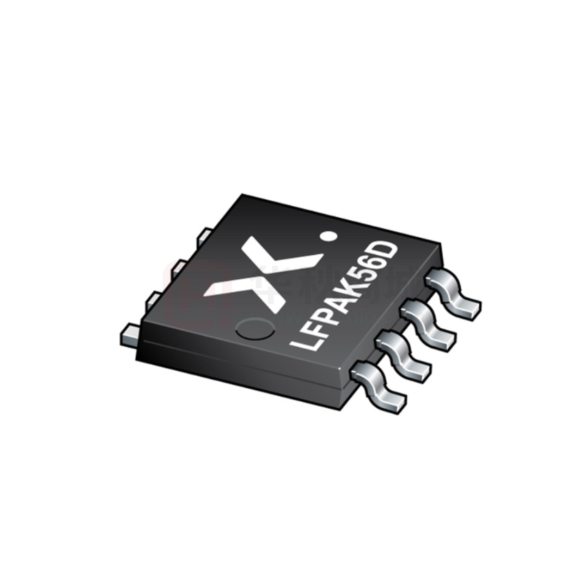

BUK9K20-80E Dual N-channel 80 V, 20 mΩ logic level MOSFET 17 August 2017 Product data sheet 1. General description Dual Logic level N-channel MOSFET in an LFPAK56D (Dual Power-SO8) package using TrenchMOS technology. This product has been designed and qualified to AEC-Q101 standard for use in high performance automotive applications. 2. Features and benefits • • • • • Dual MOSFET AEC-Q101 compliant Repetitive avalanche rated Suitable for thermally demanding environments due to 175 °C rating True logic level gate with VGS(th) rating of greater than 0.5 V at 175 °C 3. Applications • • • • 12 V, 24 V and 48 V automotive systems Motors, lamps and solenoid control Transmission control Ultra high performance power switching 4. Quick reference data Table 1. Quick reference data Symbol Parameter Conditions Min Typ Max Unit Limiting values FET1 and FET2 VDS drain-source voltage 25 °C ≤ Tj ≤ 175 °C - - 80 V ID drain current VGS = 5 V; Tmb = 25 °C; Fig. 2 - - 23 A Ptot total power dissipation Tmb = 25 °C; Fig. 1 - - 68 W VGS = 5 V; ID = 10 A; Tj = 25 °C; Fig. 11 - 14.2 19.4 mΩ - 9.4 - nC Static characteristics FET1 and FET2 RDSon drain-source on-state resistance Dynamic characteristics FET1 and FET2 QGD gate-drain charge ID = 10 A; VDS = 64 V; VGS = 5 V; Tj = 25 °C; Fig. 13; Fig. 14 BUK9K20-80E Nexperia Dual N-channel 80 V, 20 mΩ logic level MOSFET 5. Pinning information Table 2. Pinning information Pin Symbol Description 1 S1 source1 2 G1 gate1 3 S2 source2 4 G2 gate2 5 D2 drain2 6 D2 drain2 7 D1 drain1 8 D1 drain1 Simplified outline 8 7 6 Graphic symbol 5 D1 D1 S1 D2 D2 G1 S2 G2 mbk725 1 2 3 4 LFPAK56D (SOT1205) 6. Ordering information Table 3. Ordering information Type number Package BUK9K20-80E Name Description Version LFPAK56D plastic, single ended surface mounted package (LFPAK56D); 8 leads; 1.27 mm pitch; 4.7 mm x 5.3 mm x 1.05 mm body SOT1205 7. Marking Table 4. Marking codes Type number Marking code BUK9K20-80E 92080E 8. Limiting values Table 5. Limiting values In accordance with the Absolute Maximum Rating System (IEC 60134). Symbol Parameter Conditions Min Max Unit Limiting values FET1 and FET2 VDS drain-source voltage 25 °C ≤ Tj ≤ 175 °C - 80 V VDGR drain-gate voltage RGS = 20 kΩ - 80 V VGS gate-source voltage DC; Tj ≤ 175 °C -10 10 V -15 15 V Pulsed; Tj ≤ 175 °C [1] [2] Ptot total power dissipation Tmb = 25 °C; Fig. 1 - 68 W ID drain current VGS = 5 V; Tmb = 25 °C; Fig. 2 - 23 A VGS = 5 V; Tmb = 100 °C; Fig. 2 - 16 A BUK9K20-80E Product data sheet All information provided in this document is subject to legal disclaimers. 17 August 2017 © Nexperia B.V. 2017. All rights reserved 2 / 12 BUK9K20-80E Nexperia Dual N-channel 80 V, 20 mΩ logic level MOSFET Symbol Parameter Conditions Min Max Unit IDM peak drain current pulsed; tp ≤ 10 µs; Tmb = 25 °C; Fig. 3 - 92 A Tstg storage temperature -55 175 °C Tj junction temperature -55 175 °C Source-drain diode FET1 and FET2 IS source current Tmb = 25 °C - 23 A ISM peak source current pulsed; tp ≤ 10 µs; Tmb = 25 °C - 92 A - 132 mJ Avalanche ruggedness FET1 and FET2 EDS(AL)S [1] [2] [3] [4] non-repetitive drainsource avalanche energy ID = 23 A; Vsup ≤ 80 V; RGS = 50 Ω; VGS = 5 V; Tj(init) = 25 °C; unclamped; Fig. 4 [3] [4] Accumulated Pulse duration up to 50 hours delivers zero defect ppm. Significantly longer life times are achieved by lowering Tj and or VGS. Single-pulse avalanche rating limited by maximum junction temperature of 175 °C. Refer to application note AN10273 for further information. 03aa16 120 ID (A) Pder (%) aaa-026841 25 20 80 15 10 40 5 0 0 50 100 150 Tmb (°C) 0 200 0 25 50 75 100 125 150 175 Tmb (°C) 200 VGS ≥ 5 V Fig. 2. Fig. 1. Normalized total power dissipation as a function of mounting base temperature BUK9K20-80E Product data sheet Continuous drain current as a function of mounting base temperature, FET1 and FET2 All information provided in this document is subject to legal disclaimers. 17 August 2017 © Nexperia B.V. 2017. All rights reserved 3 / 12 BUK9K20-80E Nexperia Dual N-channel 80 V, 20 mΩ logic level MOSFET ID (A) aaa-026749 103 102 Limit RDSon = VDS / ID tp = 10 µs 100 µs 10 DC 1 1 ms 10 ms 100 ms 10-1 10-1 1 102 10 103 VDS (V) Tmb = 25 °C; IDM is a single pulse Fig. 3. Safe operating area; continuous and peak drain currents as a function of drain-source voltage, FET1 and FET2 IAL (A) aaa-026842 102 (1) 10 (2) 1 (3) 10-1 10-2 10-3 10-2 10-1 1 tAL (ms) 10 (1) Tj (init) = 25°C; (2) Tj (init) = 150°C; (3) Repetitive Avalanche Fig. 4. Avalanche rating; avalanche current as a function of avalanche time, FET1 and FET2 9. Thermal characteristics Table 6. Thermal characteristics Symbol Parameter Conditions Min Typ Max Unit Rth(j-mb) thermal resistance from junction to mounting base Fig. 5 - - 2.21 K/W Rth(j-a) thermal resistance from junction to ambient Minimum footprint; mounted on a printed circuit board - 95 - K/W BUK9K20-80E Product data sheet All information provided in this document is subject to legal disclaimers. 17 August 2017 © Nexperia B.V. 2017. All rights reserved 4 / 12 BUK9K20-80E Nexperia Dual N-channel 80 V, 20 mΩ logic level MOSFET 003aaj584 10 Zth(j-mb) (K/W) δ = 0.5 1 0.2 0.1 0.05 10-1 0.02 P 10-2 δ= single shot tp 10-3 Fig. 5. tp T 10-6 10-5 10-4 10-3 10-2 t T 10-1 1 tp (s) Transient thermal impedance from junction to mounting base as a function of pulse duration, FET1 and FET2 10. Characteristics Table 7. Characteristics Symbol Parameter Conditions Min Typ Max Unit drain-source breakdown voltage ID = 250 µA; VGS = 0 V; Tj = 25 °C 80 - - V ID = 250 µA; VGS = 0 V; Tj = -55 °C 72 - - V gate-source threshold voltage ID = 1 mA; VDS=VGS; Tj = 25 °C; Fig. 9; Fig. 10 1.4 1.7 2.1 V ID = 1 mA; VDS=VGS; Tj = -55 °C; Fig. 10 - - 2.45 V ID = 1 mA; VDS=VGS; Tj = 175 °C; Fig. 10 0.5 - - V VDS = 80 V; VGS = 0 V; Tj = 25 °C - 0.02 1 µA VDS = 80 V; VGS = 0 V; Tj = 175 °C - - 500 µA VGS = 10 V; VDS = 0 V; Tj = 25 °C - 2 100 nA VGS = -10 V; VDS = 0 V; Tj = 25 °C - 2 100 nA VGS = 5 V; ID = 10 A; Tj = 25 °C; Fig. 11 - 14.2 19.4 mΩ VGS = 10 V; ID = 10 A; Tj = 25 °C; Fig. 11 - 13 17 mΩ VGS = 5 V; ID = 10 A; Tj = 175 °C; Fig. 12 - - 49 mΩ - 25.5 - nC - 5.8 - nC - 9.4 - nC Static characteristics FET1 and FET2 V(BR)DSS VGS(th) IDSS IGSS RDSon drain leakage current gate leakage current drain-source on-state resistance Dynamic characteristics FET1 and FET2 QG(tot) total gate charge QGS gate-source charge QGD gate-drain charge BUK9K20-80E Product data sheet ID = 10 A; VDS = 64 V; VGS = 5 V; Tj = 25 °C; Fig. 13; Fig. 14 All information provided in this document is subject to legal disclaimers. 17 August 2017 © Nexperia B.V. 2017. All rights reserved 5 / 12 BUK9K20-80E Nexperia Dual N-channel 80 V, 20 mΩ logic level MOSFET Symbol Parameter Conditions Min Typ Max Unit Ciss input capacitance - 2603 3462 pF Coss output capacitance VDS = 25 V; VGS = 0 V; f = 1 MHz; Tj = 25 °C; Fig. 15 - 193 231 pF Crss reverse transfer capacitance - 101 138 pF td(on) turn-on delay time - 14.6 - ns tr rise time - 25.8 - ns td(off) turn-off delay time - 30 - ns tf fall time - 22.7 - ns VDS = 60 V; RL = 5 Ω; VGS = 5 V; RG(ext) = 5 Ω; Tj = 25 °C Source-drain diode FET1 and FET2 VSD source-drain voltage IS = 10 A; VGS = 0 V; Tj = 25 °C; Fig. 16 - 0.8 1.2 V trr reverse recovery time - 29.9 - ns Qr recovered charge IS = 10 A; dIS/dt = -100 A/µs; VGS = 0 V; VDS = 25 V; Tj = 25 °C - 36.5 - nC ID (A) aaa-026751 40 10 V 4.5 V 3V 30 aaa-026752 80 RDSon (mΩ) 60 2.8 V 20 40 VGS =2.6 V 10 20 2.4 V 0 0 1 2 3 VDS (V) 0 4 Tj = 25 °C Fig. 6. Product data sheet 2 4 6 8 VGS (V) 10 Tj = 25 °C; ID = 10 A Output characteristics; drain current as a function of drain-source voltage; typical values, FET1 and FET2 BUK9K20-80E 0 Fig. 7. Drain-source on-state resistance as a function of gate-source voltage; typical values, FET1 and FET2 All information provided in this document is subject to legal disclaimers. 17 August 2017 © Nexperia B.V. 2017. All rights reserved 6 / 12 BUK9K20-80E Nexperia Dual N-channel 80 V, 20 mΩ logic level MOSFET ID (A) aaa-026750 90 003aah026 10-1 ID (A) 10-2 60 min 10-3 typ max 10-4 30 175°C 0 0 1 10-5 Tj = 25°C 2 3 4 VGS (V) 10-6 5 VDS = 12 V Fig. 8. 0 1 2 3 V GS (V) Tj = 25 °C; VDS = 5 V Transfer characteristics; drain current as a function of gate-source voltage; typical values, FET1 and FET2 003aah025 3 VGS(th) (V) 2.5 Fig. 9. Sub-threshold drain current as a function of gate-source voltage, FET1 and FET2 aaa-026757 80 RDSon (mΩ) max 2.4 V 2.6 V 2.8 V 60 2 typ 1.5 40 3V min 1 20 4.5 V 0.5 0 -60 VGS = 10 V 0 60 120 Tj (° C) 0 180 Fig. 10. Gate-source threshold voltage as a function of junction temperature, FET1 and FET2 Product data sheet 10 20 30 ID (A) 40 Tj = 25 °C ID = 1 mA ; VDS = VGS BUK9K20-80E 0 Fig. 11. Drain-source on-state resistance as a function of drain current; typical values, FET1 and FET2 All information provided in this document is subject to legal disclaimers. 17 August 2017 © Nexperia B.V. 2017. All rights reserved 7 / 12 BUK9K20-80E Nexperia Dual N-channel 80 V, 20 mΩ logic level MOSFET 003aaj818 3 VGS (V) a aaa-026753 10 2.4 8 1.8 6 1.2 4 VDS = 14 V 64 V 0.6 2 0 -60 0 60 120 Tj ( °C) 0 180 0 10 20 30 40 QG (nC) 50 Tj = 25 °C; ID = 10 A Fig. 12. Normalized drain-source on-state resistance factor as a function of junction temperature, FET1 and FET2 Fig. 13. Gate-source voltage as a function of gate charge; typical values, FET1 and FET2 aaa-026754 104 VDS C (pF) ID Ciss 103 VGS(pl) VGS(th) Coss VGS QGS2 QGS1 QGS Crss 102 QGD QG(tot) 003aaa508 10 10-1 Fig. 14. Gate charge waveform definitions 1 10 VDS (V) 102 VGS = 0 V; f = 1 MHz Fig. 15. Input, output and reverse transfer capacitances as a function of drain-source voltage; typical values, FET1 and FET2 BUK9K20-80E Product data sheet All information provided in this document is subject to legal disclaimers. 17 August 2017 © Nexperia B.V. 2017. All rights reserved 8 / 12 BUK9K20-80E Nexperia Dual N-channel 80 V, 20 mΩ logic level MOSFET IS (A) aaa-026755 60 50 40 30 20 175°C 10 0 0 0.3 Tj = 25°C 0.6 0.9 VSD (V) 1.2 VGS = 0 V Fig. 16. Source-drain (diode forward) current as a function of source-drain (diode forward) voltage; typical values, FET1 and FET2 BUK9K20-80E Product data sheet All information provided in this document is subject to legal disclaimers. 17 August 2017 © Nexperia B.V. 2017. All rights reserved 9 / 12 BUK9K20-80E Nexperia Dual N-channel 80 V, 20 mΩ logic level MOSFET 11. Package outline Plastic single ended surface mounted package LFPAK56D; 8 leads E SOT1205 A A b1 c1 L1 mounting base D H D1 D2 L 1 2 3 e b (8x) 4 w X c A E1 E2 A1 C θ Lp detail X 0 2.5 A max 1.05 nom min 1.02 mm 5 mm scale Dimensions Unit y C D(1) D1(1) D2 (ref) E(1) E1(1) 4.4 0.25 0.30 4.70 4.55 3.5 5.30 1.8 0.85 4.1 0.19 0.24 4.45 4.35 3.4 4.95 1.6 0.60 A1 b b1 0.1 0.50 0.0 0.35 c c1 E2 e 1.27 H L L1 Lp 6.2 1.3 0.55 0.85 5.9 0.8 0.30 0.40 w y 0.25 0.1 Note 1. Plastic or metal protrusions of 0.2 mm maximum per side are not included. Outline version References IEC JEDEC JEITA θ 8° 0° sot1205_po European projection Issue date 14-08-21 14-10-28 SOT1205 Fig. 17. Package outline LFPAK56D (SOT1205) BUK9K20-80E Product data sheet All information provided in this document is subject to legal disclaimers. 17 August 2017 © Nexperia B.V. 2017. All rights reserved 10 / 12 BUK9K20-80E Nexperia Dual N-channel 80 V, 20 mΩ logic level MOSFET for the products described herein shall be limited in accordance with the Terms and conditions of commercial sale of Nexperia. 12. Legal information Right to make changes — Nexperia reserves the right to make changes to information published in this document, including without limitation specifications and product descriptions, at any time and without notice. This document supersedes and replaces all information supplied prior to the publication hereof. Data sheet status Document status [1][2] Product status [3] Objective [short] data sheet Development This document contains data from the objective specification for product development. Preliminary [short] data sheet Qualification This document contains data from the preliminary specification. Product [short] data sheet Production This document contains the product specification. [1] [2] [3] Suitability for use in automotive applications — This Nexperia product has been qualified for use in automotive applications. Unless otherwise agreed in writing, the product is not designed, authorized or warranted to be suitable for use in life support, life-critical or safety-critical systems or equipment, nor in applications where failure or malfunction of an Nexperia product can reasonably be expected to result in personal injury, death or severe property or environmental damage. Nexperia and its suppliers accept no liability for inclusion and/or use of Nexperia products in such equipment or applications and therefore such inclusion and/or use is at the customer's own risk. Definition Quick reference data — The Quick reference data is an extract of the product data given in the Limiting values and Characteristics sections of this document, and as such is not complete, exhaustive or legally binding. Please consult the most recently issued document before initiating or completing a design. The term 'short data sheet' is explained in section "Definitions". The product status of device(s) described in this document may have changed since this document was published and may differ in case of multiple devices. The latest product status information is available on the Internet at URL http://www.nexperia.com. Definitions Preview — The document is a preview version only. The document is still subject to formal approval, which may result in modifications or additions. Nexperia does not give any representations or warranties as to the accuracy or completeness of information included herein and shall have no liability for the consequences of use of such information. Draft — The document is a draft version only. The content is still under internal review and subject to formal approval, which may result in modifications or additions. Nexperia does not give any representations or warranties as to the accuracy or completeness of information included herein and shall have no liability for the consequences of use of such information. Short data sheet — A short data sheet is an extract from a full data sheet with the same product type number(s) and title. A short data sheet is intended for quick reference only and should not be relied upon to contain detailed and full information. For detailed and full information see the relevant full data sheet, which is available on request via the local Nexperia sales office. In case of any inconsistency or conflict with the short data sheet, the full data sheet shall prevail. Product specification — The information and data provided in a Product data sheet shall define the specification of the product as agreed between Nexperia and its customer, unless Nexperia and customer have explicitly agreed otherwise in writing. In no event however, shall an agreement be valid in which the Nexperia product is deemed to offer functions and qualities beyond those described in the Product data sheet. Disclaimers Limited warranty and liability — Information in this document is believed to be accurate and reliable. However, Nexperia does not give any representations or warranties, expressed or implied, as to the accuracy or completeness of such information and shall have no liability for the consequences of use of such information. Nexperia takes no responsibility for the content in this document if provided by an information source outside of Nexperia. Applications — Applications that are described herein for any of these products are for illustrative purposes only. Nexperia makes no representation or warranty that such applications will be suitable for the specified use without further testing or modification. Customers are responsible for the design and operation of their applications and products using Nexperia products, and Nexperia accepts no liability for any assistance with applications or customer product design. It is customer’s sole responsibility to determine whether the Nexperia product is suitable and fit for the customer’s applications and products planned, as well as for the planned application and use of customer’s third party customer(s). Customers should provide appropriate design and operating safeguards to minimize the risks associated with their applications and products. Nexperia does not accept any liability related to any default, damage, costs or problem which is based on any weakness or default in the customer’s applications or products, or the application or use by customer’s third party customer(s). Customer is responsible for doing all necessary testing for the customer’s applications and products using Nexperia products in order to avoid a default of the applications and the products or of the application or use by customer’s third party customer(s). Nexperia does not accept any liability in this respect. Limiting values — Stress above one or more limiting values (as defined in the Absolute Maximum Ratings System of IEC 60134) will cause permanent damage to the device. Limiting values are stress ratings only and (proper) operation of the device at these or any other conditions above those given in the Recommended operating conditions section (if present) or the Characteristics sections of this document is not warranted. Constant or repeated exposure to limiting values will permanently and irreversibly affect the quality and reliability of the device. Terms and conditions of commercial sale — Nexperia products are sold subject to the general terms and conditions of commercial sale, as published at http://www.nexperia.com/profile/terms, unless otherwise agreed in a valid written individual agreement. In case an individual agreement is concluded only the terms and conditions of the respective agreement shall apply. Nexperia hereby expressly objects to applying the customer’s general terms and conditions with regard to the purchase of Nexperia products by customer. No offer to sell or license — Nothing in this document may be interpreted or construed as an offer to sell products that is open for acceptance or the grant, conveyance or implication of any license under any copyrights, patents or other industrial or intellectual property rights. Export control — This document as well as the item(s) described herein may be subject to export control regulations. Export might require a prior authorization from competent authorities. In no event shall Nexperia be liable for any indirect, incidental, punitive, special or consequential damages (including - without limitation - lost profits, lost savings, business interruption, costs related to the removal or replacement of any products or rework charges) whether or not such damages are based on tort (including negligence), warranty, breach of contract or any other legal theory. Translations — A non-English (translated) version of a document is for reference only. The English version shall prevail in case of any discrepancy between the translated and English versions. Notwithstanding any damages that customer might incur for any reason whatsoever, Nexperia’ aggregate and cumulative liability towards customer Notice: All referenced brands, product names, service names and trademarks are the property of their respective owners. BUK9K20-80E Product data sheet Trademarks All information provided in this document is subject to legal disclaimers. 17 August 2017 © Nexperia B.V. 2017. All rights reserved 11 / 12 BUK9K20-80E Nexperia Dual N-channel 80 V, 20 mΩ logic level MOSFET 13. Contents 1. General description......................................................1 2. Features and benefits.................................................. 1 3. Applications.................................................................. 1 4. Quick reference data....................................................1 5. Pinning information......................................................2 6. Ordering information....................................................2 7. Marking.......................................................................... 2 8. Limiting values............................................................. 2 9. Thermal characteristics............................................... 4 10. Characteristics............................................................ 5 11. Package outline........................................................ 10 12. Legal information..................................................... 11 © Nexperia B.V. 2017. All rights reserved For more information, please visit: http://www.nexperia.com For sales office addresses, please send an email to: salesaddresses@nexperia.com Date of release: 17 August 2017 BUK9K20-80E Product data sheet All information provided in this document is subject to legal disclaimers. 17 August 2017 © Nexperia B.V. 2017. All rights reserved 12 / 12
