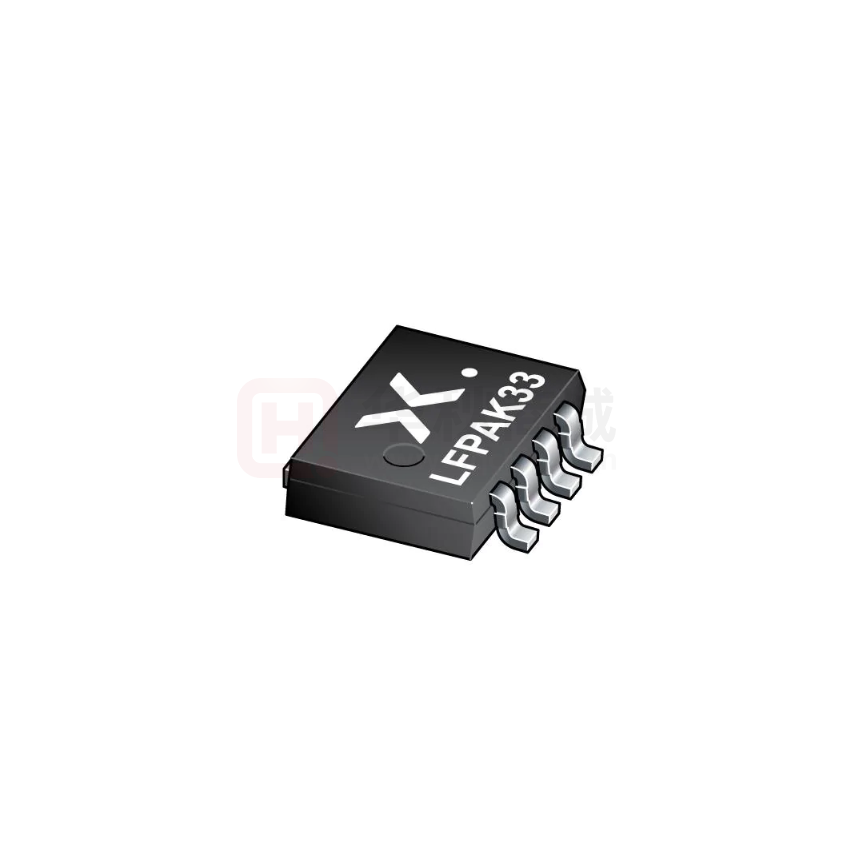

BUK9M8R5-40HX
BUK9M8R5-40HX
    NEXPERIA(安世)
    SOT-1210
    MOS管 N-channel Id=40A VDS=40V SOT1210
BUK9M8R5-40HX 数据手册
BUK9M8R5-40H N-channel 40 V, 8.5 mΩ logic level MOSFET in LFPAK33 29 January 2019 Product data sheet 1. General description Automotive qualified logic level N-channel MOSFET in an LFPAK33 package using Trench 9 TrenchMOS technology. This product has been designed and qualified to AEC-Q101 for use in high performance automotive applications. 2. Features and benefits • • • • Fully automotive qualified to AEC-Q101 at 175 °C Trench 9 superjunction technology: • Low power losses, high power density LFPAK copper clip package technology: • High robustness and reliability • Gull wing leads for high manufacturability and AOI Repetitive avalanche rated 3. Applications • • • • • 12 V automotive systems Powertrain, chassis, body and infotainment applications Medium/Low power motor drive DC-DC systems LED lighting 4. Quick reference data Table 1. Quick reference data Symbol Parameter Conditions Min Typ Max Unit VDS drain-source voltage 25 °C ≤ Tj ≤ 175 °C - - 40 V ID drain current VGS = 10 V; Tmb = 25 °C; Fig. 2 - - 40 A Ptot total power dissipation Tmb = 25 °C; Fig. 1 - - 59 W VGS = 10 V; ID = 15 A; Tj = 25 °C; Fig. 11 5 7.2 8.5 mΩ ID = 15 A; VDS = 20 V; VGS = 4.5 V; Fig. 13; Fig. 14 - 2.1 4.2 nC IS = 15 A; dIS/dt = -100 A/µs; VGS = 0 V; VDS = 20 V - 15 - nC [1] Static characteristics RDSon drain-source on-state resistance Dynamic characteristics QGD gate-drain charge Source-drain diode Qr recovered charge BUK9M8R5-40H Nexperia N-channel 40 V, 8.5 mΩ logic level MOSFET in LFPAK33 Symbol Parameter Conditions Min Typ Max S softness factor IS = 15 A; dIS/dt = -100 A/µs; VGS = 0 V; VDS = 20 V; Tj = 25 °C; Fig. 17 - 0.61 - [1] Unit 40A continuous current has been successfully demonstrated during application tests. Practically the current will be limited by PCB, thermal design and operating temperature. 5. Pinning information Table 2. Pinning information Pin Symbol Description Simplified outline Graphic symbol 1 S source 2 S source 3 S source G 4 G gate mbb076 mb D Mounting base; connected to drain D 1 2 3 S 4 LFPAK33 (SOT1210) 6. Ordering information Table 3. Ordering information Type number Package BUK9M8R5-40H Name Description Version LFPAK33 Plastic, single ended surface mounted package (LFPAK33); 8 leads; 0.65 mm pitch SOT1210 7. Marking Table 4. Marking codes Type number Marking code BUK9M8R5-40H 98H040 8. Limiting values Table 5. Limiting values In accordance with the Absolute Maximum Rating System (IEC 60134). Symbol Parameter Conditions Min Max Unit VDS drain-source voltage 25 °C ≤ Tj ≤ 175 °C - 40 V VGS gate-source voltage DC; Tj ≤ 175 °C -10 16 V Ptot total power dissipation Tmb = 25 °C; Fig. 1 - 59 W ID drain current VGS = 10 V; Tmb = 25 °C; Fig. 2 - 40 A VGS = 10 V; Tmb = 100 °C; Fig. 2 [1] - 40 A pulsed; tp ≤ 10 µs; Tmb = 25 °C; Fig. 3 - 239 A IDM peak drain current Tstg storage temperature -55 175 °C Tj junction temperature -55 175 °C Source-drain diode BUK9M8R5-40H Product data sheet All information provided in this document is subject to legal disclaimers. 29 January 2019 © Nexperia B.V. 2019. All rights reserved 2 / 11 BUK9M8R5-40H Nexperia N-channel 40 V, 8.5 mΩ logic level MOSFET in LFPAK33 Symbol Parameter Conditions Min Max Unit IS source current Tmb = 25 °C - 40 A ISM peak source current pulsed; tp ≤ 10 µs; Tmb = 25 °C - 239 A - 24 mJ Avalanche ruggedness EDS(AL)S [1] [2] [3] non-repetitive drainID = 40 A; Vsup ≤ 40 V; RGS = 50 Ω; source avalanche energy VGS = 10 V; Tj(init) = 25 °C; unclamped; Fig. 4 [2] [3] 40A continuous current has been successfully demonstrated during application tests. Practically the current will be limited by PCB, thermal design and operating temperature. Single-pulse avalanche rating limited by maximum junction temperature of 175 °C. Refer to application note AN10273 for further information. 03aa16 120 ID (A) Pder (%) aaa-029136 60 50 80 40 (1) 30 40 20 10 0 Fig. 1. 0 50 100 150 Tmb (°C) 0 200 25 50 75 100 125 150 175 Tmb (°C) Normalized total power dissipation as a function of mounting base temperature Continuous drain current as a function of mounting base temperature aaa-028980 103 102 200 VGS ≥ 10 V (1) 40A continuous current has been successfully demonstrated during application tests. Practically the current will be limited by PCB, thermal design and operating temperature. Fig. 2. ID (A) 0 Limit RDSon = VDS / ID tp = 10 µs DC 100 µs 10 1 ms 10 ms 100 ms 1 10-1 10-1 1 10 VDS (V) 102 Tmb = 25 °C; IDM is a single pulse Fig. 3. Safe operating area; continuous and peak drain currents as a function of drain-source voltage BUK9M8R5-40H Product data sheet All information provided in this document is subject to legal disclaimers. 29 January 2019 © Nexperia B.V. 2019. All rights reserved 3 / 11 BUK9M8R5-40H Nexperia N-channel 40 V, 8.5 mΩ logic level MOSFET in LFPAK33 IAL (A) aaa-028940 102 (1) 10 (2) 1 (3) 10-1 10-2 10-3 10-2 10-1 1 tAL (ms) 10 (1) Tj (init) = 25 °C; (2) Tj (init) = 150 °C; (3) Repetitive Avalanche Fig. 4. Avalanche rating; avalanche current as a function of avalanche time 9. Thermal characteristics Table 6. Thermal characteristics Symbol Parameter Rth(j-mb) Conditions thermal resistance from Fig. 5 junction to mounting base Min Typ Max Unit - 2.33 2.56 K/W aaa-028941 10 Zth(j-mb) (K/W) 1 δ = 0.5 0.2 0.1 10-1 0.05 P 0.02 δ= single shot Fig. 5. 10-5 10-4 10-3 10-2 T t tp 10-2 10-6 tp T 10-1 tp (s) 1 Transient thermal impedance from junction to mounting base as a function of pulse duration 10. Characteristics Table 7. Characteristics Symbol Parameter Conditions Min Typ Max Unit ID = 250 µA; VGS = 0 V; Tj = 25 °C 40 43 - V ID = 250 µA; VGS = 0 V; Tj = -40 °C - 40.5 - V Static characteristics V(BR)DSS drain-source breakdown voltage BUK9M8R5-40H Product data sheet All information provided in this document is subject to legal disclaimers. 29 January 2019 © Nexperia B.V. 2019. All rights reserved 4 / 11 BUK9M8R5-40H Nexperia N-channel 40 V, 8.5 mΩ logic level MOSFET in LFPAK33 Symbol VGS(th) IDSS IGSS RDSon RG Parameter gate-source threshold voltage drain leakage current gate leakage current drain-source on-state resistance gate resistance Conditions Min Typ Max Unit ID = 250 µA; VGS = 0 V; Tj = -55 °C 36 40 - V ID = 1 mA; VDS=VGS; Tj = 25 °C; Fig. 9; Fig. 10 1.45 1.77 2.15 V ID = 1 mA; VDS=VGS; Tj = -55 °C; Fig. 10 - - 2.6 V ID = 1 mA; VDS=VGS; Tj = 175 °C; Fig. 10 0.7 - - V VDS = 40 V; VGS = 0 V; Tj = 25 °C - 0.02 1 µA VDS = 16 V; VGS = 0 V; Tj = 125 °C - 0.42 10 µA VDS = 40 V; VGS = 0 V; Tj = 175 °C - 30 500 µA VGS = 16 V; VDS = 0 V; Tj = 25 °C - 2 100 nA VGS = -10 V; VDS = 0 V; Tj = 25 °C - 2 100 nA VGS = 10 V; ID = 15 A; Tj = 25 °C; Fig. 11 5 7.2 8.5 mΩ VGS = 10 V; ID = 15 A; Tj = 105 °C; Fig. 12 6.8 10.2 12.8 mΩ VGS = 10 V; ID = 15 A; Tj = 125 °C; Fig. 12 7.5 11.1 13.7 mΩ VGS = 10 V; ID = 15 A; Tj = 175 °C; Fig. 12 9.1 13.5 16.5 mΩ VGS = 4.5 V; ID = 15 A; Tj = 25 °C; Fig. 11 6.3 9 11 mΩ VGS = 4.5 V; ID = 15 A; Tj = 105 °C; Fig. 12 8.6 12.7 16.5 mΩ VGS = 4.5 V; ID = 15 A; Tj = 125 °C; Fig. 12 9.5 13.8 17.7 mΩ VGS = 4.5 V; ID = 15 A; Tj = 175 °C; Fig. 12 11.5 16.7 21.4 mΩ f = 1 MHz; Tj = 25 °C 0.3 0.8 2 Ω ID = 15 A; VDS = 20 V; VGS = 10 V; Fig. 13; Fig. 14 - 20 28 nC ID = 15 A; VDS = 20 V; VGS = 4.5 V; Fig. 13; Fig. 14 - 9 13 nC - 3.6 5.4 nC - 2.1 4.2 nC - 1286 1800 pF - 345 483 pF - 49 108 pF - 9.5 - ns - 9.4 - ns Dynamic characteristics QG(tot) total gate charge QGS gate-source charge QGD gate-drain charge Ciss input capacitance Coss output capacitance Crss reverse transfer capacitance td(on) turn-on delay time tr rise time td(off) turn-off delay time - 11 - ns tf fall time - 5.6 - ns VDS = 25 V; VGS = 0 V; f = 1 MHz; Tj = 25 °C; Fig. 15 VDS = 20 V; RL = 1.2 Ω; VGS = 4.5 V; RG(ext) = 5 Ω Source-drain diode VSD source-drain voltage IS = 15 A; VGS = 0 V; Tj = 25 °C; Fig. 16 - 0.85 1.2 V trr reverse recovery time IS = 15 A; dIS/dt = -100 A/µs; VGS = 0 V; VDS = 20 V; Fig. 17 - 22 - ns Qr recovered charge IS = 15 A; dIS/dt = -100 A/µs; VGS = 0 V; VDS = 20 V - 15 - nC BUK9M8R5-40H Product data sheet All information provided in this document is subject to legal disclaimers. 29 January 2019 © Nexperia B.V. 2019. All rights reserved 5 / 11 BUK9M8R5-40H Nexperia N-channel 40 V, 8.5 mΩ logic level MOSFET in LFPAK33 Symbol Parameter Conditions Min Typ Max S softness factor IS = 15 A; dIS/dt = -100 A/µs; VGS = 0 V; VDS = 20 V; Tj = 25 °C; Fig. 17 - 0.61 - IS = 15 A; dIS/dt = -500 A/µs; VGS = 0 V; VDS = 20 V; Tj = 25 °C; Fig. 17 - 0.41 - ID (A) aaa-028982 80 10 V 4.5 V Unit aaa-028983 40 RDSon (mΩ) 3.5 V 60 30 40 20 VGS = 3 V 2.8 V 20 10 2.6 V 0 Fig. 6. ID (A) 0 1 2 3 VDS (V) 0 4 0 2 4 6 8 10 12 14 VGS (V) 16 Tj = 25 °C Tj = 25 °C; ID = 15 A Output characteristics; drain current as a Fig. 7. function of drain-source voltage; typical values Drain-source on-state resistance as a function of gate-source voltage; typical values aaa-028984 60 aaa-029518 10-1 ID (A) 50 10-2 40 10-3 Min 30 Typ Max 10-4 20 175°C 10 10-5 Tj = -55°C 25°C 0 0 1 2 3 4 VGS (V) 10-6 5 VDS = 8 V Fig. 8. Product data sheet 0.5 1 1.5 2 2.5 VGS (V) 3 Tj = 25 °C; VDS = 5 V Transfer characteristics; drain current as a function of gate-source voltage; typical values BUK9M8R5-40H 0 Fig. 9. Sub-threshold drain current as a function of gate-source voltage All information provided in this document is subject to legal disclaimers. 29 January 2019 © Nexperia B.V. 2019. All rights reserved 6 / 11 BUK9M8R5-40H Nexperia N-channel 40 V, 8.5 mΩ logic level MOSFET in LFPAK33 aaa-029519 3 VGS(th) (V) 2.5 Max 2 aaa-028985 40 RDSon (mΩ) 2.8 V 3V 30 3.5 V Typ 1.5 20 Min 1 4.5 V 10 0.5 0 -60 VGS = 10 V -30 0 30 60 90 120 150 Tj (°C) 0 180 ID = 1 mA ; VDS = VGS 20 40 60 ID (A) 80 Tj = 25 °C Fig. 10. Gate-source threshold voltage as a function of junction temperature a 0 Fig. 11. Drain-source on-state resistance as a function of drain current; typical values aaa-029504 2 VGS (V) 1.7 aaa-028986 10 8 VGS = 4.5 V 1.4 6 10 V 1.1 20 V 4 VDS = 14 V 0.8 0.5 -60 2 -30 0 30 60 90 120 150 Tj (°C) 0 180 0 4 8 12 16 QG (nC) 20 Tj = 25 °C; ID = 15 A Fig. 12. Normalized drain-source on-state resistance factor as a function of junction temperature BUK9M8R5-40H Product data sheet Fig. 13. Gate-source voltage as a function of gate charge; typical values All information provided in this document is subject to legal disclaimers. 29 January 2019 © Nexperia B.V. 2019. All rights reserved 7 / 11 BUK9M8R5-40H Nexperia N-channel 40 V, 8.5 mΩ logic level MOSFET in LFPAK33 aaa-028987 104 C (pF) VDS ID Ciss 103 VGS(pl) Coss VGS(th) VGS QGS2 QGS1 QGS 102 Crss QGD QG(tot) 003aaa508 10 10-1 Fig. 14. Gate charge waveform definitions 1 10 VDS (V) 102 VGS = 0 V; f = 1 MHz Fig. 15. Input, output and reverse transfer capacitances as a function of drain-source voltage; typical values IS (A) 003aaf444 aaa-028988 80 ID (A) 60 trr ta 40 tb 0 0.25 IRM 20 175°C 0 0 0.2 0.4 0.6 Tj = 25°C 0.8 1 VSD (V) tb S= t a 1.2 VGS = 0 V Fig. 16. Source-drain (diode forward) current as a function of source-drain (diode forward) voltage; typical values BUK9M8R5-40H Product data sheet IRM t (s) Fig. 17. Reverse recovery timing definition All information provided in this document is subject to legal disclaimers. 29 January 2019 © Nexperia B.V. 2019. All rights reserved 8 / 11 BUK9M8R5-40H Nexperia N-channel 40 V, 8.5 mΩ logic level MOSFET in LFPAK33 11. Package outline Plastic single ended surface mounted package (LFPAK33); 8 leads E A e1 A c1 b1 L1 SOT1210 D2 mounting base D1 (D) H E1 L 1 4 b e w A A1 C X c Lp y C detail X 0 2.5 5 mm scale Dimensions Unit(1) A A1 b(1) max 0.90 0.10 0.35 nom min 0.80 0.00 0.25 mm b1(1) c c1 2.4 0.20 0.30 2.2 0.10 0.20 D ref 2.60 D1 2.35 1.90 D2 0.50 E(1) E1 3.40 2.45 3.20 2.00 e e1 0.65 0.65 H L L1 Lp 3.40 0.65 0.25 0.50 3.20 0.45 0.13 0.30 w 0.20 0.10 Note 1. Plastic or metal protrusions of 0.15 mm per side are not included. Outline version sot1210_po References IEC JEDEC y JEITA European projection Issue date 14-04-25 16-08-09 SOT1210 Fig. 18. Package outline LFPAK33 (SOT1210) BUK9M8R5-40H Product data sheet All information provided in this document is subject to legal disclaimers. 29 January 2019 © Nexperia B.V. 2019. All rights reserved 9 / 11 BUK9M8R5-40H Nexperia N-channel 40 V, 8.5 mΩ logic level MOSFET in LFPAK33 equipment, nor in applications where failure or malfunction of an Nexperia product can reasonably be expected to result in personal injury, death or severe property or environmental damage. Nexperia and its suppliers accept no liability for inclusion and/or use of Nexperia products in such equipment or applications and therefore such inclusion and/or use is at the customer's own risk. 12. Legal information Data sheet status Document status [1][2] Product status [3] Definition Quick reference data — The Quick reference data is an extract of the product data given in the Limiting values and Characteristics sections of this document, and as such is not complete, exhaustive or legally binding. Objective [short] data sheet Development This document contains data from the objective specification for product development. Preliminary [short] data sheet Qualification This document contains data from the preliminary specification. Applications — Applications that are described herein for any of these products are for illustrative purposes only. Nexperia makes no representation or warranty that such applications will be suitable for the specified use without further testing or modification. Product [short] data sheet Production This document contains the product specification. [1] [2] [3] Please consult the most recently issued document before initiating or completing a design. The term 'short data sheet' is explained in section "Definitions". The product status of device(s) described in this document may have changed since this document was published and may differ in case of multiple devices. The latest product status information is available on the internet at https://www.nexperia.com. Definitions Draft — The document is a draft version only. The content is still under internal review and subject to formal approval, which may result in modifications or additions. Nexperia does not give any representations or warranties as to the accuracy or completeness of information included herein and shall have no liability for the consequences of use of such information. Short data sheet — A short data sheet is an extract from a full data sheet with the same product type number(s) and title. A short data sheet is intended for quick reference only and should not be relied upon to contain detailed and full information. For detailed and full information see the relevant full data sheet, which is available on request via the local Nexperia sales office. In case of any inconsistency or conflict with the short data sheet, the full data sheet shall prevail. Product specification — The information and data provided in a Product data sheet shall define the specification of the product as agreed between Nexperia and its customer, unless Nexperia and customer have explicitly agreed otherwise in writing. In no event however, shall an agreement be valid in which the Nexperia product is deemed to offer functions and qualities beyond those described in the Product data sheet. Disclaimers Limited warranty and liability — Information in this document is believed to be accurate and reliable. However, Nexperia does not give any representations or warranties, expressed or implied, as to the accuracy or completeness of such information and shall have no liability for the consequences of use of such information. Nexperia takes no responsibility for the content in this document if provided by an information source outside of Nexperia. In no event shall Nexperia be liable for any indirect, incidental, punitive, special or consequential damages (including - without limitation - lost profits, lost savings, business interruption, costs related to the removal or replacement of any products or rework charges) whether or not such damages are based on tort (including negligence), warranty, breach of contract or any other legal theory. Customers are responsible for the design and operation of their applications and products using Nexperia products, and Nexperia accepts no liability for any assistance with applications or customer product design. It is customer’s sole responsibility to determine whether the Nexperia product is suitable and fit for the customer’s applications and products planned, as well as for the planned application and use of customer’s third party customer(s). Customers should provide appropriate design and operating safeguards to minimize the risks associated with their applications and products. Nexperia does not accept any liability related to any default, damage, costs or problem which is based on any weakness or default in the customer’s applications or products, or the application or use by customer’s third party customer(s). Customer is responsible for doing all necessary testing for the customer’s applications and products using Nexperia products in order to avoid a default of the applications and the products or of the application or use by customer’s third party customer(s). Nexperia does not accept any liability in this respect. Limiting values — Stress above one or more limiting values (as defined in the Absolute Maximum Ratings System of IEC 60134) will cause permanent damage to the device. Limiting values are stress ratings only and (proper) operation of the device at these or any other conditions above those given in the Recommended operating conditions section (if present) or the Characteristics sections of this document is not warranted. Constant or repeated exposure to limiting values will permanently and irreversibly affect the quality and reliability of the device. Terms and conditions of commercial sale — Nexperia products are sold subject to the general terms and conditions of commercial sale, as published at http://www.nexperia.com/profile/terms, unless otherwise agreed in a valid written individual agreement. In case an individual agreement is concluded only the terms and conditions of the respective agreement shall apply. Nexperia hereby expressly objects to applying the customer’s general terms and conditions with regard to the purchase of Nexperia products by customer. No offer to sell or license — Nothing in this document may be interpreted or construed as an offer to sell products that is open for acceptance or the grant, conveyance or implication of any license under any copyrights, patents or other industrial or intellectual property rights. Export control — This document as well as the item(s) described herein may be subject to export control regulations. Export might require a prior authorization from competent authorities. Translations — A non-English (translated) version of a document is for reference only. The English version shall prevail in case of any discrepancy between the translated and English versions. Trademarks Notice: All referenced brands, product names, service names and trademarks are the property of their respective owners. Notwithstanding any damages that customer might incur for any reason whatsoever, Nexperia’s aggregate and cumulative liability towards customer for the products described herein shall be limited in accordance with the Terms and conditions of commercial sale of Nexperia. Right to make changes — Nexperia reserves the right to make changes to information published in this document, including without limitation specifications and product descriptions, at any time and without notice. This document supersedes and replaces all information supplied prior to the publication hereof. Suitability for use in automotive applications — This Nexperia product has been qualified for use in automotive applications. Unless otherwise agreed in writing, the product is not designed, authorized or warranted to be suitable for use in life support, life-critical or safety-critical systems or BUK9M8R5-40H Product data sheet All information provided in this document is subject to legal disclaimers. 29 January 2019 © Nexperia B.V. 2019. All rights reserved 10 / 11 BUK9M8R5-40H Nexperia N-channel 40 V, 8.5 mΩ logic level MOSFET in LFPAK33 Contents 1. General description...................................................... 1 2. Features and benefits.................................................. 1 3. Applications.................................................................. 1 4. Quick reference data....................................................1 5. Pinning information......................................................2 6. Ordering information....................................................2 7. Marking.......................................................................... 2 8. Limiting values............................................................. 2 9. Thermal characteristics............................................... 4 10. Characteristics............................................................ 4 11. Package outline.......................................................... 9 12. Legal information......................................................10 © Nexperia B.V. 2019. All rights reserved For more information, please visit: http://www.nexperia.com For sales office addresses, please send an email to: salesaddresses@nexperia.com Date of release: 29 January 2019 BUK9M8R5-40H Product data sheet All information provided in this document is subject to legal disclaimers. 29 January 2019 © Nexperia B.V. 2019. All rights reserved 11 / 11
