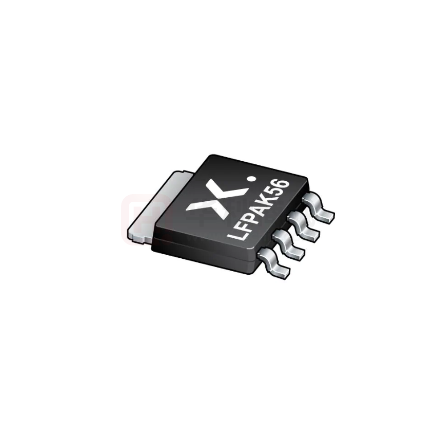

    MOS管 N-channel Id=120A VDS=40V SOT669
BUK9Y2R8-40HX 数据手册
BUK9Y2R8-40H N-channel 40 V, 2.8 mΩ logic level MOSFET in LFPAK56 31 May 2018 Product data sheet 1. General description Automotive qualified N-channel MOSFET using the latest Trench 9 low ohmic superjunction technology, housed in a robust LFPAK56 package. This product has been fully designed and qualified to meet AEC-Q101 requirements delivering high performance and endurance. 2. Features and benefits • Fully automotive qualified to AEC-Q101: • • 175 °C rating suitable for thermally demanding environments Trench 9 Superjunction technology: • • Reduced cell pitch enables enhanced power density and efficiency with lower RDSon in same footprint • Improved SOA and avalanche capability compared to standard TrenchMOS • Tight VGS(th) limits enable easy paralleling of MOSFETs LFPAK Gull Wing leads: • • High Board Level Reliability absorbing mechanical stress during thermal cycling, unlike traditional QFN packages • Visual (AOI) soldering inspection, no need for expensive x-ray equipment • Easy solder wetting for good mechanical solder joint LFPAK copper clip technology: • • Improved reliability, with reduced Rth and RDSon Increases maximum current capability and improved current spreading 3. Applications • • • • • 12 V automotive systems Motors, lamps and solenoid control Start-Stop micro-hybrid applications Transmission control Ultra high performance power switching 4. Quick reference data Table 1. Quick reference data Symbol Parameter Conditions Min Typ Max Unit VDS drain-source voltage 25 °C ≤ Tj ≤ 175 °C - - 40 V ID drain current VGS = 10 V; Tmb = 25 °C - - 120 A Ptot total power dissipation Tmb = 25 °C; Fig. 1 - - 172 W [1] BUK9Y2R8-40H Nexperia N-channel 40 V, 2.8 mΩ logic level MOSFET in LFPAK56 Symbol Parameter Conditions Min Typ Max Unit VGS = 10 V; ID = 25 A; Tj = 25 °C; Fig. 10 1.68 2.4 2.8 mΩ ID = 25 A; VDS = 20 V; VGS = 4.5 V; Fig. 12; Fig. 13 - 4.7 9 nC nC Static characteristics RDSon drain-source on-state resistance Dynamic characteristics QGD gate-drain charge Source-drain diode Qr recovered charge IS = 25 A; dIS/dt = -100 A/µs; VGS = 0 V; VDS = 20 V; Tj = 25 °C - 20.4 - S softness factor IS = 25 A; dIS/dt = -100 A/µs; VGS = 0 V; VDS = 20 V; Tj = 25 °C; Fig. 16 - 0.83 - [1] 120A continuous current has been successfully demonstrated during application tests. Practically the current will be limited by PCB, thermal design and operating temperature. 5. Pinning information Table 2. Pinning information Pin Symbol Description 1 S source 2 S source 3 S source 4 G gate mb D Simplified outline Graphic symbol D mb G mbb076 mounting base; connected to drain S 1 2 3 4 LFPAK56; PowerSO8 (SOT669) 6. Ordering information Table 3. Ordering information Type number BUK9Y2R8-40H Package Name Description Version LFPAK56; Power-SO8 plastic, single-ended surface-mounted package; 4 terminals SOT669 7. Marking Table 4. Marking codes Type number Marking code BUK9Y2R8-40H 92H840 BUK9Y2R8-40H Product data sheet All information provided in this document is subject to legal disclaimers. 31 May 2018 © Nexperia B.V. 2018. All rights reserved 2 / 12 BUK9Y2R8-40H Nexperia N-channel 40 V, 2.8 mΩ logic level MOSFET in LFPAK56 8. Limiting values Table 5. Limiting values In accordance with the Absolute Maximum Rating System (IEC 60134). Symbol Parameter Conditions Min Max Unit VDS drain-source voltage 25 °C ≤ Tj ≤ 175 °C - 40 V VGS gate-source voltage DC; Tj ≤ 175 °C -10 16 V Ptot total power dissipation Tmb = 25 °C; Fig. 1 - 172 W ID drain current VGS = 10 V; Tmb = 25 °C - 120 A IDM peak drain current pulsed; tp ≤ 10 µs; Tmb = 25 °C; Fig. 2 - 600 A Tstg storage temperature -55 175 °C Tj junction temperature -55 175 °C [1] Source-drain diode IS source current Tmb = 25 °C - 120 A ISM peak source current pulsed; tp ≤ 10 µs; Tmb = 25 °C - 600 A - 50 mJ Avalanche ruggedness EDS(AL)S [1] [2] [3] non-repetitive drainsource avalanche energy ID = 120 A; Vsup ≤ 40 V; RGS = 50 Ω; VGS = 10 V; Tj(init) = 25 °C; unclamped; Fig. 3 [2] [3] 120A continuous current has been successfully demonstrated during application tests. Practically the current will be limited by PCB, thermal design and operating temperature. Single-pulse avalanche rating limited by maximum junction temperature of 175 °C. Refer to application note AN10273 for further information. 03aa16 120 Pder (%) 80 40 0 Fig. 1. 0 50 100 150 Tmb (°C) 200 Normalized total power dissipation as a function of mounting base temperature BUK9Y2R8-40H Product data sheet All information provided in this document is subject to legal disclaimers. 31 May 2018 © Nexperia B.V. 2018. All rights reserved 3 / 12 BUK9Y2R8-40H Nexperia N-channel 40 V, 2.8 mΩ logic level MOSFET in LFPAK56 ID (A) aaa-027787 103 Limit RDSon = VDS / ID tp = 10 µs 102 100 µs DC 10 1 ms 10 ms 100 ms 1 10-1 10-1 1 10 102 VDS (V) Tmb = 25 °C; IDM is a single pulse Fig. 2. Safe operating area; continuous and peak drain currents as a function of drain-source voltage IAL (A) aaa-027786 103 102 (1) 10 (2) (3) 1 10-1 10-3 10-2 10-1 1 tAL (ms) 10 (1) Tj (init) = 25°C; (2) Tj (init) = 150°C; (3) Repetitive Avalanche Fig. 3. Avalanche rating; avalanche current as a function of avalanche time 9. Thermal characteristics Table 6. Thermal characteristics Symbol Parameter Conditions Min Typ Max Unit Rth(j-mb) thermal resistance from junction to mounting base Fig. 4 - 0.77 0.87 K/W BUK9Y2R8-40H Product data sheet All information provided in this document is subject to legal disclaimers. 31 May 2018 © Nexperia B.V. 2018. All rights reserved 4 / 12 BUK9Y2R8-40H Nexperia N-channel 40 V, 2.8 mΩ logic level MOSFET in LFPAK56 aaa-027087 1 Zth(j-mb) (K/W) δ = 0.5 0.2 10-1 0.1 0.05 0.02 single shot 10-2 P δ= Fig. 4. 10-5 10-4 10-3 10-2 T t tp 10-3 10-6 tp T 10-1 1 tp (s) Transient thermal impedance from junction to mounting base as a function of pulse duration 10. Characteristics Table 7. Characteristics Symbol Parameter Conditions Min Typ Max Unit ID = 250 µA; VGS = 0 V; Tj = 25 °C 40 43 - V ID = 250 µA; VGS = 0 V; Tj = -40 °C - 40.5 - V ID = 250 µA; VGS = 0 V; Tj = -55 °C 36 40 - V ID = 1 mA; VDS=VGS; Tj = 25 °C; Fig. 8; Fig. 9 1.35 1.66 2.05 V ID = 1 mA; VDS=VGS; Tj = 175 °C; Fig. 9 0.6 - - V ID = 1 mA; VDS=VGS; Tj = -55 °C; Fig. 9 - - 2.5 V VDS = 40 V; VGS = 0 V; Tj = 25 °C - 0.06 5 µA VDS = 16 V; VGS = 0 V; Tj = 125 °C - 0.8 10 µA VDS = 40 V; VGS = 0 V; Tj = 175 °C - 108 500 µA VGS = 16 V; VDS = 0 V; Tj = 25 °C - 2 100 nA VGS = -10 V; VDS = 0 V; Tj = 25 °C - 2 100 nA Static characteristics V(BR)DSS VGS(th) IDSS IGSS drain-source breakdown voltage gate-source threshold voltage drain leakage current gate leakage current BUK9Y2R8-40H Product data sheet All information provided in this document is subject to legal disclaimers. 31 May 2018 © Nexperia B.V. 2018. All rights reserved 5 / 12 BUK9Y2R8-40H Nexperia N-channel 40 V, 2.8 mΩ logic level MOSFET in LFPAK56 Symbol Parameter Conditions Min Typ Max Unit RDSon drain-source on-state resistance VGS = 10 V; ID = 25 A; Tj = 25 °C; Fig. 10 1.68 2.4 2.8 mΩ VGS = 10 V; ID = 25 A; Tj = 105 °C; Fig. 11 2.5 3.6 4.4 mΩ VGS = 10 V; ID = 25 A; Tj = 125 °C; Fig. 11 2.7 4 5 mΩ VGS = 10 V; ID = 25 A; Tj = 175 °C; Fig. 11 3.5 4.9 6.2 mΩ VGS = 4.5 V; ID = 25 A; Tj = 25 °C; Fig. 10 2.1 3 3.9 mΩ VGS = 4.5 V; ID = 25 A; Tj = 105 °C; Fig. 11 3.1 4.5 6.1 mΩ VGS = 4.5 V; ID = 25 A; Tj = 125 °C; Fig. 11 3.4 4.9 6.8 mΩ VGS = 4.5 V; ID = 25 A; Tj = 175 °C; Fig. 11 4.4 6 8.6 mΩ f = 1 MHz; Tj = 25 °C 0.32 0.8 2 Ω ID = 25 A; VDS = 20 V; VGS = 10 V; Fig. 12; Fig. 13 - 44 62 nC ID = 25 A; VDS = 20 V; VGS = 4.5 V; Fig. 12; Fig. 13 - 20 28 nC - 8 12.2 nC - 4.7 9 nC - 3101 4341 pF - 709 992 pF - 112 246 pF - 18.9 - ns - 21.6 - ns RG gate resistance Dynamic characteristics QG(tot) total gate charge QGS gate-source charge QGD gate-drain charge Ciss input capacitance Coss output capacitance Crss reverse transfer capacitance td(on) turn-on delay time tr rise time td(off) turn-off delay time - 22.5 - ns tf fall time - 13.2 - ns VDS = 25 V; VGS = 0 V; f = 1 MHz; Tj = 25 °C; Fig. 14 VDS = 20 V; RL = 0.8 Ω; VGS = 4.5 V; RG(ext) = 5 Ω Source-drain diode VSD source-drain voltage IS = 25 A; VGS = 0 V; Tj = 25 °C; Fig. 15 - 0.81 1.2 V trr reverse recovery time IS = 25 A; dIS/dt = -100 A/µs; VGS = 0 V; VDS = 20 V; Tj = 25 °C; Fig. 16 - 28.1 - ns Qr recovered charge IS = 25 A; dIS/dt = -100 A/µs; VGS = 0 V; VDS = 20 V; Tj = 25 °C - 20.4 - nC S softness factor IS = 25 A; dIS/dt = -100 A/µs; VGS = 0 V; VDS = 20 V; Tj = 25 °C; Fig. 16 - 0.83 - IS = 25 A; dIS/dt = -500 A/µs; VGS = 0 V; VDS = 20 V; Tj = 25 °C; Fig. 16 - 0.66 - BUK9Y2R8-40H Product data sheet All information provided in this document is subject to legal disclaimers. 31 May 2018 © Nexperia B.V. 2018. All rights reserved 6 / 12 BUK9Y2R8-40H Nexperia N-channel 40 V, 2.8 mΩ logic level MOSFET in LFPAK56 aaa-027789 130 ID (A) 10 V 4.5 V 104 aaa-027790 10 RDSon (mΩ) 8 VGS = 3 V 78 6 2.8 V 52 4 2.6 V 26 2 2.4 V 0 Fig. 5. 0 1 2 3 VDS (V) 0 4 0 2 4 6 8 16 Tj = 25 °C; ID = 25 A Output characteristics; drain current as a Fig. 6. function of drain-source voltage; typical values Drain-source on-state resistance as a function of gate-source voltage; typical values aaa-027821 aaa-027637 10-1 ID (A) 160 10-2 120 10-3 Min 80 25°C 1 2 3 4 VGS (V) 10-6 5 VDS = 8 V Product data sheet 0 0.5 1 1.5 2 2.5 VGS (V) 3 Tj = 25 °C; VDS = 5 V Transfer characteristics; drain current as a function of gate-source voltage; typical values BUK9Y2R8-40H Max 10-5 Tj = -55°C 0 Typ 10-4 175°C 40 Fig. 7. 12 14 VGS (V) Tj = 25 °C 200 ID (A) 0 10 Fig. 8. Sub-threshold drain current as a function of gate-source voltage All information provided in this document is subject to legal disclaimers. 31 May 2018 © Nexperia B.V. 2018. All rights reserved 7 / 12 BUK9Y2R8-40H Nexperia N-channel 40 V, 2.8 mΩ logic level MOSFET in LFPAK56 aaa-027638 3 VGS(th) (V) 2.5 aaa-027791 20 RDSon (mΩ) 2.6 V 2.8 V 3V 16 Max 2 12 1.5 Typ 8 Min 1 0 -60 -30 0 30 60 90 120 150 Tj (°C) 0 180 ID = 1 mA ; VDS = VGS Fig. 9. a 4.5 V 4 0.5 VGS = 10 V 0 40 80 160 ID (A) 200 Tj = 25 °C Gate-source threshold voltage as a function of junction temperature Fig. 10. Drain-source on-state resistance as a function of drain current; typical values aaa-027640 2.4 VGS (V) 2.1 aaa-027792 10 8 1.8 VGS = 4.5 V 6 1.5 10 V 20 V 4 1.2 VDS = 14 V 2 0.9 0.6 -60 120 -30 0 30 60 90 120 150 Tj (°C) 0 180 0 10 20 30 40 QG (nC) 50 Tj = 25 °C; ID = 25 A Fig. 11. Normalized drain-source on-state resistance factor as a function of junction temperature BUK9Y2R8-40H Product data sheet Fig. 12. Gate-source voltage as a function of gate charge; typical values All information provided in this document is subject to legal disclaimers. 31 May 2018 © Nexperia B.V. 2018. All rights reserved 8 / 12 BUK9Y2R8-40H Nexperia N-channel 40 V, 2.8 mΩ logic level MOSFET in LFPAK56 aaa-027793 104 C (pF) VDS ID Ciss 103 VGS(pl) Coss VGS(th) VGS QGS2 QGS1 QGS Crss 102 QGD QG(tot) 003aaa508 10 10-1 Fig. 13. Gate charge waveform definitions 1 10 VDS (V) 102 VGS = 0 V; f = 1 MHz Fig. 14. Input, output and reverse transfer capacitances as a function of drain-source voltage; typical values 003aaf444 aaa-027794 300 IS (A) ID (A) 240 trr ta 180 tb 0 120 0.25 IRM 60 0 175°C 0 0.2 0.4 0.6 Tj = 25°C 0.8 1 VSD (V) tb S= t a IRM 1.2 t (s) VGS = 0 V Fig. 15. Source-drain (diode forward) current as a function of source-drain (diode forward) voltage; typical values BUK9Y2R8-40H Product data sheet Fig. 16. Reverse recovery waveform definitions All information provided in this document is subject to legal disclaimers. 31 May 2018 © Nexperia B.V. 2018. All rights reserved 9 / 12 BUK9Y2R8-40H Nexperia N-channel 40 V, 2.8 mΩ logic level MOSFET in LFPAK56 11. Package outline Plastic single-ended surface-mounted package (LFPAK56; Power-SO8); 4 leads E A2 A SOT669 C c2 b2 E1 b3 L1 mounting base b4 D1 D H L2 1 2 3 e 4 w b A X c 1/2 e A (A3) A1 C q L detail X 0 y C θ 5 mm 8° scale 0° Dimensions (mm are the original dimensions) Unit(1) A A1 A2 A3 b b2 max 1.20 0.15 1.10 0.50 4.41 nom 0.25 min 1.01 0.00 0.95 0.35 3.62 mm c c2 D(1) D1(1) E(1) E1(1) b3 b4 2.2 0.9 0.25 0.30 4.10 4.20 5.0 3.3 2.0 0.7 0.19 0.24 3.80 4.8 3.1 e 1.27 H L L1 L2 6.2 0.85 1.3 1.3 5.8 0.40 0.8 0.8 Note 1. Plastic or metal protrusions of 0.15 mm maximum per side are not included. Outline version SOT669 References IEC JEDEC JEITA w y 0.25 0.1 sot669_po European projection Issue date 11-03-25 13-02-27 MO-235 Fig. 17. Package outline LFPAK56; Power-SO8 (SOT669) BUK9Y2R8-40H Product data sheet All information provided in this document is subject to legal disclaimers. 31 May 2018 © Nexperia B.V. 2018. All rights reserved 10 / 12 BUK9Y2R8-40H Nexperia N-channel 40 V, 2.8 mΩ logic level MOSFET in LFPAK56 Suitability for use in automotive applications — This Nexperia product has been qualified for use in automotive applications. Unless otherwise agreed in writing, the product is not designed, authorized or warranted to be suitable for use in life support, life-critical or safety-critical systems or equipment, nor in applications where failure or malfunction of an Nexperia product can reasonably be expected to result in personal injury, death or severe property or environmental damage. Nexperia and its suppliers accept no liability for inclusion and/or use of Nexperia products in such equipment or applications and therefore such inclusion and/or use is at the customer's own risk. 12. Legal information Data sheet status Document status [1][2] Product status [3] Definition Objective [short] data sheet Development This document contains data from the objective specification for product development. Preliminary [short] data sheet Qualification This document contains data from the preliminary specification. Product [short] data sheet Production This document contains the product specification. [1] [2] [3] Please consult the most recently issued document before initiating or completing a design. The term 'short data sheet' is explained in section "Definitions". The product status of device(s) described in this document may have changed since this document was published and may differ in case of multiple devices. The latest product status information is available on the internet at https://www.nexperia.com. Definitions Draft — The document is a draft version only. The content is still under internal review and subject to formal approval, which may result in modifications or additions. Nexperia does not give any representations or warranties as to the accuracy or completeness of information included herein and shall have no liability for the consequences of use of such information. Short data sheet — A short data sheet is an extract from a full data sheet with the same product type number(s) and title. A short data sheet is intended for quick reference only and should not be relied upon to contain detailed and full information. For detailed and full information see the relevant full data sheet, which is available on request via the local Nexperia sales office. In case of any inconsistency or conflict with the short data sheet, the full data sheet shall prevail. Product specification — The information and data provided in a Product data sheet shall define the specification of the product as agreed between Nexperia and its customer, unless Nexperia and customer have explicitly agreed otherwise in writing. In no event however, shall an agreement be valid in which the Nexperia product is deemed to offer functions and qualities beyond those described in the Product data sheet. Disclaimers Limited warranty and liability — Information in this document is believed to be accurate and reliable. However, Nexperia does not give any representations or warranties, expressed or implied, as to the accuracy or completeness of such information and shall have no liability for the consequences of use of such information. Nexperia takes no responsibility for the content in this document if provided by an information source outside of Nexperia. In no event shall Nexperia be liable for any indirect, incidental, punitive, special or consequential damages (including - without limitation - lost profits, lost savings, business interruption, costs related to the removal or replacement of any products or rework charges) whether or not such damages are based on tort (including negligence), warranty, breach of contract or any other legal theory. Quick reference data — The Quick reference data is an extract of the product data given in the Limiting values and Characteristics sections of this document, and as such is not complete, exhaustive or legally binding. Applications — Applications that are described herein for any of these products are for illustrative purposes only. Nexperia makes no representation or warranty that such applications will be suitable for the specified use without further testing or modification. Customers are responsible for the design and operation of their applications and products using Nexperia products, and Nexperia accepts no liability for any assistance with applications or customer product design. It is customer’s sole responsibility to determine whether the Nexperia product is suitable and fit for the customer’s applications and products planned, as well as for the planned application and use of customer’s third party customer(s). Customers should provide appropriate design and operating safeguards to minimize the risks associated with their applications and products. Nexperia does not accept any liability related to any default, damage, costs or problem which is based on any weakness or default in the customer’s applications or products, or the application or use by customer’s third party customer(s). Customer is responsible for doing all necessary testing for the customer’s applications and products using Nexperia products in order to avoid a default of the applications and the products or of the application or use by customer’s third party customer(s). Nexperia does not accept any liability in this respect. Limiting values — Stress above one or more limiting values (as defined in the Absolute Maximum Ratings System of IEC 60134) will cause permanent damage to the device. Limiting values are stress ratings only and (proper) operation of the device at these or any other conditions above those given in the Recommended operating conditions section (if present) or the Characteristics sections of this document is not warranted. Constant or repeated exposure to limiting values will permanently and irreversibly affect the quality and reliability of the device. Terms and conditions of commercial sale — Nexperia products are sold subject to the general terms and conditions of commercial sale, as published at http://www.nexperia.com/profile/terms, unless otherwise agreed in a valid written individual agreement. In case an individual agreement is concluded only the terms and conditions of the respective agreement shall apply. Nexperia hereby expressly objects to applying the customer’s general terms and conditions with regard to the purchase of Nexperia products by customer. No offer to sell or license — Nothing in this document may be interpreted or construed as an offer to sell products that is open for acceptance or the grant, conveyance or implication of any license under any copyrights, patents or other industrial or intellectual property rights. Export control — This document as well as the item(s) described herein may be subject to export control regulations. Export might require a prior authorization from competent authorities. Translations — A non-English (translated) version of a document is for reference only. The English version shall prevail in case of any discrepancy between the translated and English versions. Trademarks Notwithstanding any damages that customer might incur for any reason whatsoever, Nexperia’s aggregate and cumulative liability towards customer for the products described herein shall be limited in accordance with the Terms and conditions of commercial sale of Nexperia. Notice: All referenced brands, product names, service names and trademarks are the property of their respective owners. Right to make changes — Nexperia reserves the right to make changes to information published in this document, including without limitation specifications and product descriptions, at any time and without notice. This document supersedes and replaces all information supplied prior to the publication hereof. BUK9Y2R8-40H Product data sheet All information provided in this document is subject to legal disclaimers. 31 May 2018 © Nexperia B.V. 2018. All rights reserved 11 / 12 BUK9Y2R8-40H Nexperia N-channel 40 V, 2.8 mΩ logic level MOSFET in LFPAK56 Contents 1. General description......................................................1 2. Features and benefits.................................................. 1 3. Applications.................................................................. 1 4. Quick reference data....................................................1 5. Pinning information......................................................2 6. Ordering information....................................................2 7. Marking.......................................................................... 2 8. Limiting values............................................................. 3 9. Thermal characteristics............................................... 4 10. Characteristics............................................................ 5 11. Package outline........................................................ 10 12. Legal information.......................................................11 © Nexperia B.V. 2018. All rights reserved For more information, please visit: http://www.nexperia.com For sales office addresses, please send an email to: salesaddresses@nexperia.com Date of release: 31 May 2018 BUK9Y2R8-40H Product data sheet All information provided in this document is subject to legal disclaimers. 31 May 2018 © Nexperia B.V. 2018. All rights reserved 12 / 12 Mouser Electronics Authorized Distributor Click to View Pricing, Inventory, Delivery & Lifecycle Information: Nexperia: BUK9Y2R8-40HX
