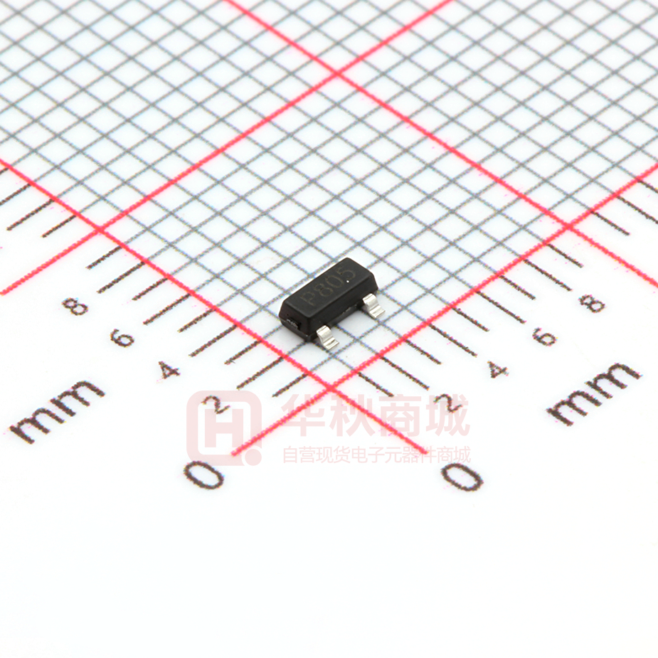

    SOT-23
    输出类型:固定 输出极性:正 输出通道数:1 最大输入电压:30V 输出电压:5V 压差:1.7V@(100mA) 输出电流:100mA
PJ78L05SA 数据手册
PJ78L05SA 3-Terminal Voltage Regulator Features SOT-23  Input voltage:up to 30V  Output Voltage:5V  Output current up to 100 mA, internal thermal overload protection and short-circuit limiting.  Continuous total dissipation PD: Internal limited 1. OUT Maximum Ratings 2.IN 3. GND Ratings at TA = 25℃ ambient temperature unless otherwise specified. Parameter Symbols Value Units Input Voltage VI 30 V Output Current IO 100 mA Junction Temperature TJ 150 ℃ Operating Temperature Range TOPR -40~125 ℃ Storage Temperature Range TSTG -55~150 ℃ Electrical Characteristics Ratings at TA = 25℃ ambient temperature unless otherwise specified. Parameter Symbols Test Conditions Min Typ Max Unit 4.80 5.0 5.2 V IO=1mA to 40mA VI=7V to 20V 4.75 5.0 5.25 V IO=1mA to 70mA VI=10V 4.75 5.0 5.25 V Io=40mA Output Voltage Line Regulation VO Vo △ VO Load Regulation △ Ripple Rejection RR Output Noise Voltage eN Dropout Voltage VD Quiescent Current IQ Quiescent Current Change www.pingjingsemi.com Revision1.0 Sep-2018 △ IQ TJ=25℃ VI=7V to 20V TJ=25℃ 32 150 mV VI=8V to 20V TJ=25℃ 26 100 mV 15 60 mV 8 30 mV IO=1mA to 100mA IO=1mA to 40 mA VI=8V to 18V TJ=25℃ TJ=25℃ TJ=25℃ 49 dB 42 μV TJ=25℃ 1.7 V TJ=25℃ 3.8 f=10Hz~100KHz f=120Hz TJ=25℃ 41 6 mA TJ=125℃ 5.5 mA VI=8V to 20V 1.5 mA IO=1mA to 40mA 0.1 mA 1/3 PJ78L05SA 3-Terminal Voltage Regulator Ratings and Characteristic Curves - - Vo -VI VI Vo 8.0 2.5 TJ IO =70mA vout =5.0v 2.0 (V) (V) 6.0 1.5 4.0 IO = 100mA IO = 40mA IO = 40mA 1.0 VI Vo - - Vo IO =1.0mA 2.0 IO = 1.0mA 0.5 0 0 2.0 4.0 6.0 8.0 0 10 0 25 50 75 VI - ( V ) TJ - (℃) IQ - TA IQ -VI 4.2 100 125 5.0 4.0 4.0 (mA) 3.0 - IQ 3.6 3.4 IQ (mA) 3.8 2.0 3.2 1.0 3.0 VI =10V IO=40mA 0 0 25 IO =40mA 0 50 75 100 125 0 5.0 15 20 25 30 35 40 VI - (V ) TA - ( ℃ ) Vi 10 1 2 Vo PJ78L05SA C1 0.33 µF www.pingjingsemi.com Revision1.0 Sep-2018 3 C2 0.1 µF 2/3 PJ78L05SA 3-Terminal Voltage Regulator Package Outline SOT-23 0.8 Max. 1.025 1.150 A1 0.000 0.050 0.100 b c D 0.300 0.080 2.800 0.400 0.115 2.900 0.500 0.150 3.000 E 1.200 1.300 1.400 HE 2.250 2.400 2.550 e 1.800 1.900 2.000 0.550REF L1 L 0.300 0o θ 0.500 8o 2.2 Typ. 0.900 A 0.8 1.0 Min. 1.0 Dimensions in millimeter Symbol 1.9 SOT-23 (TO-236) Recommended soldering pad Ordering Information Device Package Shipping PJ78L05SA SOT-23 3,000/ Tape & Reel (7 inches) www.pingjingsemi.com Revision1.0 Sep-2018 3/3
