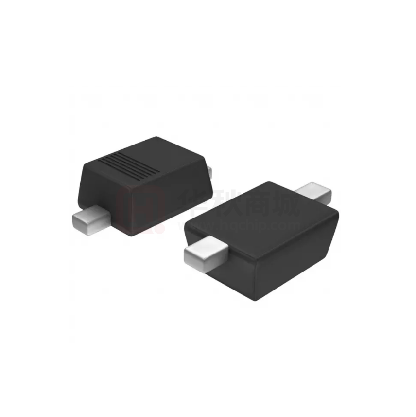

BZX84J series Single Zener diodes Rev. 2 — 1 August 2011 Product data sheet 1. Product profile 1.1 General description General-purpose Zener diodes in a SOD323F (SC-90) very small and flat lead Surface-Mounted Device (SMD) plastic package. 1.2 Features and benefits  Non-repetitive peak reverse power dissipation:  40 W  Total power dissipation:  550 mW  AEC-Q101 qualified  Small plastic package suitable for surface-mounted design  Wide working voltage range: nominal 2.4 V to 75 V (E24 range)  Two tolerance series: 2 % and 5 %  Low differential resistance 1.3 Applications  General regulation functions 1.4 Quick reference data Table 1. Quick reference data Symbol Parameter VF forward voltage PZSM non-repetitive peak reverse power dissipation Conditions IF = 100 mA [1] Pulse test: tp  300 s;   0.02. [2] tp = 100 s; square wave; Tj = 25 C prior to surge Min Typ Max Unit [1] - - 1.1 V [2] - - 40 W 2. Pinning information Table 2. Pin Pinning Description 1 cathode 2 anode Simplified outline Symbol [1] 1 2 1 2 006aaa152 [1] The marking bar indicates the cathode. BZX84J series Nexperia Single Zener diodes 3. Ordering information Table 3. Ordering information Type number Package BZX84J-B2V4 to B ZX84J-C75[1] [1] Name Description Version SC-90 plastic surface-mounted package; 2 leads SOD323F The series consists of 74 types with nominal working voltages from 2.4 V to 75 V. 4. Marking Table 4. Marking codes Type number Marking code Type number Marking code Type number Marking code Type number Marking code BZX84J-B2V4 SL BZX84J-B15 SC BZX84J-C2V4 U3 BZX84J-C15 TV BZX84J-B2V7 SM BZX84J-B16 SD BZX84J-C2V7 U4 BZX84J-C16 TW BZX84J-B3V0 ST BZX84J-B18 SE BZX84J-C3V0 U9 BZX84J-C18 TX BZX84J-B3V3 SU BZX84J-B20 SF BZX84J-C3V3 UA BZX84J-C20 TY BZX84J-B3V6 SV BZX84J-B22 SG BZX84J-C3V6 UB BZX84J-C22 TZ BZX84J-B3V9 SW BZX84J-B24 SH BZX84J-C3V9 UC BZX84J-C24 U1 BZX84J-B4V3 SZ BZX84J-B27 SK BZX84J-C4V3 UF BZX84J-C27 U2 BZX84J-B4V7 TA BZX84J-B30 SN BZX84J-C4V7 UG BZX84J-C30 U5 BZX84J-B5V1 TD BZX84J-B33 SP BZX84J-C5V1 UL BZX84J-C33 U6 BZX84J-B5V6 TE BZX84J-B36 SR BZX84J-C5V6 UM BZX84J-C36 U7 BZX84J-B6V2 TH BZX84J-B39 SS BZX84J-C6V2 UR BZX84J-C39 U8 BZX84J-B6V8 TK BZX84J-B43 SX BZX84J-C6V8 US BZX84J-C43 UD BZX84J-B7V5 TM BZX84J-B47 SY BZX84J-C7V5 UU BZX84J-C47 UE BZX84J-B8V2 TN BZX84J-B51 TB BZX84J-C8V2 UV BZX84J-C51 UH BZX84J-B9V1 TP BZX84J-B56 TC BZX84J-C9V1 UW BZX84J-C56 UK BZX84J-B10 S8 BZX84J-B62 TF BZX84J-C10 TR BZX84J-C62 UN BZX84J-B11 S9 BZX84J-B68 TG BZX84J-C11 TS BZX84J-C68 UP BZX84J-B12 SA BZX84J-B75 TL BZX84J-C12 TT BZX84J-C75 UT BZX84J-B13 SB - - BZX84J-C13 TU - - BZX84J_SER Product data sheet All information provided in this document is subject to legal disclaimers. Rev. 2 — 1 August 2011 © Nexperia B.V. 2017. All rights reserved 2 of 13 BZX84J series Nexperia Single Zener diodes 5. Limiting values Table 5. Limiting values In accordance with the Absolute Maximum Rating System (IEC 60134). Symbol Parameter Conditions IF forward current Min Max Unit mA - 250 - see Table 8 and 9 IZSM non-repetitive peak reverse current [1] PZSM non-repetitive peak reverse power dissipation [1] - 40 W Ptot total power dissipation [2] - 550 mW Tj junction temperature - 150 C Tamb ambient temperature 55 +150 C Tstg storage temperature 65 +150 C Tamb  25 C [1] tp = 100 s; square wave; Tj = 25 C prior to surge [2] Device mounted on an FR4 Printed-Circuit Board (PCB), single-sided copper, tin-plated, mounting pad for cathode 1 cm2. 6. Thermal characteristics Table 6. Symbol Thermal characteristics Parameter Conditions Rth(j-a) thermal resistance from junction to ambient Rth(j-sp) thermal resistance from junction to solder point in free air Min Typ Max Unit [1] - - 230 K/W [2] - - 55 K/W [1] Device mounted on an FR4 PCB, single-sided copper, tin-plated, mounting pad for cathode 1 cm2. [2] Soldering point of cathode tab. 7. Characteristics Table 7. Characteristics Tj = 25 C unless otherwise specified. Symbol VF [1] BZX84J_SER Product data sheet Parameter Conditions Min Typ Max Unit IF = 10 mA - - 0.9 V IF = 100 mA - - 1.1 V [1] forward voltage Pulse test: tp  300 s;   0.02. All information provided in this document is subject to legal disclaimers. Rev. 2 — 1 August 2011 © Nexperia B.V. 2017. All rights reserved 3 of 13 BZX84J series Nexperia Single Zener diodes Table 8. Characteristics per type; BZX84J-B2V4 to BZX84J-C24 Tj = 25 C unless otherwise specified. BZX84J- Sel xxx Working voltage Differential resistance Reverse current Temperature coefficient Diode capacitance VZ (V) rdif () IR (A) SZ (mV/K) Cd (pF)[1] Non-repetitive peak reverse current IZSM (A)[2] 2V4 2V7 3V0 3V3 3V6 3V9 4V3 4V7 5V1 5V6 6V2 6V8 7V5 8V2 9V1 10 11 12 IZ = 5 mA IZ = 1 mA IZ = 5 mA Min Max Max Max Max VR (V) Min B 2.35 2.45 400 100 50 1 C 2.2 2.6 450 100 20 500 95 500 B 2.65 2.75 C 2.5 2.9 B 2.94 3.06 C 2.8 3.2 B 3.23 3.37 C 3.1 3.5 B 3.53 3.67 C 3.4 3.8 B 3.82 3.98 C 3.7 4.1 B 4.21 4.39 C 4 4.6 B 4.61 4.79 C 4.4 5 B 5 5.2 C 4.8 5.4 B 5.49 5.71 C 5.2 6 B 6.08 6.32 C 5.8 6.6 B 6.66 6.94 C 6.4 7.2 B 7.35 7.65 C 7 7.9 B 8.04 8.36 C 7.7 8.7 B 8.92 9.28 C 8.5 9.6 B 9.8 10.2 C 9.4 10.6 B 10.8 11.2 C 10.4 11.6 B 11.8 12.2 C 11.4 12.7 BZX84J_SER Product data sheet IZ = 5 mA Max Max Max 3.5 0 450 12 1 3.5 0 440 12 10 1 3.5 0 425 12 95 5 1 3.5 0 410 12 500 90 5 1 3.5 0 390 12 500 90 3 1 3.5 0 370 12 600 90 3 1 3.5 0 350 12 500 80 3 2 3.5 0.2 325 12 480 60 2 2 2.7 1.2 300 12 400 40 1 2 2 2.5 275 12 150 10 3 4 0.4 3.7 250 12 80 15 2 4 1.2 4.5 215 12 80 10 1 5 2.5 5.3 170 4 80 10 0.7 5 3.2 6.2 150 4 100 10 0.5 6 3.8 7 120 3 150 10 0.2 7 4.5 8 110 3 150 10 0.1 8 5.4 9 108 2.5 150 10 0.1 8 6 10 105 2.5 All information provided in this document is subject to legal disclaimers. Rev. 2 — 1 August 2011 © Nexperia B.V. 2017. All rights reserved 4 of 13 BZX84J series Nexperia Single Zener diodes Table 8. Characteristics per type; BZX84J-B2V4 to BZX84J-C24 …continued Tj = 25 C unless otherwise specified. BZX84J- Sel xxx Working voltage Differential resistance Reverse current Temperature coefficient Diode capacitance VZ (V) rdif () IR (A) SZ (mV/K) Cd (pF)[1] Non-repetitive peak reverse current IZSM (A)[2] 13 15 16 18 20 22 24 IZ = 5 mA IZ = 1 mA IZ = 5 mA Min Max Max Max Max VR (V) Min Max Max Max B 12.7 13.3 170 10 0.1 8 7 11 103 2.5 C 12.4 14.1 B 14.7 15.3 200 15 0.05 10.5 9.2 13 99 2 C 13.8 15.6 B 15.7 16.3 200 20 0.05 11.2 10.4 14 97 1.5 C 15.3 17.1 B 17.6 18.4 225 20 0.05 12.6 12.4 16 93 1.5 C 16.8 19.1 B 19.6 20.4 225 20 0.05 14 14.4 18 88 1.5 C 18.8 21.2 B 21.6 22.4 250 25 0.05 15.4 16.4 20 84 1.25 C 20.8 23.3 B 23.5 24.5 250 30 0.05 16.8 18.4 22 80 1.25 C 22.8 25.6 [1] f = 1 MHz; VR = 0 V [2] tp = 100 s; square wave; Tj = 25 C prior to surge BZX84J_SER Product data sheet IZ = 5 mA All information provided in this document is subject to legal disclaimers. Rev. 2 — 1 August 2011 © Nexperia B.V. 2017. All rights reserved 5 of 13 BZX84J series Nexperia Single Zener diodes Table 9. Characteristics per type; BZX84J-B27 to BZX84J-C75 Tj = 25 C unless otherwise specified. BZX84J- Sel xxx Working voltage Differential resistance Reverse current Temperature coefficient VZ (V) rdif () IR (A) SZ (mV/K) Diode Non-repetitive capacitance peak reverse current C (pF)[1] d IZSM (A)[2] 27 30 33 36 39 43 47 51 56 62 68 75 IZ = 2 mA IZ = 0.5 mA IZ = 2 mA Min Max Max Max Max VR (V) Min Max Max Max B 26.5 27.5 250 40 0.05 18.9 21.4 25.3 73 1 C 25.1 28.9 B 29.4 30.6 250 40 0.05 21 24.4 29.4 66 1 C 28 32 B 32.3 33.7 275 40 0.05 23.1 27.4 33.4 60 0.9 C 31 35 300 60 0.05 25.2 30.4 37.4 59 0.8 300 75 0.05 27.3 33.4 41.2 58 0.7 325 80 0.05 30.1 37.6 46.6 56 0.6 325 90 0.05 32.9 42 51.8 55 0.5 350 110 0.05 35.7 46.6 57.2 52 0.4 375 120 0.05 39.2 52.2 63.8 49 0.3 400 140 0.05 43.4 58.8 71.6 44 0.3 400 160 0.05 47.6 65.6 79.8 40 0.25 400 175 0.05 52.5 73.4 88.6 35 0.2 B 35.3 36.7 C 34 38 B 38.2 39.8 C 37 41 B 42.1 43.9 C 40 46 B 46.1 47.9 C 44 50 B 50 52 C 48 54 B 54.9 57.1 C 52 60 B 60.8 63.2 C 58 66 B 66.6 69.4 C 64 72 B 73.5 76.5 C 70 79 [1] f = 1 MHz; VR = 0 V [2] tp = 100 s; square wave; Tj = 25 C prior to surge BZX84J_SER Product data sheet IZ = 2 mA All information provided in this document is subject to legal disclaimers. Rev. 2 — 1 August 2011 © Nexperia B.V. 2017. All rights reserved 6 of 13 BZX84J series Nexperia Single Zener diodes mbg801 103 PZSM (W) mbg781 300 IF (mA) 102 200 (1) 10 100 (2) 1 10−1 1 0 0.6 10 tp (ms) 0.8 1 VF (V) (1) Tj = 25 C (prior to surge) Tj = 25 C (2) Tj = 150 C (prior to surge) Fig 1. Non-repetitive peak reverse power dissipation as a function of pulse duration; maximum values Fig 2. mld444 0.5 SZ (mV/K) Forward current as a function of forward voltage; typical values mld445 12 15 SZ (mV/K) 4V7 13 12 11 10 9V1 8V2 7V5 6V8 6V2 5V6 5V1 0 8 4V3 −0.5 2V4 4 2V7 3V9 −1 3V6 −1.5 0 3V3 3V0 −2 10−1 1 −4 10−1 102 10 1 102 10 IZ (mA) Fig 3. IZ (mA) BZX84J-B/C2V4 to BZX84J-B/C4V7 BZX84J-B/C5V1 to BZX84J-B/C15 Tj = 25 C to 150 C Tj = 25 C to 150 C Temperature coefficient as a function of working current; typical values BZX84J_SER Product data sheet Fig 4. Temperature coefficient as a function of working current; typical values All information provided in this document is subject to legal disclaimers. Rev. 2 — 1 August 2011 © Nexperia B.V. 2017. All rights reserved 7 of 13 BZX84J series Nexperia Single Zener diodes 006aaa996 50 VZ(nom) (V) = 2.7 IZ (mA) VZ(nom) (V) = 10 IZ (mA) 25 3.3 3.9 40 006aaa997 30 4.7 5.6 6.8 12 20 8.2 30 15 15 20 10 18 10 22 27 0 0 0 2 4 6 8 10 0 10 20 30 VZ (V) Fig 5. 33 36 5 40 VZ (V) Tj = 25 C Tj = 25 C BZX84J-B/C2V7 to BZX84J-B/C8V2 BZX84J-B/C10 to BZX84J-B/C36 Working current as a function of working voltage; typical values Fig 6. Working current as a function of working voltage; typical values 8. Test information 8.1 Quality information This product has been qualified in accordance with the Automotive Electronics Council (AEC) standard Q101 - Stress test qualification for discrete semiconductors, and is suitable for use in automotive applications. BZX84J_SER Product data sheet All information provided in this document is subject to legal disclaimers. Rev. 2 — 1 August 2011 © Nexperia B.V. 2017. All rights reserved 8 of 13 BZX84J series Nexperia Single Zener diodes 9. Package outline 1.35 1.15 0.80 0.65 0.5 0.3 1 2.7 2.3 1.8 1.6 2 0.25 0.10 0.40 0.25 Dimensions in mm Fig 7. 04-09-13 Package outline SOD323F (SC-90) 10. Packing information Table 10. Packing methods The indicated -xxx are the last three digits of the 12NC ordering code.[1] Type number Package BZX84J-B2V4 to SOD323F BZX84J-C75 [1] Description Packing quantity 4 mm pitch, 8 mm tape and reel 3000 10000 -115 -135 For further information and the availability of packing methods, see Section 14. 11. Soldering 3.05 2.2 2.1 solder lands solder resist 0.5 (2×) 1.65 0.95 0.6 (2×) solder paste occupied area 0.5 (2×) 0.6 (2×) Dimensions in mm sod323f_fr Reflow soldering is the only recommended soldering method. Fig 8. BZX84J_SER Product data sheet Reflow soldering footprint SOD323F (SC-90) All information provided in this document is subject to legal disclaimers. Rev. 2 — 1 August 2011 © Nexperia B.V. 2017. All rights reserved 9 of 13 BZX84J series Nexperia Single Zener diodes 12. Revision history Table 11. Revision history Document ID Release date Data sheet status Change notice Supersedes BZX84J_SER v.2 20110801 Product data sheet - BZX84J_SER v.1 Modifications: BZX84J_SER v.1 BZX84J_SER Product data sheet • • • • • • Figure 5 and Figure 6 updated Figure 8 updated Section 1.2 “Features and benefits” updated Section 5 “Limiting values” updated Section 8 “Test information” added Section 13 “Legal information” updated 20070301 Product data sheet - All information provided in this document is subject to legal disclaimers. Rev. 2 — 1 August 2011 - © Nexperia B.V. 2017. All rights reserved 10 of 13 BZX84J series Nexperia Single Zener diodes 13. Legal information 13.1 Data sheet status Document status[1][2] Product status[3] Definition Objective [short] data sheet Development This document contains data from the objective specification for product development. Preliminary [short] data sheet Qualification This document contains data from the preliminary specification. Product [short] data sheet Production This document contains the product specification. [1] Please consult the most recently issued document before initiating or completing a design. [2] The term ‘short data sheet’ is explained in section “Definitions”. [3] The product status of device(s) described in this document may have changed since this document was published and may differ in case of multiple devices. The latest product status information is available on the Internet at URL http://www.nexperia.com. 13.2 Definitions Draft — The document is a draft version only. The content is still under internal review and subject to formal approval, which may result in modifications or additions. Nexperia does not give any representations or warranties as to the accuracy or completeness of information included herein and shall have no liability for the consequences of use of such information. Short data sheet — A short data sheet is an extract from a full data sheet with the same product type number(s) and title. A short data sheet is intended for quick reference only and should not be relied upon to contain detailed and full information. For detailed and full information see the relevant full data sheet, which is available on request via the local Nexperia sales office. In case of any inconsistency or conflict with the short data sheet, the full data sheet shall prevail. Product specification — The information and data provided in a Product data sheet shall define the specification of the product as agreed between Nexperia and its customer, unless Nexperia and customer have explicitly agreed otherwise in writing. In no event however, shall an agreement be valid in which the Nexperia product is deemed to offer functions and qualities beyond those described in the Product data sheet. 13.3 Disclaimers Limited warranty and liability — Information in this document is believed to be accurate and reliable. However, Nexperia does not give any representations or warranties, expressed or implied, as to the accuracy or completeness of such information and shall have no liability for the consequences of use of such information. In no event shall Nexperia be liable for any indirect, incidental, punitive, special or consequential damages (including - without limitation - lost profits, lost savings, business interruption, costs related to the removal or replacement of any products or rework charges) whether or not such damages are based on tort (including negligence), warranty, breach of contract or any other legal theory. Notwithstanding any damages that customer might incur for any reason whatsoever, Nexperia’s aggregate and cumulative liability towards customer for the products described herein shall be limited in accordance with the Terms and conditions of commercial sale of Nexperia. malfunction of a Nexperia product can reasonably be expected to result in personal injury, death or severe property or environmental damage. Nexperia accepts no liability for inclusion and/or use of Nexperia products in such equipment or applications and therefore such inclusion and/or use is at the customer’s own risk. Applications — Applications that are described herein for any of these products are for illustrative purposes only. Nexperia makes no representation or warranty that such applications will be suitable for the specified use without further testing or modification. Customers are responsible for the design and operation of their applications and products using Nexperia products, and Nexperia accepts no liability for any assistance with applications or customer product design. It is customer’s sole responsibility to determine whether the Nexperia product is suitable and fit for the customer’s applications and products planned, as well as for the planned application and use of customer’s third party customer(s). Customers should provide appropriate design and operating safeguards to minimize the risks associated with their applications and products. Nexperia does not accept any liability related to any default, damage, costs or problem which is based on any weakness or default in the customer’s applications or products, or the application or use by customer’s third party customer(s). Customer is responsible for doing all necessary testing for the customer’s applications and products using Nexperia products in order to avoid a default of the applications and the products or of the application or use by customer’s third party customer(s). Nexperia does not accept any liability in this respect. Limiting values — Stress above one or more limiting values (as defined in the Absolute Maximum Ratings System of IEC 60134) will cause permanent damage to the device. Limiting values are stress ratings only and (proper) operation of the device at these or any other conditions above those given in the Recommended operating conditions section (if present) or the Characteristics sections of this document is not warranted. Constant or repeated exposure to limiting values will permanently and irreversibly affect the quality and reliability of the device. Terms and conditions of commercial sale — Nexperia products are sold subject to the general terms and conditions of commercial sale, as published at http://www.nexperia.com/profile/terms, unless otherwise agreed in a valid written individual agreement. In case an individual agreement is concluded only the terms and conditions of the respective agreement shall apply. Nexperia hereby expressly objects to applying the customer’s general terms and conditions with regard to the purchase of Nexperia products by customer. Right to make changes — Nexperia reserves the right to make changes to information published in this document, including without limitation specifications and product descriptions, at any time and without notice. This document supersedes and replaces all information supplied prior to the publication hereof. No offer to sell or license — Nothing in this document may be interpreted or construed as an offer to sell products that is open for acceptance or the grant, conveyance or implication of any license under any copyrights, patents or other industrial or intellectual property rights. Suitability for use — Nexperia products are not designed, authorized or warranted to be suitable for use in life support, life-critical or safety-critical systems or equipment, nor in applications where failure or Export control — This document as well as the item(s) described herein may be subject to export control regulations. Export might require a prior authorization from national authorities. BZX84J_SER Product data sheet All information provided in this document is subject to legal disclaimers. Rev. 2 — 1 August 2011 © Nexperia B.V. 2017. All rights reserved 11 of 13 BZX84J series Nexperia Single Zener diodes Quick reference data — The Quick reference data is an extract of the product data given in the Limiting values and Characteristics sections of this document, and as such is not complete, exhaustive or legally binding. 13.4 Trademarks Notice: All referenced brands, product names, service names and trademarks are the property of their respective owners. 14. Contact information For more information, please visit: http://www.nexperia.com For sales office addresses, please send an email to: salesaddresses@nexperia.com BZX84J_SER Product data sheet All information provided in this document is subject to legal disclaimers. Rev. 2 — 1 August 2011 © Nexperia B.V. 2017. All rights reserved 12 of 13 Nexperia BZX84J series Single Zener diodes 15. Contents 1 1.1 1.2 1.3 1.4 2 3 4 5 6 7 8 8.1 9 10 11 12 13 13.1 13.2 13.3 13.4 14 15 © Product profile . . . . . . . . . . . . . . . . . . . . . . . . . . 1 General description . . . . . . . . . . . . . . . . . . . . . 1 Features and benefits . . . . . . . . . . . . . . . . . . . . 1 Applications . . . . . . . . . . . . . . . . . . . . . . . . . . . 1 Quick reference data . . . . . . . . . . . . . . . . . . . . 1 Pinning information . . . . . . . . . . . . . . . . . . . . . . 1 Ordering information . . . . . . . . . . . . . . . . . . . . . 2 Marking . . . . . . . . . . . . . . . . . . . . . . . . . . . . . . . . 2 Limiting values. . . . . . . . . . . . . . . . . . . . . . . . . . 3 Thermal characteristics . . . . . . . . . . . . . . . . . . 3 Characteristics . . . . . . . . . . . . . . . . . . . . . . . . . . 3 Test information . . . . . . . . . . . . . . . . . . . . . . . . . 8 Quality information . . . . . . . . . . . . . . . . . . . . . . 8 Package outline . . . . . . . . . . . . . . . . . . . . . . . . . 9 Packing information . . . . . . . . . . . . . . . . . . . . . 9 Soldering . . . . . . . . . . . . . . . . . . . . . . . . . . . . . . 9 Revision history . . . . . . . . . . . . . . . . . . . . . . . . 10 Legal information. . . . . . . . . . . . . . . . . . . . . . . 11 Data sheet status . . . . . . . . . . . . . . . . . . . . . . 11 Definitions . . . . . . . . . . . . . . . . . . . . . . . . . . . . 11 Disclaimers . . . . . . . . . . . . . . . . . . . . . . . . . . . 11 Trademarks. . . . . . . . . . . . . . . . . . . . . . . . . . . 12 Contact information. . . . . . . . . . . . . . . . . . . . . 12 Contents . . . . . . . . . . . . . . . . . . . . . . . . . . . . . . 13 Nexperia B.V. 2017. All rights reserved For more information, please visit: http://www.nexperia.com For sales office addresses, please send an email to: salesaddresses@nexperia.com Date of release: 01 August 2011
